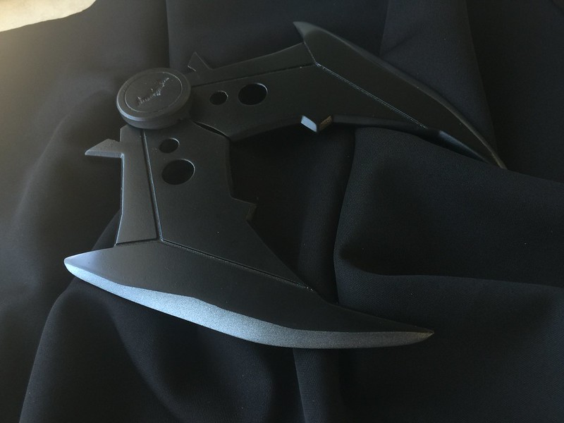

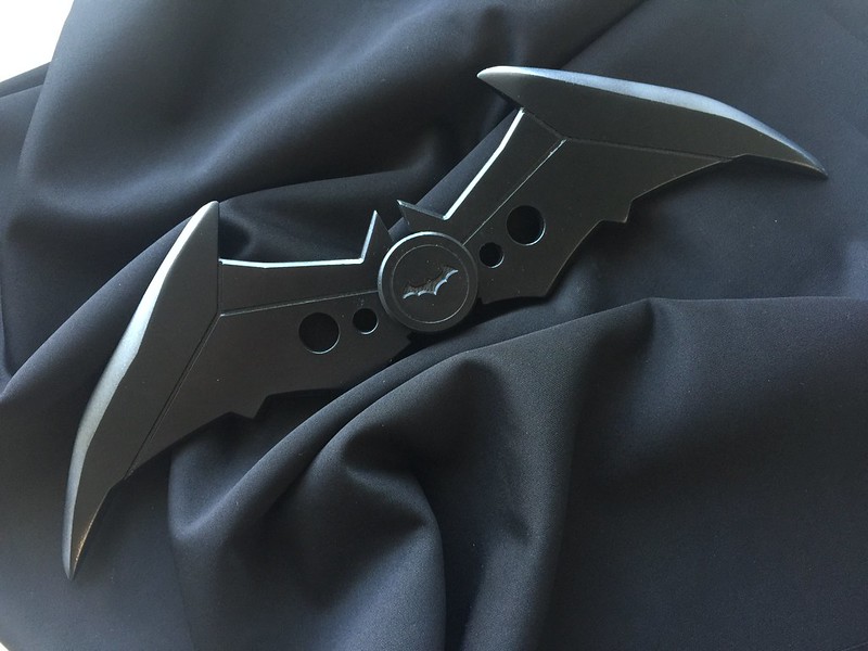

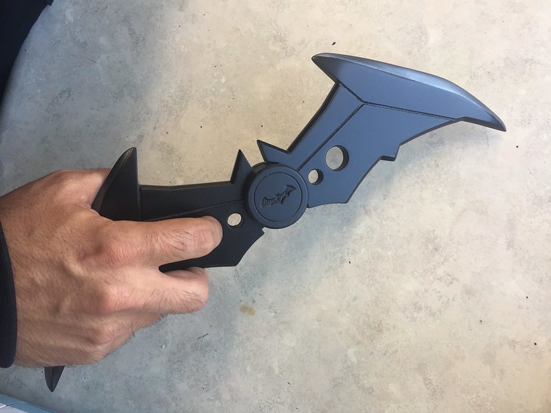

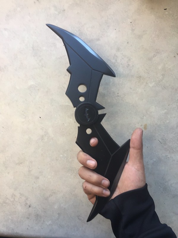

Havent made this thing in a long time but I had a customer asking about it so I offered to make one from scratch as I was unhappy with the mold I made for it. Reprinted and painted as an ABS print. This one came out a lot smoother and nicer than my first... So I just wanted to revive this thread and share.
