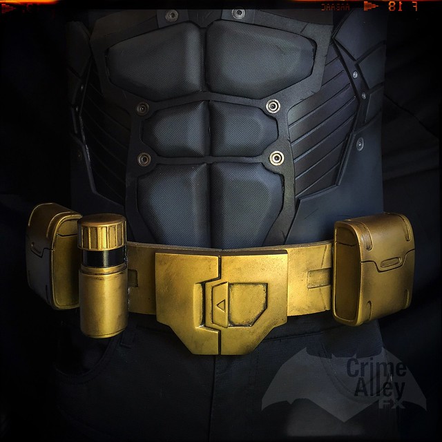

Im thinking of going gold on my belt.. made this for a customer and its the first time I've made it in gold and I just love the contrast and color. Im also thinking of redoing the belt models for additional detail and accuracy so we will see where that goes.
Decided to redo the buckle design. Was finished redoing and adding details to the original model when I noticed while playing Arkham Knight that the Arkham Origins Skin Pack has a slightly modified design on the belt buckle. The design was very much the same but had a couple subtle changes that made it a little sleeker and more sturdy looking. So I decided to go that route and have the buckle done in that style. Here is the current model as of now and although I'm pretty happy with it, I think I might still play with the bevels around the borders a bit more. Redoing the pouches and capsule too but this piece has the most noticeable differences.
last I'm thinking of having the belt itself rendered so I can cast the base out of resin or urethane. I'll have to play with the design to see which is the best route.
