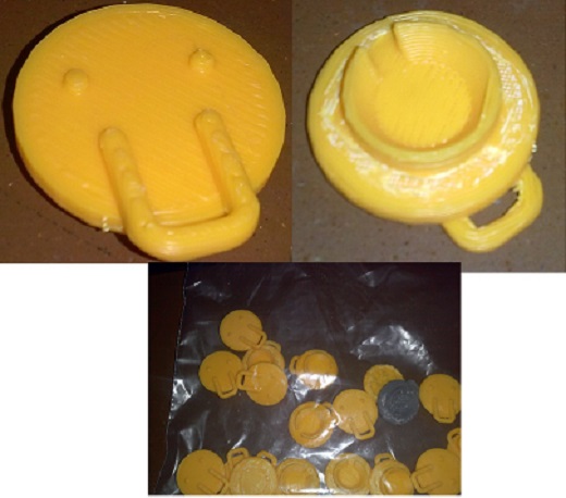

We went back to the original download of the files and tried printing them again and they came out correct. What happened it turns out is a problem with Turbocad and the way it deals with some files. Here is the link to a forum talking about the issue http://forums.turbocad.com/index.php?topic=6645.0
Having never owned a sealab my friend who was doing the printing would open the file and find that their was no size on some of them so he would choose a size and then Turbocad would do its thing and the resulting part came out 20mm wide.
...Good to know that the maruska Sealab parts are accurate...I've been using them to size things off of! :D ...

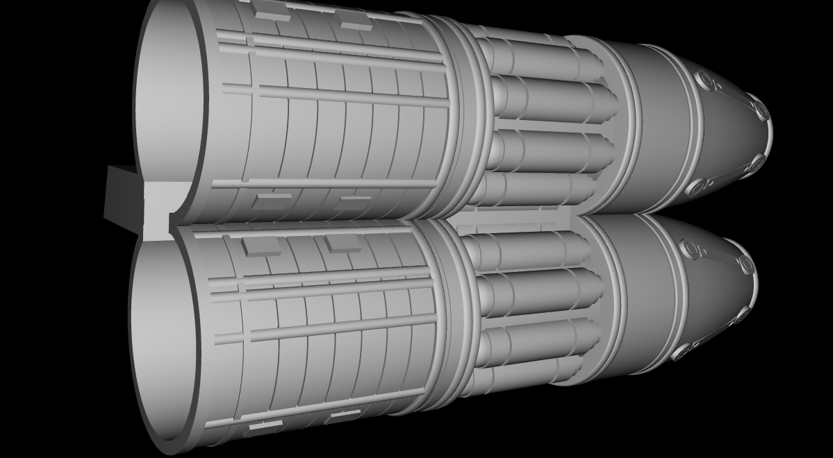

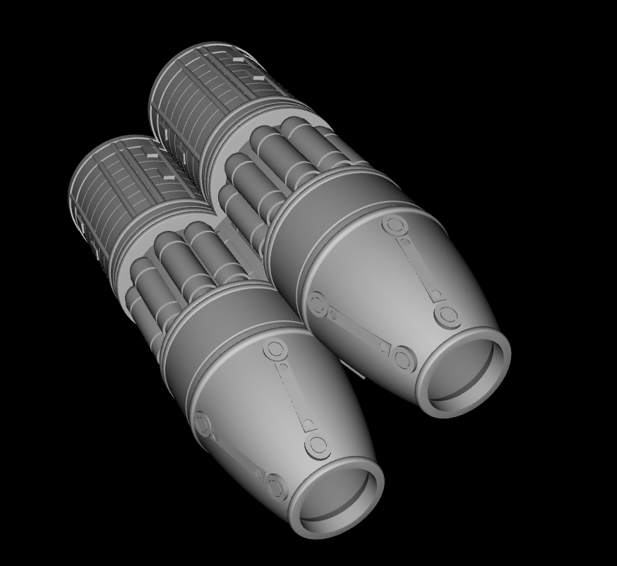

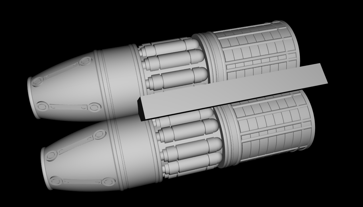

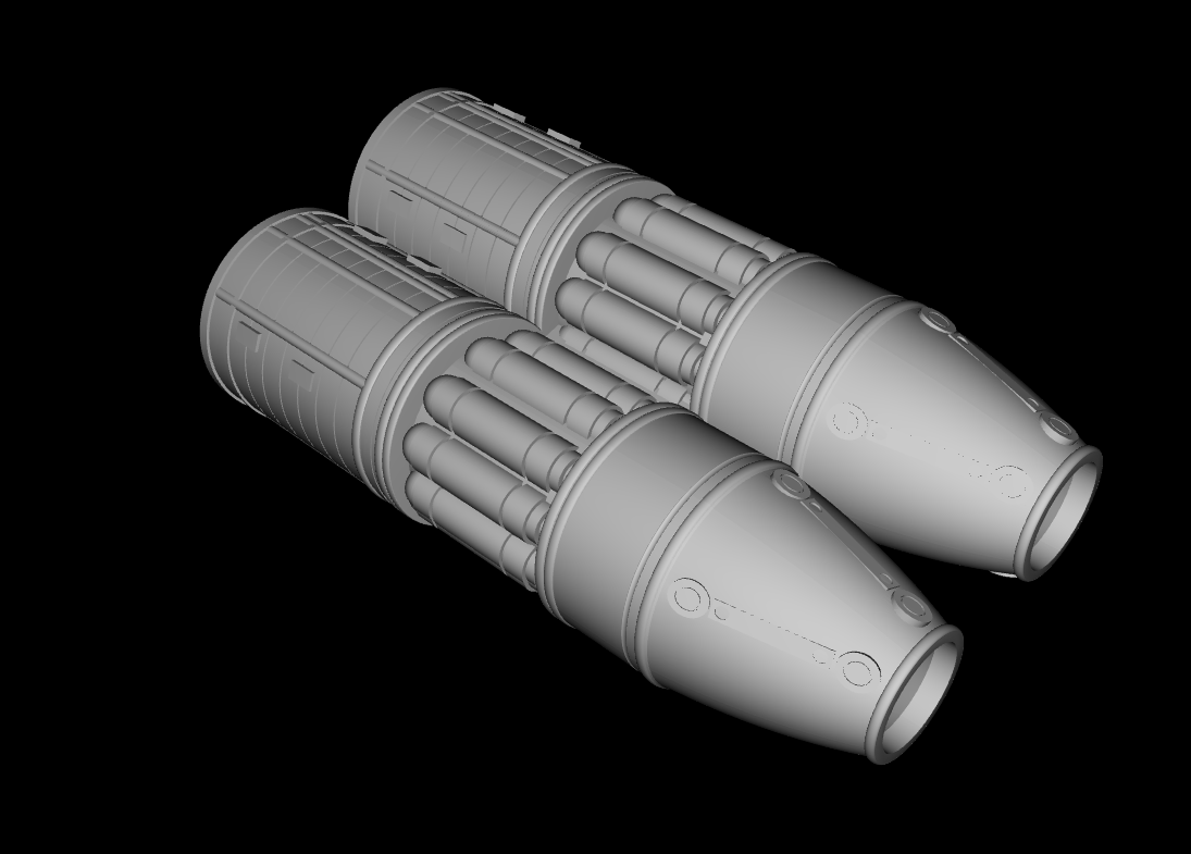

Hey guys, I've been working on 3D modeling the Nebulon B and as it turns out it shares just about every donor kit for every other model. My goal is to represent it as accurately as possible so I've been collecting the real donor kits and examining them while working in 3D. Here's the X-3 Stiletto engine parts for example:
