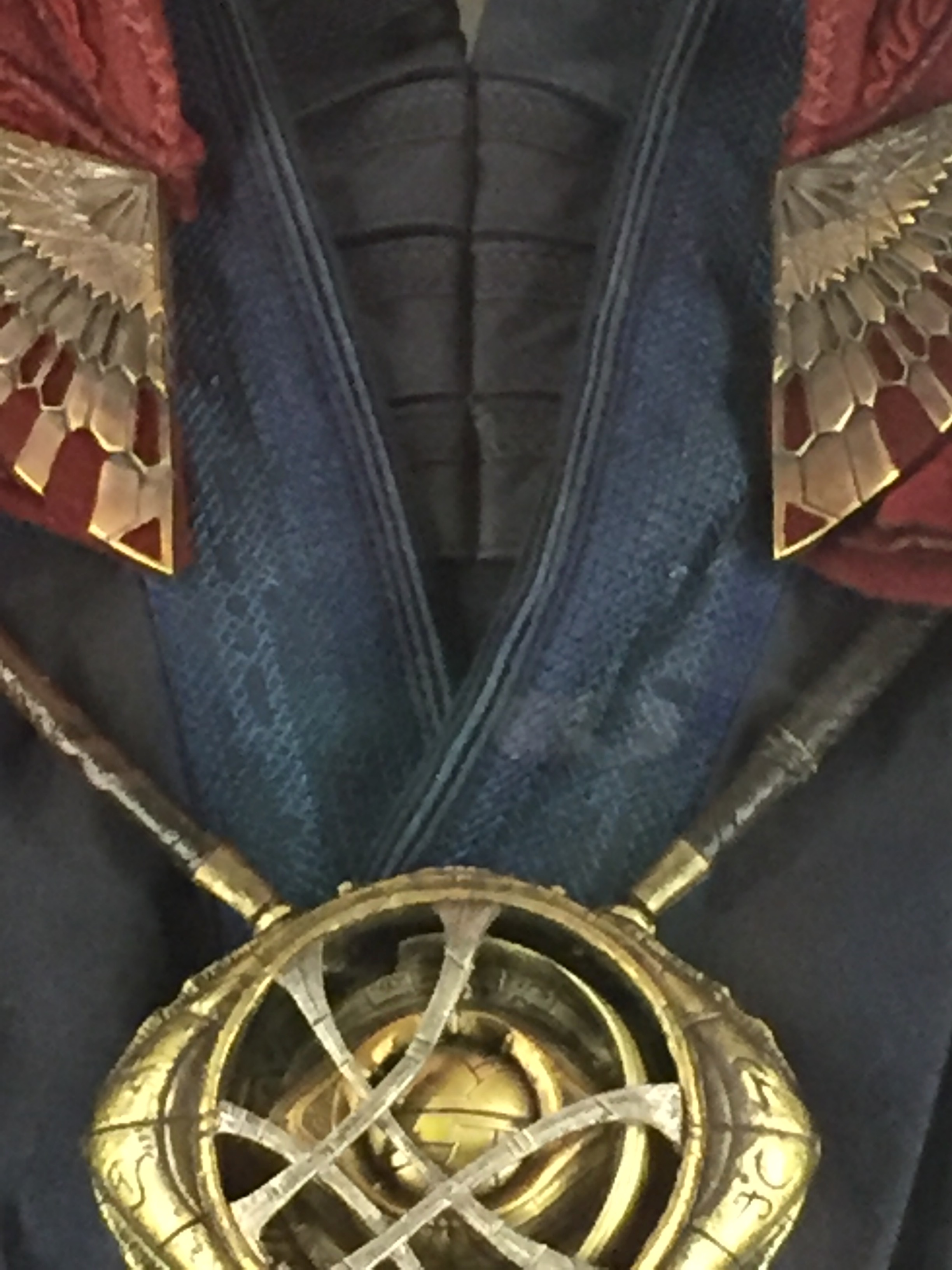

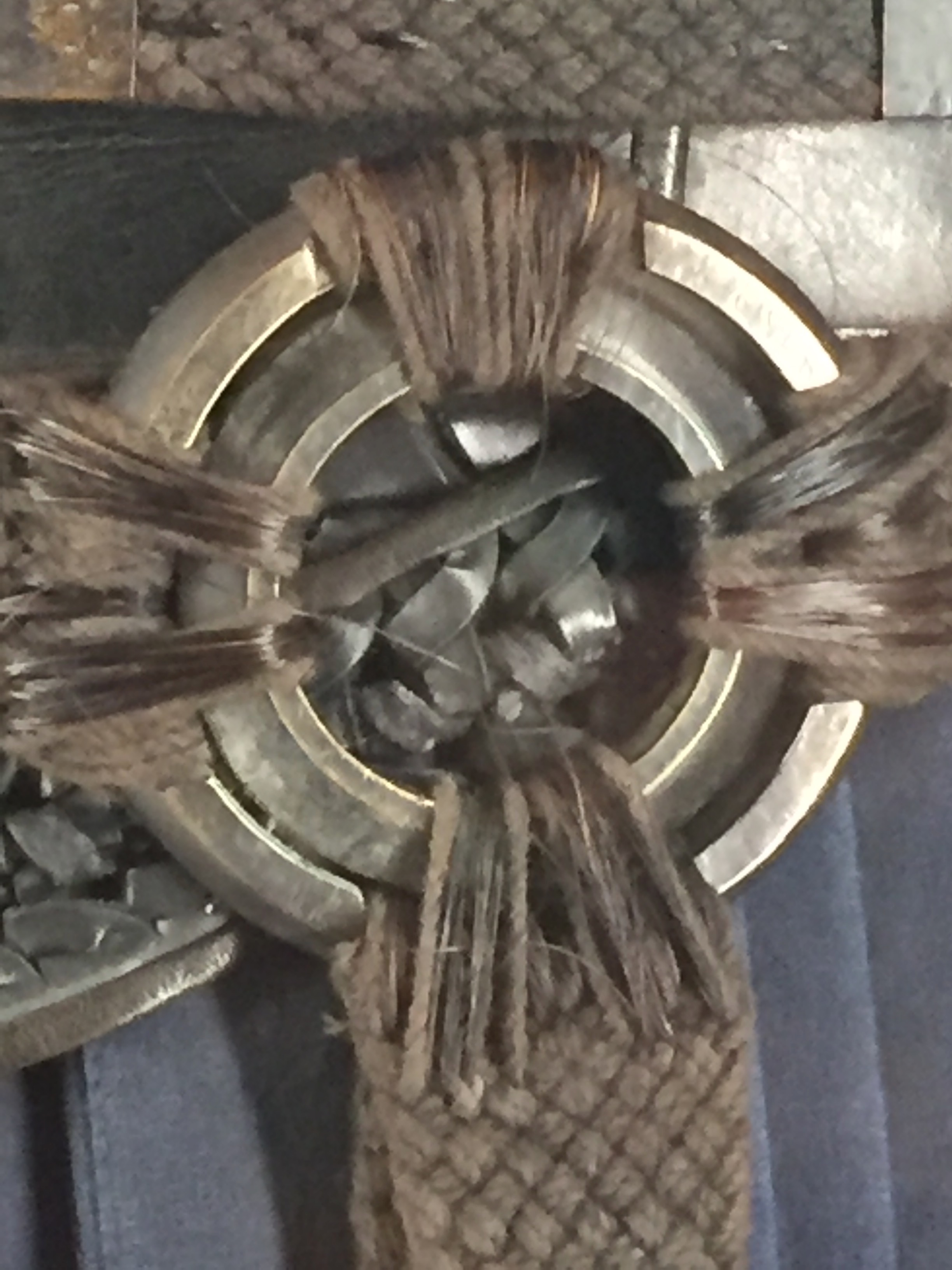

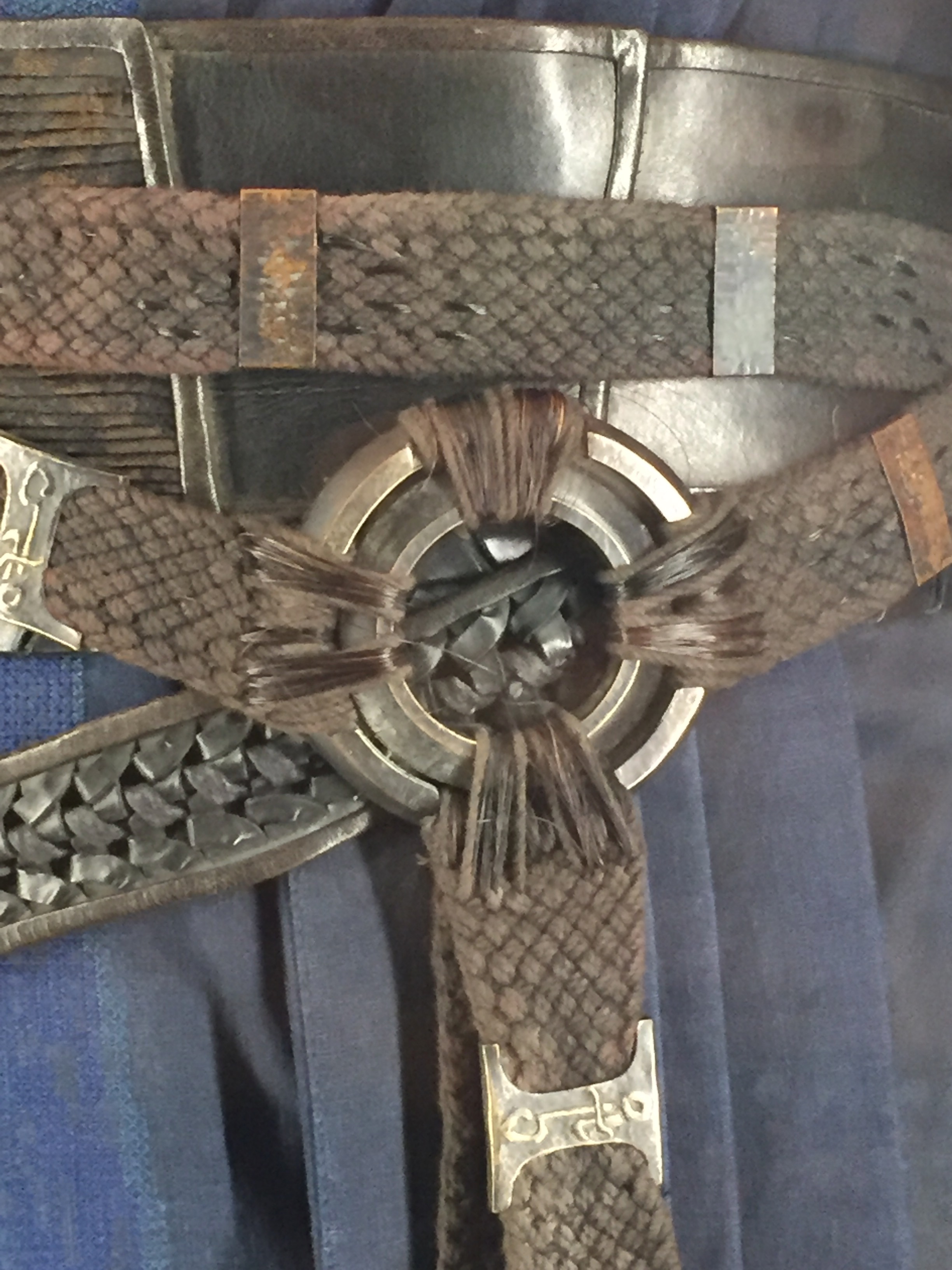

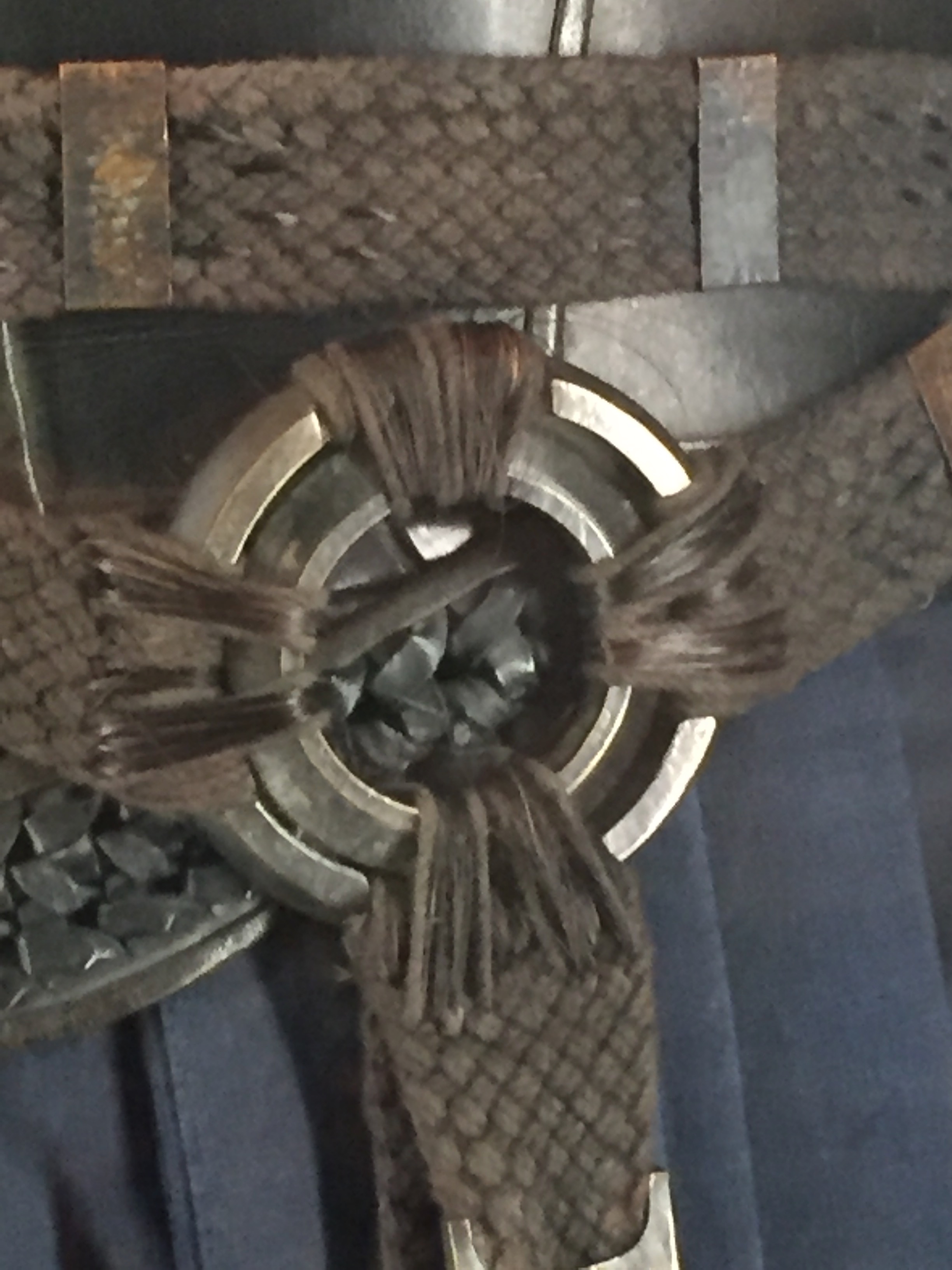

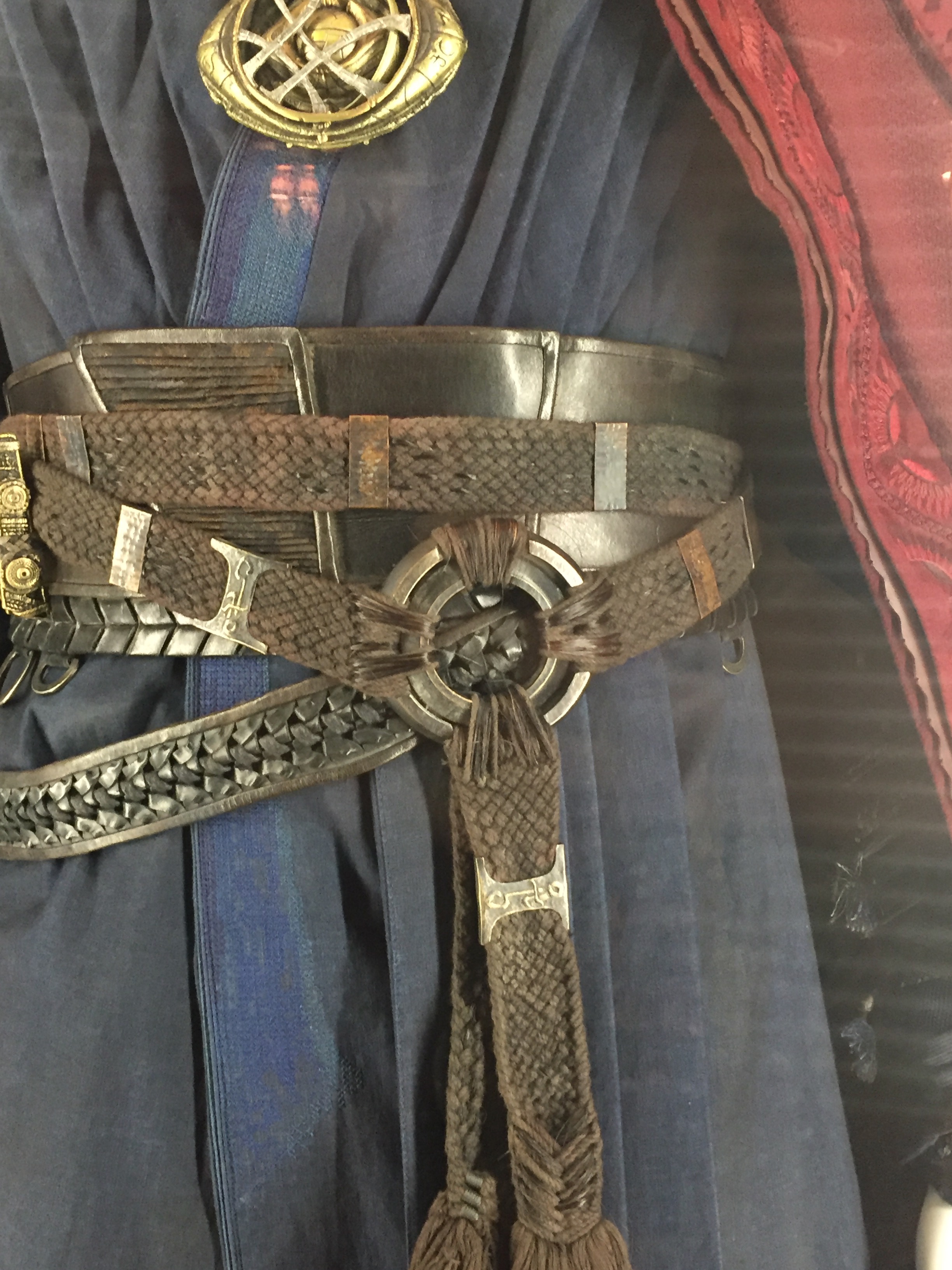

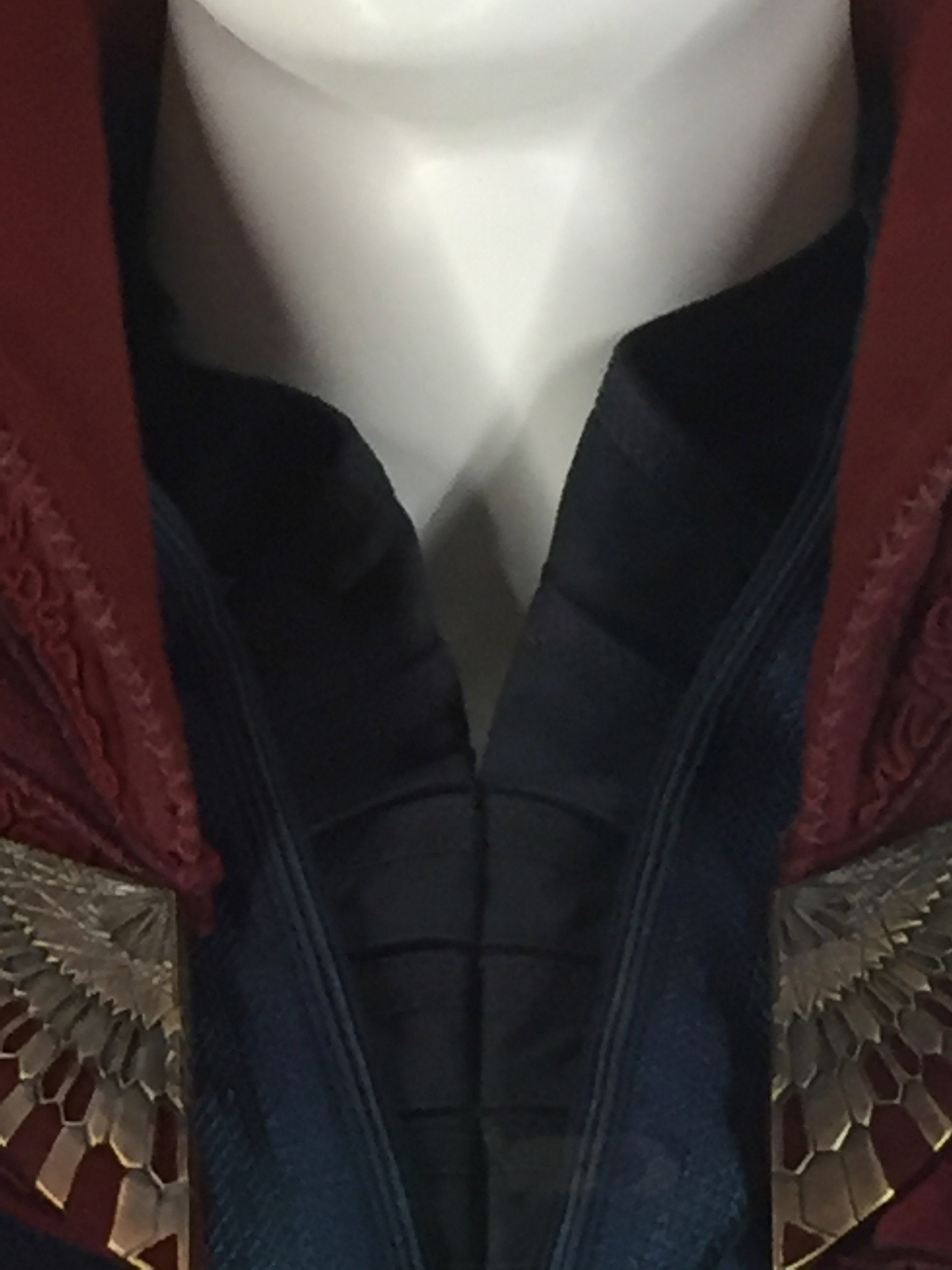

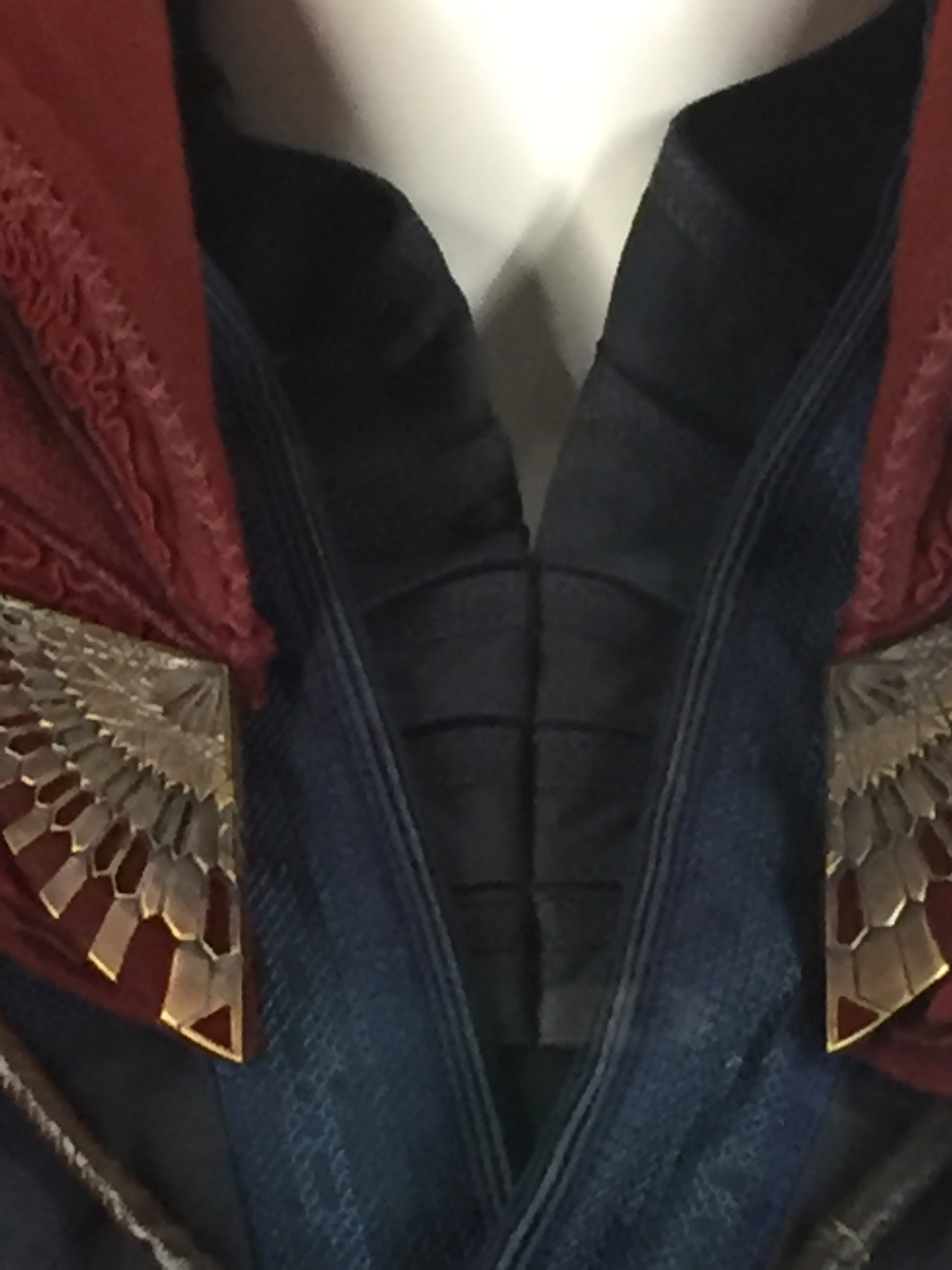

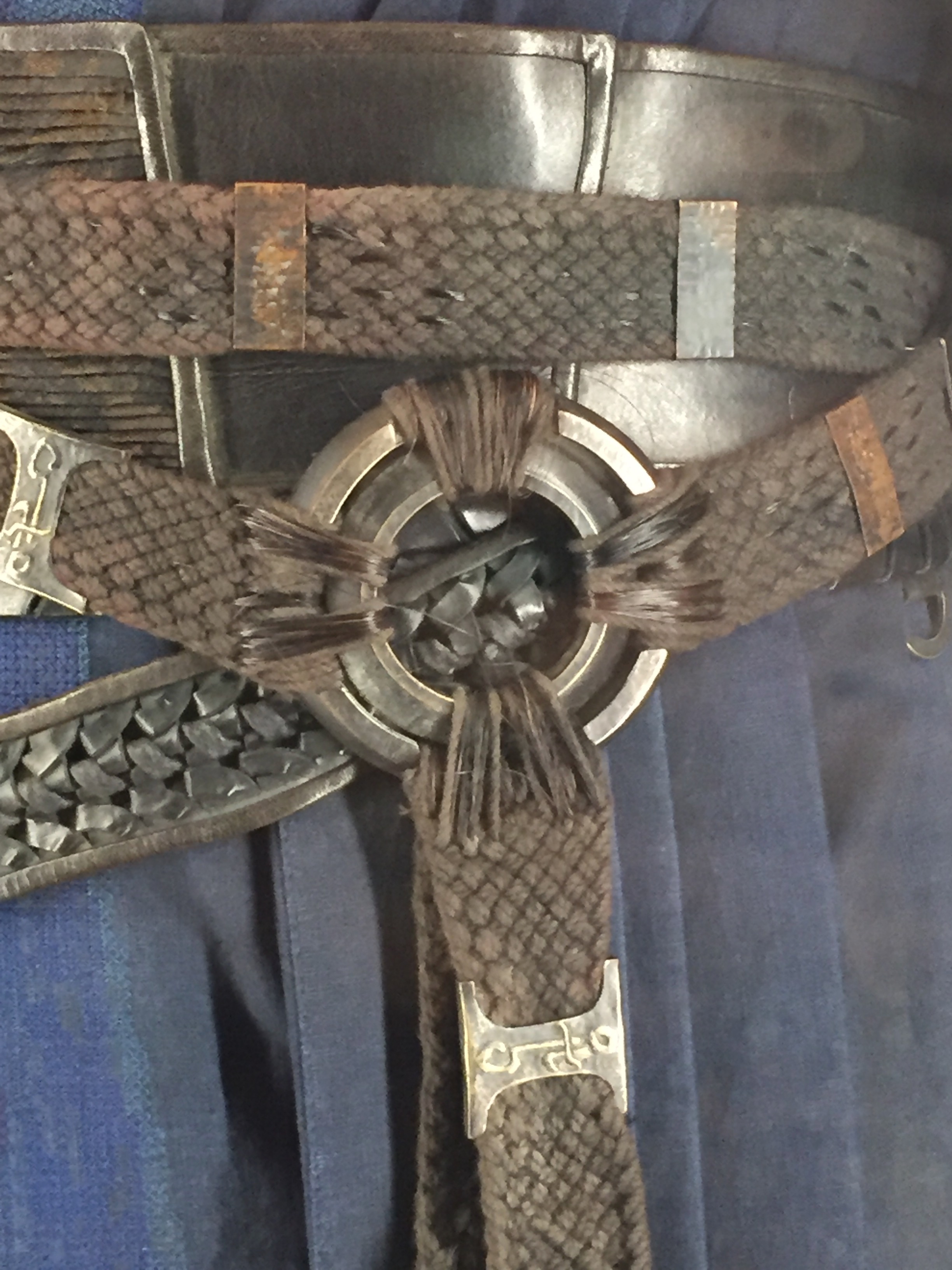

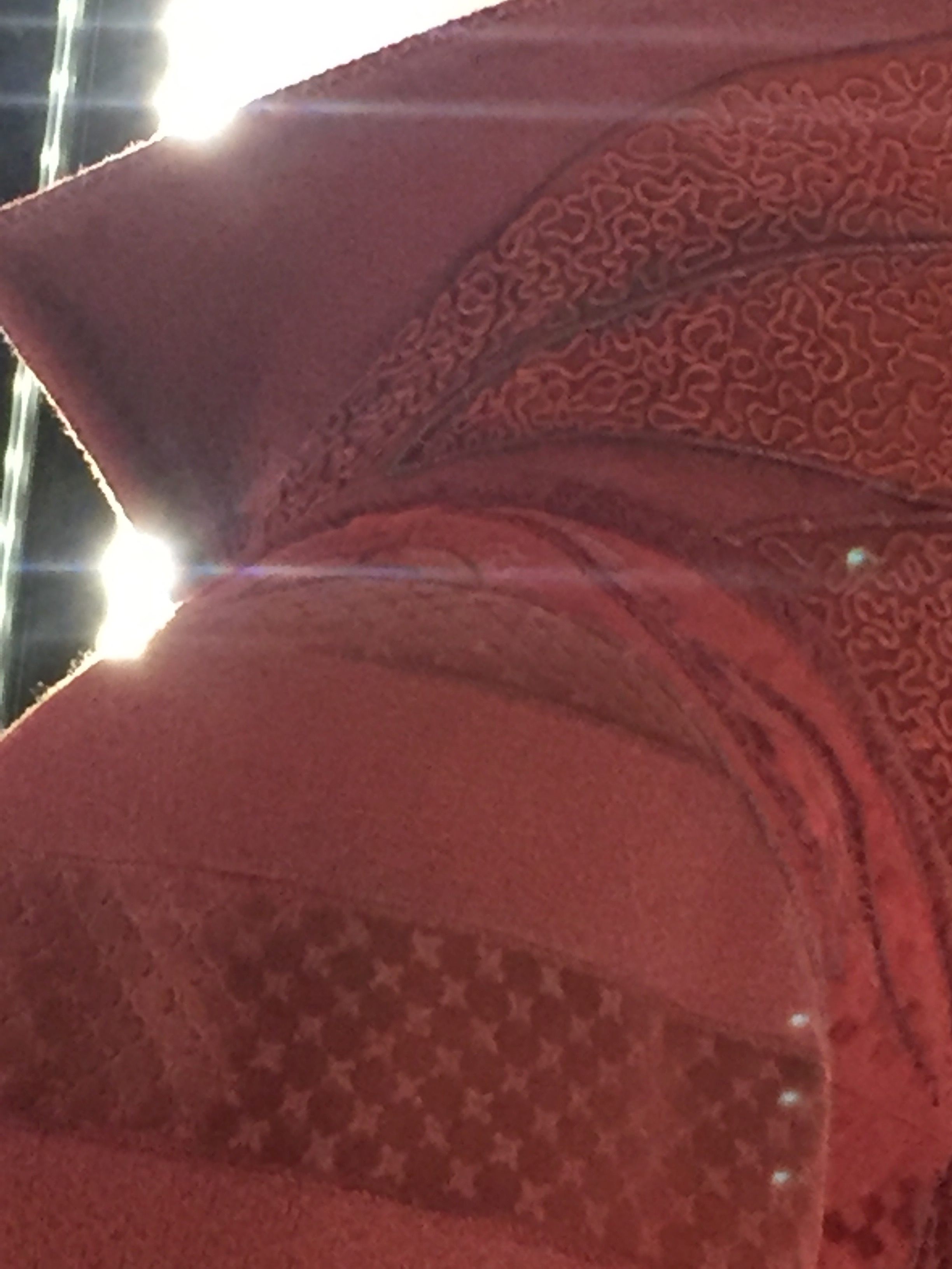

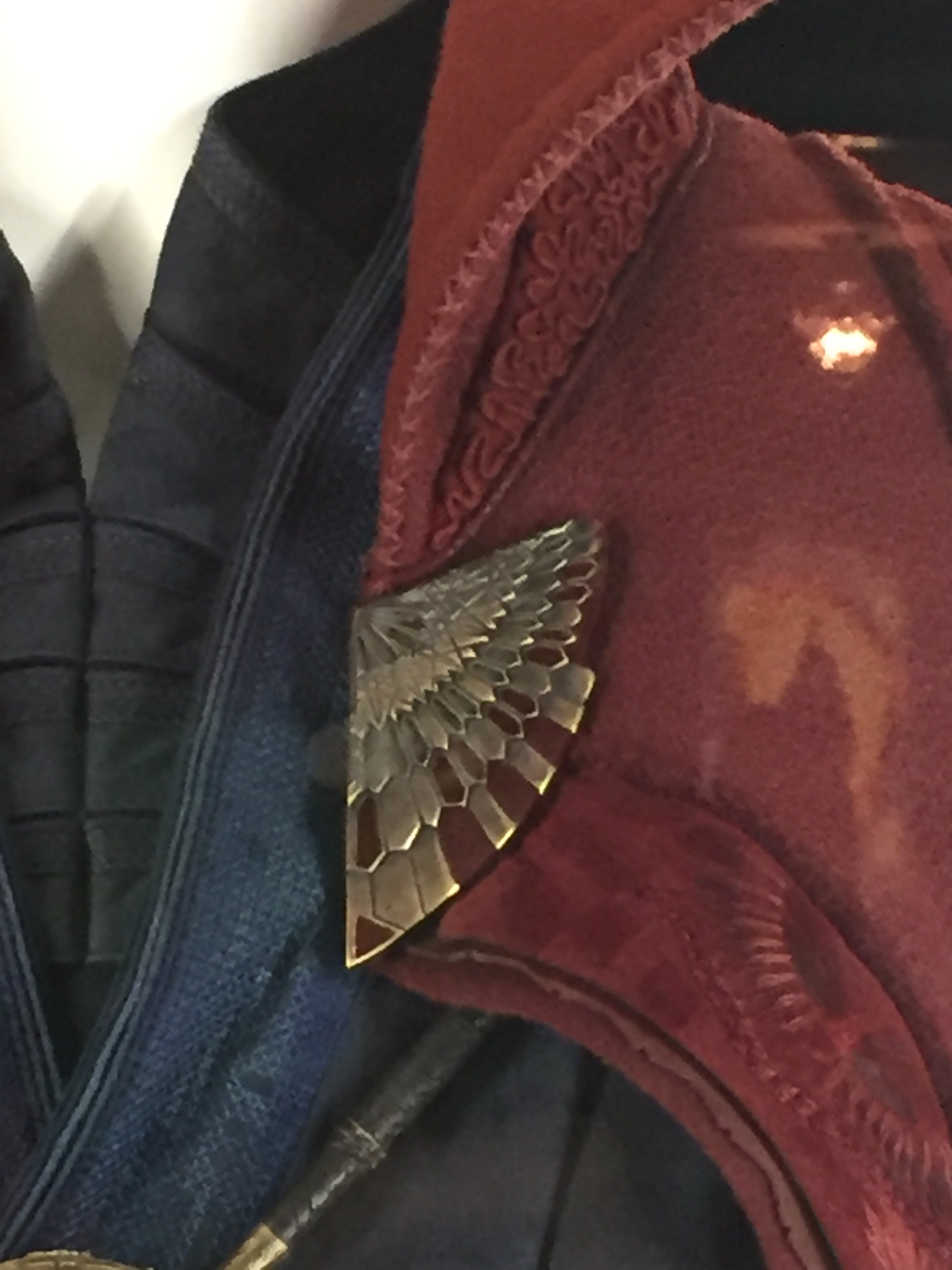

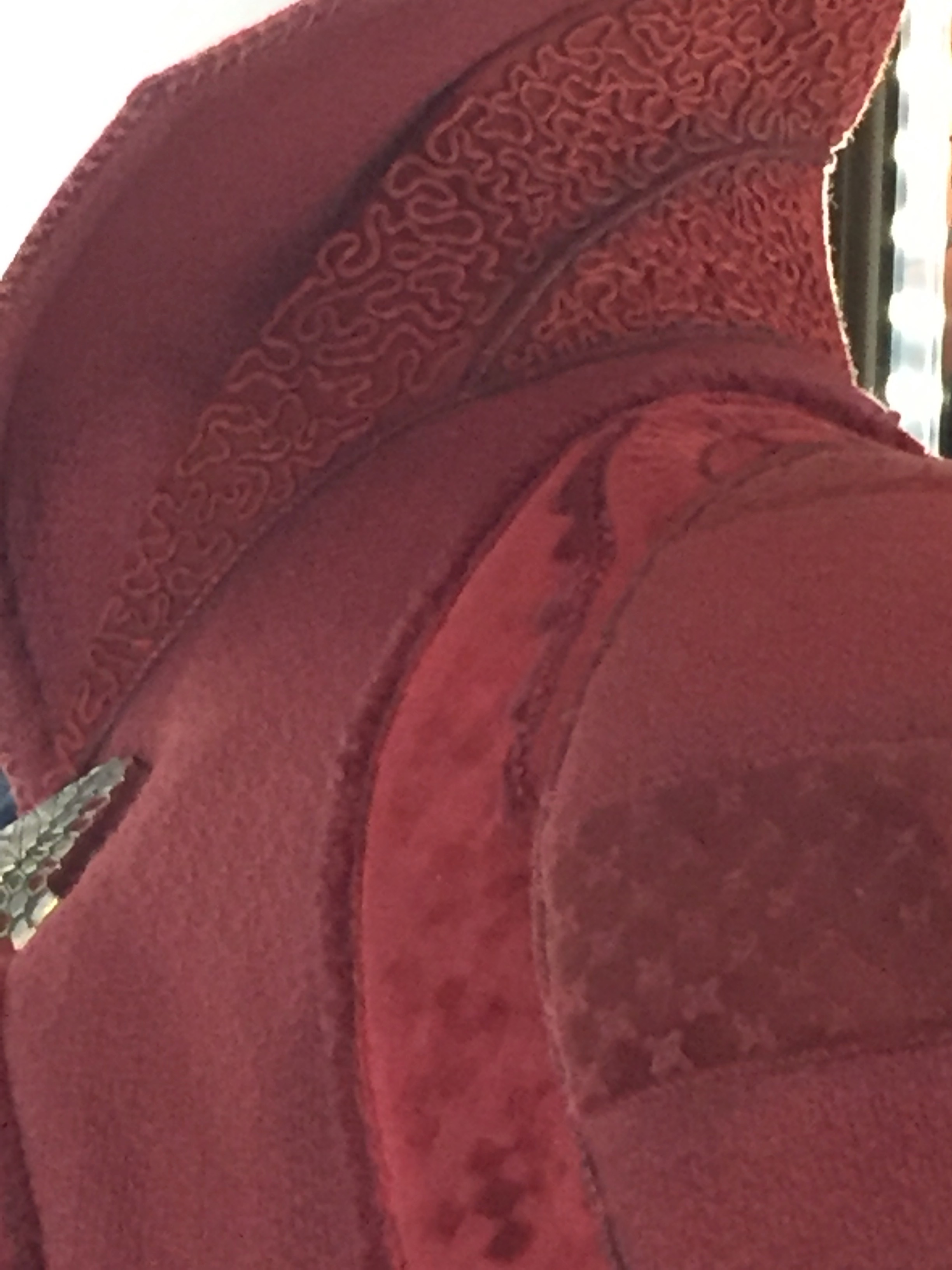

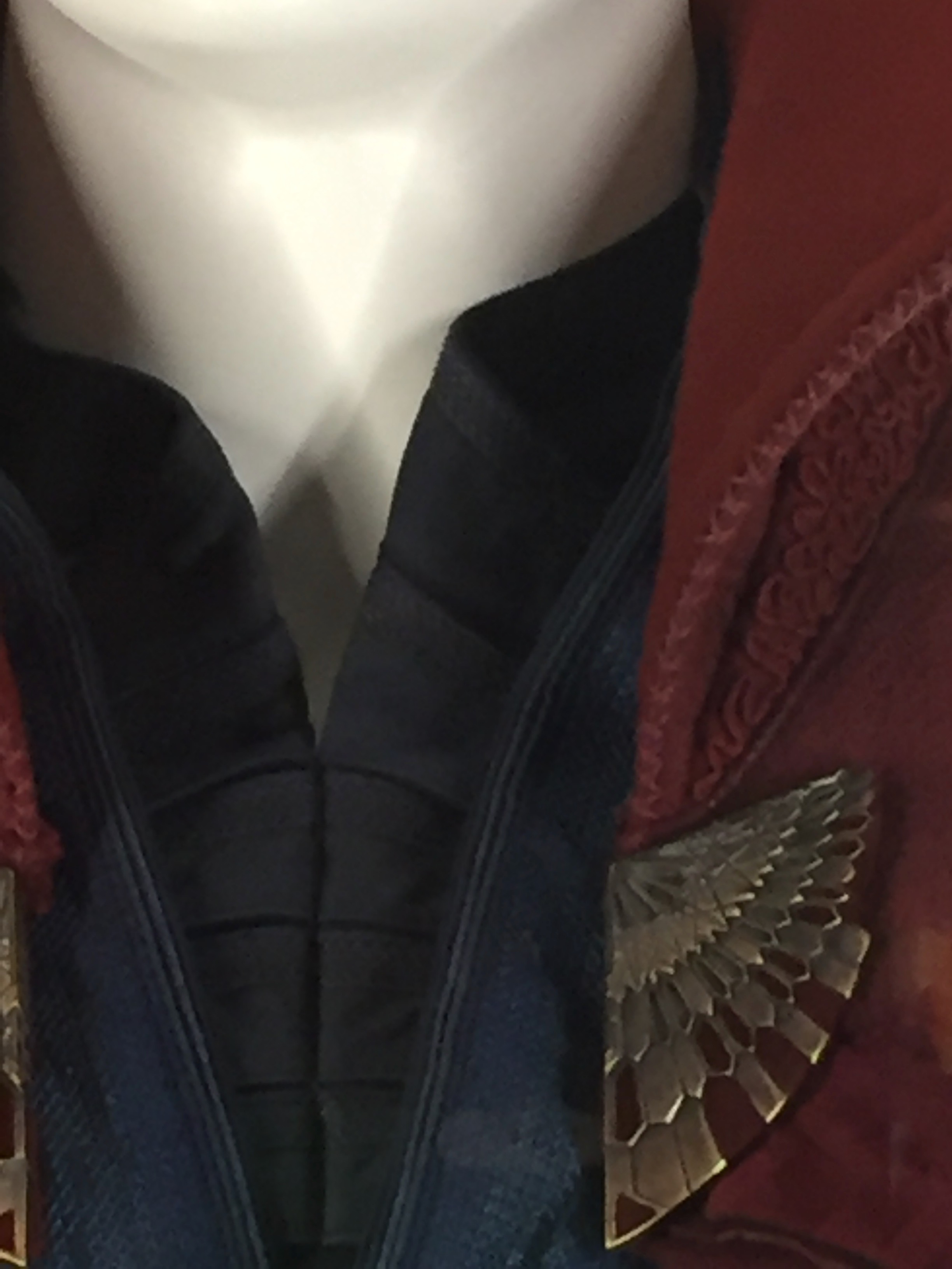

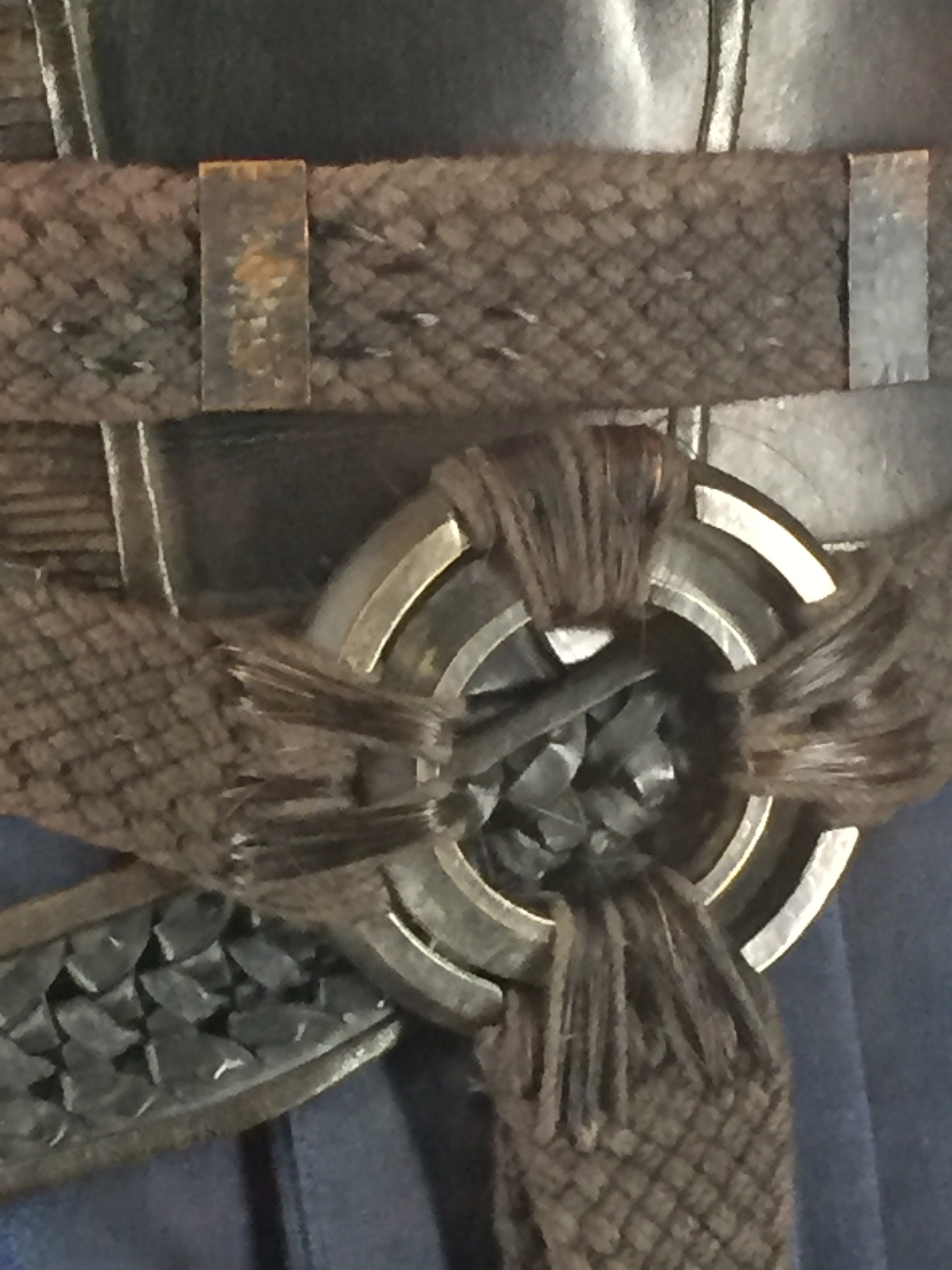

I would like a close-up of the shirt at the neck so that the trim shows up really well. Also a close-up of the round "belt buckle" would be great. I am trying to work out if it is turned from a piece of timber and then reinforced with some sort of metal.

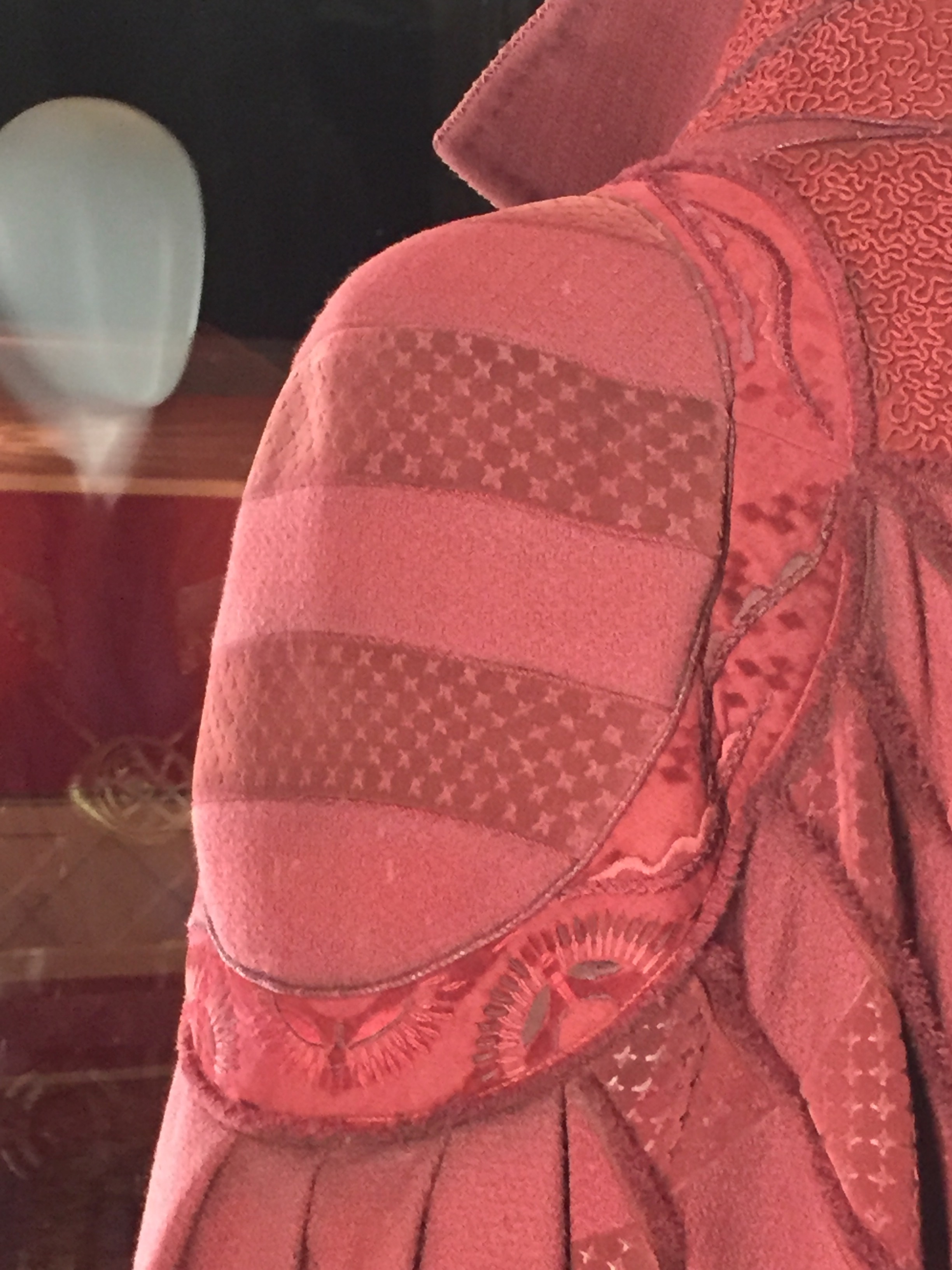

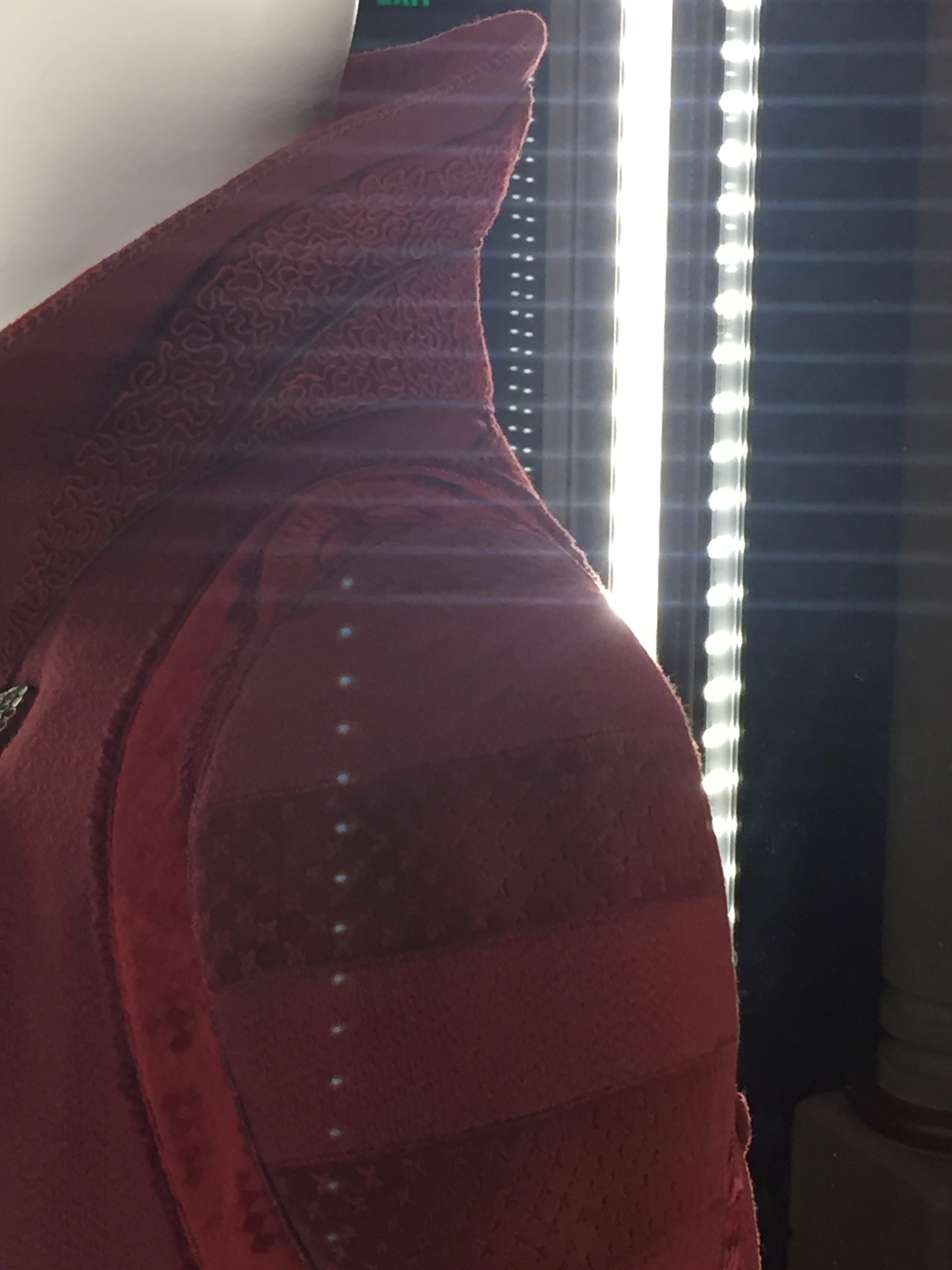

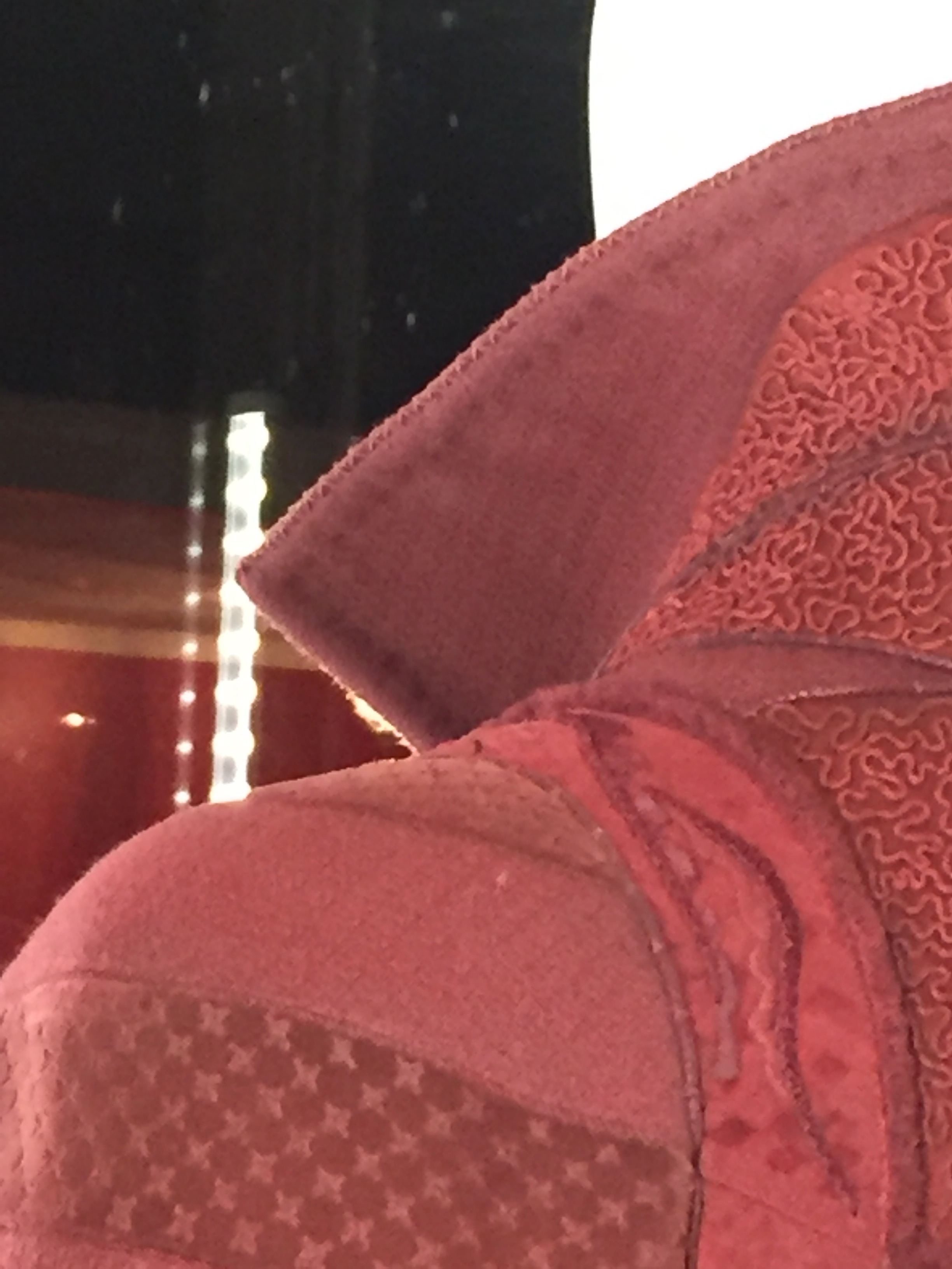

Finally a close-up of where the seams on the back of the cape meet the "roundel" that sits on the left shoulder would be great as well.

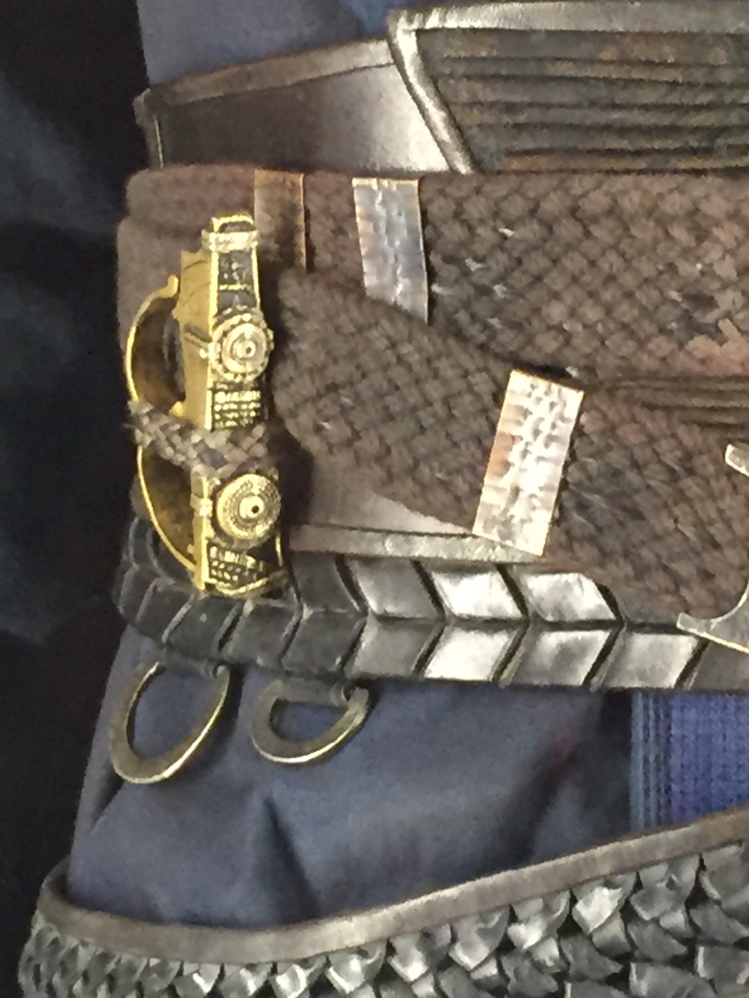

Oh man, I am so sorry for not getting these up sooner. Sometimes life gets in the way.
Just with the iPhone again, but hopefully more detail on those areas you wanted. As for the circular belt buckle thing, it looked like metal through-and-through in person.

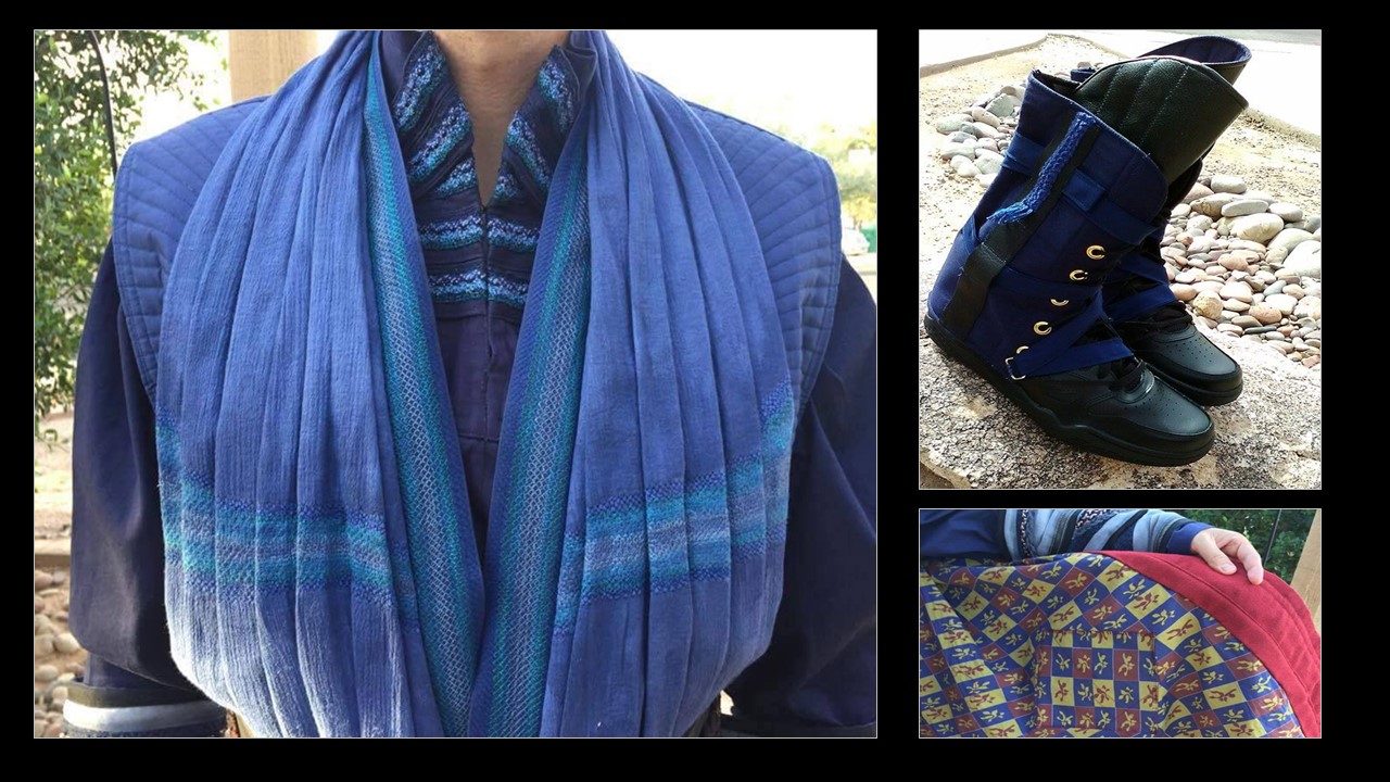

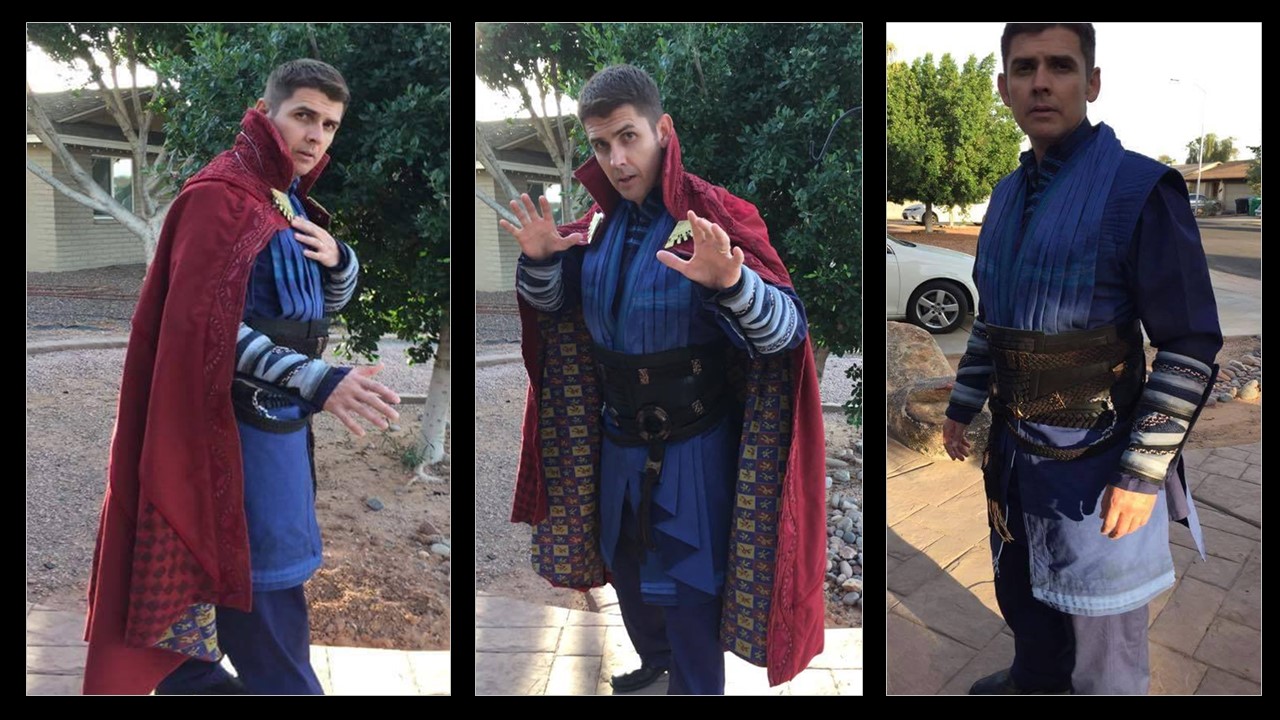

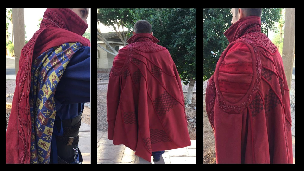

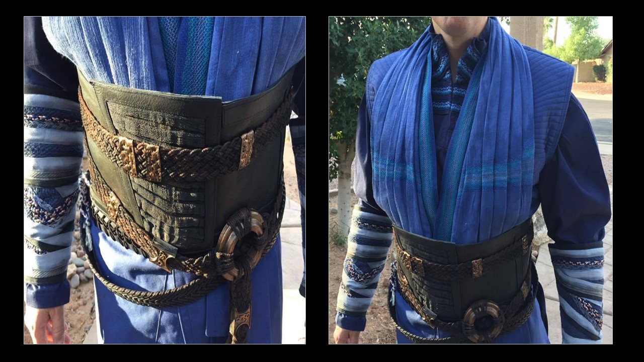

Thought I would just post some pics of the Dr. Strange I just built for a client. This costume is a basic design, but be warned...the detail is insane. Since I've already made it, if anyone has any questions, just let me know. It always helps to talk to someone who's already made all the mistakes...LOL. Thanks!
View attachment 677528View attachment 677529View attachment 677530View attachment 677531
Looks amazing!
Yeah, I have a question or two. 1) How did you do the swirly design on the upper back and on the collar? 2) Did you use the embossing technique on the cape trip? 3) How did you get the insane light blue detail on the front of the tunic?

Hi Mark,
Here are the answers to your three questions: 1) The swirly design on the collar and yoke is called Soutashe. It is a hand-stitched technique using cording or beading that allows the stitcher to apply a very detailed “coral” effect on fabric. I used a satin cording instead of the leather cording used in the movie. If you want more details, you can google it for a sample or YouTube it to see how it’s done. 2) I did not use an embossing technique on the trim. It is actual fabric appliques and hand embroidery. A little more time consuming, but worth it. 3) The insane light-blue detail on the tunic was stitched using a machine, in a specific “X” design. I started with a darker blue, sewing a couple of rows, then I did rows of dark turquoise, then rows of light turquoise, and then a light blue. I also distressed it with a medium blue wash to tone down the light blue and give it a more aged look.
I hope this helps. I’ve been doing this for a long time and some of these techniques are very difficult to master, so don’t get discouraged and give it a shot. :)
