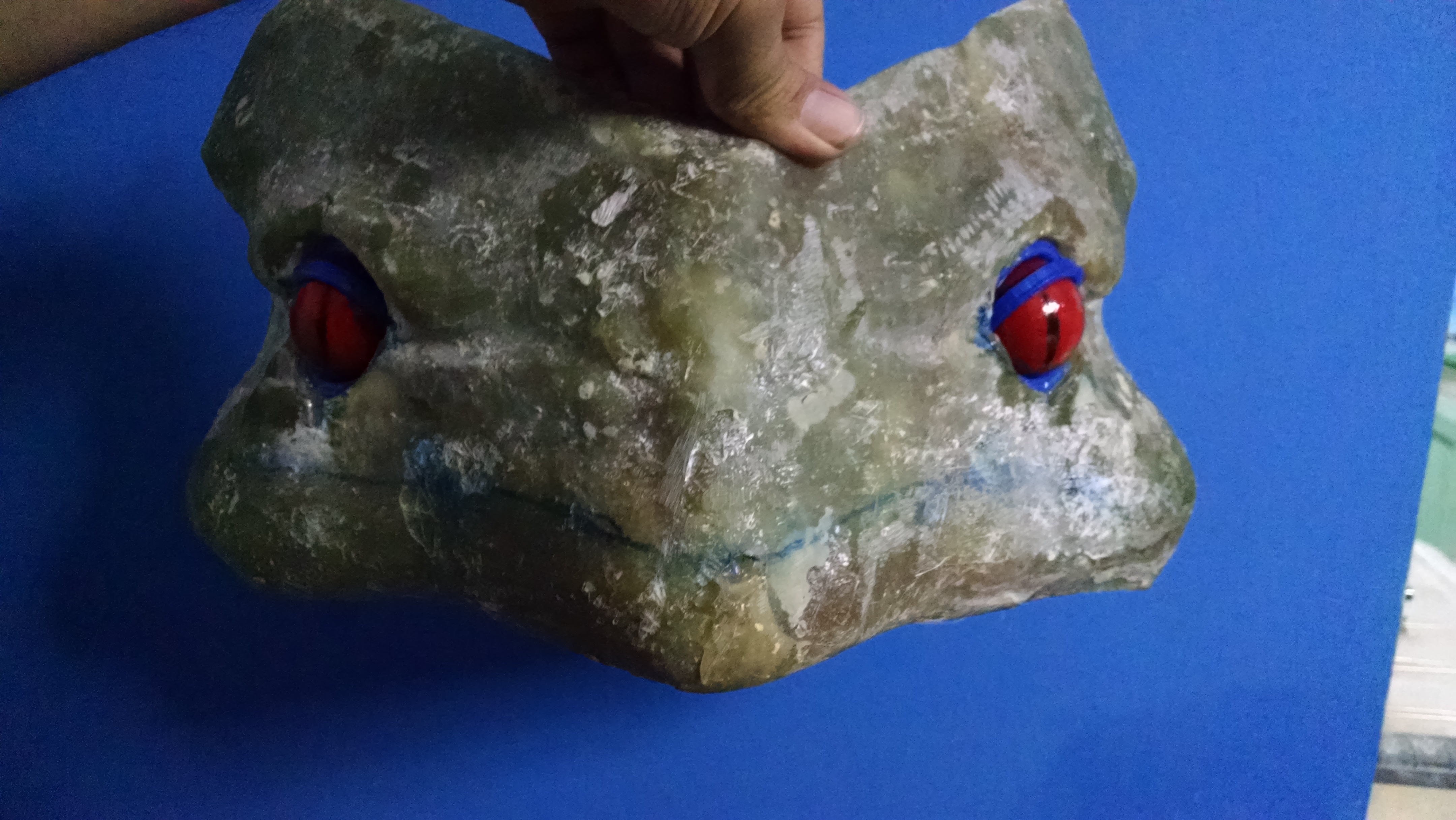

First started by making a skull in fiberglass.
Then I designed and 3D printed some custom sockets for the eyes. I used ping pong ball as the eyes. This is the file for the sockets:
http://www.thingiverse.com/thing:1459466
IMG_20160305_144138272_HDR.jpgIMG_20160309_241206532_HDR.jpgIMG_20160308_174321689.jpg
Then I added some servos and an Arduino Nano to control them to rotate to random positions and blink at random times.

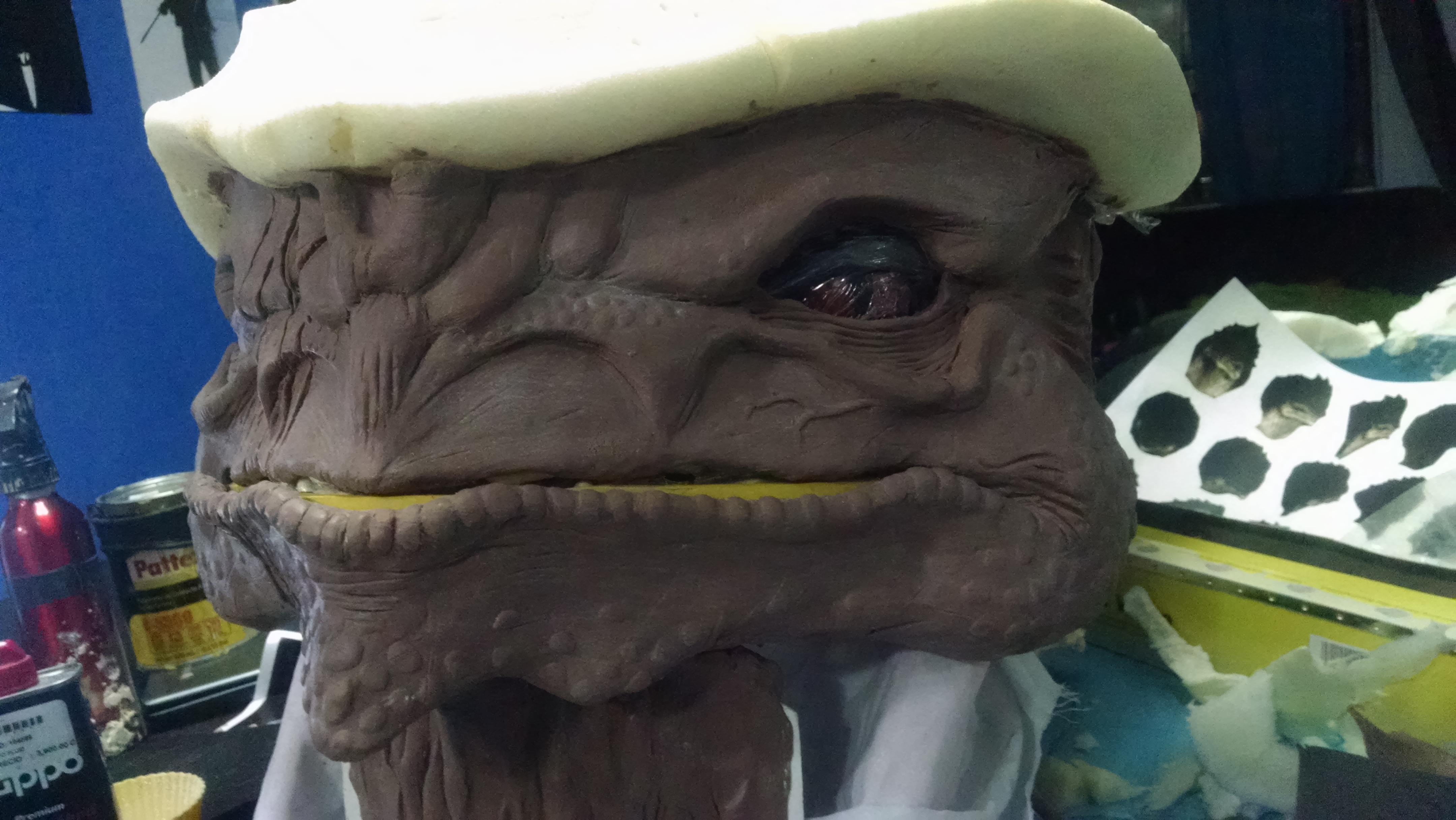

I sculpted the face in Monster Clay, made the mold and casted it in silicone.
So far the head is ready and soon will begin to work on the body armor.

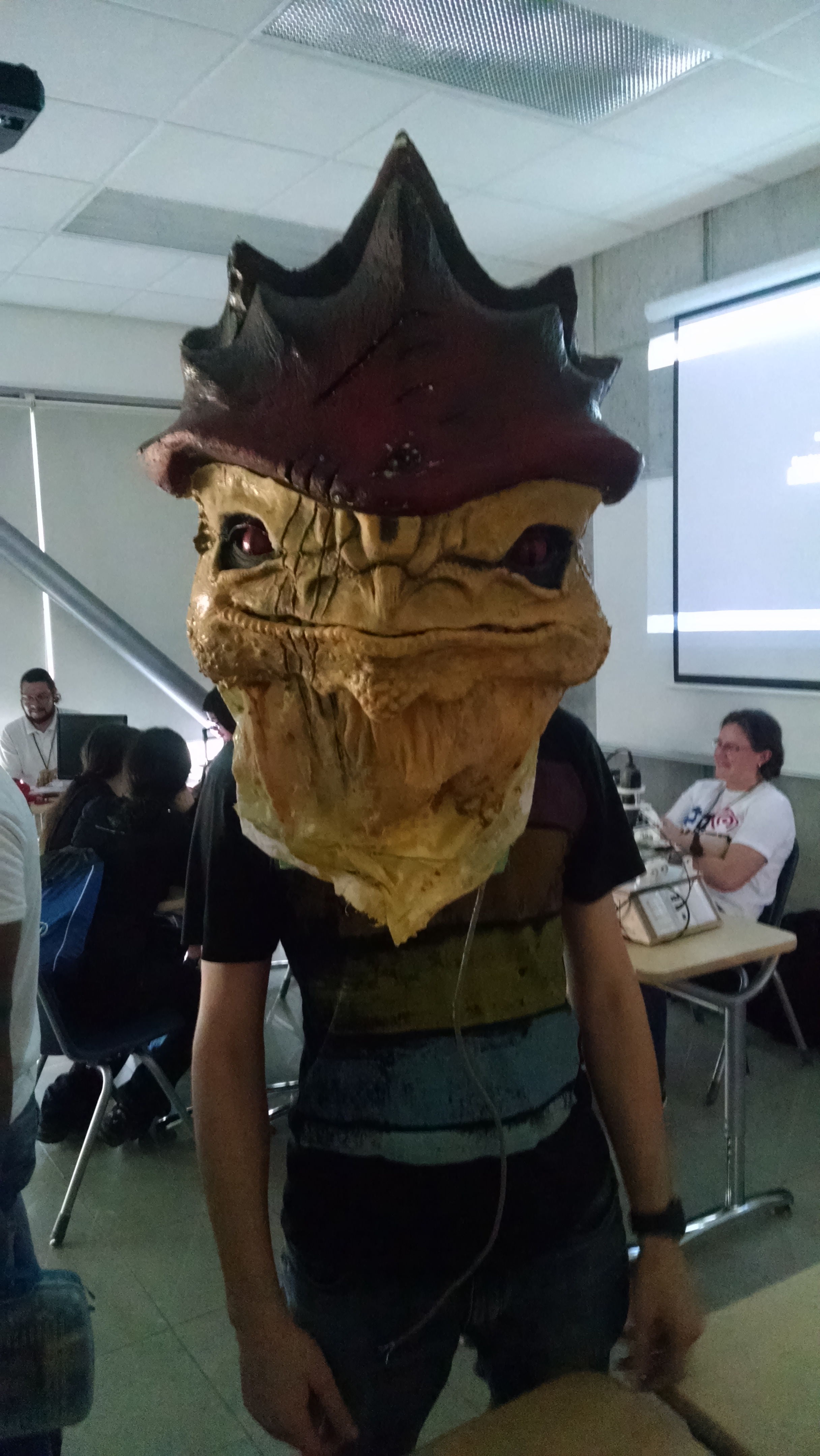

Inside the head, there is a car dashcam to see outside. I can see upfront in a 2.5in screen. There are also computer fans for ventilation. All the system runs on a powerbank. The mouth can open and is connected to my jaw so it moves when I talk.
