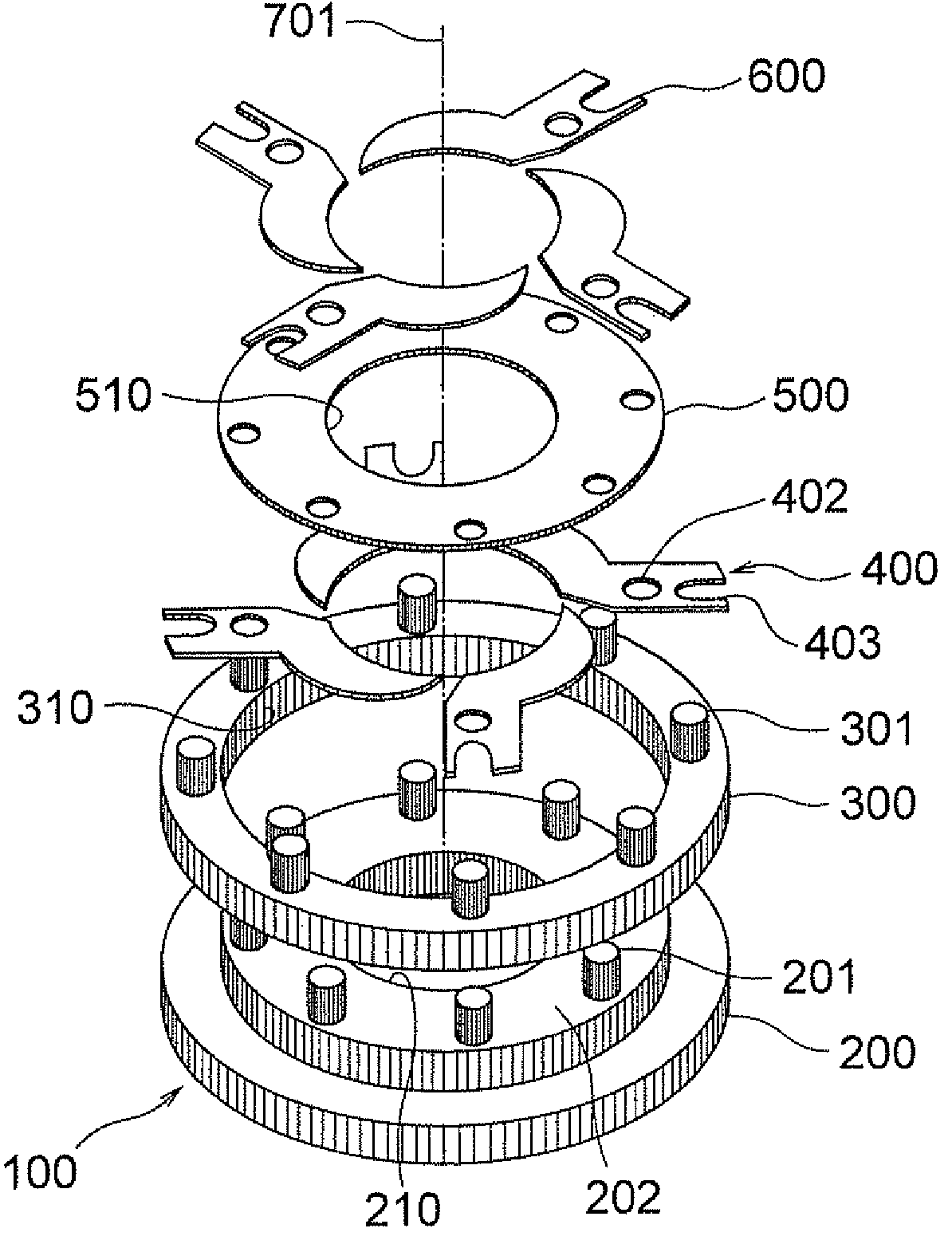

US07832950-20101116-D00000.pngPicture from a quick google search for patents. Shows one way to have double layers. Still thinking and looking around for something to do about the curvature.

"The mask is not for sale. I will let everyone know how I did it, but I want to have a finished prototype before I do." <-- From the video description. But yeah let's not wait for him. I googled for the curvature and brainstormed with some friends who aren't on theRPF and though we aren't engineers or anything, we concluded that the curvature is actually more complicated because Spidey's eye isn't a perfect dome. The blades will need to bend in order to conform to whatever angle is required at each degree of the rotation. We think that the PVC sheet idea would work because it would be a good balance between lack of friction and flexibility. Rubber came up and even though the flexibility is better, the friction would get a little too much. Besides the PVC blades there will need to be a bit of a spacing at the spokes instead of a nearly flush fit to allow a bit of bending there as well.

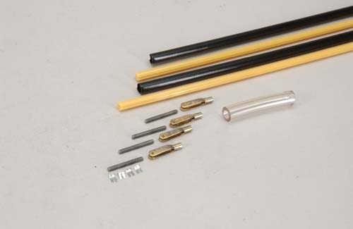

If build into the face shell, may I suggest micro flexible push rods? We use them in small gliders to keep the servos in the center. This might help with your controls if you print or order a small connection at the end.

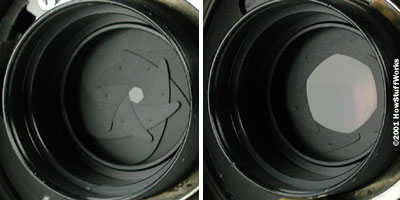

While staring at the gloriousness that is eyeFrameTest4.gif I noticed one more thing that may or may not be of interest. The 3 blades that you have designed are flat and placed one behind the other. Yellow on top, then blue, then red. While a camera aperture has them being on the same plane by keeping the blades thin and flexible and having their 'tails' overlap. Here's a picture:
So I guess they wouldn't exactly be flat and cuz of how they are locked in place because of the interlocked tails I feel like we can get away with bending the axles on which the move to make the resulting aperture convex. It'll be slight but it just might be enough for Spidey's eye.
