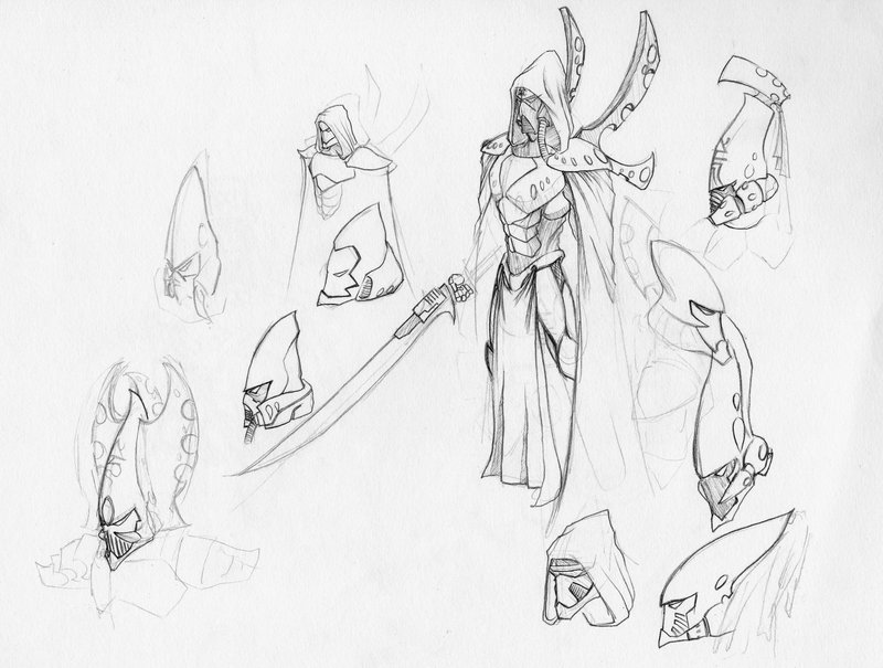

I have wanted to make a full suit of incubus warrior armor as well, but have never gotten around to it, so this may or may not help you here..but in the event you try your hand at something 3D..I made the front and side orthographic views of the helmet based on the cover artwork of "path of the incubus" (minus the horns).
One of the issues I saw with trying to make this helmet, and anything Eldar related really, is that an Eldar head is far skinnier than a normal human head. This means the helmet will need to be wider, which in turn makes it look slightly off and not as sleek as most things crafted by Eldar. However, if that doesn't deter you, then have at it!

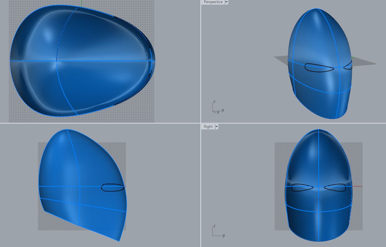

I am actualy working on this problem.
The lack of a decent nose area is a problem, especialy when you have to adjust the eyes to compensate.
I have been investigating the required base shape in Rhino, but also want to make a cast of my head, and then layer on clay till the nose is covered to see what dimensions I get.
I could then scan this in and use this as a base model for all the detailing.

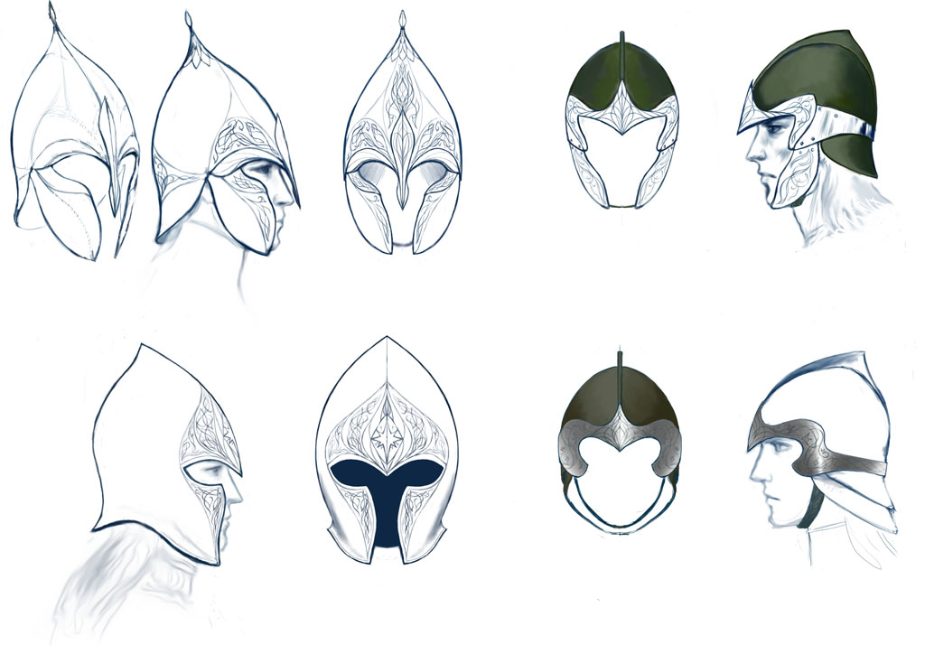

base surface play.JPGcrusader helm ghosted.jpg2611f09bba7137688c9d5a657e4f3e2e.jpgEldar_Ranger_Exarch_by_biomonkz.jpg
In practical armouring, the Sugarloaf helm has many similarities with the shape and eye layout. (you can see this from my model, Im just working to cover my head model at the moment, fine tuning can come later)
You can scale up the helmet to compensate for this, but that can effect your eye placement.
Its quite a trick to get all these variables to work together
