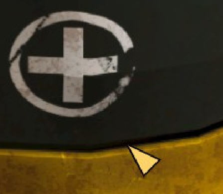

I am not at home so I cannot include one of my screenshots and I could not find any images of the the Fallout 4 fusion cell that includes the white text, so I have to include one of the similar Fallout 3 version. Keep in mind I came up with a 48mm diameter, about two inches. The white paper is not an option for a couple reasons. I have not started work on the graphics yet, but the white text is going to be about an 8 point font. That is probably close to what you are reading now. No way I would be able to trim that by hand. And I would probably have to buy a very expensive inkjet to get it to be able to match the dark green I am using on the anode or the yellow I am using on the main body. The trimming problem also applies to creating any sort of mask. The other options are expensive and/or only practical for a one off.

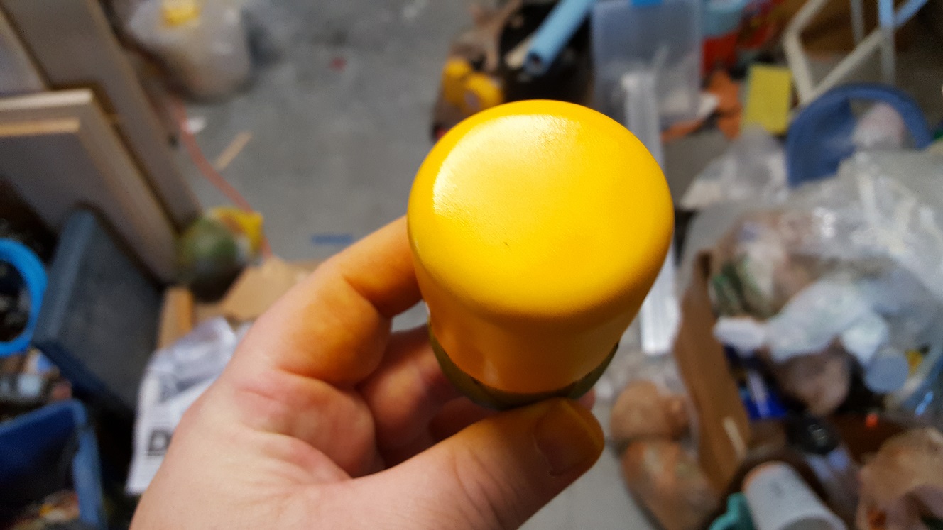

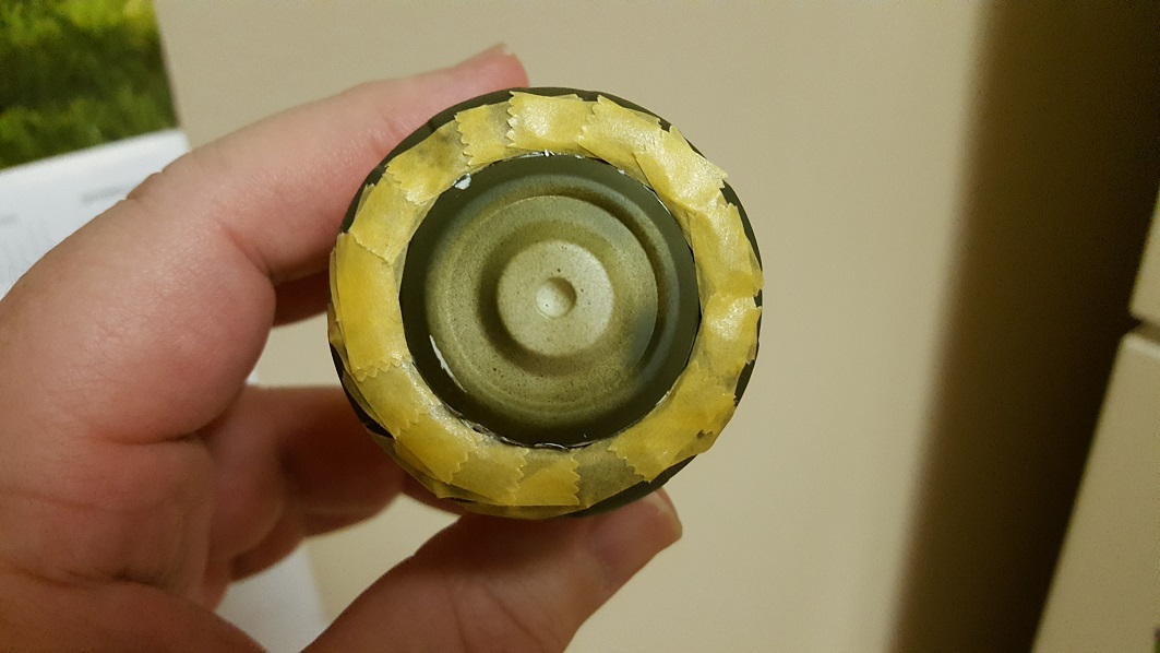

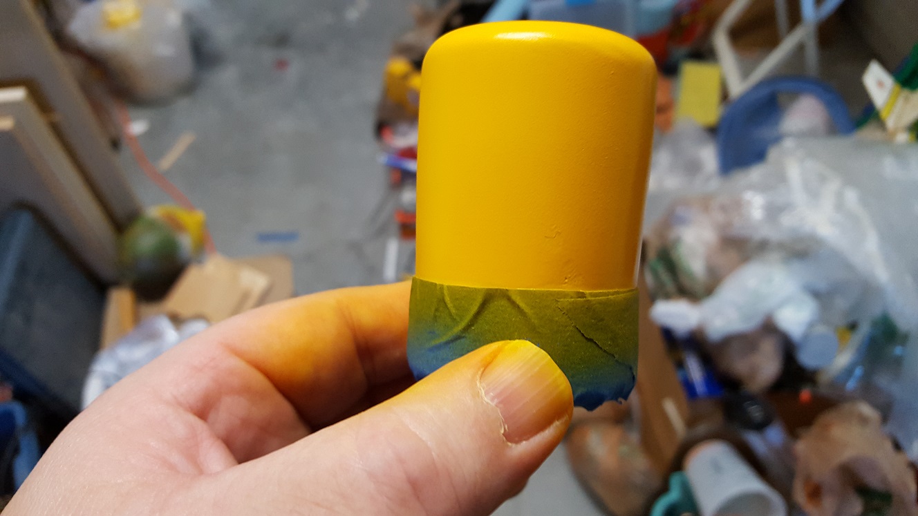

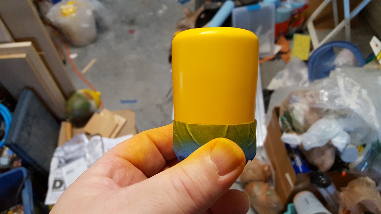

I'm still not totally sold on the color, but the yellow is on. There is a spot where I touched it with my finger. I'm going to leave it and if I remember I will add extra weathering to it. The masking was just kind of slapped on so I would have something to hold without leaving fingerprints. The dark green will cover any overspray. The color is Vallejo "Gold Yellow", 72-707, in the Game Air line of acrylic.
Tonight I will paint the dark green on the anode. I figure Monday and Tuesday will be the metallic part of the anode then clear coat. I am also starting in on the decals in Inkscape. Getting a set of videos that Bill Doran is selling on his Punished Props store is helping.

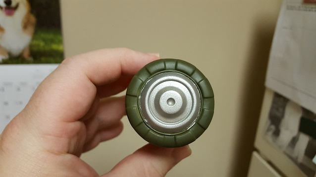

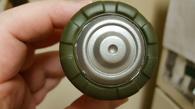

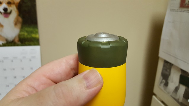

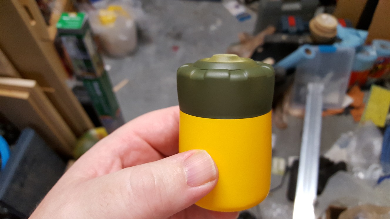

There are a few spots that look like they might be a little light. I did not notice them last night so I might just leave them alone.

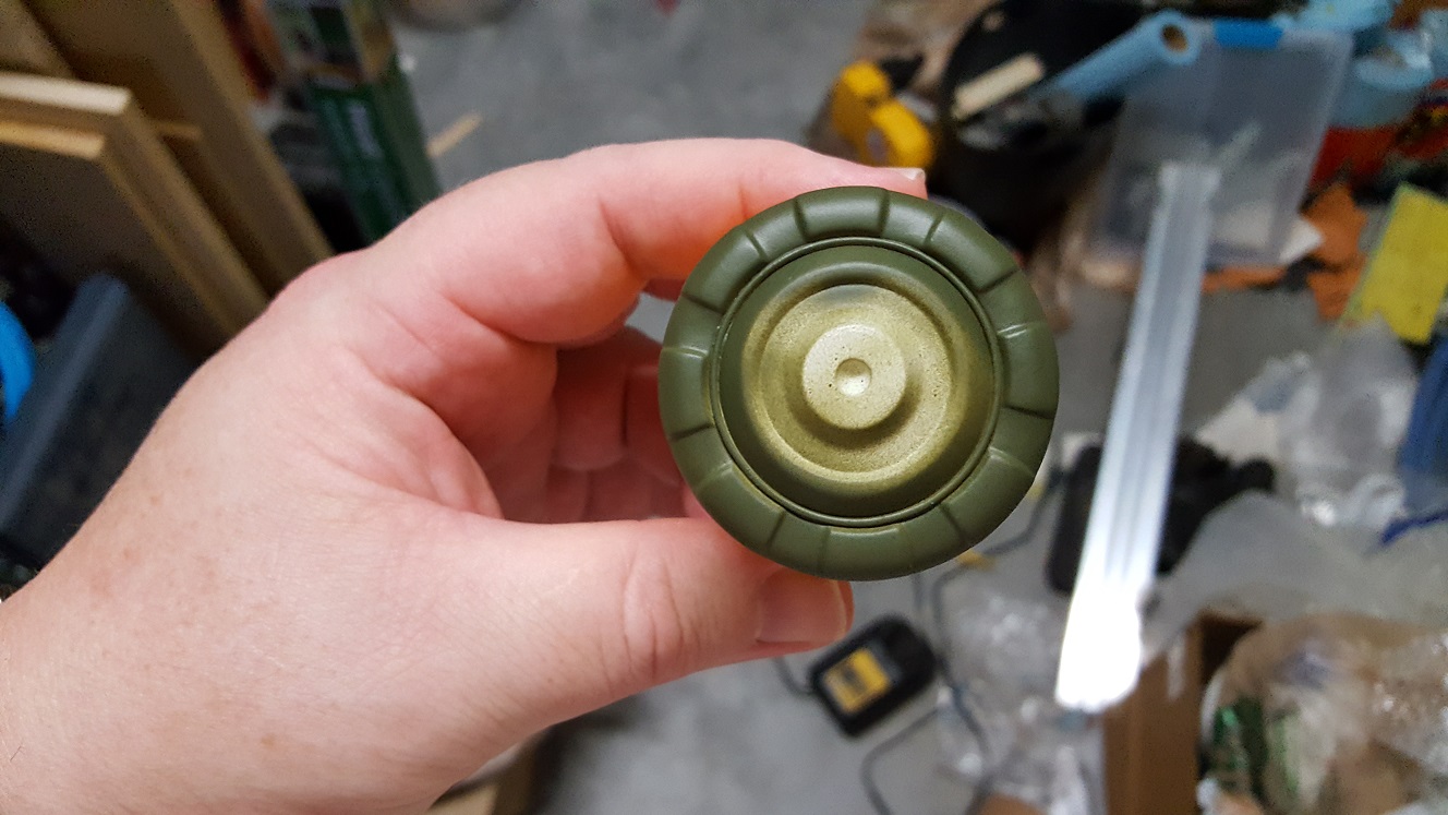

Tonight I will mask off part of the top and spray the inner round parts. In my screenshots the outer ring and the inner ring are slightly different colors, but I might just paint it one color.
Hurrah! I found a mistake! Pretty minor actually. After I glued the top and bottom together I used Bondo glazing putty to fill the gap. Nope. Looking at my screenshots I see that there should be a gap. Minor, but annoying. Minor enough that I'm not fixing it and repainting.
For future reference, paint the shiny part first and THEN the dark green. It would have made masking a lot easier. More spots to apply extra weathering.

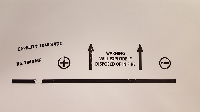

I was hoping the printer at work would print darker. Looking at the last photo you can see that the print is not solid, there are some faint areas. For this that is not a problem, but in the future for other decals it might be. I do not know yet how much of that will show up in the decals.

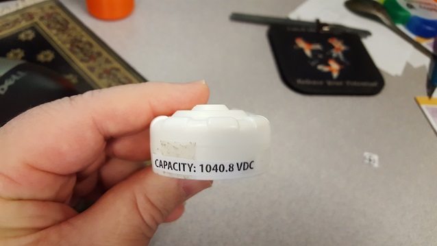

Huzzah! It mostly worked.

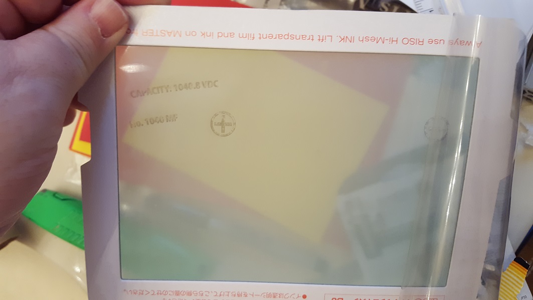

Here is a before shot of the screen for the white and black decals.

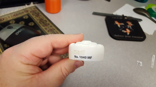

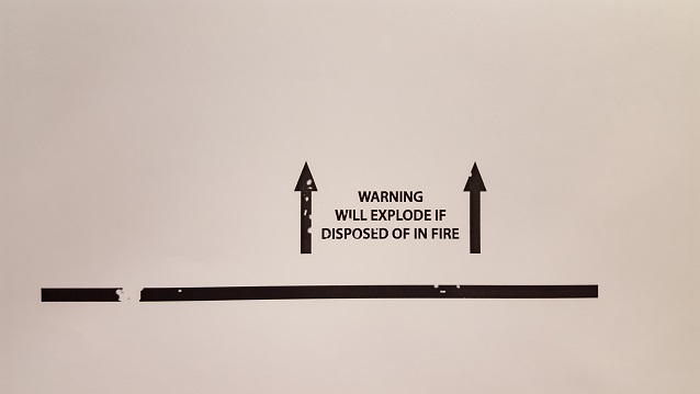

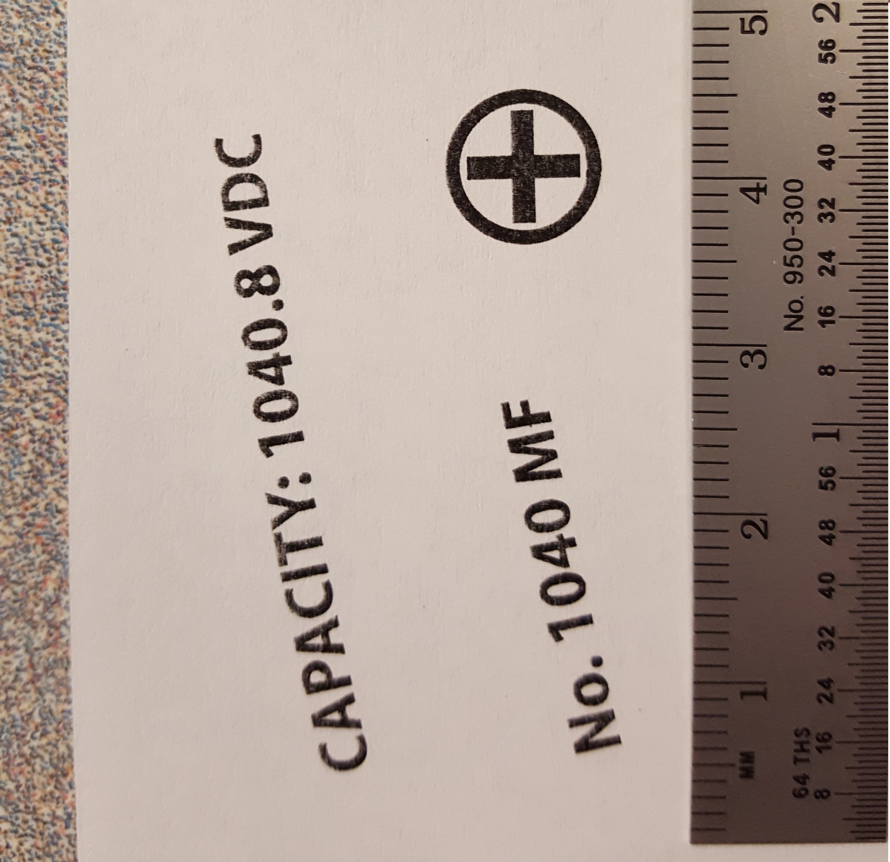

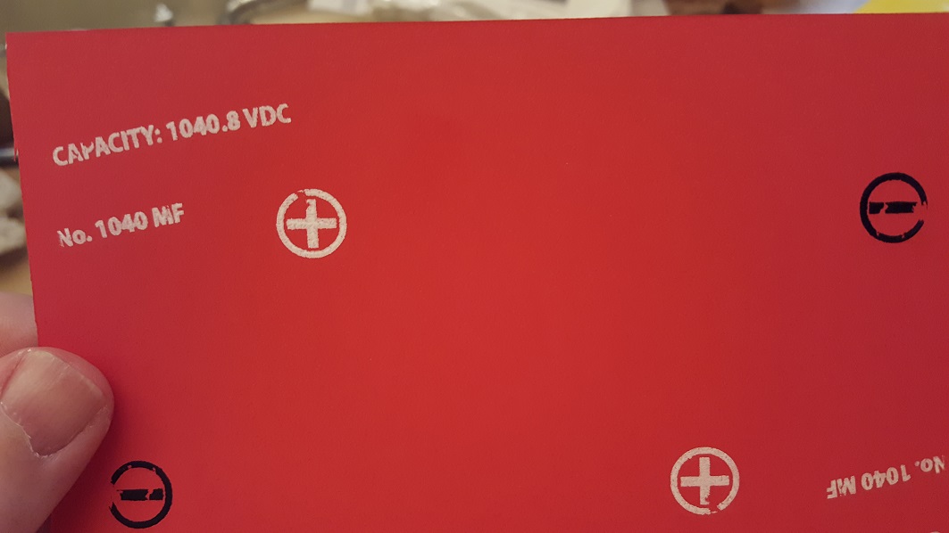

Here are a couple of tests of the white and black decals. The text is not as clear as I would like. I do not know how much of that is because of the ink, how much pressure I applied, and the paper. It looks ok on the decal, but the decal paper I got has a white paper backing so it is very hard to see it in a picture.
And here is the decal itself. The corner is cut off because I got water on it while I was trying to take a picture of the white and it got wet. So I cut it off to stop the water from spreading.

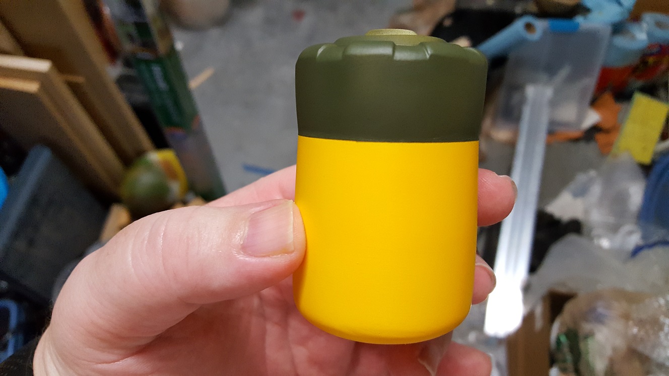

In the morning I will clear coat this and the model and after that has a chance to dry I'll give this a try.

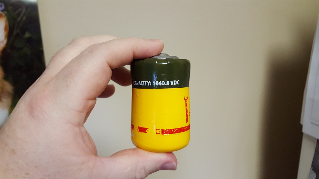

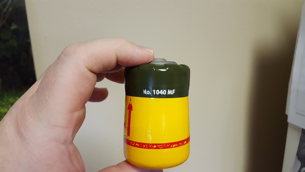

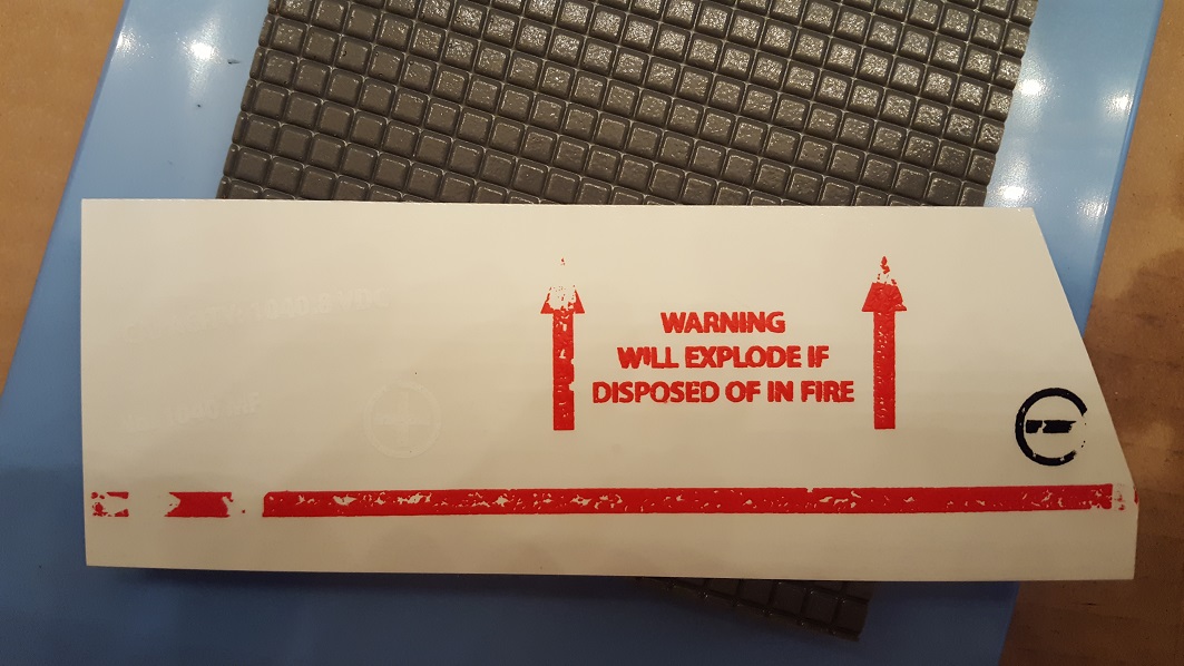

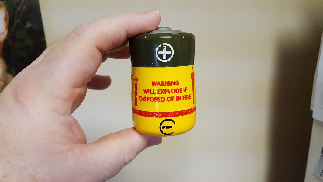

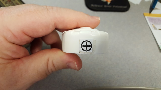

It mostly worked. That does not include my decal application skills. I did not trim them enough before I put them in the water. And the decals seemed thick. I don't know if that was the film or if I put to much clear coat on the paper. I still need to clear coat and weather.
The arrows are too long and I think the polarity signs may be a bit large.
There are two other problems. The first problem is the red line and arrows are far more distressed than what I had designed. Actually, the black polarity sign is too. If you look at earlier posts you can see what the were supposed to look like. I looked at the screen and that is where most of the problem lies. The second problem is that some of the text is heavier than it should be, like too much ink was put down.
The print quality is on me needing to learn how much pressure to apply while printing. The quality of the screens is the big problem. I have enough supplies to make three more screens, but there is no guarantee they will turn out any better. This thing went out of production about eight years ago so screens are at least that old. The only real source of the screens is ebay. The cheapest ones are about $9. The other part needed to make these screens are disposable camera flashbulbs. The cheapest I saw in the correct size are about $3.50 each and it takes two of them to create a screen.
