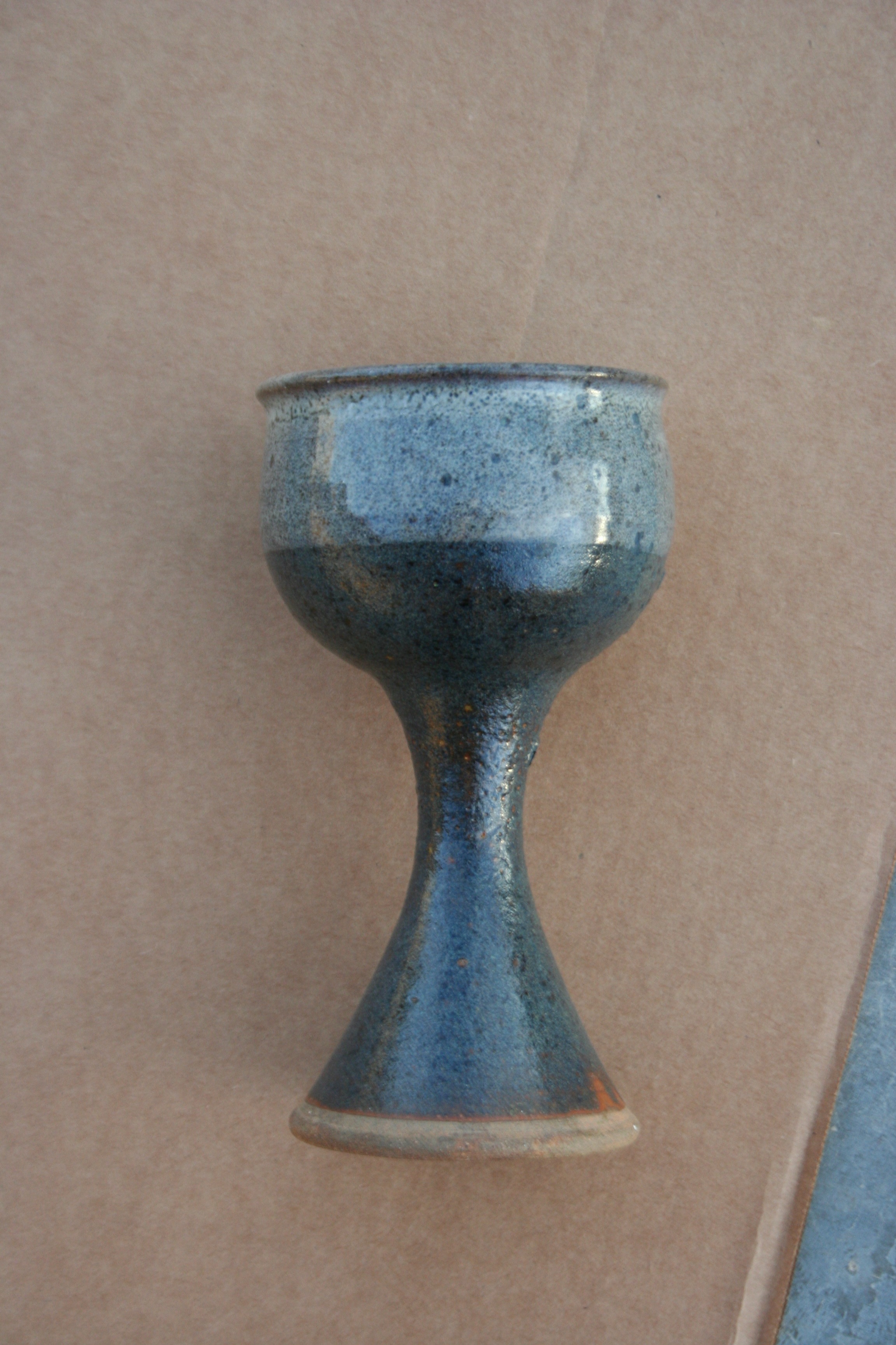

This is the base I started with. The shape isn't perfect, but it's decently close and I already had it so it made things cheap and easy.

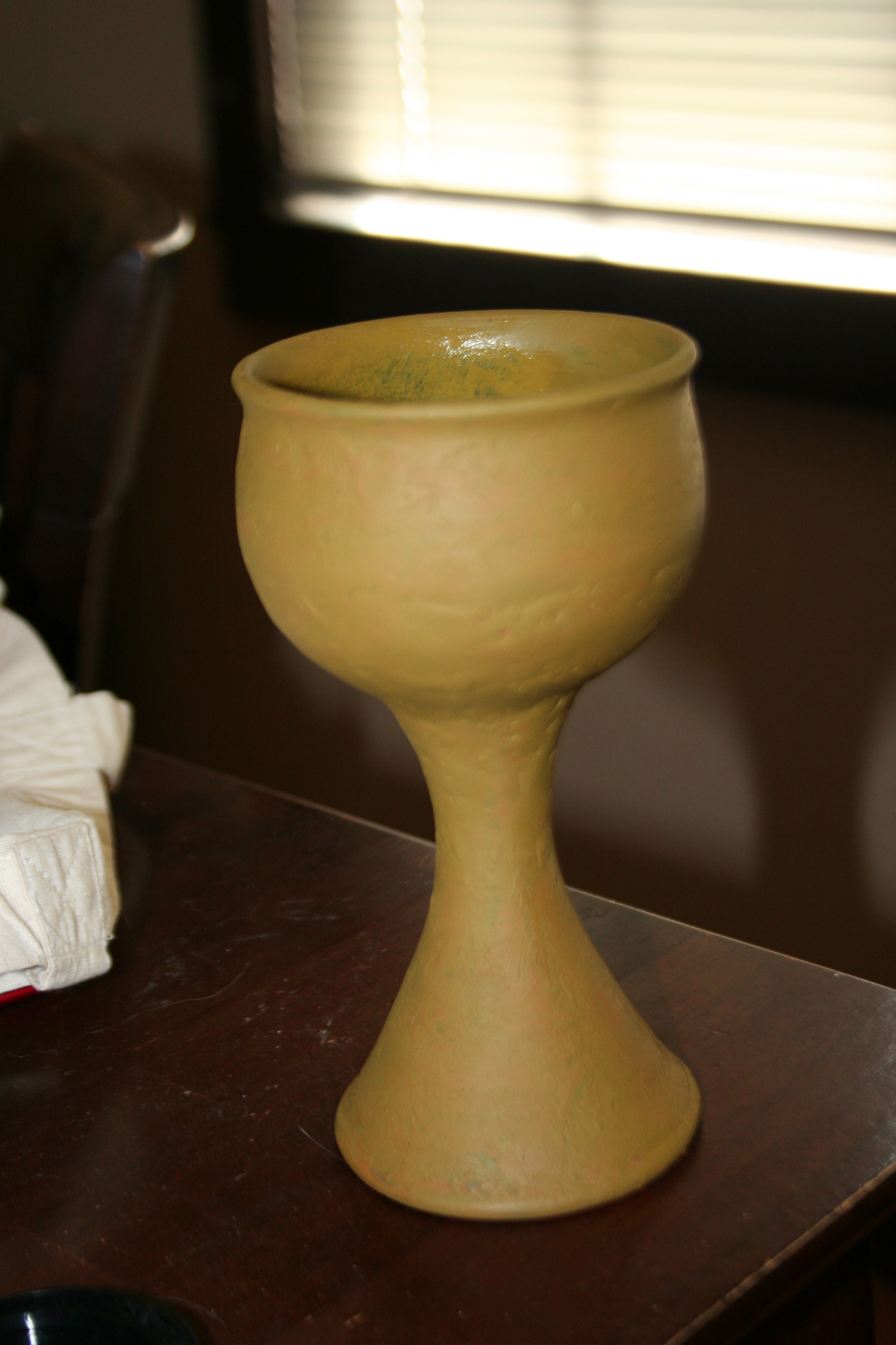

I did a sandable spray primer to cover the glaze and prep for Bondo, which I used for the little bubble pits in the original glaze. I liked the texture of the Bondo so I ended up spreading a rough single layer over the whole cup to make it more like an unfinished plaster/ceramic again. I didn't take a photo of the all-over Bondo on its own, but you can still kind of see it under the first coat of paint on the right.

Base paint was Ceramcoat Old Gold, and the second color was Ceramcoat Metallic Gold. The "Old Gold" is really more of a weird rotten pea soup or mustard color, but it worked well as a base to cover up the Bondo and make the second paint go on easier.

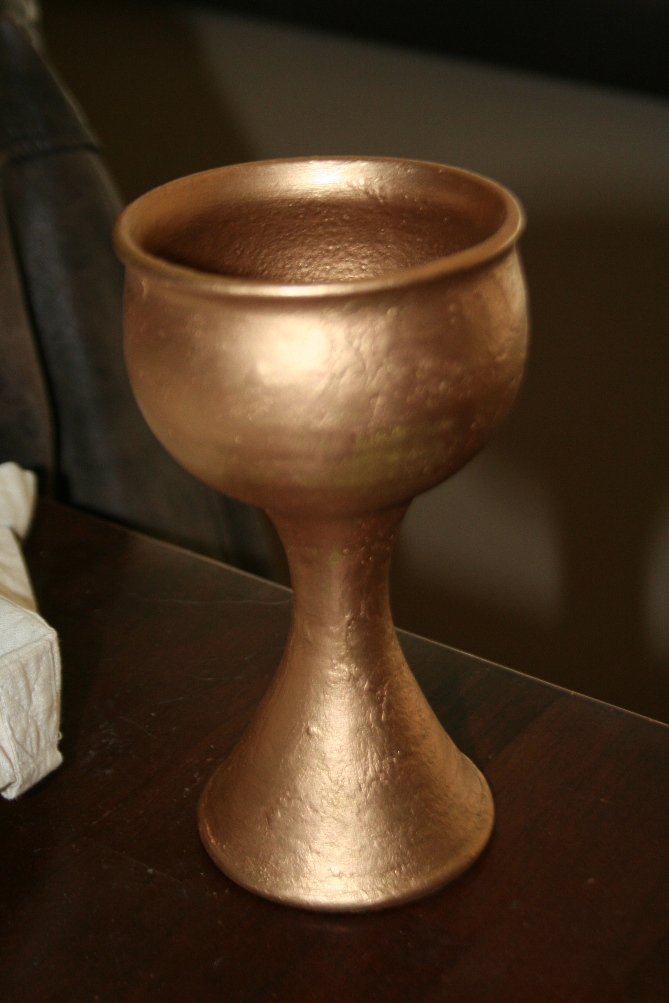

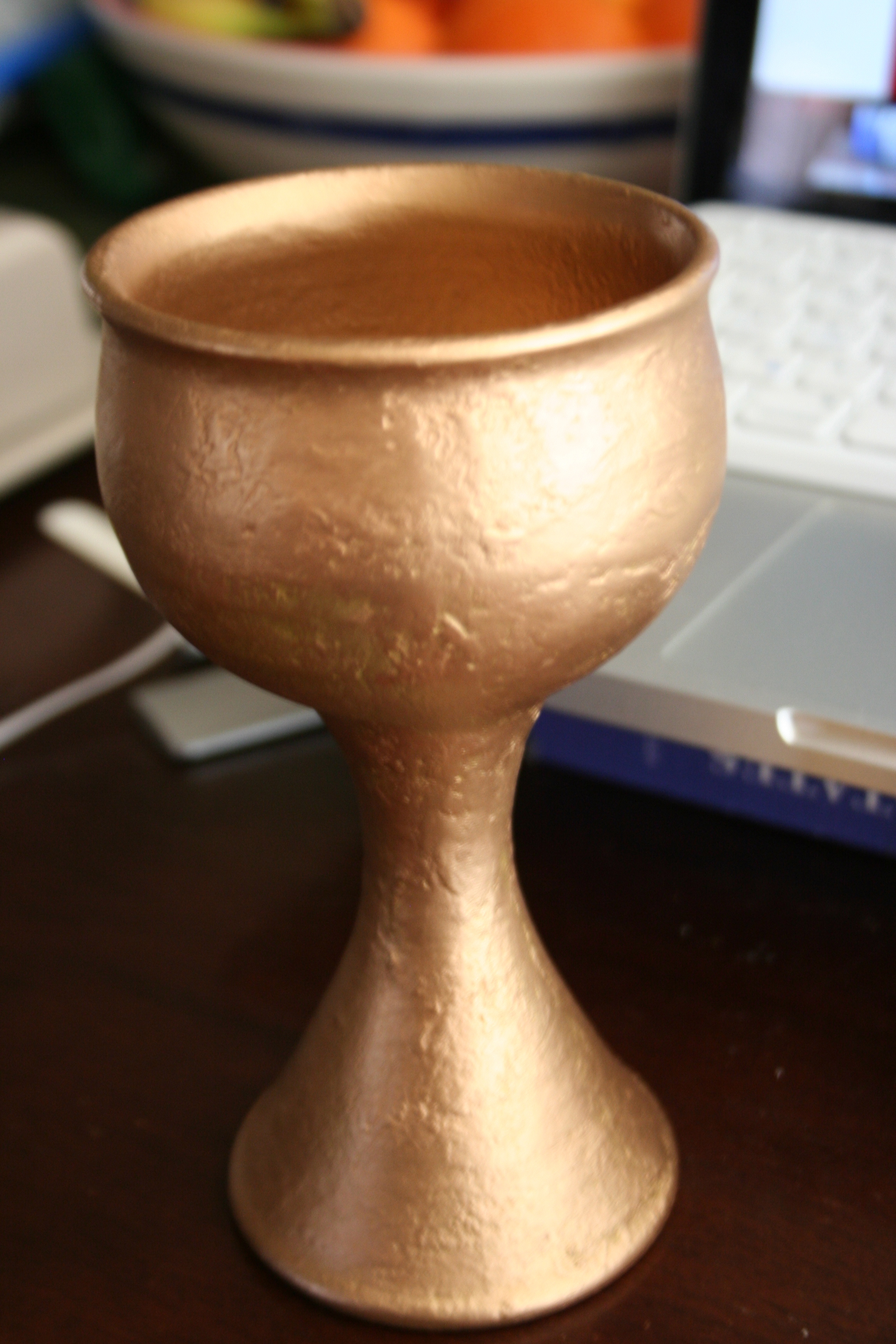

After paint I did a coat of Rub 'n Buff in Antique Gold. In retrospect I should have used Gold Leaf or Grecian Gold instead, but my local craft store was out of both of those (naturally) so I went with what I could get. (I really should have used actual gold leaf, but I didn't want to spend that kind of money on a cup that doesn't have quite the right shape. ~*STANDARDS*~) For anyone who hasn't used it, I highly recommend wearing gloves when you apply it. The package says you can just use your fingers, and some people say bare fingers work better, but I didn't notice any problems with gloves and it made the whole thing a lot less messy.
So now before I move forward to a second coat of Rub 'n Buff and the final paint, I need to decide whether to continue with this coppery gold color, or wait until the craft store has another gold in stock and switch to that. Chances are I'll get antsy and want to finish it as-is before I have a chance to get new Rub 'n Buff, but we'll see.
So I ultimately stuck with the Antique Gold Rub 'n Buff. I was too impatient to wait for the store to get other colors in stock, and this is just a first draft, so I figured what the heck, might as well keep going.

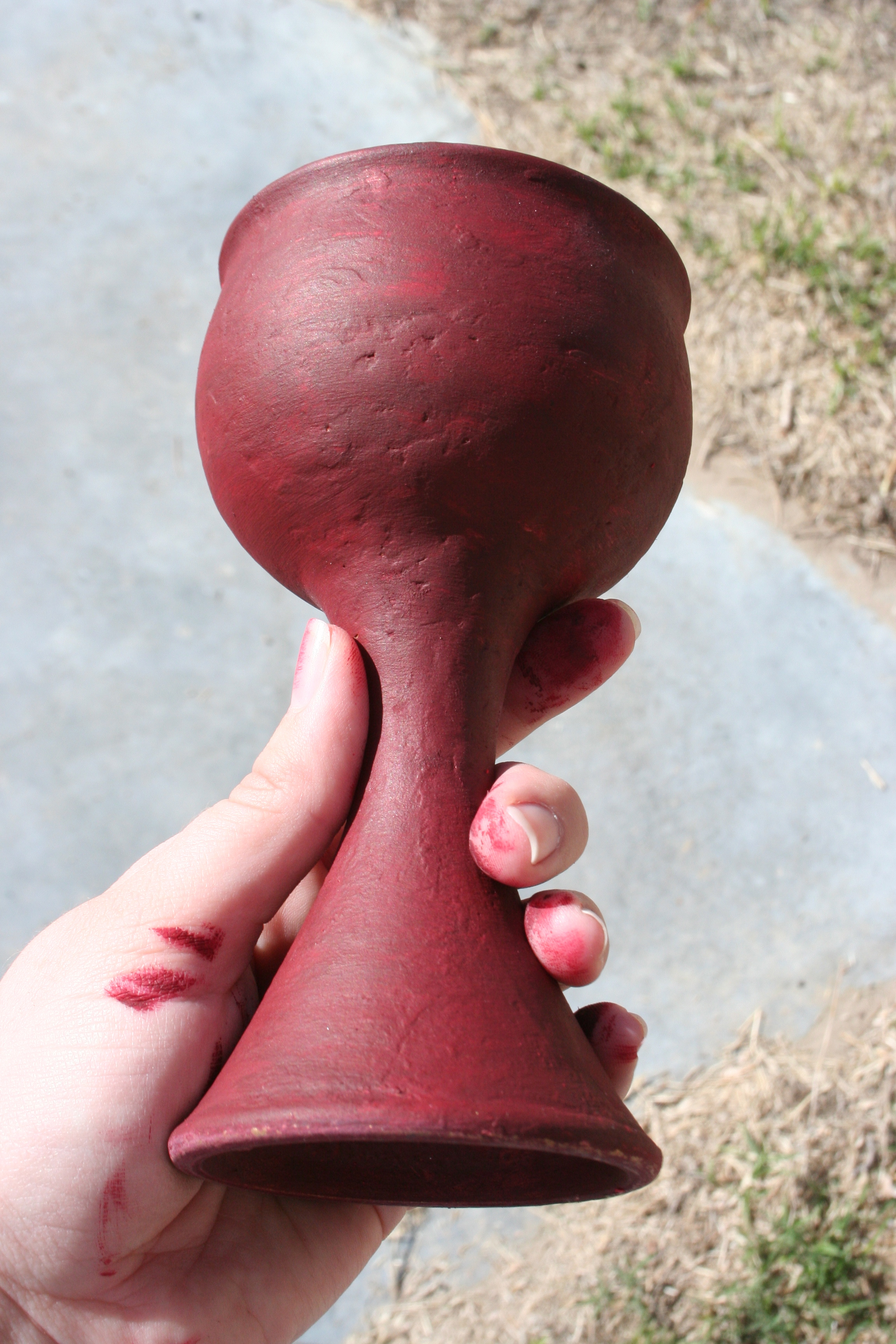

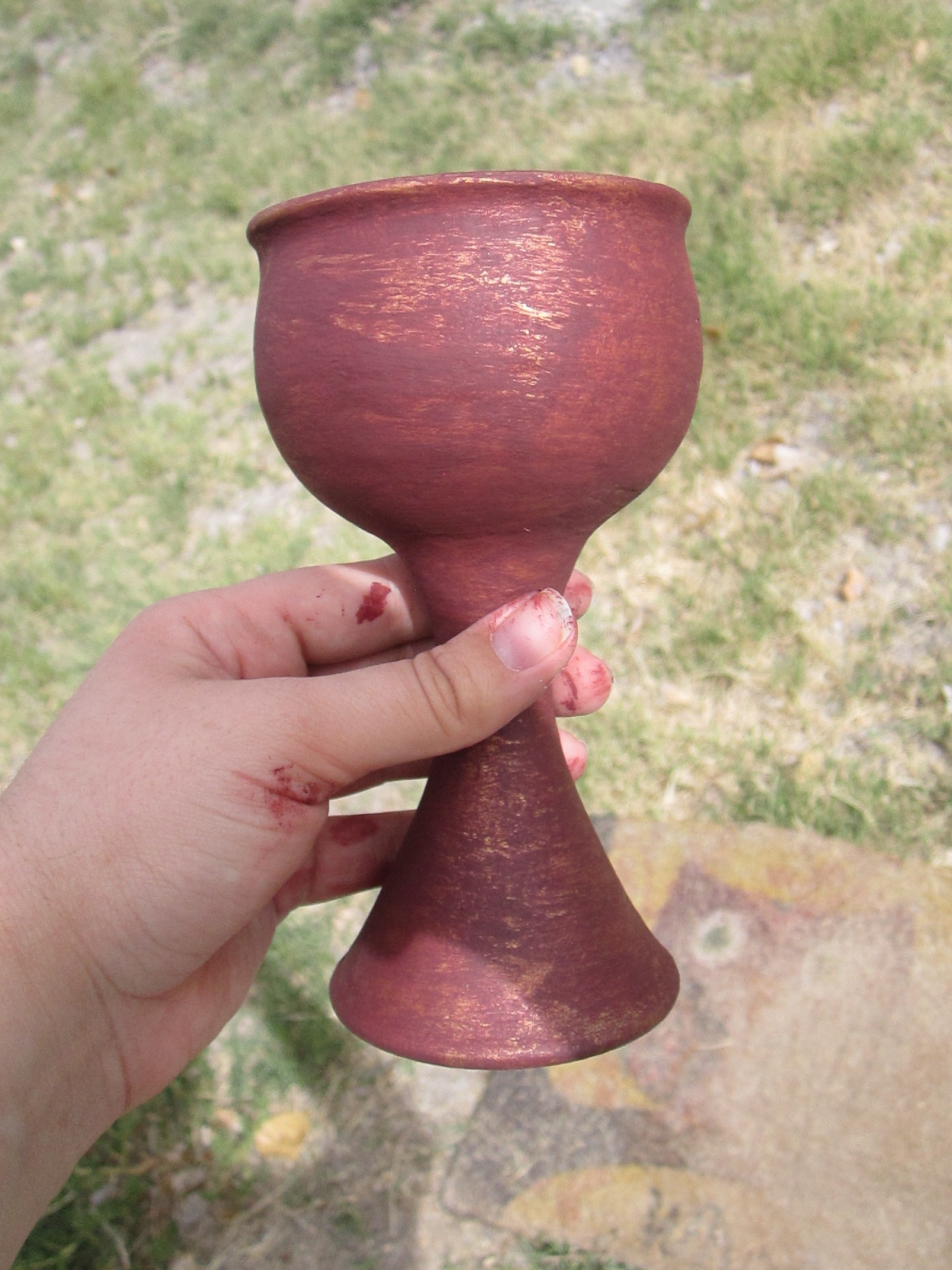

I mixed matte red and black acrylic and painted that roughly over the whole outside in a solid coat. It turned out what seemed like too red, so I went back with another darker coat that later ended up being too dark. Live and learn. Then I rubbed and scratched off sections of the paint to let the gold come through. I started with just a little, then progressively worked more off. The paint and scuffing had dulled the gold some, so I also touched up the visible spots to brighten them again.

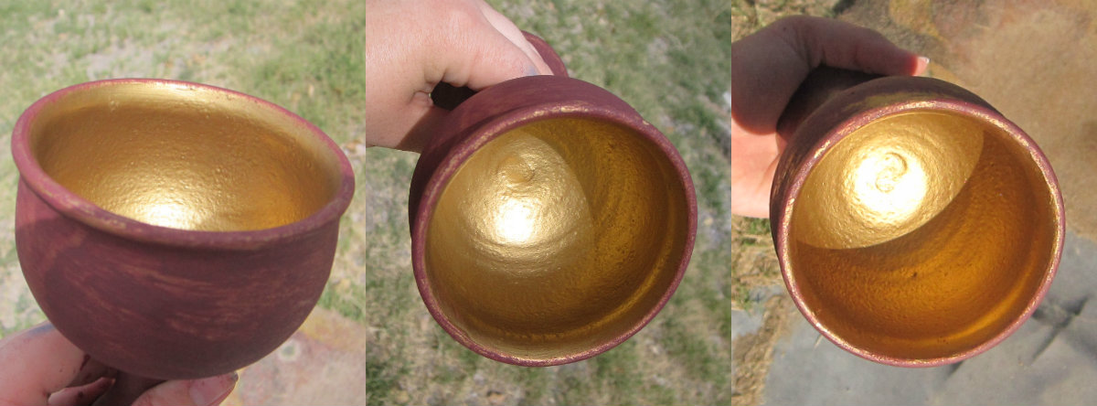

Not terrible, but not what I wanted and I never came around to it. So I scraped the paint and started over from the gold step.

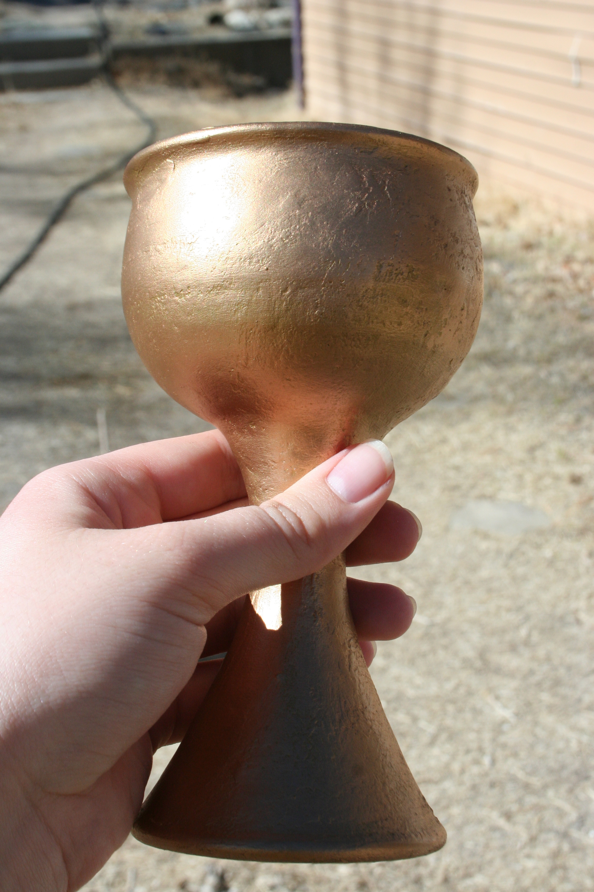

I broke down and got the Gold Leaf Rub 'n Buff. It still doesn't compare to real gold leaf, but it's definitely a step up from the old color.
For the paint, I mixed the color better - started with the same red again, but only did one drop of black and added a lot of brown - and only did one streaked coat. The bits of gold showing through made the worn spots more natural this time, and matched the reference photos better. I also did fewer worn spots, same reason.
Aaaaand done (almost). I just have to figure out the dusty weathering. I'll probably try some Plains Dust. For now, I'm so much happier with how it turned out, and locking down a good technique makes me more hopeful for the eventual Version 2.0.

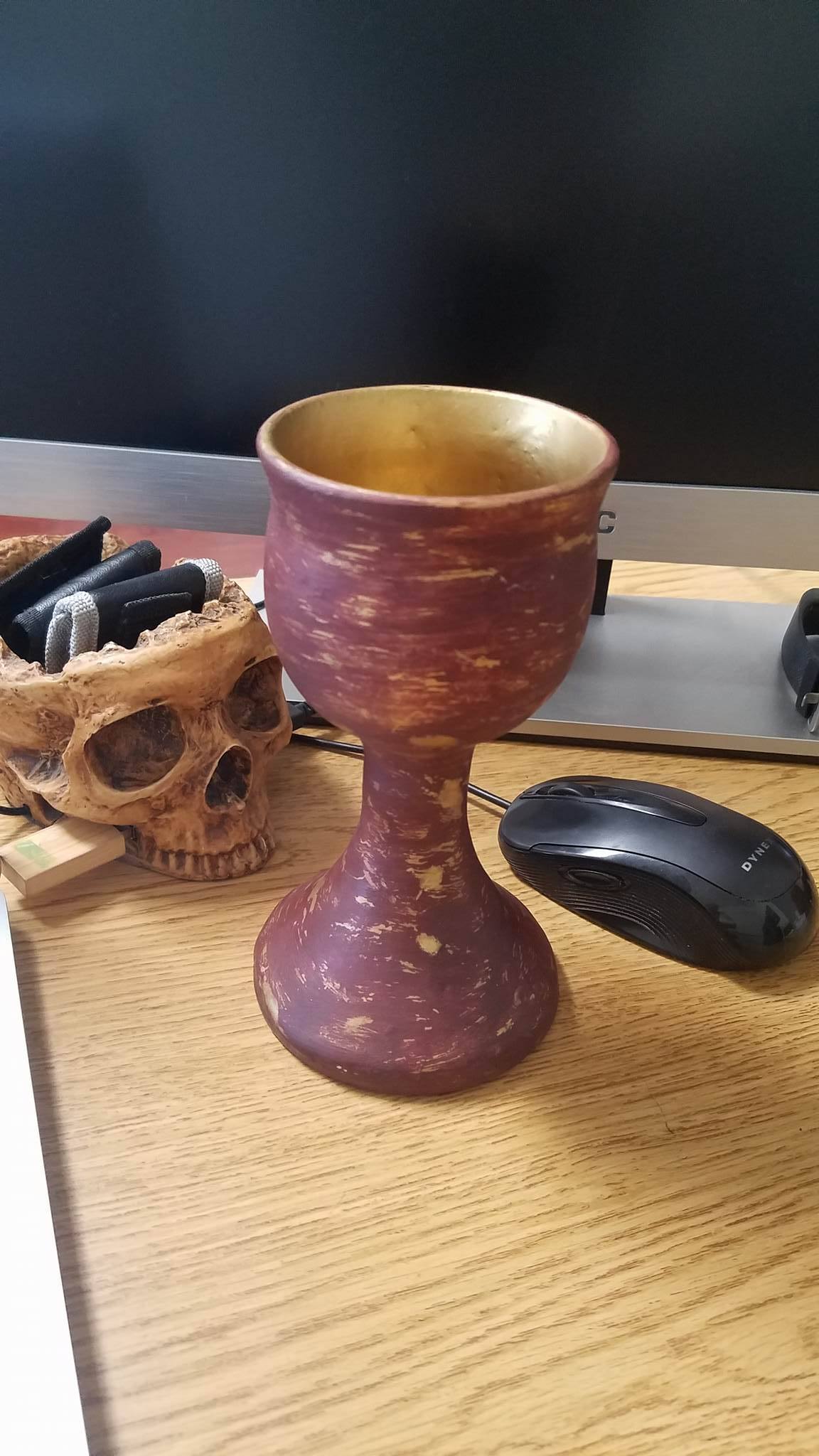

I recently did another Grail using the same process for a friend who's a huge Indy fan. Like the cup I used for mine, this one was something he just had sitting around that was close enough for a casual prop. I left it on his desk as a surprise, and when he got it he sent me this photo and a cheeky marriage proposal. I guess he liked it. :p
