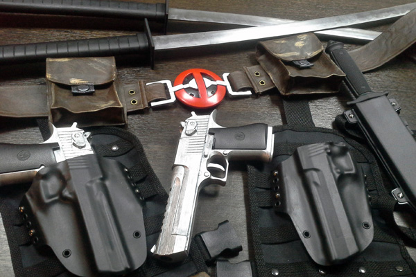

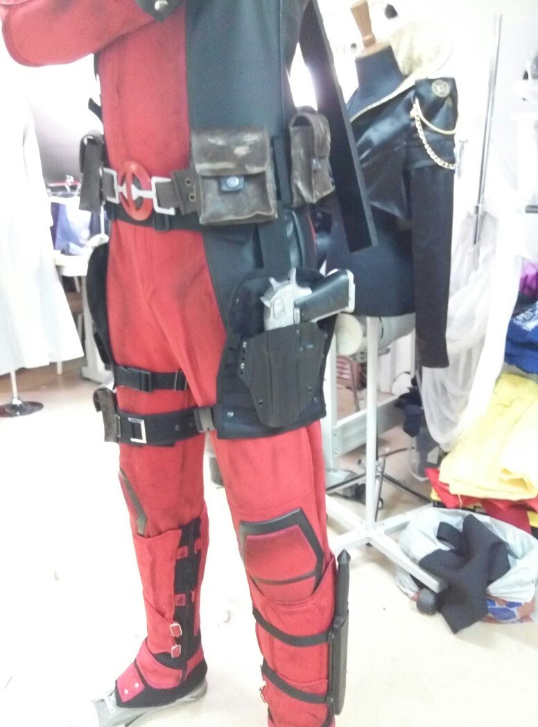

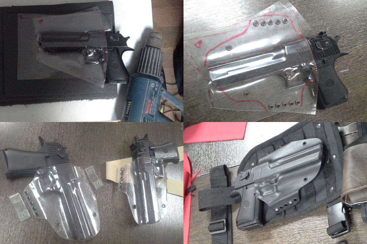

Gun holsters:
Same as knife holsters, but for base was used gun itself. Form, trimm, rubber-paint finish. I deside to make rubber finish on bough (knife and gun) holsters, and it was mistake because now we know that gun holsters have "carbon" finish. You can make it of kydex with carbon finish, but in my case its very hard to find it in my country, so PVC is cheaper alternative and if you prefer you can cover it with car film with "carbon" effect.
Also important moment: first i made holster mounts for regular 5 cm belt, but in new poster we can clearly see that mounts has different shape and didnt even fits the sling, just fixed over it somehow. I think it was made to avoid "thrusting out" fabric in mount part (othere wise they nee second belt on top of fabric part). So i decide to make new mounts as shown on picture and fix them permanently.

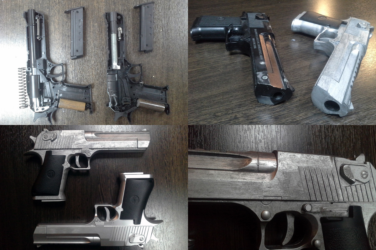

Guns:
In our country we still can take airsoft guns to con`s without orange plugs and any labels, thats why i prefer to modify even bought toy guns to make them act and look more like real ones... (1st photo on the right inner part modified) I took away all "firing" parts, replace barrel with wider one and add extra weight to the barrel (then "gun" is balanced more like real one for me it feels more comfortable and realystic in motion). Also cheap toys have plenty of screws on one side, so i moved them to another place and fill holes (on second photo you can see bigger barrel and covered holes) . After painting i also add some dirt and scratches (3rd picture show difference between silver paint and finished look)

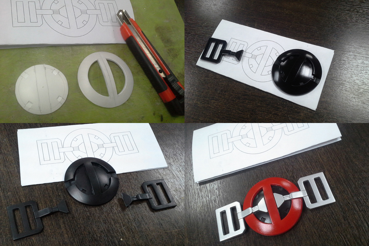

Buckle:
The hardest part was make accurate dome shape for two main parts, everything else is simple, cut, sand, prime, cold cast, paint and gluing parts together.
First i thought (as many who start to make buckles reffering to first photos) that silver parts in center has round shape, but in new photos we can see that is is more complicated and rised over black part.

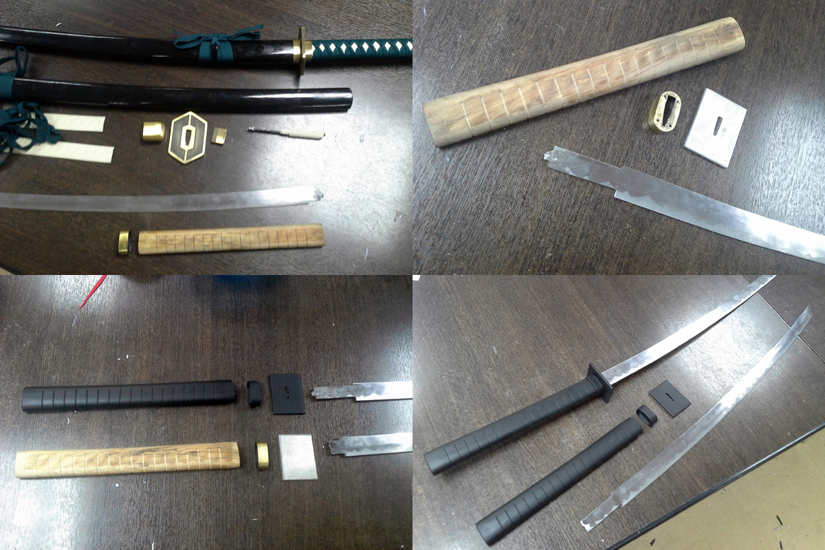

Katanas:
I took two souvenir katanas, throw away not needed parts (on 1st photo only 3 bottom parts needed) , engrave the handle, made new guard using 5mm aluminum sheet and finish with rubber paint.
During disassemble i broke blade (on 1st photo steel rod on the right from guard is piece that was in handle) because it was permanently glued in handle (my previous katana was just screwed together) but anyway you need make it shorter (because movie version is shorter than "real" one), so you just need to trim part of blade and make new hole for it in handle.

Gun holsters:
Guns:
Buckle:
Katanas:
