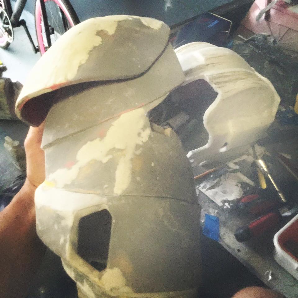

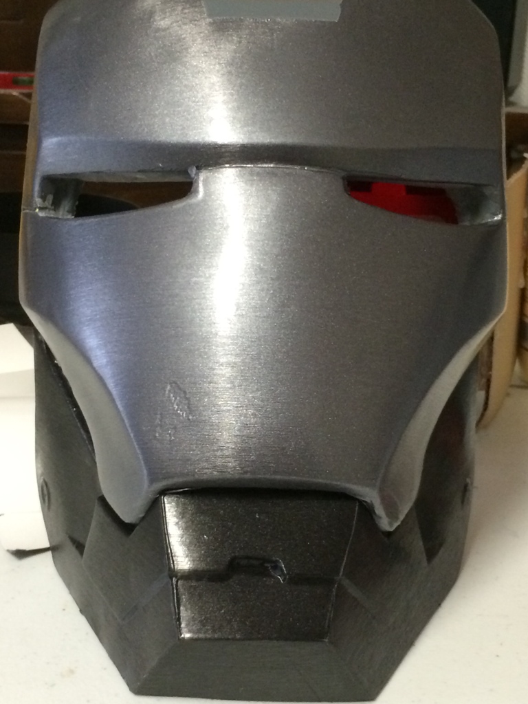

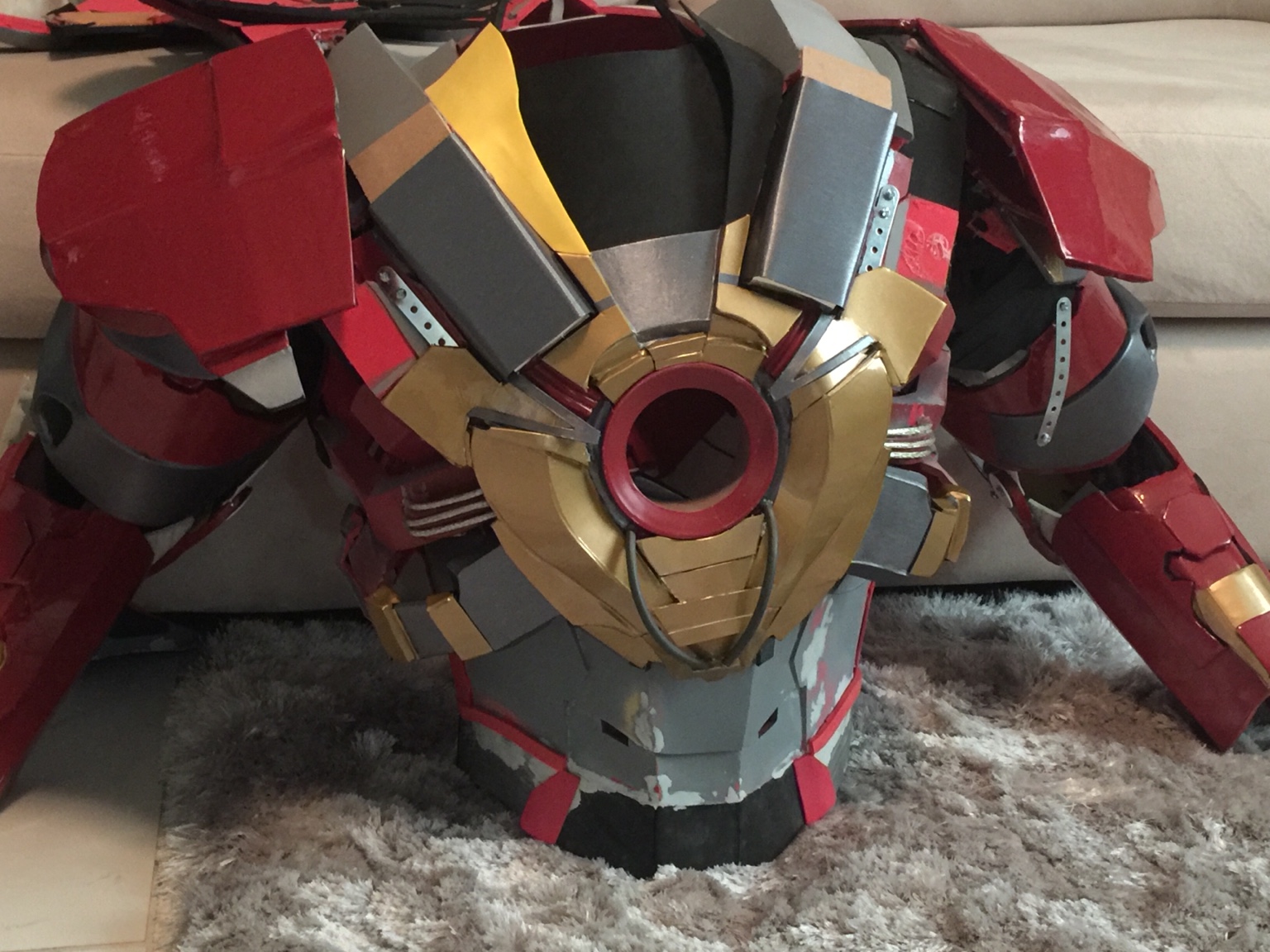

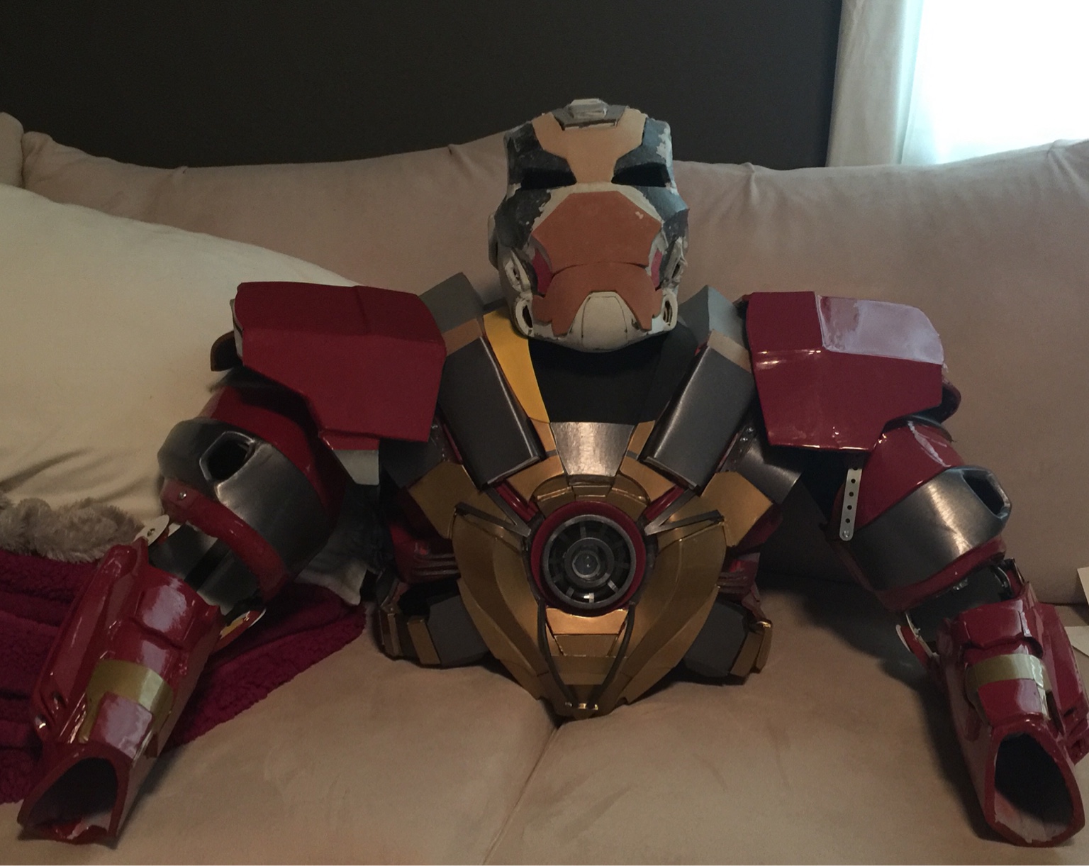

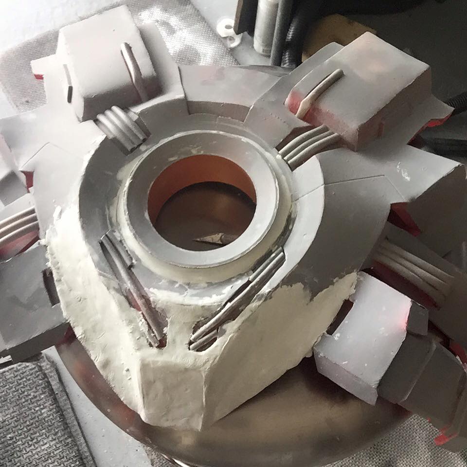

So I am going to start my build thread... I had someone do the foam pep for me to start with ( I don't have the time nor mental toughness to do pep for to long) I am using them mainly as a base to build off....I will make and sculpt the rest on my own. I plan on mixing up most of the aspects of the MK17 with some of my own elements as well as subtle elements from other suits as I like different aspects of a lot of other suits and cant make up my mind for just one suit. I also will be using 3M 1080 vinyl car wrap in place of paint.. I started experimenting with the 3M 1080 in the helm below that is black and brushed steel ( there is no paint on that helm its all wrap) it was my first attempt I have gotten better at it :) with a solid base that is smooth the finished product looks like a pro paint job on steel. I am hardening a lot of key areas but not all as some places don't need it and it would be over kill.... anyhow.. here is my start ... more to follow.

yes the 3M 1080 wrap does great with no extra "glue" needed. However, I will say that doing it over untreated foam is a mistake I made (and will fix/not do it again) as it will leave bend marks when the armor is flexed enough... I would have harden the foam prior as it looks WAY better :)

Yea no extra adhesive needed, but just smooth/harden your foam prior, if not it will show some wrinkles in areas that flex. Some places I did use heat gun and other I did not. It took some practice finding out what color wraps do what when used like this. I found cutting tiny slivers to do seams works good to cover edges depending on colors where others are better with wrap around and heat.. ( sorry for confusing response I am on treadmill while writing this lol )
