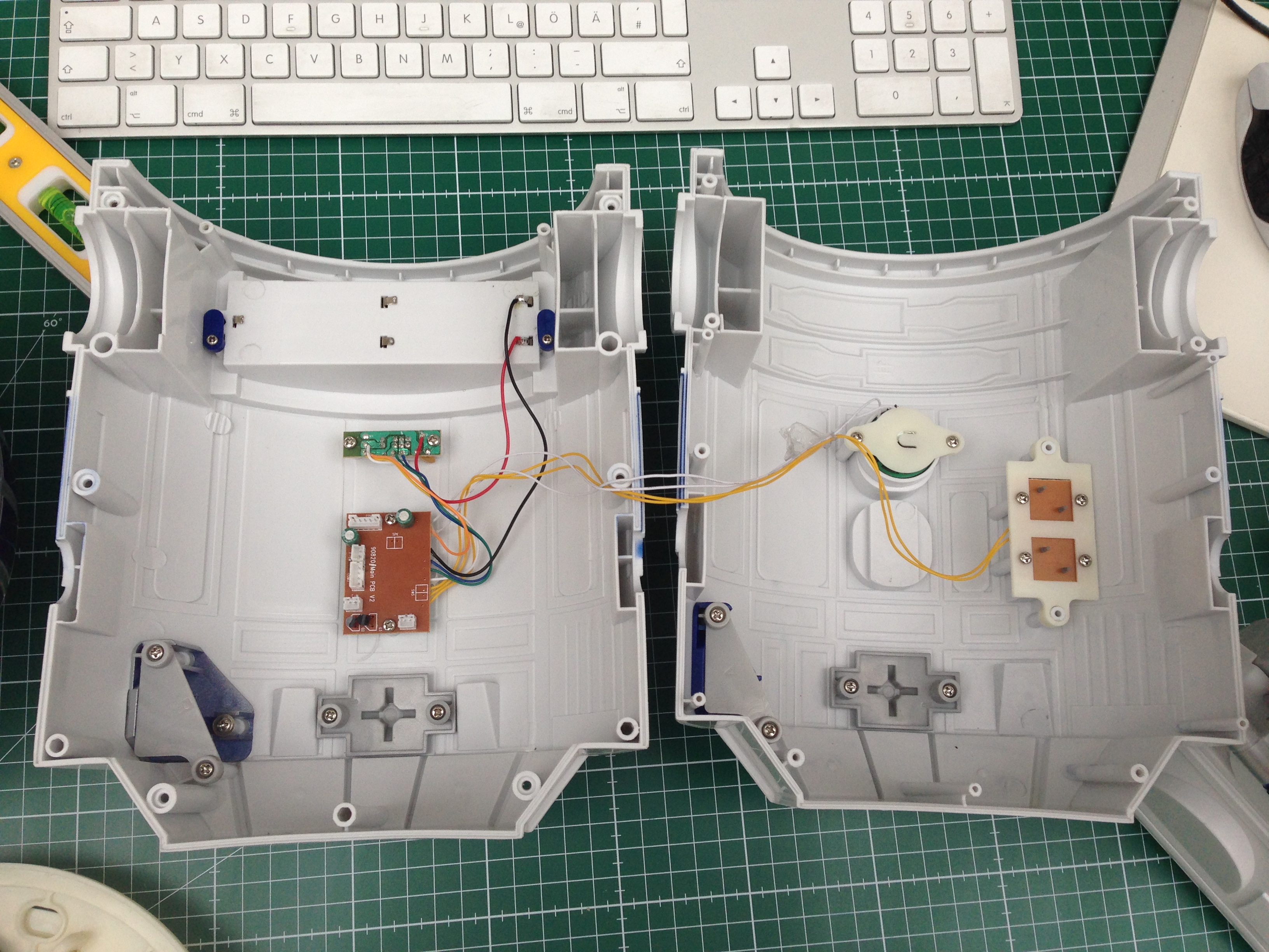

Started to take it apart this morning, it was super easy as its only attached with 8 screws and no glue like most Hasbro Toys.
Main Body with electronics.

Legs...one have a small engine inside so it tilts sideways like R2 does when he is nervous or something (Kenny Baker Style :) )
Swivel/Rotation plate with engine...will keep that for sure.

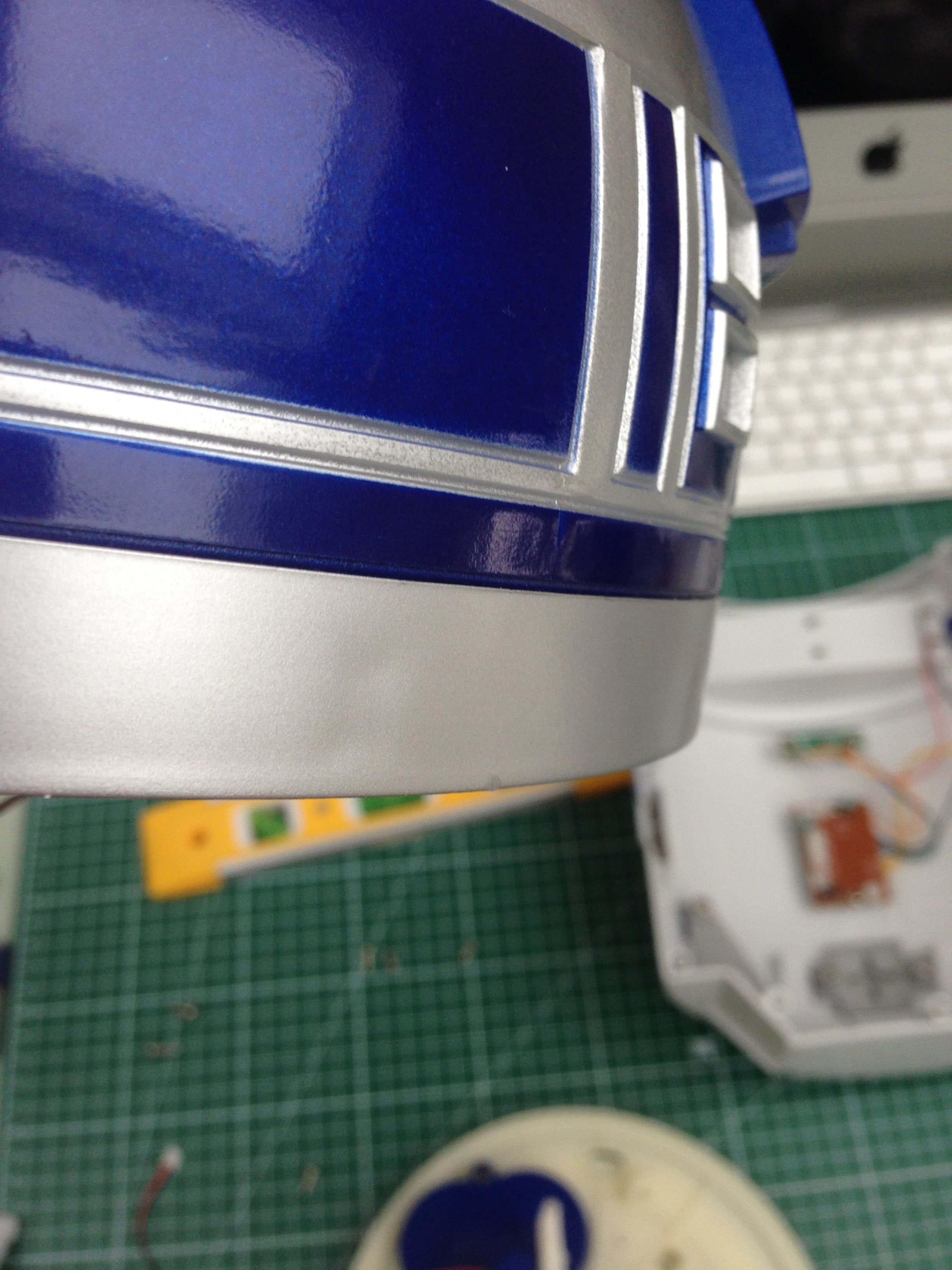

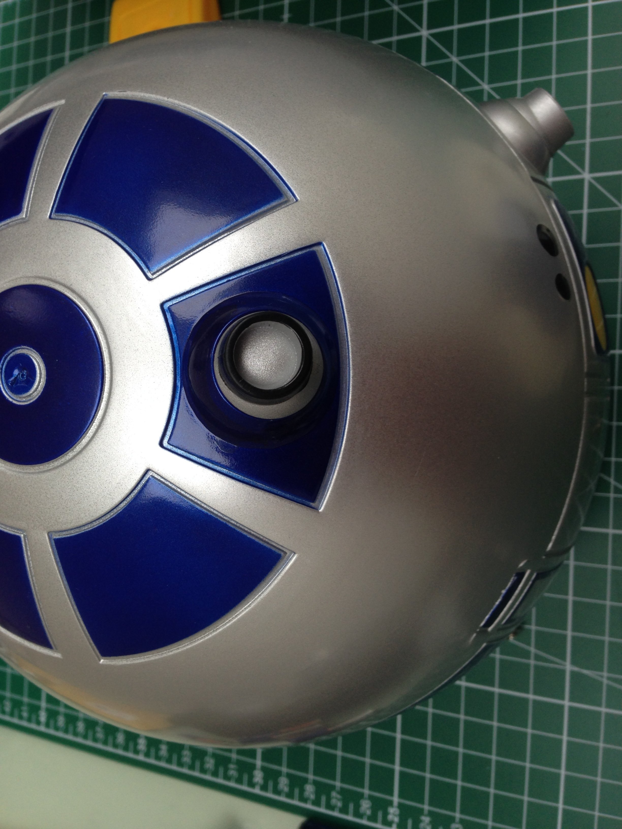

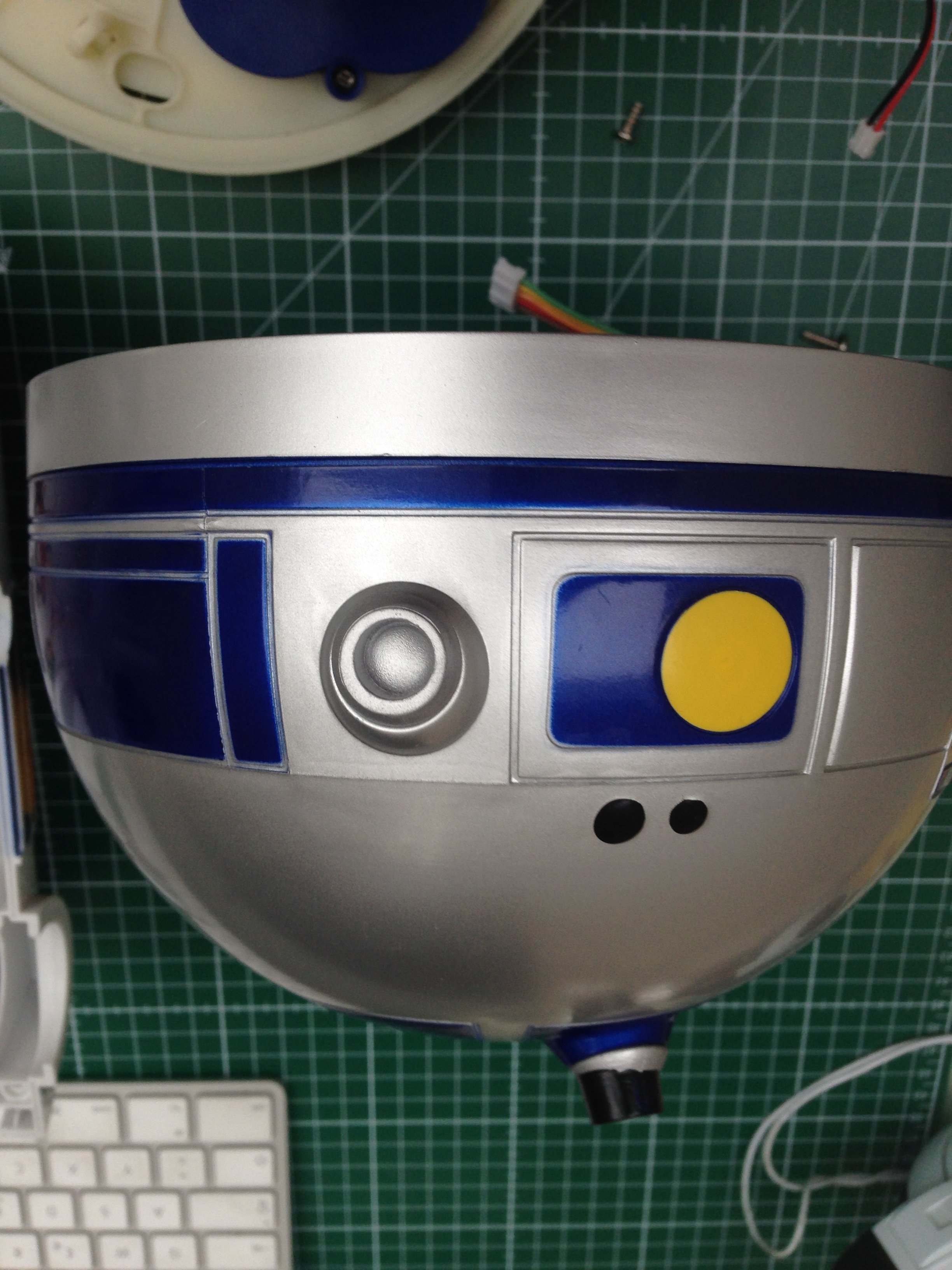

As you can see the Holo Projector is solid and needs to be cut out and fitted with a lens, also the PSI has a Red tinted plastic piece that needs to be replaced to a Milky Semi Transparent one.
The Proportion of the Lower Blue Band is also to narrow so I need to fill that and cut a new Panel Line to get it right...about another 6-7mm should do the trick.
Same in the back, the PSI needs to be cut out and replaced.
as well as the top Holo Lens.

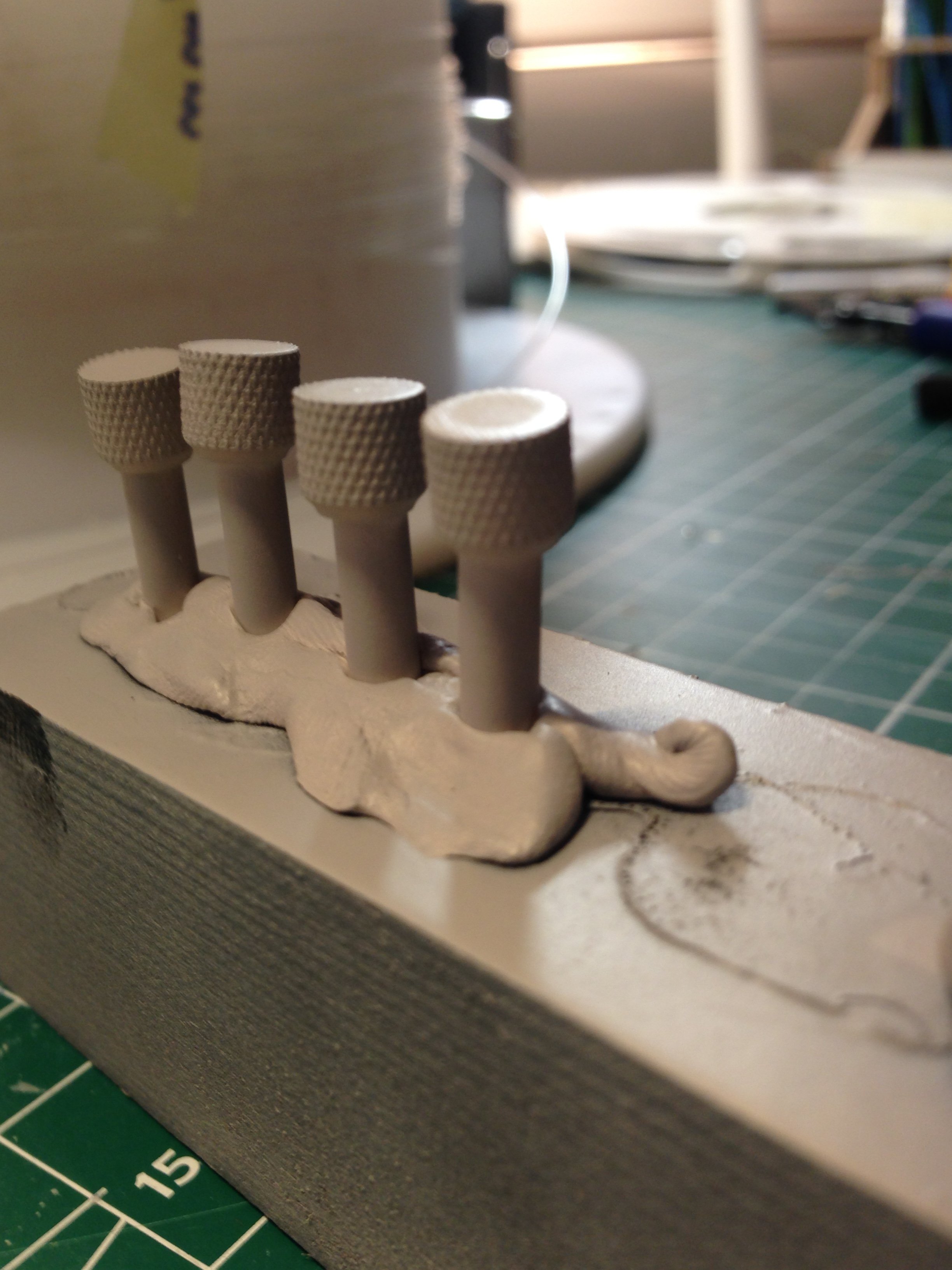

And a "Knurled Hose Fitting"
And uploaded the 3D Data to "Shapeways" and got the parts back and...
Not to bad hey :) its a Vickers Viscount 700 Series Cabin Lamp ;) wasn't cheap but hey its for R2!
And the Knurled Fittings with a 4.5 mm Braided tubing I got of e-Bay for like 14€

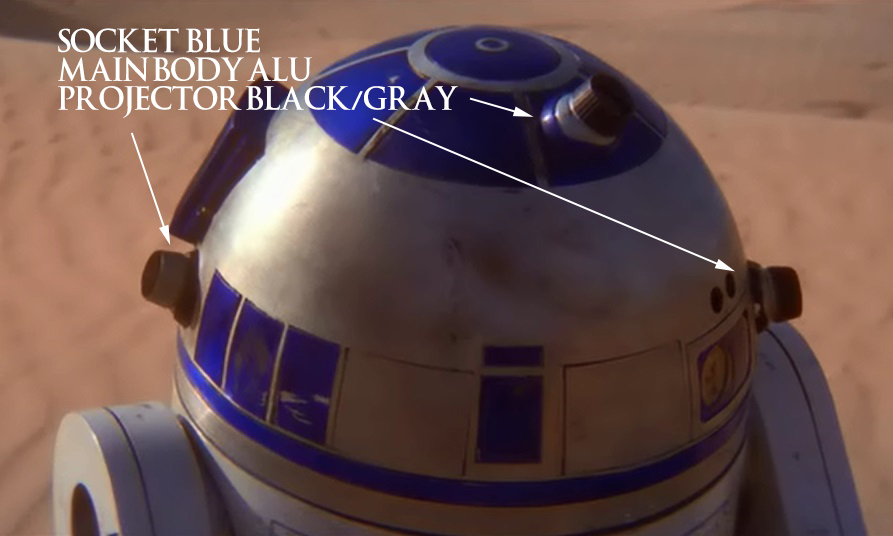

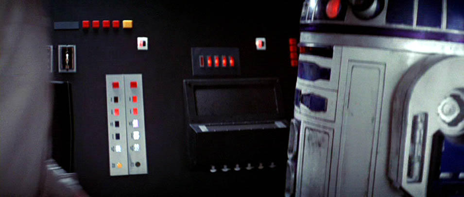

Got a question regarding the color Scheme of R2's Holo Projector. Been looking at different pics for reference and noticed that the HP not always looks the same, so I narrowed down the search to different films and this is what I found.

I guess there are some hardcore R2 builders here so maybe you can confirm or at least tell me what the deal is with the Holo Projector.
My personal preference is leaning towards A New Hope...with the Blue Socket...somehow looks more like R2 :)
I think most builders tend to go in the ESB-direction. I might be wrong, just my personal observation.
Very nice build so far. :)
After ANH the HP's and surrounds are painted silver (or rather not painted at all, that's how they came from factory). ANH changes literally from scene to scene, shot to shot, droid to droid. If you want ANH, you'll for sure want the front HP cone to be black, and the surround or "cowling" to be black or blue, your preference.

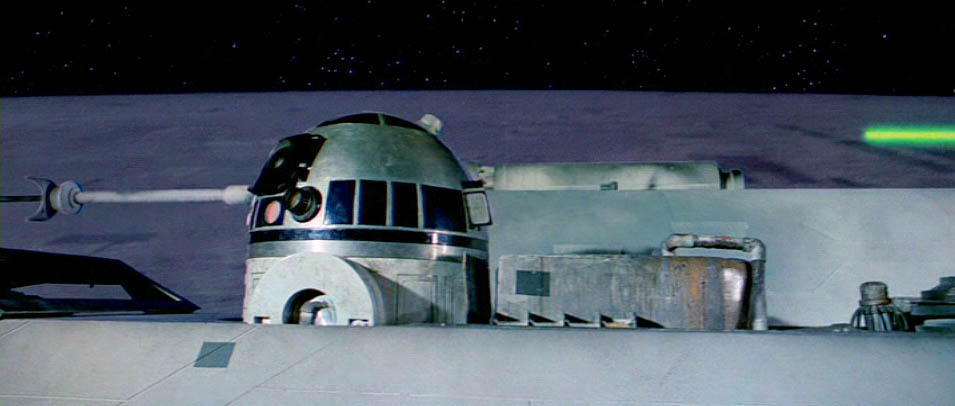

HA! now thats a revelation, seems like the props guys got their R2's pretty mixed up between locations and takes. Sifted through A New Hope at the Star Wars Screencaps site and its really clear that they used different R2's all the time :)
