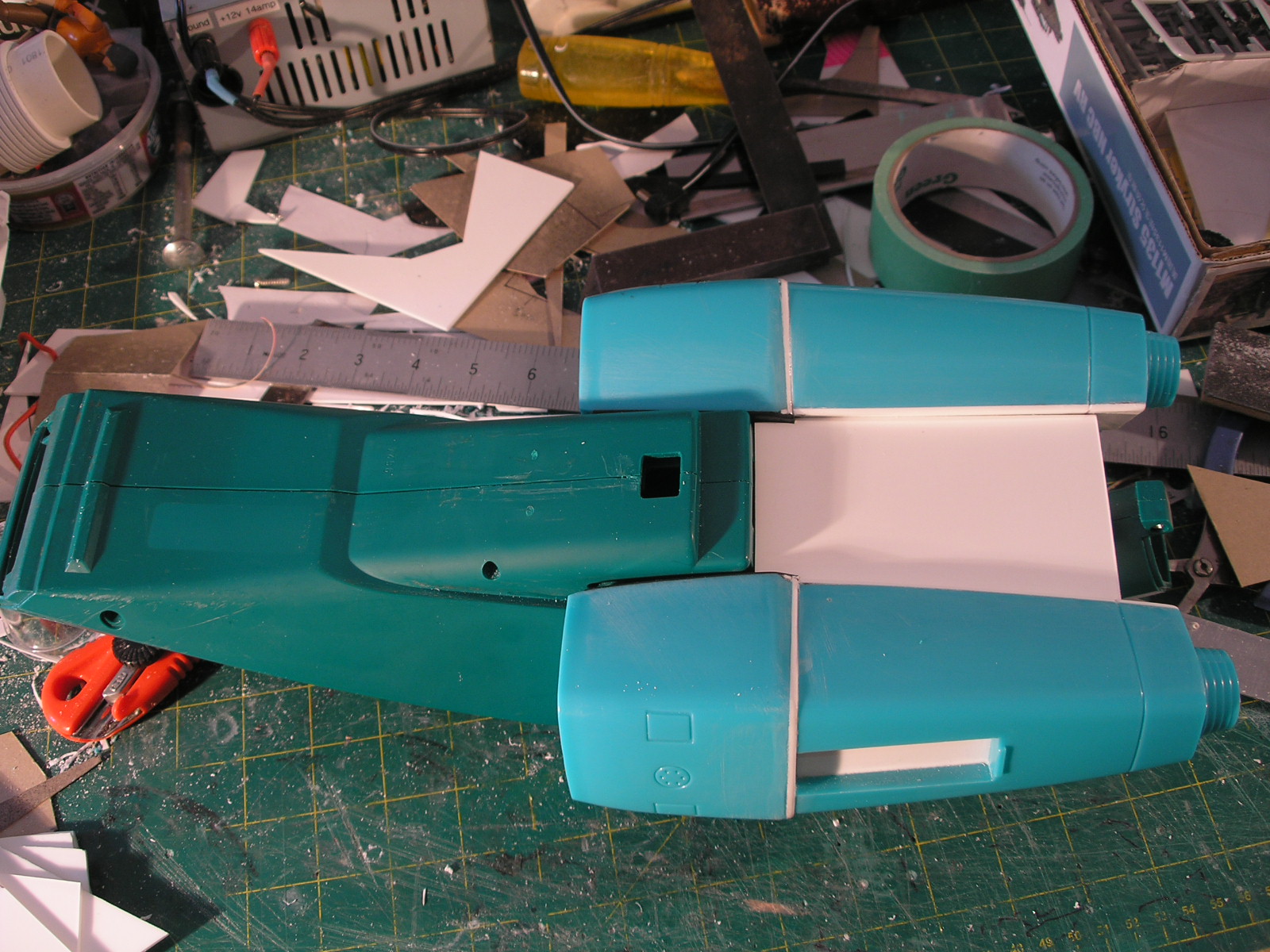

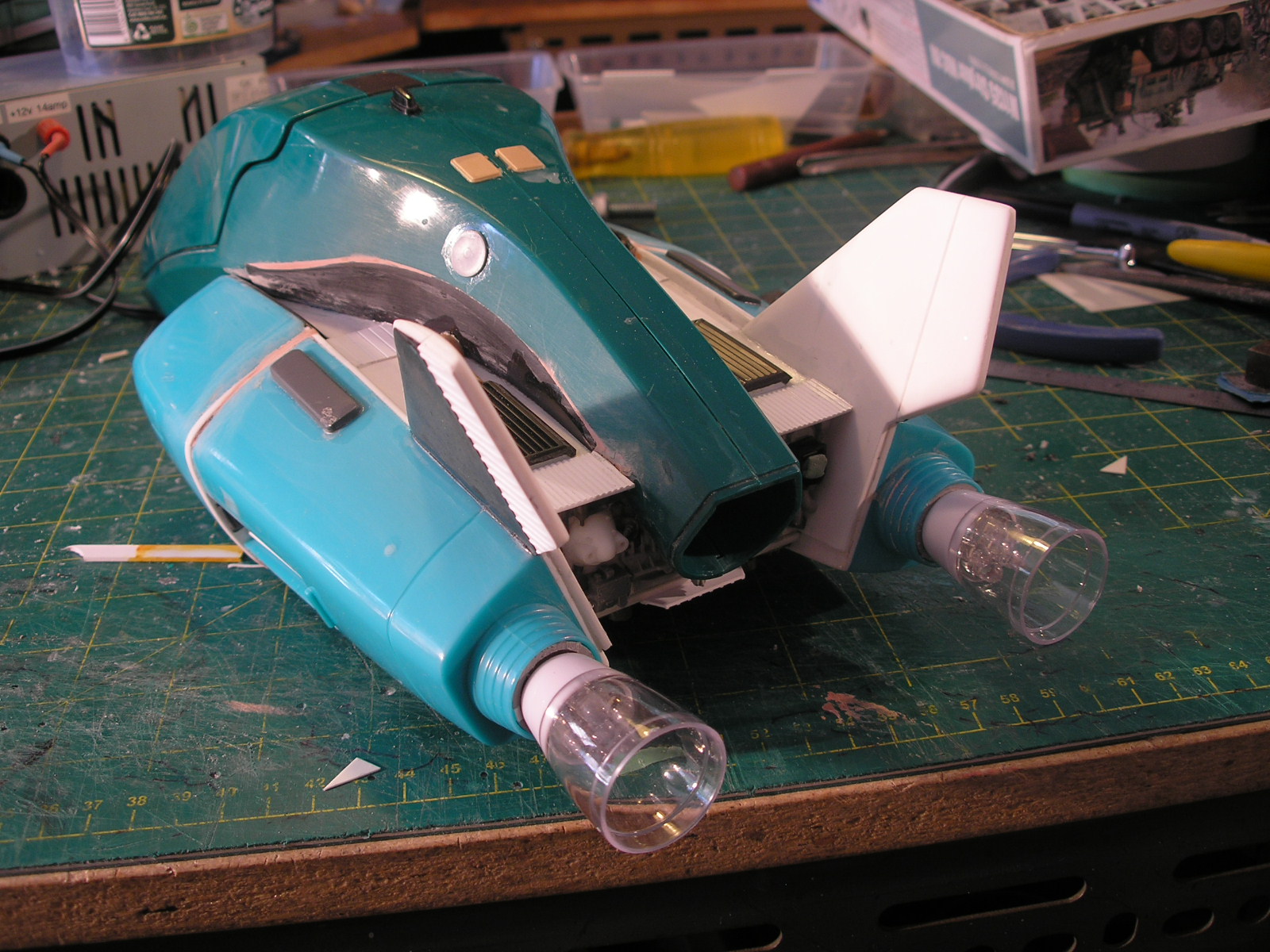

from which I salvaged the blue engine mouldings which I shortened by removing a section from the middle.
The engines are fitted together with a box structure of 2mm styrene at an angle which matches the angle of
the lower side of the dustbuster shell which has been gutted of its internals.

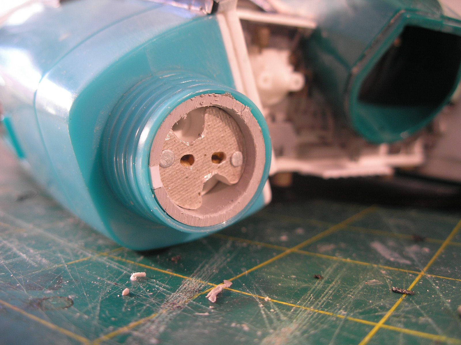

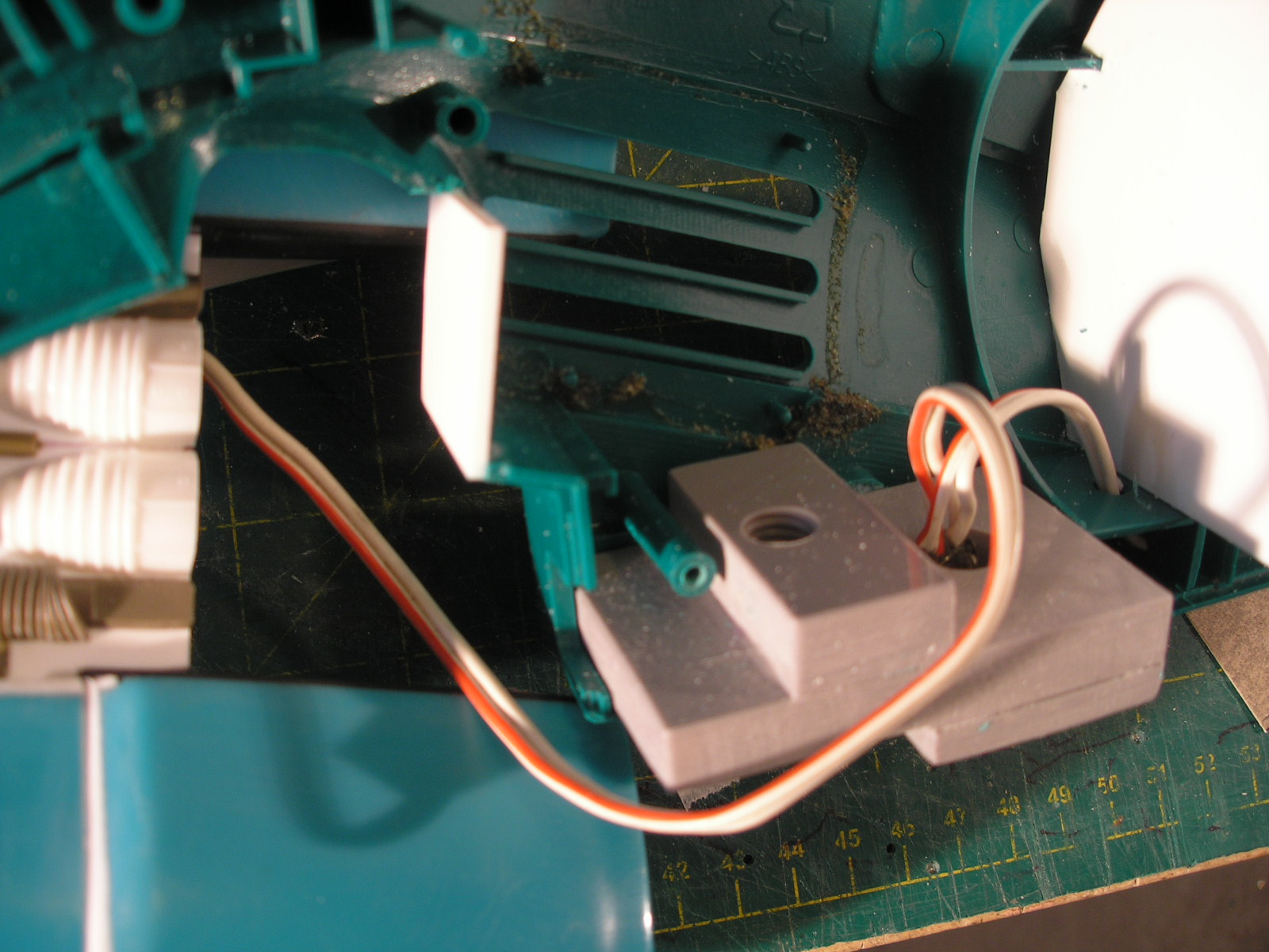

Slabs of 10mm and 6mm grey pvc make up the support rod housing underneath and at the rear.
A hole was threaded 3/8 whitworth to match the 3/8 whitworth bolt I use as a support rod.

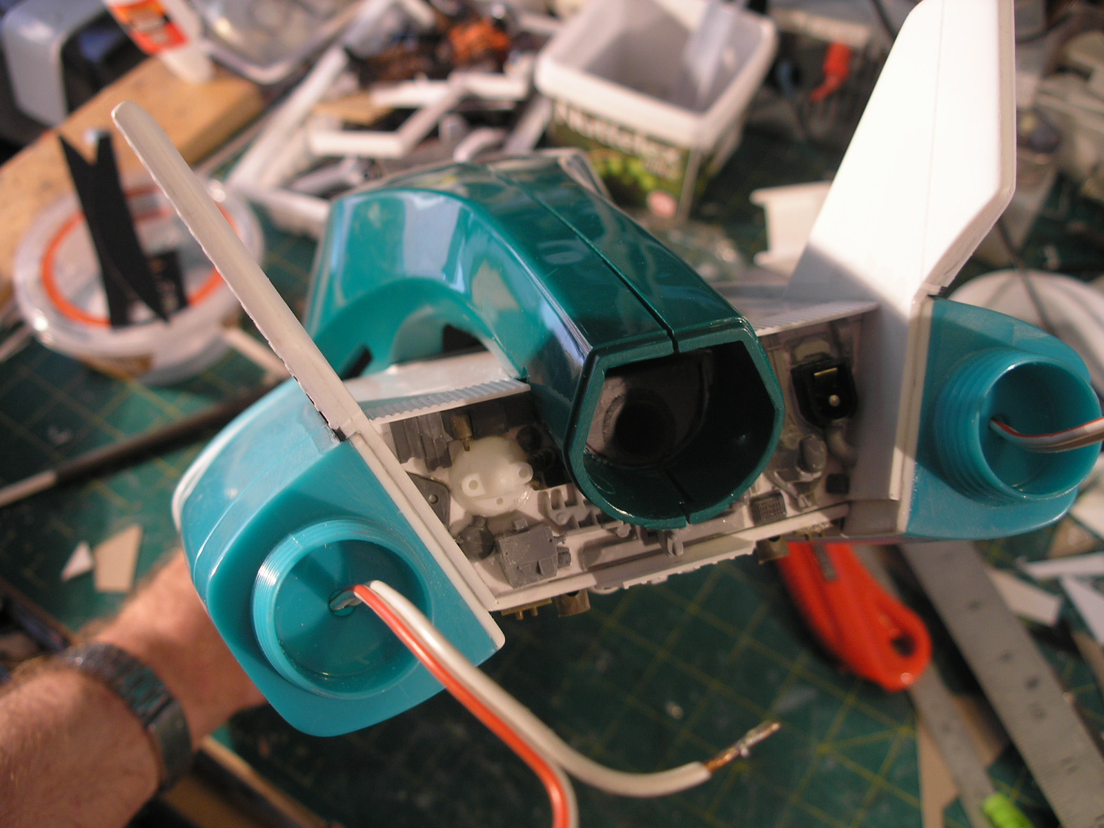

Wiring for the engine lights and the cockpit lights is also installed and hooked up to a couple of 12volt DC connectors.
The PVC is glued with thick super glue to heavily roughened surfaces.
Some kit part detailing of the back of the engine structure was done.
With all the wiring tested the two halves could be permanently brought together with the aid of the original screws,
and the engine assembly glued on with the usual Methylene chloride solvent.
The bottom panel of the engine bay was made removable and detailed.

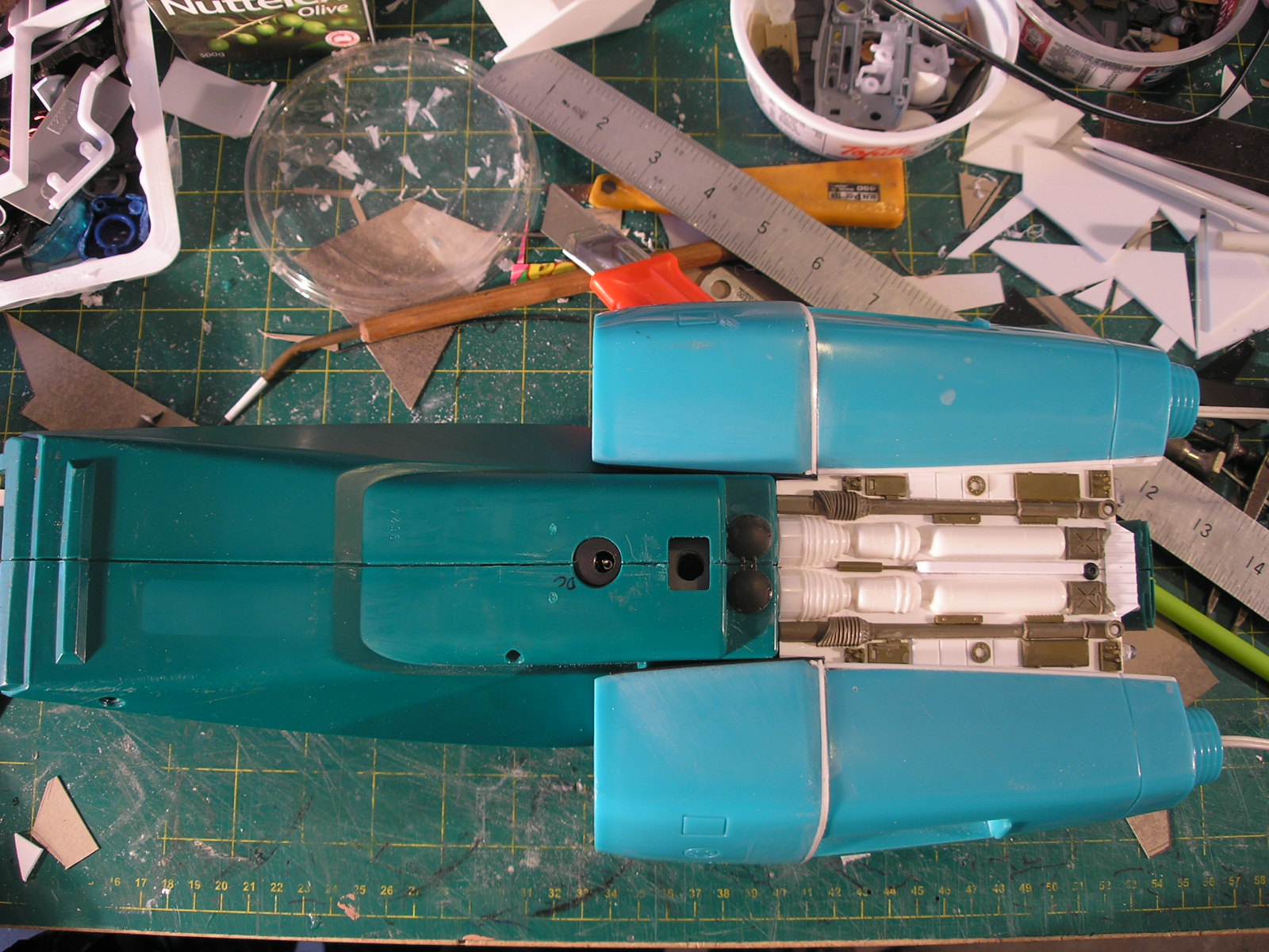

You can see the round bottom DC connector next to the support rod access which uses a rectangular hole that
already existed in the housing.
Below you can make out the rear DC connector on the right hand side. It should be inconspicuous in amongst
the rest of the nurnies.

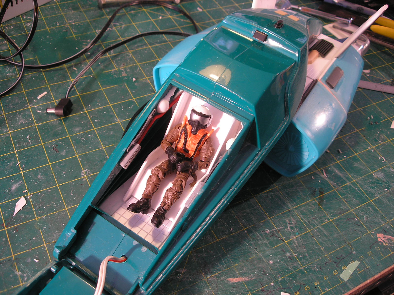

The cockpit has had some minimal details added and a chair constructed.

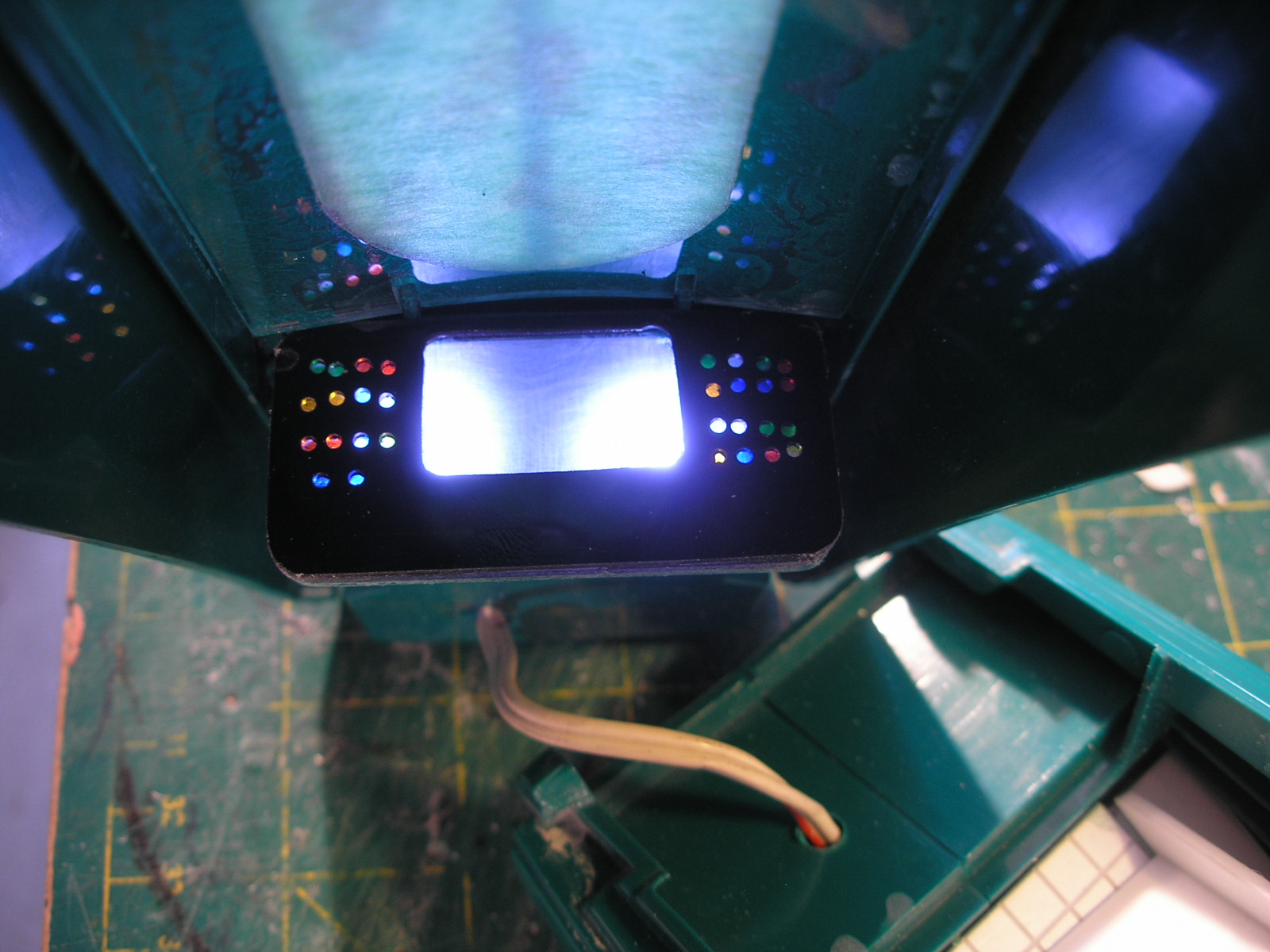

I also made up a dashboard which is lit by two bright white leds shining through some roughly sanded acrylic
sheet to diffuse the light a bit. The leds have a 470 ohm resistor wired in series calculated for the 12 volt supply.
The front surface of the dash has a piece of black 1mm styrene with a screen shape and 1.5mm holes drilled into it
to stand in as switches and indicator lights.
The back of the frosted acrylic has then been painted with varying hues of Tamiya clear colours to give the
multicoloured effect.
Its crude but should be enough when seen through the cockpit window.
The light from the screen lights the pilot.

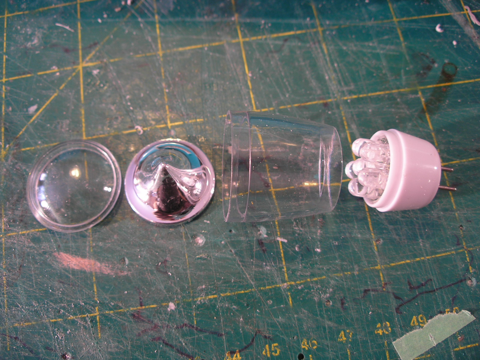

I had a search in my local Bunnings hardware store for something suitable for the engine lights and came across
these 12 volt HPM brand led garden bulbs.
They are designed for multiple fixtures and come apart to be adapted for what ever housing required.
They were perfect for what I needed and come with a suitable bell shaped nozzle, I just removed the end lens and
the internal reflector which just all press fits together.
They also have the standard bi pin connector so I added a couple of the ceramic connectors I have in stock to the
rear of the engines and plugged in the lights.

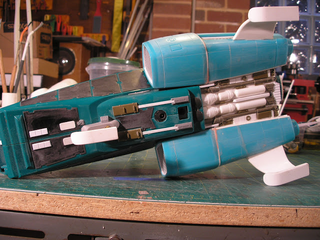

I made up the landing skids and made the front one compress with a spring inside two telescoping brass tubes.
The outer tube has a small slot and the inner tube has a pin press fitted into a hole that slides in the slot and
stops the lower tube from falling out.
The engine intakes have some perforated aluminium screens salvaged from an old ghetto blaster.
They are retained with some evergreen strips glued into the recess.

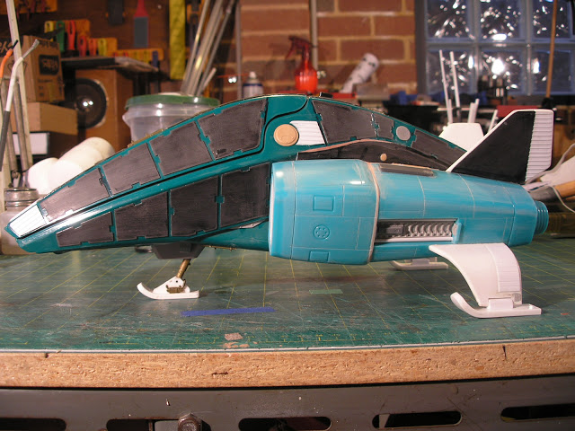

I set about coming up with a paint scheme for the Escape Pod Mk2 the same way I tackled the design of the paint
scheme for the Kitbash Shuttle project, namely taking the side view image of the grey primer model and messing
about in Photoshop overlaying colours till I had something I liked.
The other deciding factor was that I had to make use of the colours I had on hand.
Below is the original grey photo side view I started with and then the two rough versions I came up with.
The two versions are the same colours but with the reciprocal placement.
Because the Shuttle pod was already orange and I liked the mostly blue version best I chose that for the model.
I had a spray can of Blue metallic car paint on hand.
I don't usually like metallic car paints on a model because the metal flake is way over scale but it is what I had to
hand and as it turned out once the weathering took off a bit of the gloss, I think it turned out OK.
The white markings where sprayed on using white primer. The numeral 2 was done by printing out the computer font
onto paper, sticking that paper onto the back of some wide masking tape and carefully cutting along the outline with
a scalpel blade.
The masking tape was then carefully peeled off the cutting mat and transferred to the model.
In the photoshop mock up I had a couple of letters "EP" for Escape Pod but I found they were just too tiny to cut by
hand and peel of the mat without ripping apart, so I abandoned them.
The black lettering on the tail is some more of the old Letraset dry transfer lettering I recently re-discovered in a box
at home and the red pinstripe at the rear is a bit of ancient Letraline found in the same stash.
The weathering was done as per my usual technique described previously.
I also painted up one of the cheap figures I found in Target for the cockpit occupant and added some control panels
and a joystick mounted on the sides of the seat.
