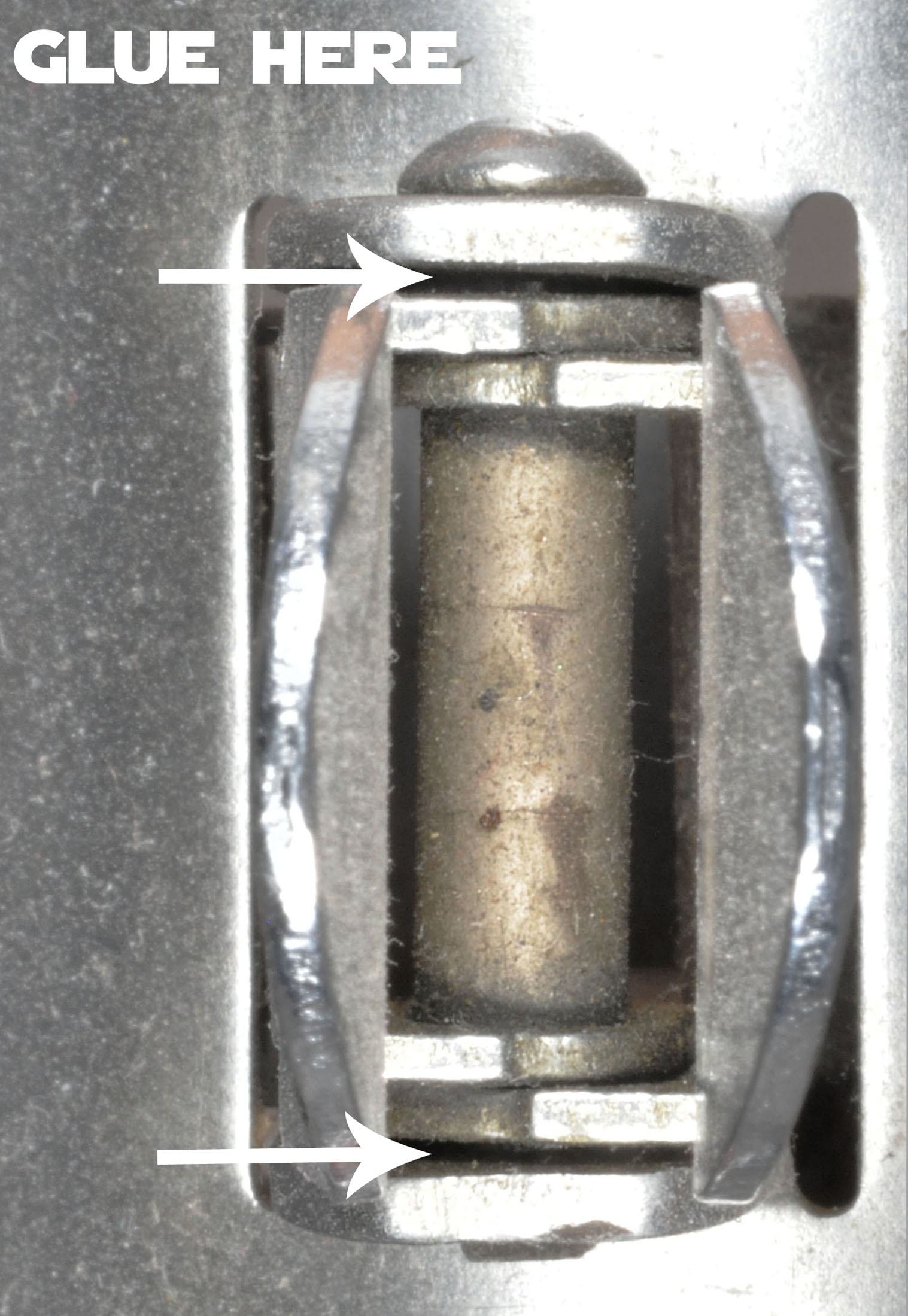

They all move, it's not just yours. On mine I centered the ring and used a few drops off crazy glue and it hasn't moved in 16 years. There are other methods as well but this works fine.

It works great! And the best part is you can't even tell that there's glue holding it. It's clear, and I didn't have to use that much. Thanks man!

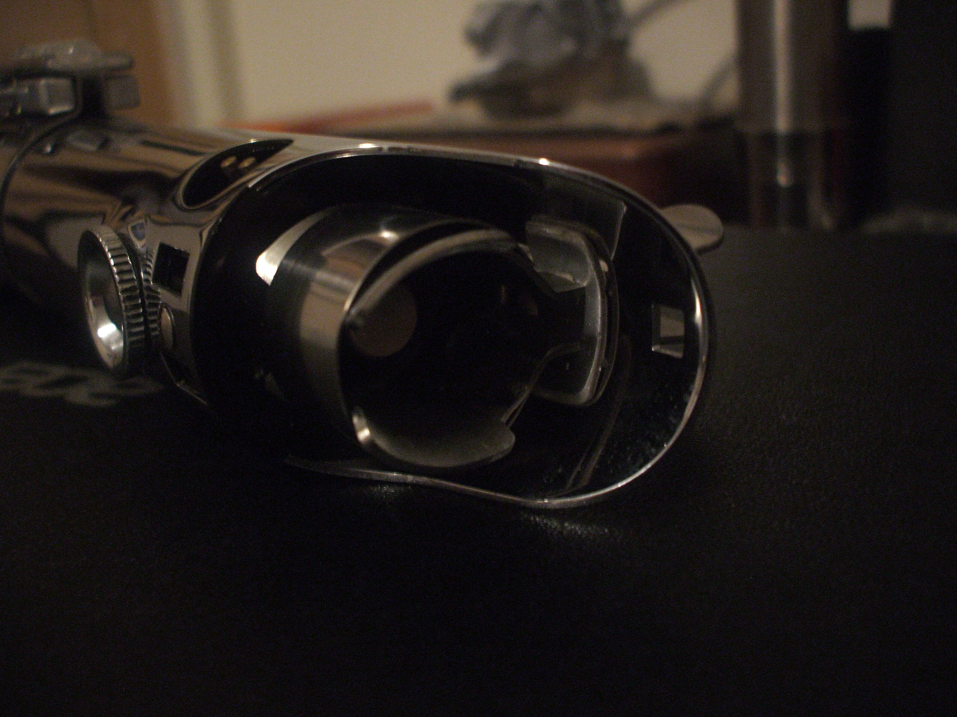

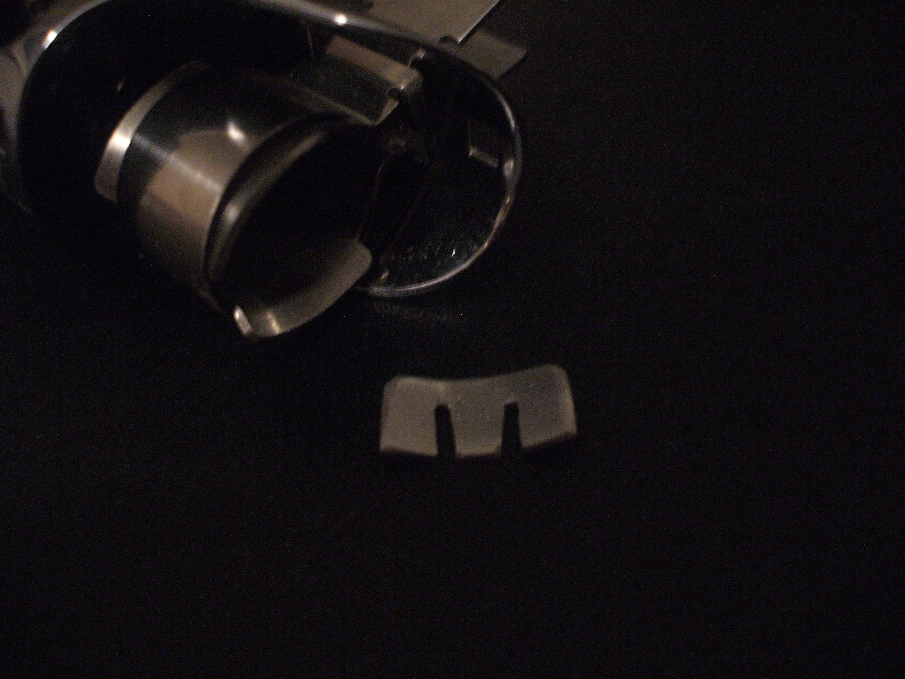

one thing I did was with a hole saw cut a circle piece of 1/8" acrylic and then bored out the center hole so i can fit it inside the bulb clamp. it holds the bunny ears in a perfect spot and doesn't look to bad when looking down the saber

the smallest drop of super glue administered from a pin is how I did mine. Right between the joint. It is easily reversible because super glue is quite weak to shearing (moving the ears side to side). You're already gluing grips etc to it :lol
