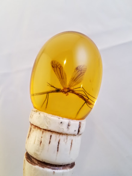

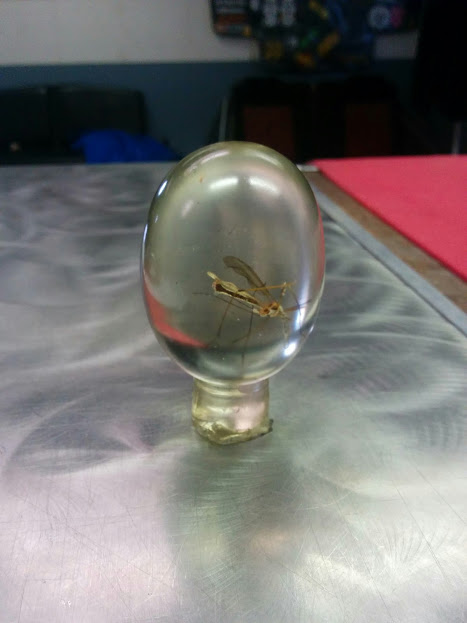

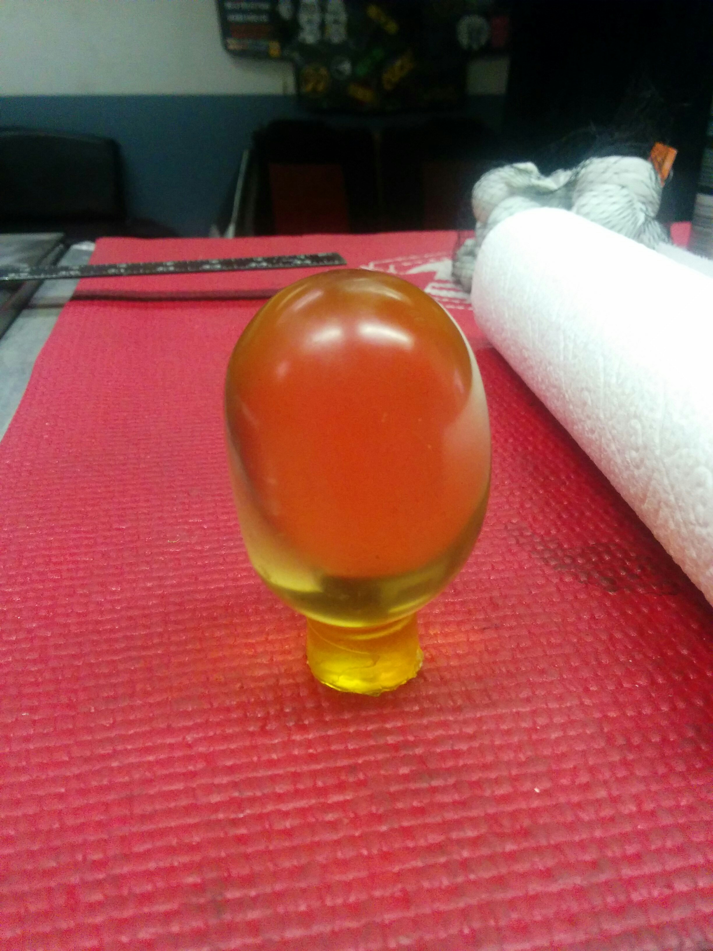

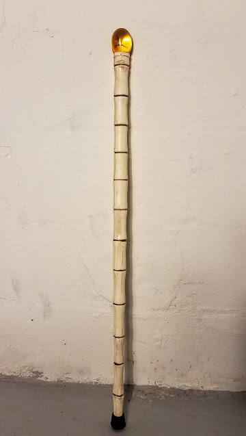

Threads have been merged. If you are reading this for the first time. Over the last few years Ive been obsessing over the John Hammond cane. Constantly tweeking and updating the tiniest of details. In an attempt to make the best replica possible. I started by making shifter knobs, for cars. Which quickly evolved in to making full size canes as well. The shifter knobs are slightly larger than the cane topper. (Mostly for strength and feel) Here are a few pics are of progress from the prototype amber egg shift knob to some finished pieces as of Oct 2017. Feel free to comment and or offer suggestions/critique. Ill do my best to continue to update, as things change or progress ;)

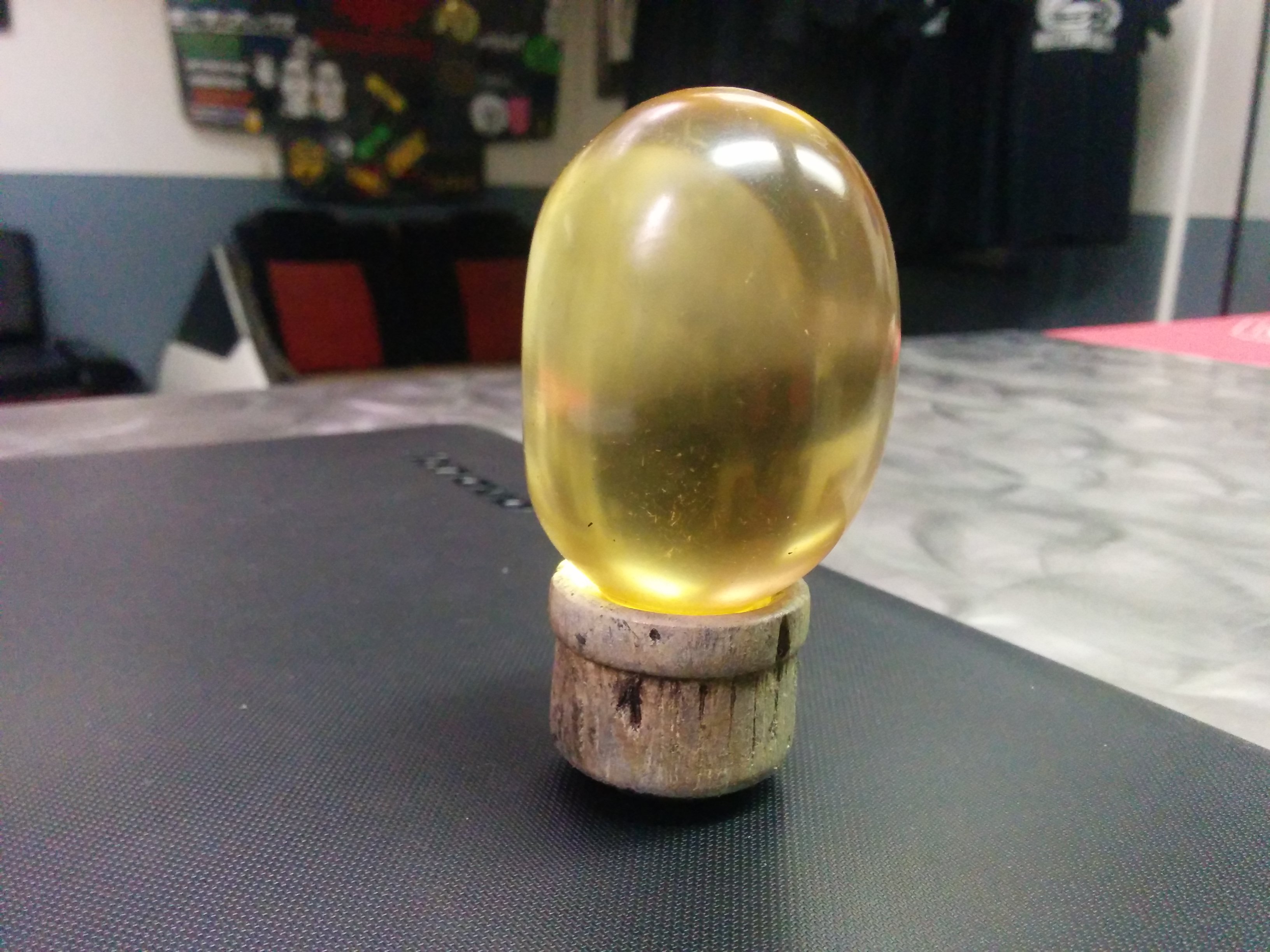

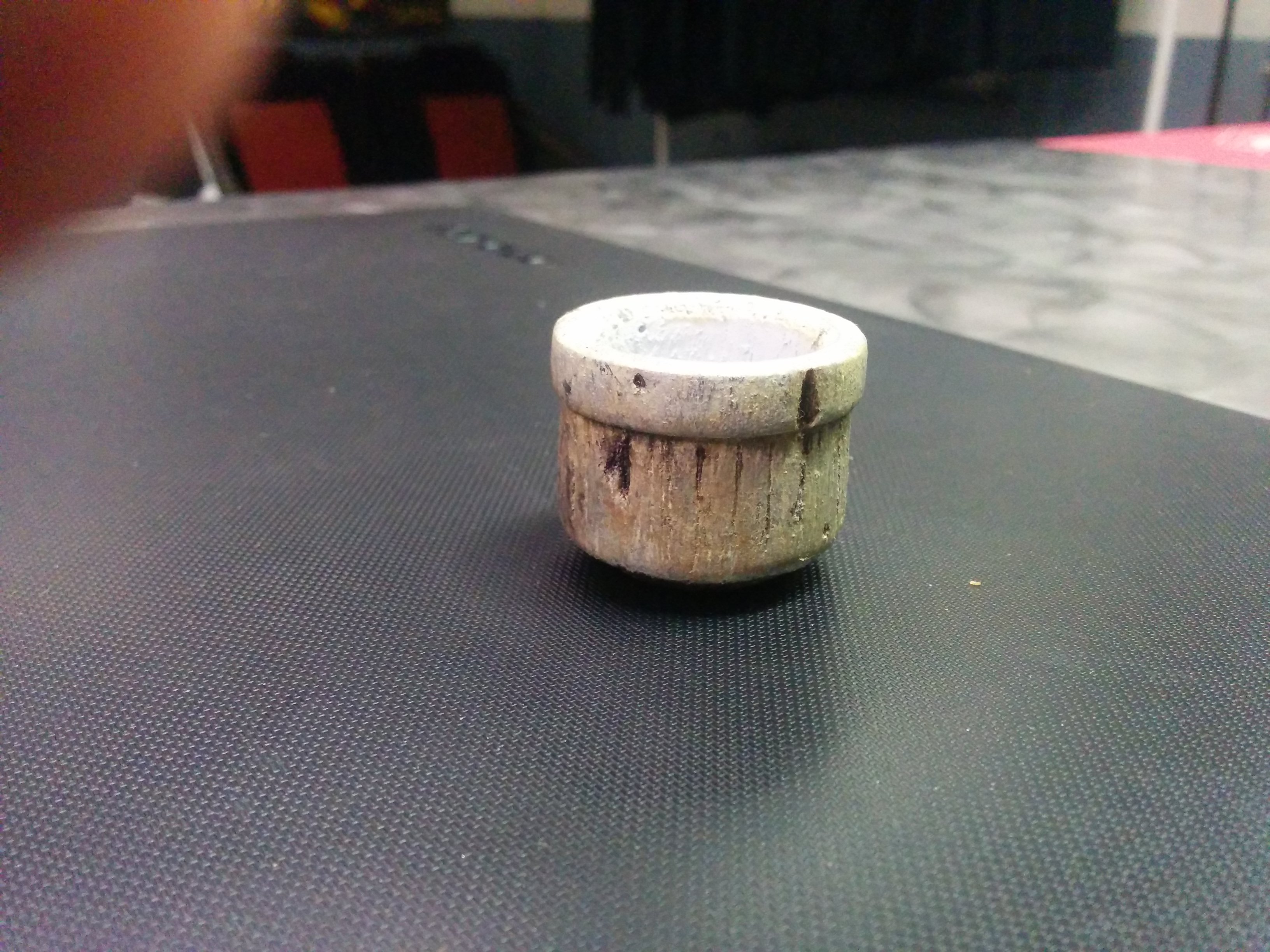

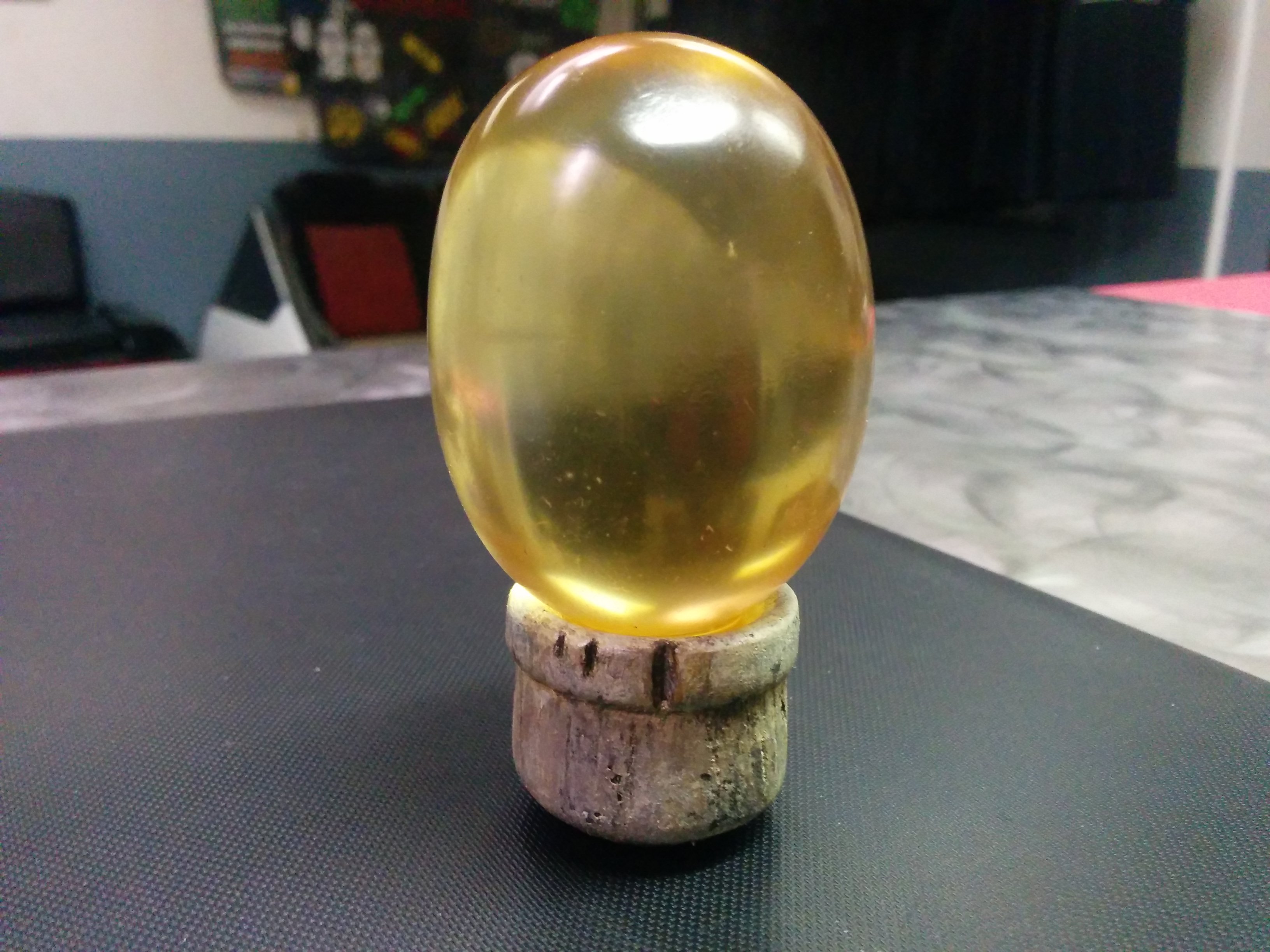

Here's a few more pics of the separate pieces. I made the egg mold as a one piece silicone mold. Its kind of a pain to extract them, but the end result is way worth it. Much less finishing work and no ugly casting lines. I haven't cast the spacer yet its still just painted wood. Hopefully Ill get that done in the next day or 2.
And the Previous knob for compaarison

Yes indeed..Some people have been using them for cane tops as well.. I figure this latest incarnation with the spacer stands on its own so well. Its something that could even be used as a desk or shelf item if some so chose. Once I get more mosquitos Ill probably make one for myself as well.

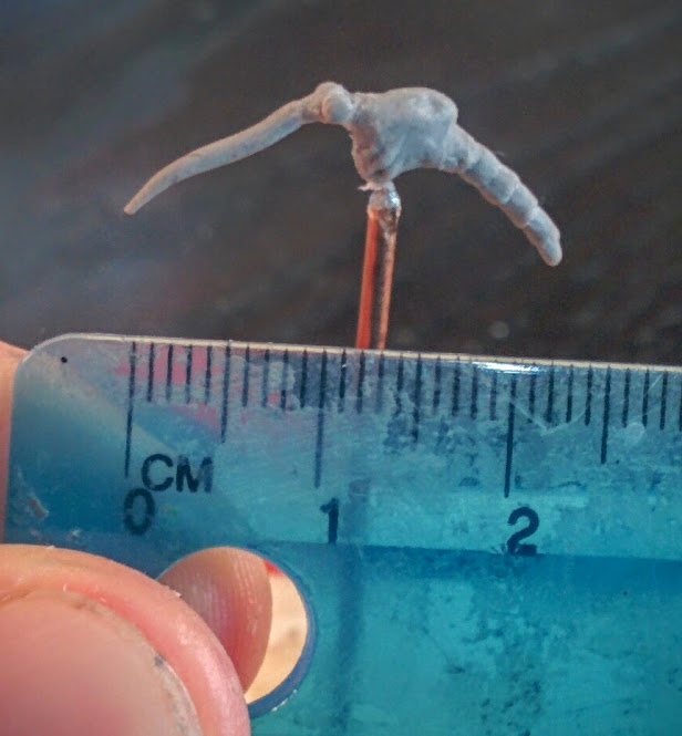

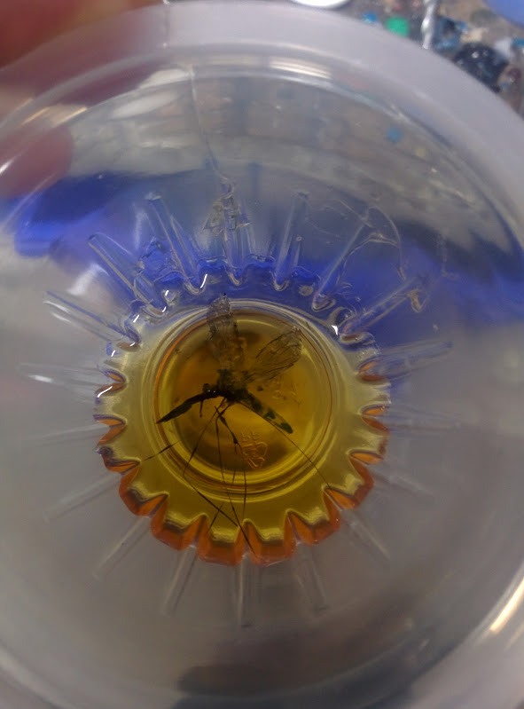

Ive decided Finding and buying mosquito's is not only a supreme pain in the ass. But also not screen accurate. So I took a stab at sculpting my own instead. Still need to make a few tweeks but Im pleased overall. I dropped it in some resin just to see how it will look.

sculpt # 2.. After mulling over the photos I think Im gonna make another one , and add in a few more tweeks and details. But I feel like its starting to look pretty good at this point.

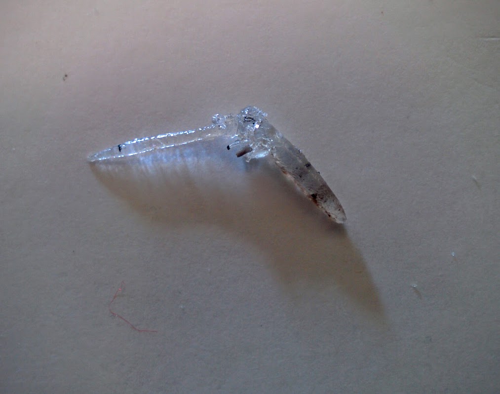

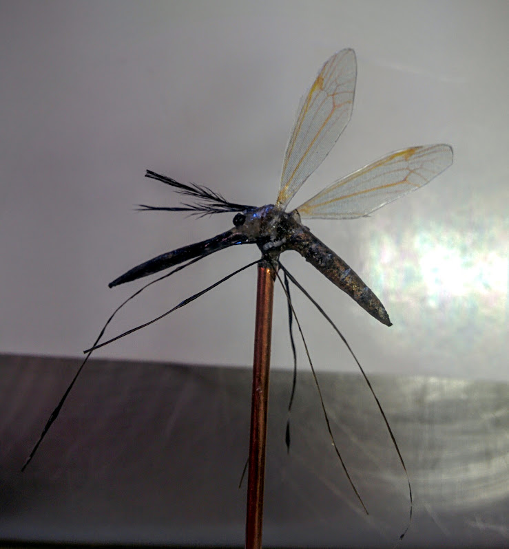

Yeah I sculpted the body from polymer clay, made a mold, and cast it in resin. The wings and legs are melted down plastic and the antennae are a not so secret recipe LOL
I didnt take a pic of this particular body beforehand but heres a snap of another one that didnt quite turn out right.
Heres another pic of the build up painting and adding the legs and antennae
