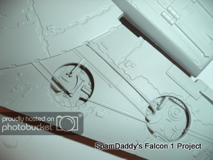

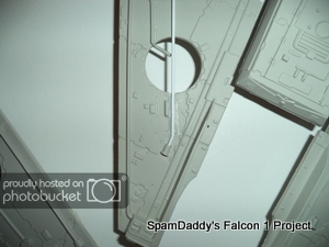

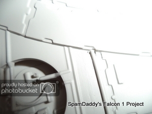

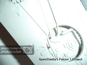

First update in a bit...after getting through the holidays and getting in a few large doses of SW Battlefront for my brand new PS4 (My wife loves meh!!!) I have returned to the task at hand - Falcon 1. I bought some plastruct rods which you will see pictured below to simulate piping but I am finding that they have a tendency to break at a 90 degree angle once stressed to hold shape (the .050 anyway - I haven't tried manipulating the .080 yet).
You can see in the pictures below the areas where the rods gave way and I cobbled together a finished product.

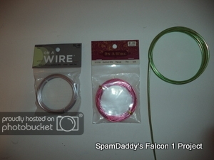

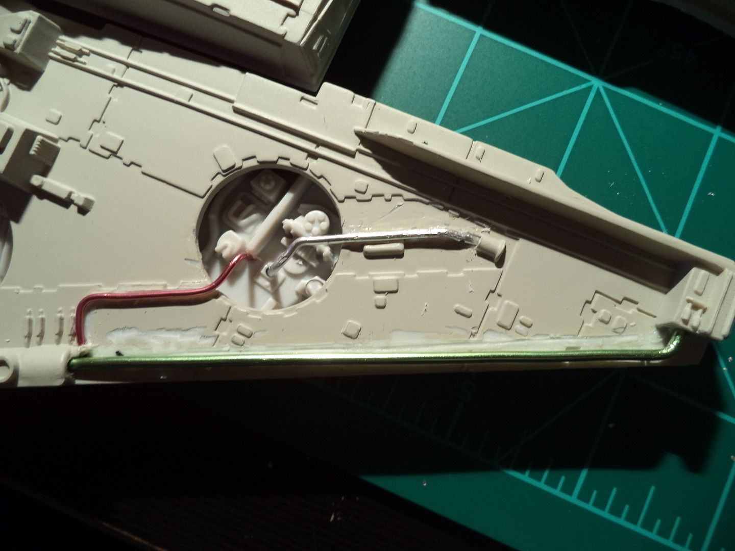

I am using tweezers and I also tried heat but its so touch and go due to the minute size of the plastruct. It easily melts with the least bit of over exposure to heat.
So I found myself taking down our Christmas tree and realized that a bit of wire I had used to fasten a string of lights to the interior of the tree offered the pliability and thickness that I was looking for so I went today to my local "Hobby Lobby" and purchased 3 packs of varying size (pictured below and found in the necklace making isle with all the charms). I have not used it yet but I have taken a length and formed the piping I wanted quite easily. It has a glossy finish so I dusted it up with scratch pads before painting it as a test and wouldn't you know it, it is holding the paint like a champ! I believe this will make simulating pipe MUCH easier than the plastruct and it is 30% cheaper for more product than the plastruct. The only issue there is that there are more plastruct designs and sizes than the wire.
You will also notice the first sample I provide (top 3 photos) is painted using the plastruct and the second example (photo4 in the series above) is unpainted yet the hull of the Falcon is still the same color. That color is "Model Master Custom Spray Enamel Flat Gull Grey 1930" (pictured below). This is my base coat.
I am looking for all criticism, ideas, and input on the above.

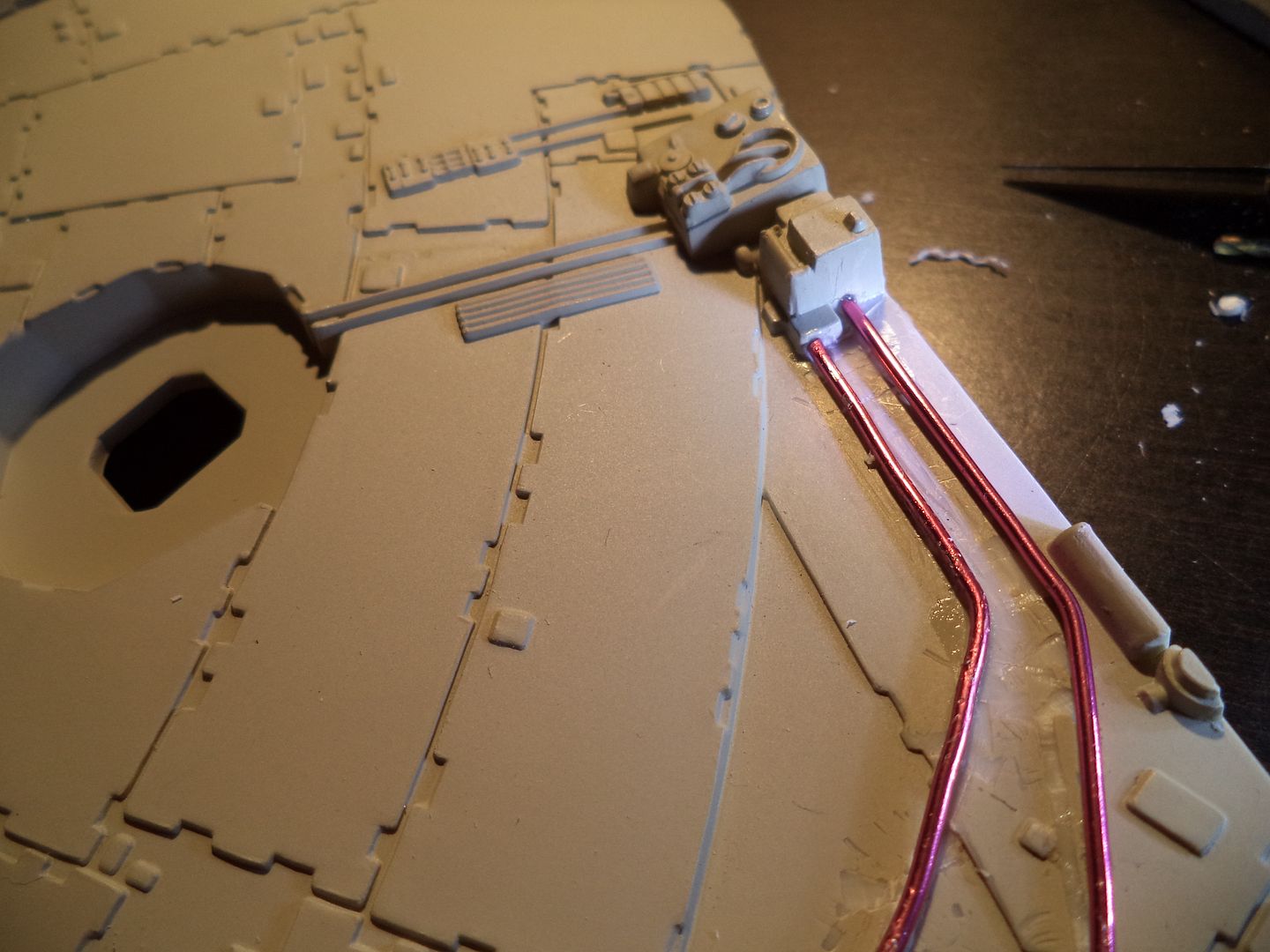

I think the hobby wire is a great idea, its pliable but can hold its form when static, I'll be using the same material on my own!
I've been using various widths of copper rod on my Falcon, it's a little more expensive but it's totally worth it for the pliability and clean finish, 0.5mm, 0.75mm, 1mm and 1.5mm widths cover pretty much all piping across the Falcon....they look especially good when you've got different widths next to each other, somehow makes it look more real
You are 100% correct, HH! I love the look of the wire piping. I know my quality of work is nowhere near most here but below is how things are shaping up so far. I am not repiping the entirety of Falcon1 just selecting certain areas to try and liven the kit up. You reworked the rear parts of the engine deck on the top side as pictured below - what did you use? I can't find anything that I could use to simulate the look...
This is the repiping so far:
Not a masterwork but I am learning AND having fun. I proudly displayed the before and after pictures with the actual product and her "discerning" eye detected nothing. She said, "What am I looking at or for?"
