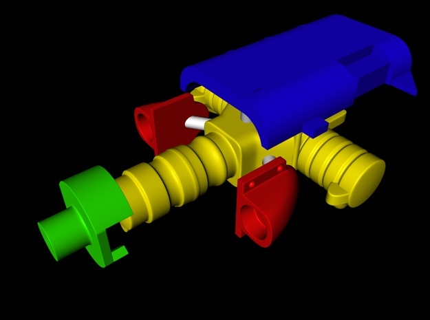

If you got these parts...then yes, you have the KGV parts (blue & green parts)
https://www.shapeways.com/product/94RMWKJ6Z/deago-greeble-set-1?optionId=61576116
I got these in from shapeways the other day. Very nicely done.
A word of caution when handling the FUD parts, the material is REALLY brittle. It fell out of my hand onto a kitchen worktop from maybe 6 inches and broke apart in all directions. Luckily i found the pieces. It was the sprues holding each part that had failed not the parts.
Kit 20053 has all the parts needed though if you are going to do the fronts of the mandibles I think you will need more than one kit. I know what you mean about kit numbers I got burned on the Tamiya Agano.As for shapeways parts I totally agree, they are way to brittle I'm left wondering if they will degrade over time. I bought the entire cockpit & nose cone but after so many little details broke off I've decided not to use them instead opting to go down the Paragrafix route.

About the KGV parts, do you have a close up how they been attached ?
Thanks, Kuat.
There are some close up shots of where they used to be, its pretty easy to work out where they were attached from the glue and difference in colour.
Kuat- when I put mine on I found that the large rectangle piece hangs off the bottom of the mandible a bit, all the pics are pretty blurry of the original area before they broke off, so I'm not sure if the piece originally hung off the bottom or not. I trimmed mine so it fit, but wondering if I should have let it hang over the bottom edge now, I also removed the little triangle piece from the bottom of the part, which I feel I don't see in the original models ref pics. I can post a pic later tonight to show you what I mean if it's unclear.

Kuat- Here is how I ended up applying the parts to the DeAgo sidewalls, after looking more at the DeAgo parts I see now that they are just a bit too low on the sidewalls and a little off in the shapes which is why this piece doesn't fit correctly. I'm going to replace most of the sidewall parts so I should be able to get more accurate spacing as I rebuild the pieces.
Here is an example of how they could go on as is, or the piece could not be trimmed to fit and just hang off the bottom as well..but it looks like that part fit flush with the bottom of the original prop so may not want to do that.. hope it helps some..
