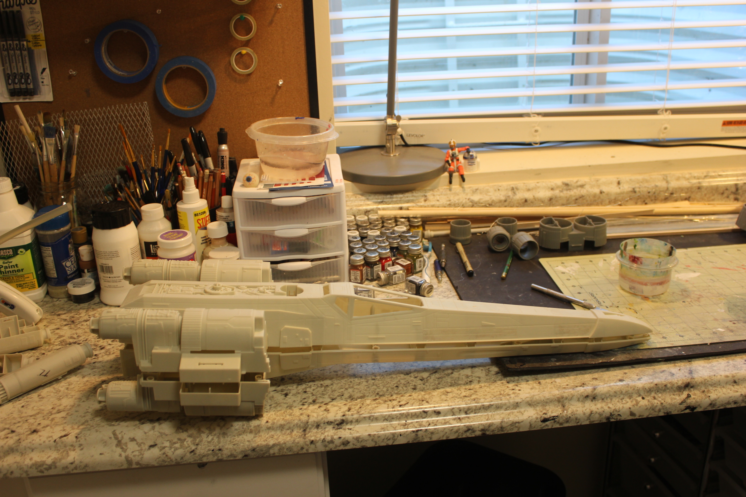

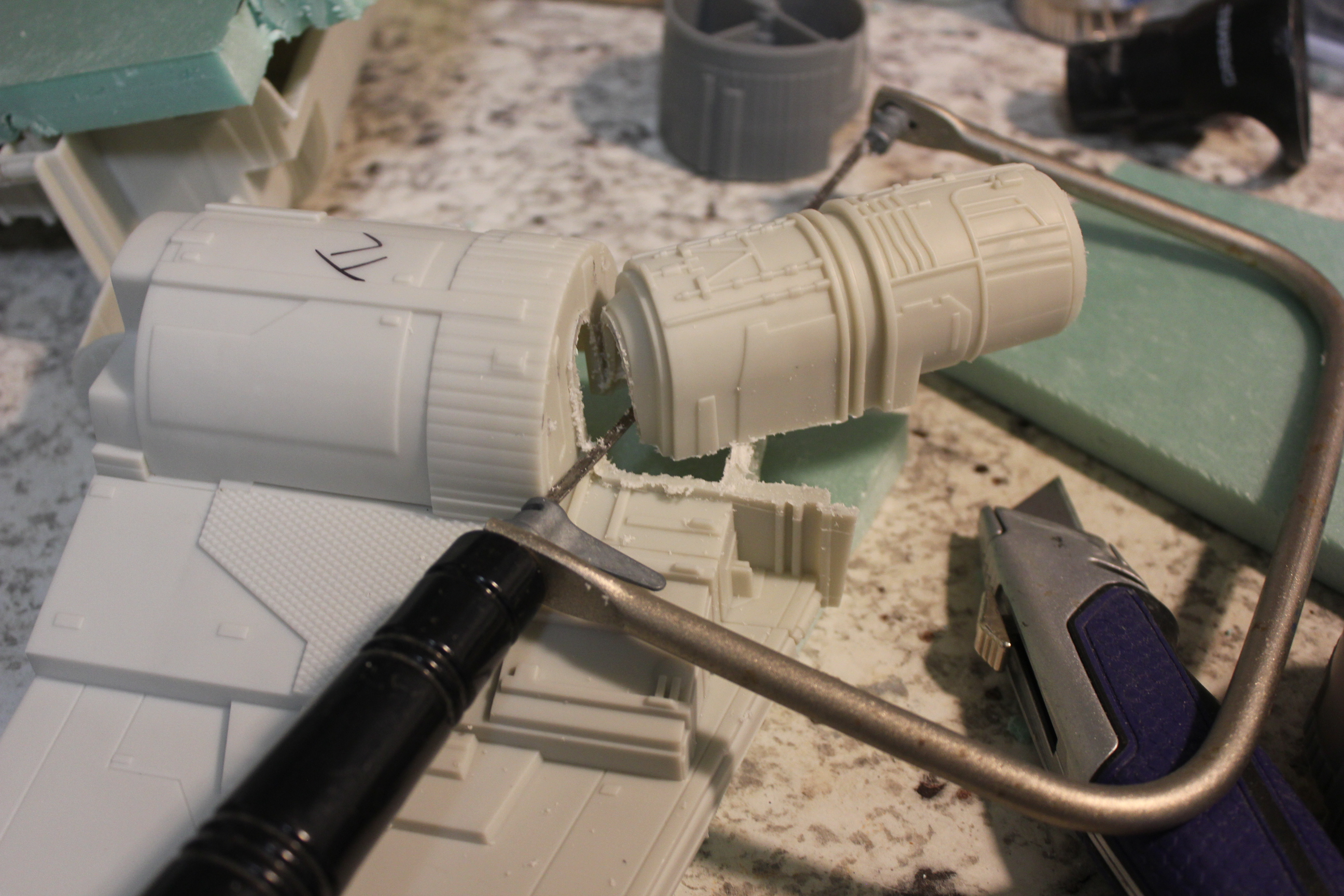

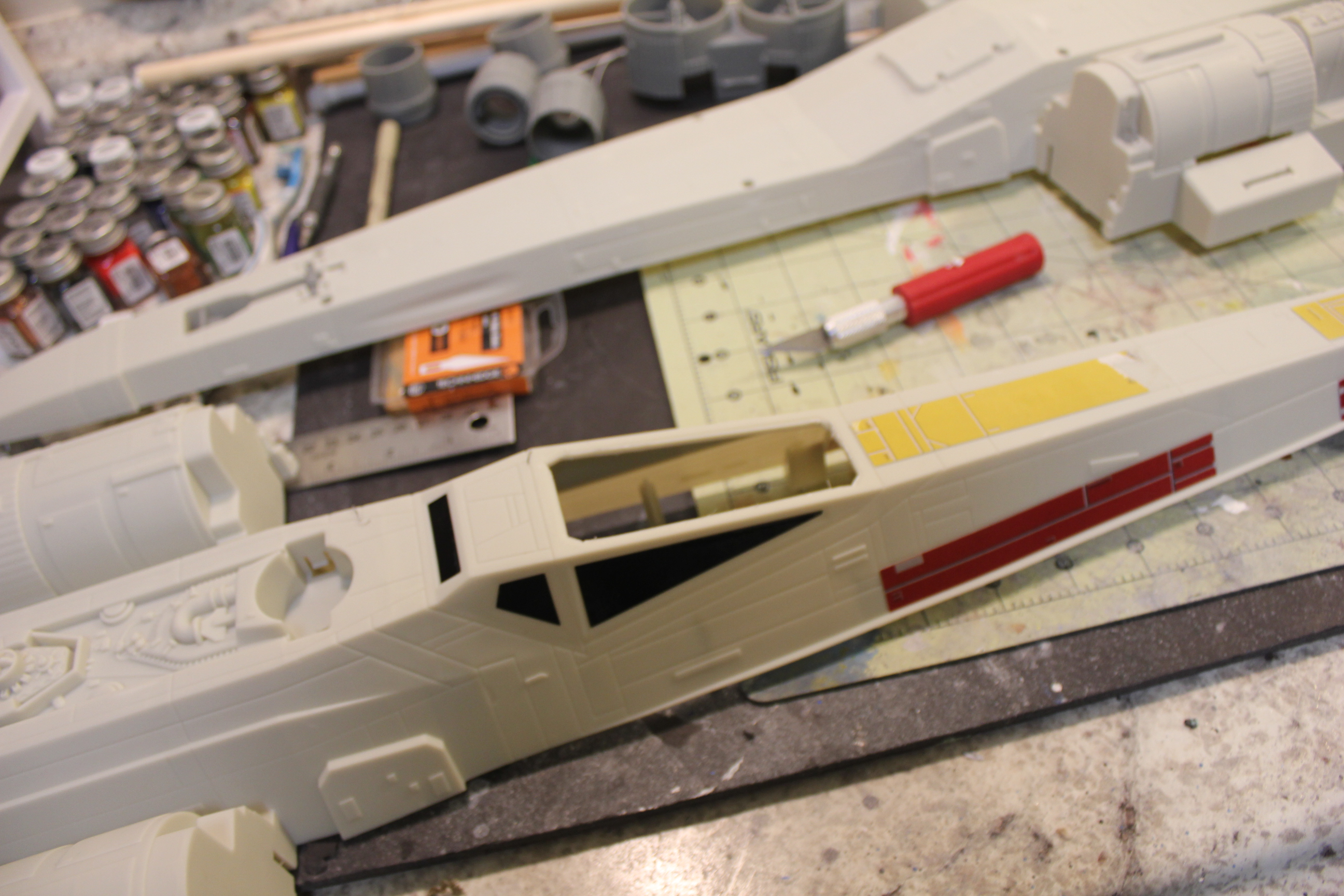

The fun part: cutting it into pieces

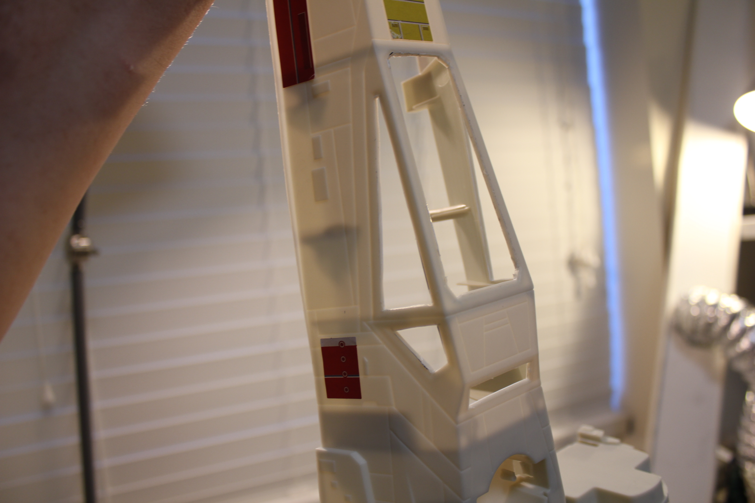

I couldn't resist the urge for immediate gratification by cutting out the windows
Also, the stickers are just horrible. A little sand paper first, then water, then goof off did the trick to get it cleaned up
My initial intentions were to have this completed in about 2 weeks.
So I kinda jumped in with both feet and started rolling....
Hot glue works great with this crappy plastic...as long as you keep it hidden. I wouldn't suggest using it on any finished joints

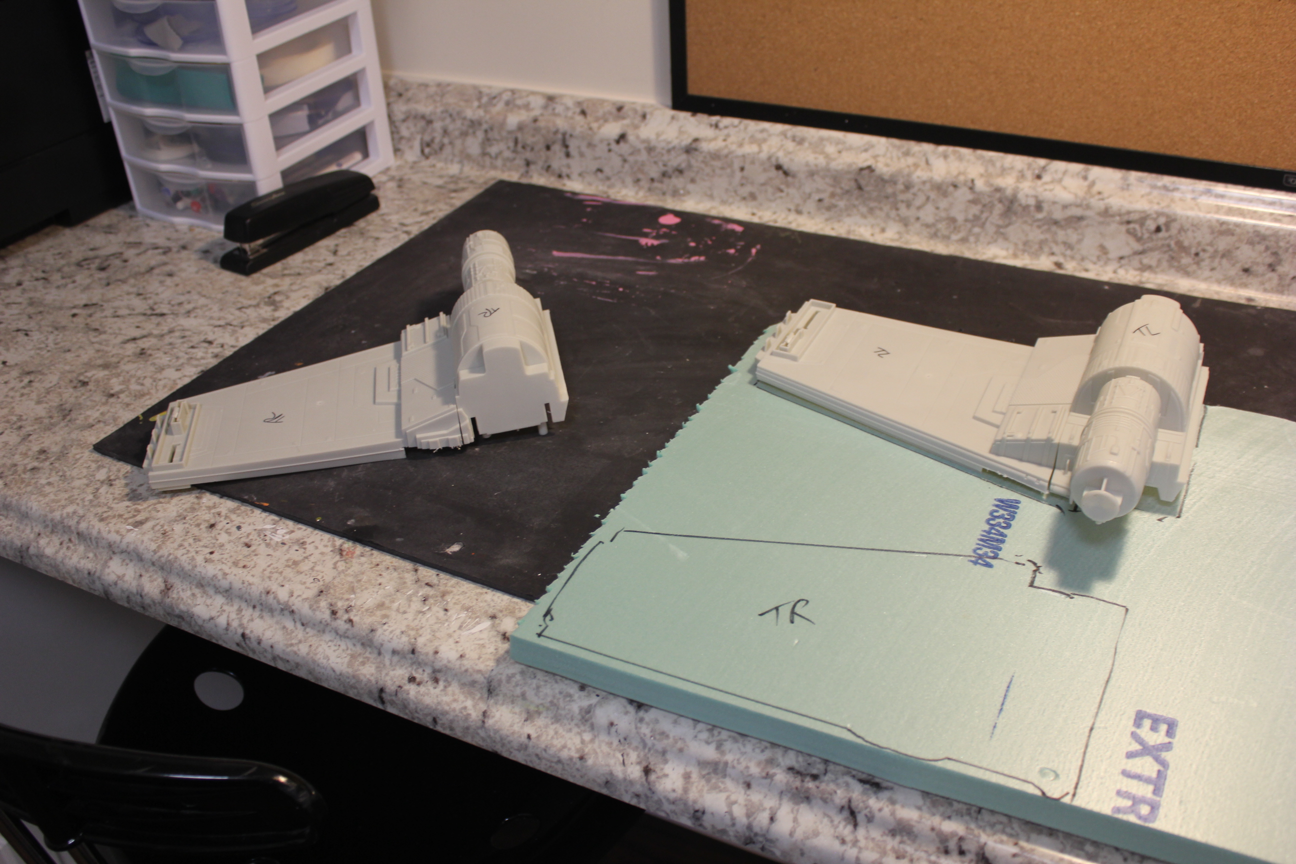

Foam boarded the underside of the wings
Later, I can cut out the areas to install the engine details pretty easily.
The other great thing about foam...it's super light. So if you plan on hanging from the ceiling, you won't have reinforce your joists...

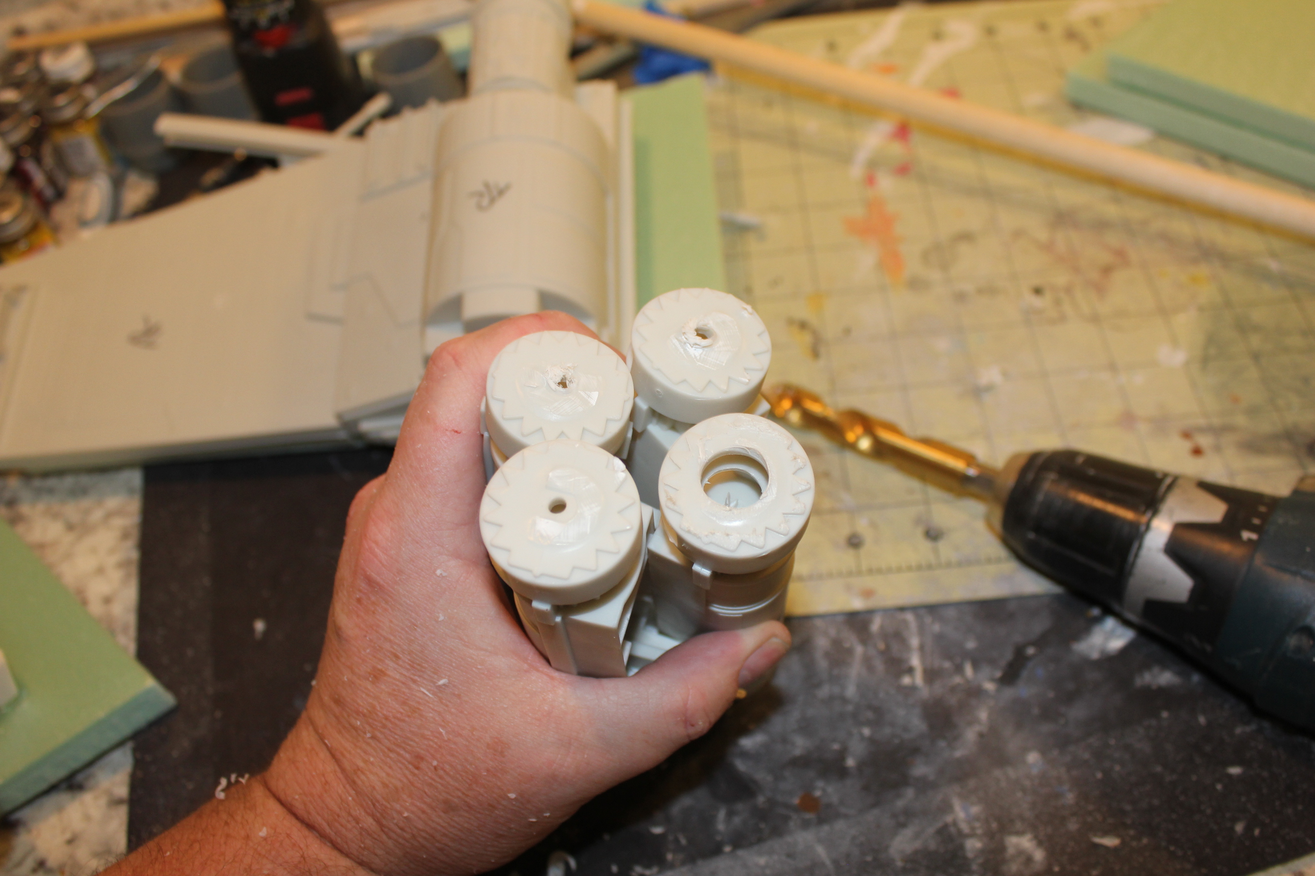

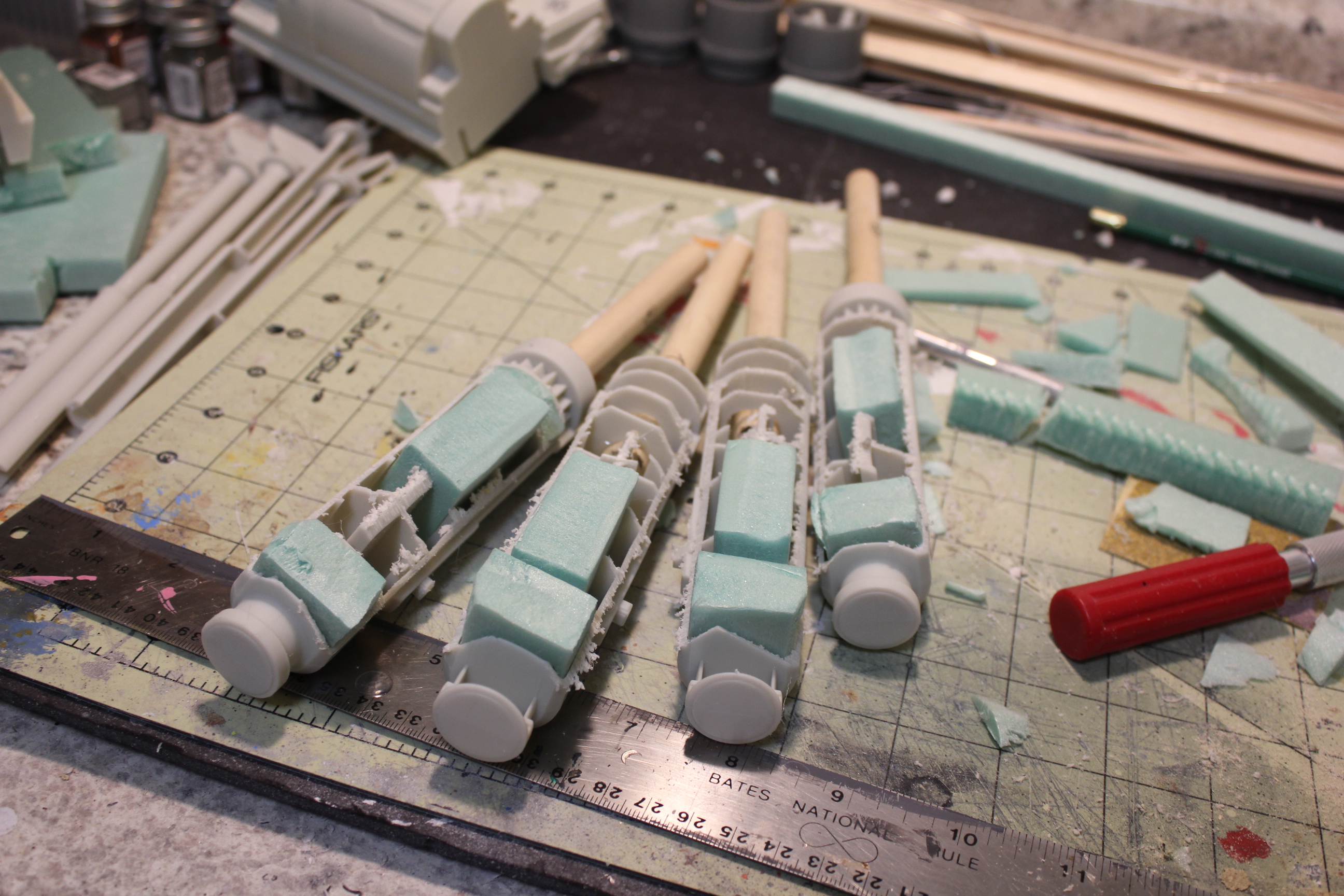

cut off the plastic tabs and drilled holes for future LED lighting

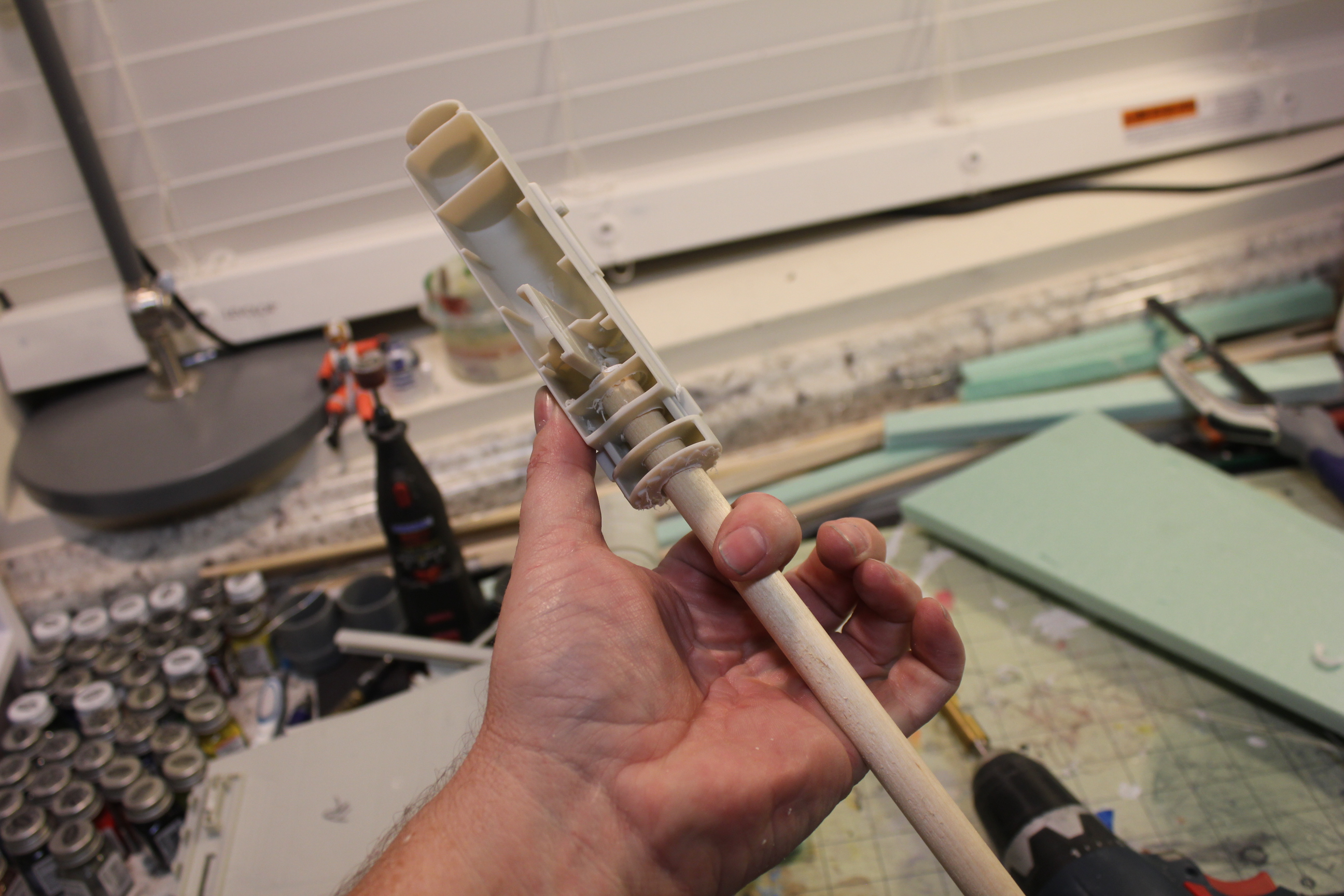

Jumped over to the cannons and drilled through....
....using simple wooden dowels
Hot glued inside for max stability

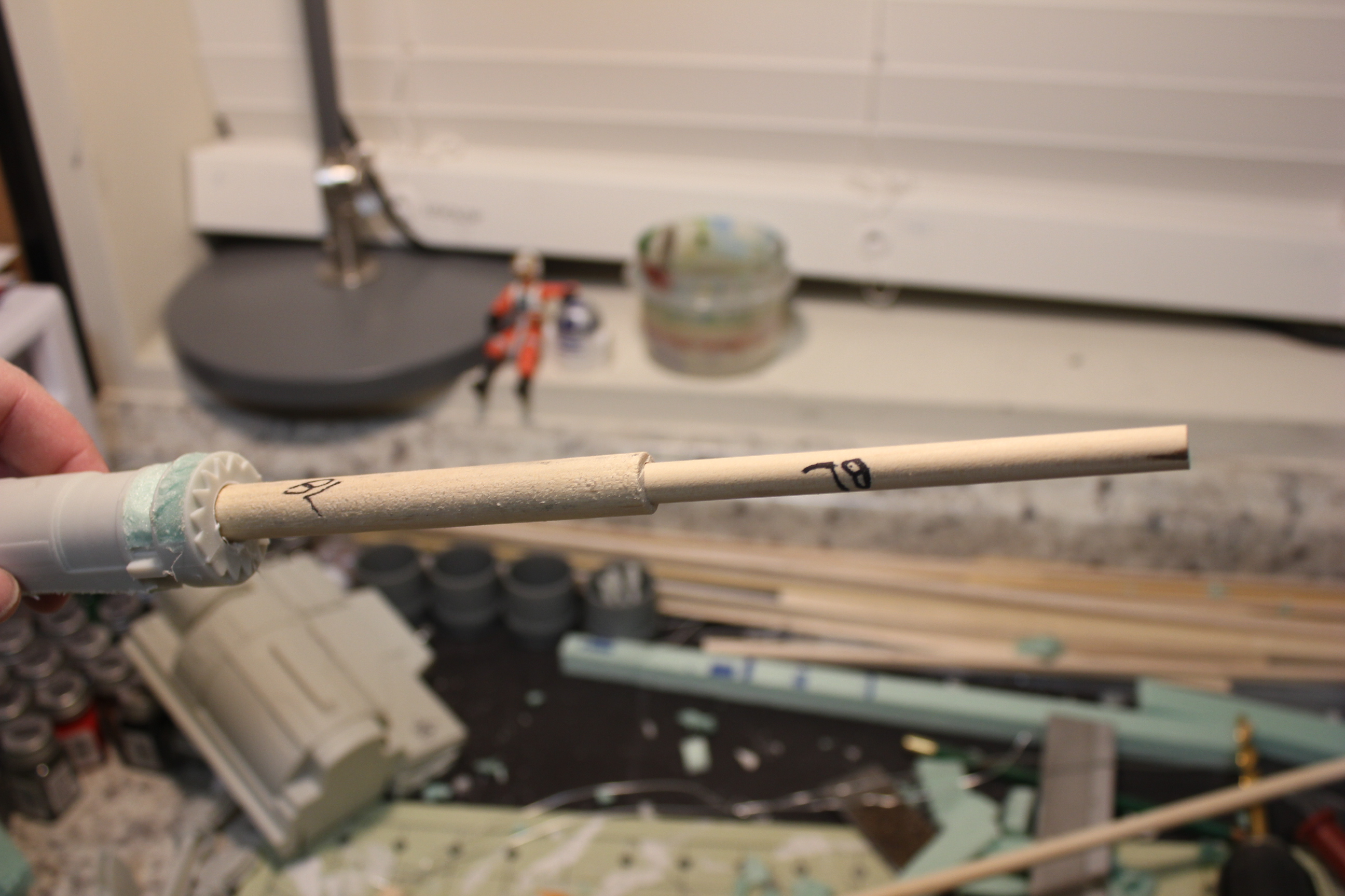

Sizing seemed pretty good so I matched the lengths

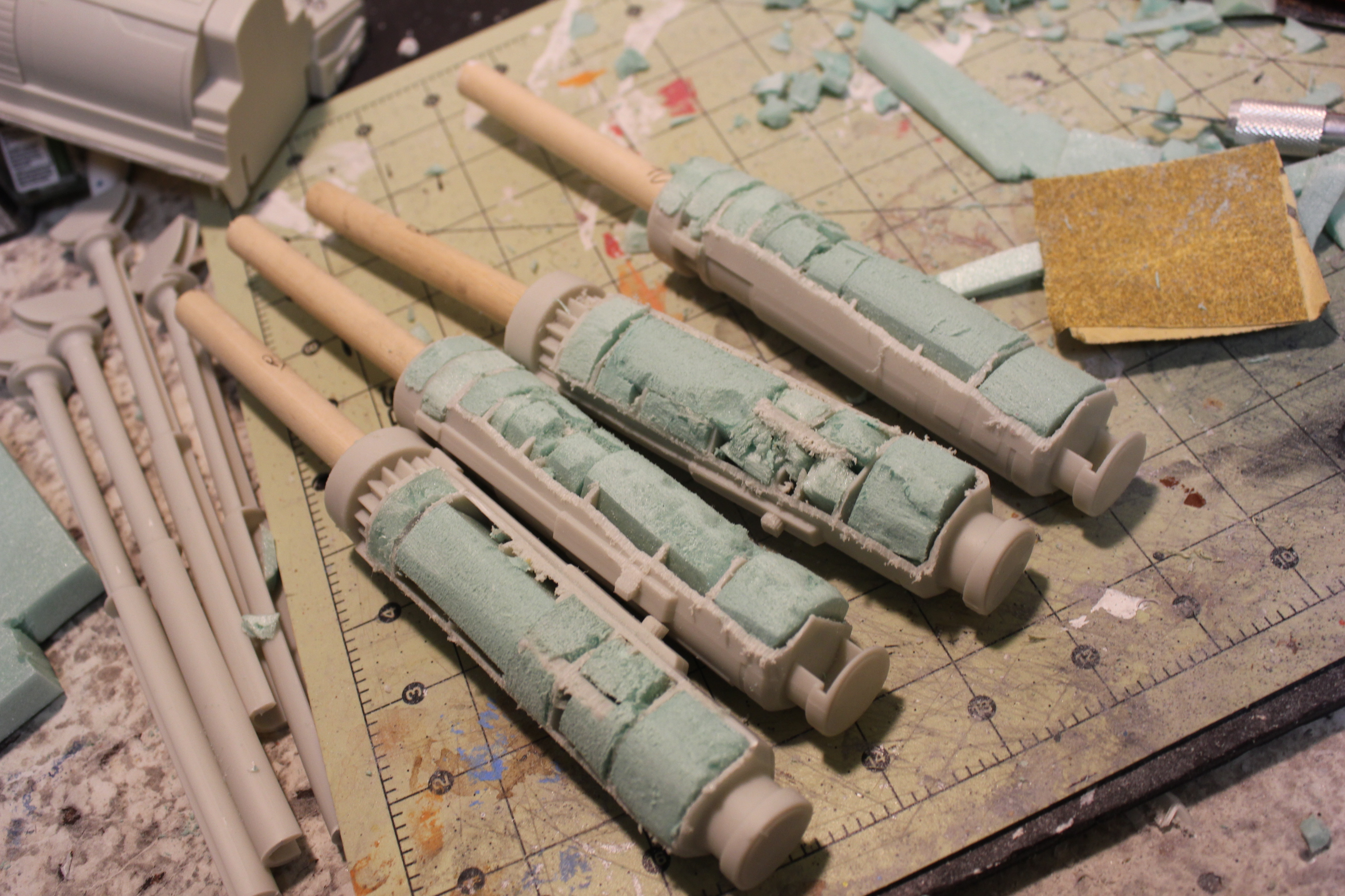

Now for the hard part...making them round after the butcher job of cutting them off the wings
I decided to fill it with foam, fill and sand.
We'll see if that is acceptable. if not, I just rebuild from scratch.

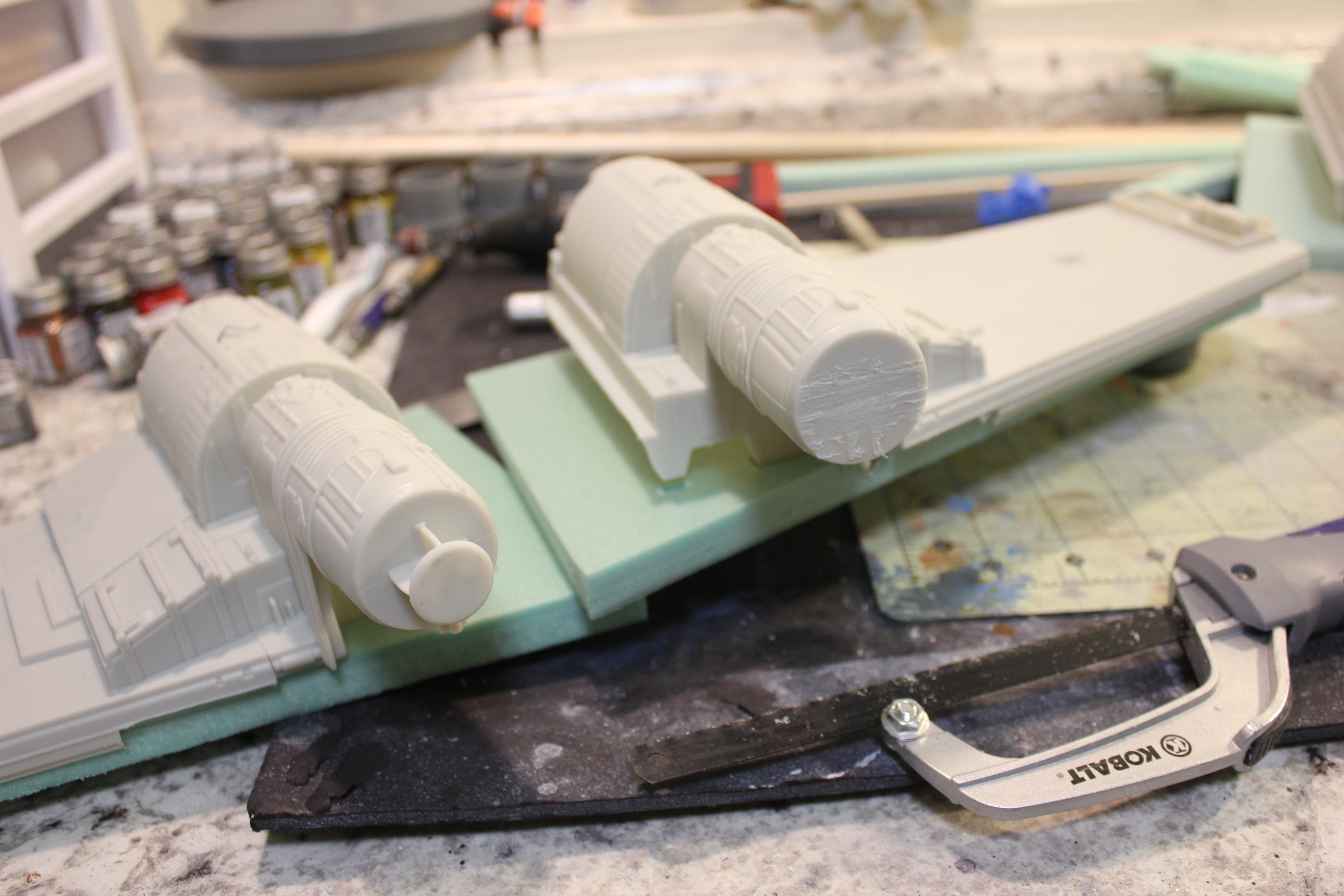

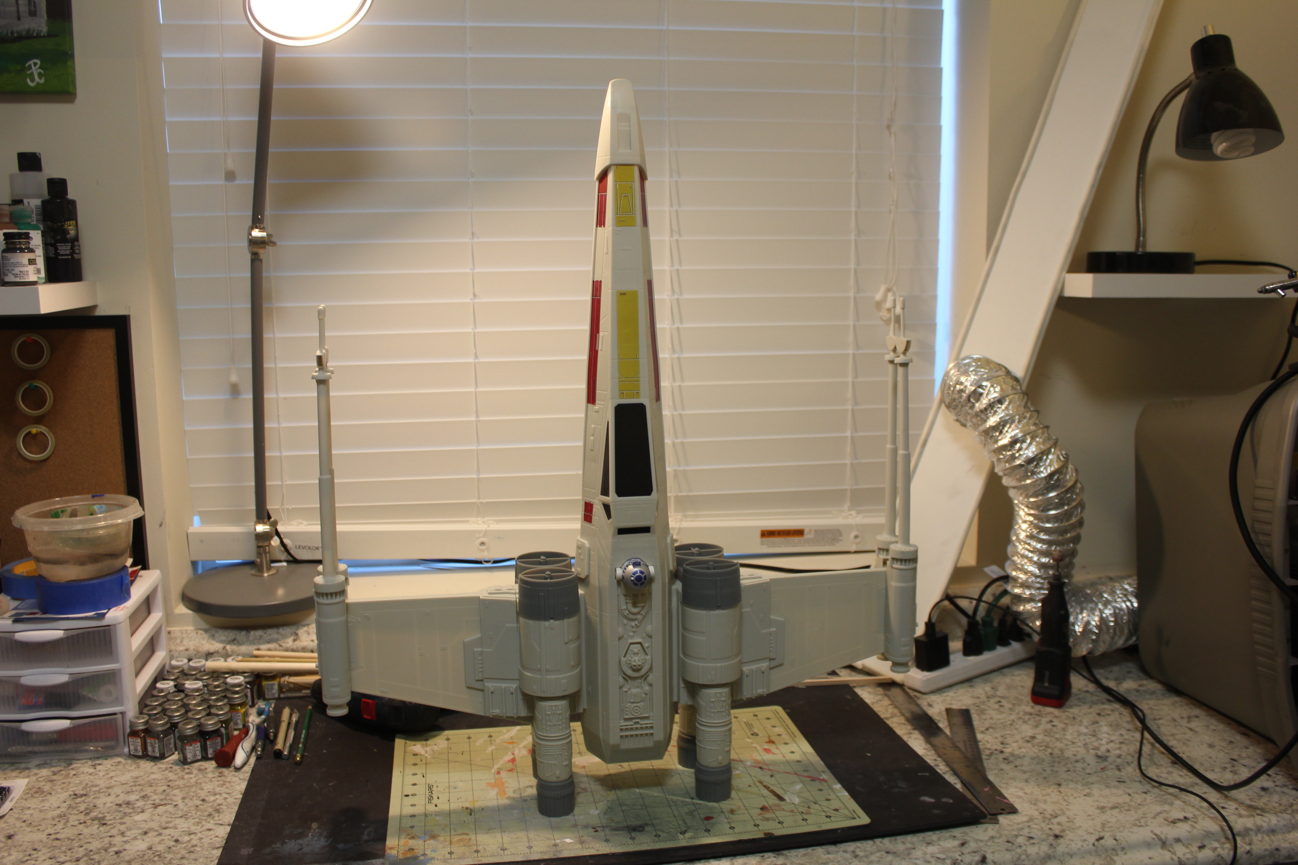

and beat goes on....
so I filled the cavities with foam but until it works out, I may just rebuild the whole thing from scratch...we'll see

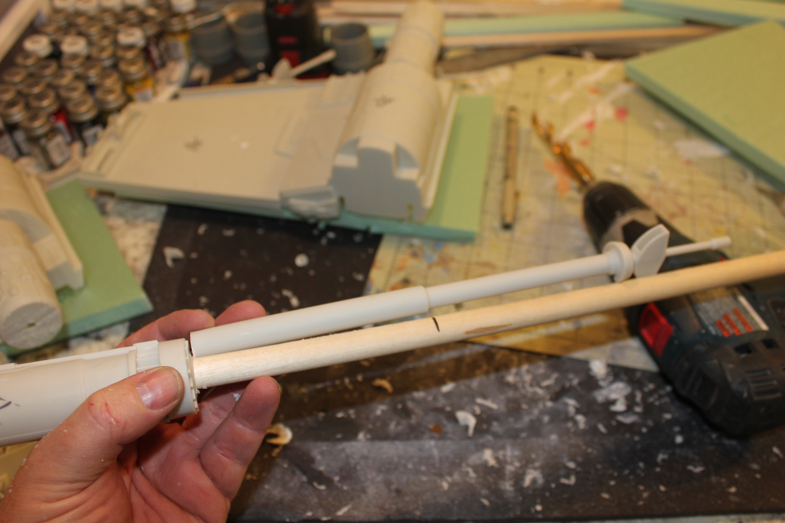

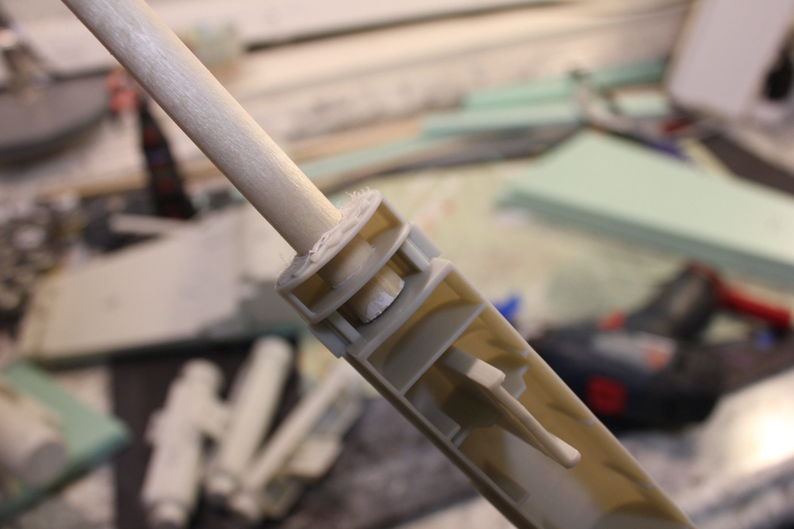

again, using wooden dowels...I may switch to poly
balsa wood

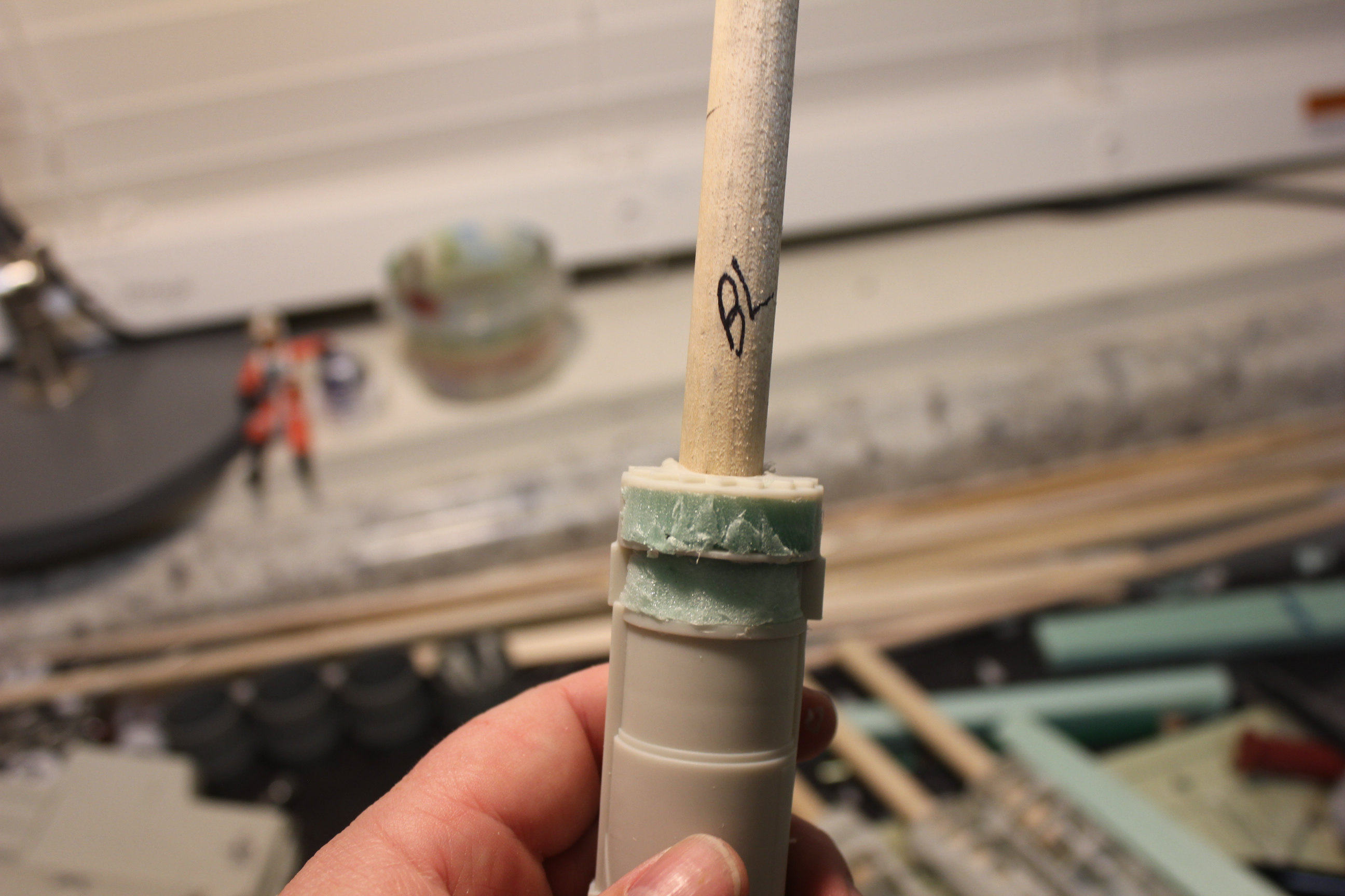

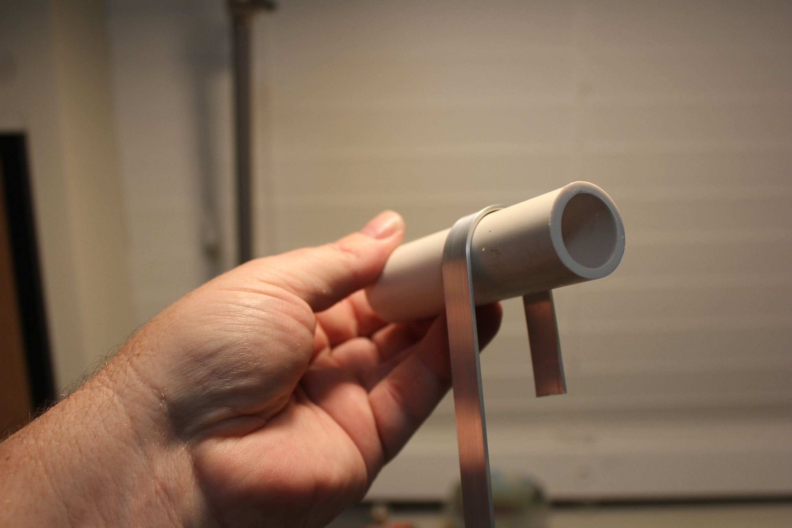

happened to see some aluminum strips at the hardware store....thought they might work out
need to clean them up a little and smooth the cuts

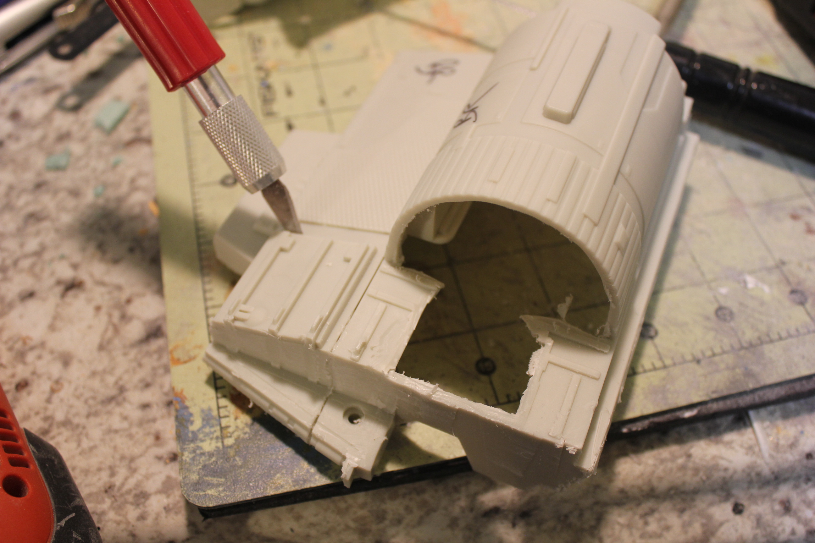

as I looked at the studio scale model, it was obvious this engine detail had to be completely redone
I thought I could get away with just cutting off the jets....
but the detail here so far off from the real thing I almost want to rebuild all of it from scratch

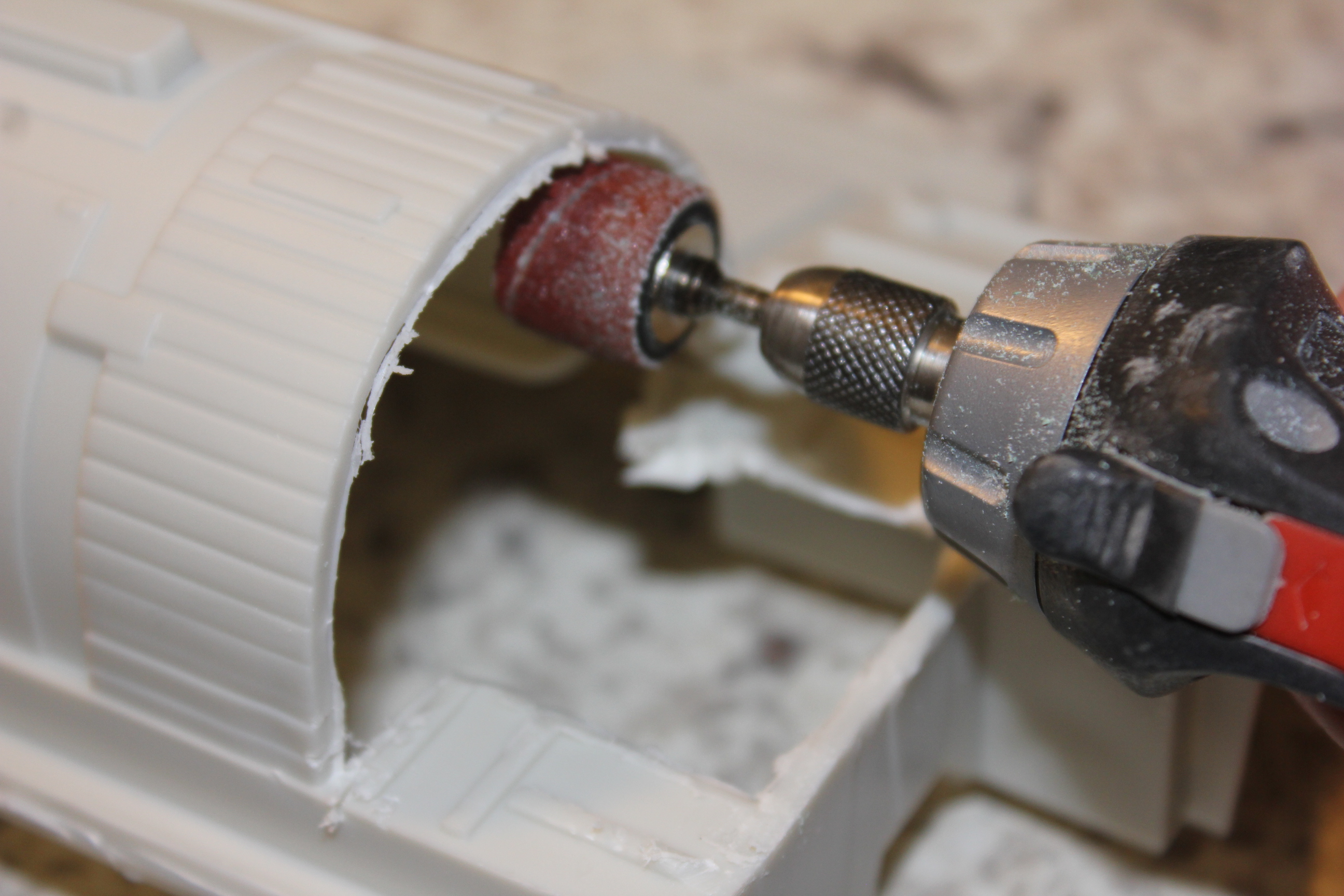

removing the vertical divide
sanded as best I could... it's tough to get in there !
cutting and smoothing edges
I'm really thinking about a complete rebuild in this area.
