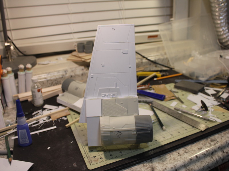

Re: Pcoz's Hasbro Hero Star Wars X-Wing Conversion
oh yeah, almost forgot....the mess as it sits now.
I had to do a loose assembly to get some feeling of progress and inspiration. Sometimes you work on such small areas for long periods of time and you feel like you're getting nowhere. There may indeed be a light at the end of this tunnel...
ANY and ALL suggestions are welcome !
Pcoz

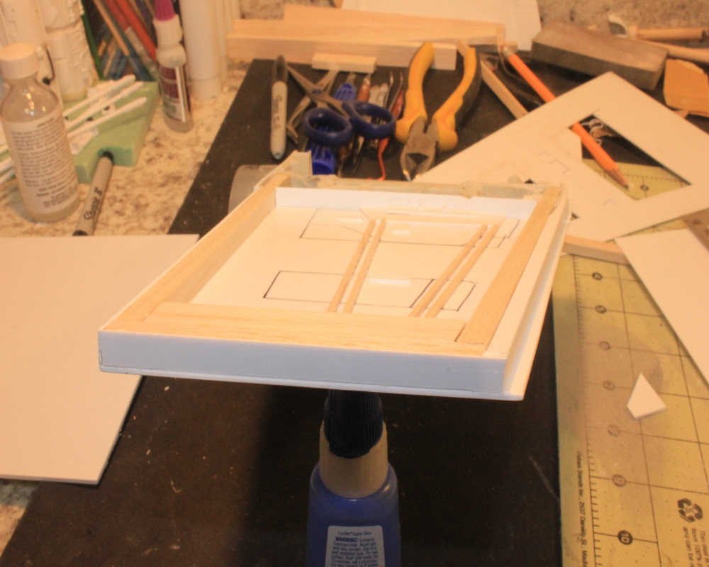

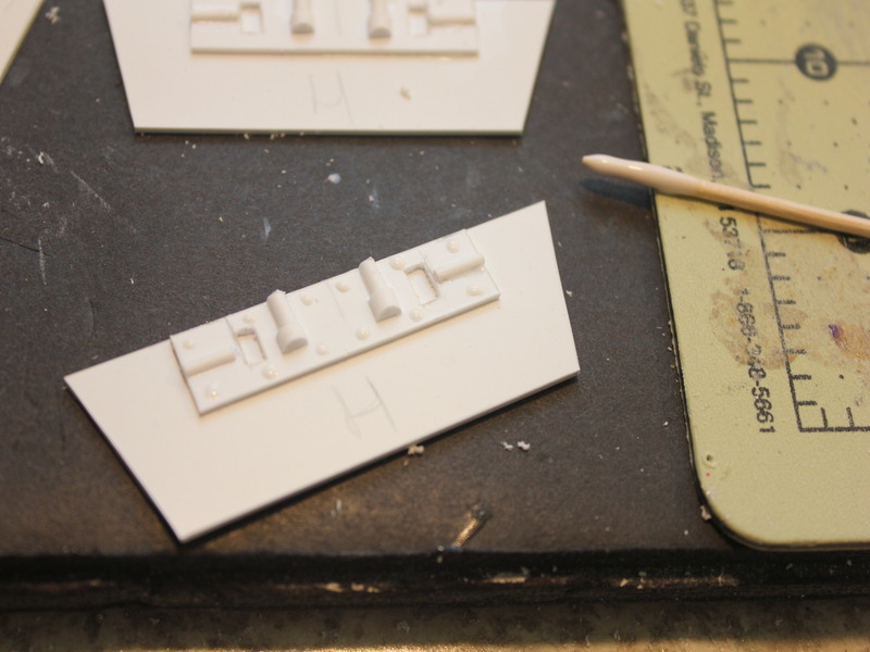

A wing and a prayer !
ok, here's a quick update:
found some strange leather buttons intended for leather or something in the craft store....works out to be the size I needed
hole drilled and glued

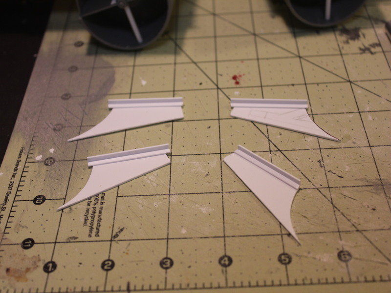

Replaced the balsa wings with styrene
and then started on the trim and replacing the ones made of balsa

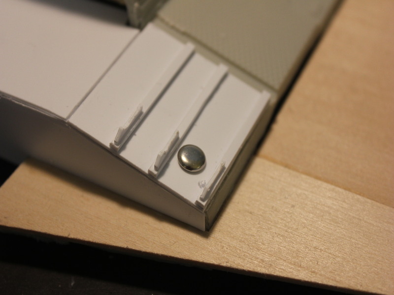

Used the Mod Podge Hard Coat dipped with a toothpick and tapped on to create a rivet...so far so good, and easy !

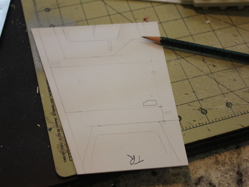

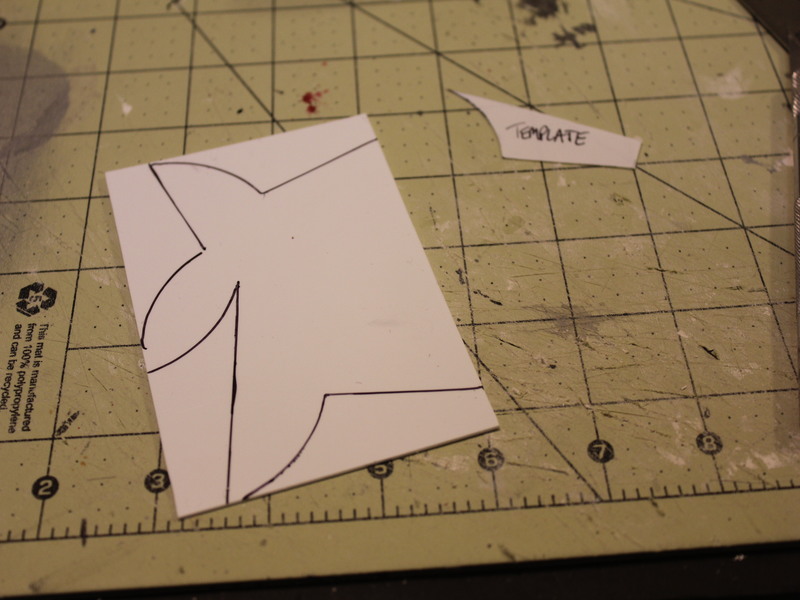

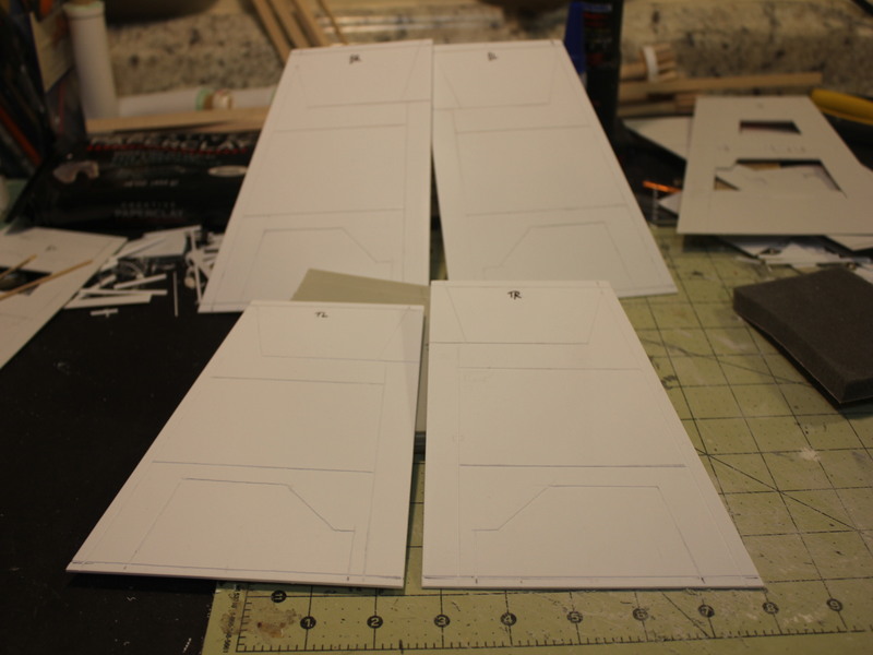

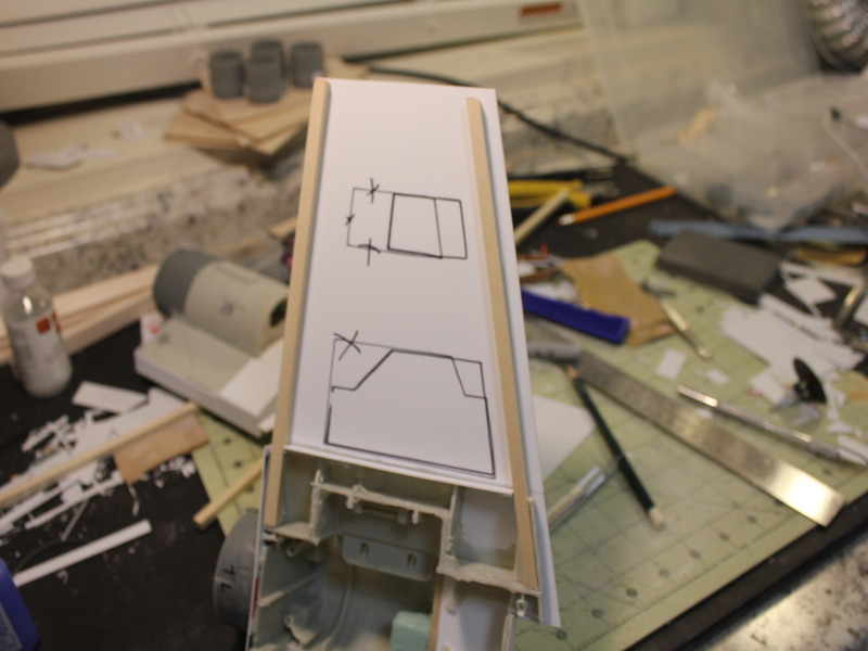

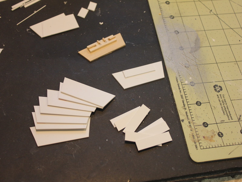

drawing out the wing patterns
copying them over to the rest of the wings
scribed
some of the details added

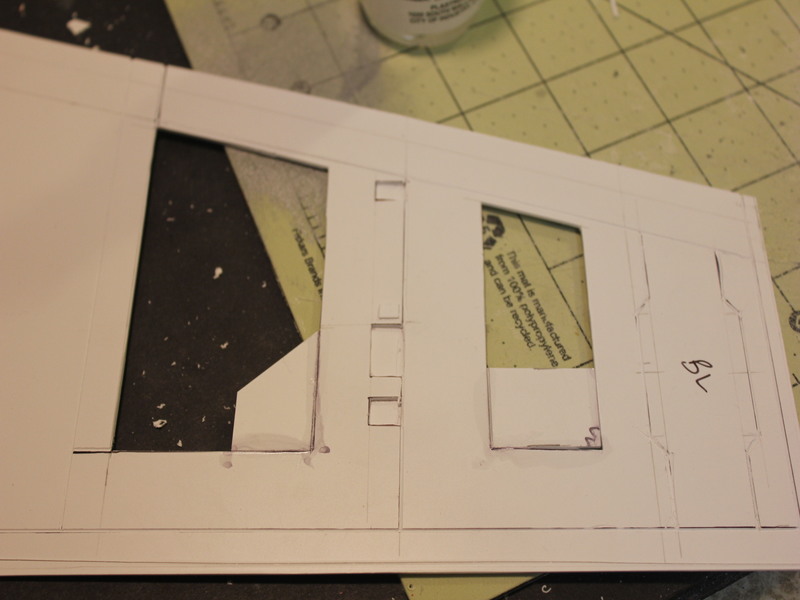

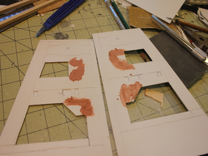

BUT THEN I REALIZED I CUT OUT THE OPENINGS INCORRECTLY ! FACING THE WRONG DIRECTION ! AAAHHH!!!!
Oh well, I repaired it and moving on....
first time using bondo too.....

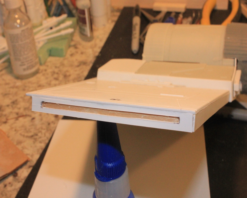

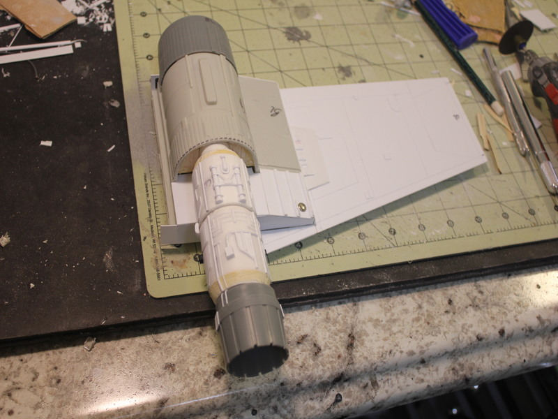

completing the top of the wing and test fit

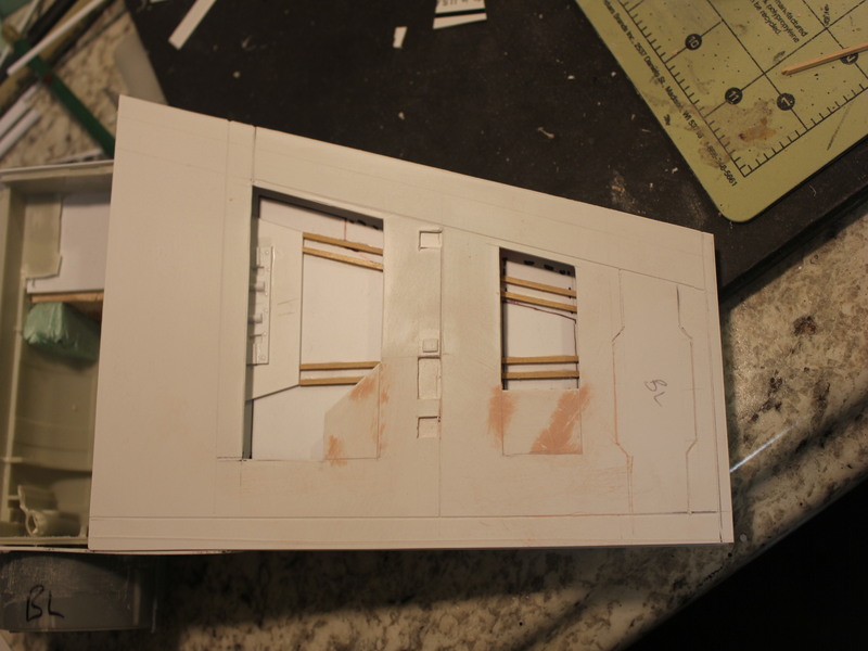

figured I'd reinforce the wings with some square wooden dowels

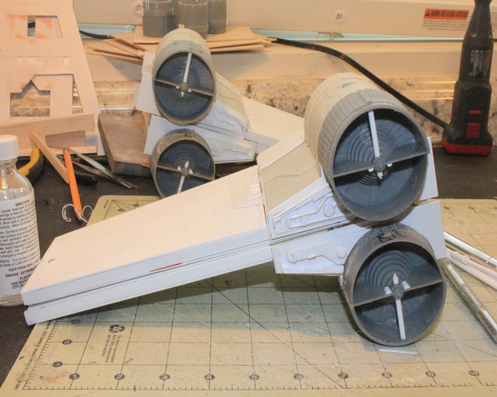

test fit the engine
Well, that's it for now...working on the details inside and the ends of the wings tonight. Hopefully get those done soon....
Thanks for looking !
Pcoz

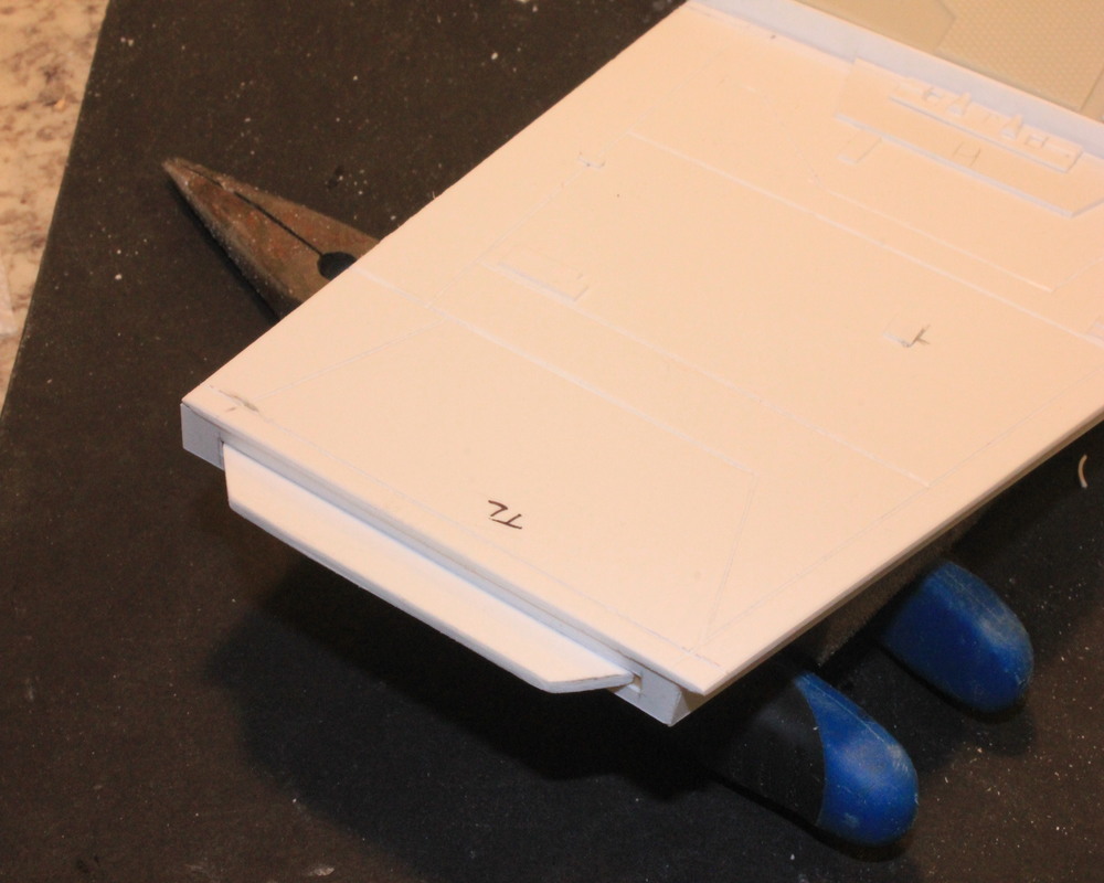

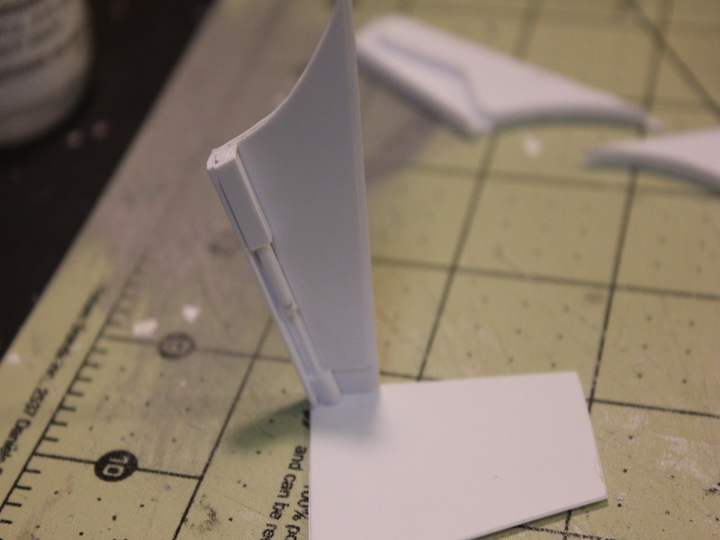

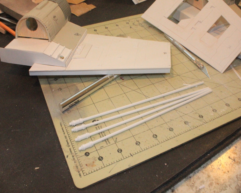

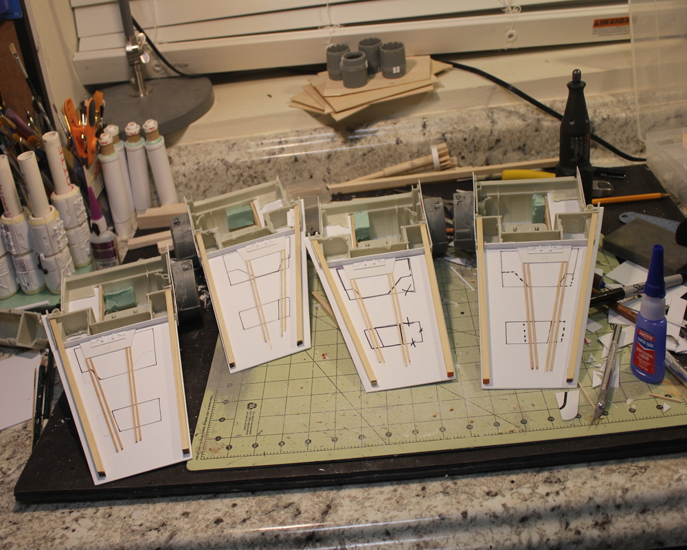

Got a little more done last night on the wings.
Still a ton left to do.....

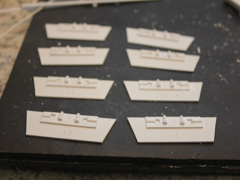

Started to add some of the details inside the wing.
repeat x4
test fit...I'm not sure if I want to attach the inside panels of each wing before or after painting.
stated filling in the end of each wing so there will be some "meat on the bones" for attachment of the cannons later.
working on the rear part of the wing detail
will just glue them on the backside of the wing

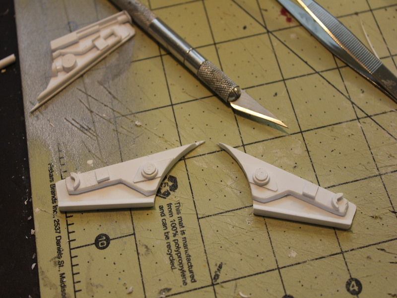

started adding my previously made pieces to finally see SOME progress

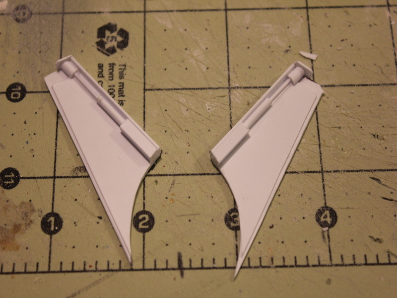

as I was looking at the referance model, I realized I needed to fill the tip of the wing.....
....add styrene sheet,
and cut it out to accept the end piece,
here
It turned out to be the easiest way to tackle that area. Thank god, because it seems like I've made some other areas extremely difficult....when I didn't have to. "Think McFly!"
Anyway, checking the inside paneling
and couldn't resist a quick "prop up" to get an idea of what it's going to be....
As always, comments and suggestions are more than welcome !
Pcoz

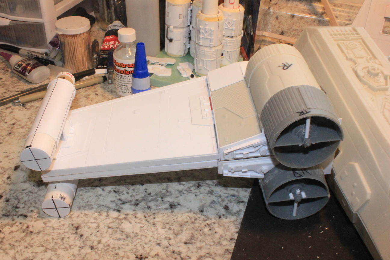

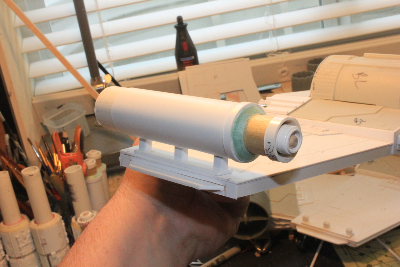

Quick update (1 of 2)
Had some more free time this weekend so I wanted to get as much done as possible.

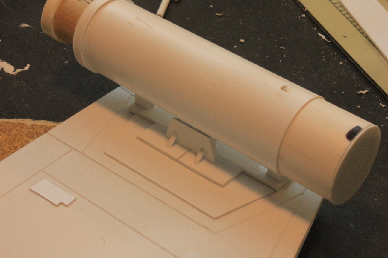

started in on the cannons and wing details in that area.

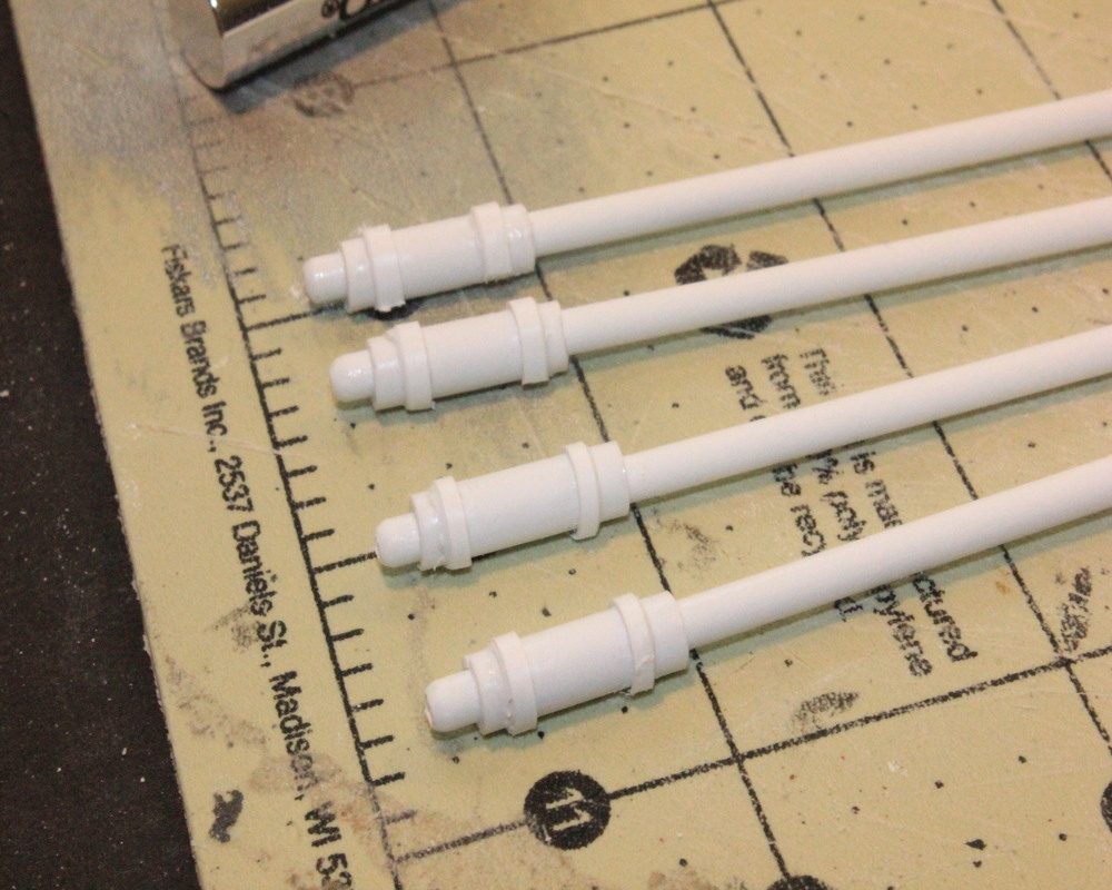

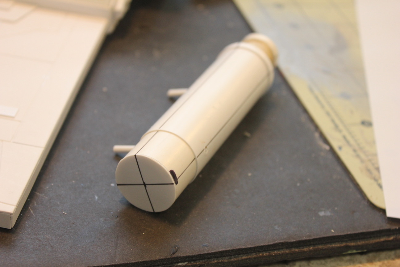

so cutting some plastic...
took some rectangular tubing and chopped it up
I'm not sure if I'll curve the bases or not similar to the reference pic's I've looked at...
This whole project had kind of turned into a hodge podge of different reference photos but alas, I keep going. :facepalm
drilled and ran rod through the wing and through the cannon for support and alignment. You'll also notice that there is not a HOLE in my finger....yet
test fit and will probably keep these separate until final painting
working on the inside trim on the tip of the wing for more cannon support I guess...Sorry, I do not know all the technical terms for all the parts, lol
used the modge podge method to install my "rivets"
divided up the cannons and will start detailing them next.
some quick set up pic's to make me feel better and on to the next area !
Thanks for checking it out ! More coming tonight....
Suggestions/Comments are welcome !
Pcoz
