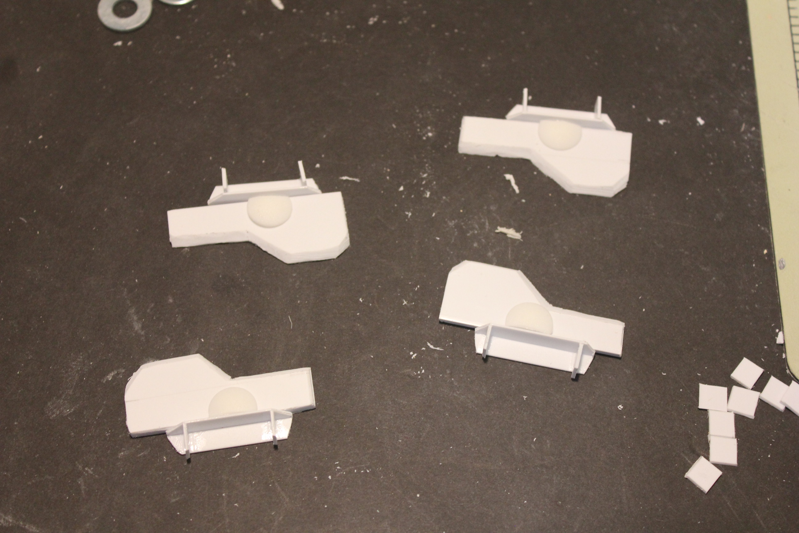

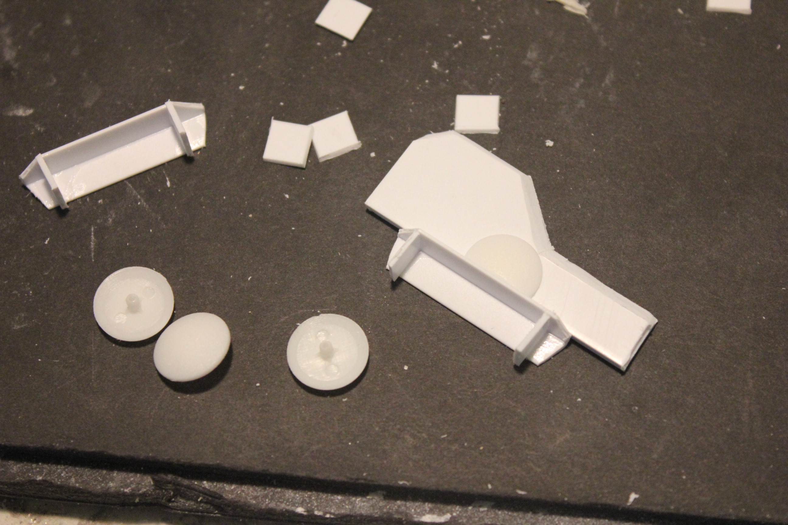

hello peeps, quick update....
I finally have a day with NOTHING planned !
I hope to make some significant progress today

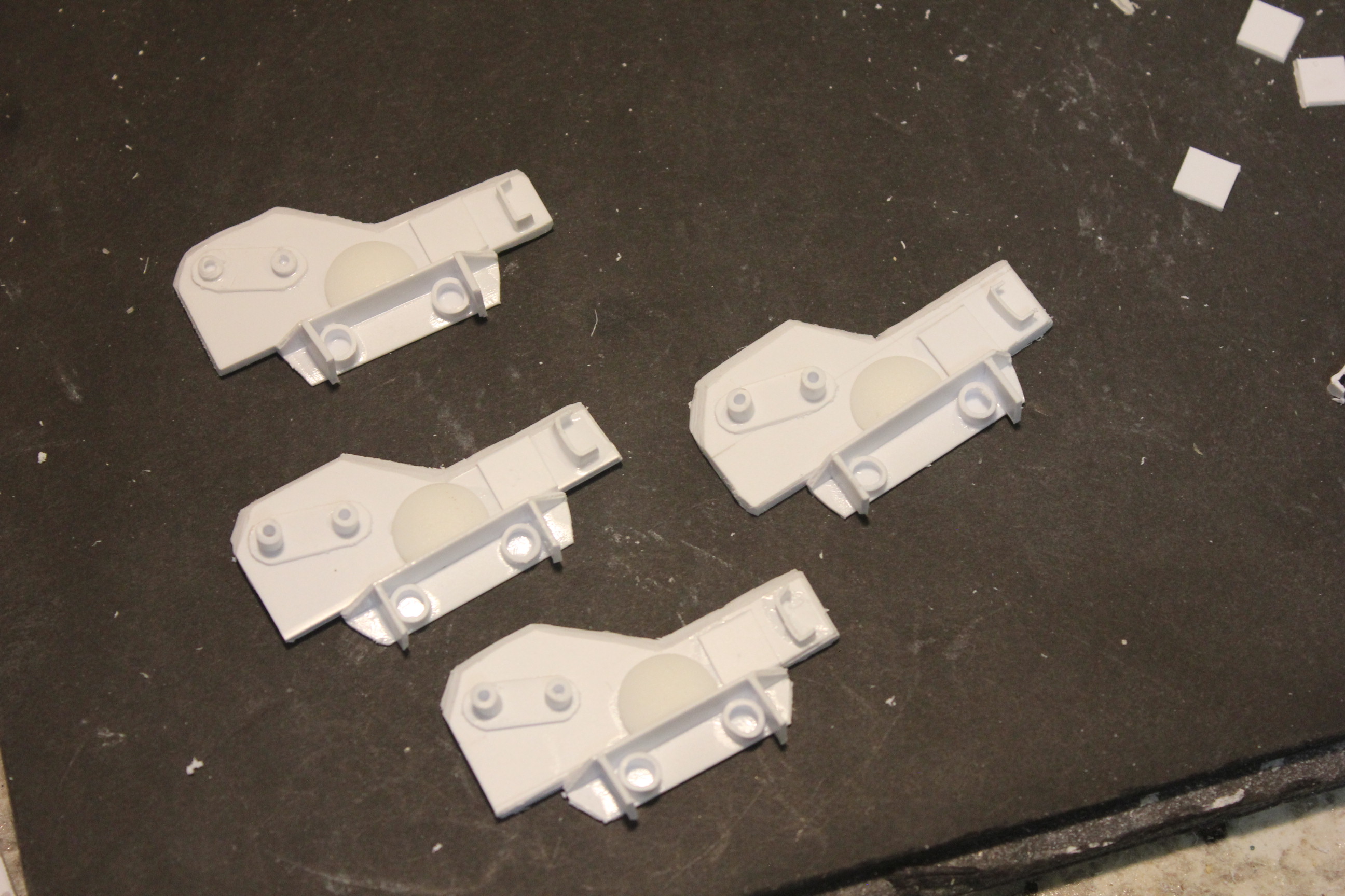

Anyway, here are some some pics of the build now that my styrene order came in and I'm broadening my model-making horizons....next I'd like to try some molds. As you'll see as I move forward, it would have saved me a ton of time repeating builds X4.
Here is my first order and I've already figured out what I need to order more of and what I'll probably never use.
sized and rough cut
rough shaping
checking the fit
beveled edge with x-acto and dremel
these angles came in handy
working out the details

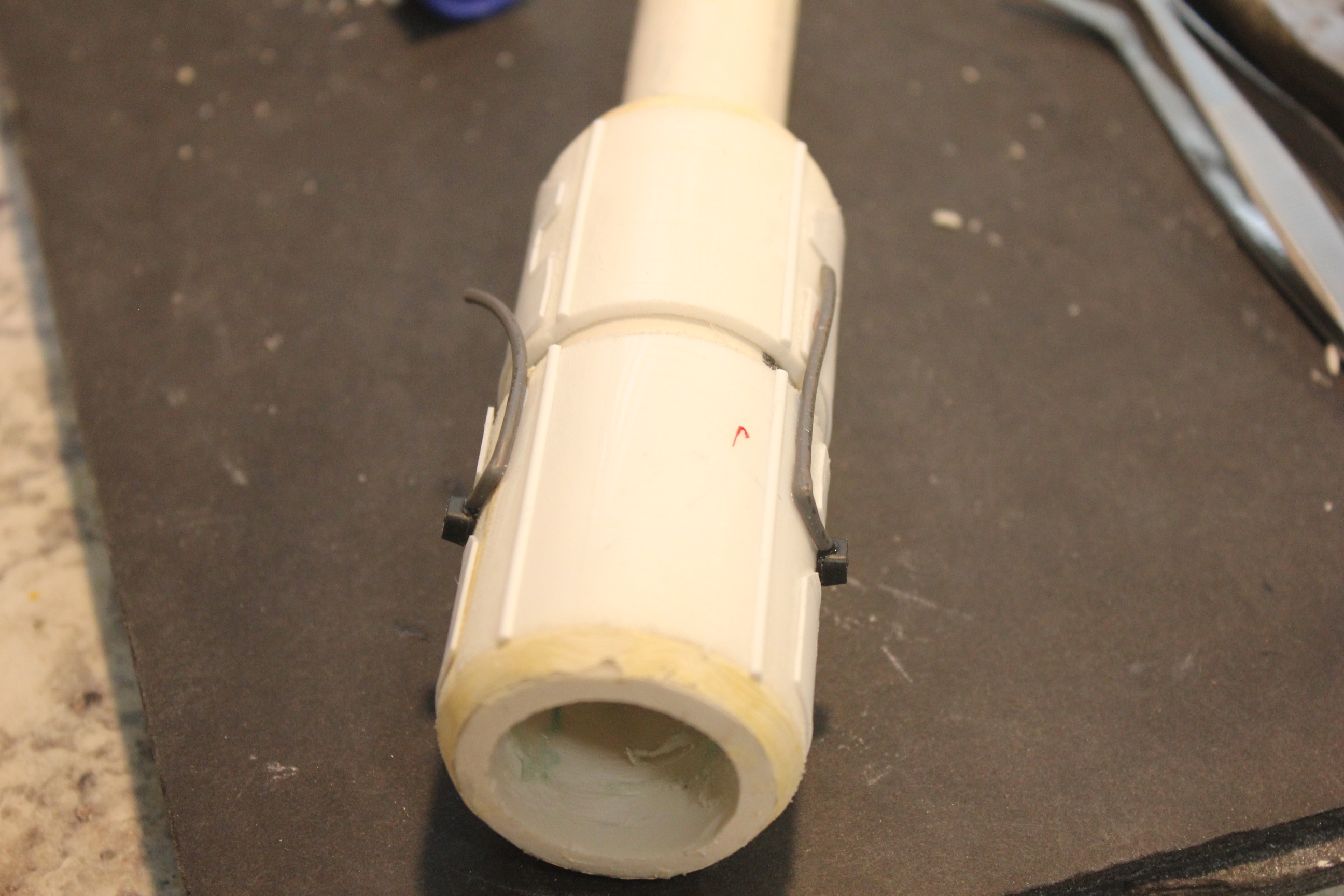

cheap plastic furniture screw covers will do the job
cut off the ends of small zip ties
1/2 round rod helps a bunch too...
Welp, that's it for now. As you can see, I really need to learn how to make 1 and mold each one so I don't have to repeat the process over and over.
Thanks for looking...
More to come soon
Pcoz

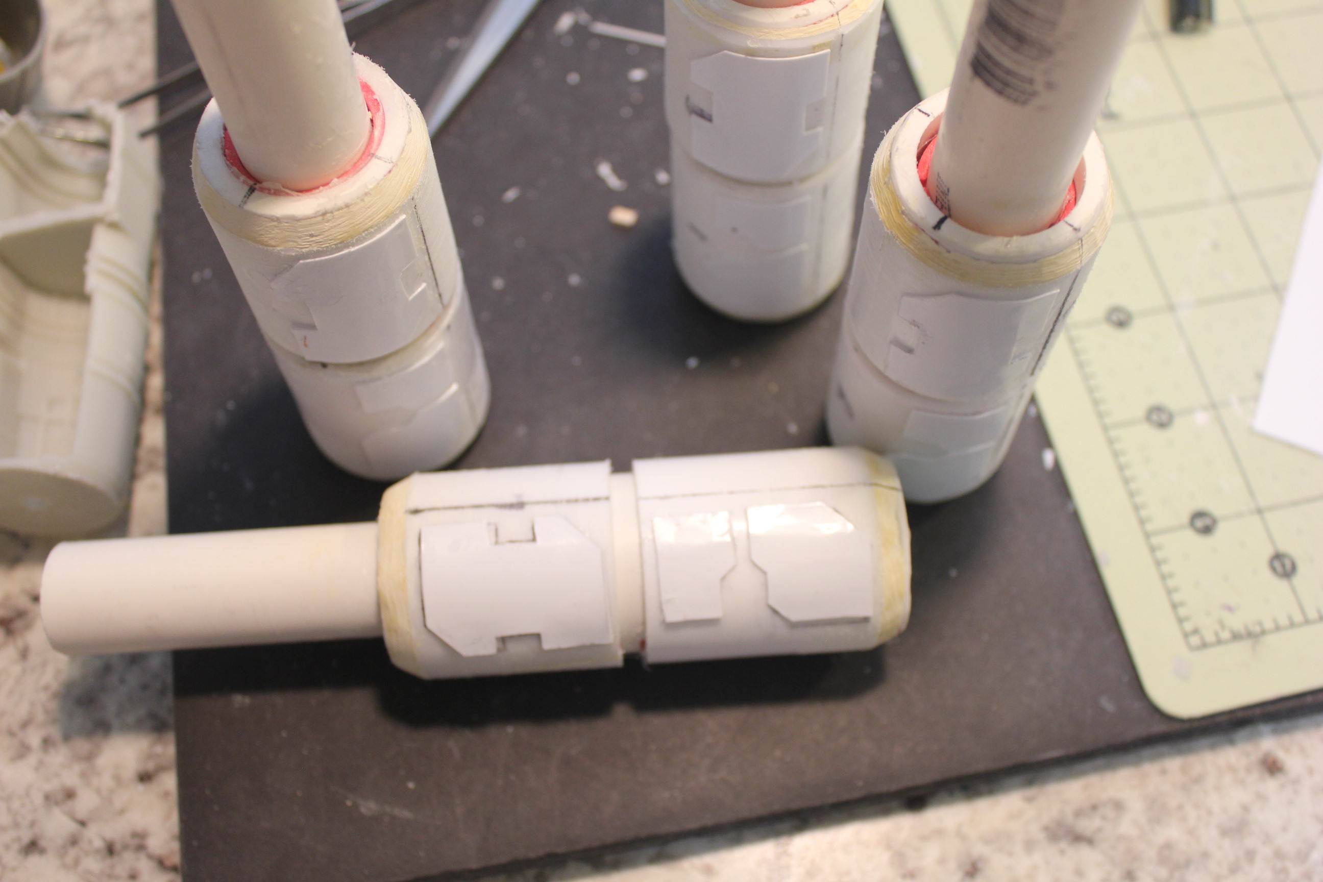

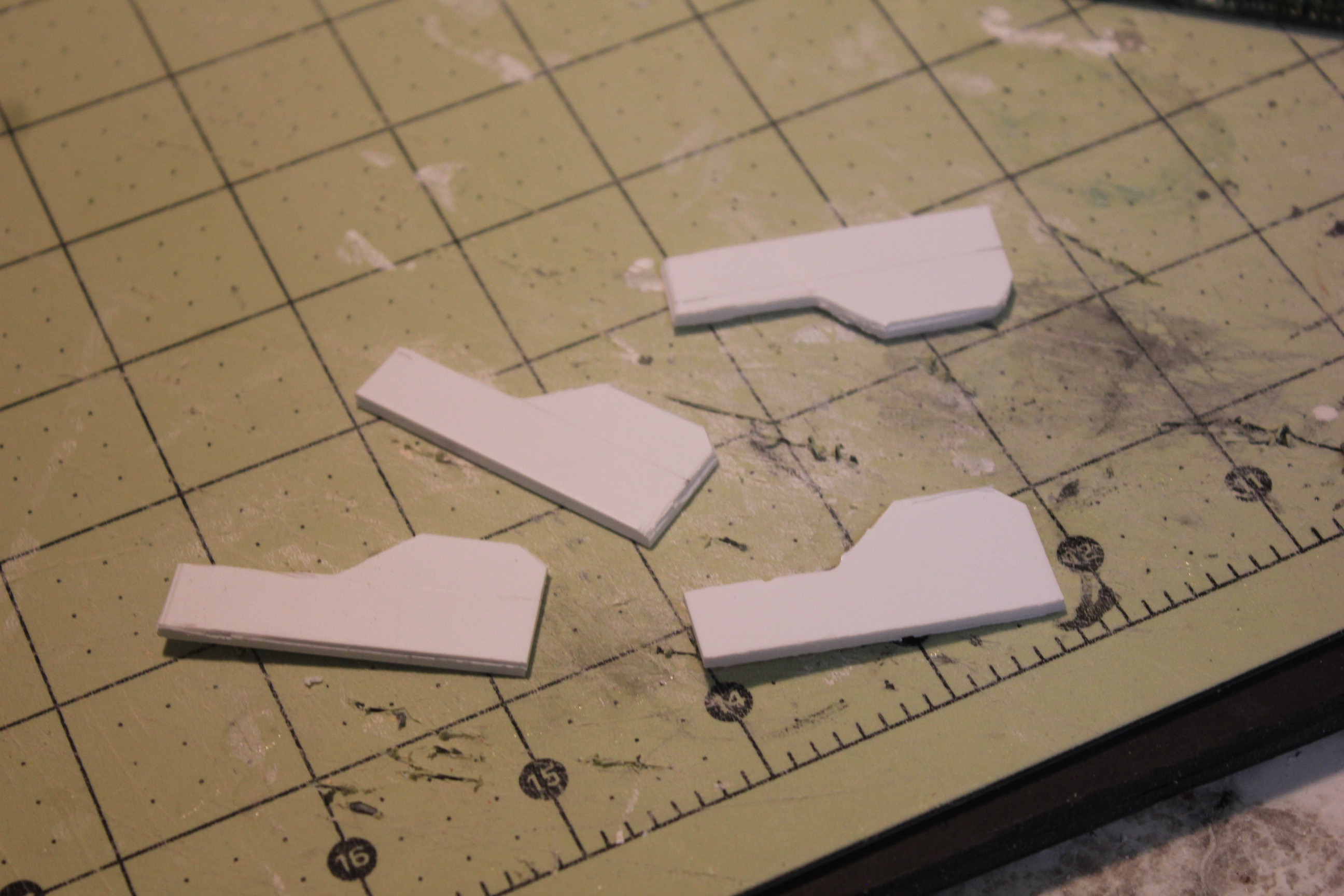

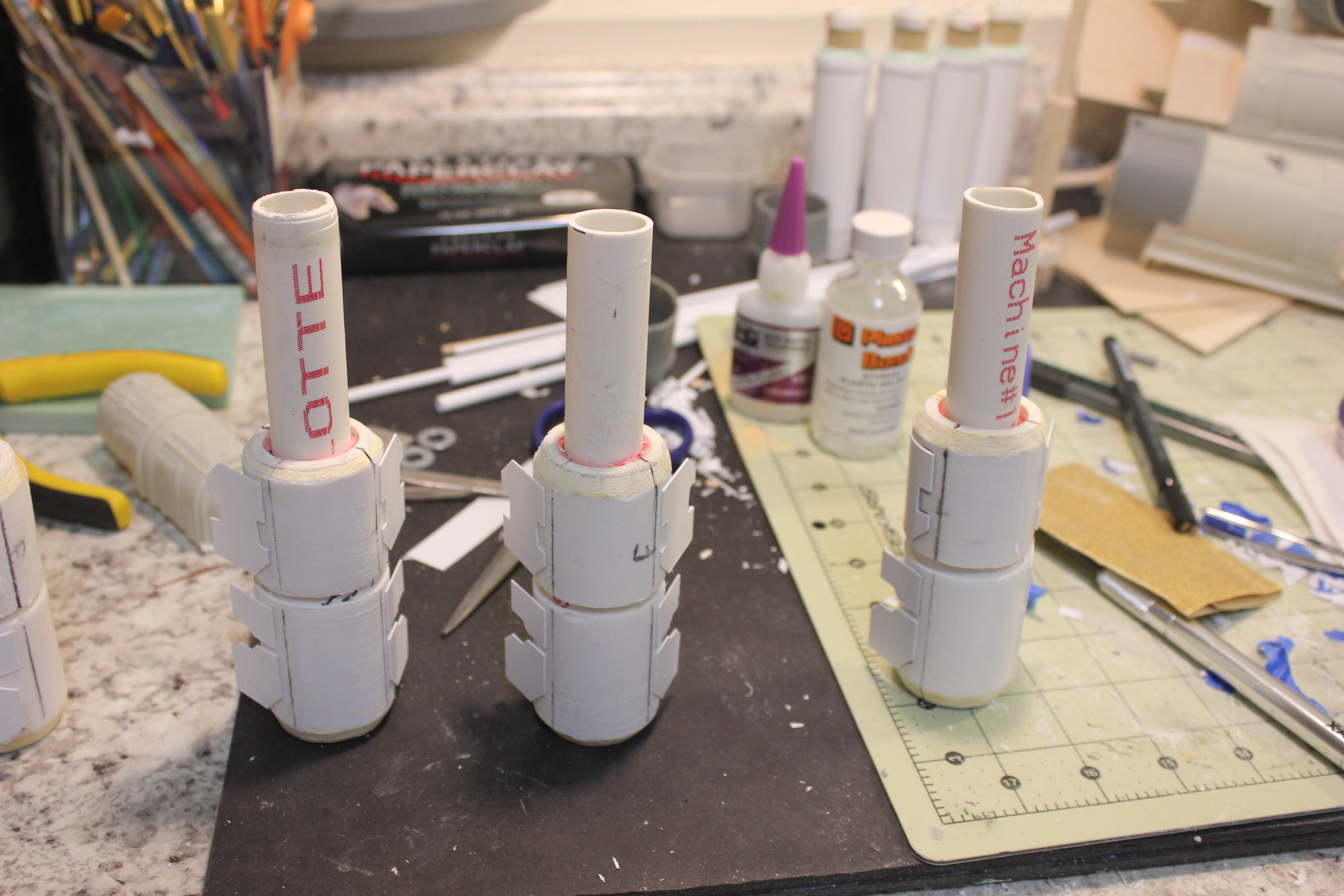

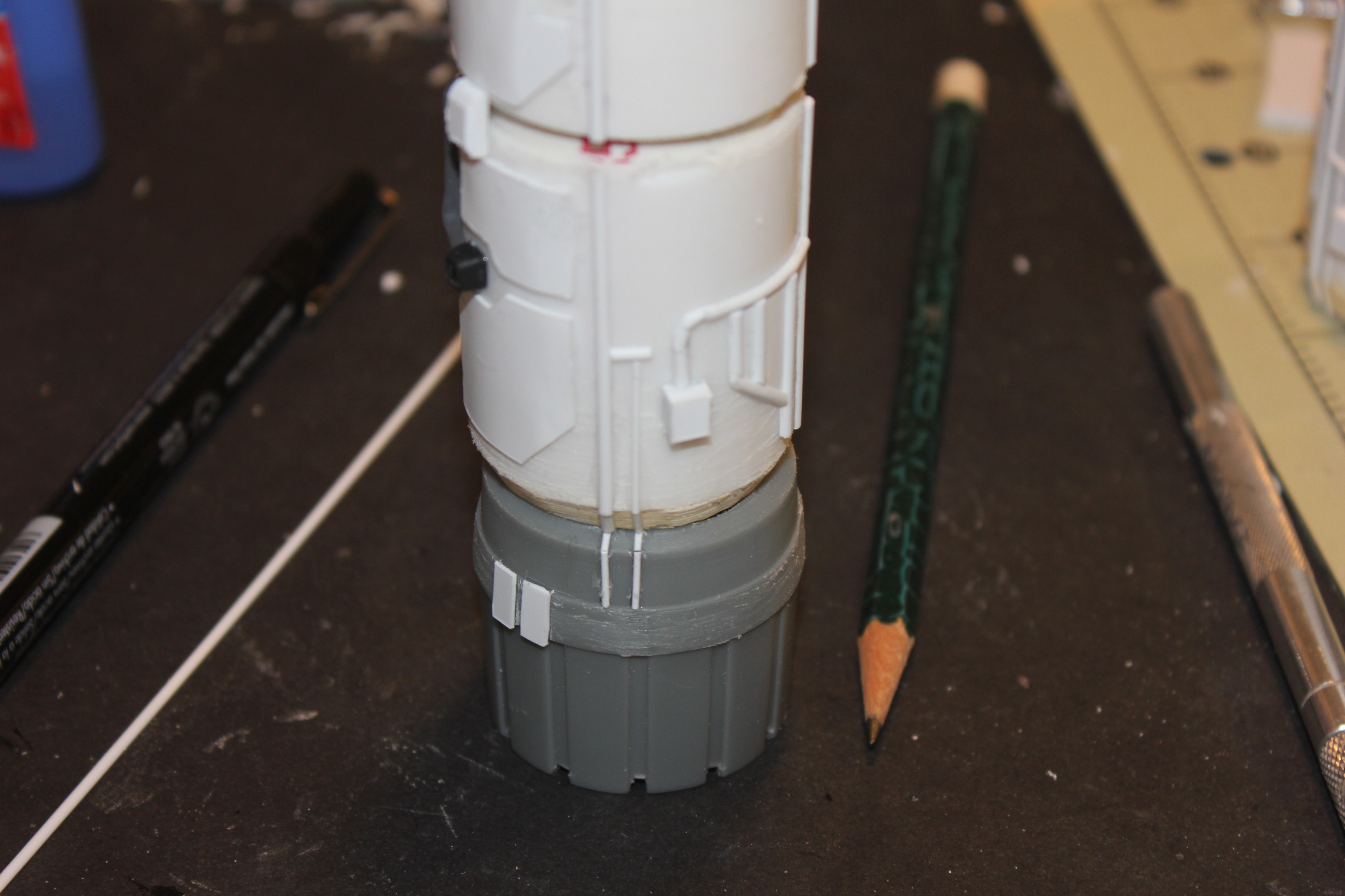

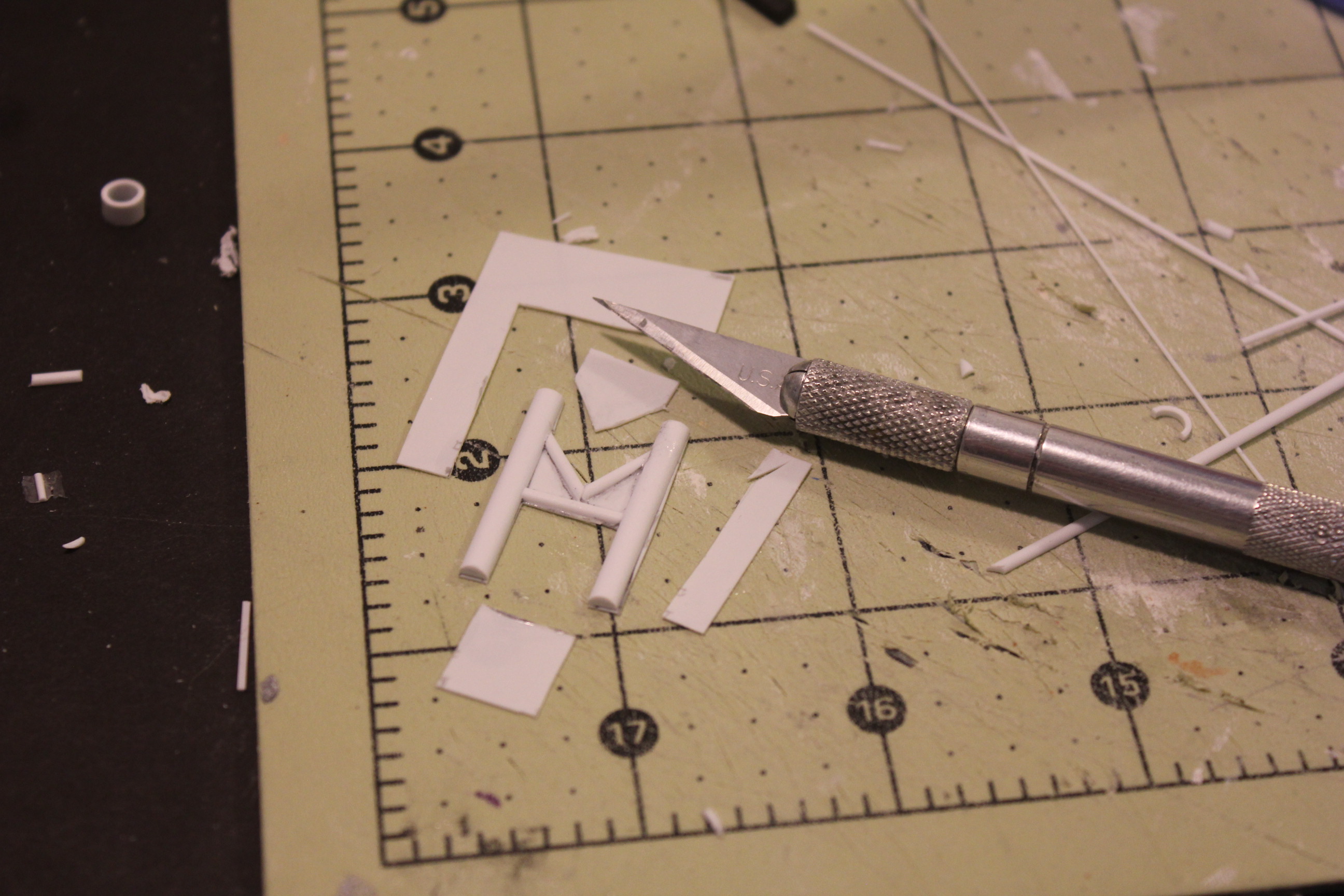

ok, here's the mess so far.....
moved back to the engines to try and get them close to being finished and then move to the wings

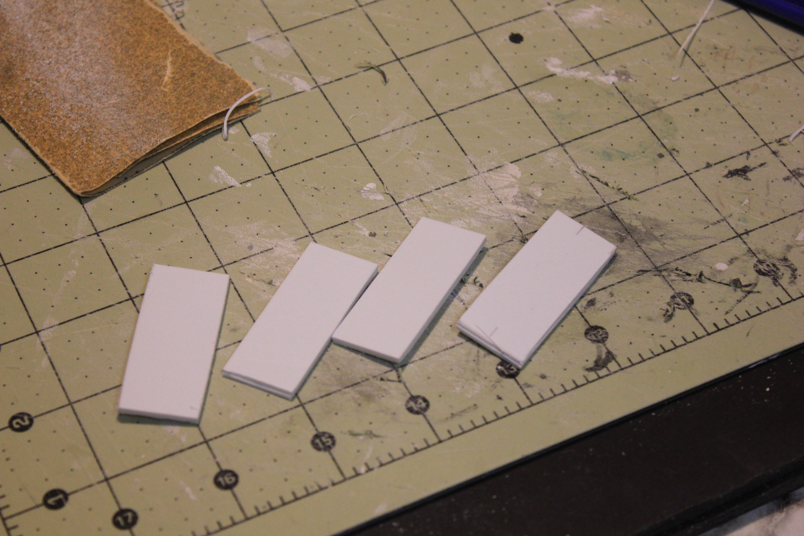

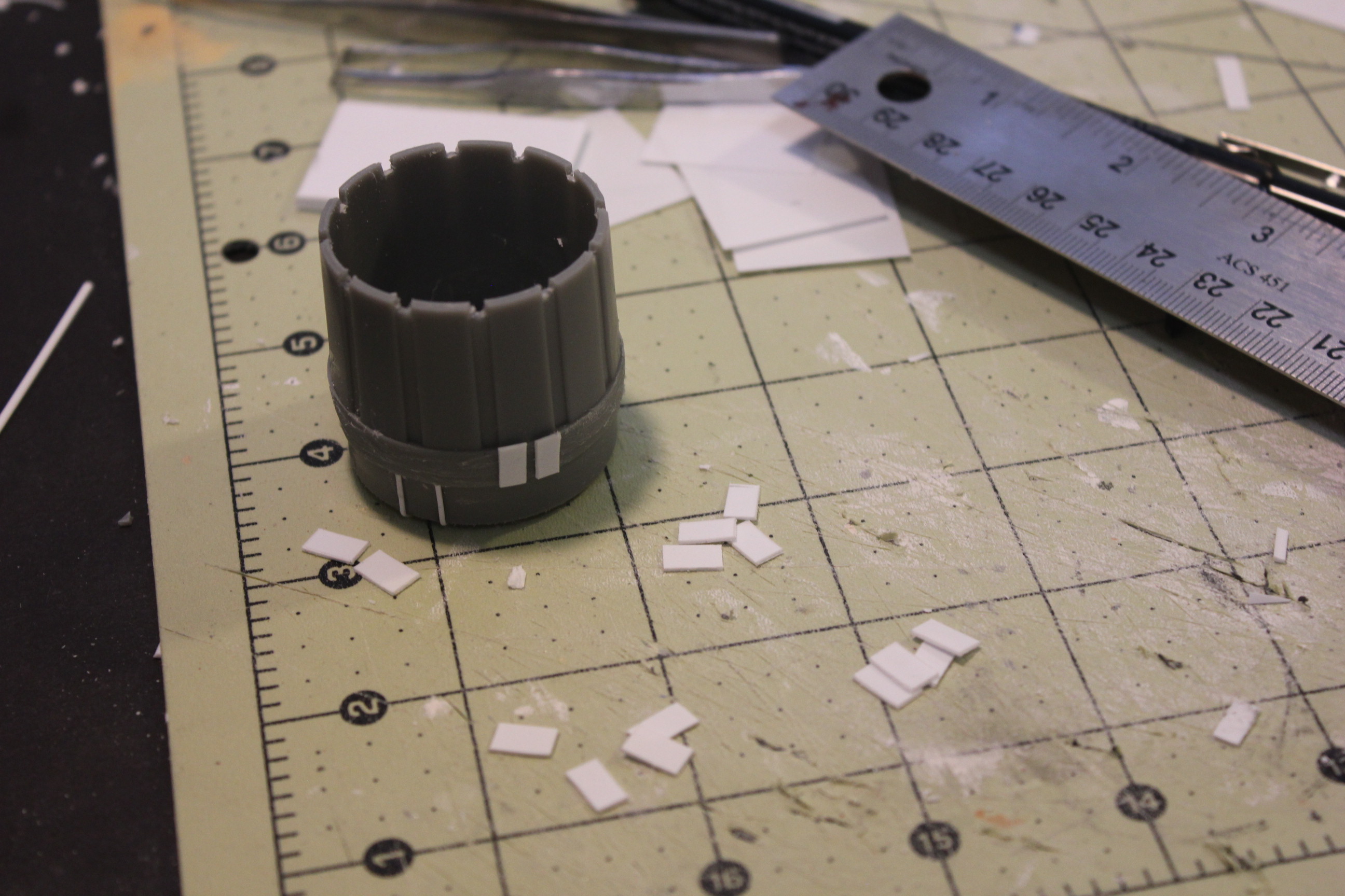

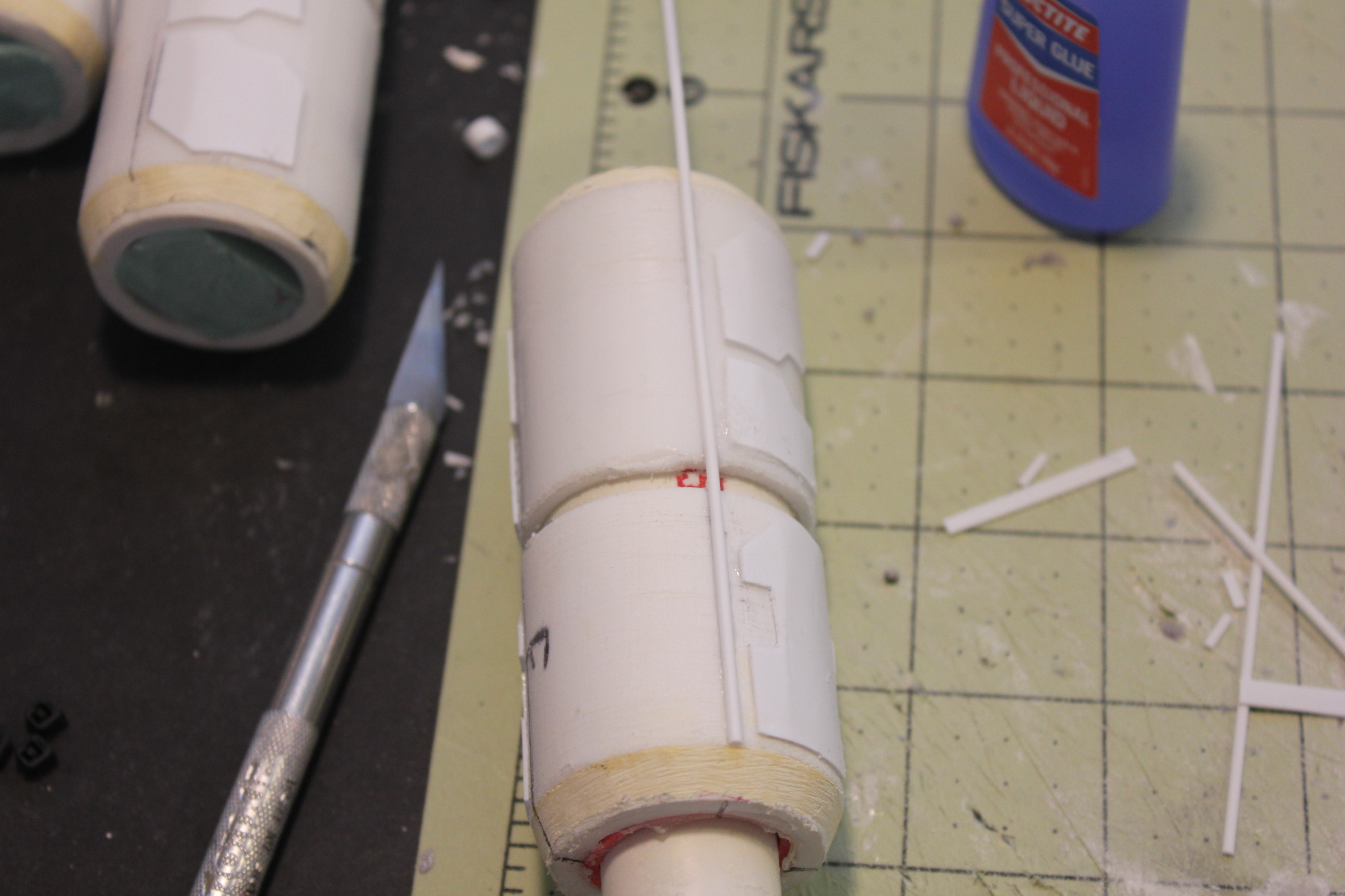

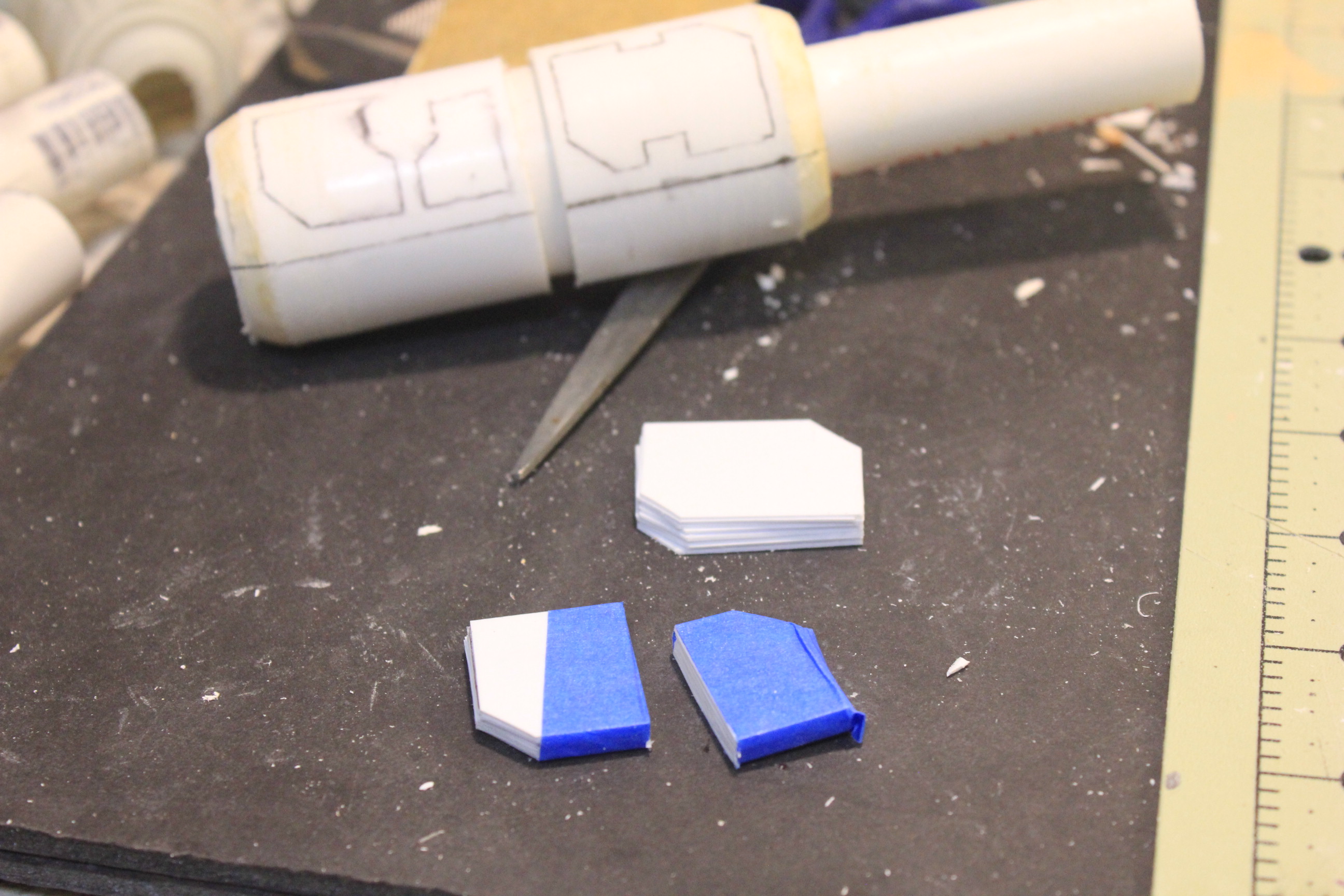

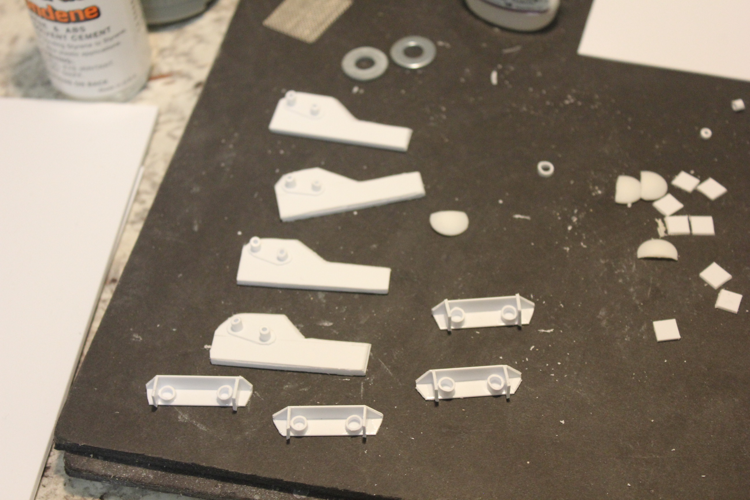

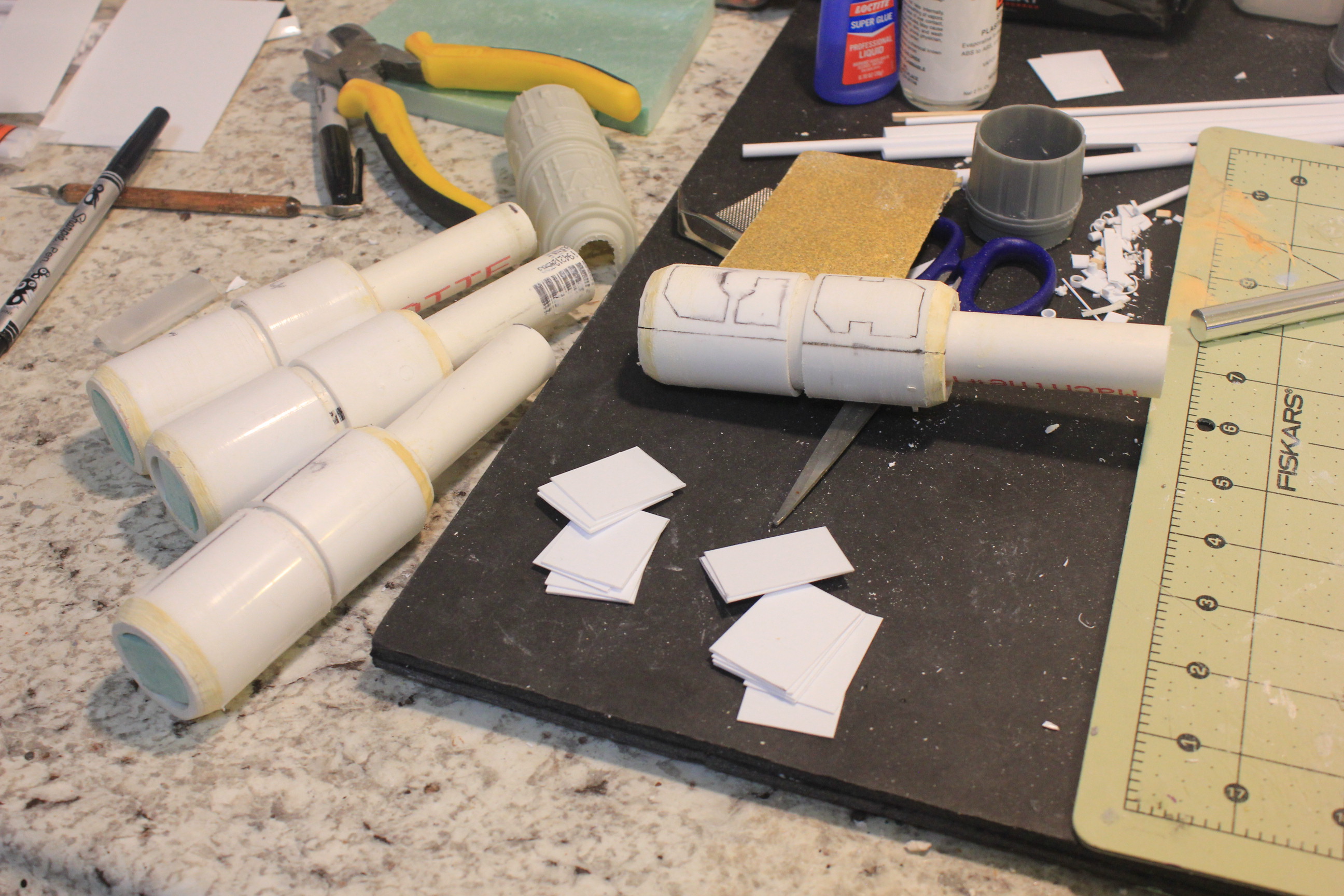

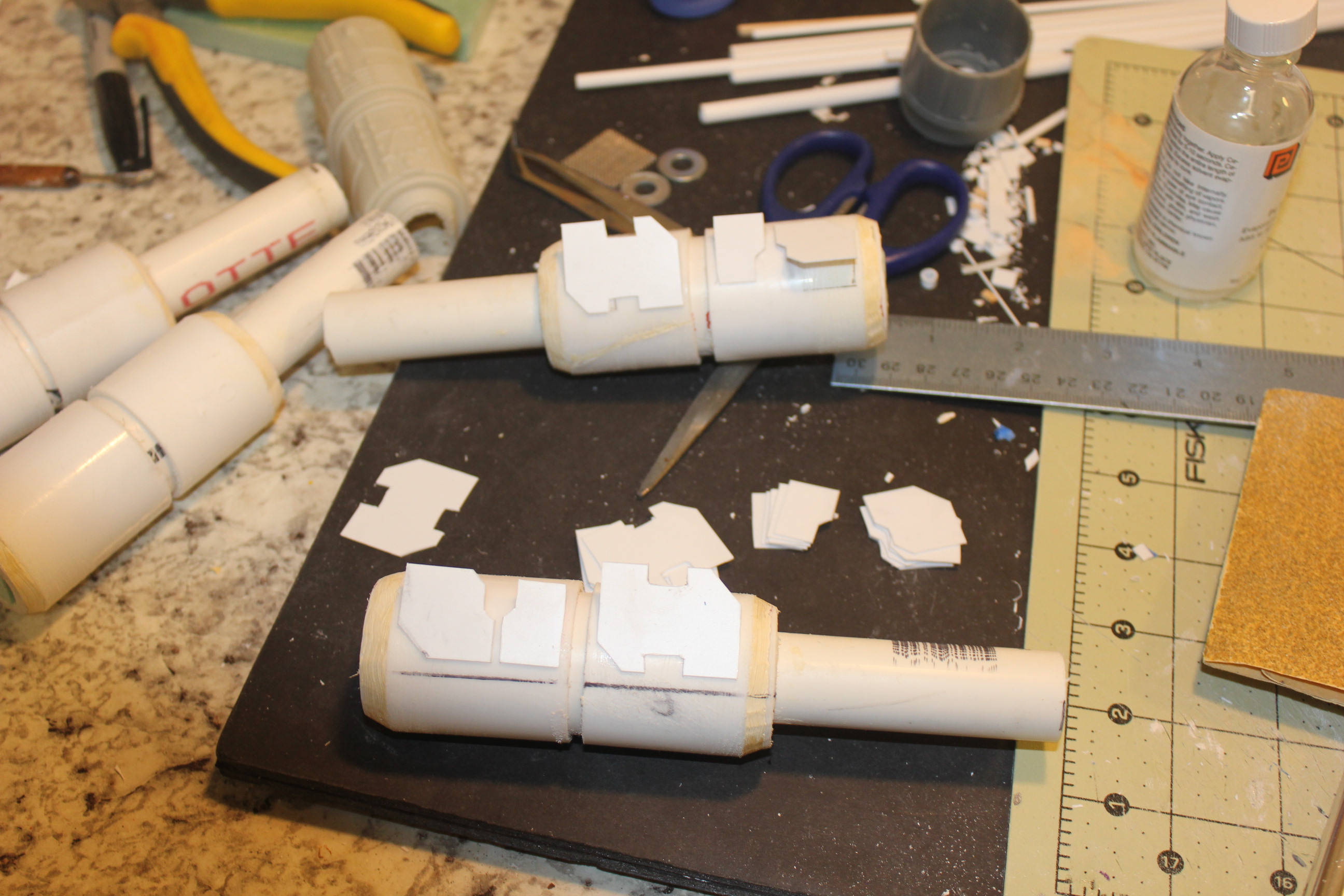

cut styrene sheets to size
matching them up and cutting
Since my reference is the large 4' model, I'm keeping it in tune with that....or something close.
glued to the pvc
notching out the ends...

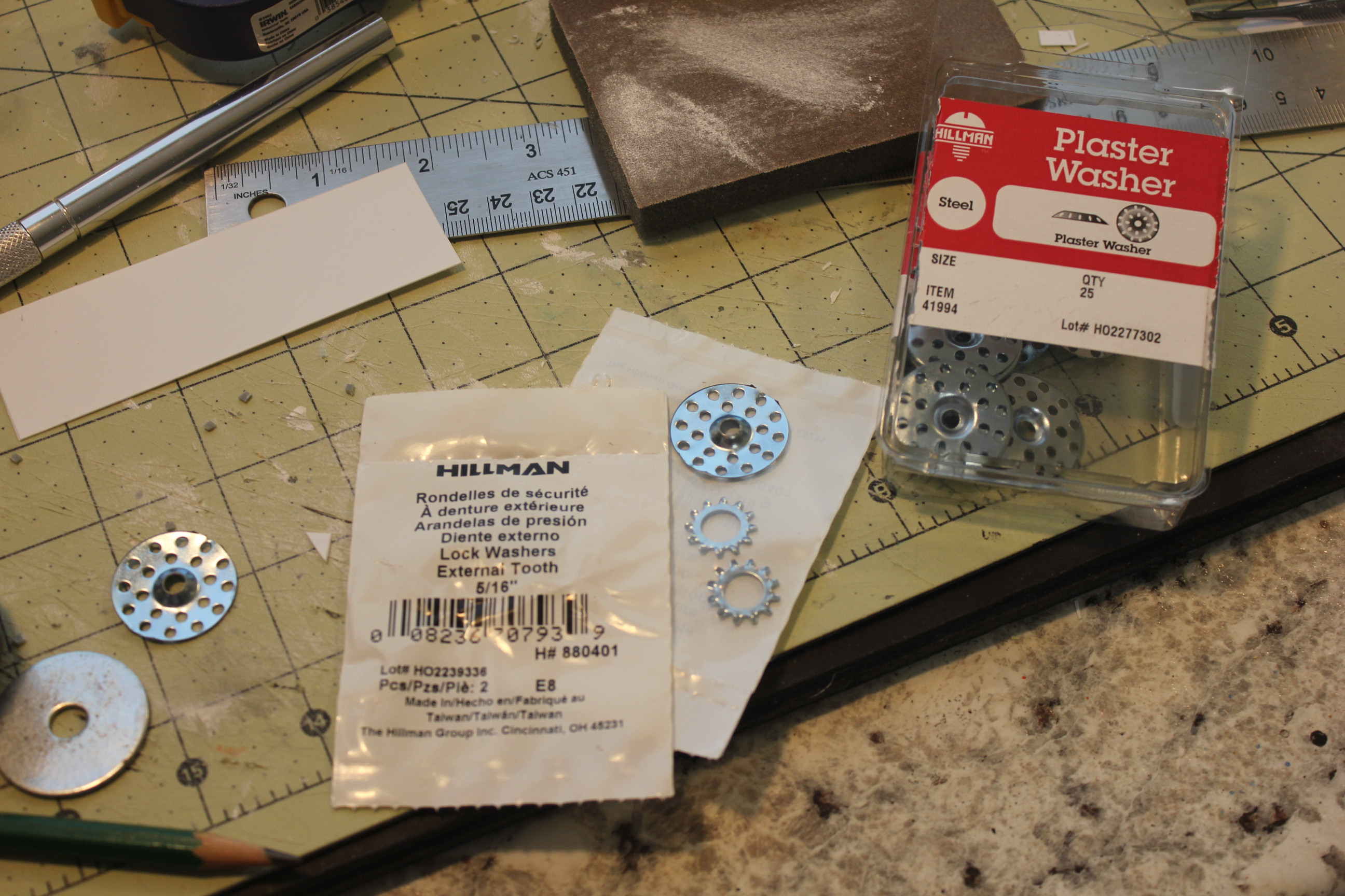

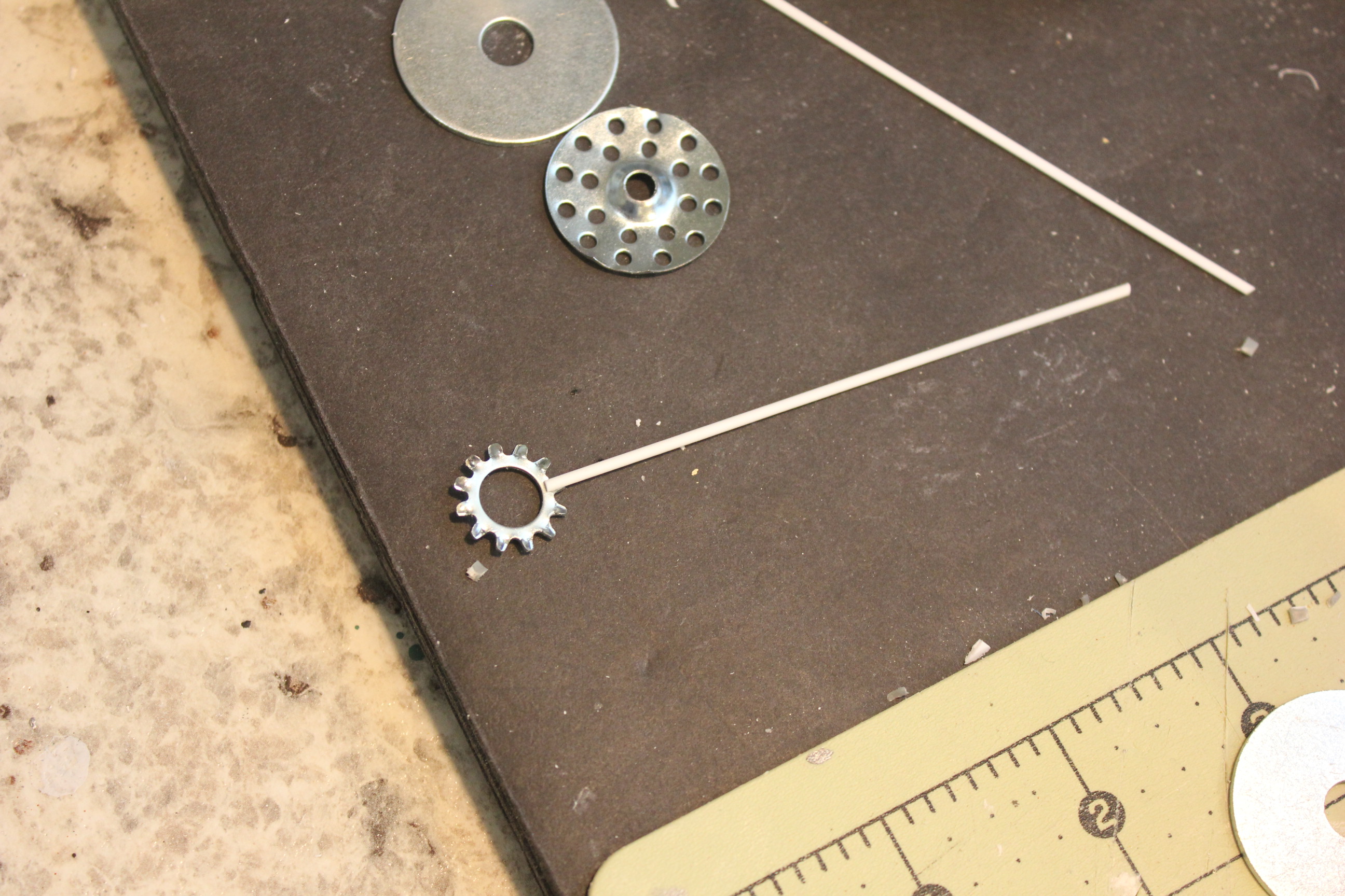

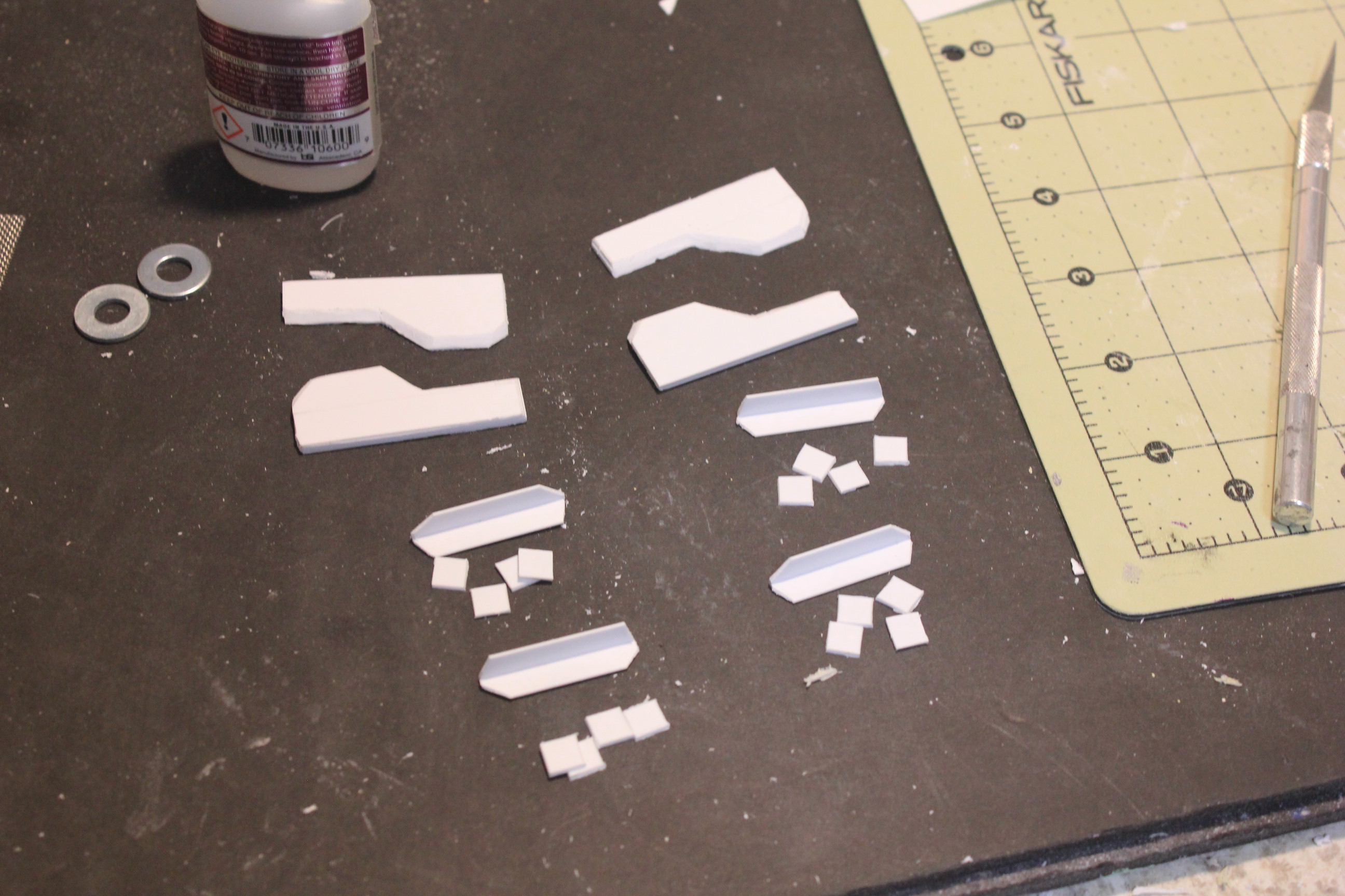

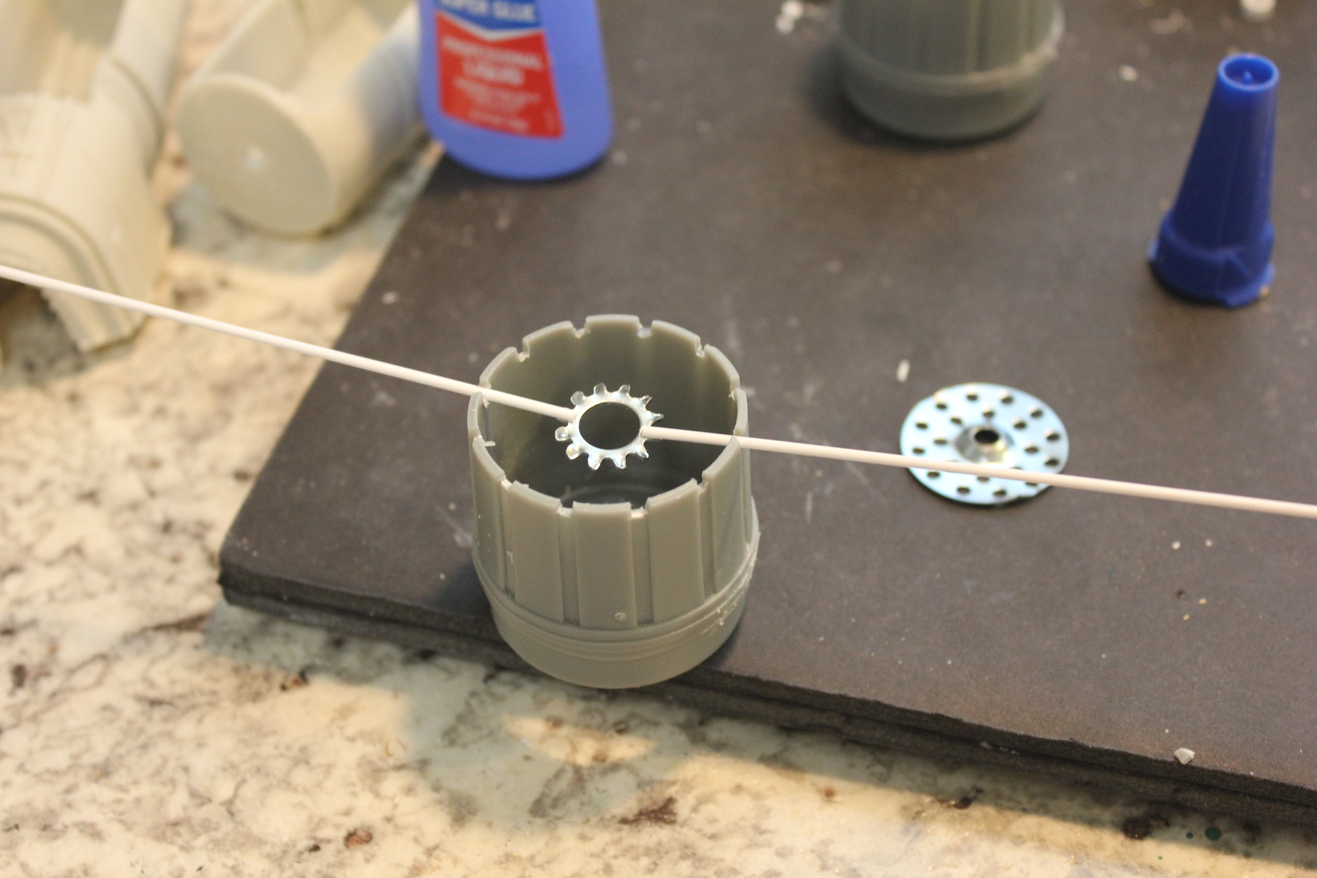

happened to be in Loews today and found a few parts that may help
this lock washer had the size and correct number of tabs so I thought I'd give it a try
lining them up
kinda worked, we'll see

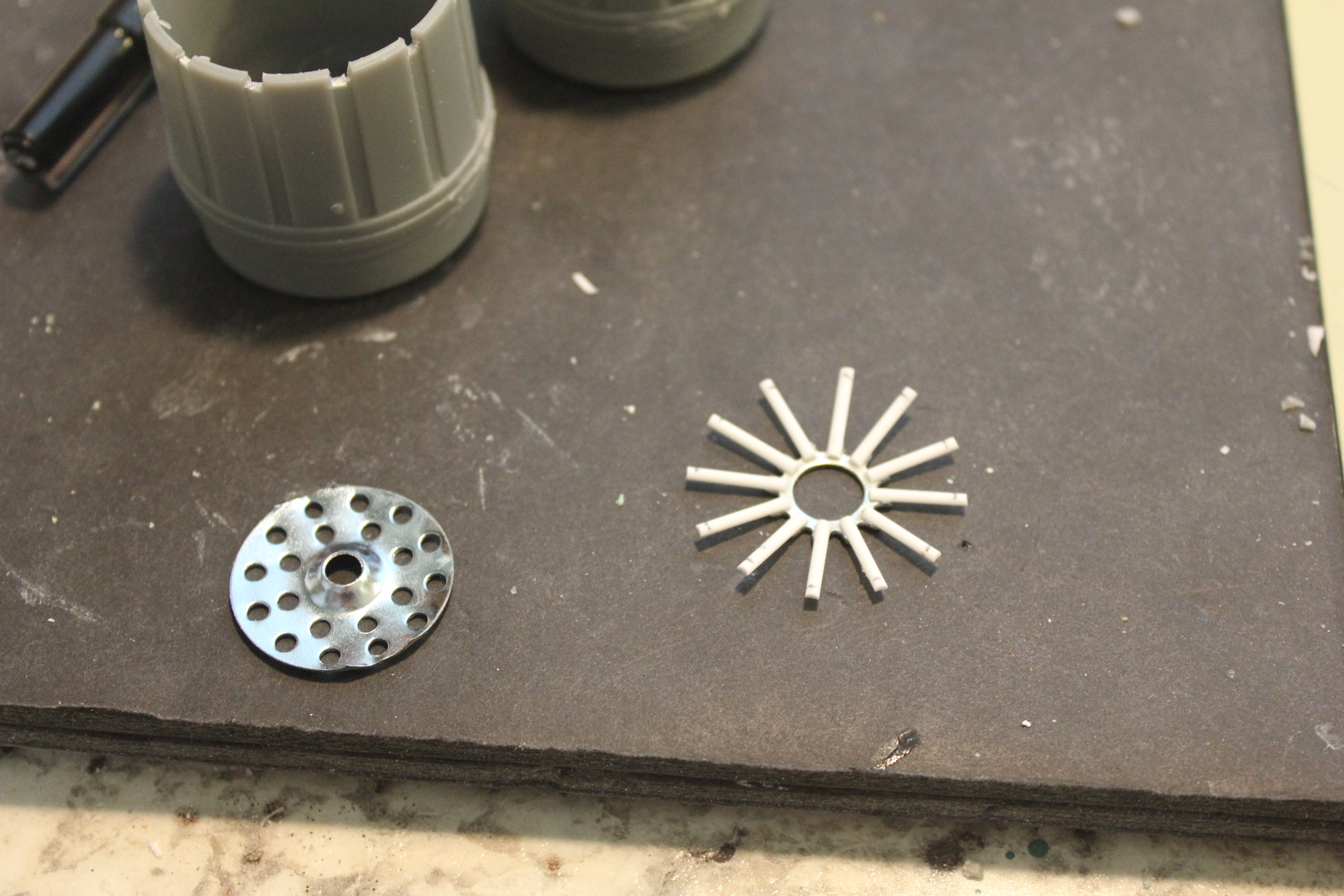

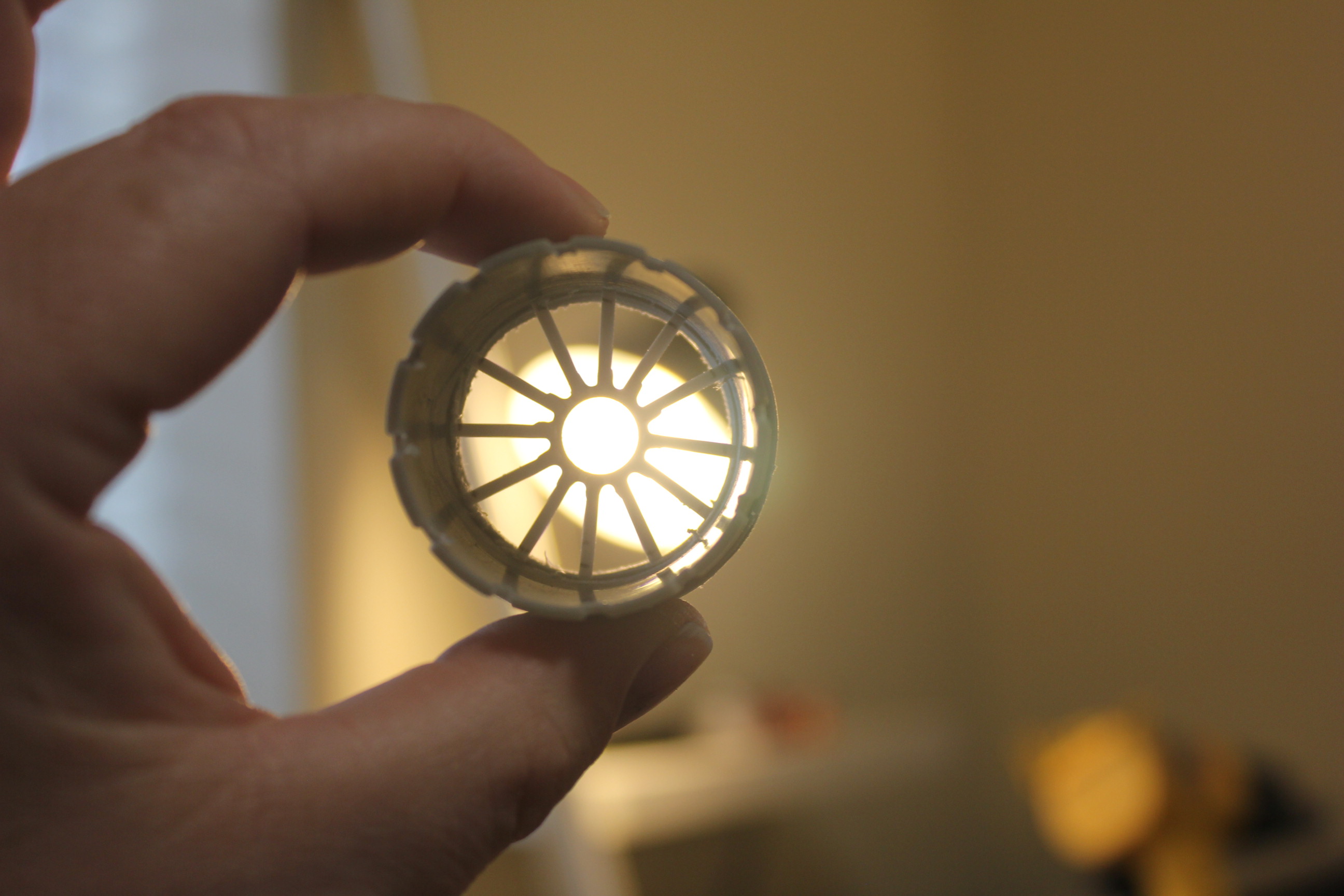

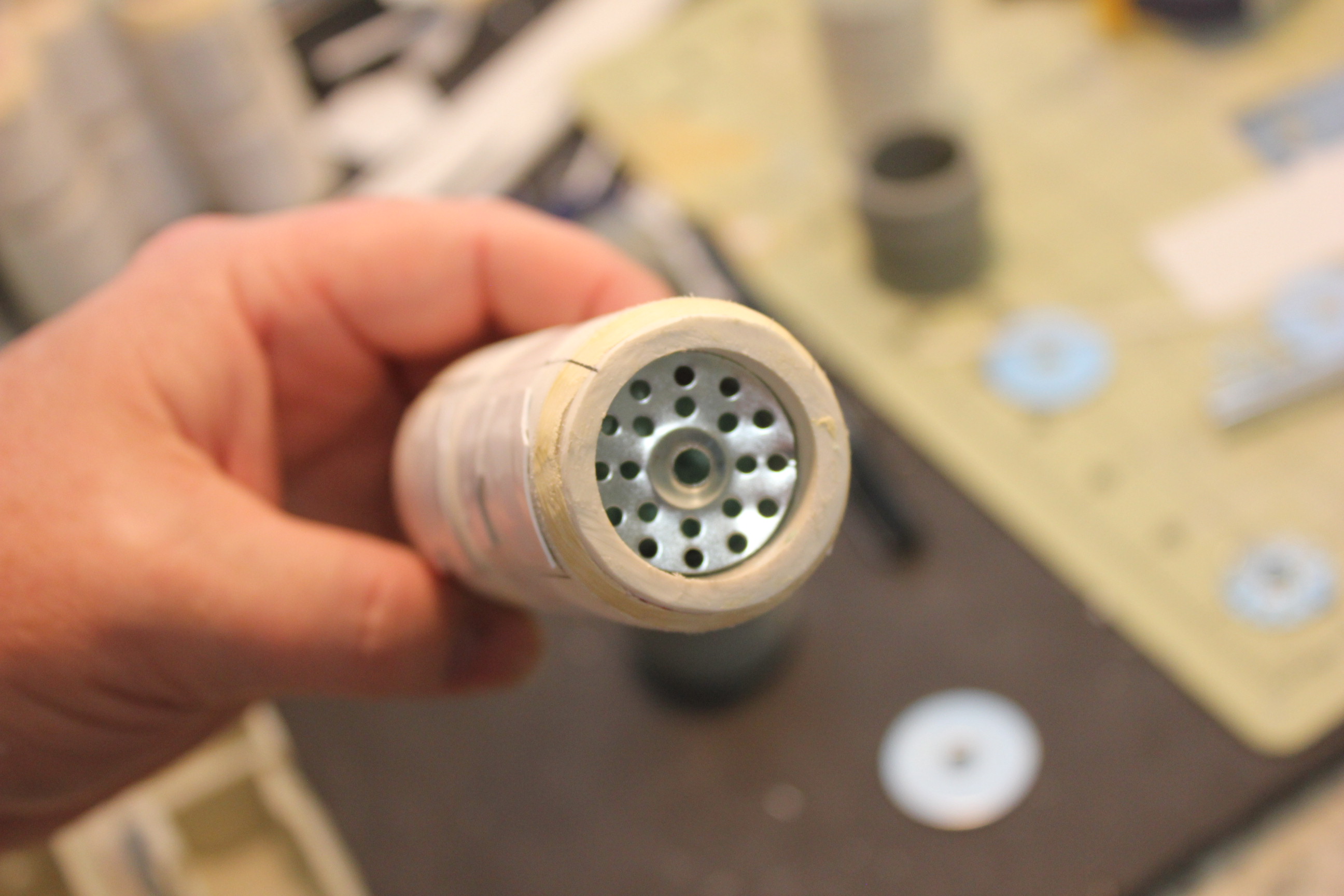

I haven't decided if I'll use this, but it looks pretty cool. If my LED's are behind this, it may not emit enough light. I'll tackle that later
trimmed to fit
checking the look...
Ok, gotta run, but I'm going to try and power through this project, so....Back Soon !
Oh Yeah, can anyone point me in the right direction for molds, casting materials I may need ? I'm almost done with the trim on one engine and I dread having to repeat it 3 more times....Thanks!
Pcoz

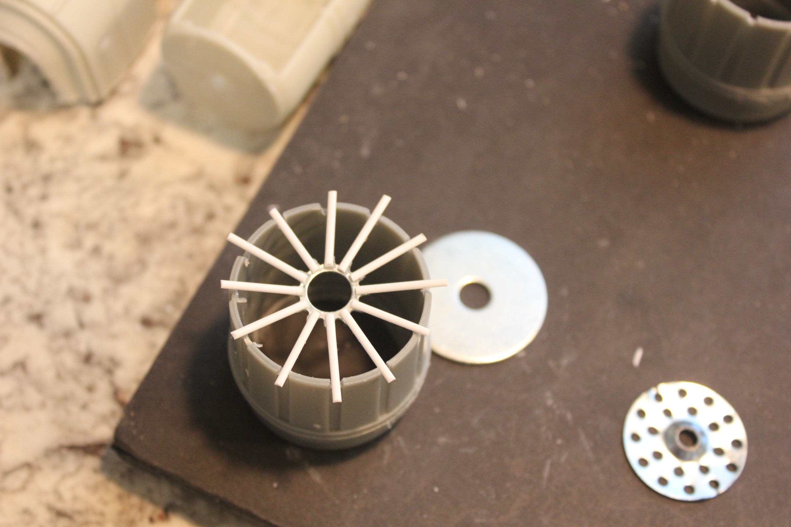

Pcoz, you could always use your metal perf'ed disk as a 'mask' for a clear disk... so you'd have the 'holes' painted black, letting the light through the rest...
R/ Robert
Re: Pcoz's Hasbro Hero Star Wars X-Wing Conversion
R/ Robert
That's a great idea, I never thought of that. I also have plenty of plexiglass laying around too... that might give it a really good, deep look about it.

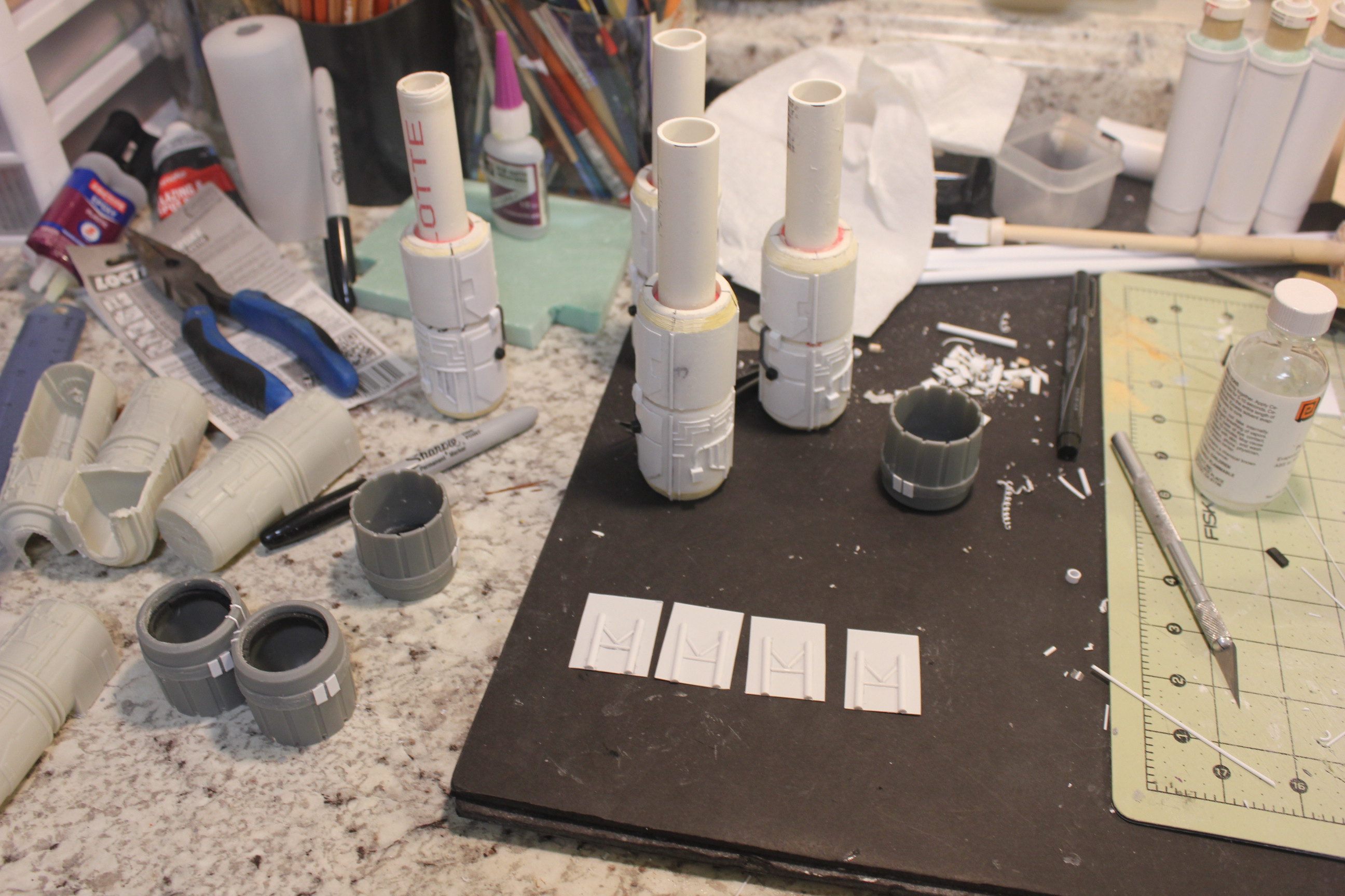

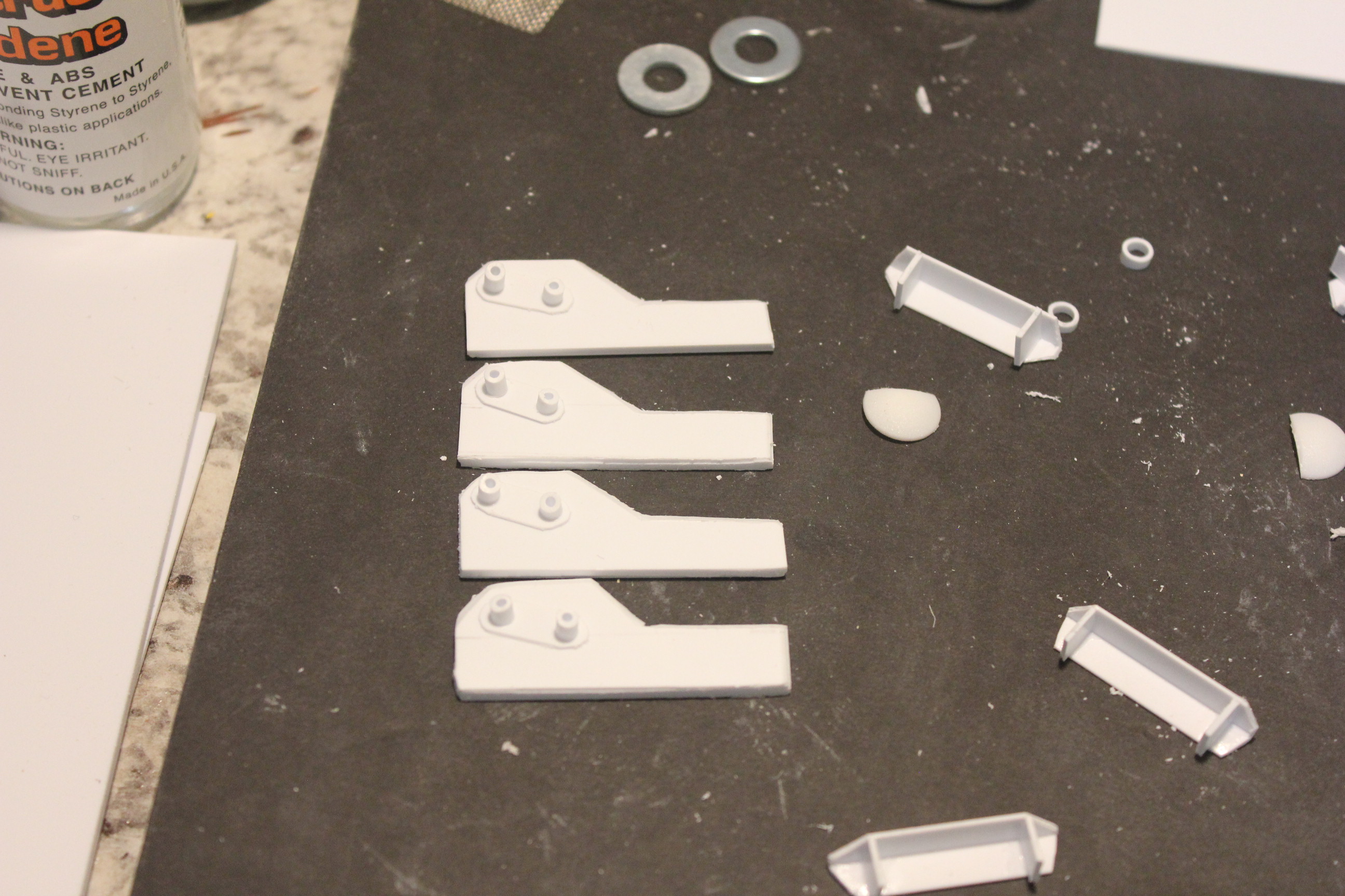

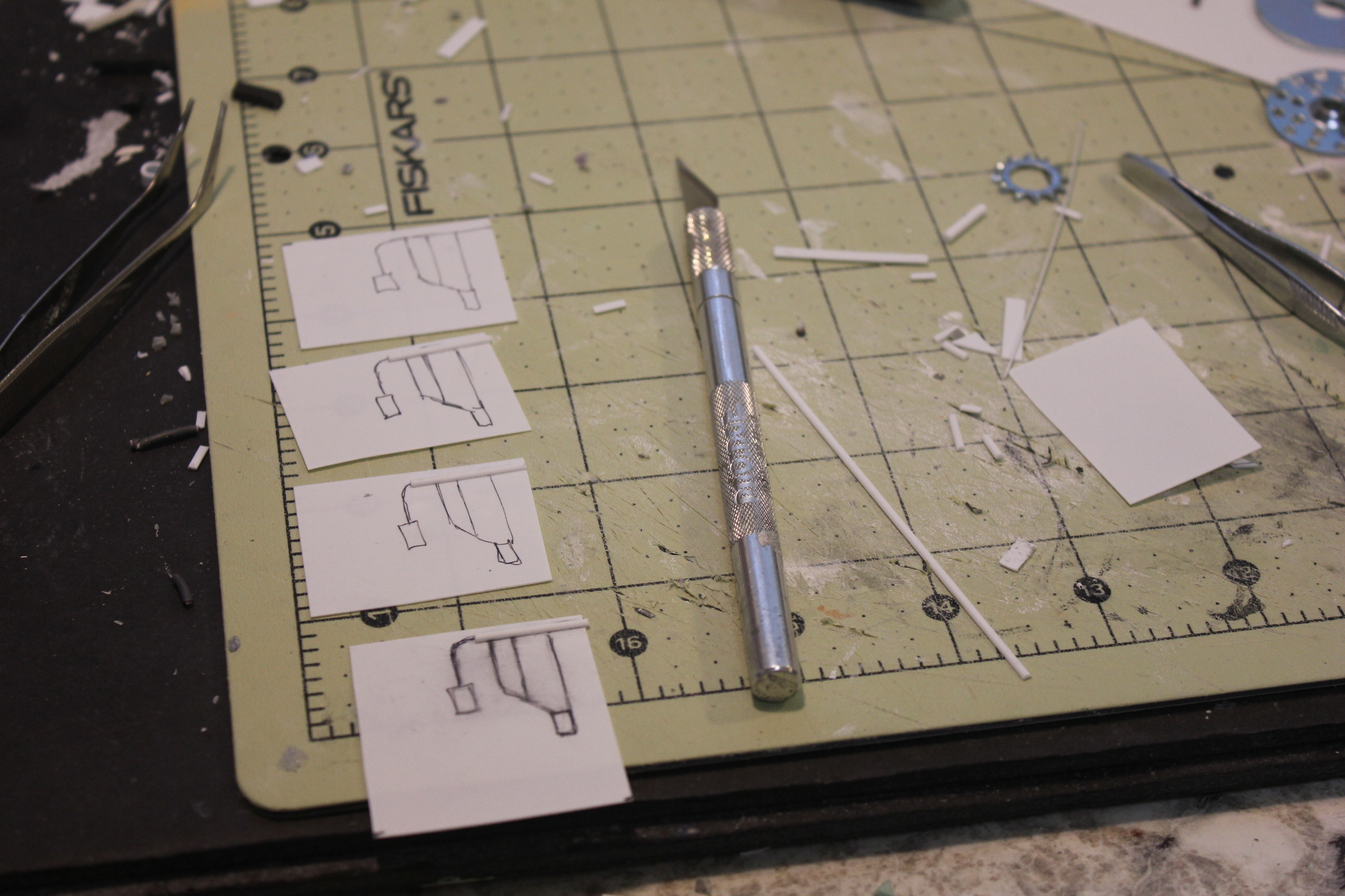

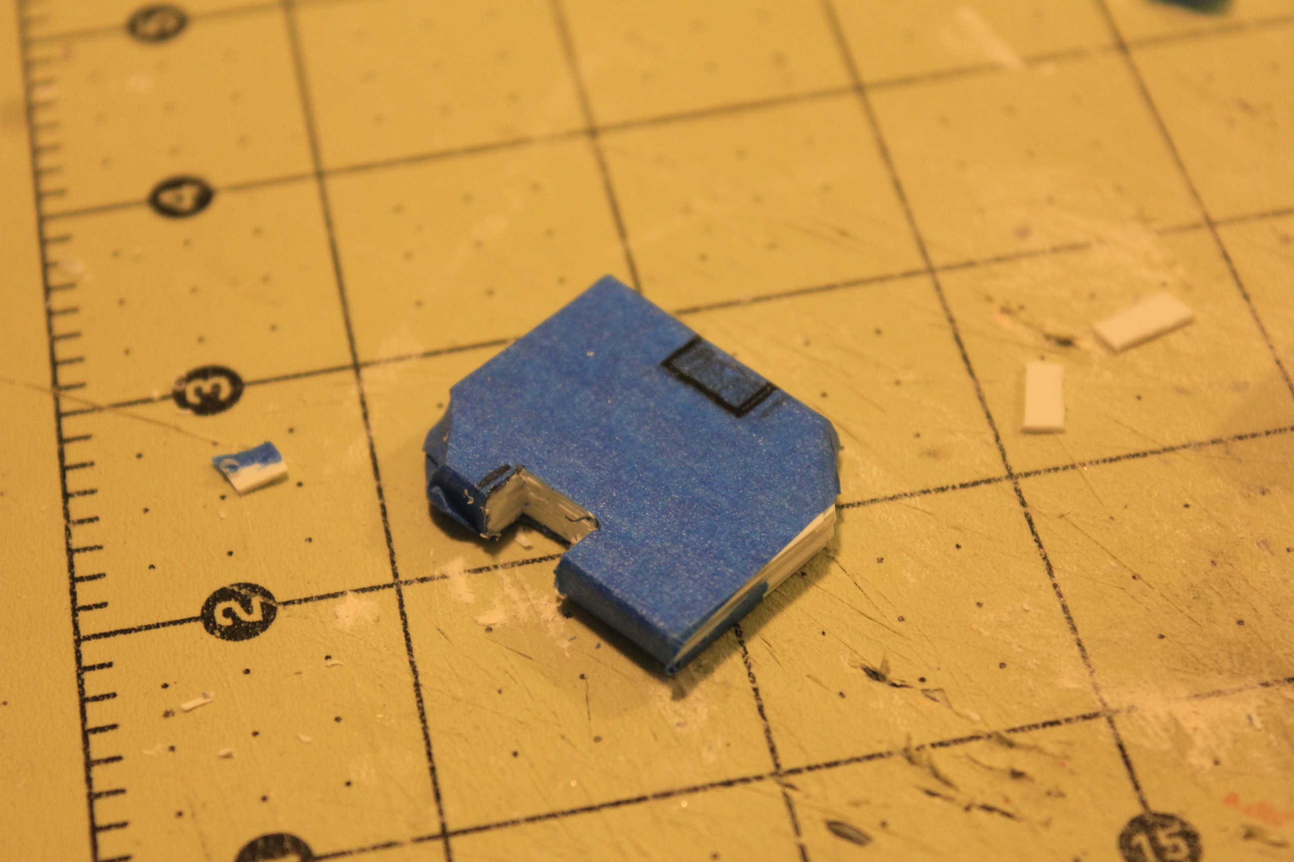

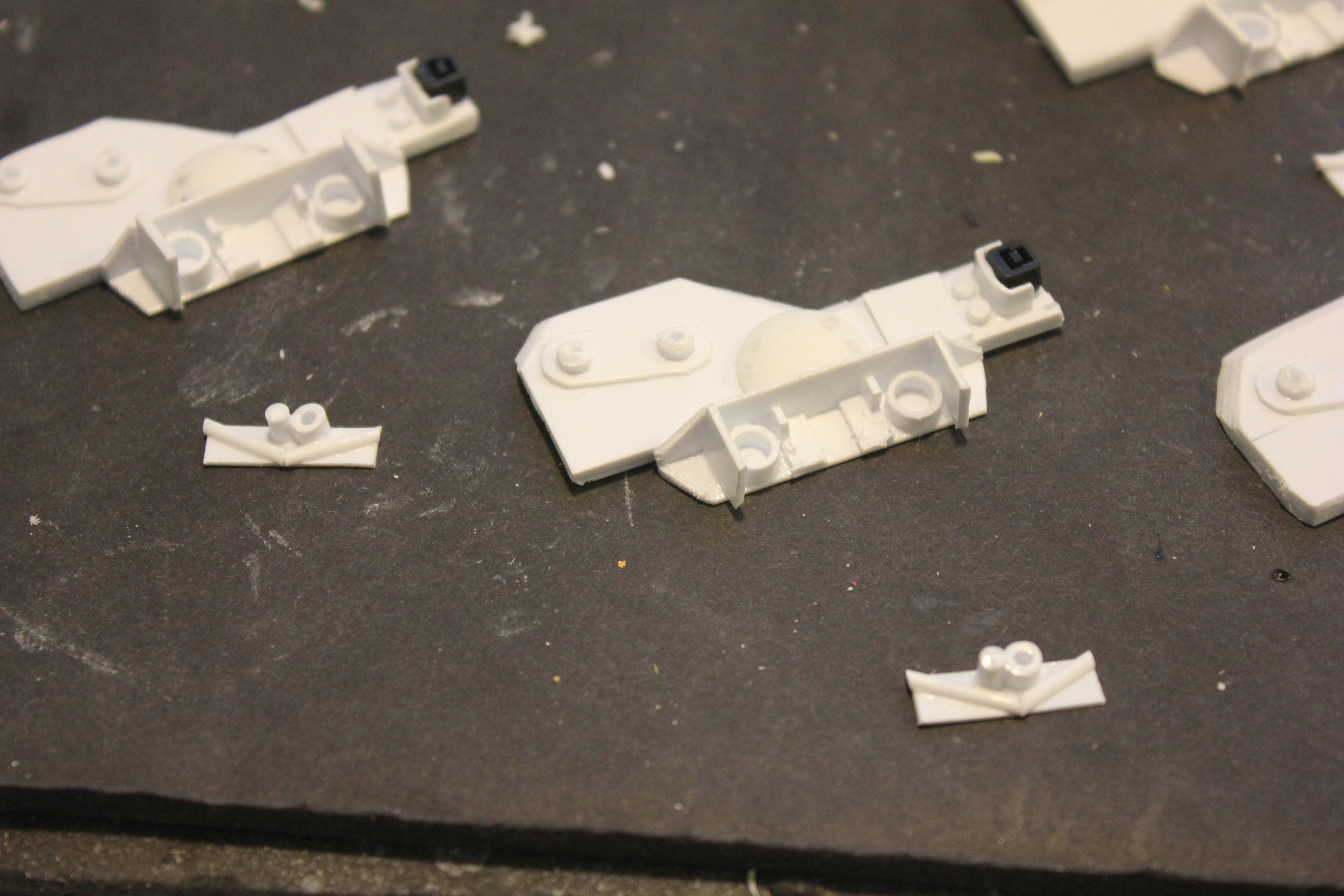

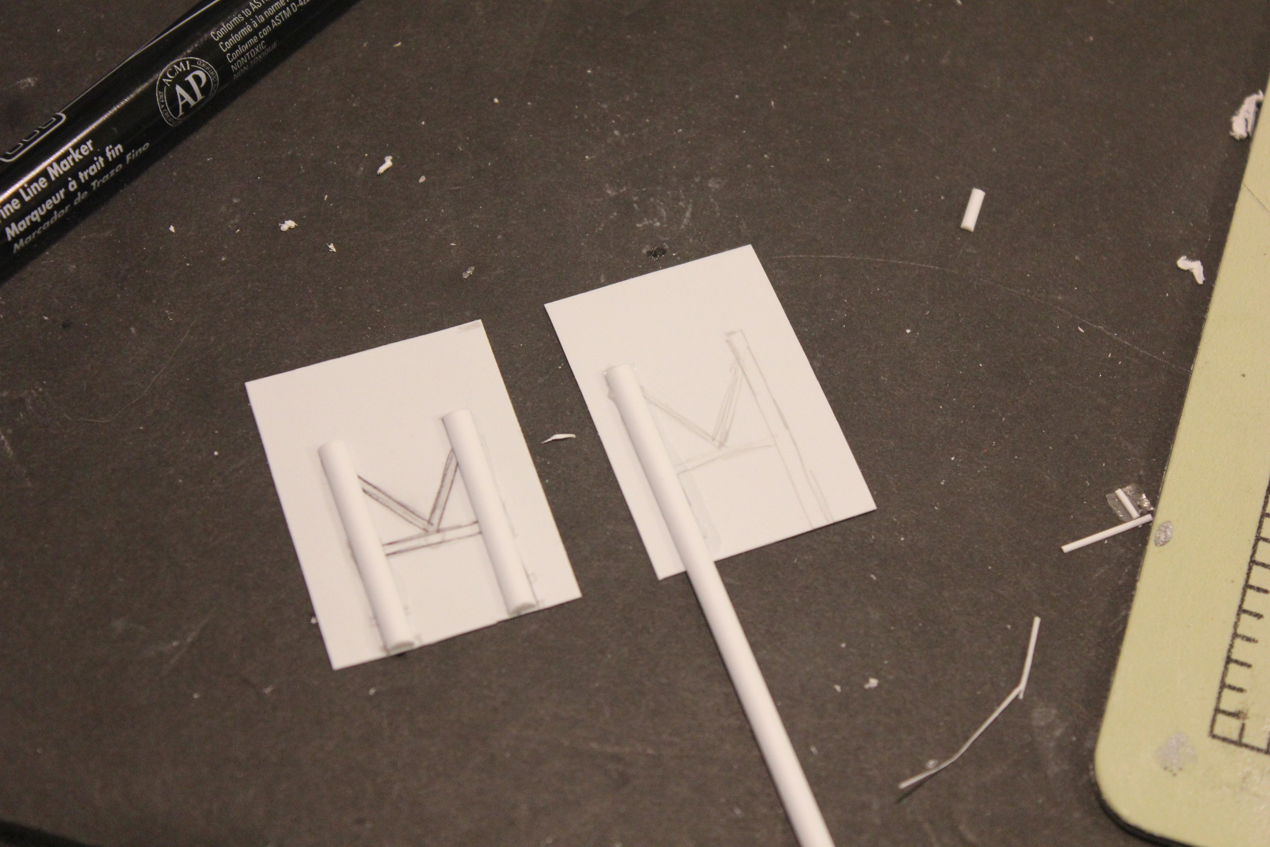

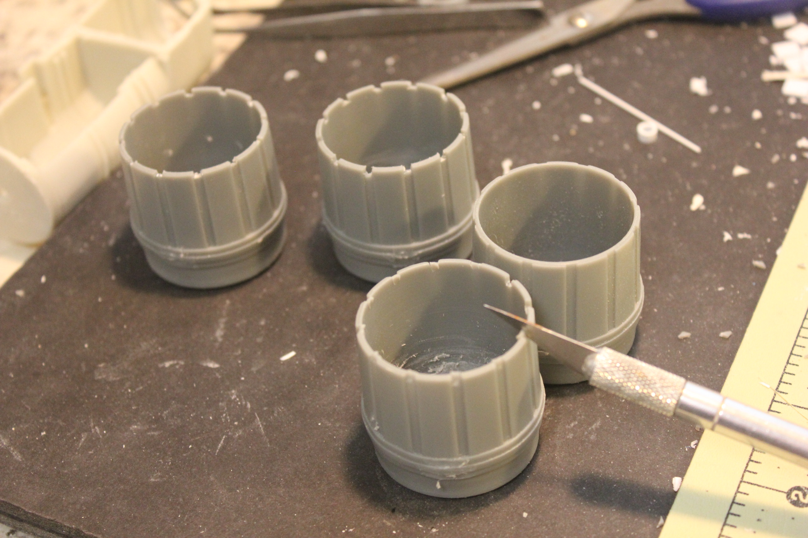

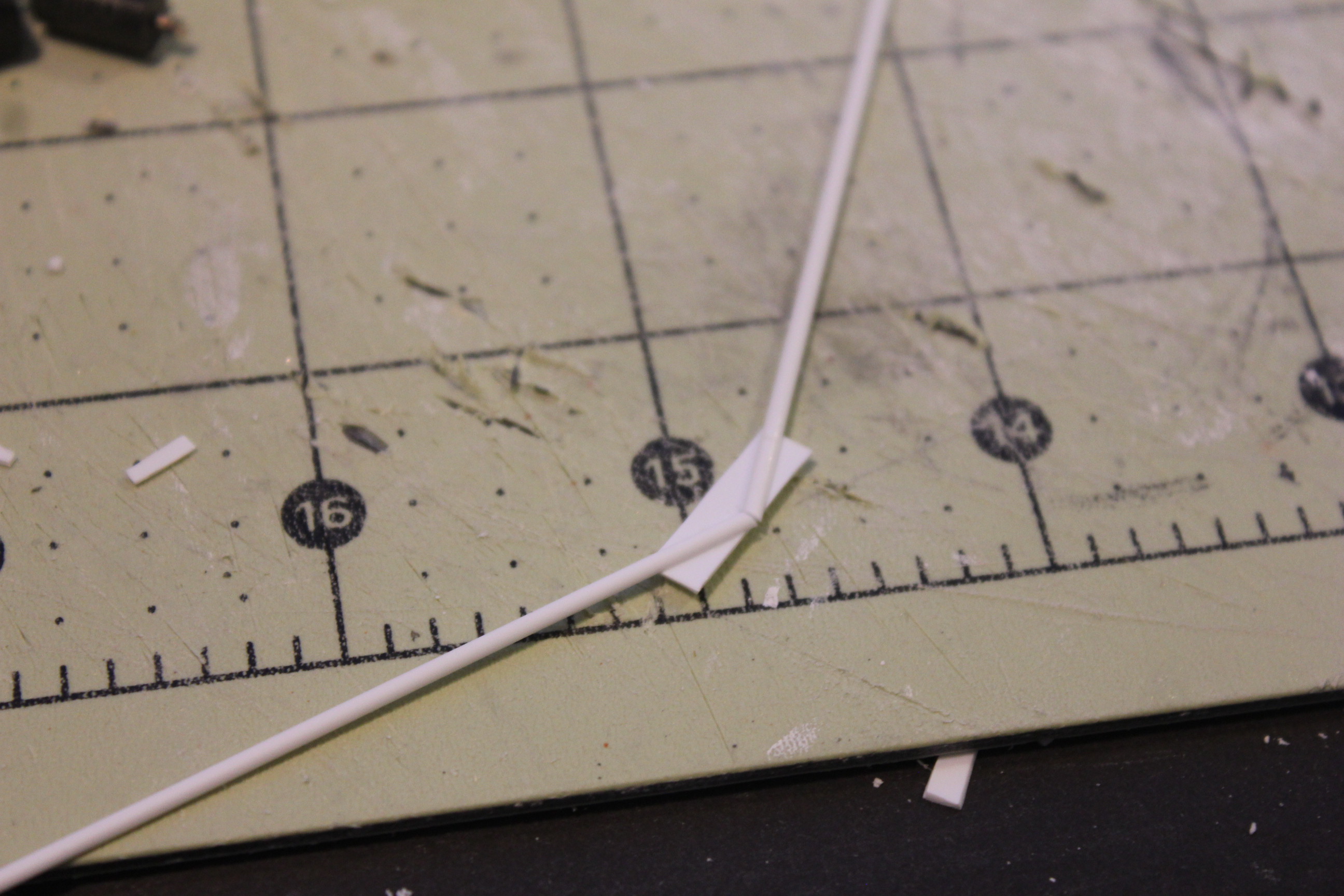

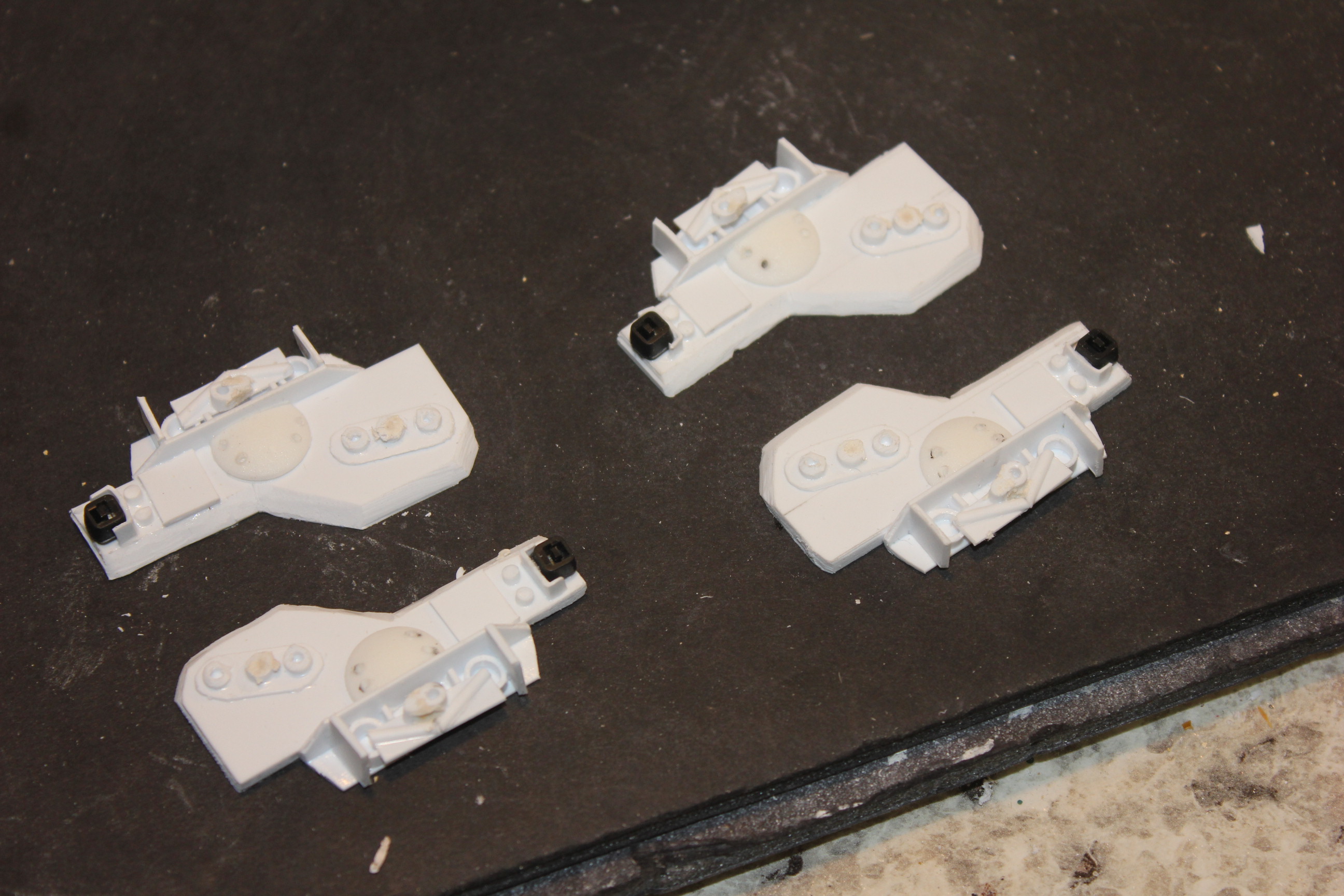

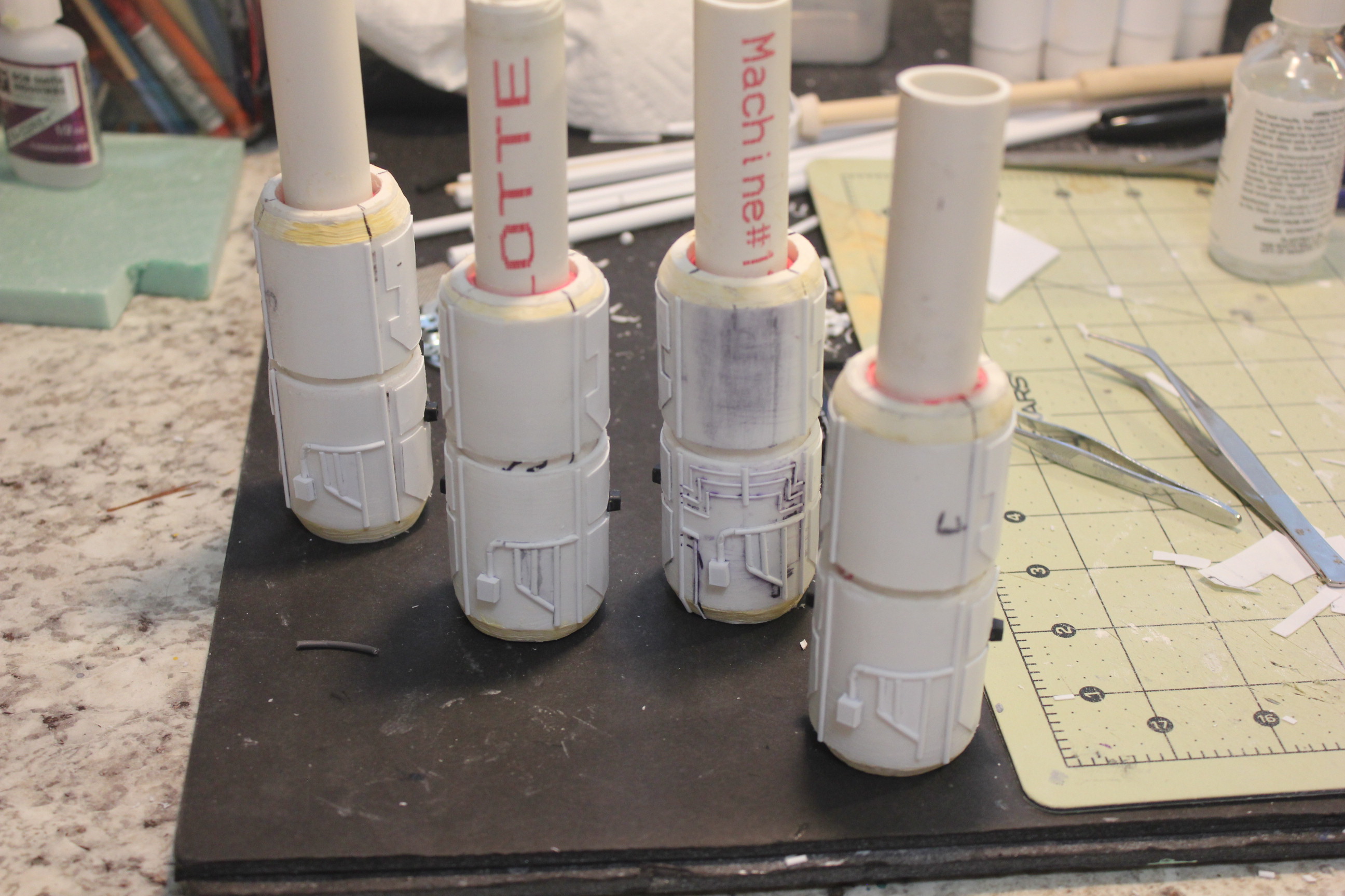

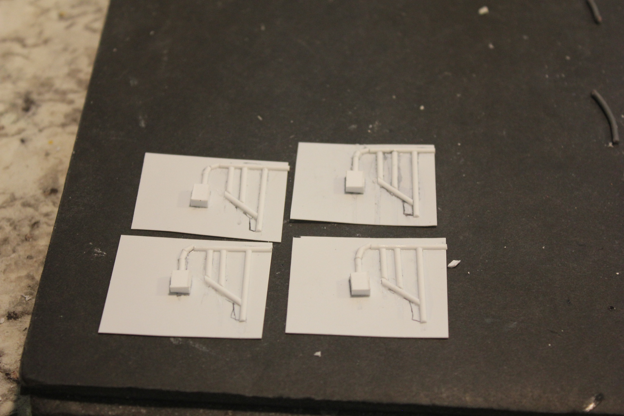

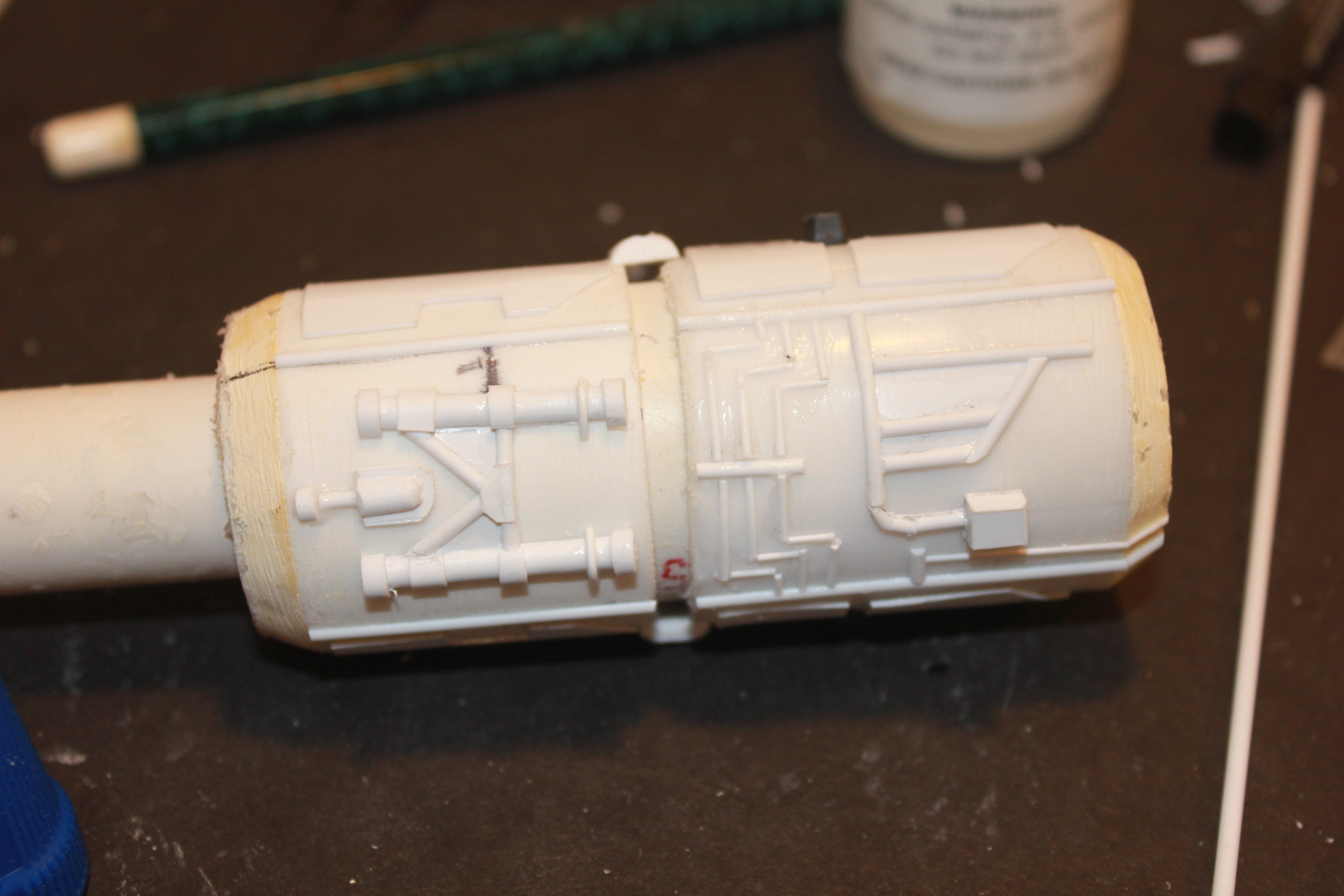

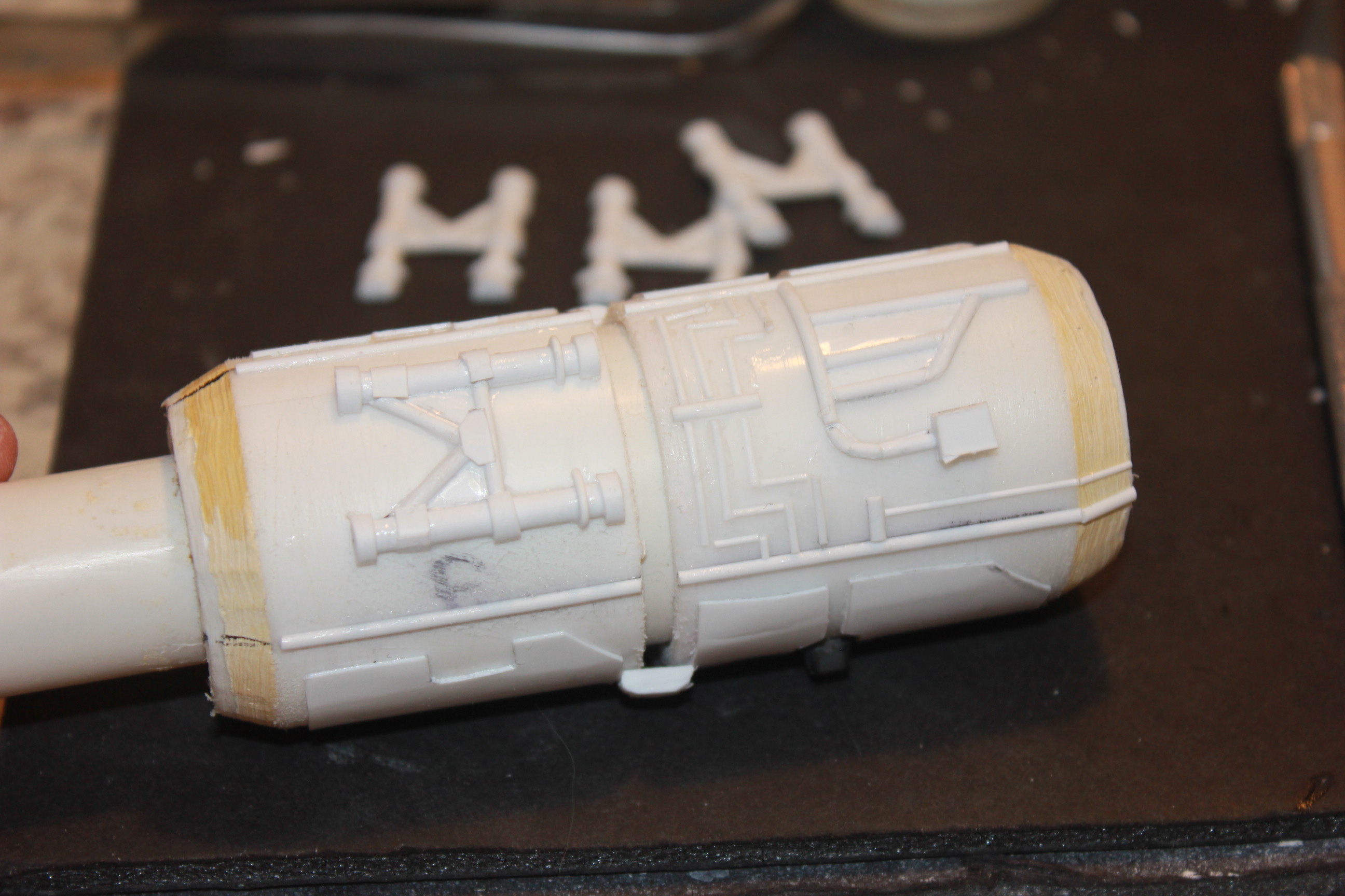

quick update...
still working on the engines.
since I haven't ordered any mold making materials yet, I thought I'f just power through making this foursome.

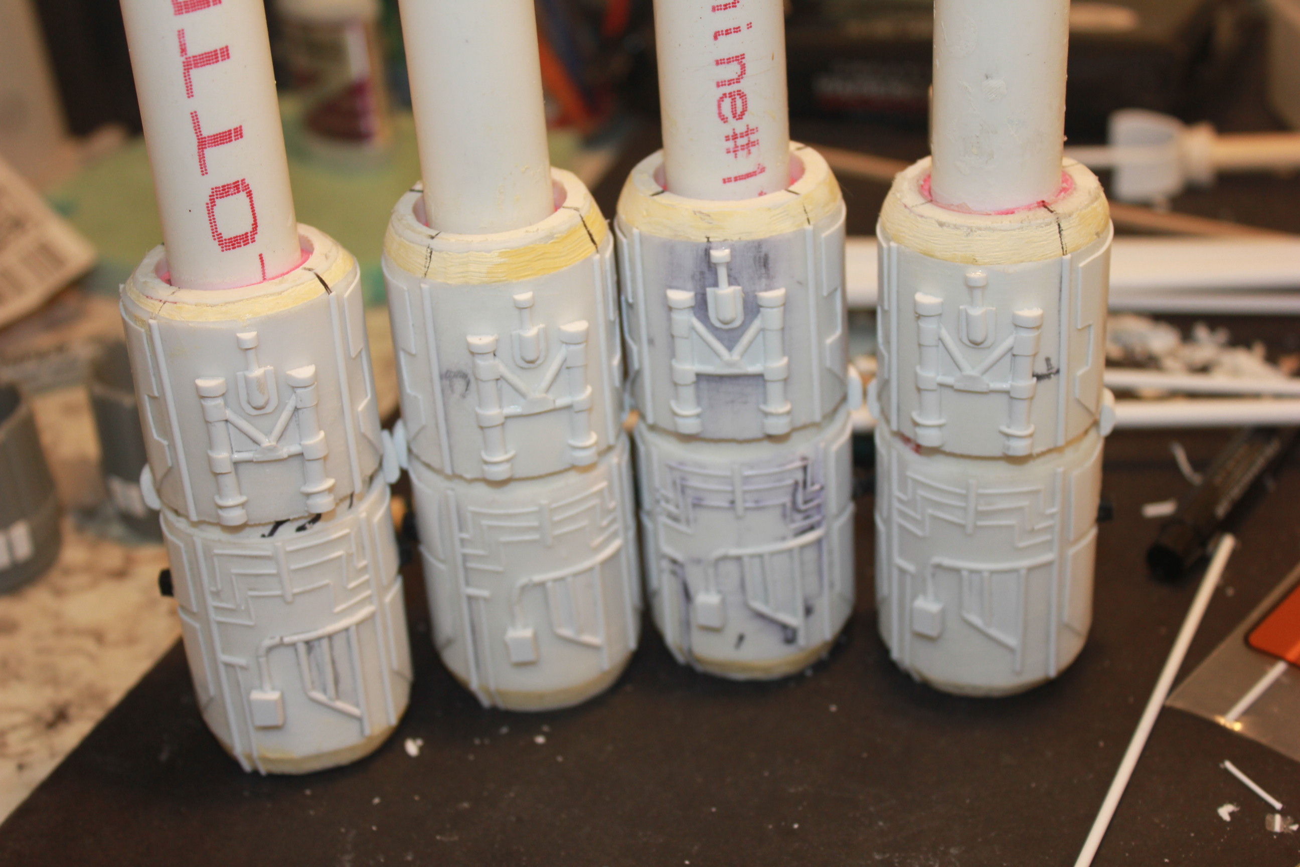

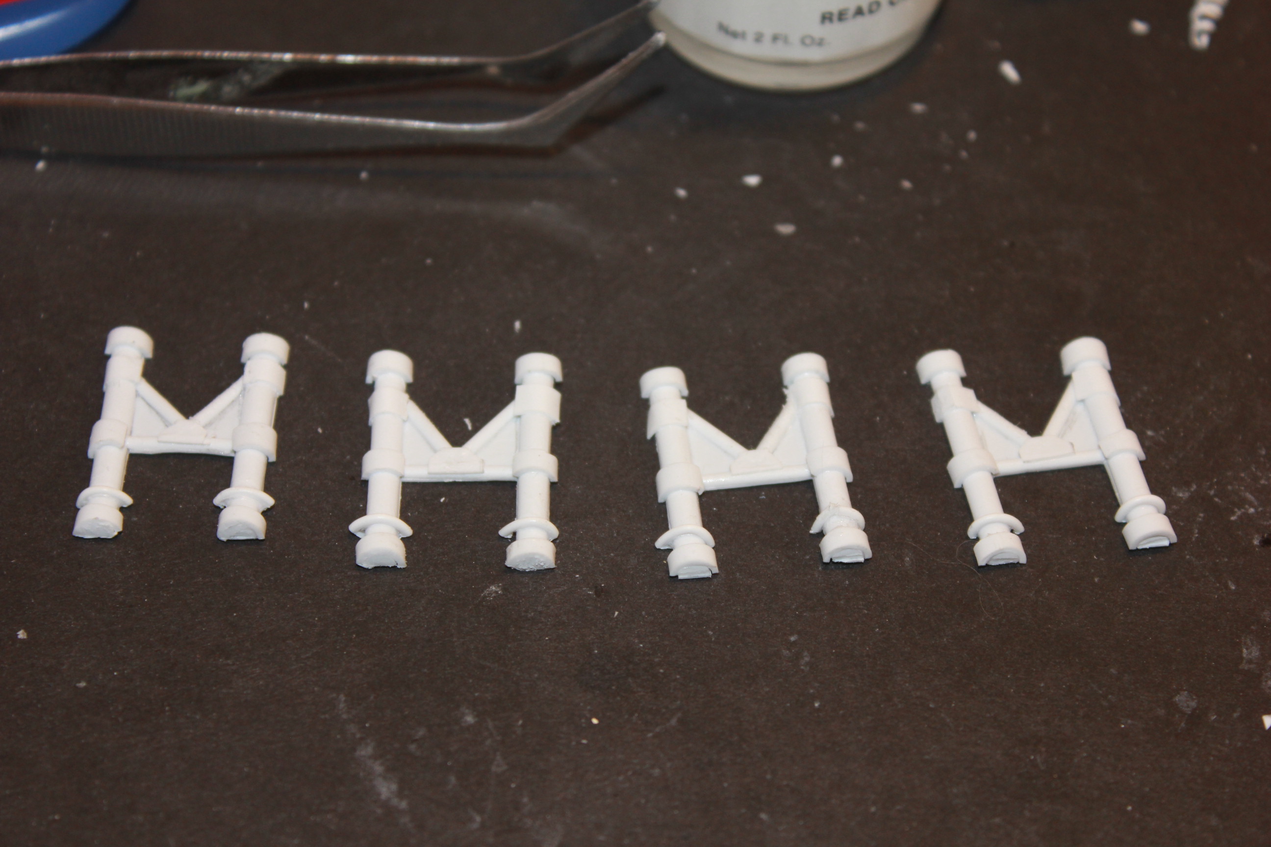

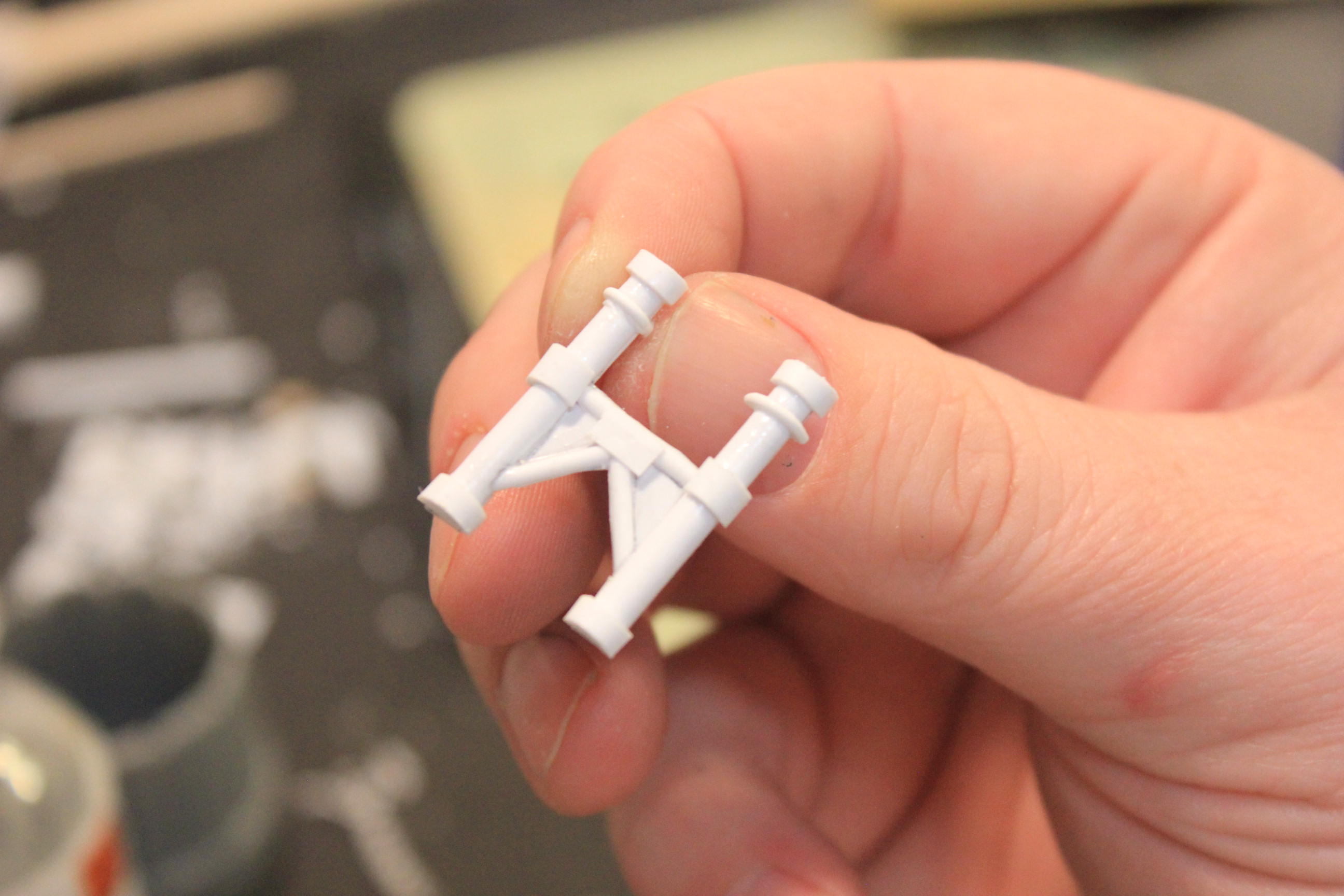

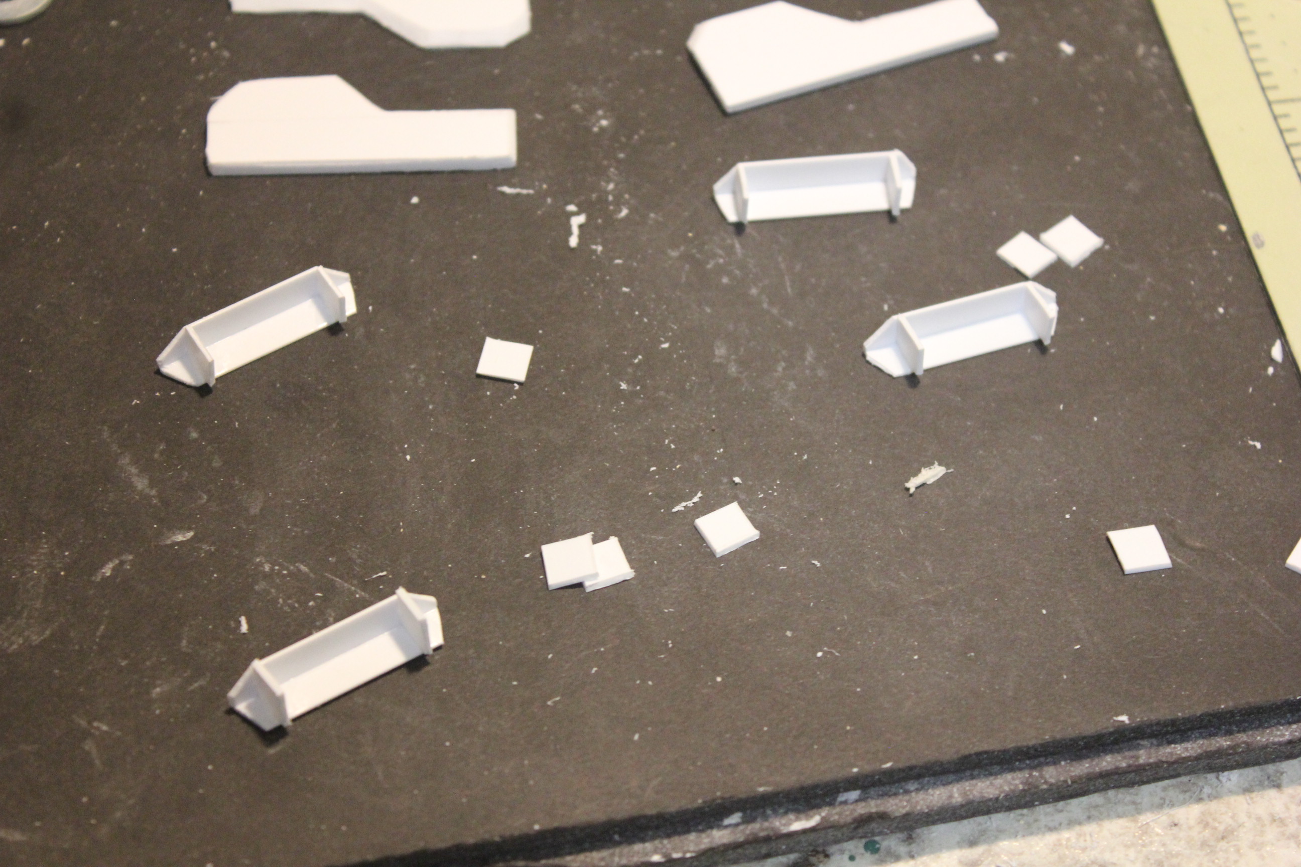

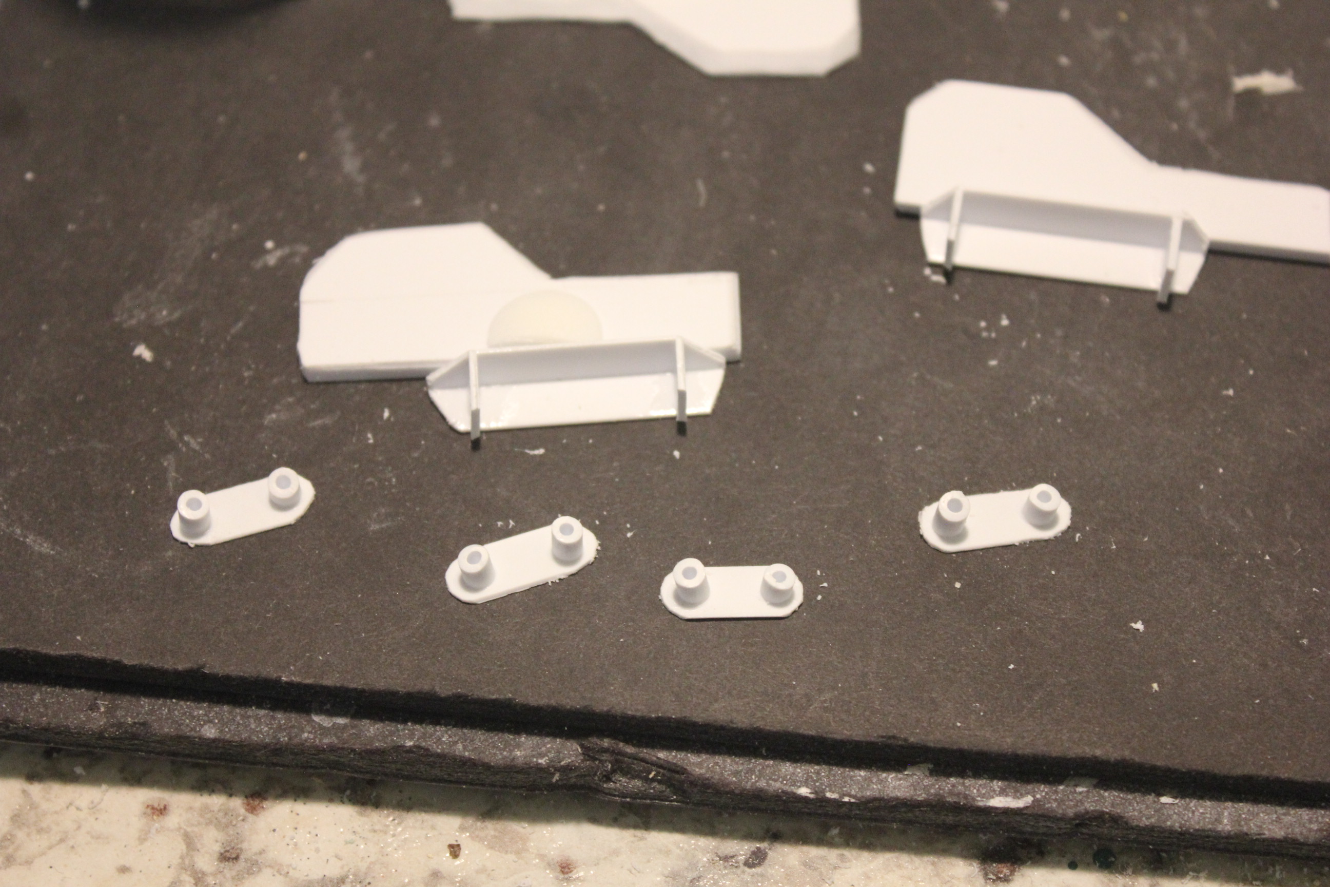

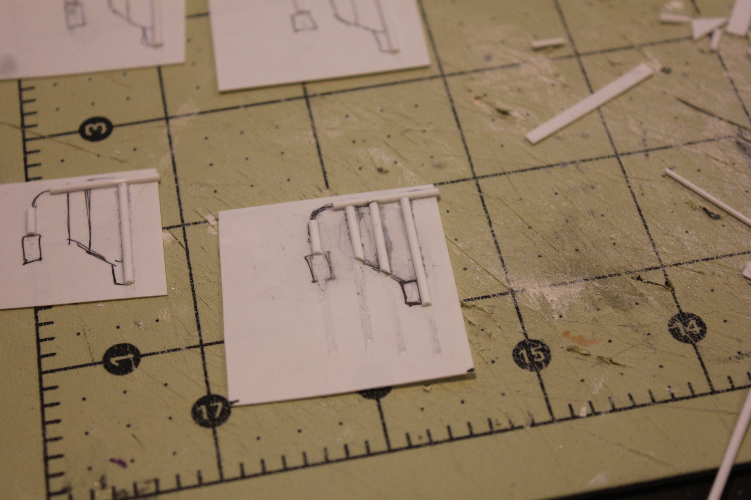

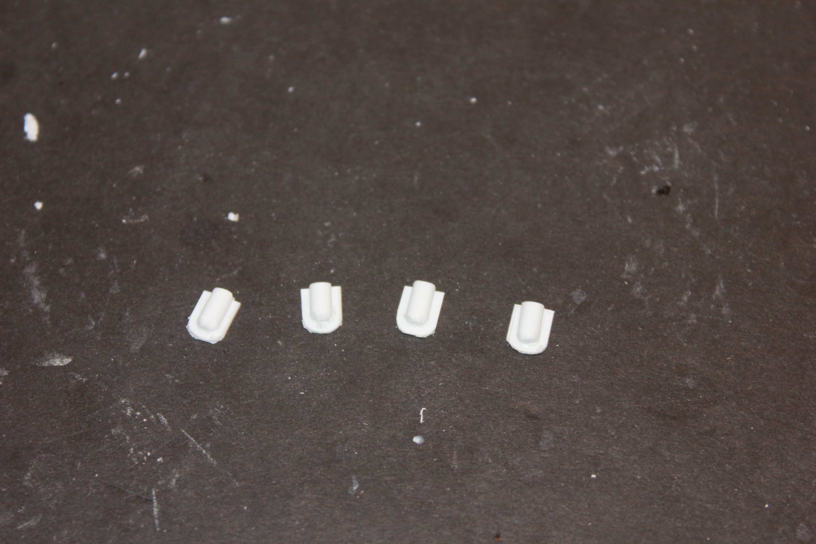

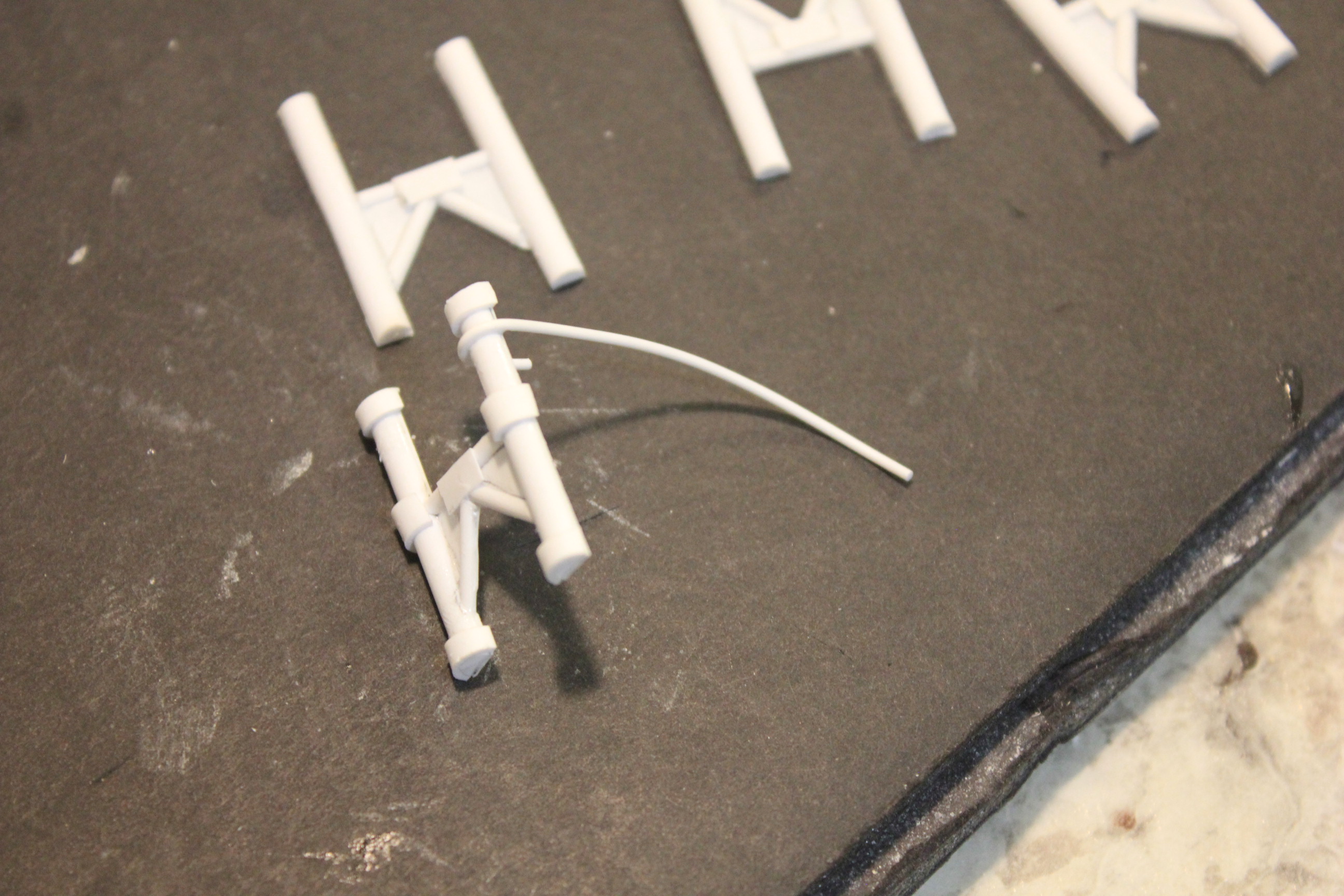

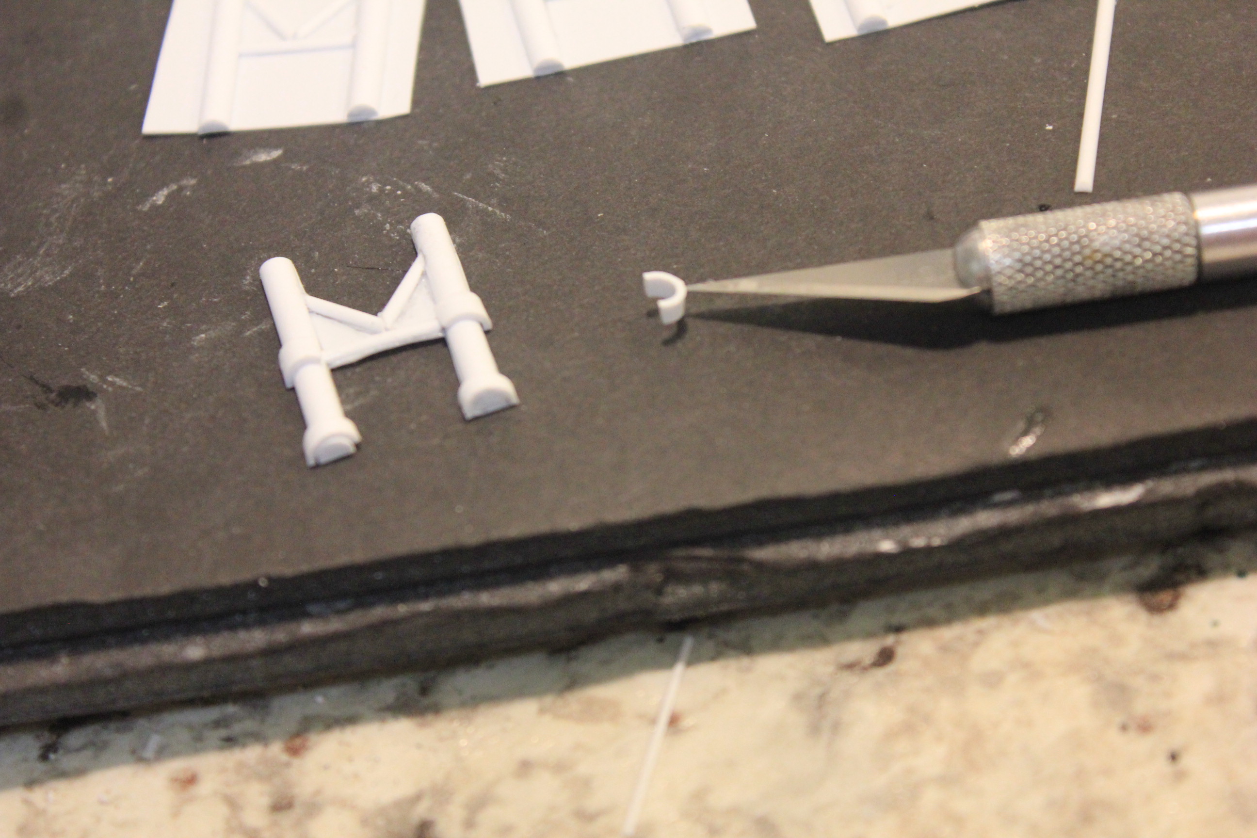

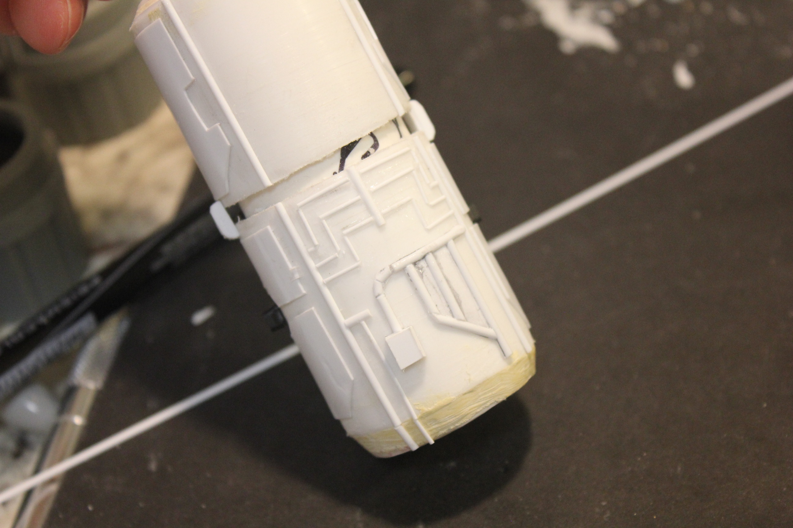

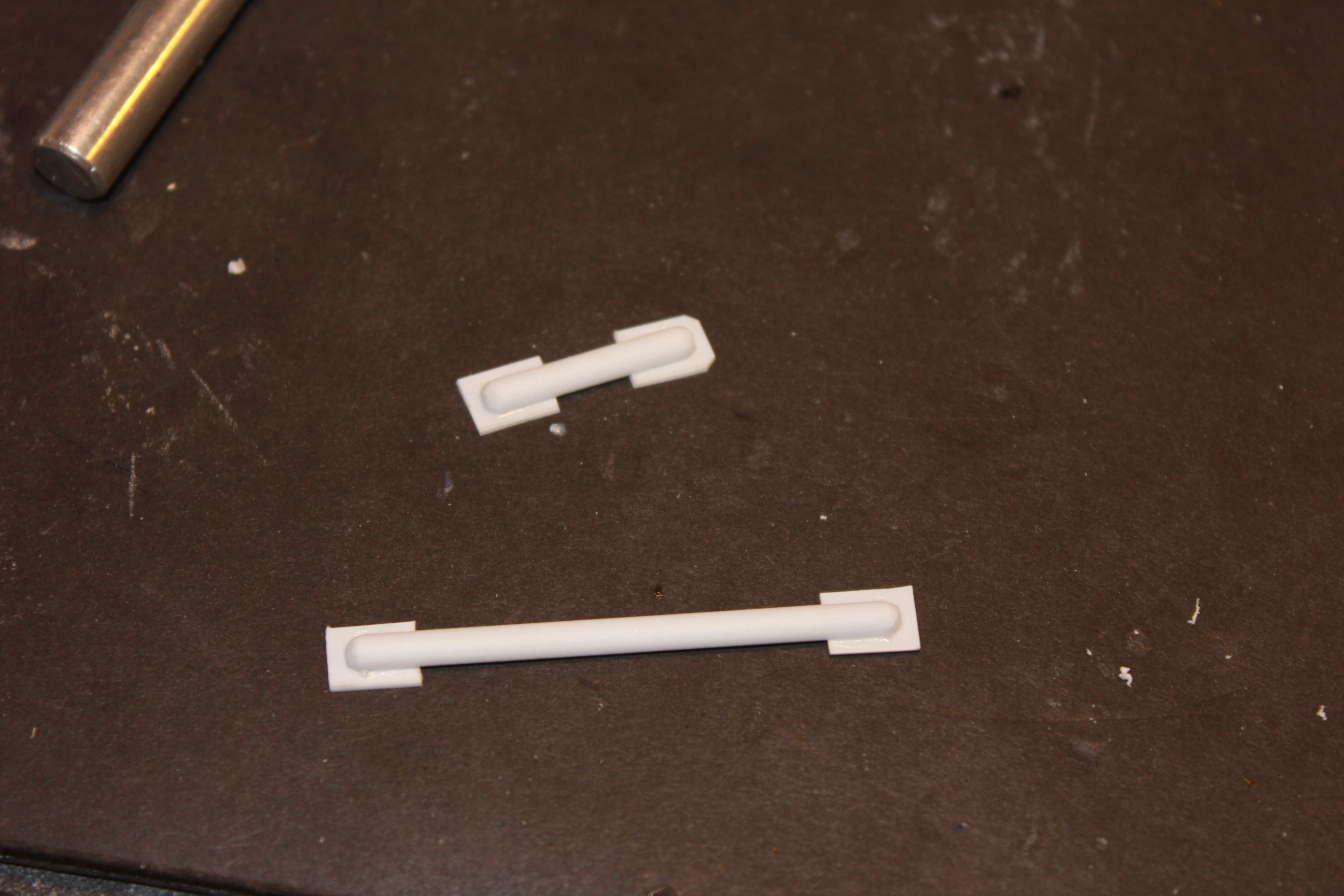

half round styrene
zip tie heads and wire

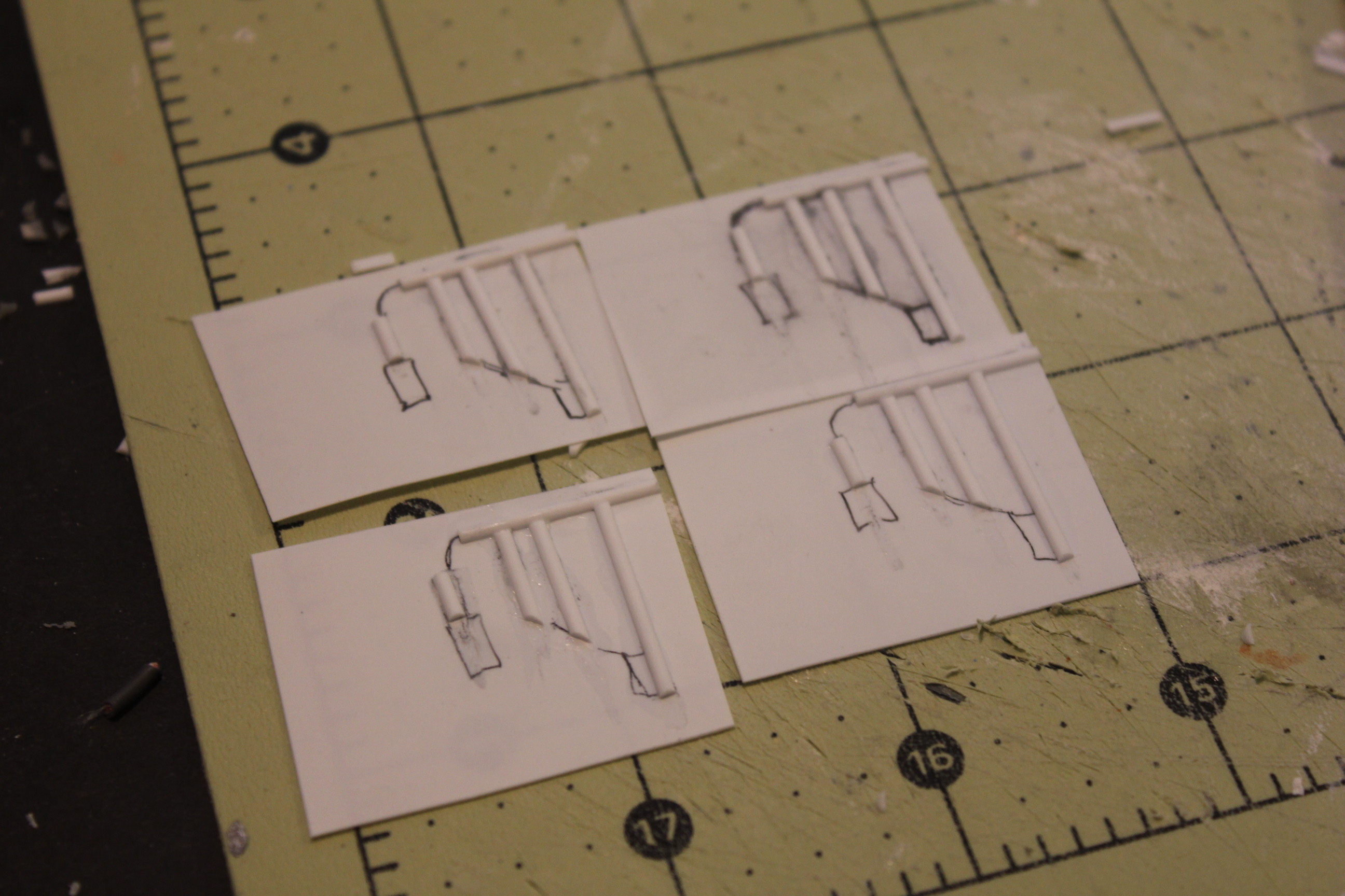

duplicating x4

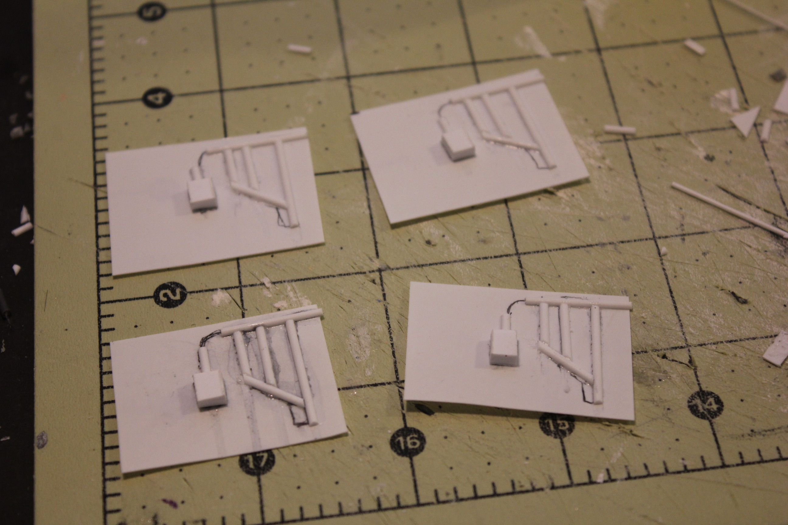

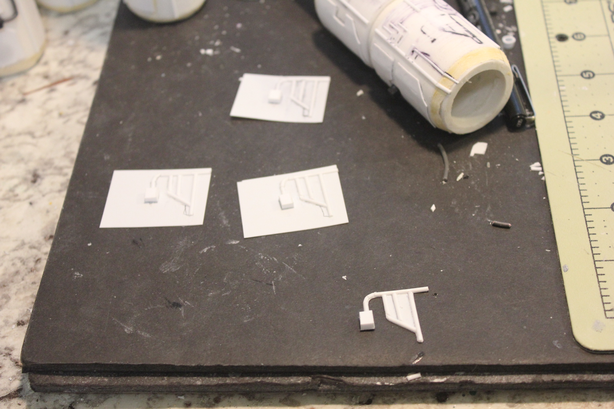

used a super thin sheet of styrene to hold my details together
filling in the pattern

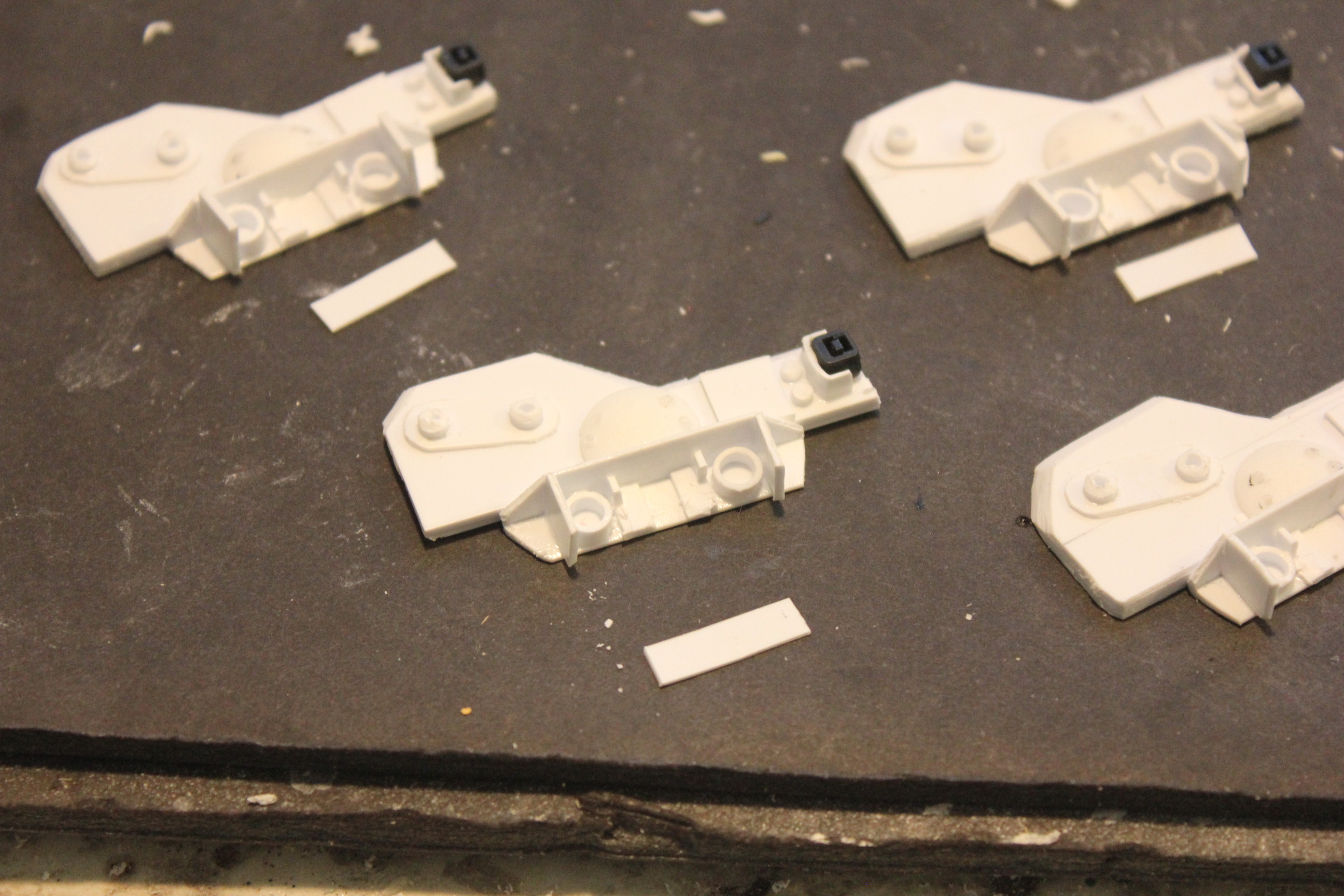

again, I WILL be making molds for anything else I need multiples of....
cutting away most of the sheet and then gluing to the details to the engines

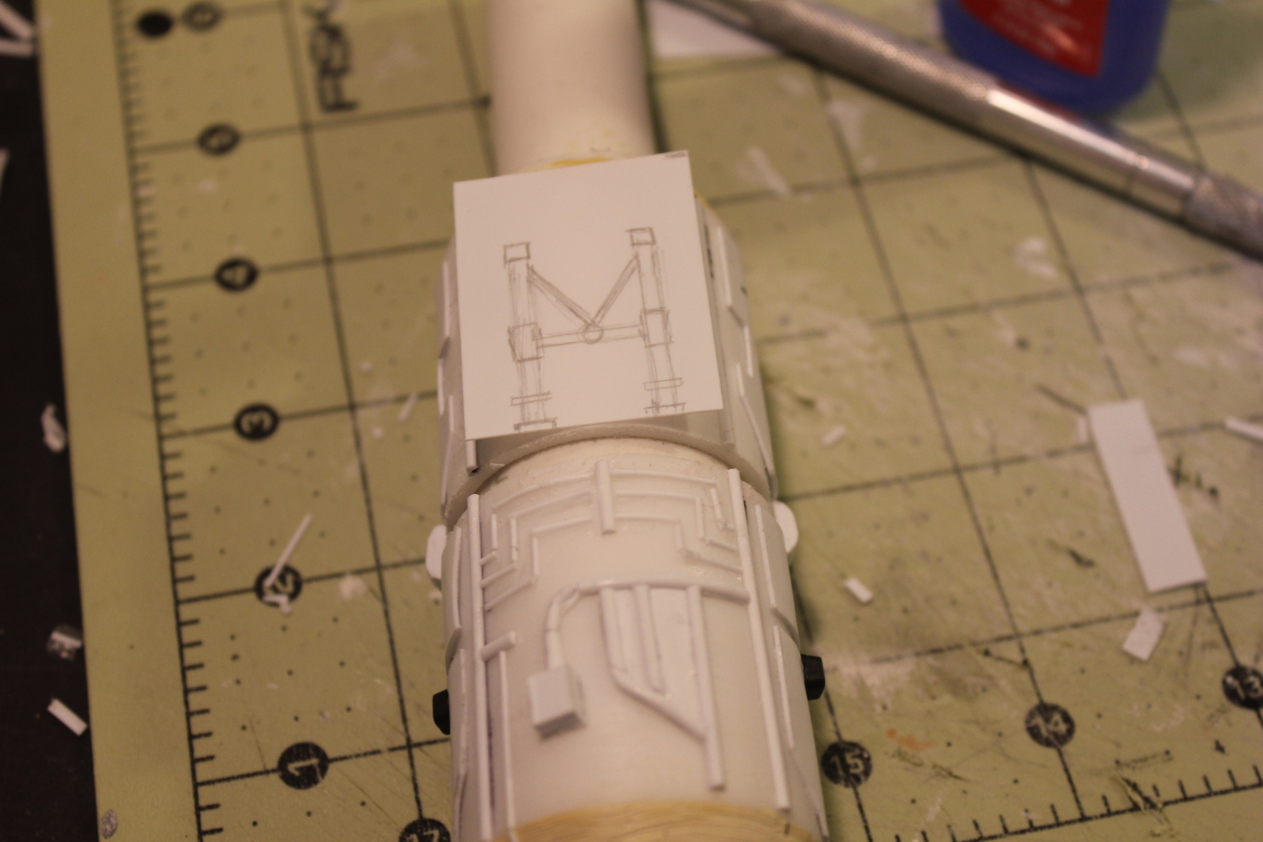

adding some more details

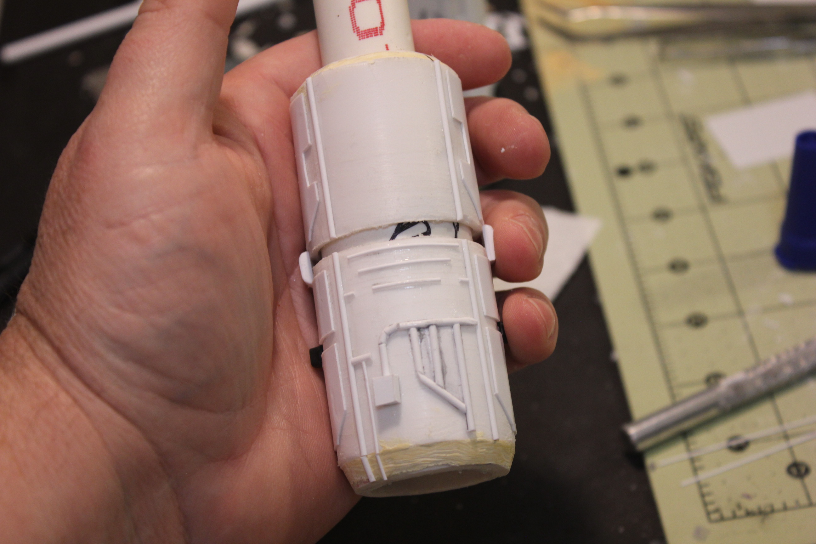

starting to come together....
now that I'm getting a little more comfortable with this process, I'm much quicker
again, using same technique

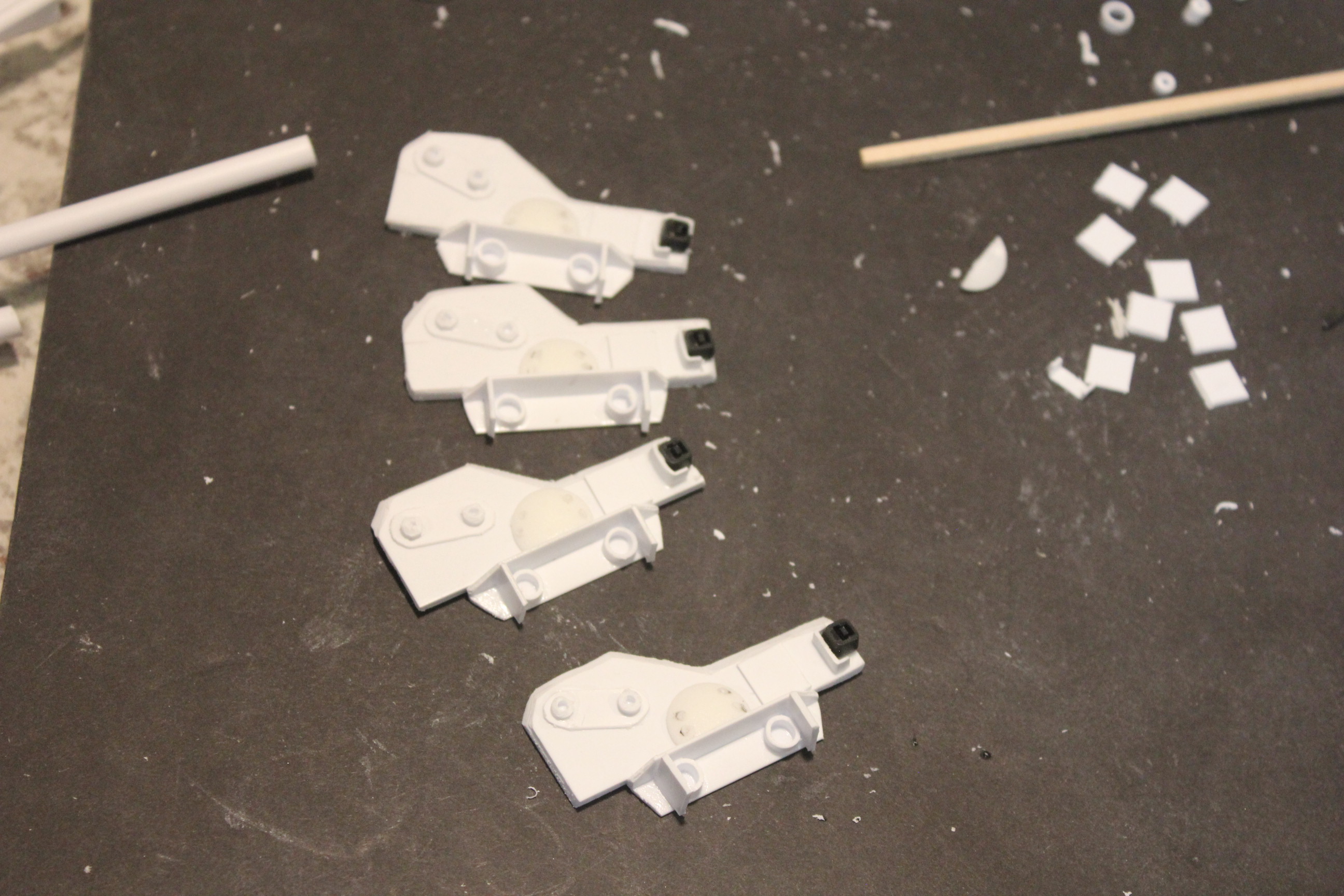

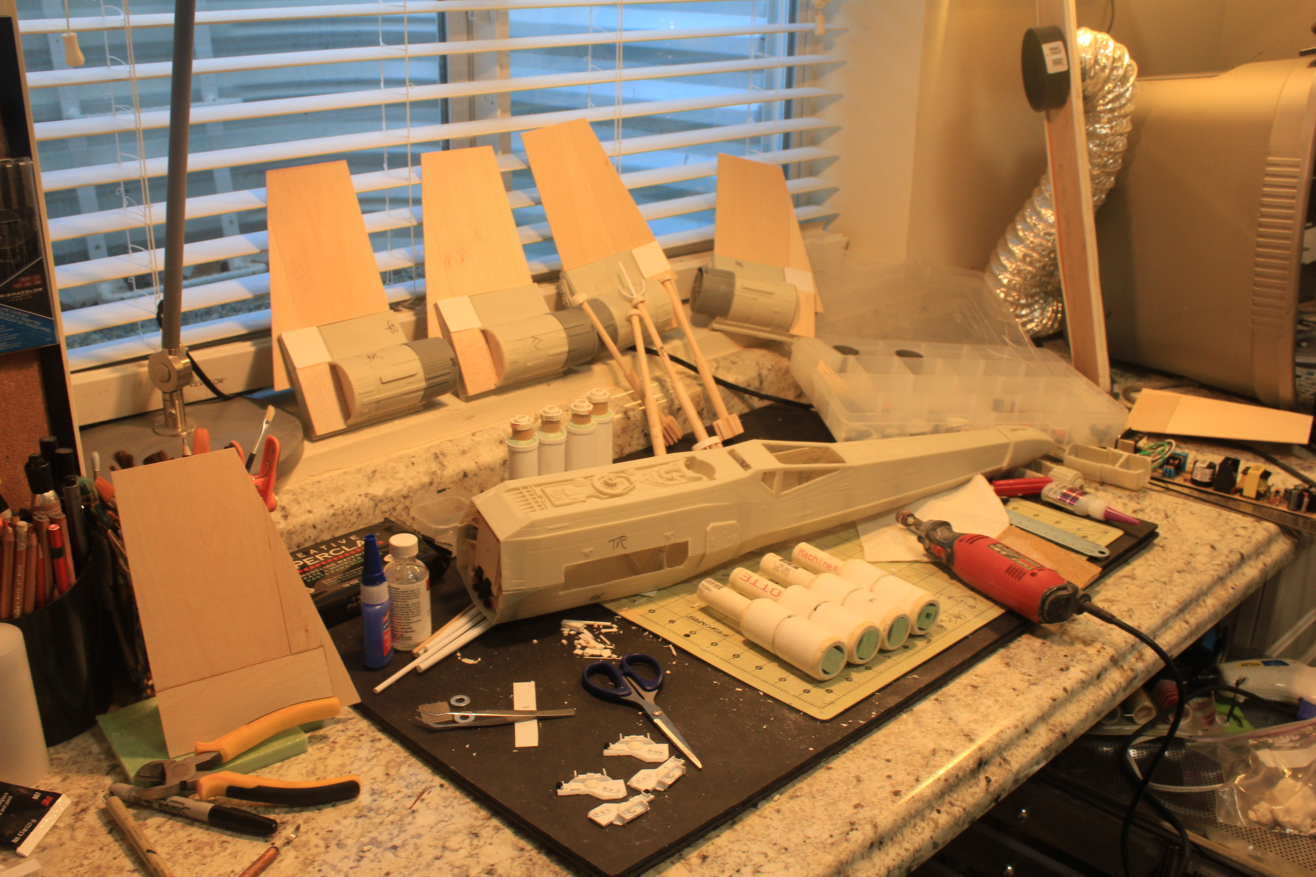

wide shot of my mess
cut round tubing in half
used small round rod for "clamps"

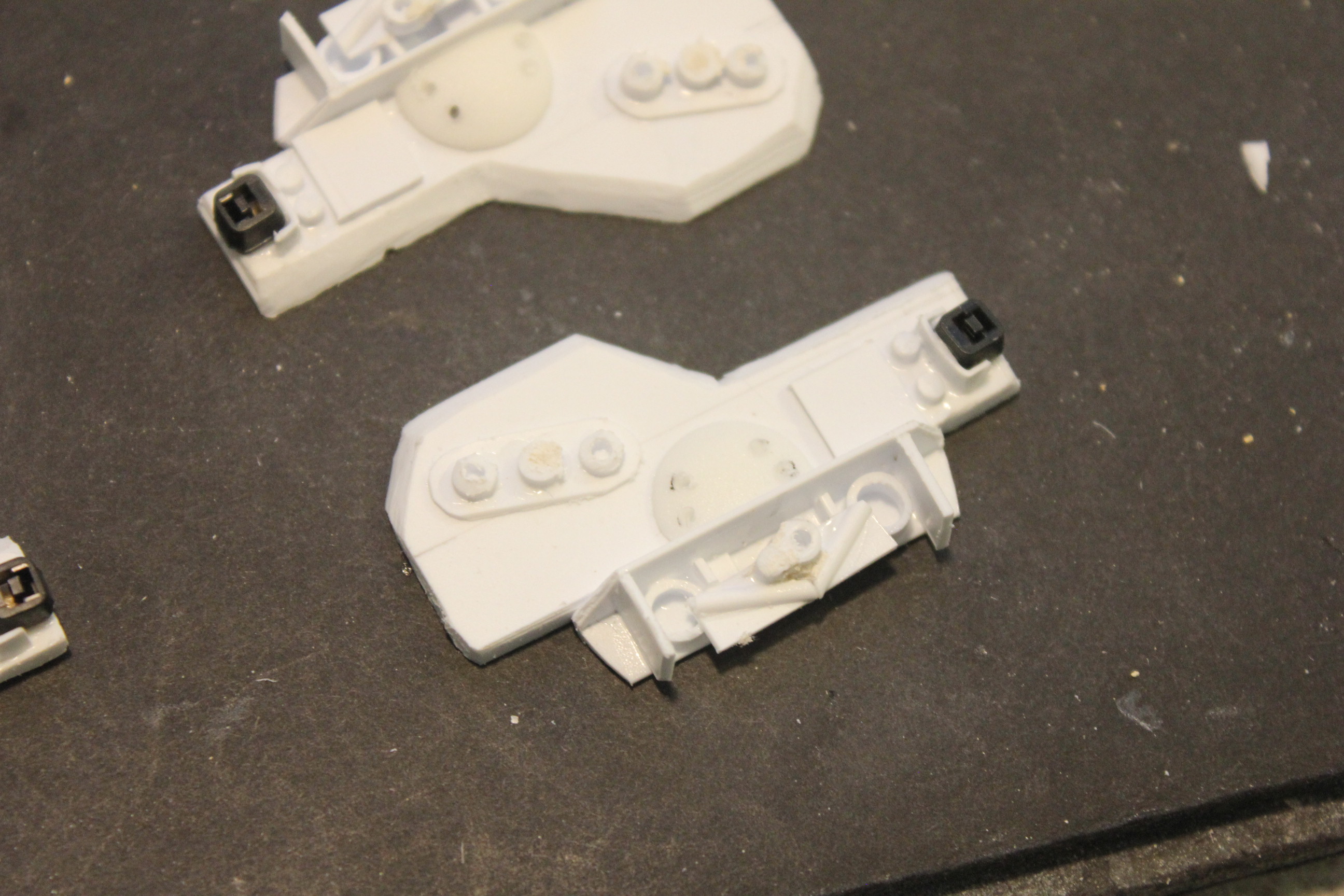

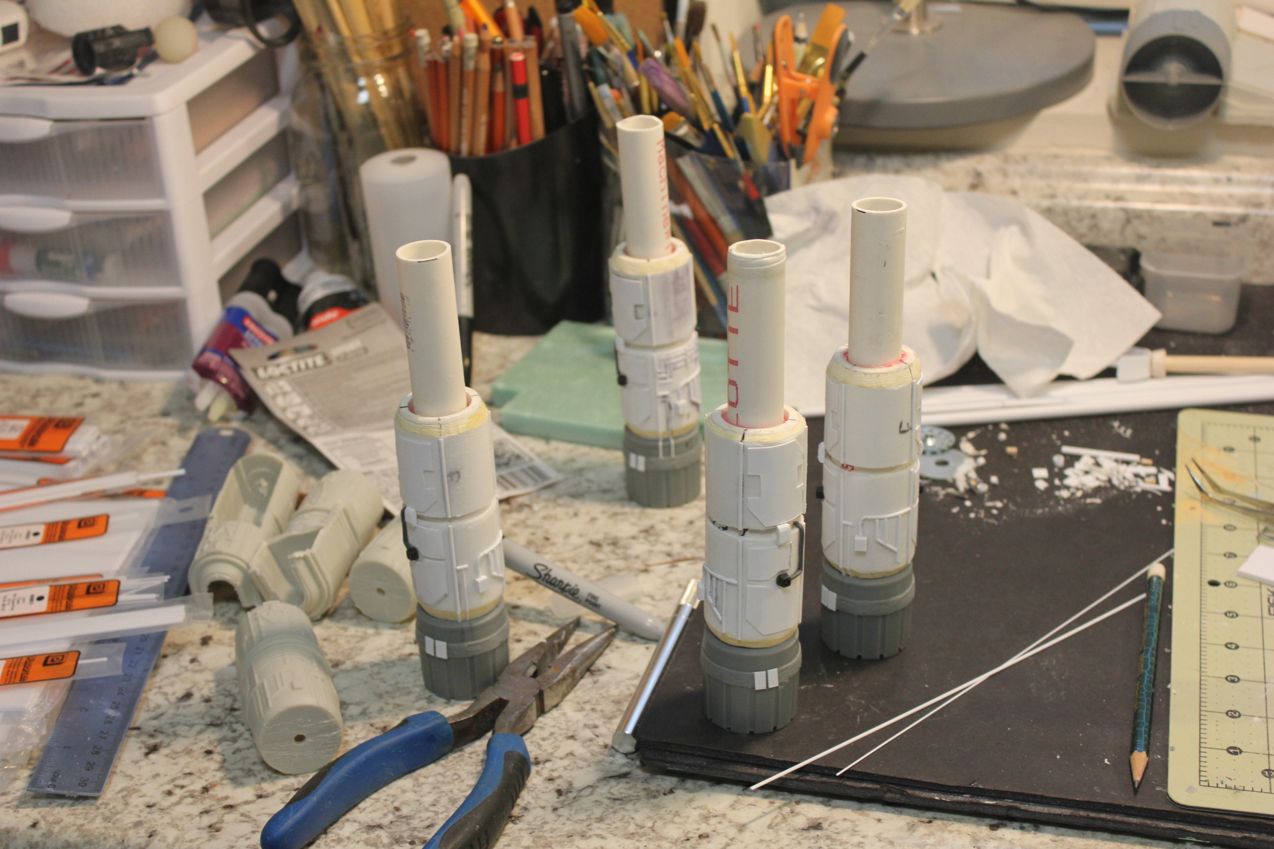

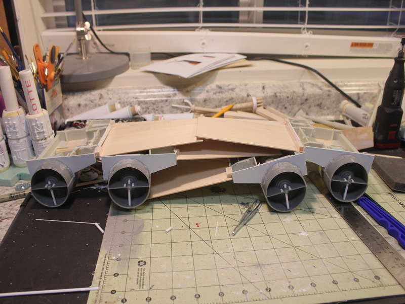

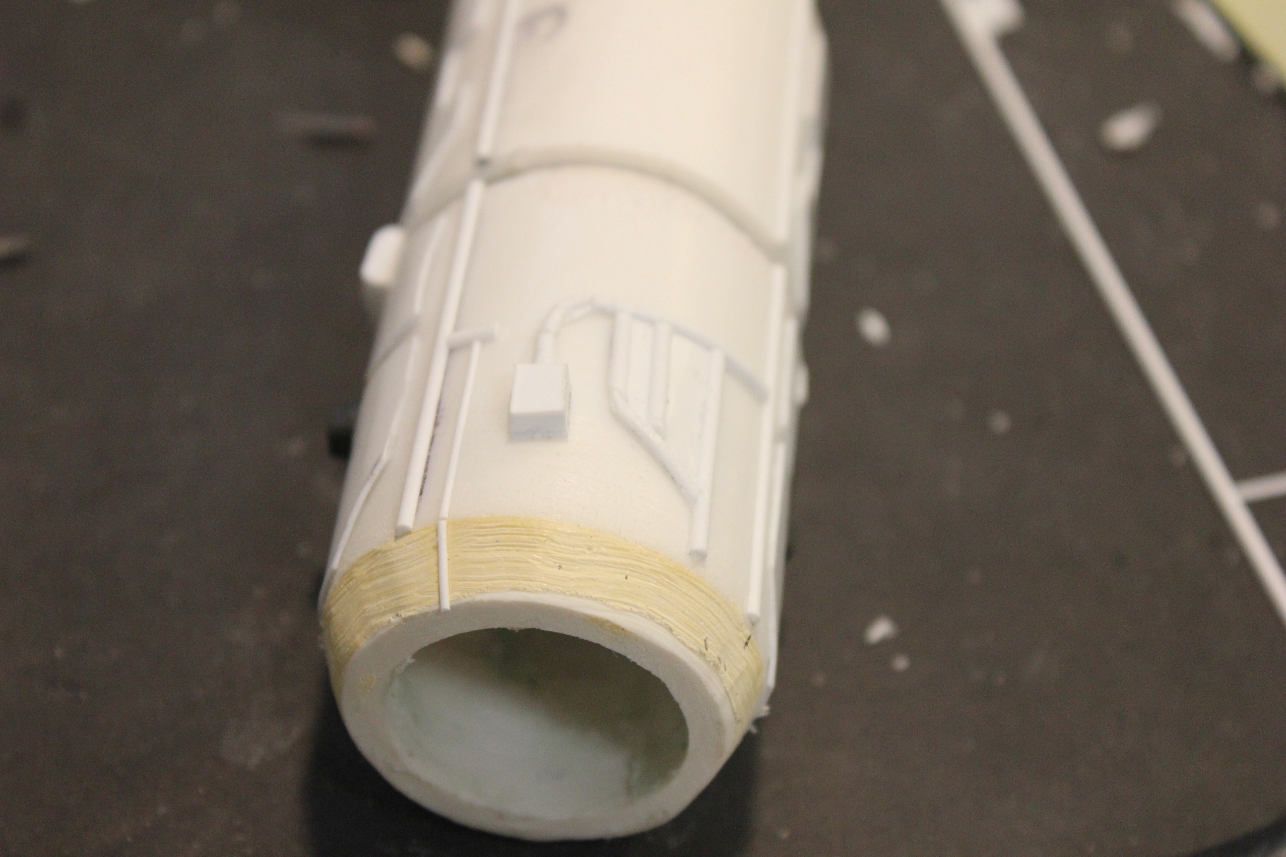

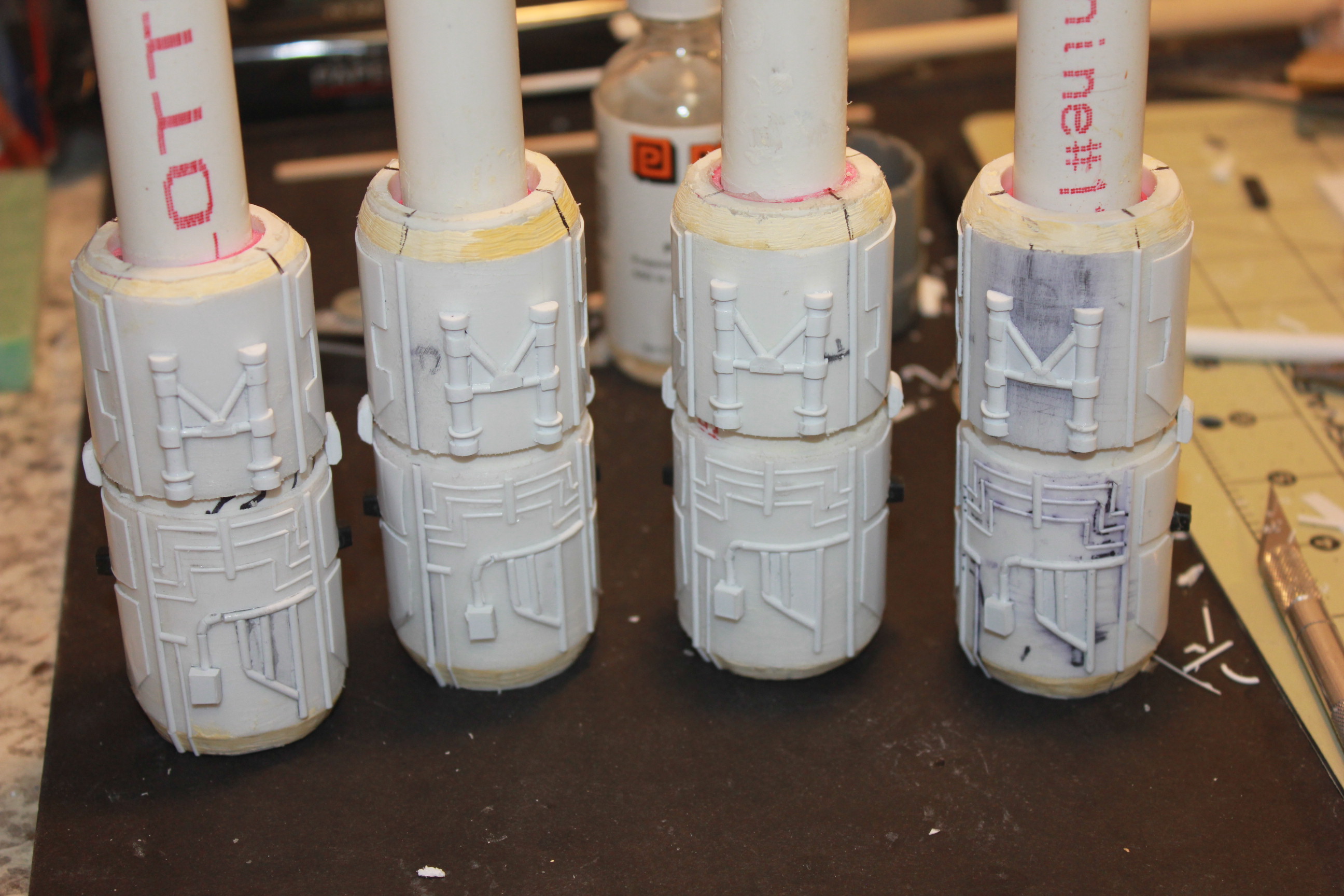

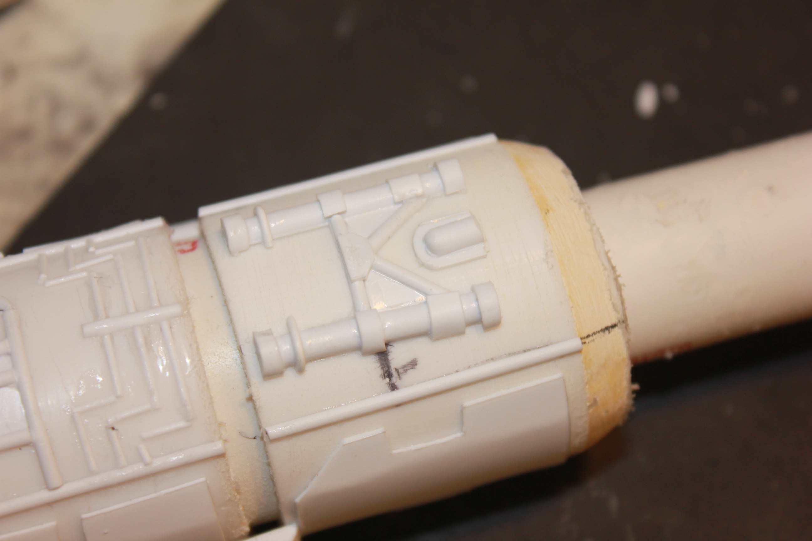

engines con't....

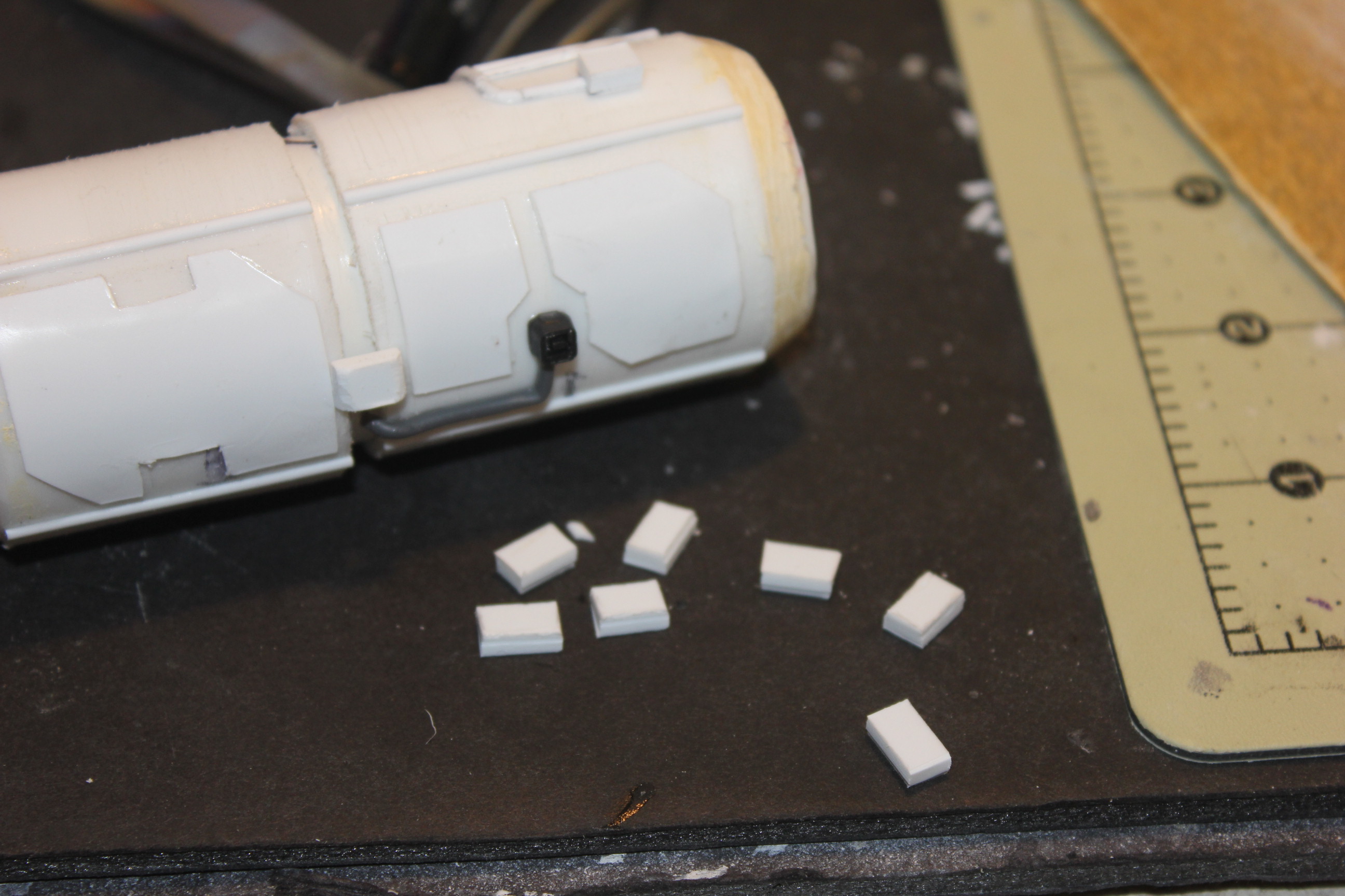

ready for some filling and sanding.
ok, this is where I'm at right now. I tend to jump around from one area to another, so my plan is to stick to the engines, then the wings, then completely redo the cannons, work on the cockpit, led's....man, what the heck did I get myself into?
Anyway, thanks for looking
Pcoz

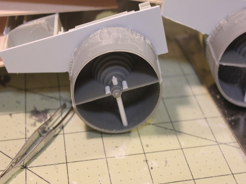

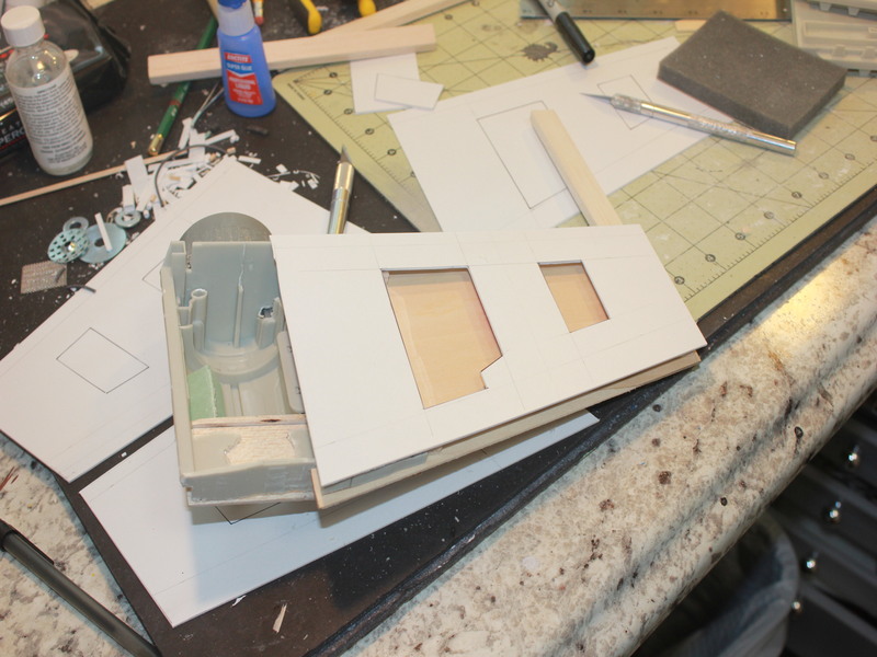

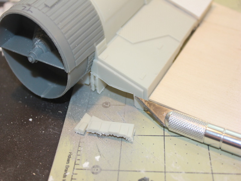

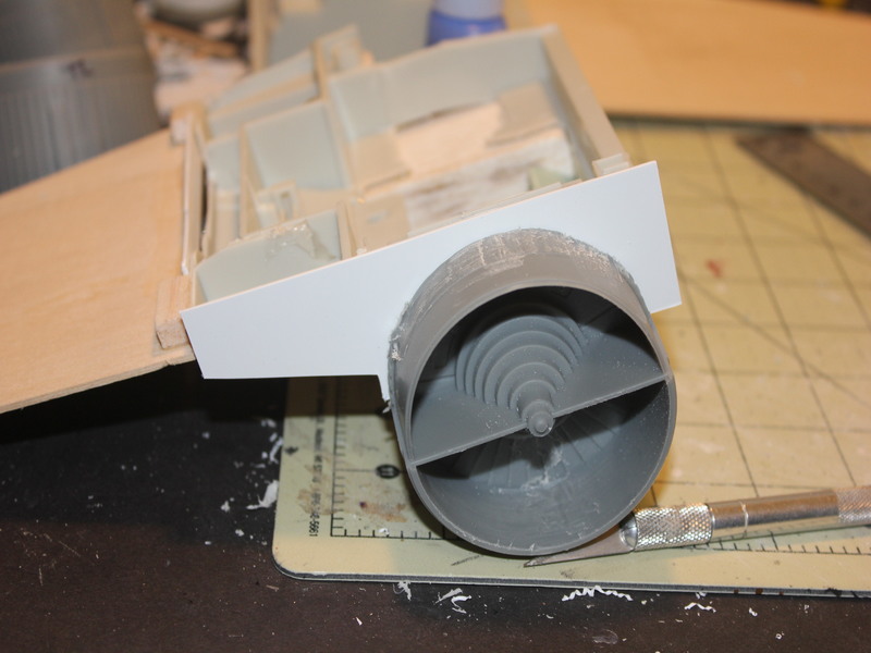

Ok, here we go....

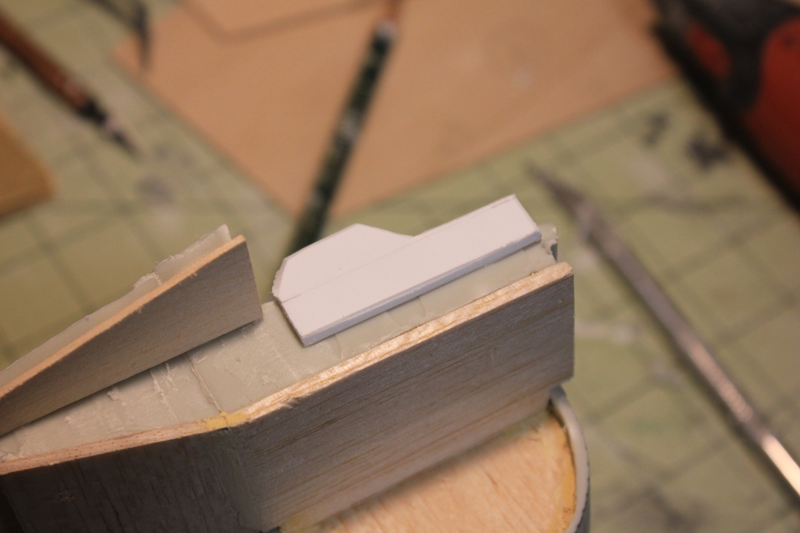

I swear the more I get into this, the more I cut away and rebuild from scratch.

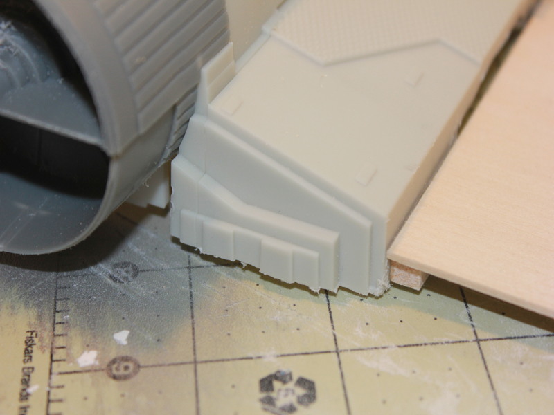

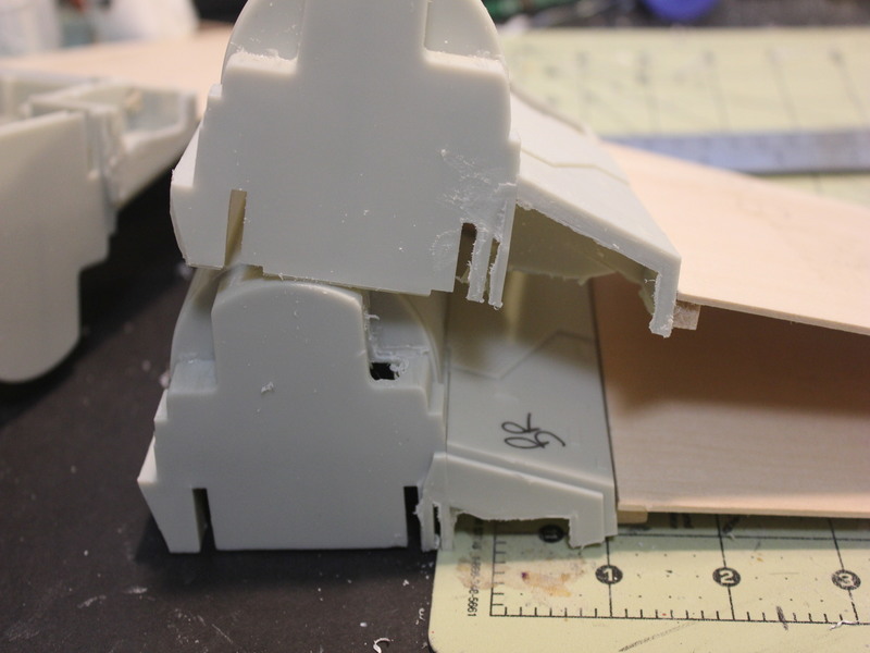

So, looking at the lack of accurate detail in these areas, I chose to cut them off....
first the small raised area...
....then just the whole end and will start over. More on that later

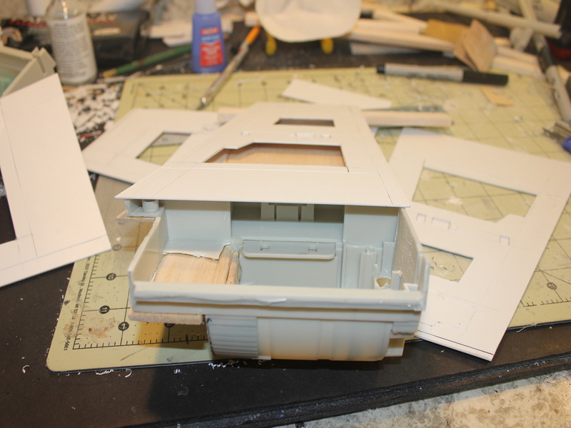

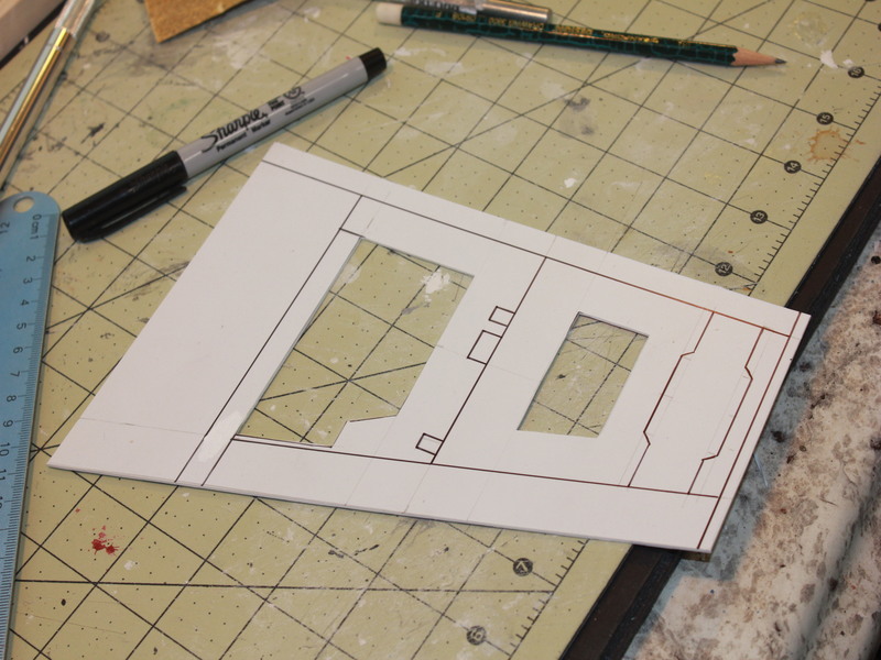

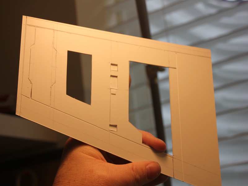

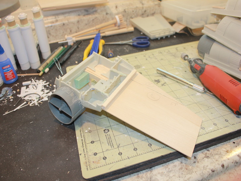

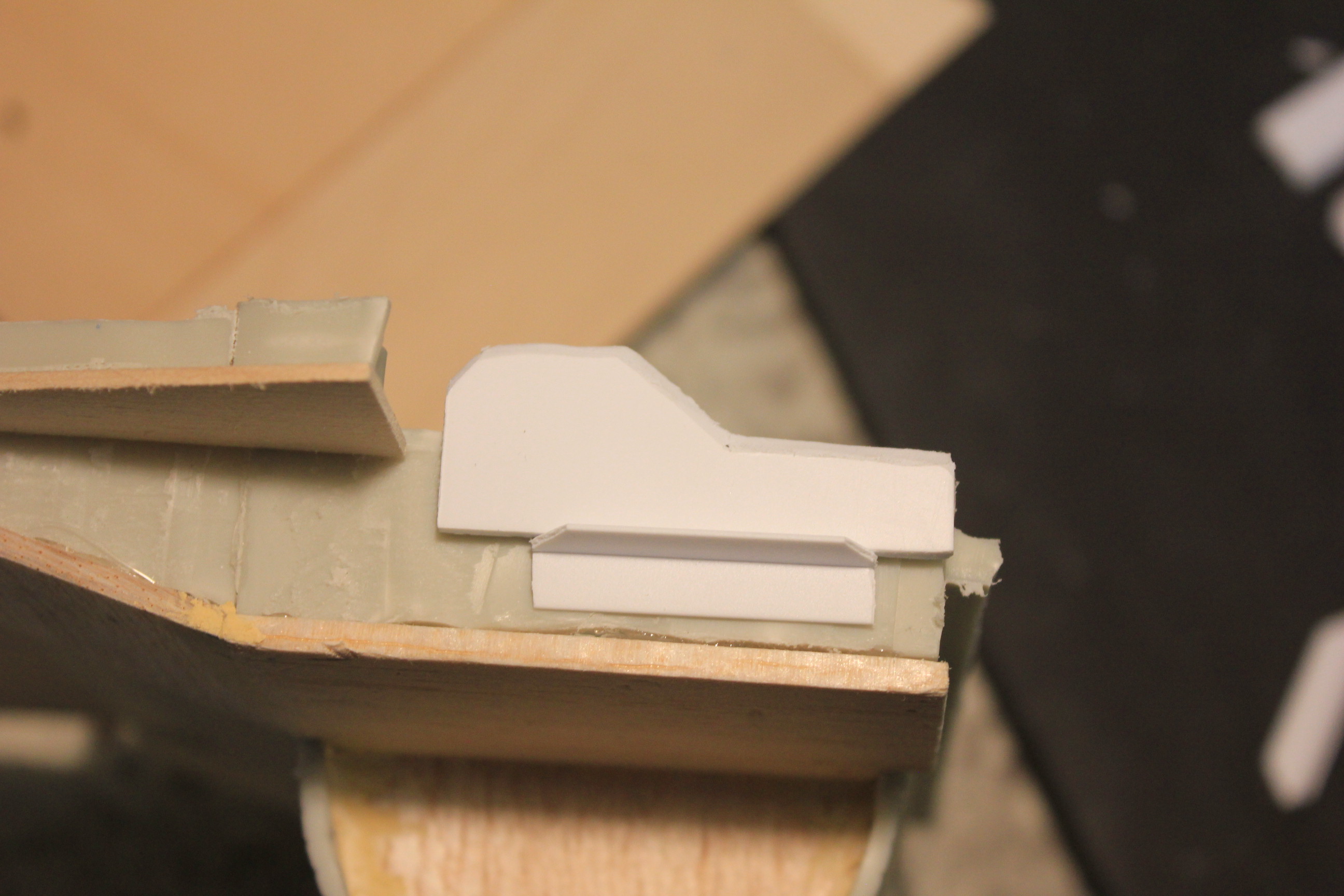

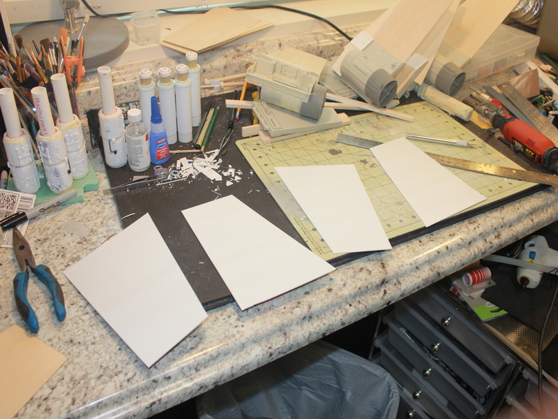

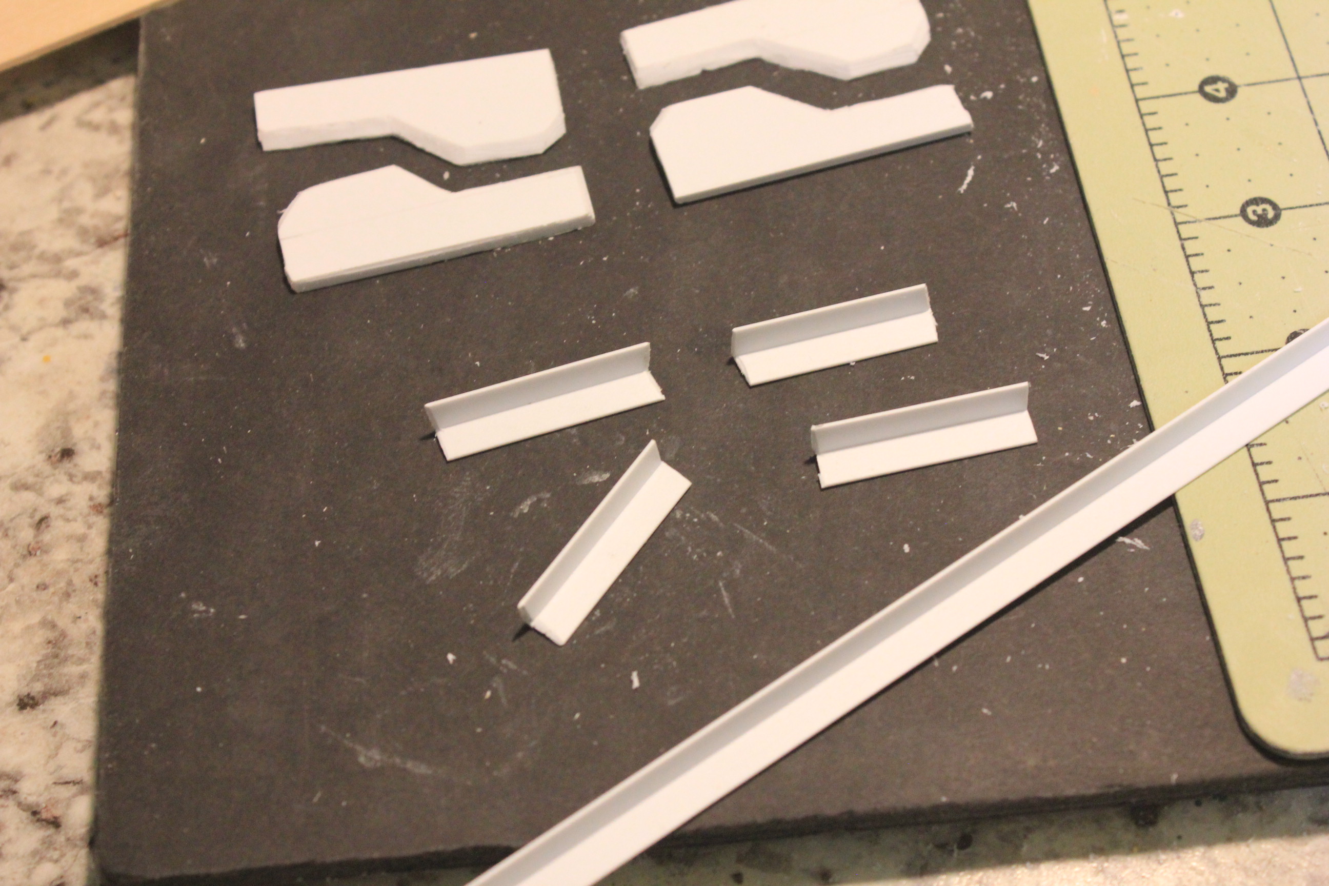

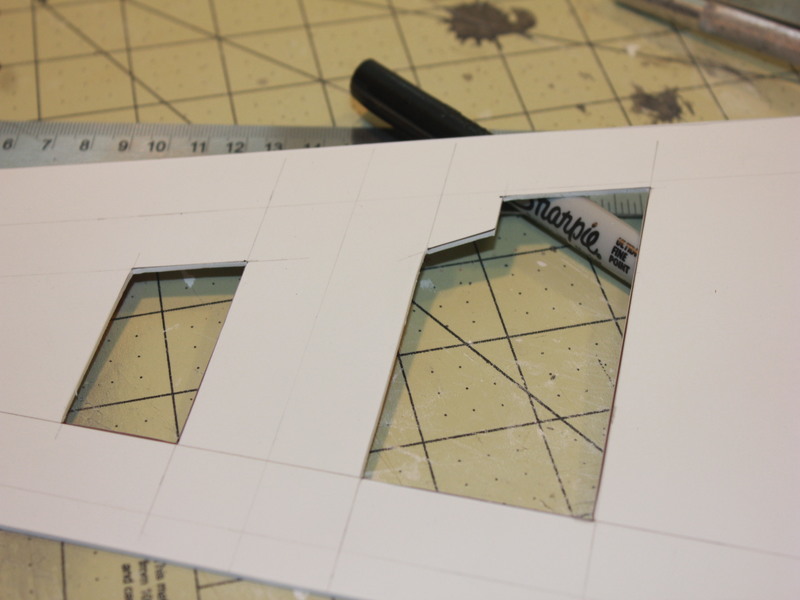

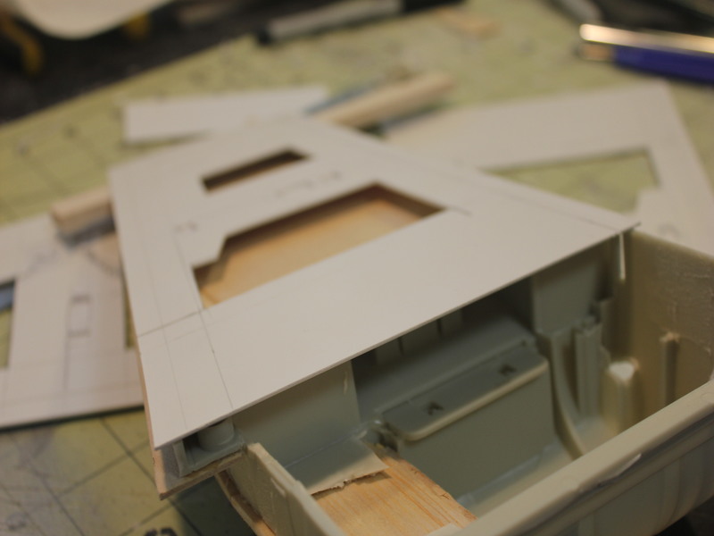

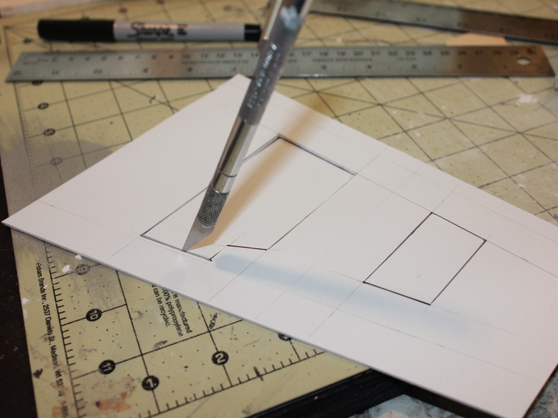

I did buy a bunch of styrene sheets, but I definitely overestimated the larger thicknesses and didn't buy enough of the .5 mm or .8 mm which would have been great for the wings...and since I had already grabbed a sign from Lowes, I'll just it for the undersides of each wing and then I'll use my styrene for the tops. My 2nd order will be much more accurate of the sizes I'll need for future use, but still learning.

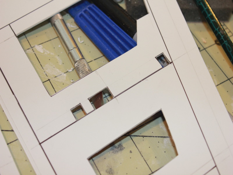

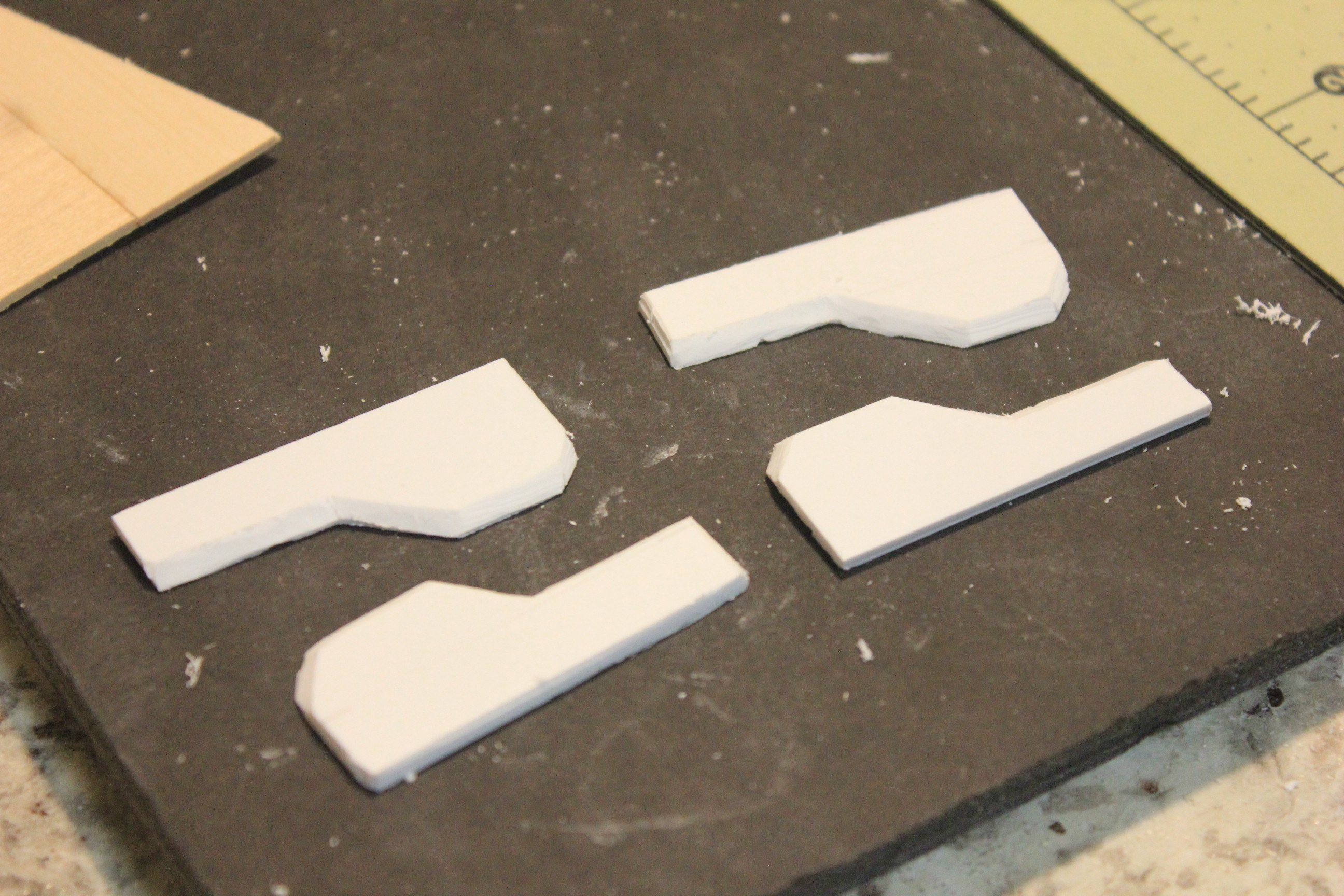

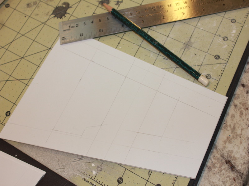

Anyway, cut out the wings...
followed the pattern on the 4' model I've been using as reference.

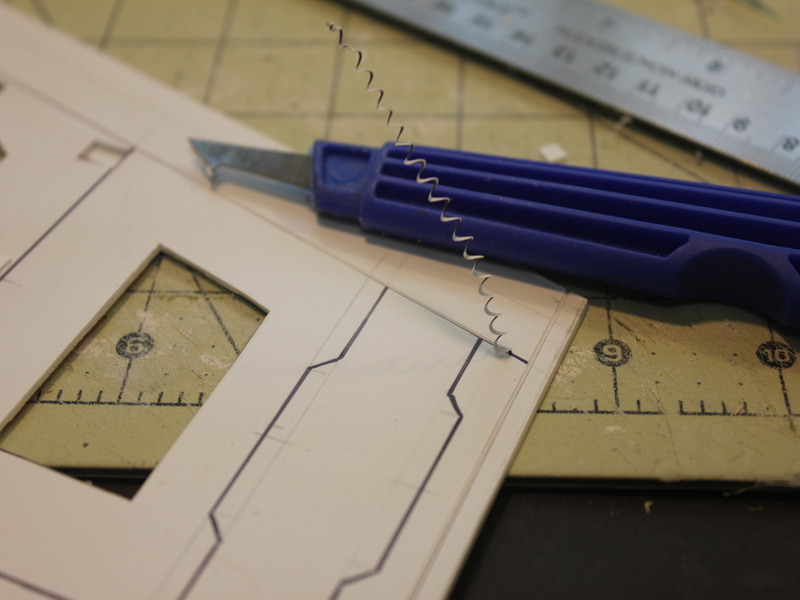

test fit

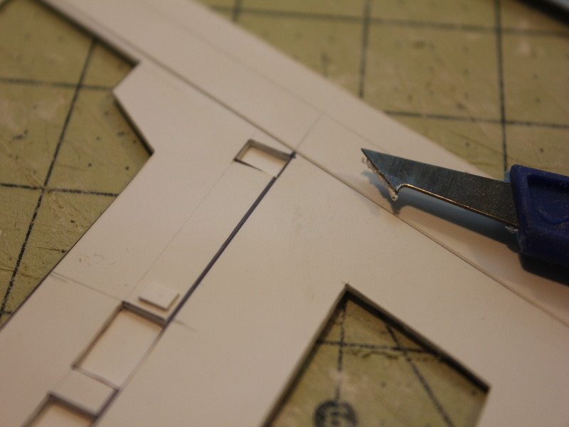

scribing the lines
not sure if you can see this well, but the depth turned out pretty decent and once painted, will be more pronounced

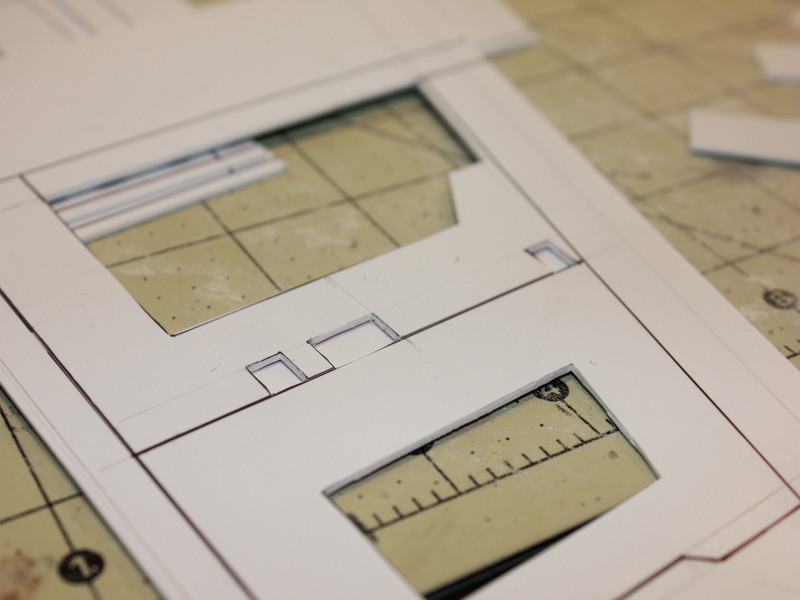

ok, back to rebuilding these areas next to the intakes
changing a few details inside the intakes to make it a little more screen accurate.
I'm not looking to be 100% screen accurate, but I definitely want to improve the entire look of this x-wing.
Pcoz

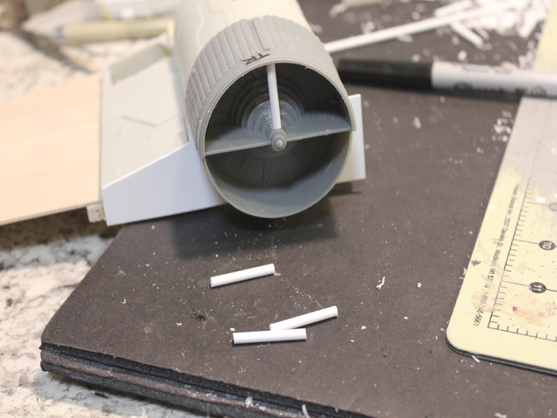

I have never noticed the little post on the inside of the engine. Now I see it in my ref pictures. I'm planing on leaving 1 post out like on the original prototype.
