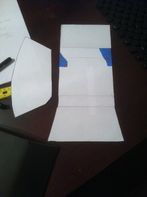

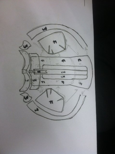

Started out with some crappy sketches and made some templates.

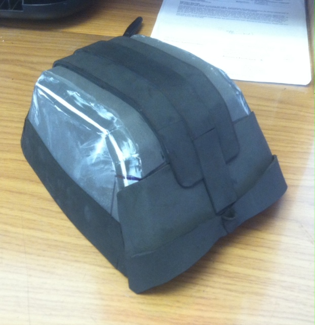

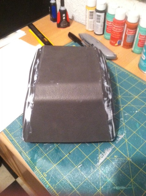

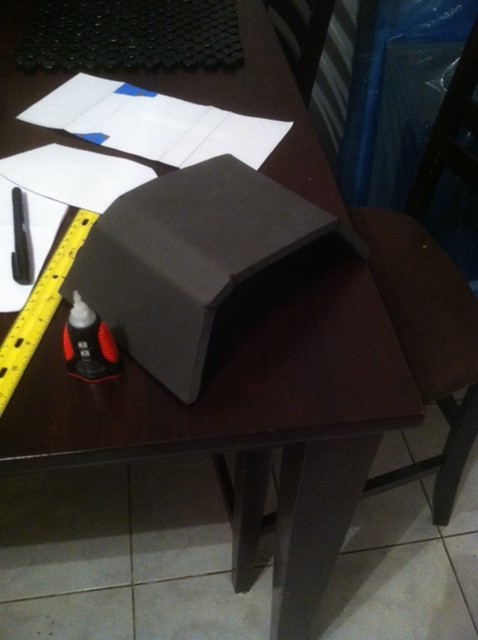

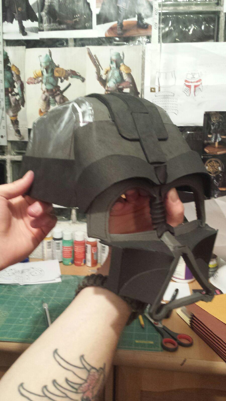

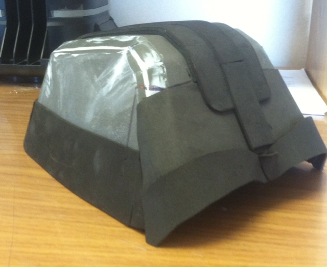

When I started to assemble the Chrome and fit it to my fiancés head I was very doubtful, at first I thought "I just made a box, very nice looking box but a box non the less"... So I put some filler in and sanded it down, also some more complications had occurred the motor in my dremel burned out and i have to call the company for a replacement :cry:facepalm.

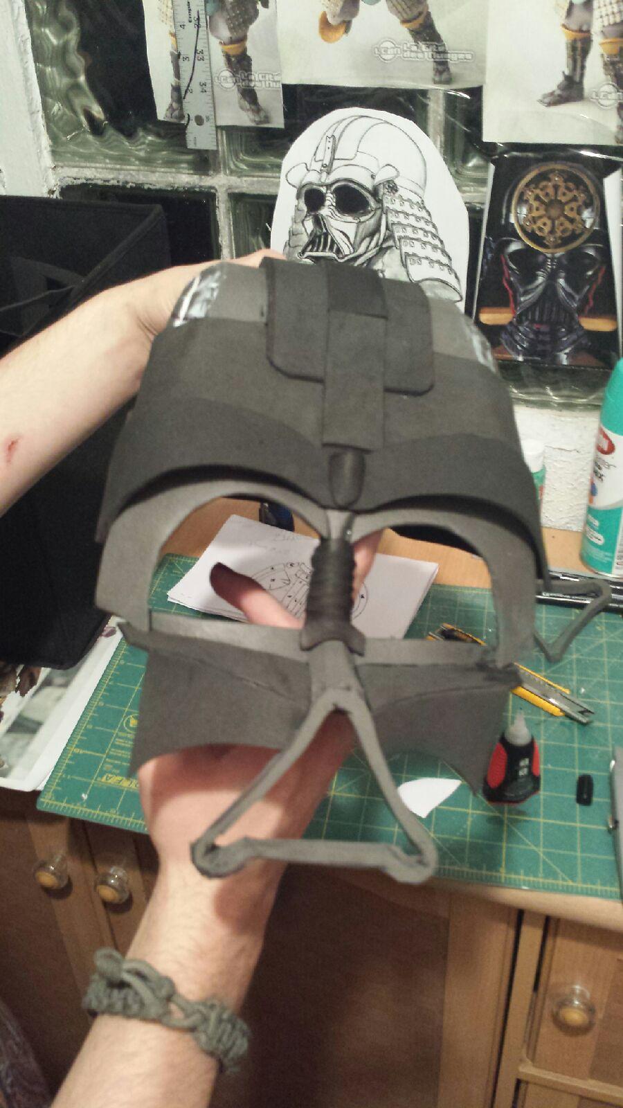

And Finally the One thing that has bugged me for the past 4 days and had given me so many excuses to not continue and doubts. The dreaded face mask, it seems so simple but just isn't! Anyways had to yet again draw up the templates myself and use some floor matt foam and 3mm foam I'm very satisfied with it, being a scratch build. I know once I cut everything out and begin sanding and detailing and spraying primer filler on it should look a million times better but this came out a lot better than I expected. My fiancé loves it too, my only issue was it doesn't look evil enough haha, maybe if I heat and reshape the eye lid section.
View attachment 556752View attachment 556753View attachment 556754View attachment 556755View attachment 556756

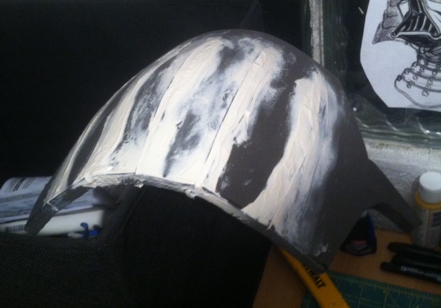

Used a latex based crack proof Caulk to cover up the huge seems in the back and sanded the hell out of it to give it a smoother surface. My fiancé was telling me not to worry about he smoothness because it will be covered up by the flaps of the helmet, but I cant help my own critique haha.

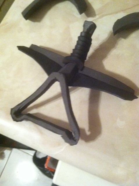

Also got to work on the grill for the mouth, this was quite challenging. At first was trying to execute with 1/2 inch floor matt foam but in the end decided to go with 3mm foam, it was just too difficult to cut the 1/2 inch with the small curves involved.

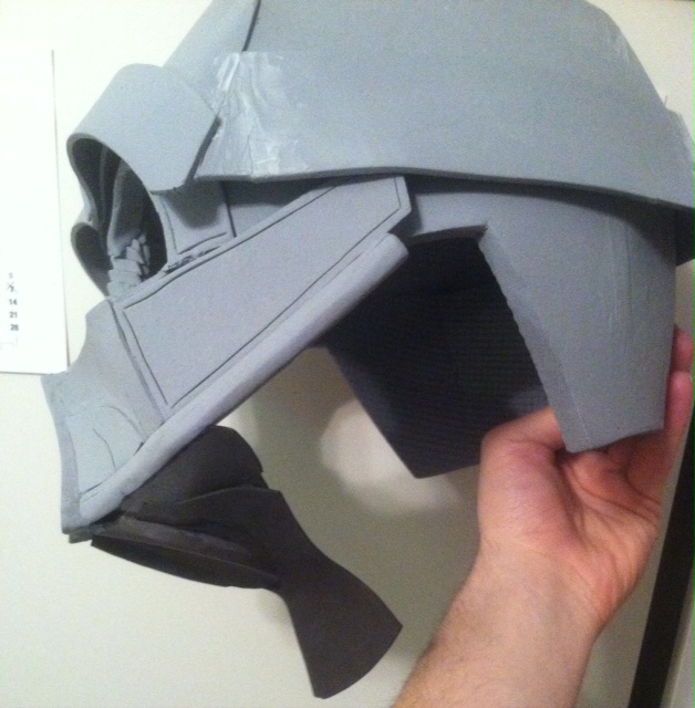

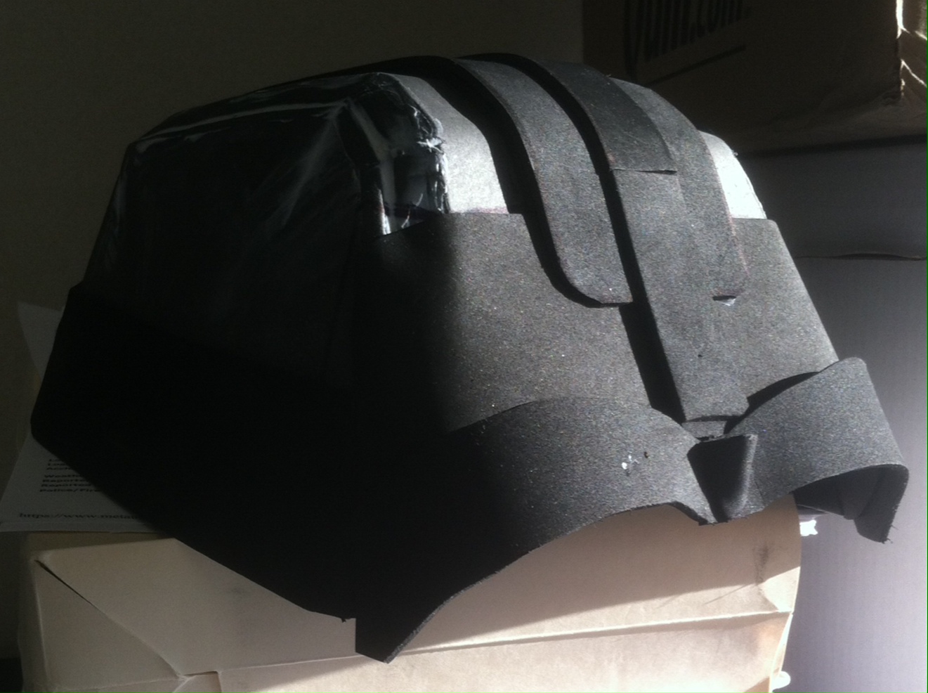

So I ran into some complications first I realized that there are a lot of places that need detailing and filler on the face mask, and it also seems that the back of the helmet is far to tall when I connect the top piece of the helmet to everything else, so ended up having to basically cut 2 inches off the top. All that caulk for nothing lol. Also someone pointed it out to me and I took a long look at it but the eyes look like an anime character with those over exaggerated eyes so I pulled the eye brows down and dremmeled under the eyes as well to make them more round (and evil I guess haha). A lot of adjusting that I didn't expect, but I think it comes with the territory on a scratch build.
Yeah that just didn't look right...

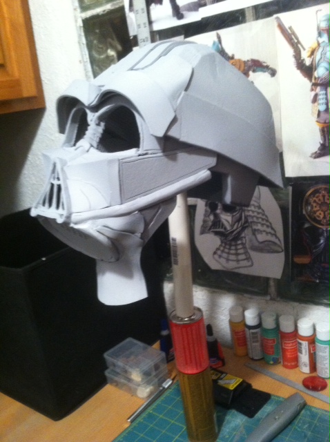

As promised my afternoon update, so I think I will break down the helmet into 3 parts 1 being the face and top of the helmet which I have completed sculpting, 2 the chin and neck panels, and 3 the flaps that surround the side and back of the helmet. So I managed to get down to home depot on Friday, not realizing it was black Friday it was nuts! Nut they had good deal on primer filler so I couldn't resist standing on line for $4 a can.
So I decided to skip the palstidip process on this one because there are to many minor details that need resolving and the primer filler allows me to sand and add filler as needed to fix little things, unlike plastidip which balls up after it dries and you try to sand. So I applied the first coat, and could already spot several spots I will have to make adjustments and fix minor details.

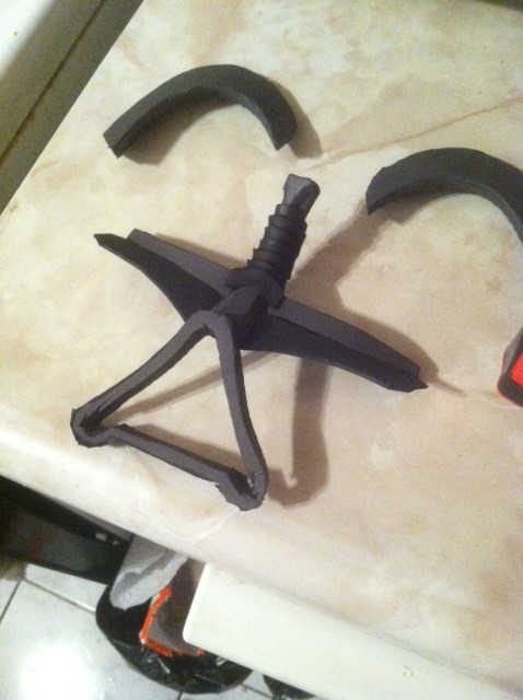

So I dremmeled the areas that needed fixing and also used a small nail filer to work on the mouth grill, and applied filler to a lot of gaps I had missed previously.

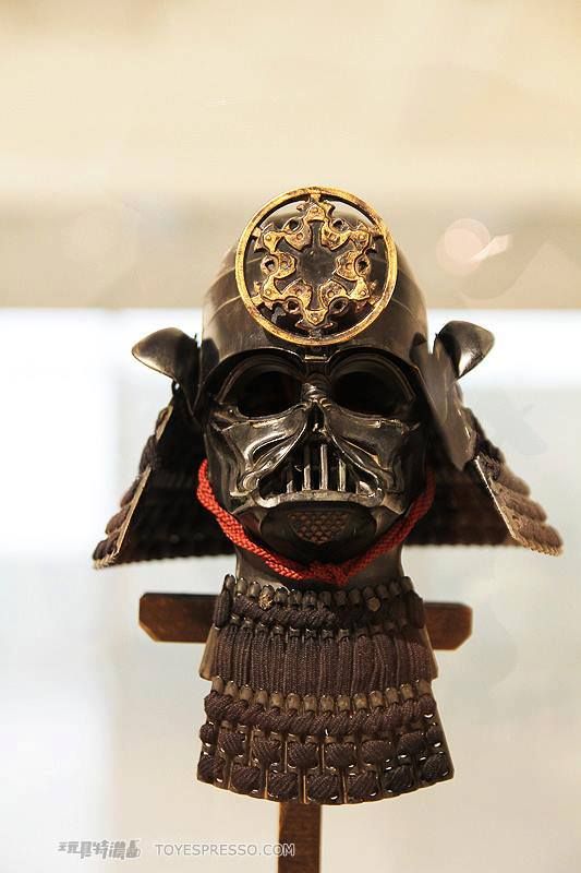

greetings friend, the designer of this armor was Takayuki Takeya, this is the original helmet 1: 1 he produced a few years ago, te puede servir de inspiración
Alright Mid-weekly update, so thanks to @Darth Rodo and the awesome reference pic above I was able to get a better look at the chin and neck. I got started with that grill under the mouth, quite tedious but I'm a glutton for long and tedious projects. A lot of adjustments and cutting and shaping to get it right. Its not exact but I think it gets the message across to someone.
Hit it with some filler, it was hard to match up and get it perfect but it fits on my fiancés head and for this project that's a win in my book.

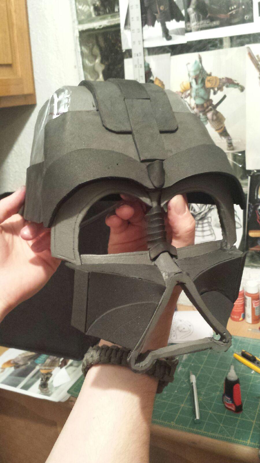

So another update, not much was done this weekend with Wintercon, I hope everyone who attended enjoyed. Got to meet a lot of great people and makers alike, and it was quite the honor to meet Jeremy Bullock what an awesome man and legend!
Anyways aside from an awesome weekend I was able to get some work done during the night time hours and I was able to finally finish the entire frame of the mask and helmet! Now all that's left are the flaps under the chin and surrounding the helmet itself, so here is the complete frame with its first coat of primer filler which is only half sanded.

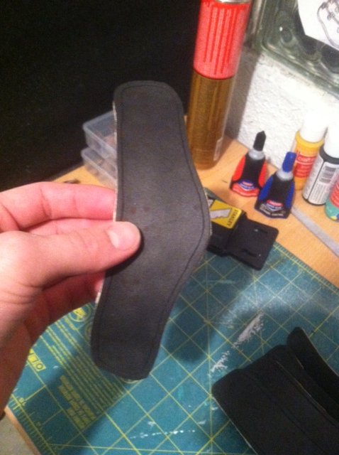

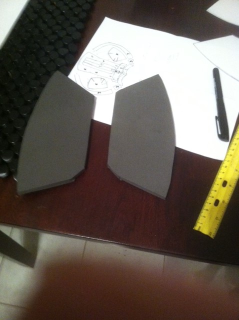

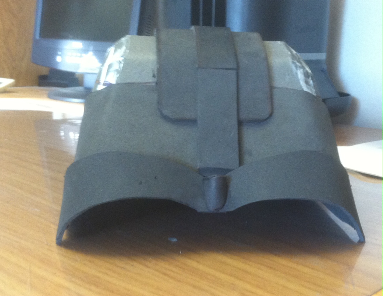

I did get started on the chin flaps, they seemed simple so wanted to test that out before I moved along with the big back flaps. I executed the same technique I used for my ronin Bobe fett and used 33mm foam for the front and combined worbla to the back for stability. So luckily with worbla there is one side that has adhesive that will stick to anything when heated, so it saved me some glue and time.
Pretty satisfied so far, now at first I was going to use a drill bit to make the holes for the 550 cord to loop thru, but I was afraid it would tear or rip at the foam, I ended up using the dremmel which I have a better handle and sturdier grip. It came out better than I hoped though it was a **** load of holes cant wait to start the back flaps haha... Gave it a coat of plasti dip because these will have to be somewhat mendable and then tonight they will get the primer filler treatment.
