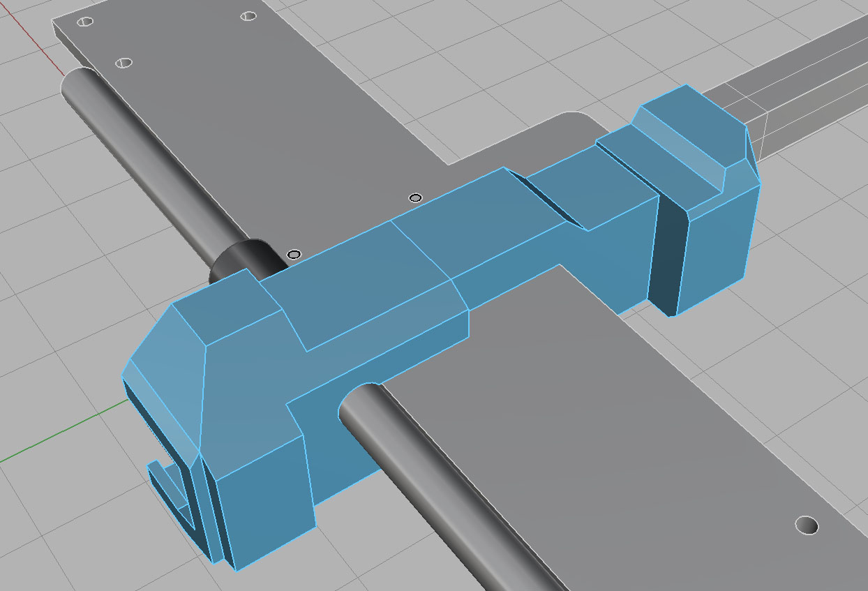

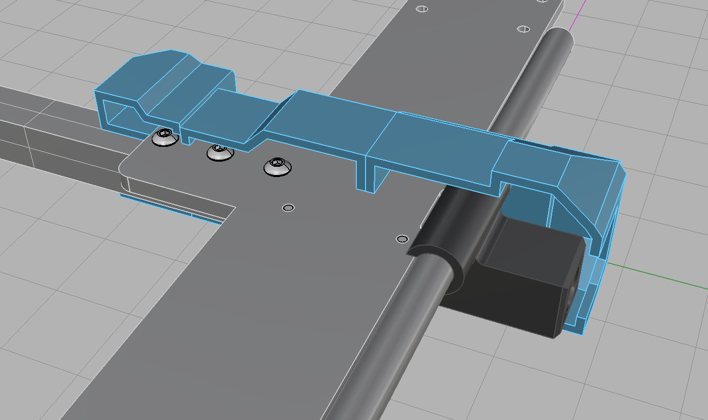

Dave, make sure and apply sufficient material to 'fair' in the aft support tube; your last image looks like it would concentrate the stress in the relatively narrow cross section of the where the tube mates to the ABS 'clamp'. Even better would be for the aluminum tubing to extend back into and past that 'joint'. Same issue probably with the bottom 'socket' due to the length of the 'neck' creating a significant moment arm. What are you thinking to secure the mount in the collars?
Regards, Robert
Re: The Y-Wing "Green Leader" Project
The block is still a WIP, but the rear mount will only be used to support the model vertically, nose straight up, for assembly and painting, never for horizontal display. Working out the moment stresses on the bottom. It may become a larger block to the extent possible by the fuselage. I'm also thinking about having the bottom block 3D printed out of a material that is carbon filled and very strong.
Here are further refinements to the armature and fuselage. The support collars on the armature mounting block have been beefed up. The block forming the bottom mount will actually be visible as part of the fuselage. That allowed me to make it as beefy as possible. The main fuselage (blue pieces) will be 3D printed in sections that will assemble around the armature. In the renderings only the right side of the fuselage sections are shown.
Since the fuselage is going to be 3D printed anyway I considered combining the shells and mounting blocks into one set of parts but decided against it since I want to print the armature parts out of ABS or Nylon for strength and the fuselage shells out of PLA to reduce shrinkage and finishing issues.

Oh yeah, baby! Awesome design work, Dave. Hmm. It occurs to me that the bottom mount 'pad' thickness could be reduced flush with the 'shell' (or is that part of the 'shell' contour?), plus with a matching hole in the 'wing plate', your mount tube could engage *through* the plate. Seems to be some room under the upper body 'shell'... and a sleeve of the mount material in an over-sized plate hole might make that bit of drill work less critical... aluminum is much easier to file slightly to fit a nylon sleeve than the other way around... even a pin adapter to provide a shear force linkage from the tube to the plate. Sorry, getting some involuntary brainstorming happening. Carry on, mate.
Regards, Robert
There is actually a block projecting out of the bottom of the main fuselage on the film models so if I made the mounting block flush I would just be adding back to it anyway. The longer the mounting block the stronger it will be. I thought about adding a hole in the Tee plate but I like the idea of it forming the 'stop' for the display roof the bottom out on.

I did a test print and assembly of some of the armature and fuselage shells and that led to a bunch of mostly minor tweaks to the CG model. But one big change is that the main mounting block now has a stub that goes forward into the central aluminum spar. The spar will now be sandwiched between the Tee plate one the top and the block on the bottom, making for a very strong, rigid connection. The central spar has now also been changed from a 3/4" square tube to a 3/4" x 1/2" C channel, mainly because I had some of the channel on hand and not the tube, but also because the channel is plenty rigid enough to do the job and actually a little bit easier to attach to the redesigned main block.
