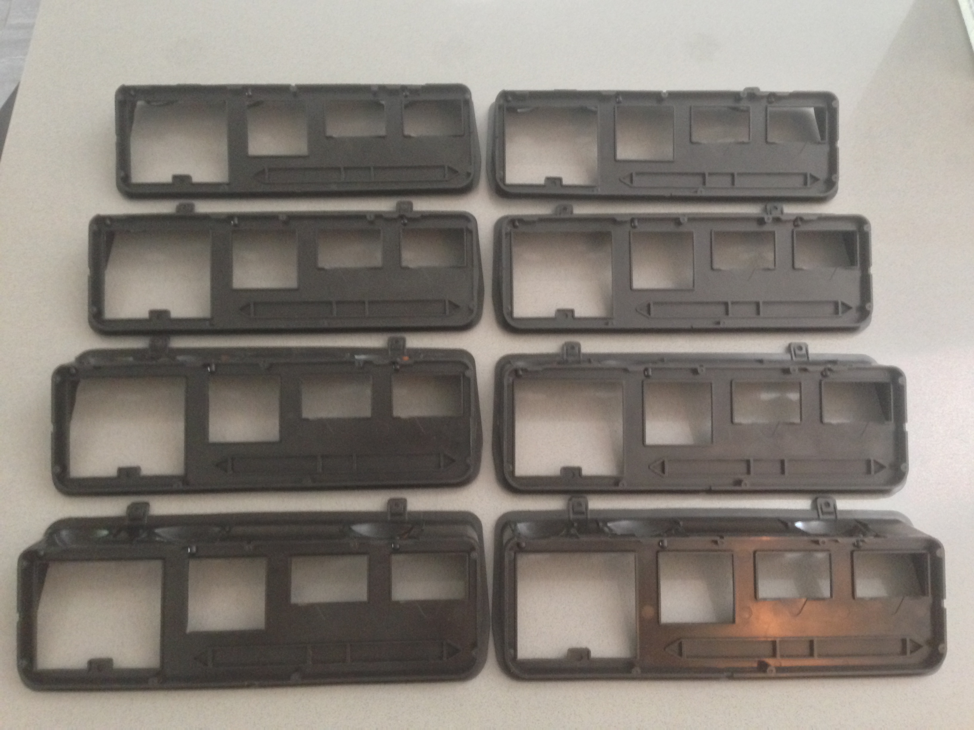

That being said, I finally had time to cast my own set a couple weeks back. And most parts made it. Here's my material:
- Han: Darthchromer full rubber front (was Kingjawa 3 parts)
- Box: Zenix MDF box
- Panels: My casts (check my sale thread)
Molds for the panels, and my cast

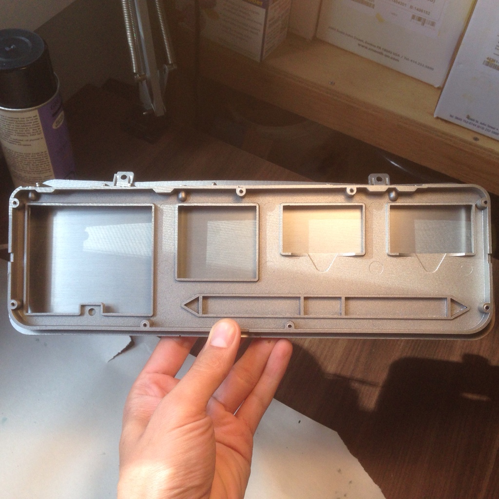

Here's the first painted panels, I also drilled all the panel screw holes since I blocked them for casting purpose. I thought it looked much better for a 2 minutes job.

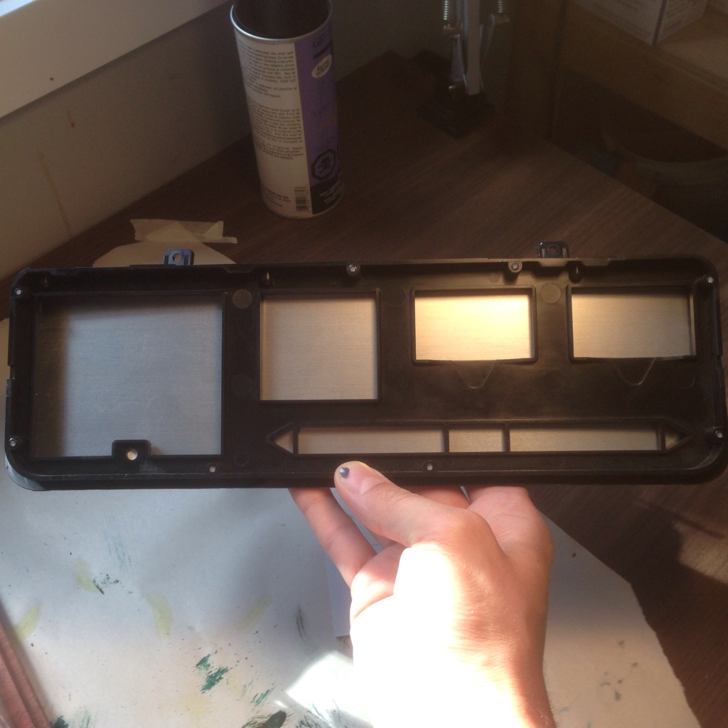

Hero panel prep:
- Drilled out electronic button switch in alignment with grill.
- Dremeled some plastic from the backing to have a better fitting of the pulsating screen and the switch

Get some aluminium sheet to back the panels with and definitely try to get one of the Bronica viewers.
Han In Carbonite in Canada - Build and Research thread
Definitely! Got that done yesterday! :)
Instead of getting them cut much larger like I've seen here, I had them cut tight to the windows inside. So I won't need to cut all those curves for fitting! Size was 3-3/8" x 12-1/2" (disclaimer: don't use those numbers without testing first! :))
ImageUploadedByTapatalk1446217335.174082.jpg ImageUploadedByTapatalk1446217601.688769.jpg ImageUploadedByTapatalk1446217622.006807.jpg
