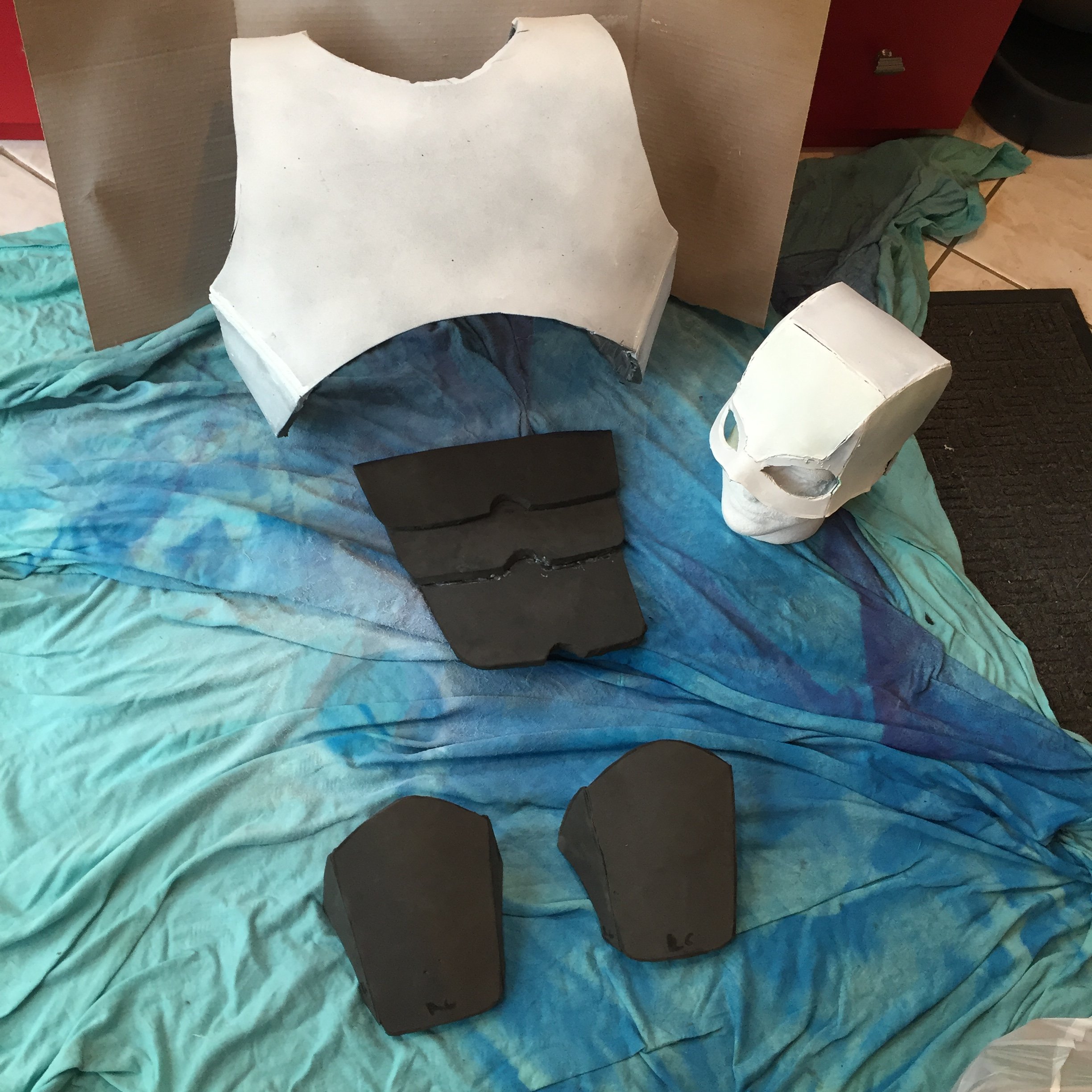

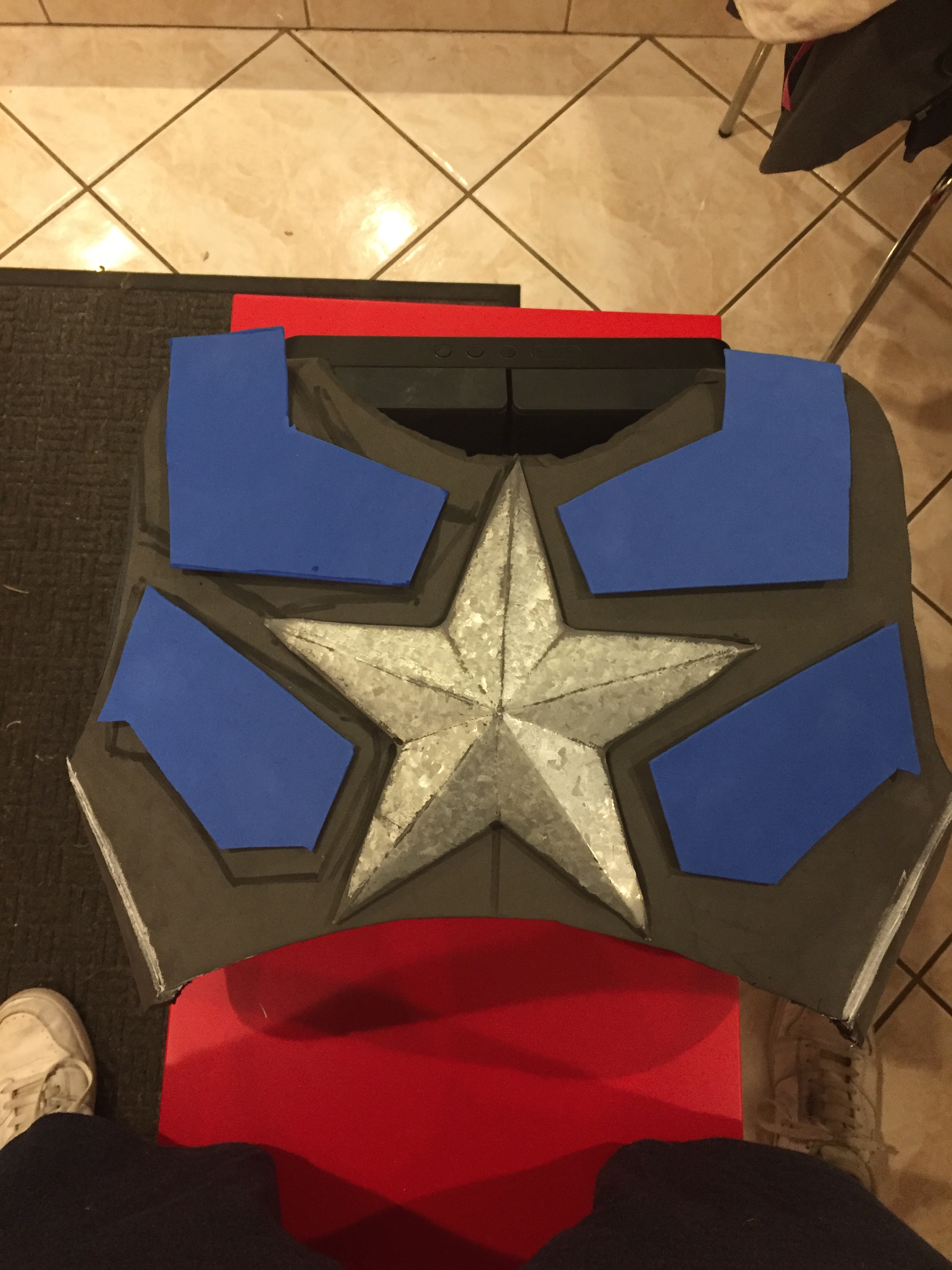

First I grabbed some foam from Walmart the big squares you find in the fitness section ,and some craft foam for details.

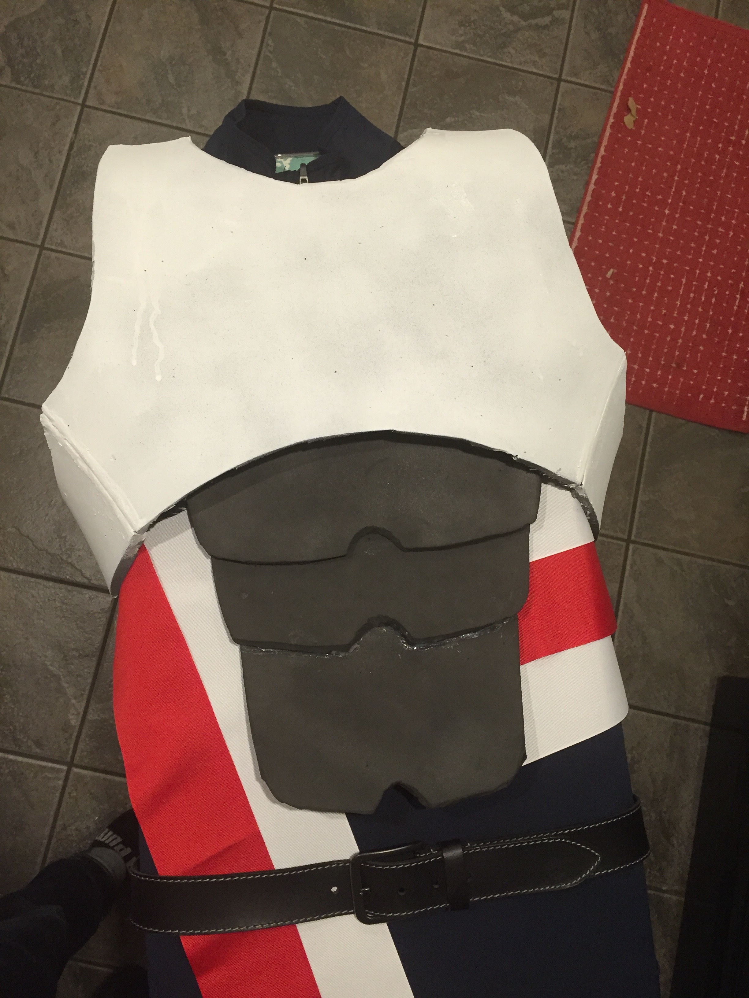

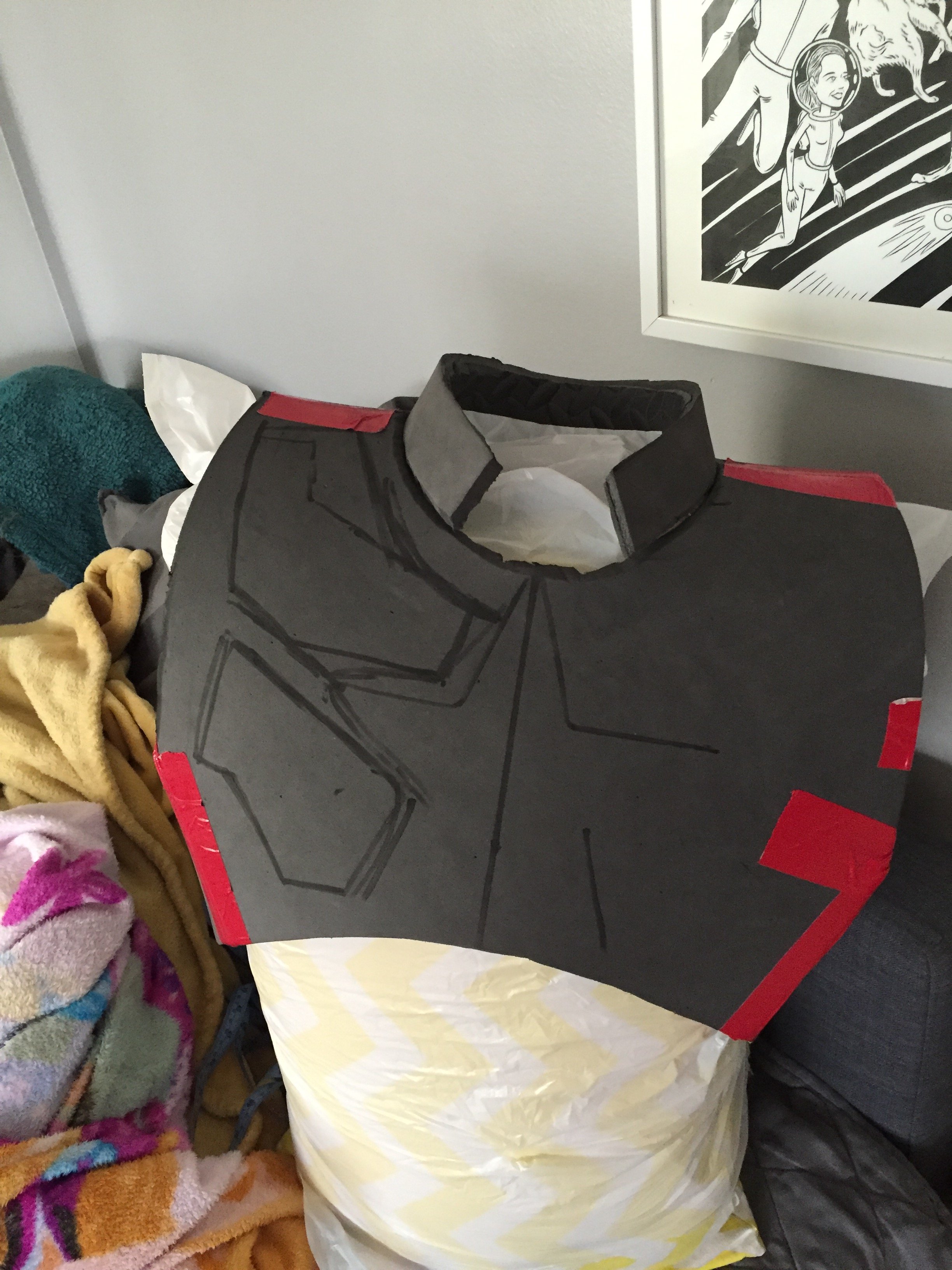

Then I measured my chest and free handed a template for front , back and sides. After cutting I taped it all together to test fit.
Then I glued and primed cut the abs and the detail parts at this point i was experimenting with how to do stripes.
For the shirt I found a slightly shiny navy blue long sleeve work out shirt , for the stripes I went to Micahels and got cloth ribbon and iron on adhesive (I don't have a sewing machine or skills).

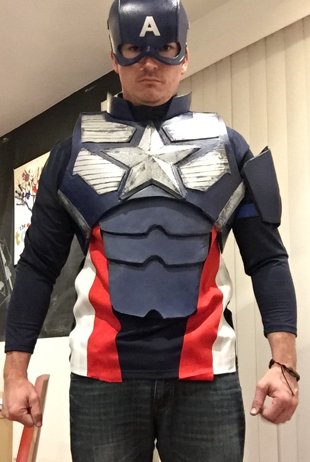

I glued chest details on, plati dipped(rushed it too much and it got sloppy) I painted it all with a Rostoleum navy Blue, then taped off the blue and sprayer metalic silver and it had this weird effect causing cracking in the paint.
I decided I was running out of time , so instead of redoing the prime and paint of details I used black acrylic to add battle damage/ weathering.

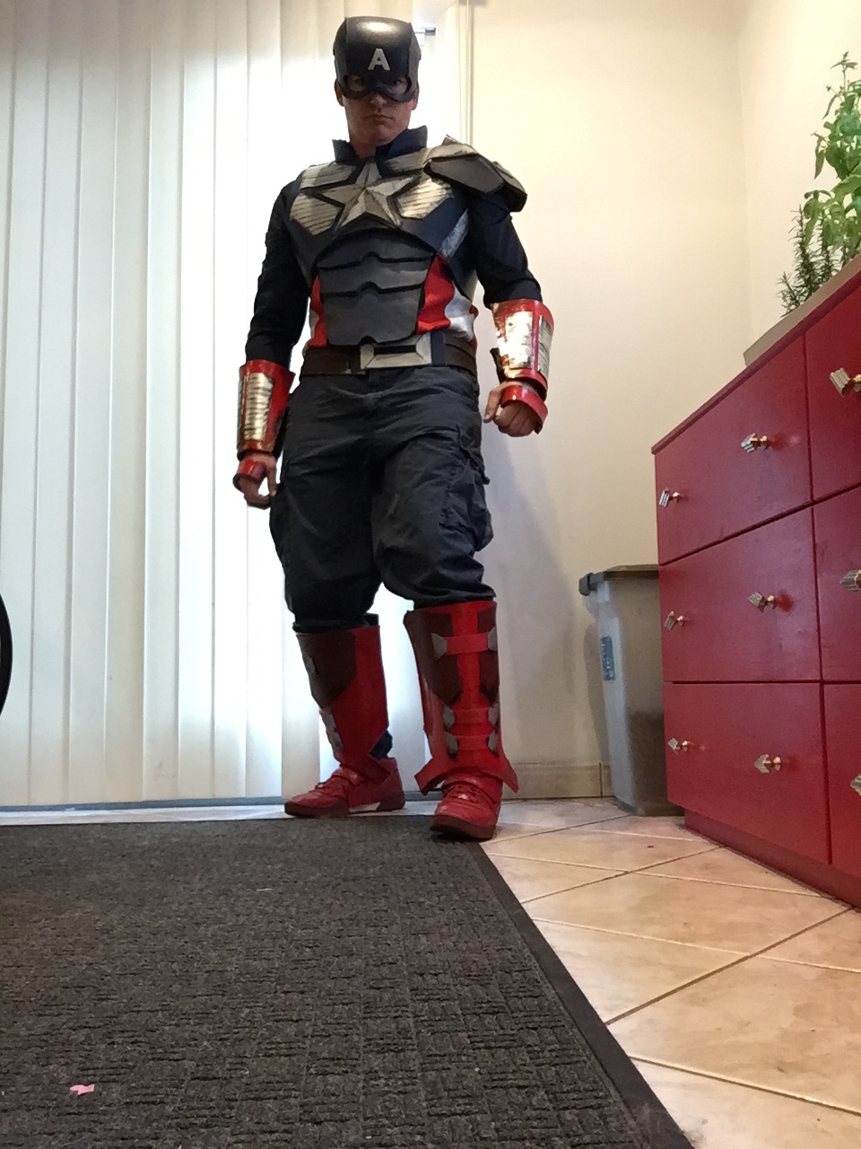

Heres a suit up so far.
I'll need to do something about the shoulder pad it kept falling. Let me know what you guys think.

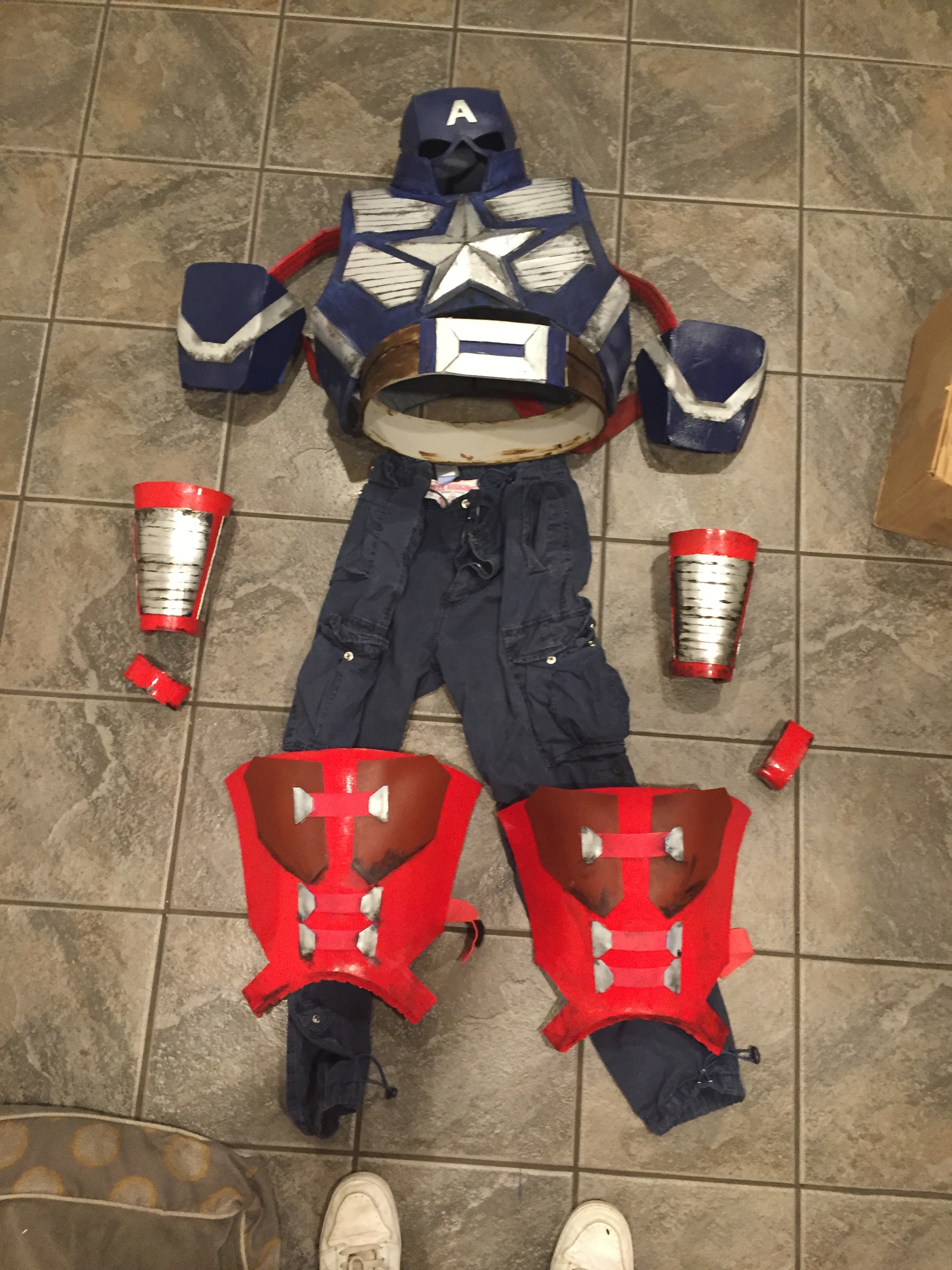

I still need to do the harness , utility belt , arm braces, and boot /shin covers. :facepalm fingers crossed.
