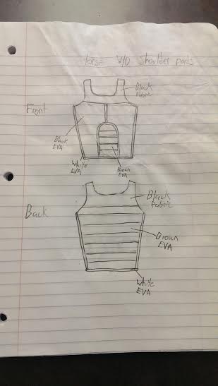

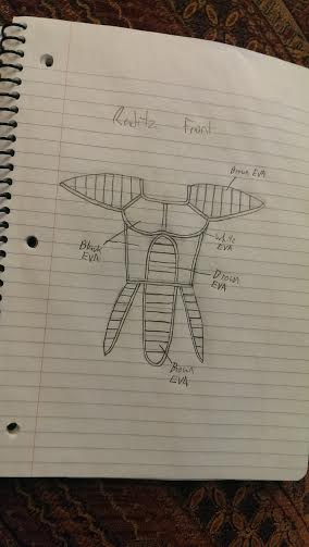

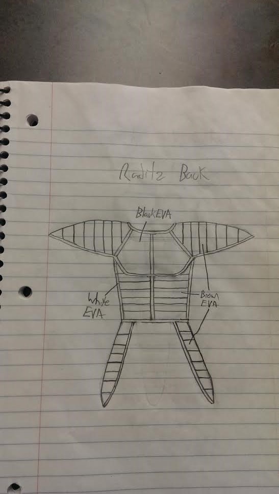

First I drew up some concept pictures.

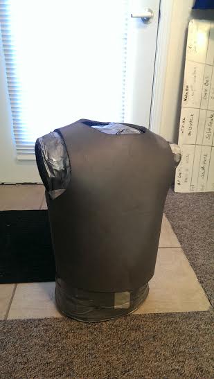

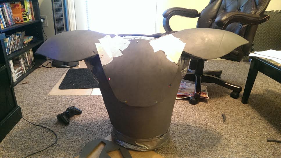

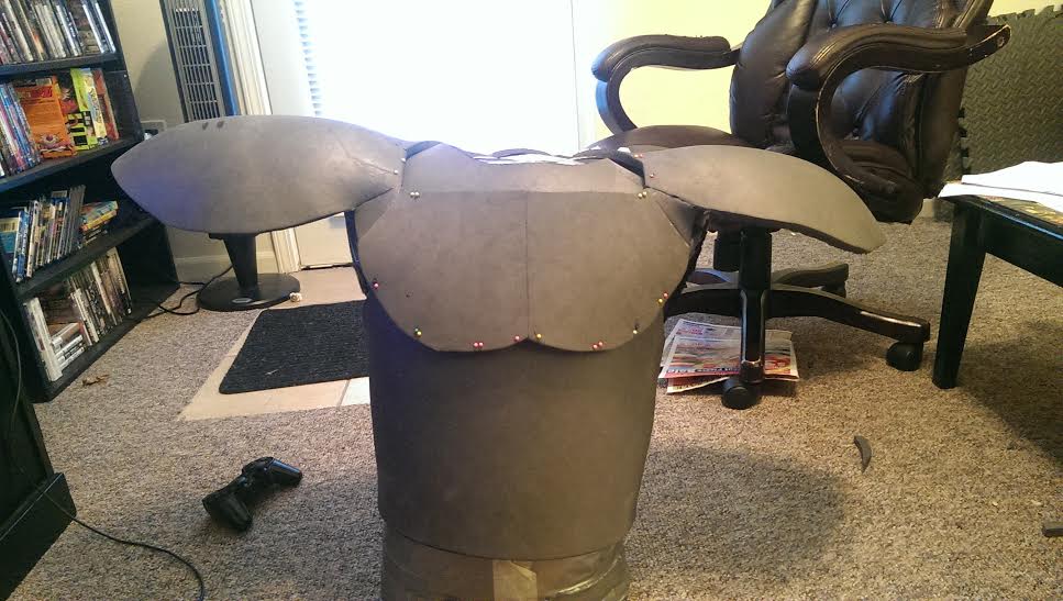

I mocked up some patterns for the base torso using my duck tape mannequin and cut them out using 1/2 in foam floor mats.

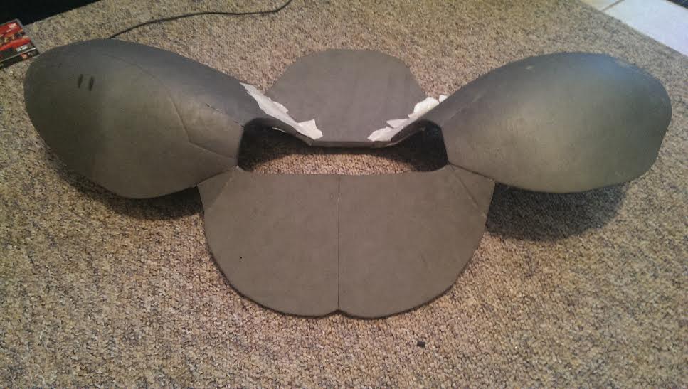

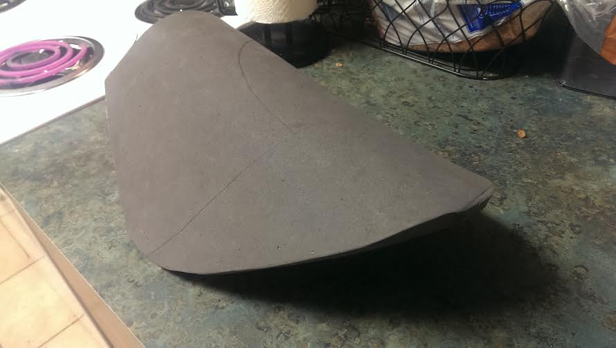

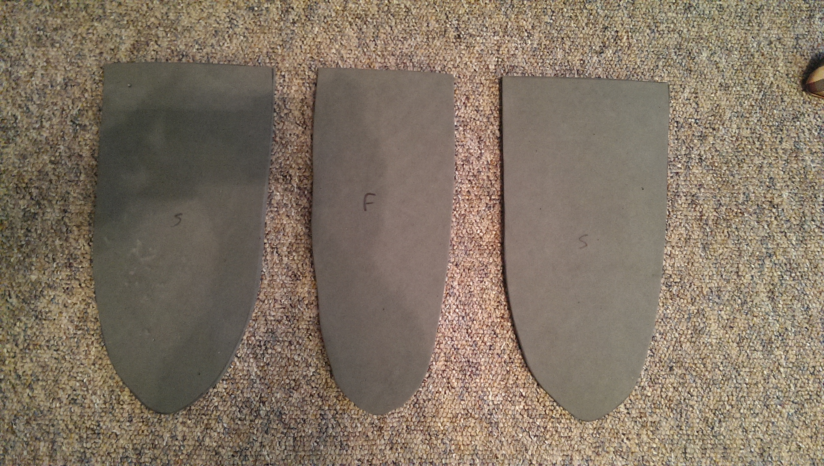

Now for the shoulder pads, I started by sketching up some patterns and cut them out in foam.
The shoulder pads have an egg shape to them so I heated the foam up with my heat gun and bent it over a football.
Before shaping
and after shaping and gluing

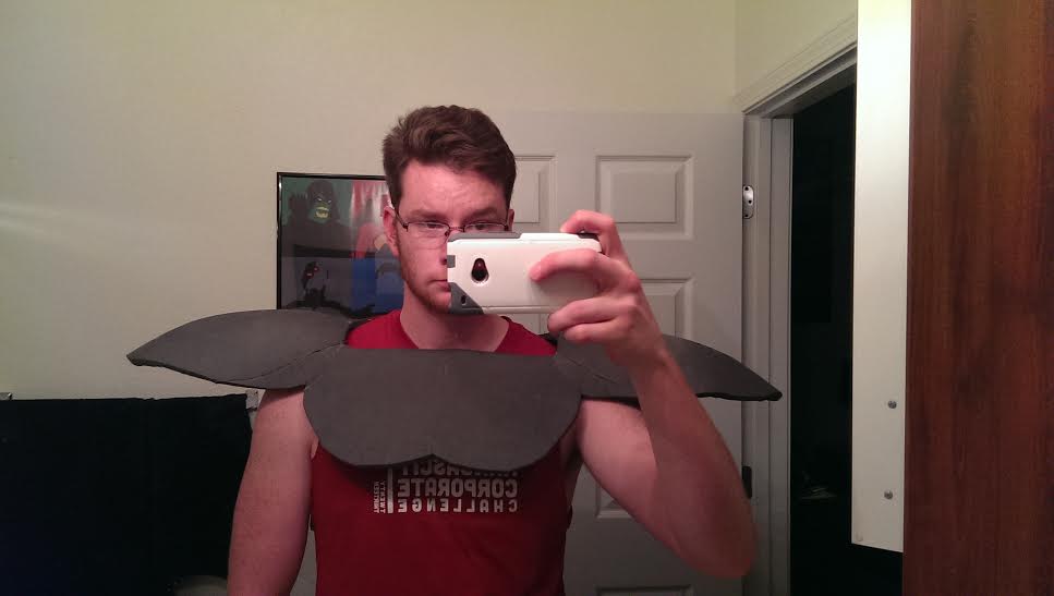

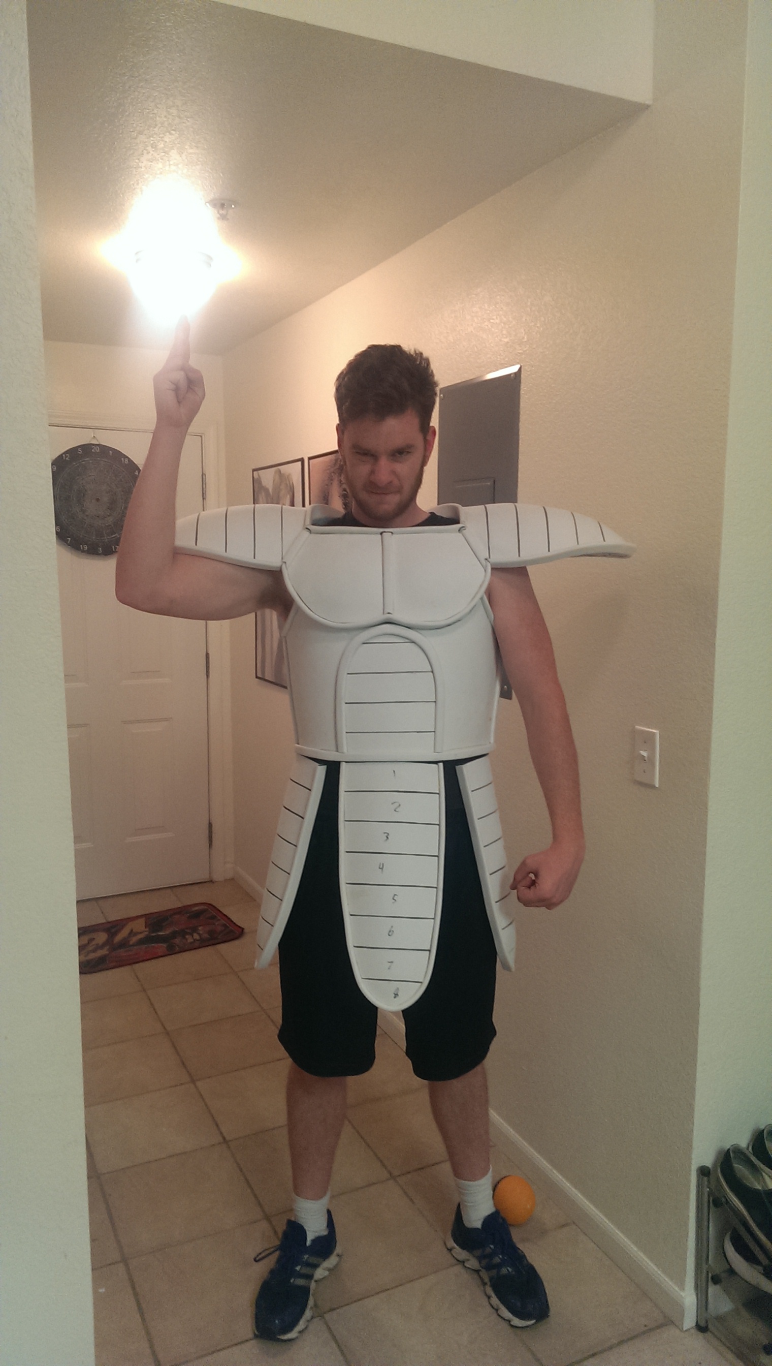

I then added a few pieces of foam to even out the armor and give it a shape I was happier with
Here is the result
Then I layered 2mm EVA foam over it for the stripes on the shoulder pads.

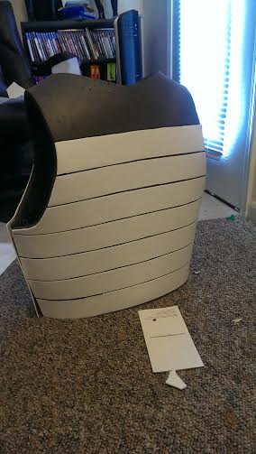

I layered the torso with 2mm foam to give it the details.

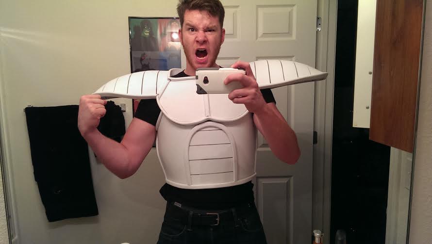

Here is what it looks like with the shoulder pads sitting on top.
I contined the lining process with she shoulder pads, abs and waist lining. then I attached the shoulder pads
A big thanks to STEALTH who gave me some good advice about forming the chest piece to make it look rounded, 30 minutes of heat forming later this is the result
I think I'll spend some more time heat forming but I'm happy with the progress so far, next I'll get started on the hip and groin flaps.

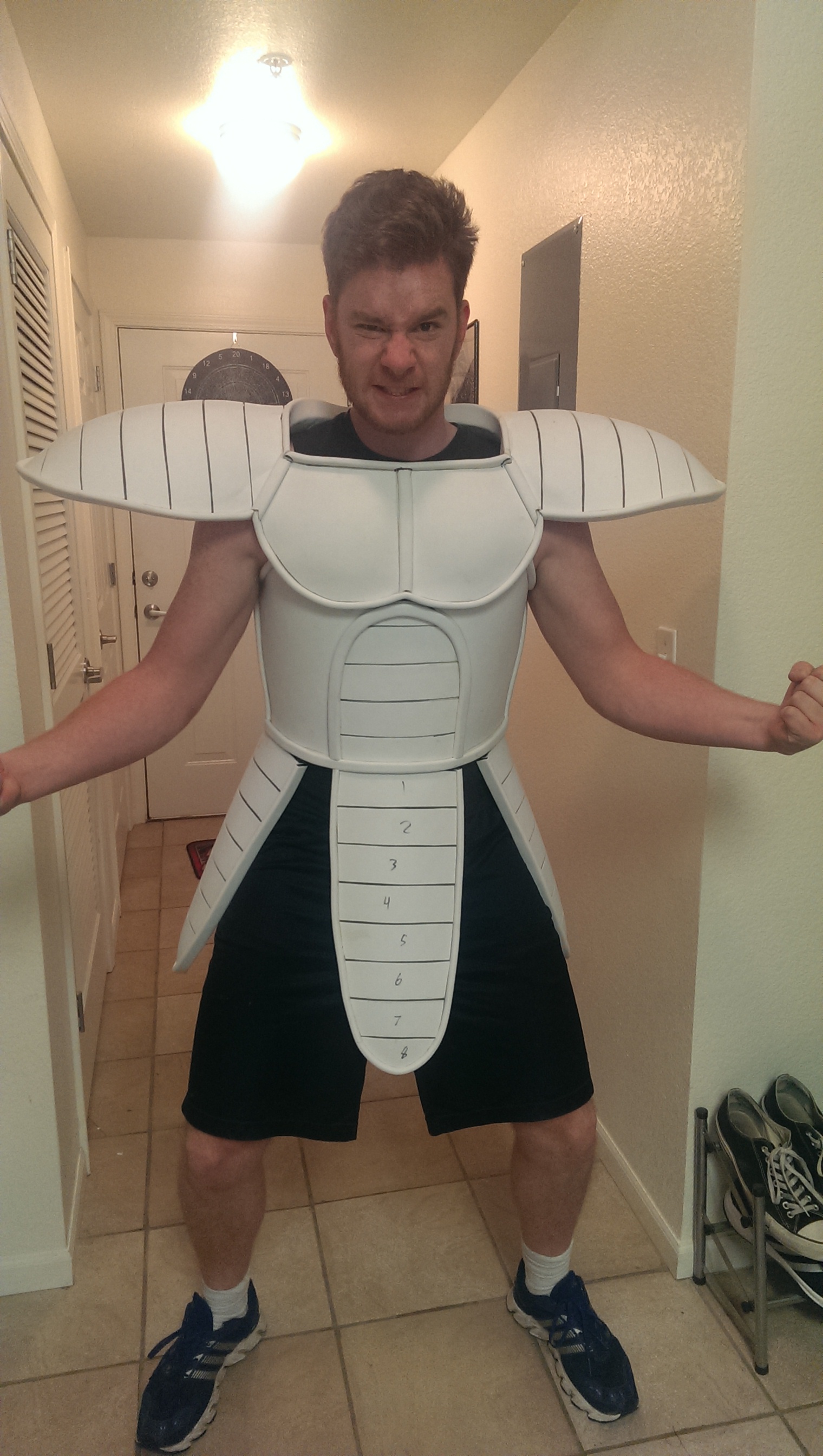

Hip and groin flaps done!
I used 1/2in thick foam for the flaps
I used a heat gun to give them a rounded shape, then added strips of foam and tubing on the outside using the same method as described above.
And used Velcro to attach them to the bottom of the armor
I still need to fix a few imperfections but it's almost time to paint!

Looks great so far! Not sure how screen accurate you are looking to get with this but.. One thing I noticed when making armor for my son. Is almost all screen shots of this type of armor have 6 ribs on the belly section, and 7 on the shoulder pads.
I believe the pic you posted is fan art. Heres one from the show. ;)
Re: DBZ Saiyan armor Raditz (WIP)
To be honest, I wonder how consistent they are with drawing those things.
Thanks! I actually looked into the whole number of strips and tried to keep it true to the anime ( its what I watched to get pumped for this build haha) but I noticed that something didn't look quite right when I translated it to the armor, maybe its a mistake I made in measuring the base of the armor. in my personal opinion it looked better with every strip being the same width.
Thanks for the advice!:D
On my sons armor I probably got more into trying to be exact than was necessary. Honestly.. In all my measuring and resizing It turned out that the width of 6 stripes on his, came out to be roughly 1 and 1/8 inches. Exactly the width of my yard stick LOL so I just traced that with a razor blade LOL The strips themself were made from foam toolbox drawer liner. spaced ever so slightly apart. If I had more time I would have been more particular with it. Giving them more of a "bubbled" look instead of glued flat.. But start to finish I only had about 10 total hours to put into it.. Even still it looks pretty good imo.

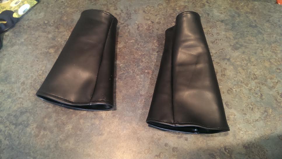

Now for the gauntlets
I mocked up a quick pattern and sewed them together using some extra black pleather.
Then I made tubing using the same method from the armor and attached it using contact cement.
8f0c408a-f73b-4f00-9b69-766b5a1ac033.jpg46c935bc-12d5-467d-a608-18513001b147.jpgb4e88add-e7ec-4625-8958-bbeb30ff8734.jpg
I still need to add the piece between the thumb and index finger and then add the rope like piece around the wrist.
