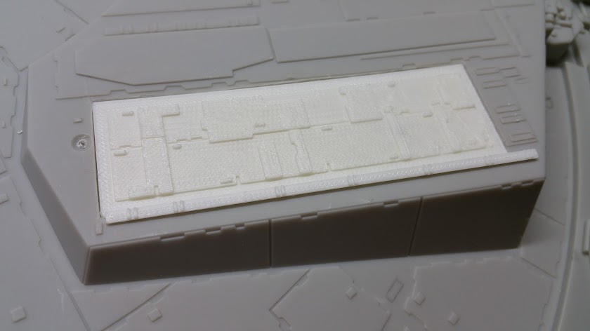

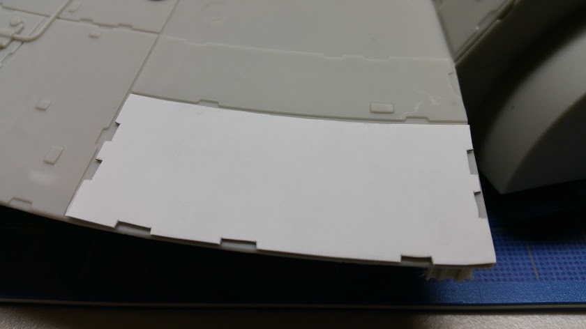

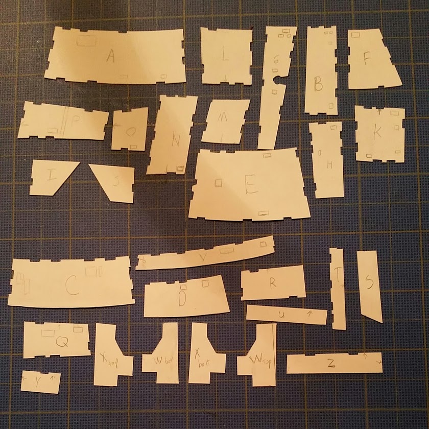

Ok, the next thing I have been working on is replacing all of those missing panels.

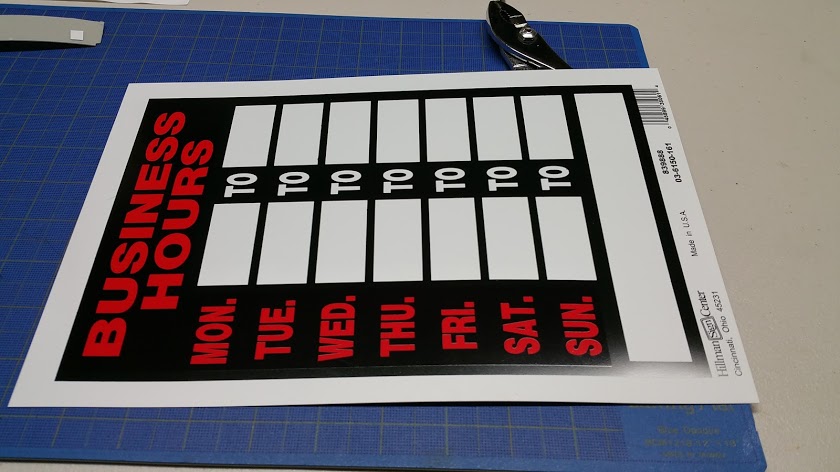

oddjob93 suggested that I use standard for sale signs for this (Awesome idea!). Just cut them out and glue them down. Tested the gluing and with the loctite plastics bonding system glue it works awesome!

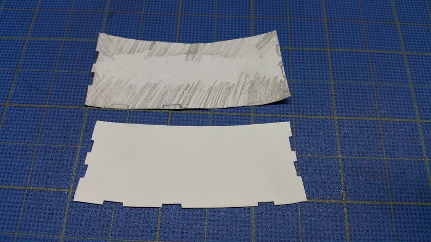

So I have been just using a large soft lead pencil with some paper and using a standard "rubbing" technique I get the space where the piece needs to fit rubbed onto the paper and then draw out the exact shape I want. Cut that out with an exacto knife and ruler and use that as a template to draw my shape onto the for sale sign. Cut that out and it works like a charm!
Biggest issue here is that there are a BOAT LOAD of these to cut out! Currently I count 26 of these on the bottom, and another 40 on the top! And that doesn't count any of the "warts" that I will be cutting out and gluing down. Probably gonna be close to another 75 of those to do also. Fun times are ahead! Here is a shot of what I have cut out so far. 28 down, 38 to go!! Labeling these so I can remember where they go is ESSENTIAL!!
All of those little squares you see are warts that I will be adding to these parts as I glue them into place.

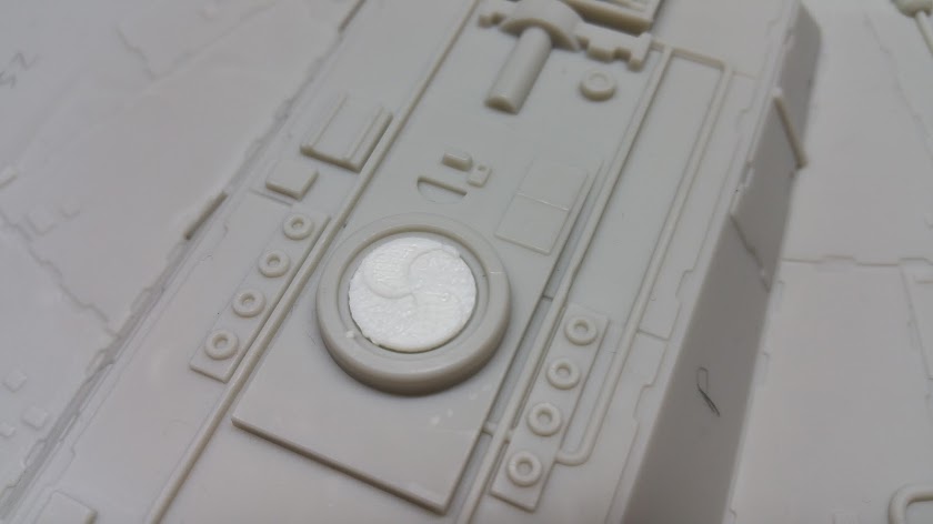

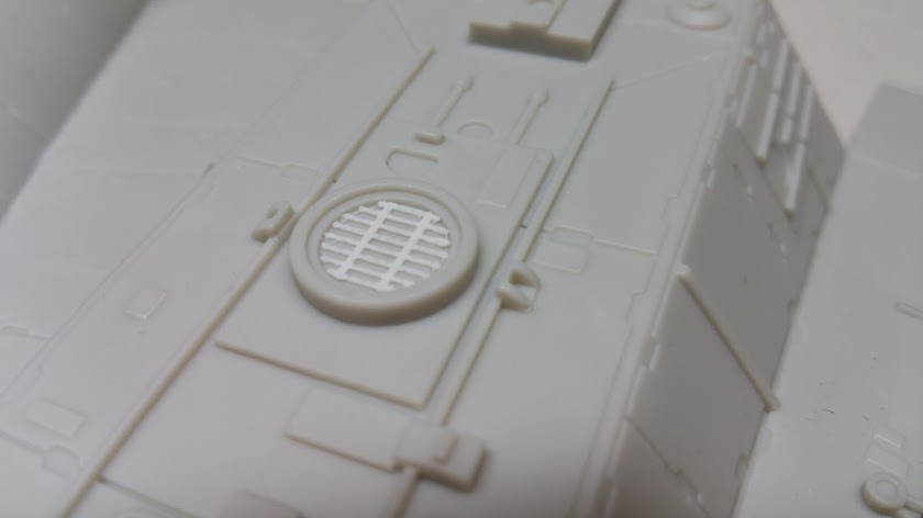

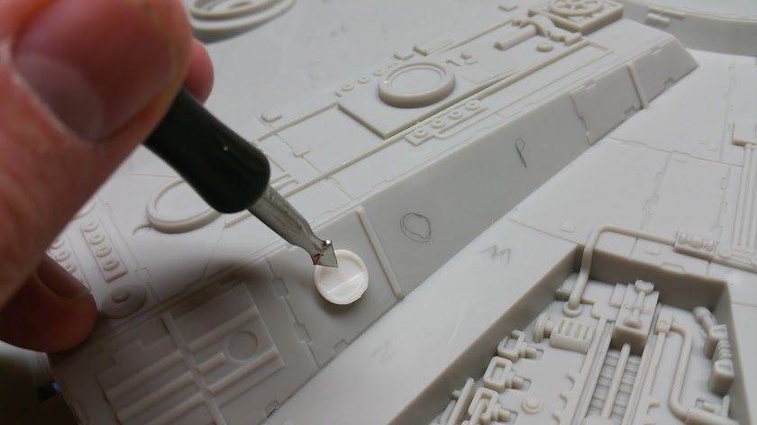

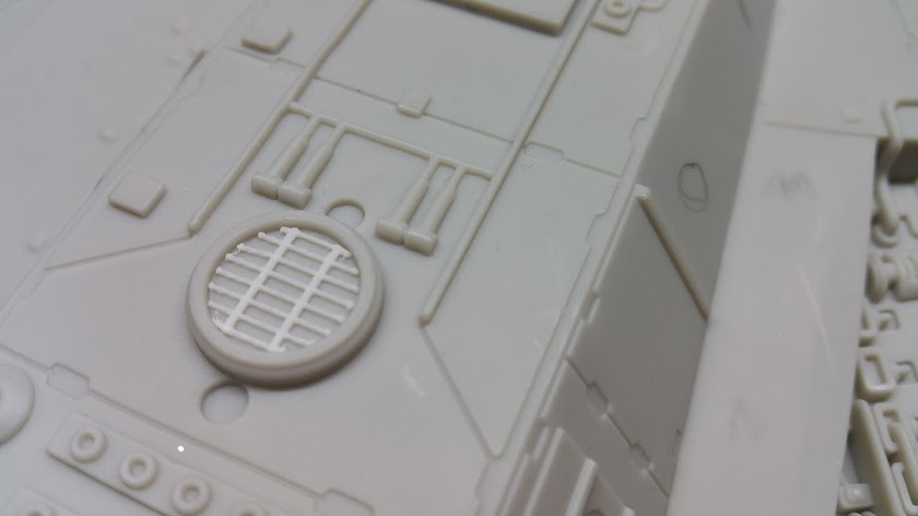

Here are the realized docking bay grates and hatch. Turned out pretty good. I was originally hoping to cut these out to give them some depth but after examining the model I realized there were too many large supports directly beneath them and decided it wasn't worth the hassle to try to fix it. So they will just sit on top. Still looks pretty good I think! Let me know what you think!
Also made this little greeblie part that was clearly missing from the Hasbro model.

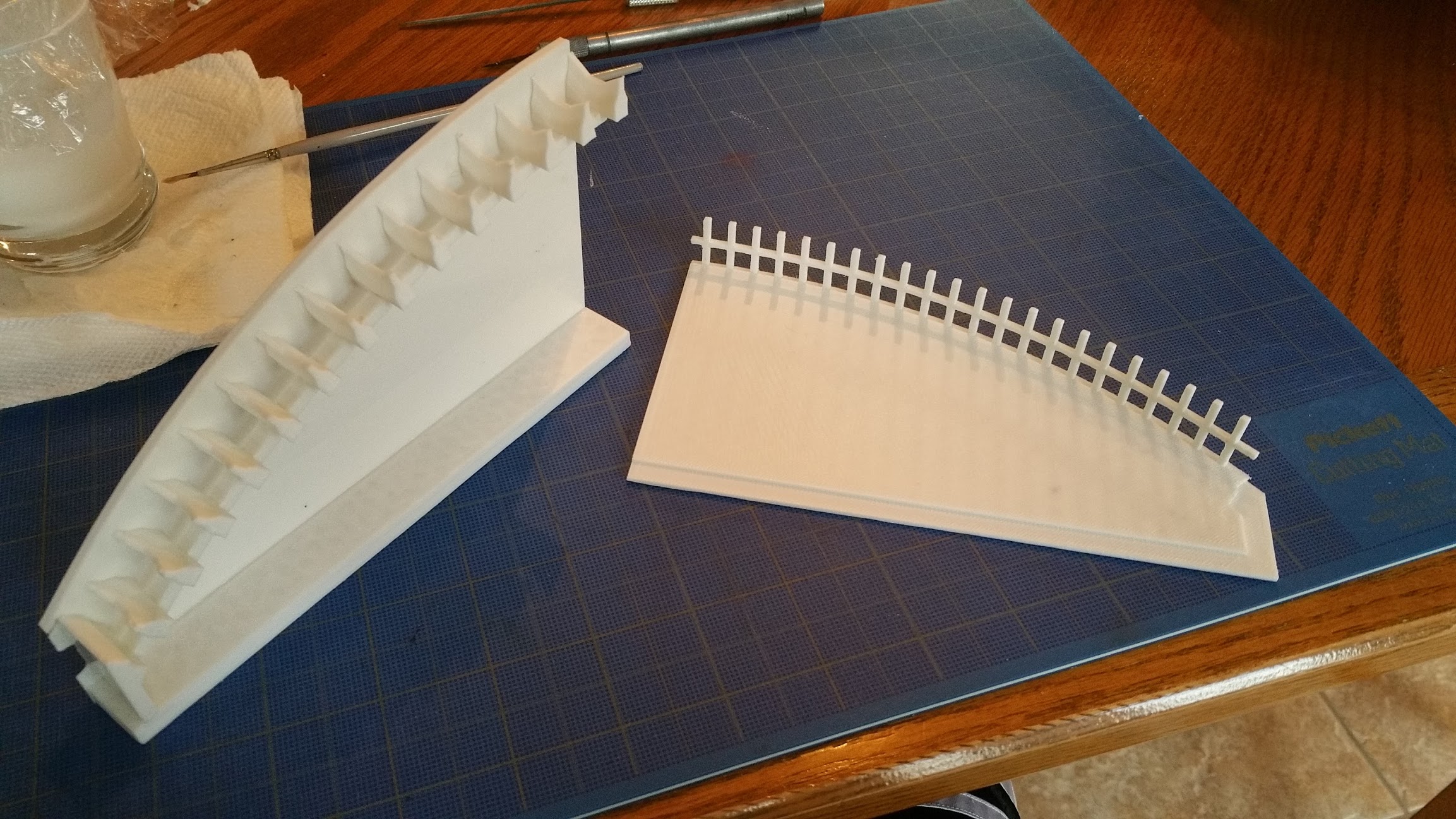

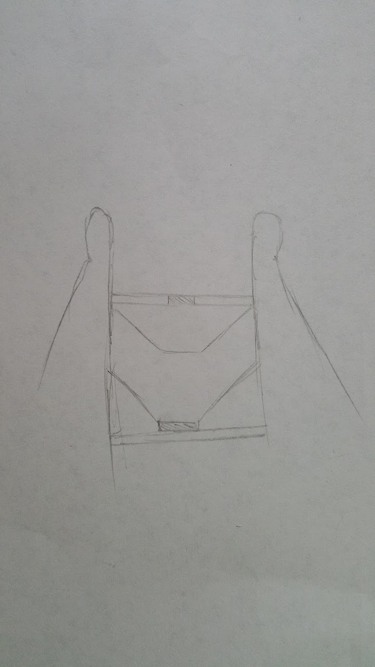

So from those images and several others I looked at I did this quick sketch showing the design I believe is pretty accurate to what the official falcon engine assembly would look like.

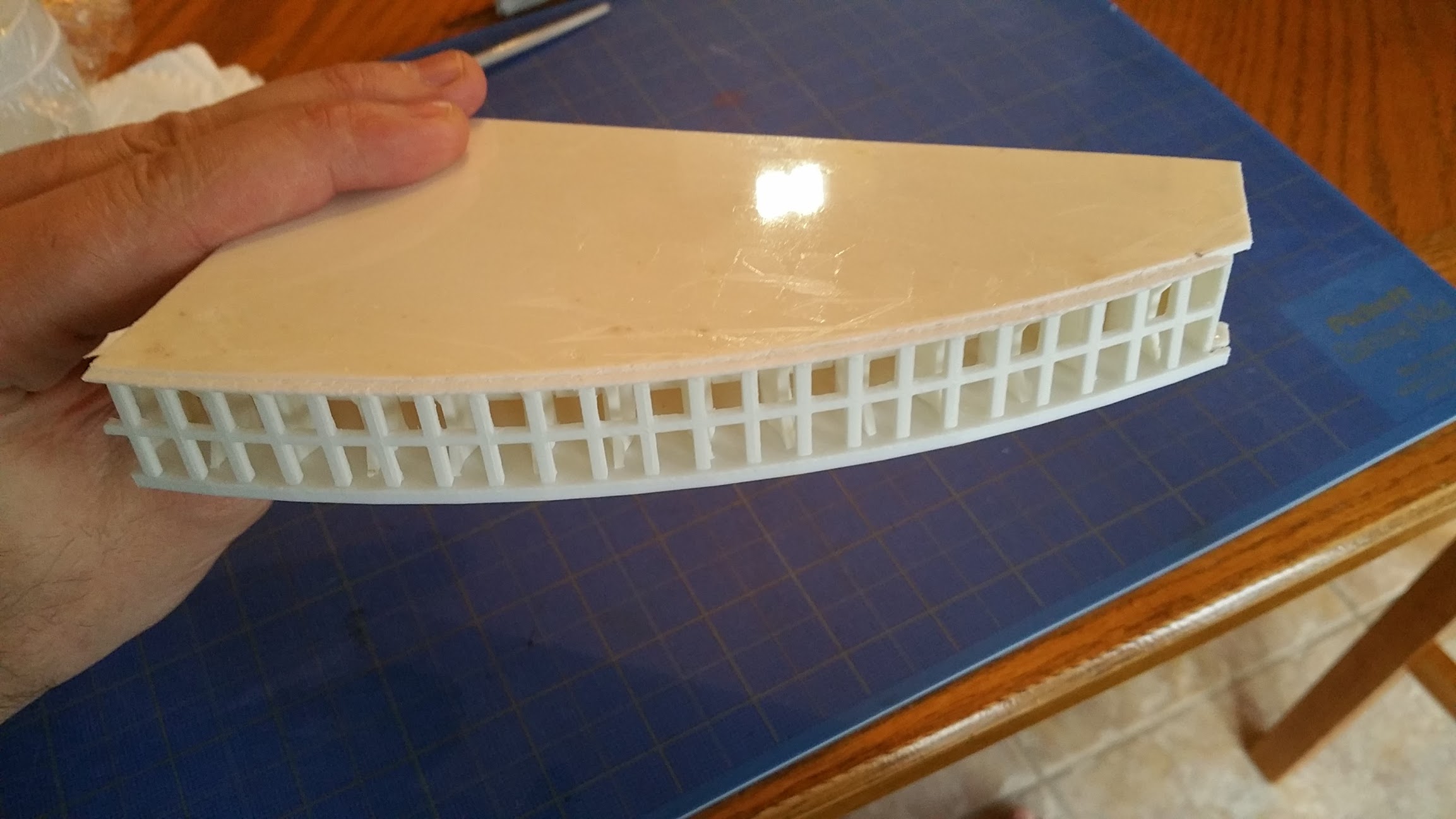

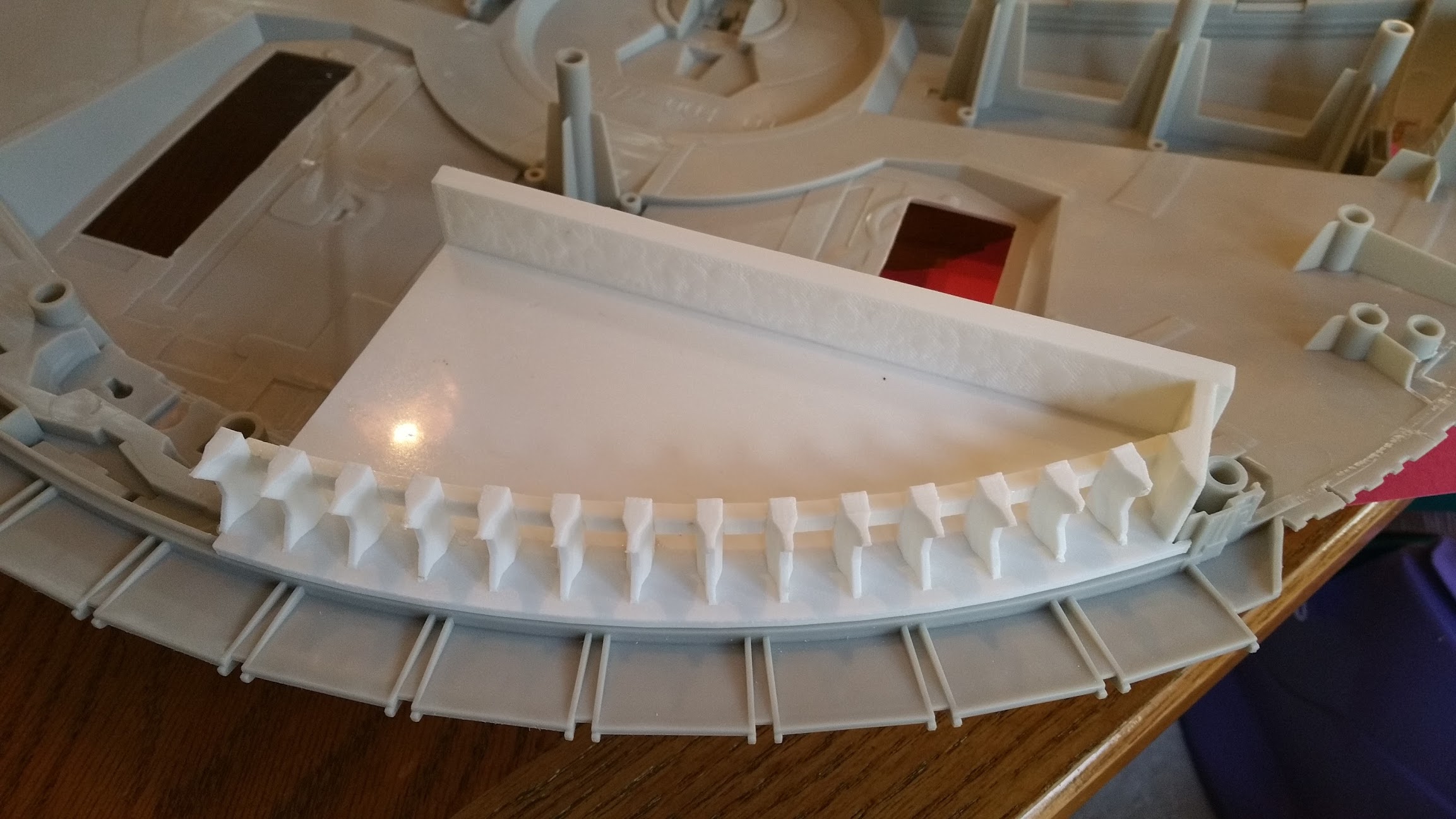

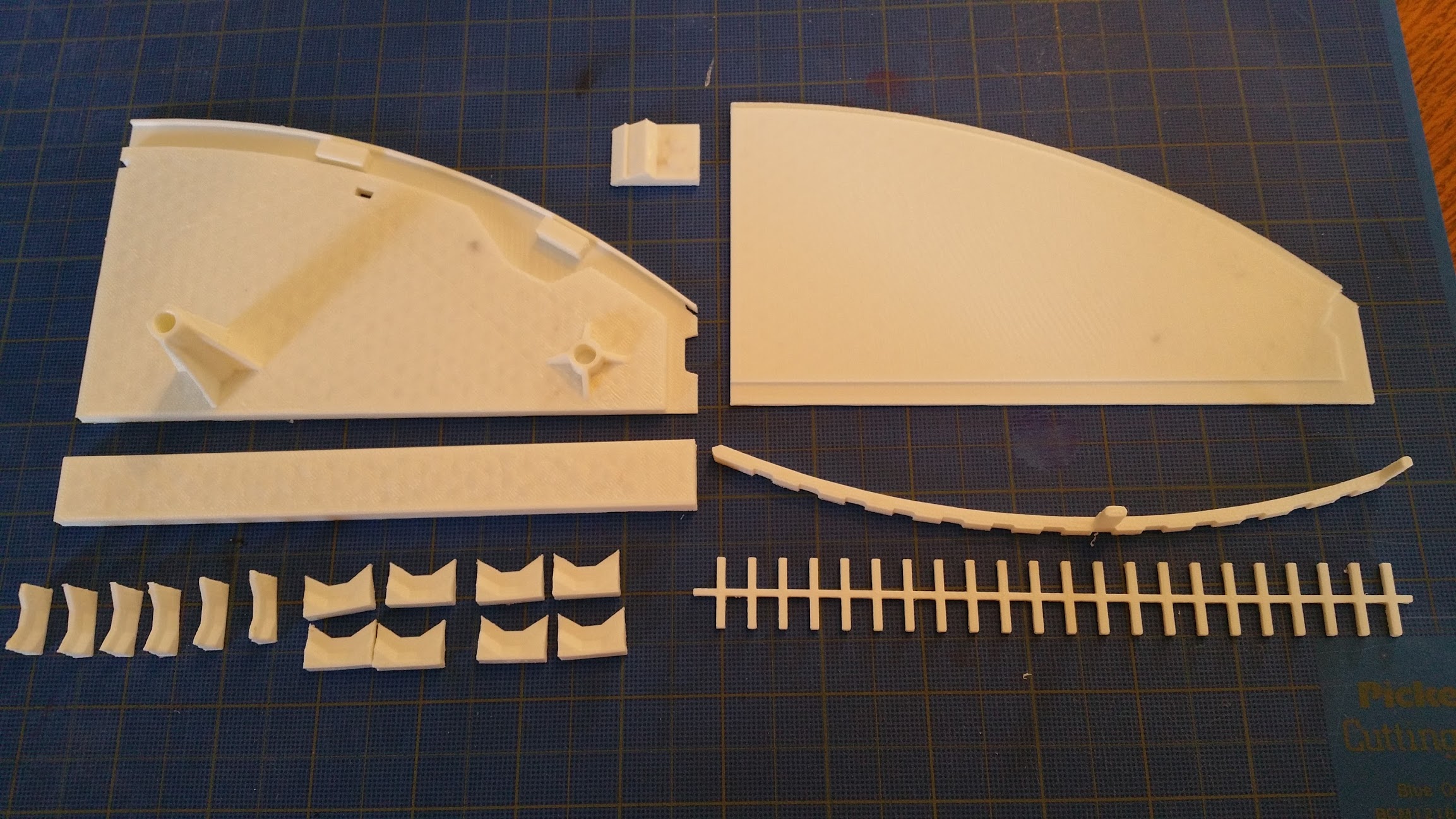

Now that I had that figured out I started modeling out a 3d version of this. I built it with space to add some lights and so that it would fit into the Hasbro Falcon in a way that its design would give support to the opening since to replace that flat plane would take out 5 major supports on the model.
So here are all of the parts from my final design.
Here are the top and bottom parts of the right side glued together:
The final assembly of the right side of the engine:

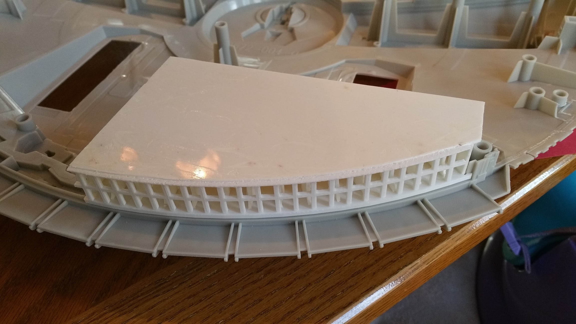

Here I have cut out the space for it and placed it into the Falcon. Fits like a glove!!
And with the lid on it.
And with the top of the Falcon in place:

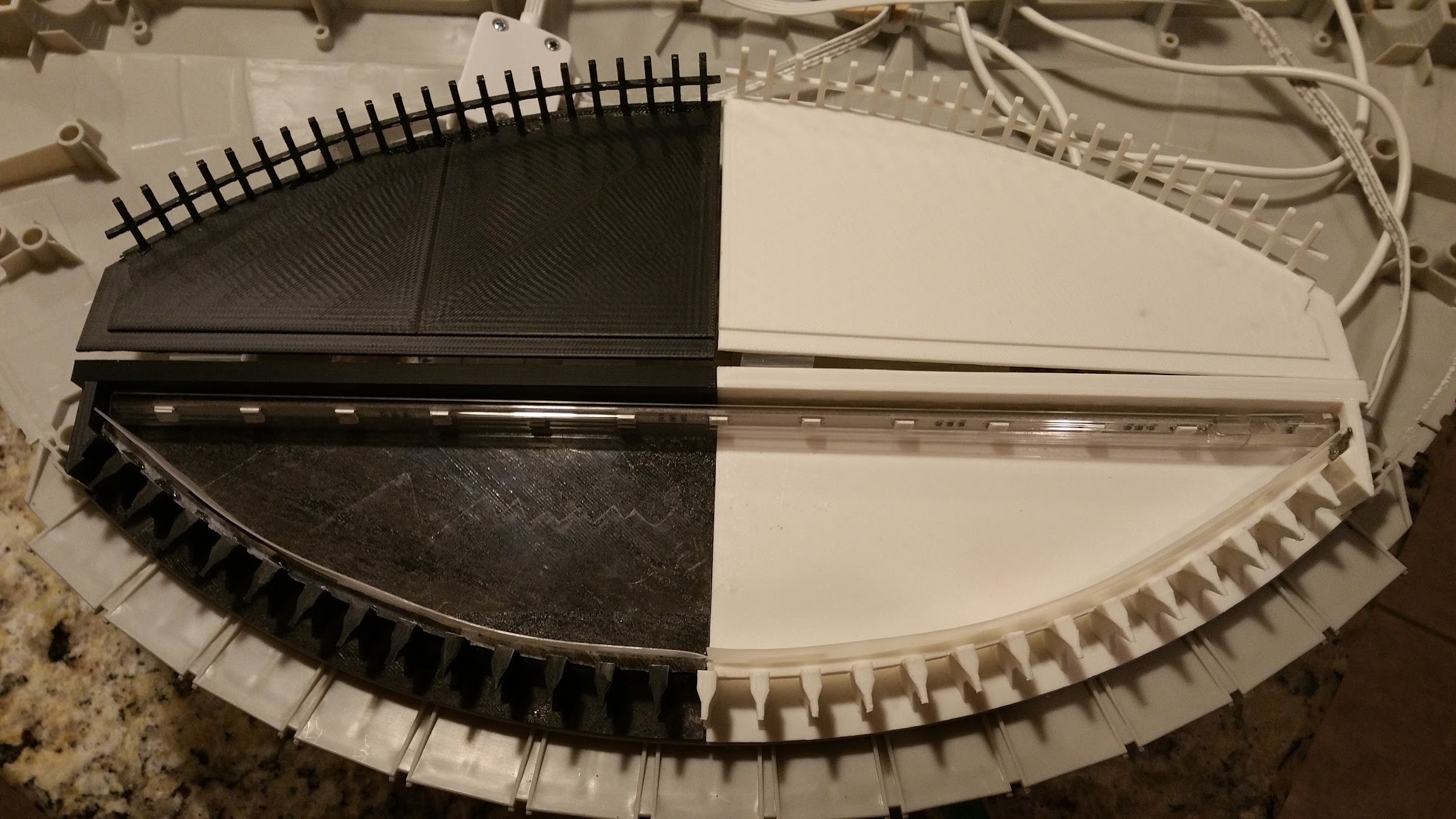

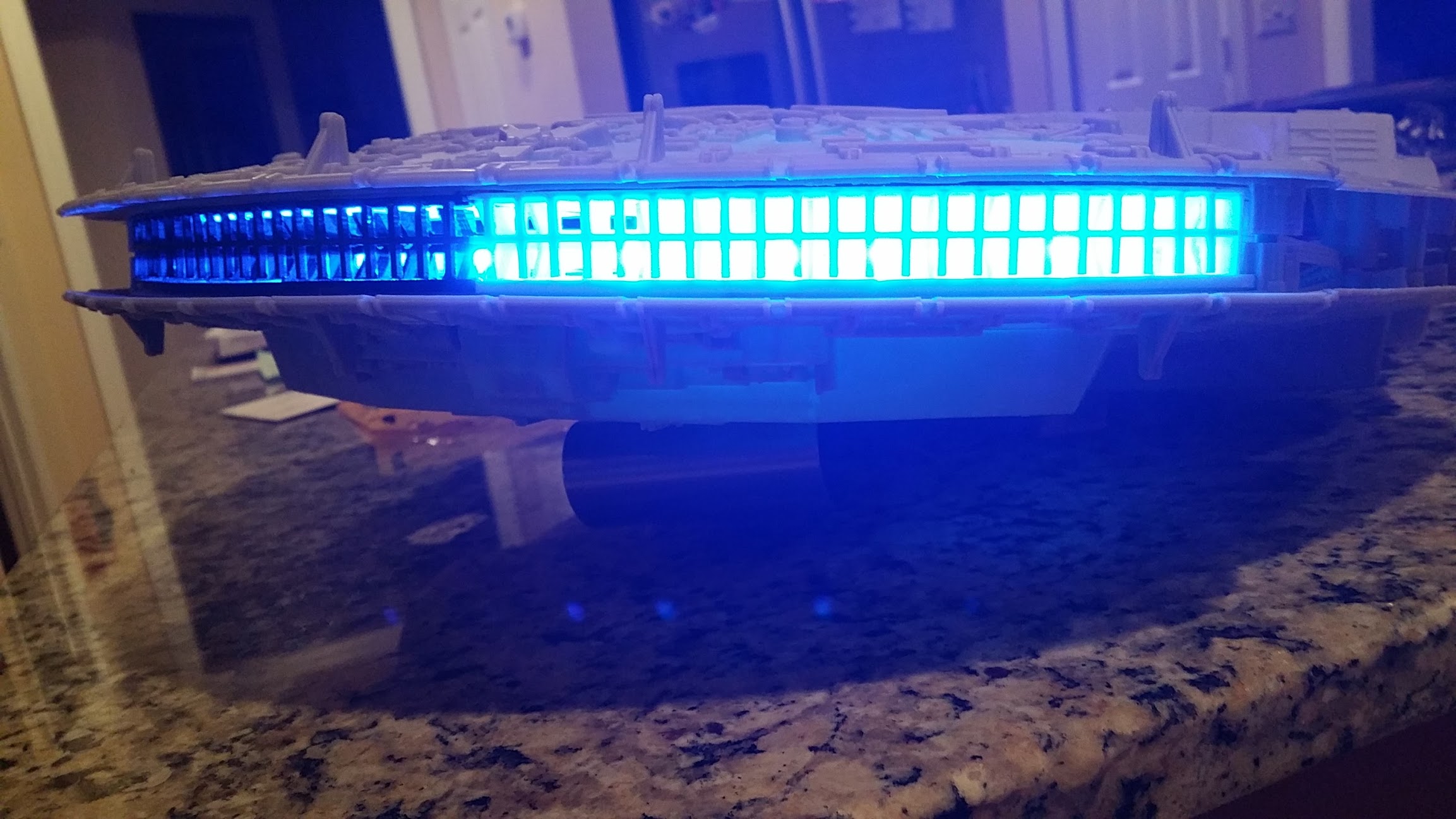

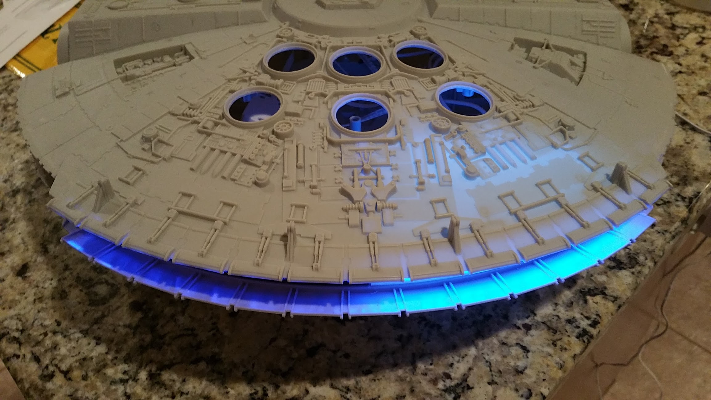

So the next step was to build the other side. I noticed that the white ABS allowed a lot of light to leak so I printed the other side in black to see if that helped. Here is the entire assembly opened up with the 12 LED light bar placed in it so you can see how it works.
As you can see here, the black ABS clearly blocks a lot more light!
The one part that is missing is that on the back of the slats support, where the light is going to push through I needed to add something like a frosted clear plastic to diffuse the light. For now I did this by just cutting out the shapes from a milk carton. But in the end I think I am going to get some thin acrylic or styrene strips and lightly sand them on one side with a high grit sandpaper to give them a frosted look.
Here is a link to a video I made of it that shows how it looks a bit better.
After doing some tests with painting, I have decided to print it in white ABS, and then paint the outside of the assembly black so that I can control where the light leaks and where it doesn't. I think that will allow me to give it a better look. As both of the sides above (all black and all white) have issues with how it directs the light. Once I get it all finally assembled, painted and glued together I will post more pics to show the final effect.
