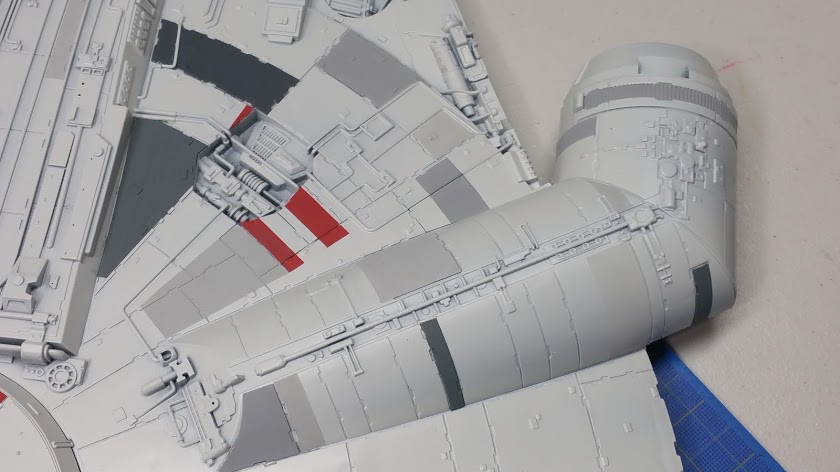

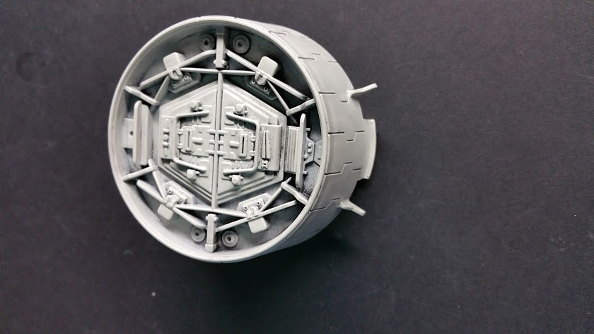

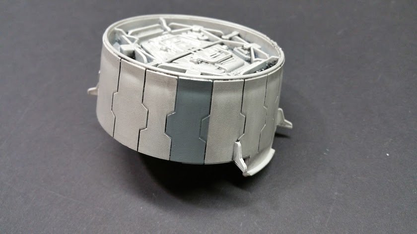

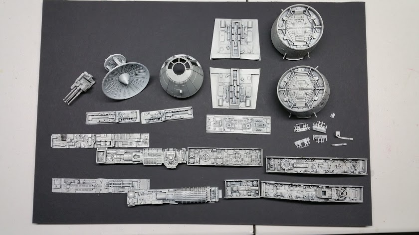

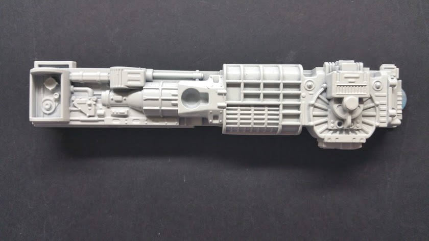

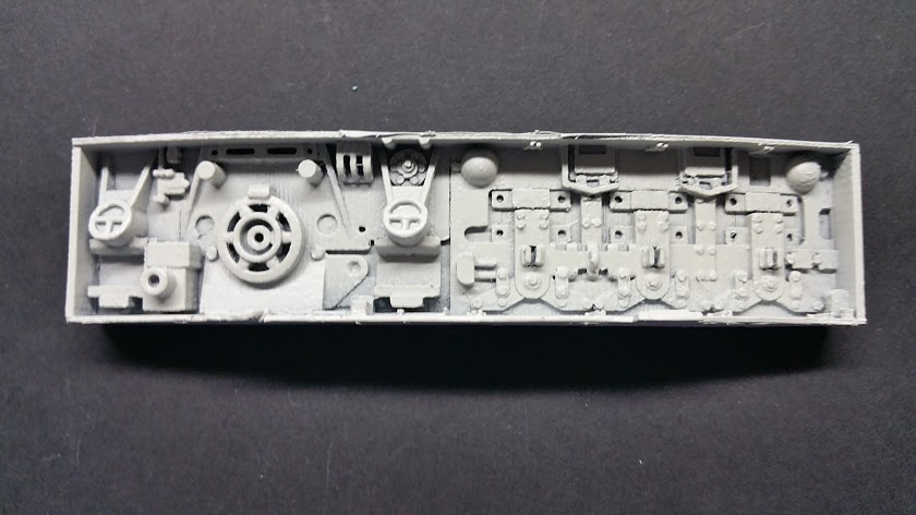

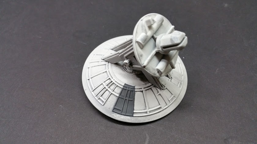

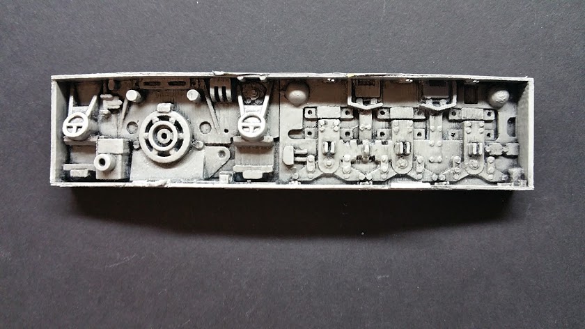

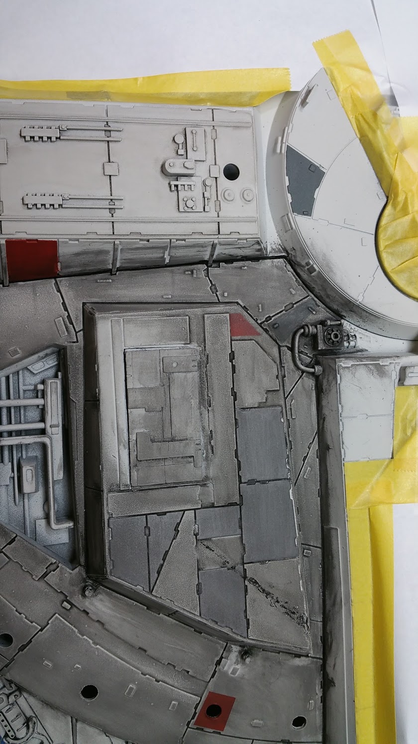

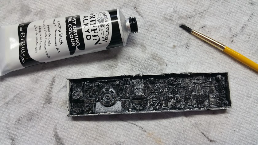

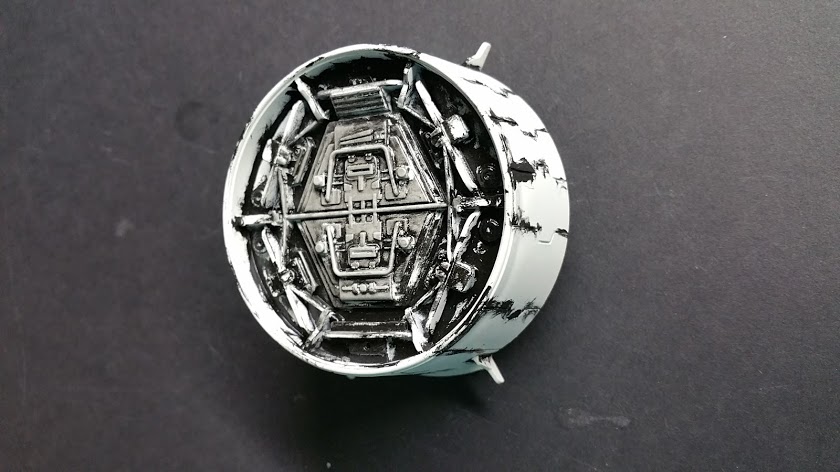

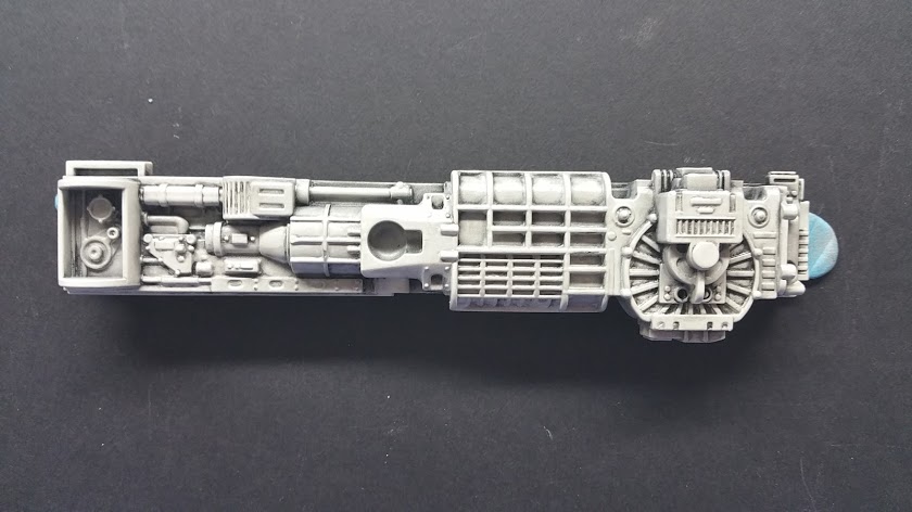

Next for me was starting to apply a coat of oils using Windsor & Newton Lamp Black fast drying oils and a microfiber cloth with some Q-tips. So I went through all of the smaller parts first. With plans to do the hull last.
Here are a few pieces I did.
Before:
After
Before:
During:
After:
And Finally...Before:
During:
After:

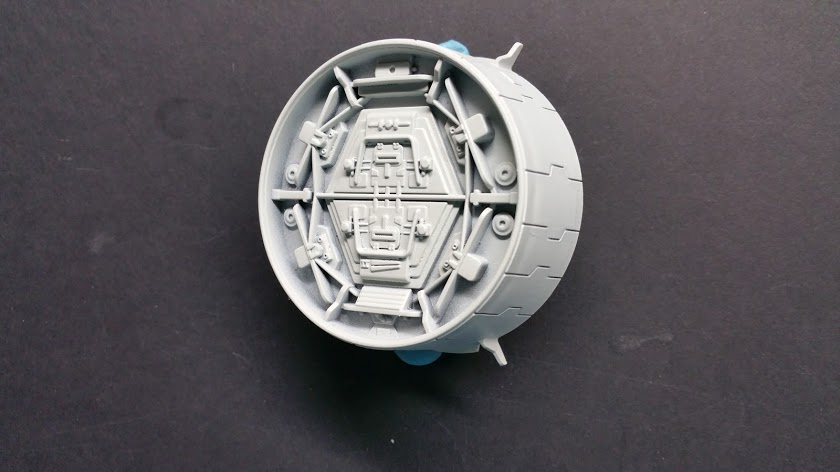

And here are all of the parts after applying oils.
One problem with this plan I discovered is that I should have painted any colored panels before doing the oils!!! Luckily there are only a couple on the parts that I already oiled that I had to touch up. So I masked those off, painted the panels, and then applied oils after the fact to get it to match. Worked pretty well.
Super glad I discovered this mistake BEFORE I starting applying oils to the main hull!!!

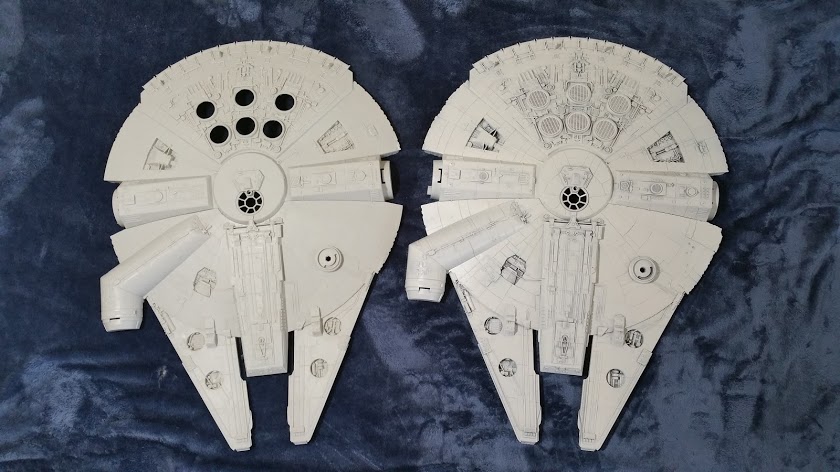

Also I took this picture to post it just so I could show off the difference between the base model and the model after painting Insignia White over the black wash. Base colors are surprisingly close, but you can really see the details pop thanks to that black base coat!

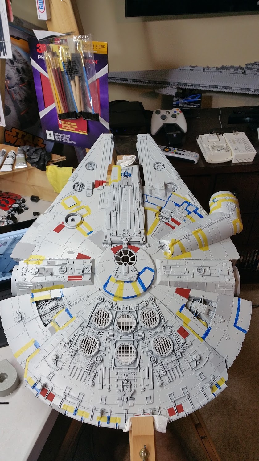

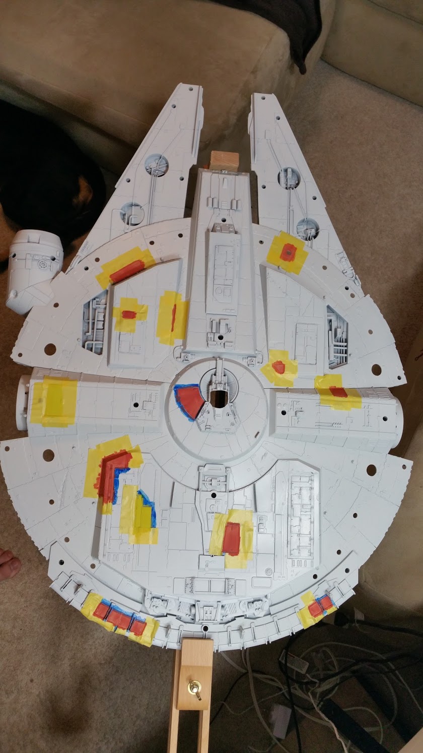

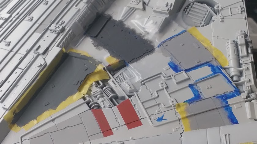

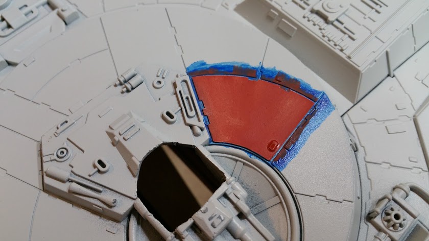

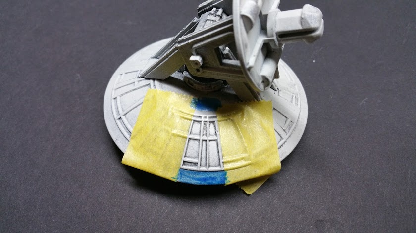

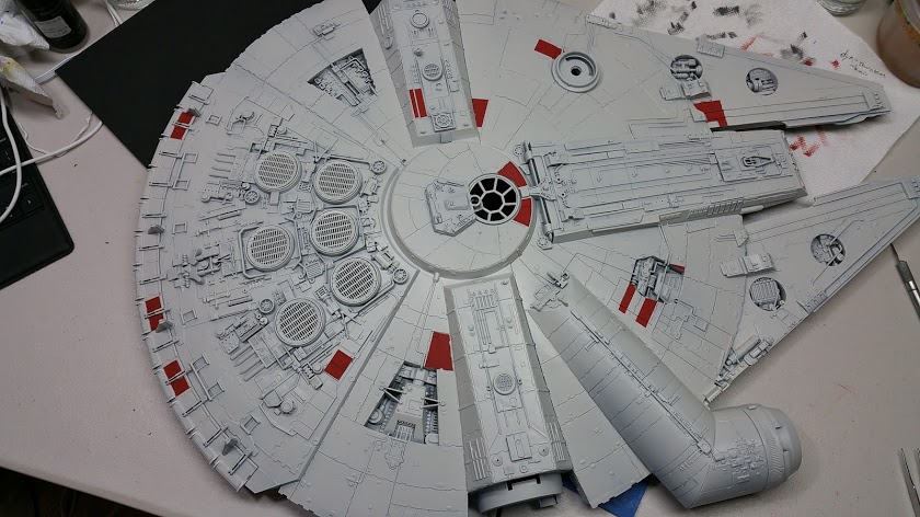

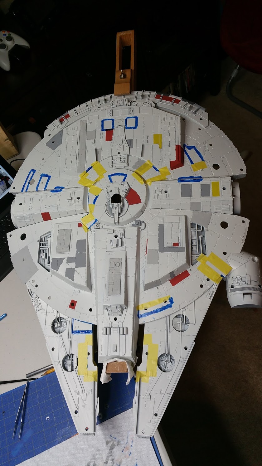

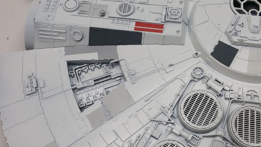

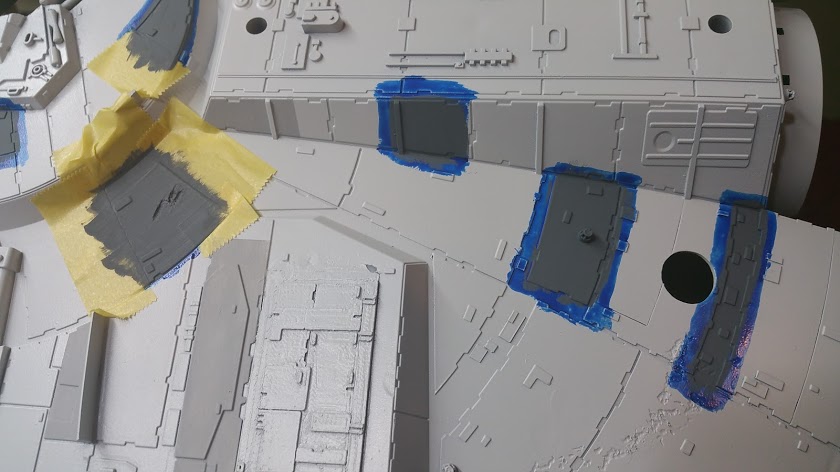

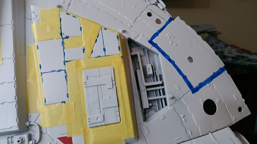

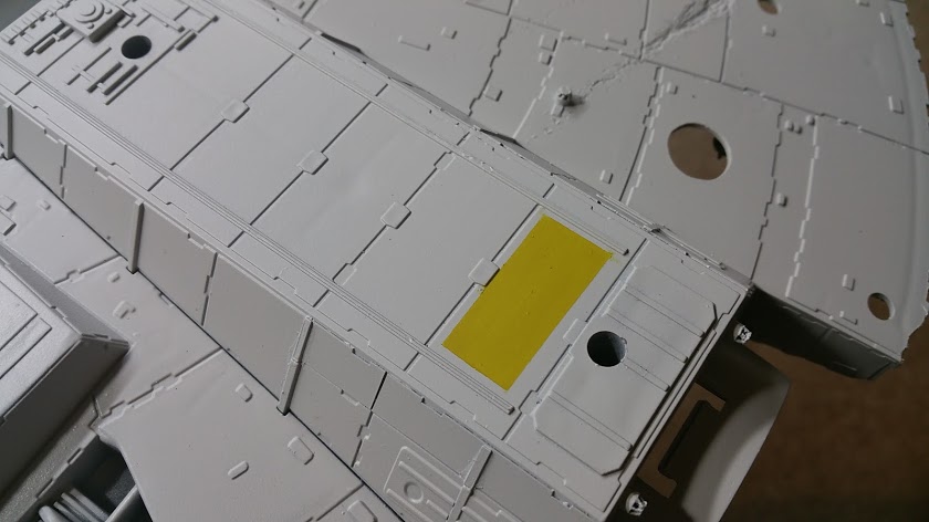

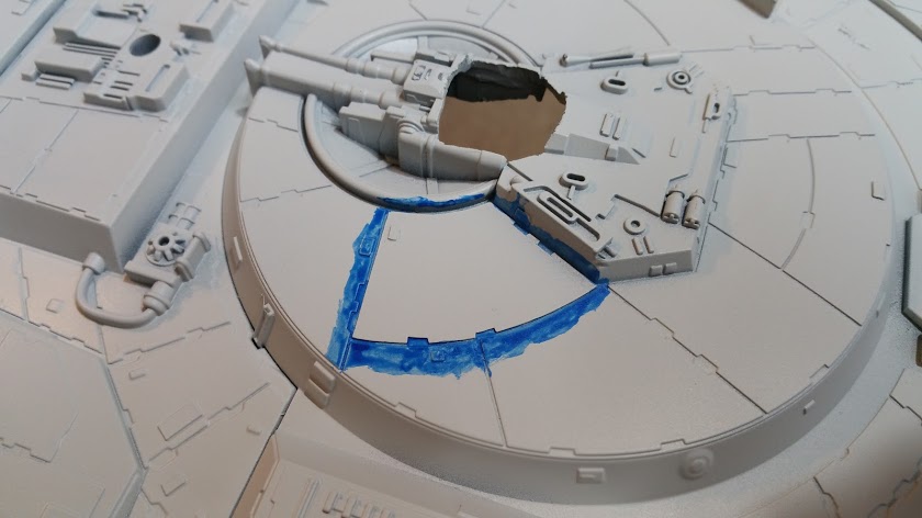

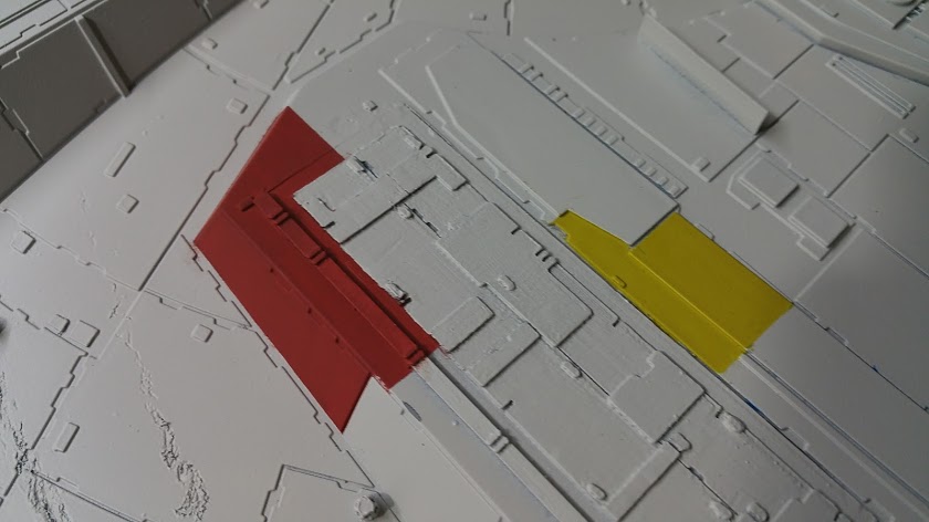

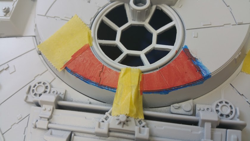

I have been spending a lot of time lately masking off and painting panels on the hull! I started with the bottom as it's not going to be as seen. Figured I would get some practice on it before I do the top. What I have learned...masking off the panels is the MOST tedious part of this project to date!!! Especially when you are a perfectionist like me. And honestly its no where near as good as I want it to be!! Fighting the paint bleeding into seams of the mask and tape is painful!

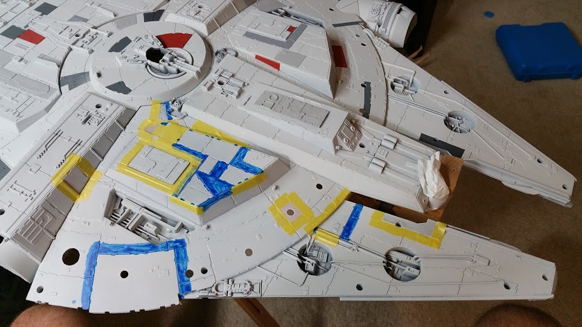

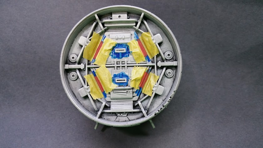

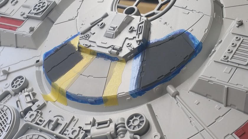

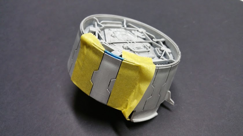

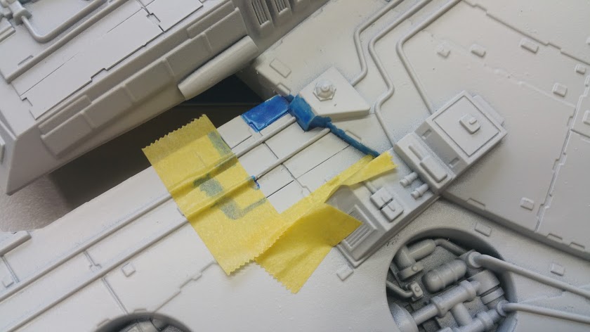

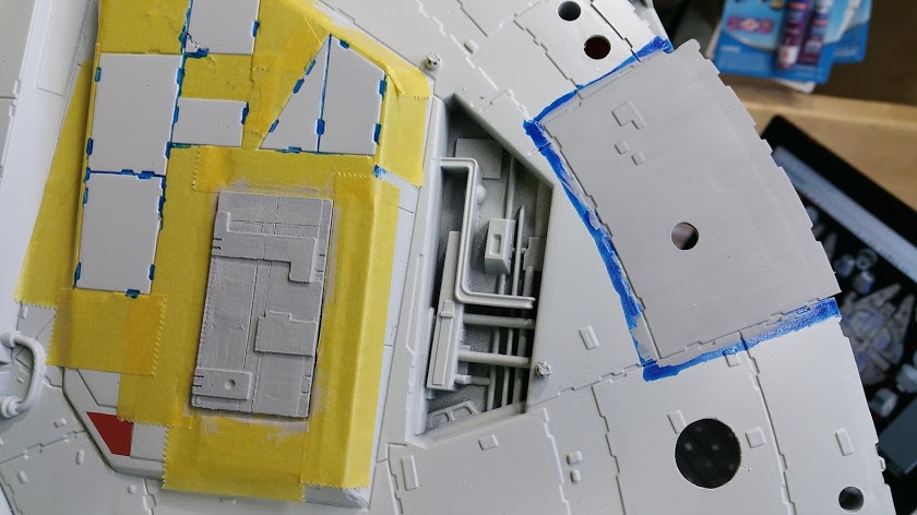

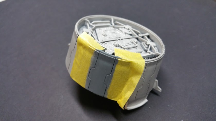

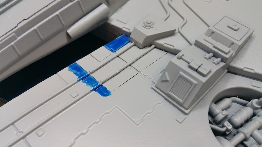

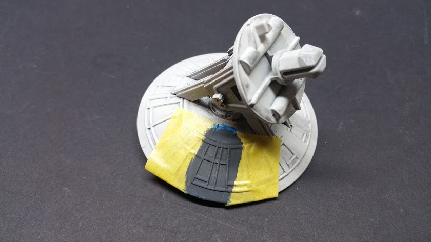

Here are a few images of some areas I masked. Won't bore you with them all.

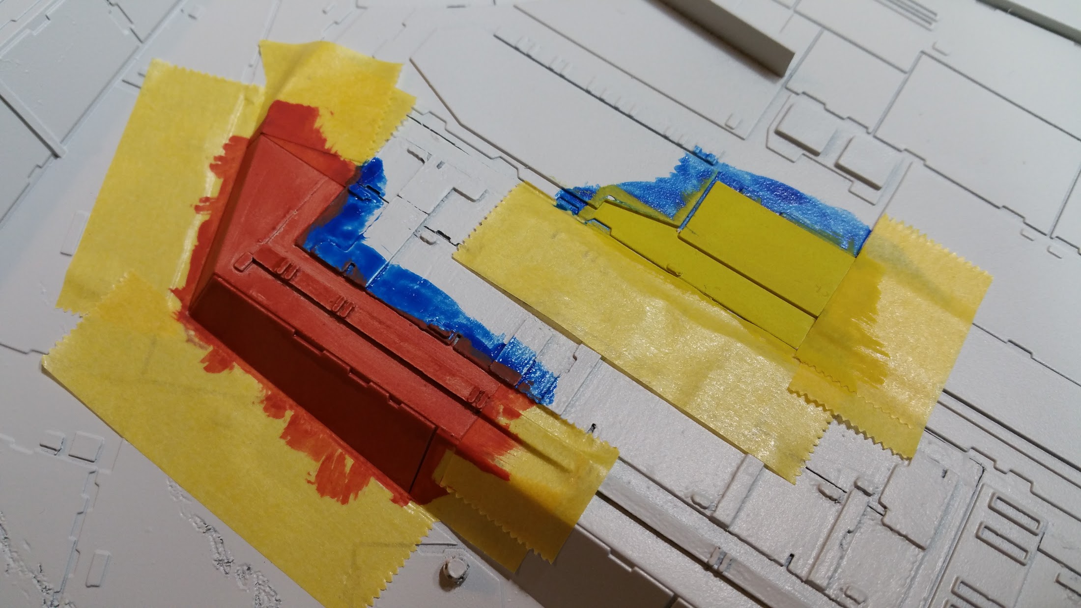

Then I painted again with thinned Tamiya paints and a brush. These pics are after only the first coat. I think I did about 2-3 more coats after this. You will see it better what the final look is later.

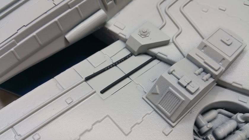

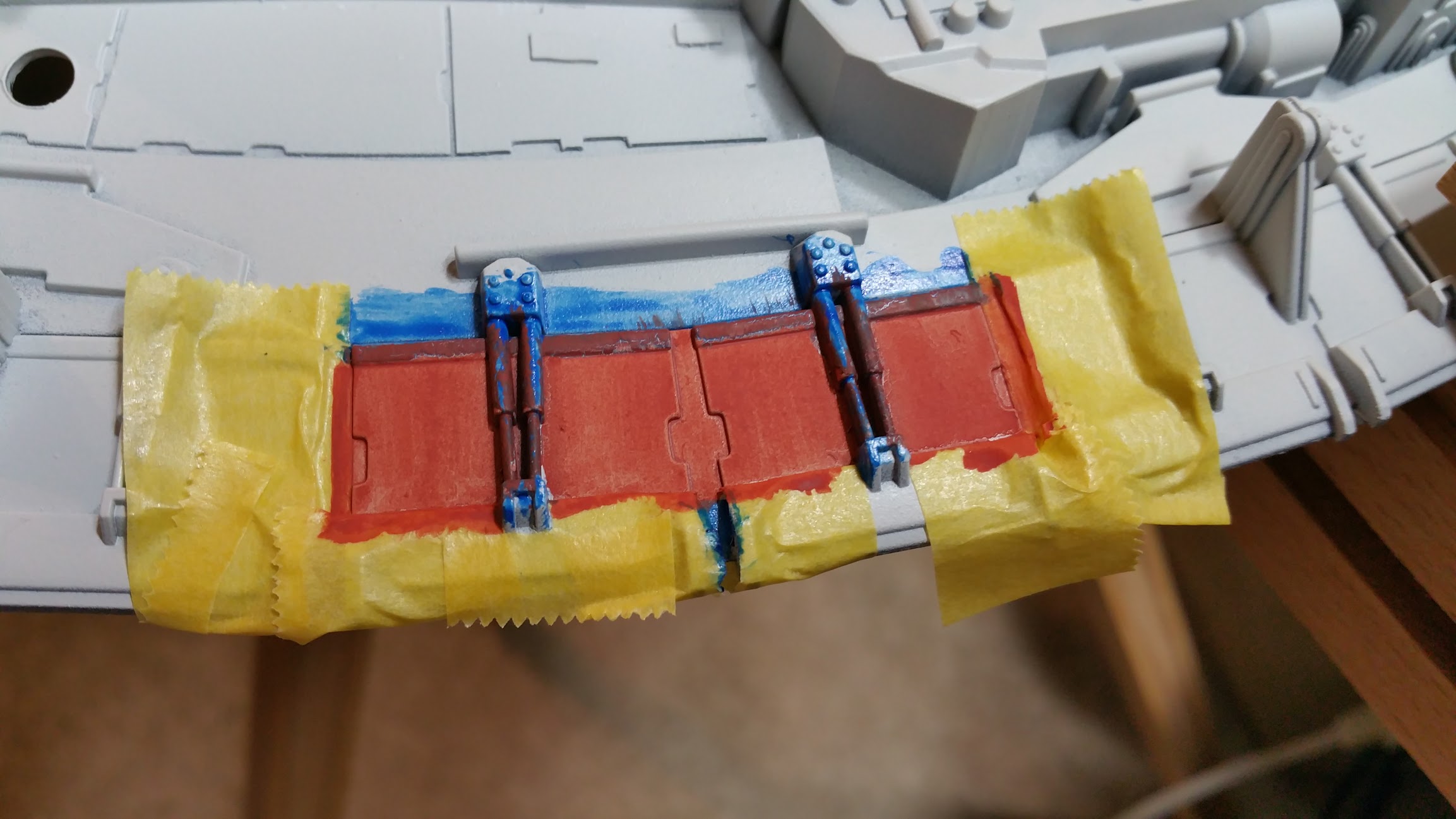

In the process of masking and painting I realized I missed a few hoses. Needed something I could add on without cutting the hull to make room. Found a wire from an old laptop I scrapped for parts and cut these and replaced it.
Here is the bottom after doing all of the red and yellow.
Then I did the top.
And the top after final red panels.

Re: SirCharles77's Hasbro Millennium Falcon Conversion
Wow. Looking really really great.

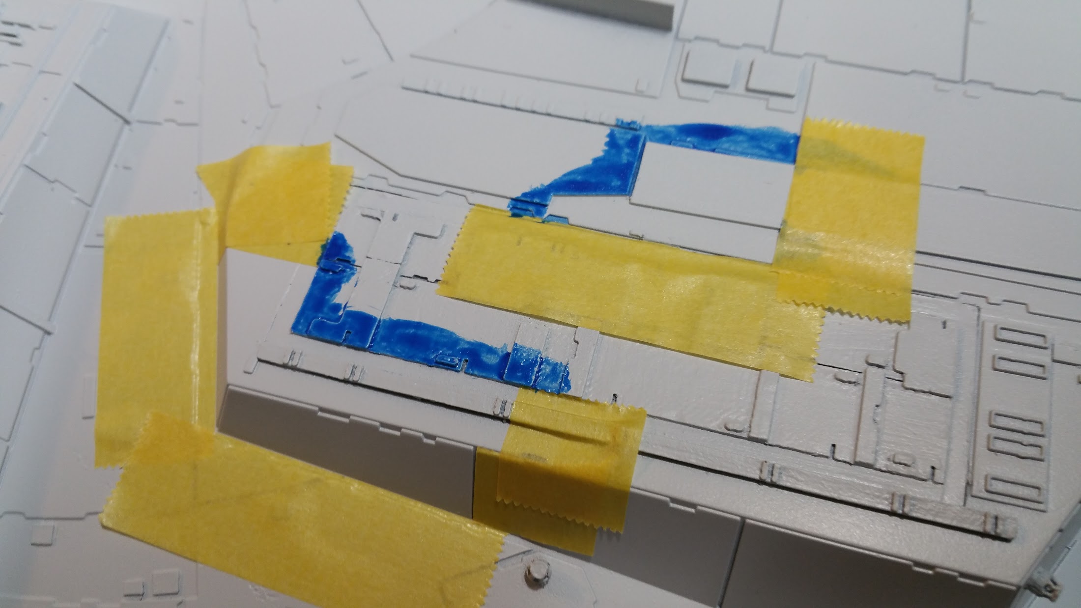

whats the blue stuff you're using for masking?
Is it possible to paint them by hand ?

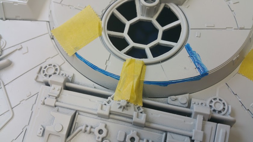

Masking fluid, also called liquid mask. there is various brands and makes, His looks like MicroMask, its blue in color like that. Depending what you are working with you can use thinned white glue for a same use.
That is correct I am using MicroMask. It works pretty good. Sometimes it's a little hard to get off but usually it's good.
Sent from my SM-N915V using Tapatalk
If you have an airbrush (or even if not, can be done with a brush too) apply a coat of "Future" to the mask. The clear coat will seal the edge of the tape, preventing bleed through. Since it is clear, if IT bleeds through, no worries.
The varying sheen will be consolidated at some point with a flat (matte) clear coat application.
Regards, Robert

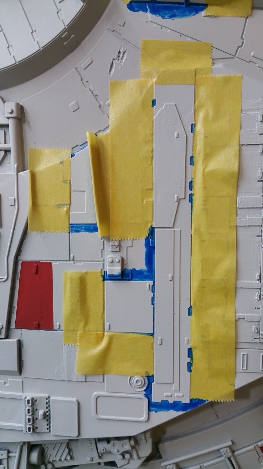

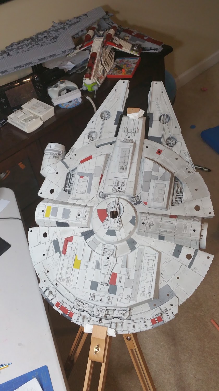

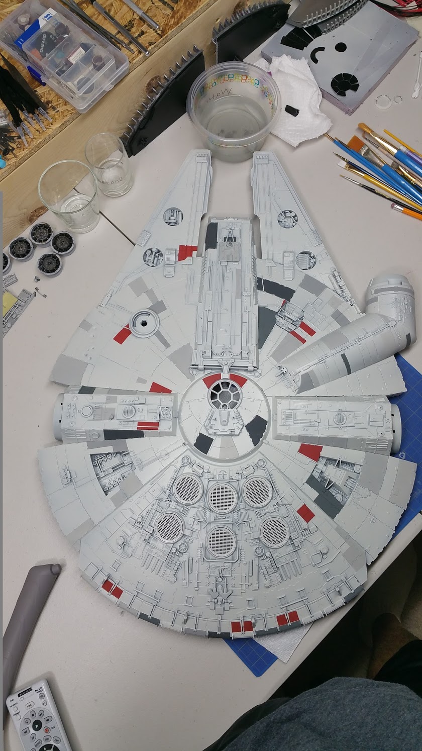

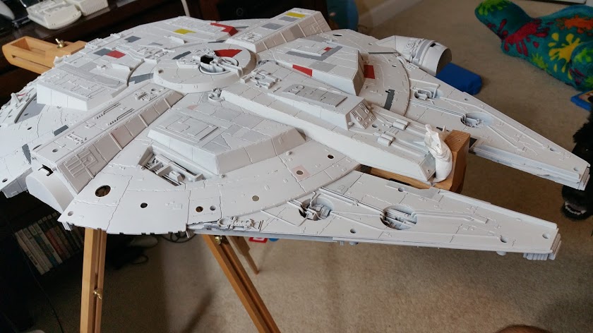

It's been awhile again!! I seem to have a tendency to work for a while and go dark and then do big updates all at once! HAHA

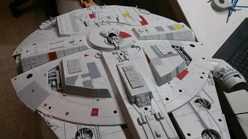

Essentially all I have been doing for the last month is slowly trying to get the paint job done on this baby. Masking off all of those panels and painting them was very time consuming!! Way more than I thought it would be but it is now done!!! Here are some various pics of my girl over the course of that process.

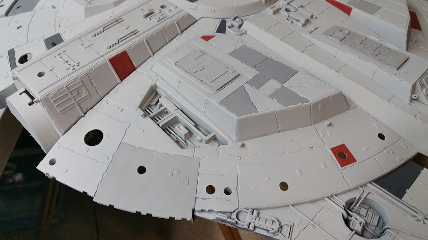

Here is the bottom with all panel painting finished!
Next it was time to start on the top.
And here is the top with all panels painted and ready for weathering!!
Next step is weathering!! The scary part! Will get to that in a post soon.

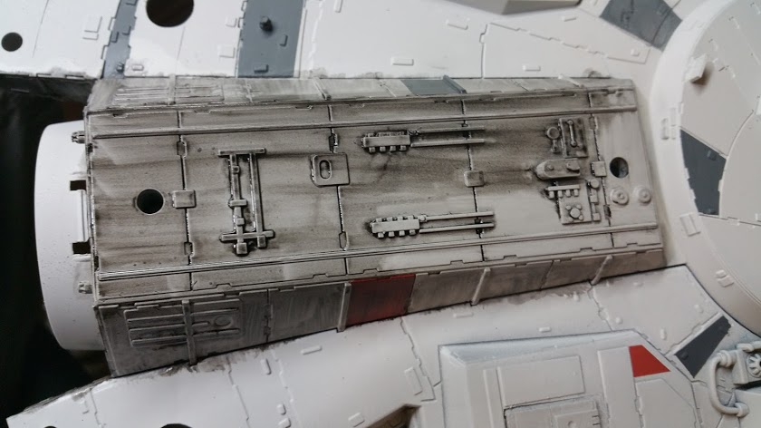

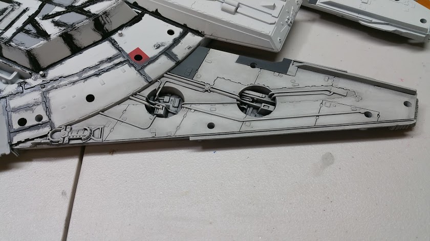

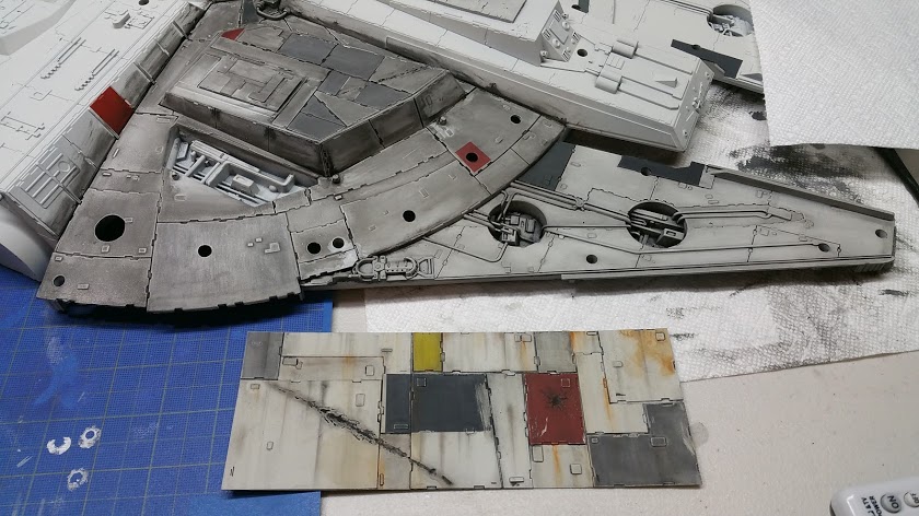

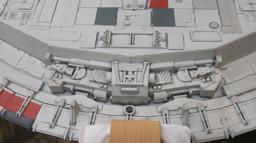

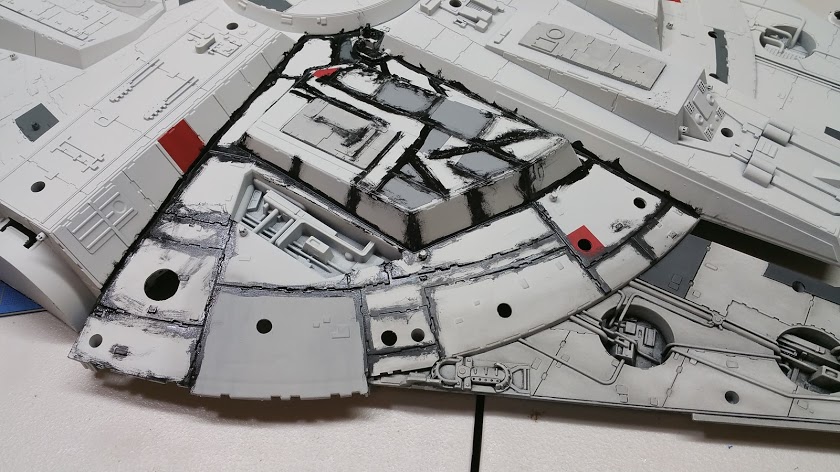

So I had a problem. My next step was to start weathering. I planned to use the oil technique that I showed earlier in this thread which worked great on my test panel. I attempted it on the bottom left mandible to see how it went and it was too dark! Way darker than it was on my test piece which had me concerned!
Here are some shots of that.
So I thought that maybe a dull coat would make it not soak in as much. So I did a dull coat over the piece and tested it again and its even darker!!
You can see my test panel below this shot. I am very confused as to why this happened!! I used the exact same process both times and yet different results. This is why I am so scared of painting!!! Such a finicky thing!
Well I decided to try something different and got much closer to the results that I was expecting. So for this one I used the regular oils (As opposed to the fast drying ones).
First I brushed over the surface with some turps to get it wet.
Then lightly put down oils in the areas where I wanted it to be heavier, and then brushed the oils in with a little more turps on my brush.
Then let it dry for a few minutes. (You don't want it to be completely dry but you don't want it really wet either.) Then rub off the oils with a microfiber cloth. You can use the rubbing to really clean it up in some areas or leave it heavy in others.
It's MUCH easier to control using this method and it allows me to control the heaviness of the oils a lot better! I can do it in layers this way to get it thicker or thinner in areas and I don't have to worry so much about overdoing it on accident. Here is how it looked.

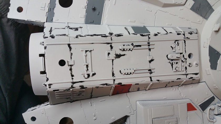

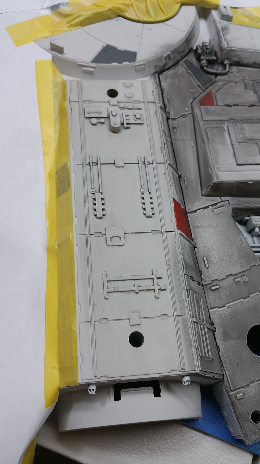

So on that note, here is another update.
This is the turps\oil\turps\wipe method I described earlier put into practice.
Dropped some oils on in the crevices.
Wiped over it with turps. And as you can see in the bottom right of that section I wiped away part before I took this pic so you could see the result in comparison.
Here she is with just that same top right section done. I will note that in this first part I accidentally forgot to put turps down first, AND I left it on to dry too long before I started wiping it away. As a result you will notice that it is darker than I liked and the middle areas where the oil was the thinnest is darker in spots than the edges where I wanted it. This sucks. But at this point I am just working around it. I could easily mask it off and fix it but to the bare eye its not that visible, and the way I am displaying this one you will rarely see the bottom anyway. I will post a pic of an area I did correctly next so you can see the results.
Here are some areas done correctly.
I didnt use any other colors when doing this like Blue or Rust. If I did it would probably add a nice discoloration to these crevices. Maybe next time I will add those.
