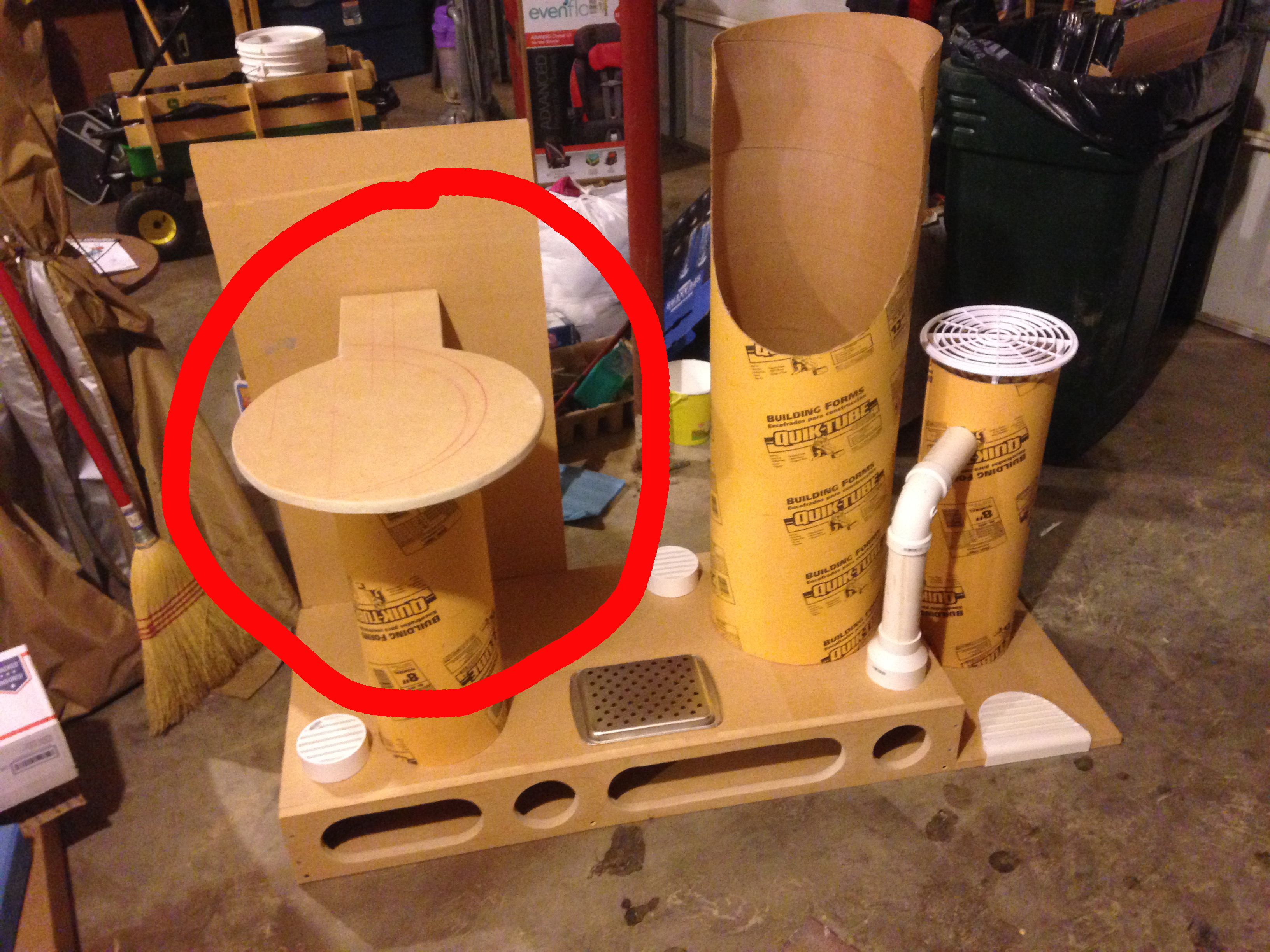

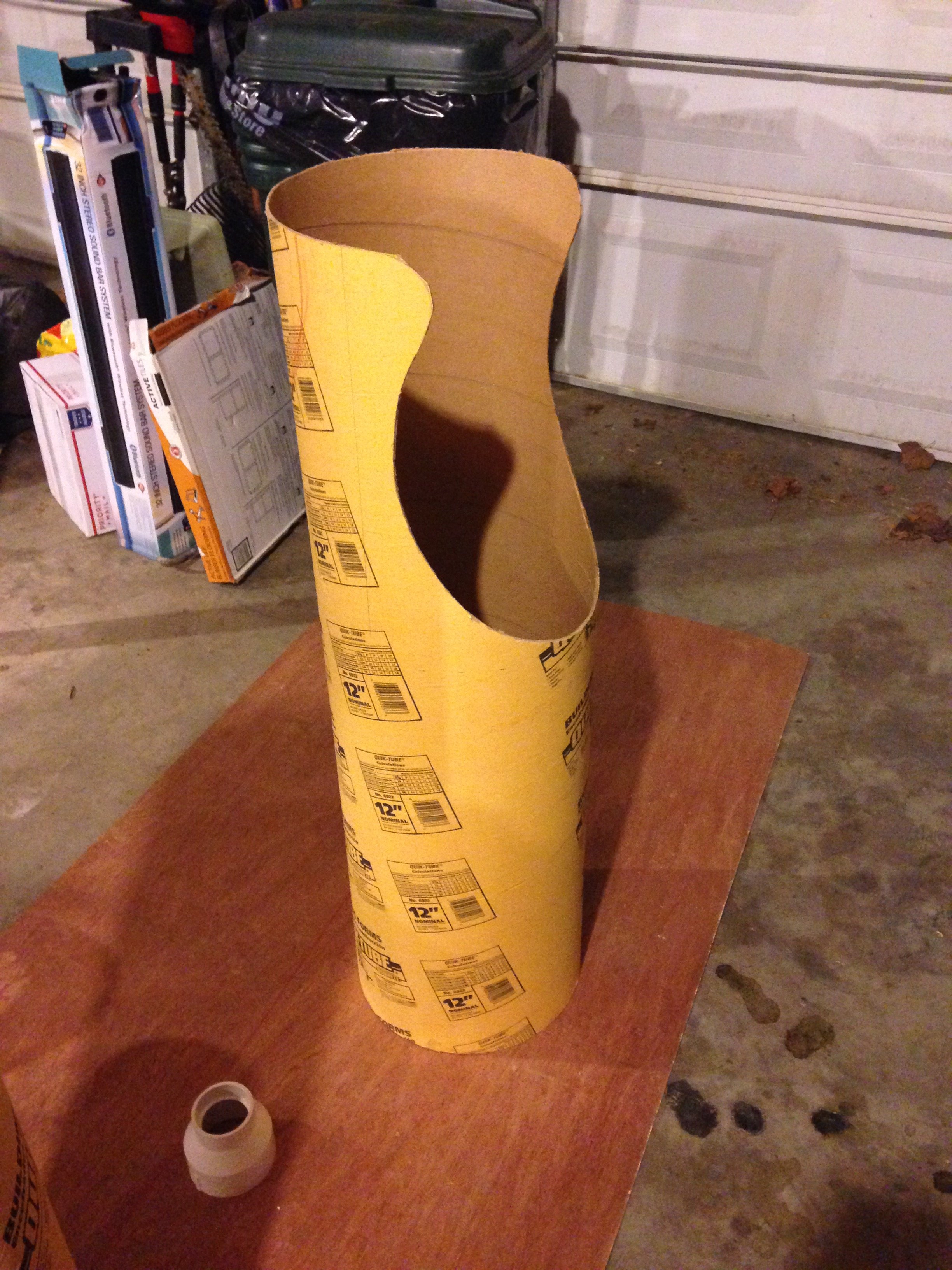

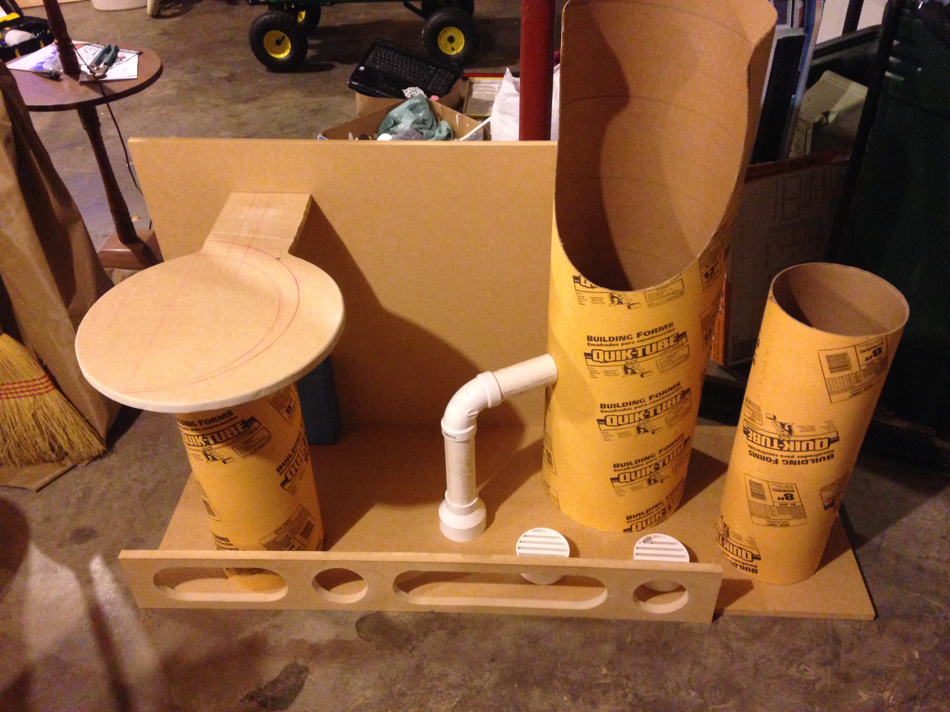

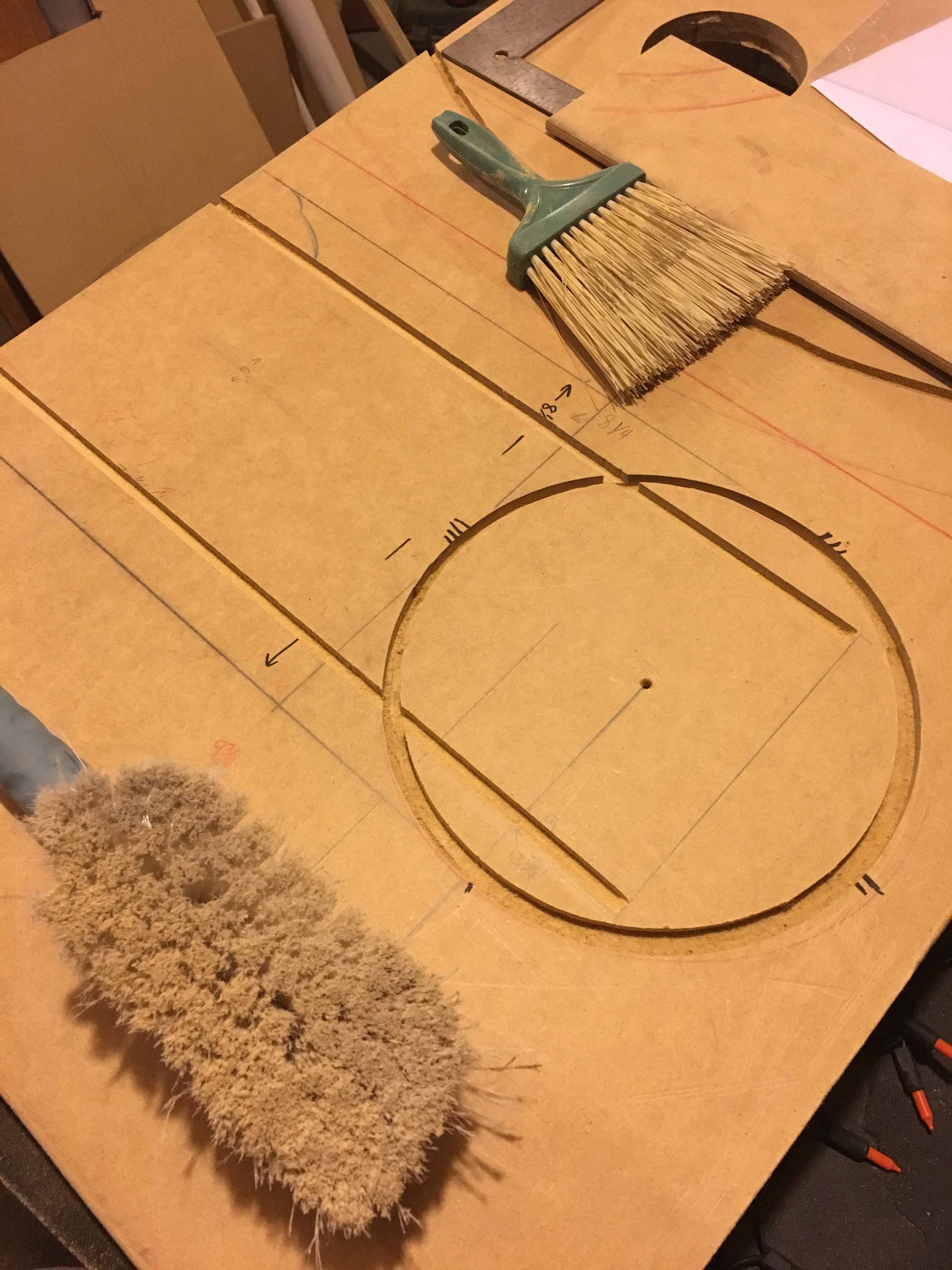

Hey.. looking to build a work station at the studio I work at. I am trying to make an area that will hold a few items, a paper towel roll holder (I may just buy this and incorporate it into the piece.), a glove box holder/dispenser as well as container for garbage (garbage can).
I am basing all of my build off of ESB Bespin City concepts and overall feel.. I am kinda designing this on-the-fly. I have the trash can design and a few others kinda figured out and wouldn't mind a little feedback, even though it isn't laid out plans.. I wouldn't mind suggestions on lighting and other effects. I am currently trying to figure out the lighting to get that"orange" glow of the carbonite chamber stairs etc...
I would eventually like to build an HIC, throne room window, falcon Dejarik table area and a TK outfit capable of meeting 501st regulations but that is to come..
Let's cross one bridge at a time..
Here are some photos of what is going on...
I found another post where someone was building a office area and they did a stage area with lighting resembling that of the carbonite chamber steps but I can seem to relocate it. I just was looking at ideas on how to light up the platform area with that orangish colored steps.
Will be building an area that holds my power supply and other items that will resemble the carbonite chamber control board.
This is also all the fault of Fuzzual's Smugglers Room. He has inspired me...
Thank you Fuzzual...
Hope to add to this post again very soon...
Thanks for looking

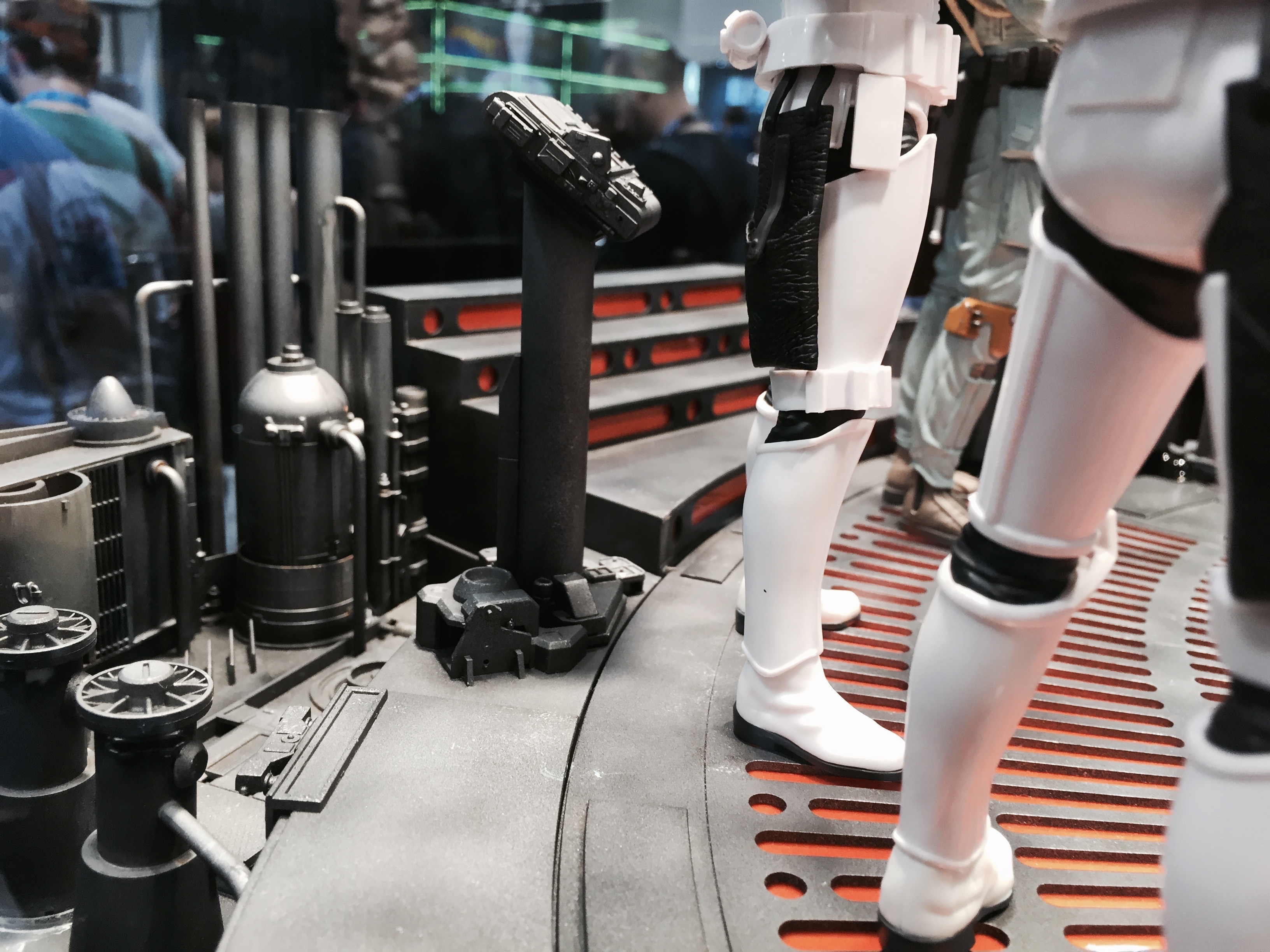

**Not sure if you need any reference, but I took these photos when I was at Celebration last april. It was a small mock up, but I loved the details. It helped me anyway.

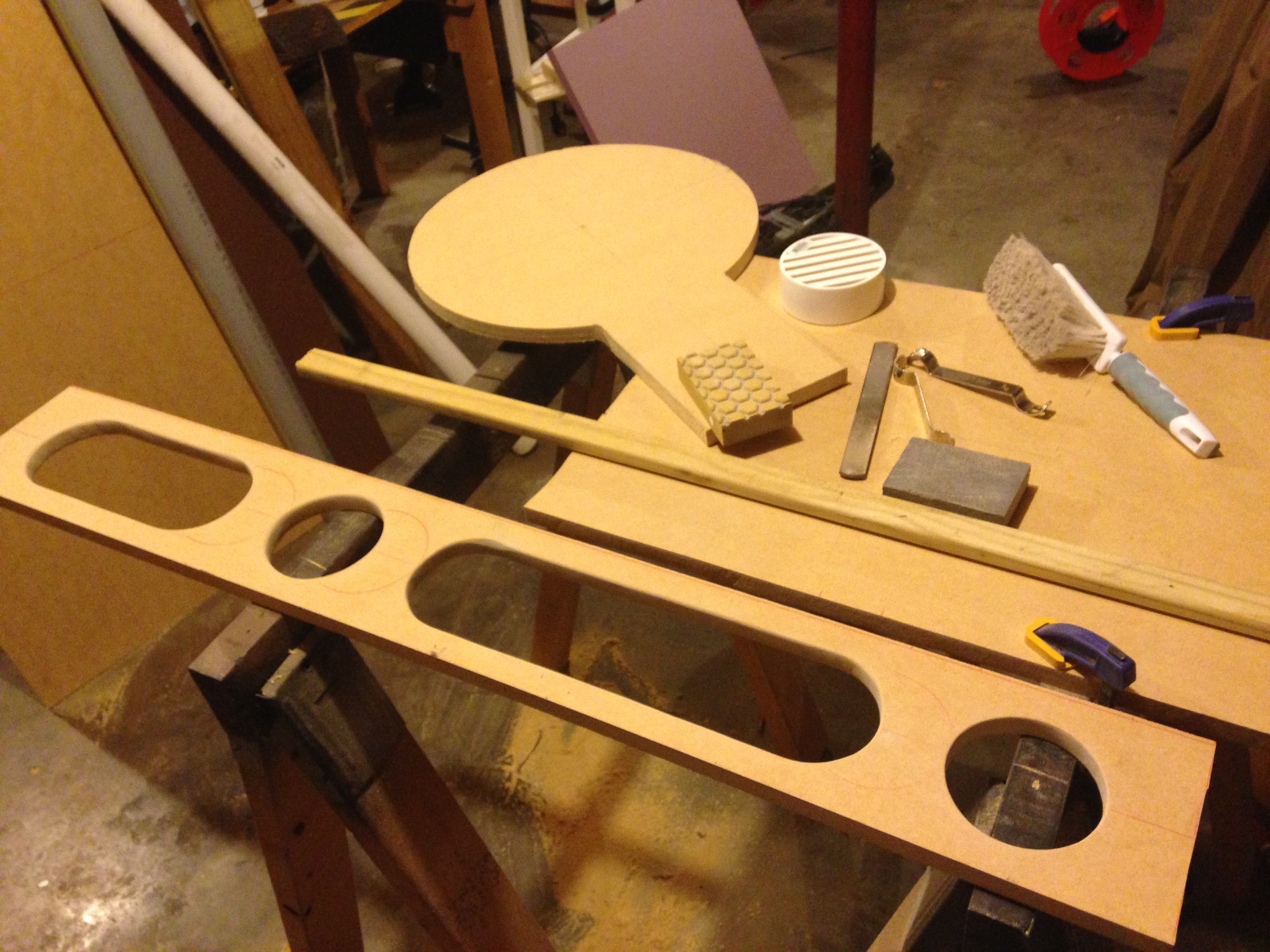

Thanks man.. I don't have a table saw so a lot of my cuts are horrible! ... but that will add to the "worn" look..HA! Just wrapped some orange wrap around a light just to see this...
Gosh this gives me goose bumps... right here.. in my garage... I have Star Wars!! This is too cool...
Can't wait to actually start adding all the lighting and painting.. This small project has gotten a bit larger...

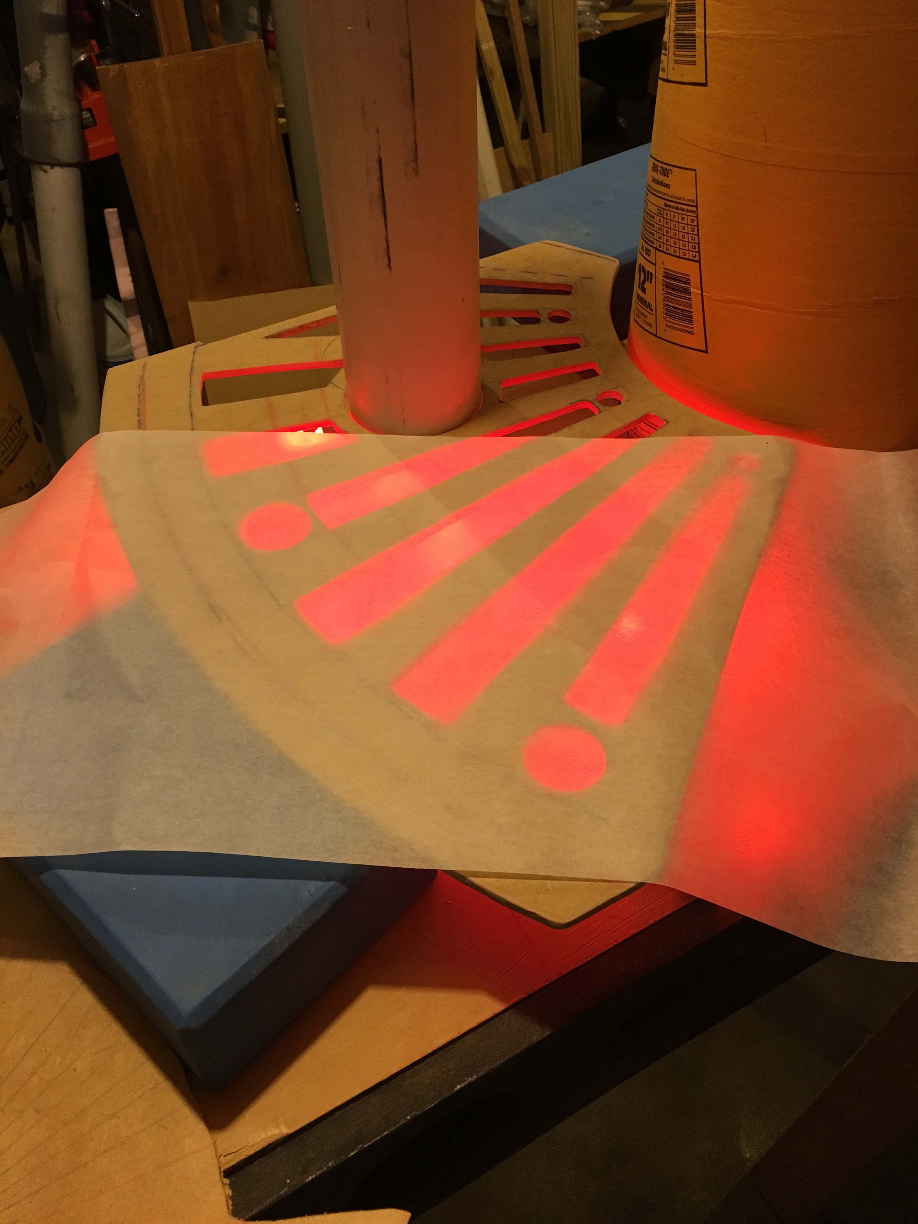

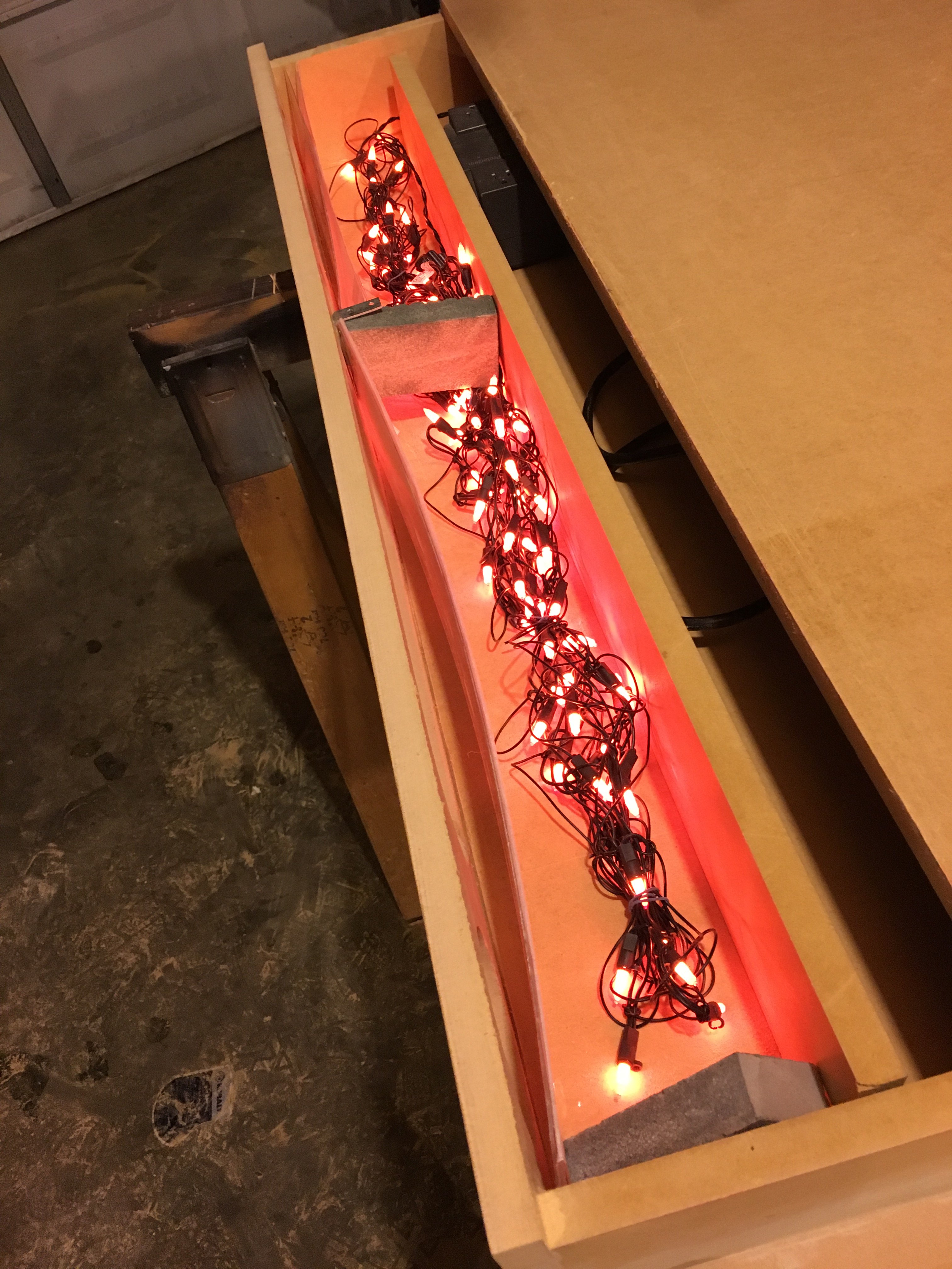

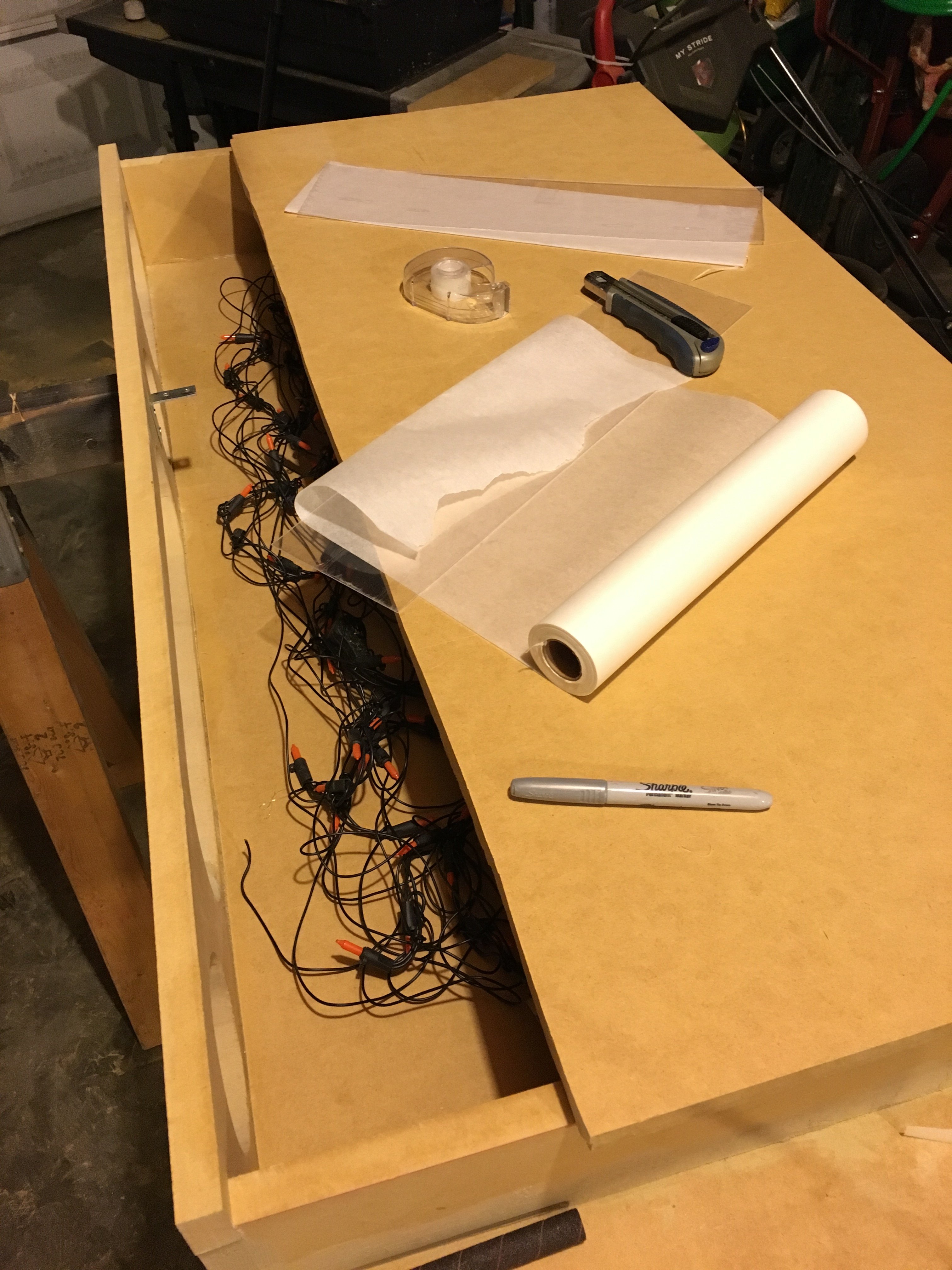

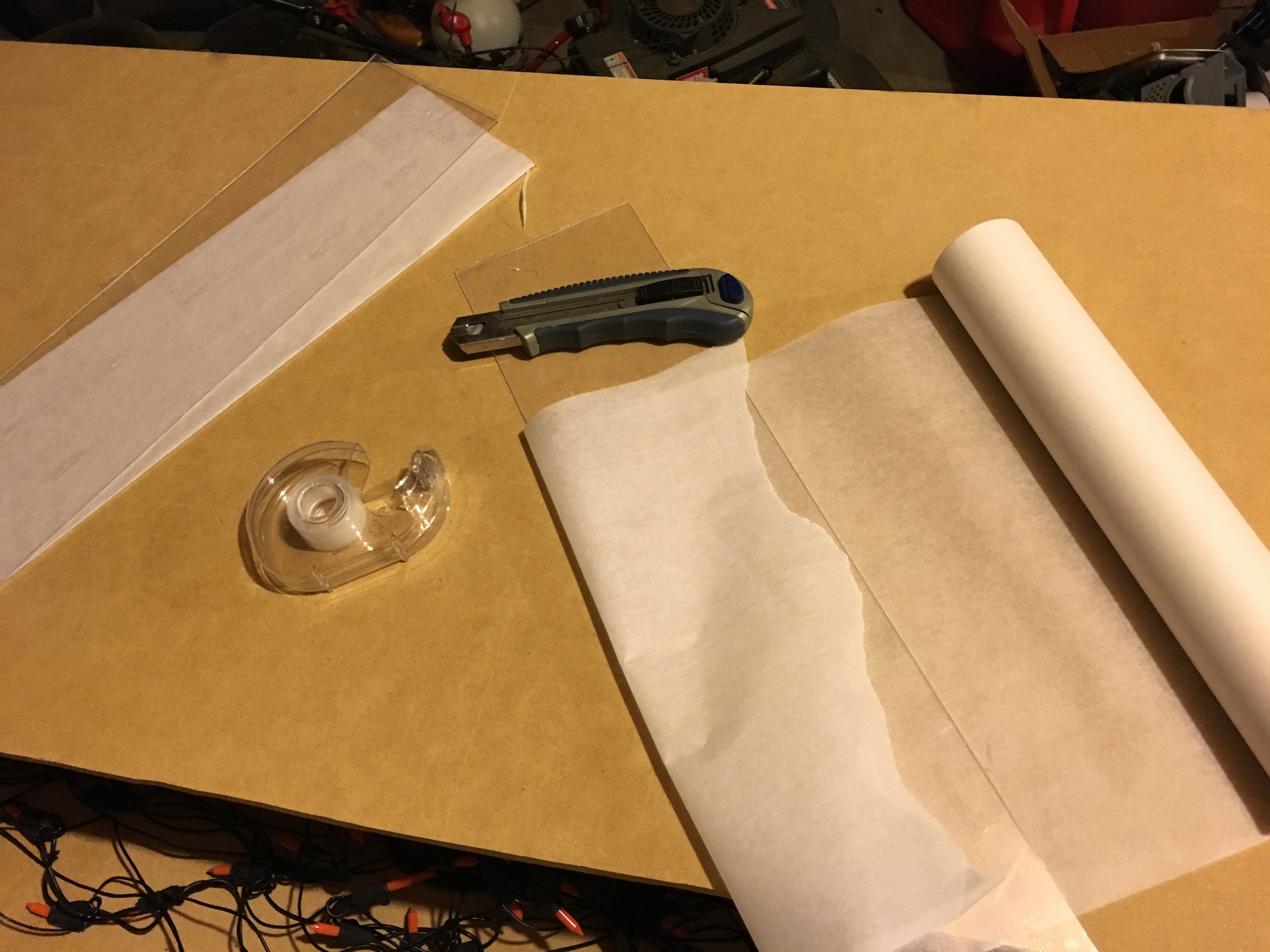

Well, I figured out how I'm going to do the lighting.. in lit areas it is still bright enough to see the lighting and in the dark it's awesome...
Since it is Halloween time and orange lighting is over abundant, I took advantage and tried a few options. I liked option 3 which consisted of string lights zip tied to make a small line and the tracing paper with plastic sheeting from the local hobby shop (Hobby Lobby, name drop) to get said effect..
I also decided to go on and put some primer down to get a feel for the piece...
While this was drying, I took the time to test out some other paints that are offered from hammered to metallic. Just to see the difference... I really liked oil rubbed bronze... I also got distracted by taking apart an old mac powerbook G4.. I'm telling you, some of the "innards" of the powerbook were awesome...

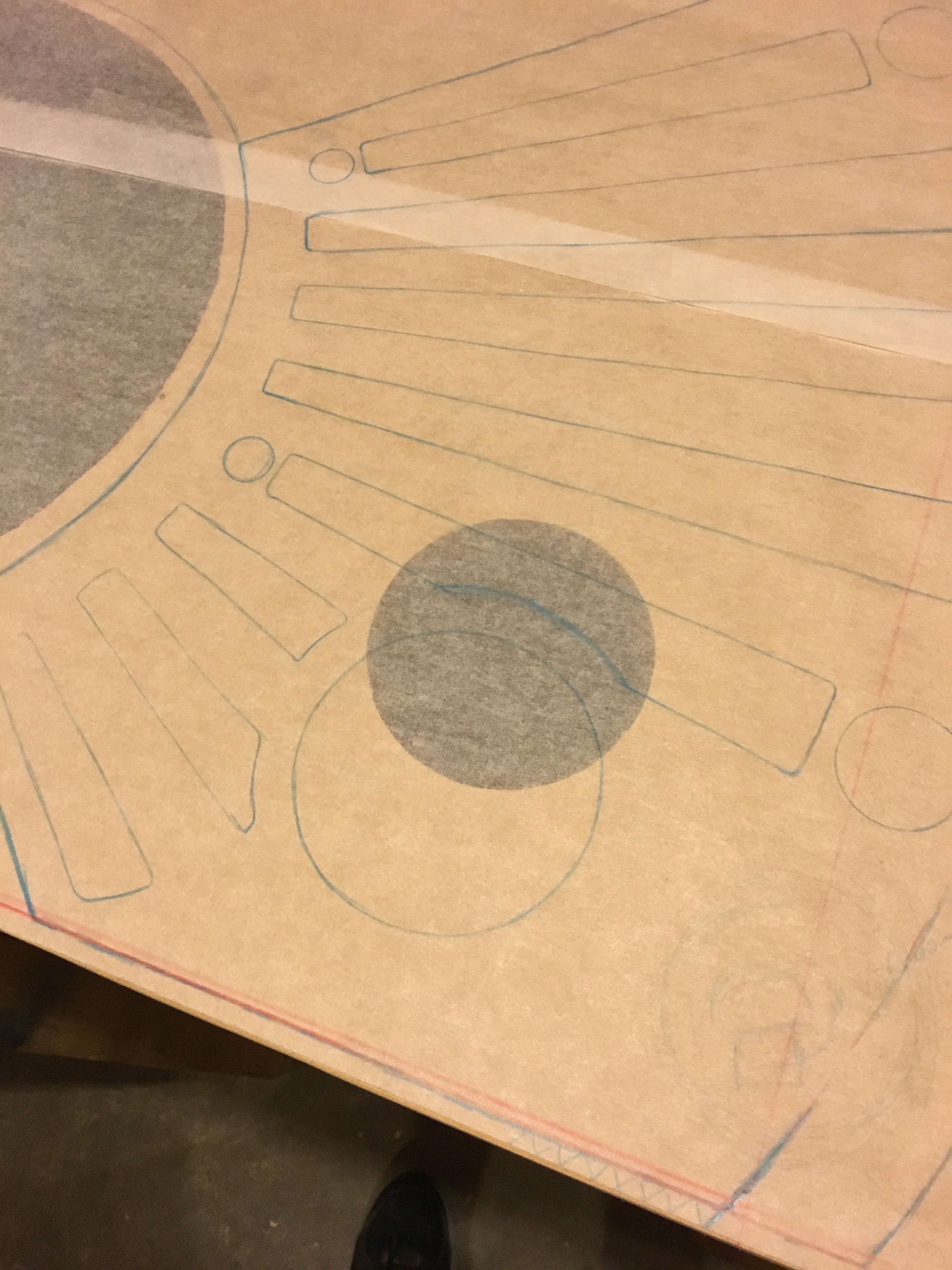

Well, now that I got that out of the way, my big question is, do I just go carbonite chamber look or go Bespin style? I kinda want my palette area to resemble the landing pad from Bespin

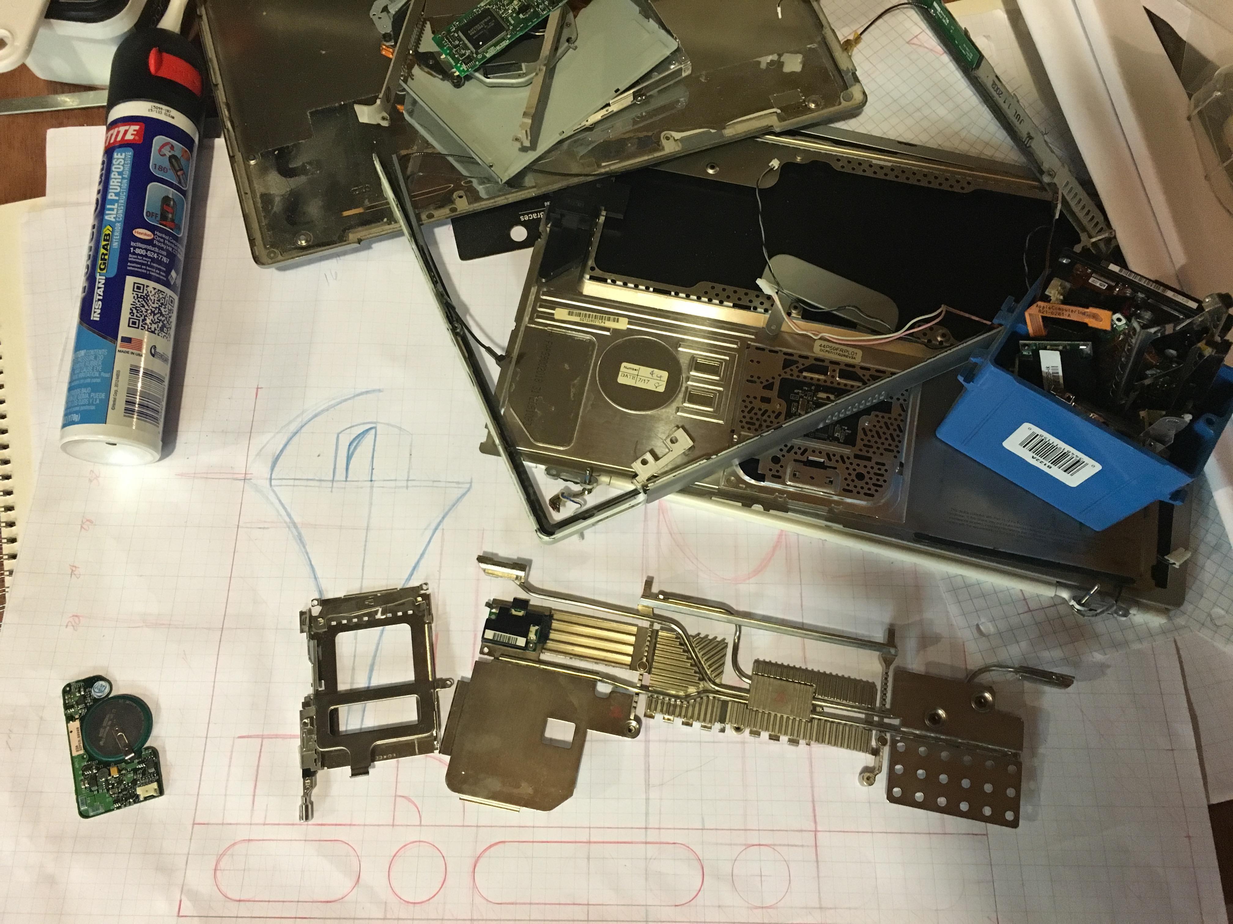

The entire piece is actually a workstation now... I am also going to try to replicate the carbonate chamber controls... sort-of...
I need somewhere to place paper towels, gloves, water bottles and other misc. stuff... mainly the aforementioned.
Suggestions would be nice!! If not, I'll do what I normally do..... IMPROVISE!!
Control panel is next...

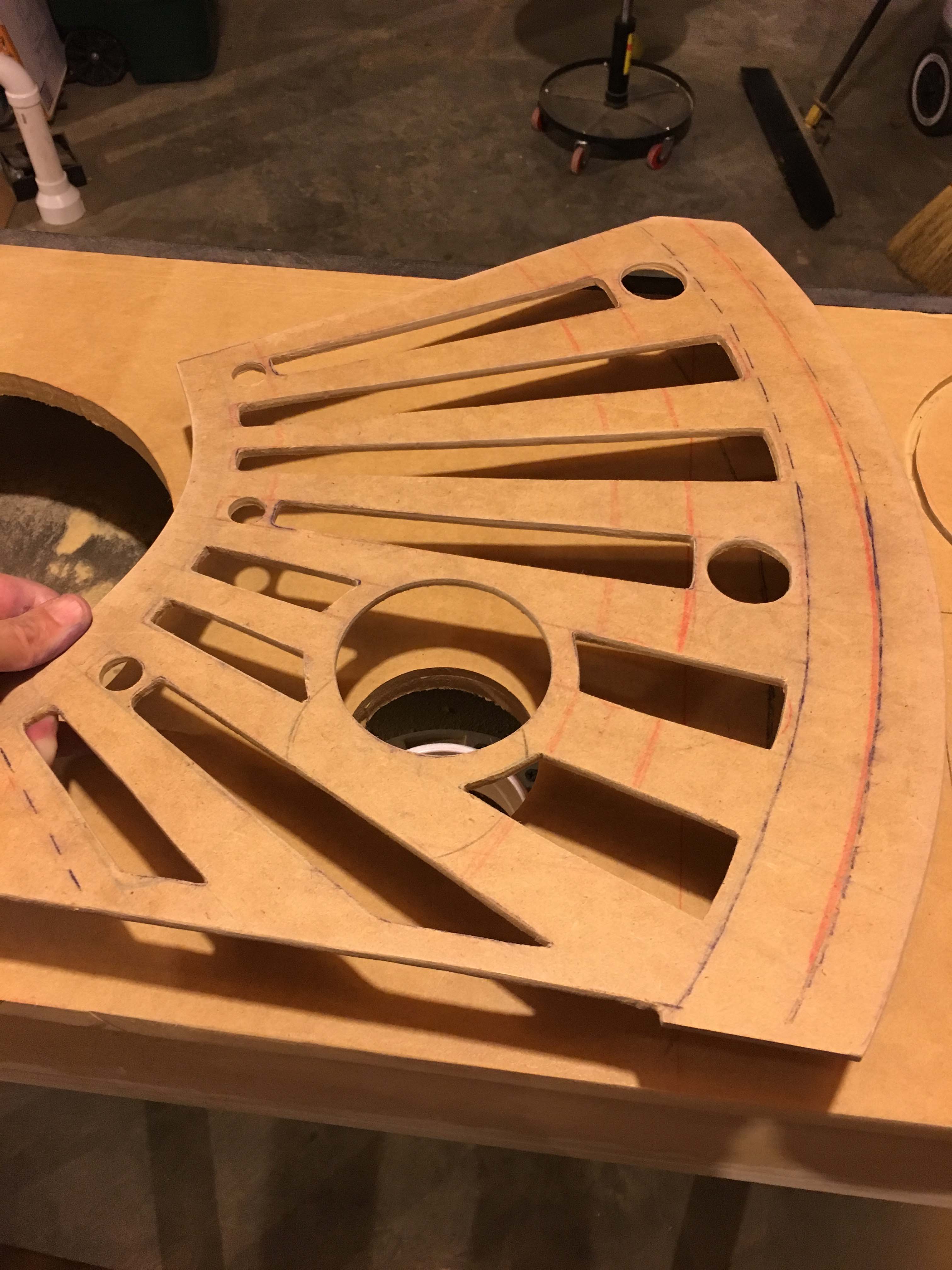

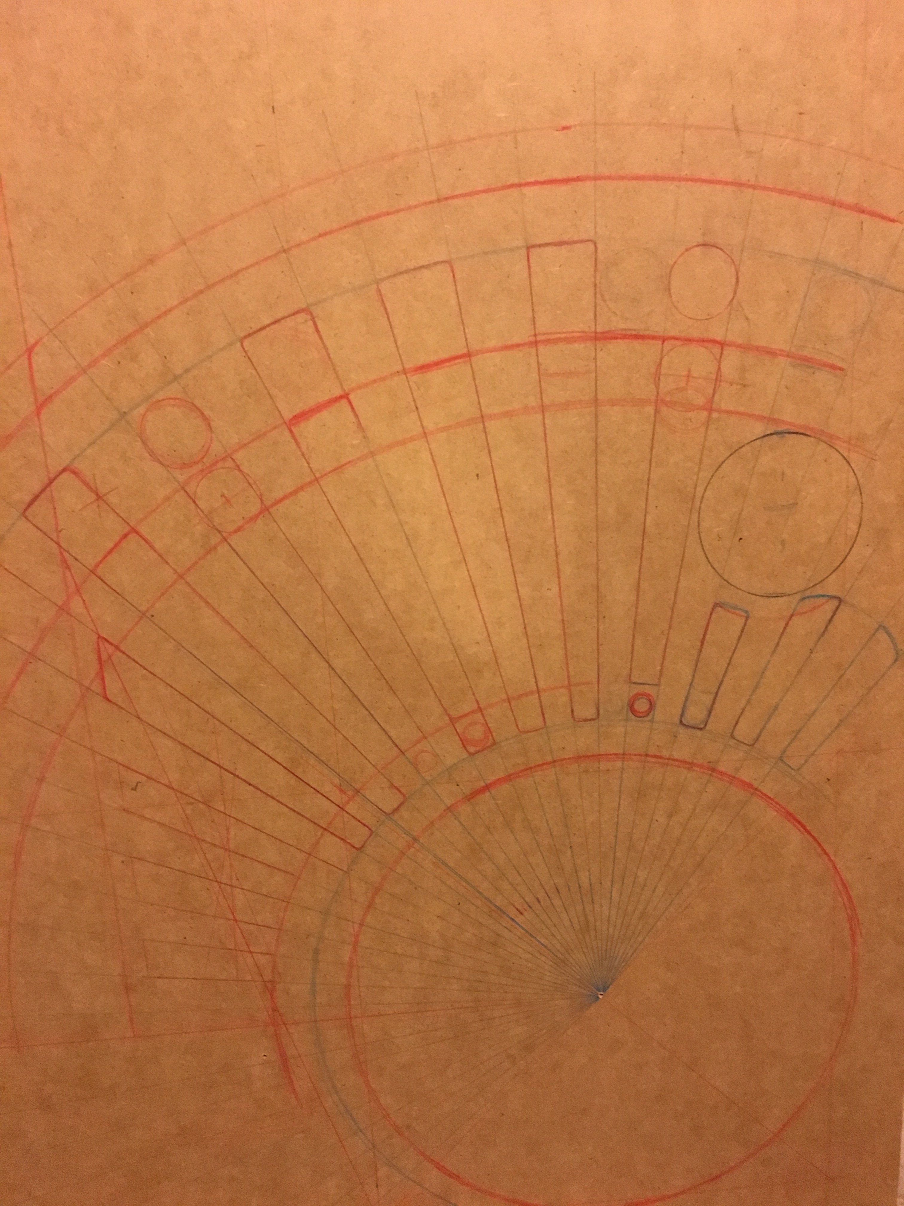

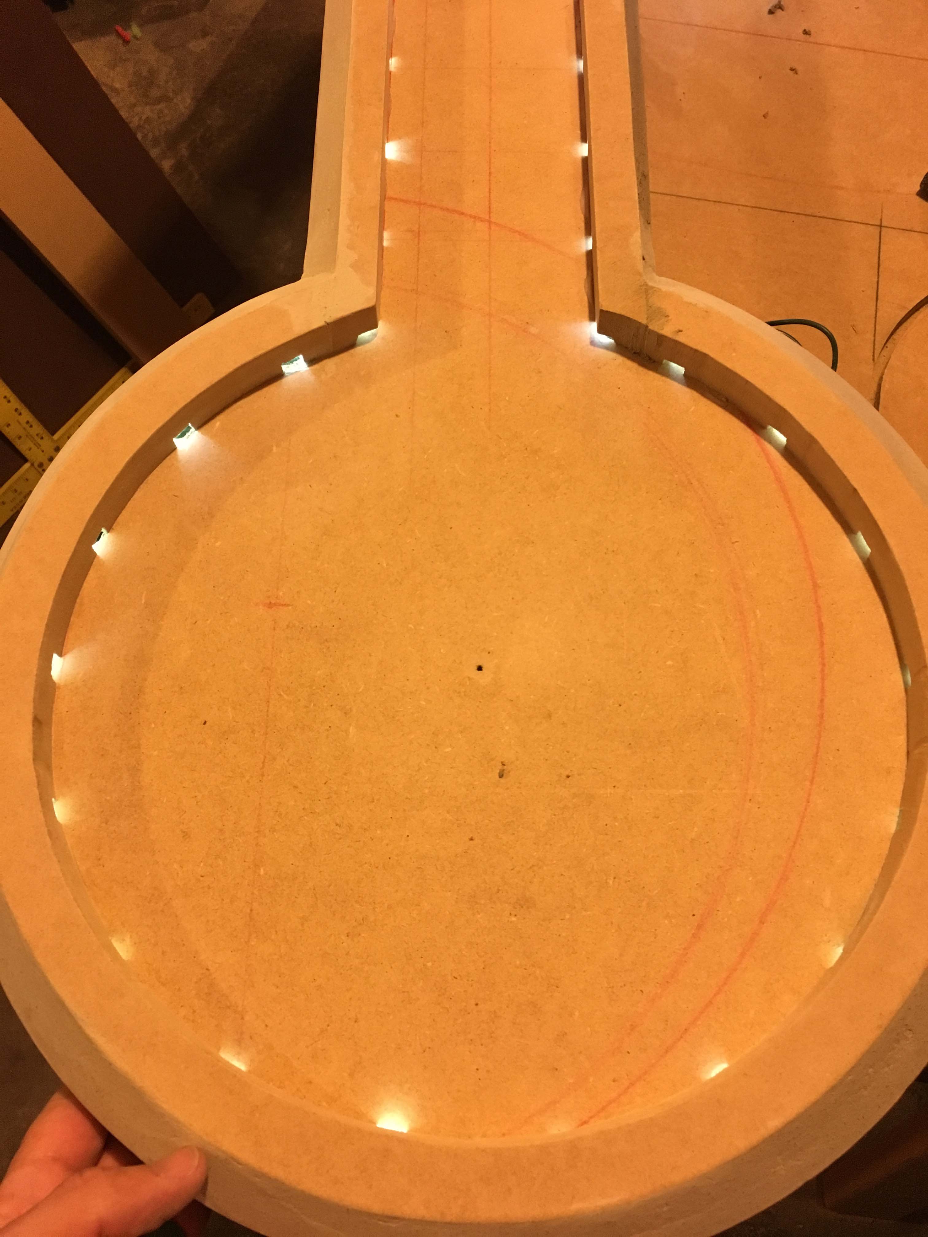

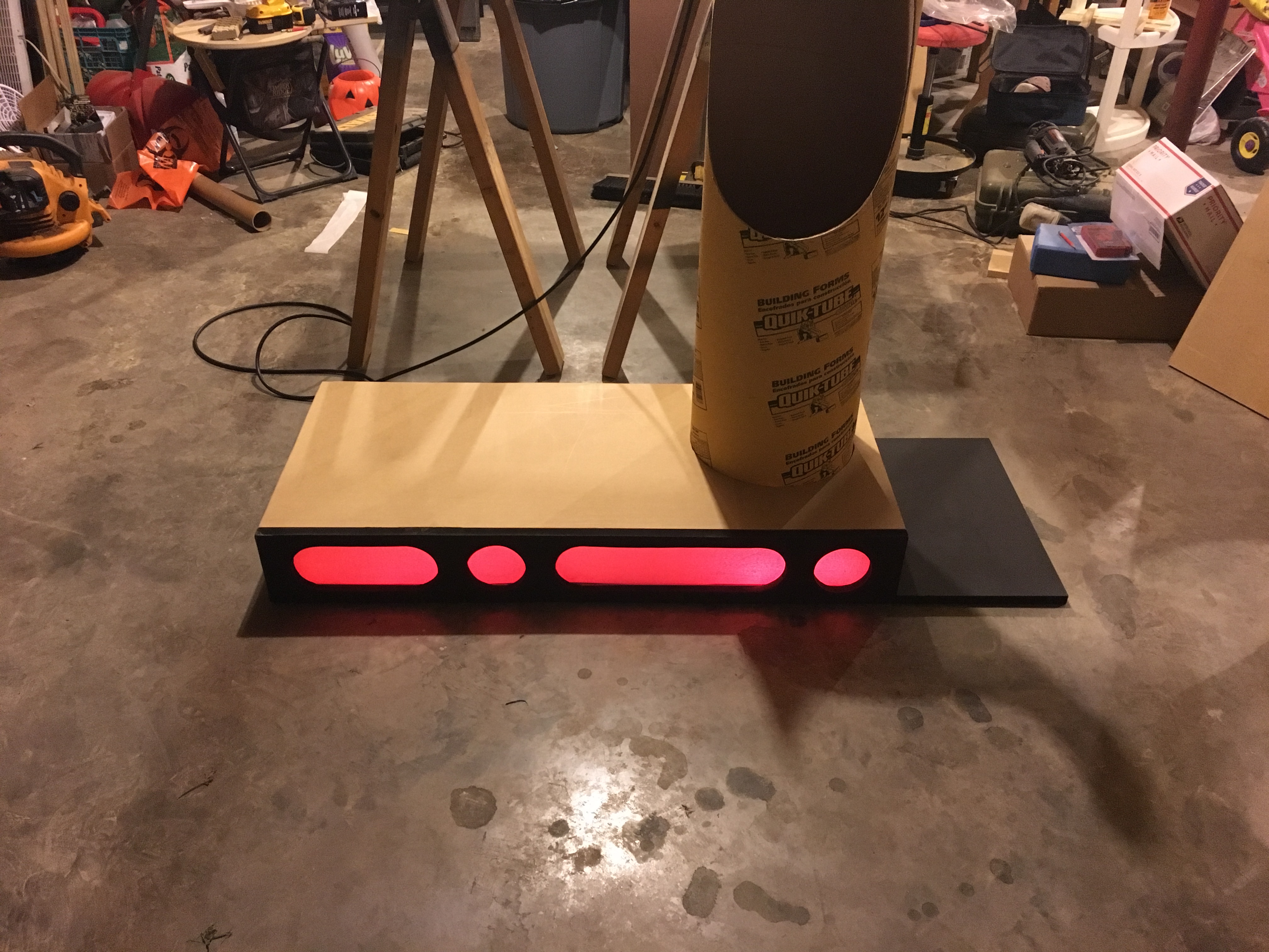

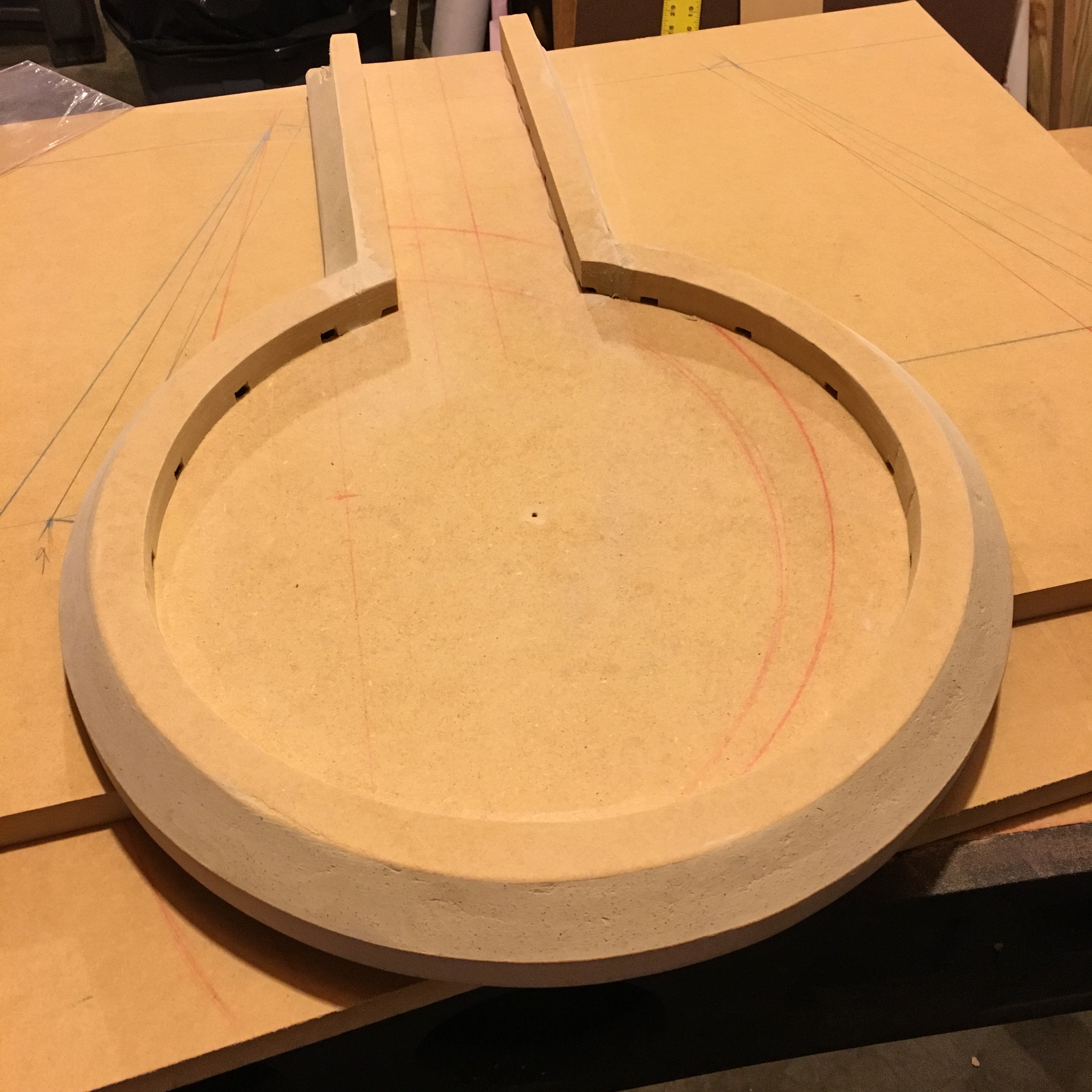

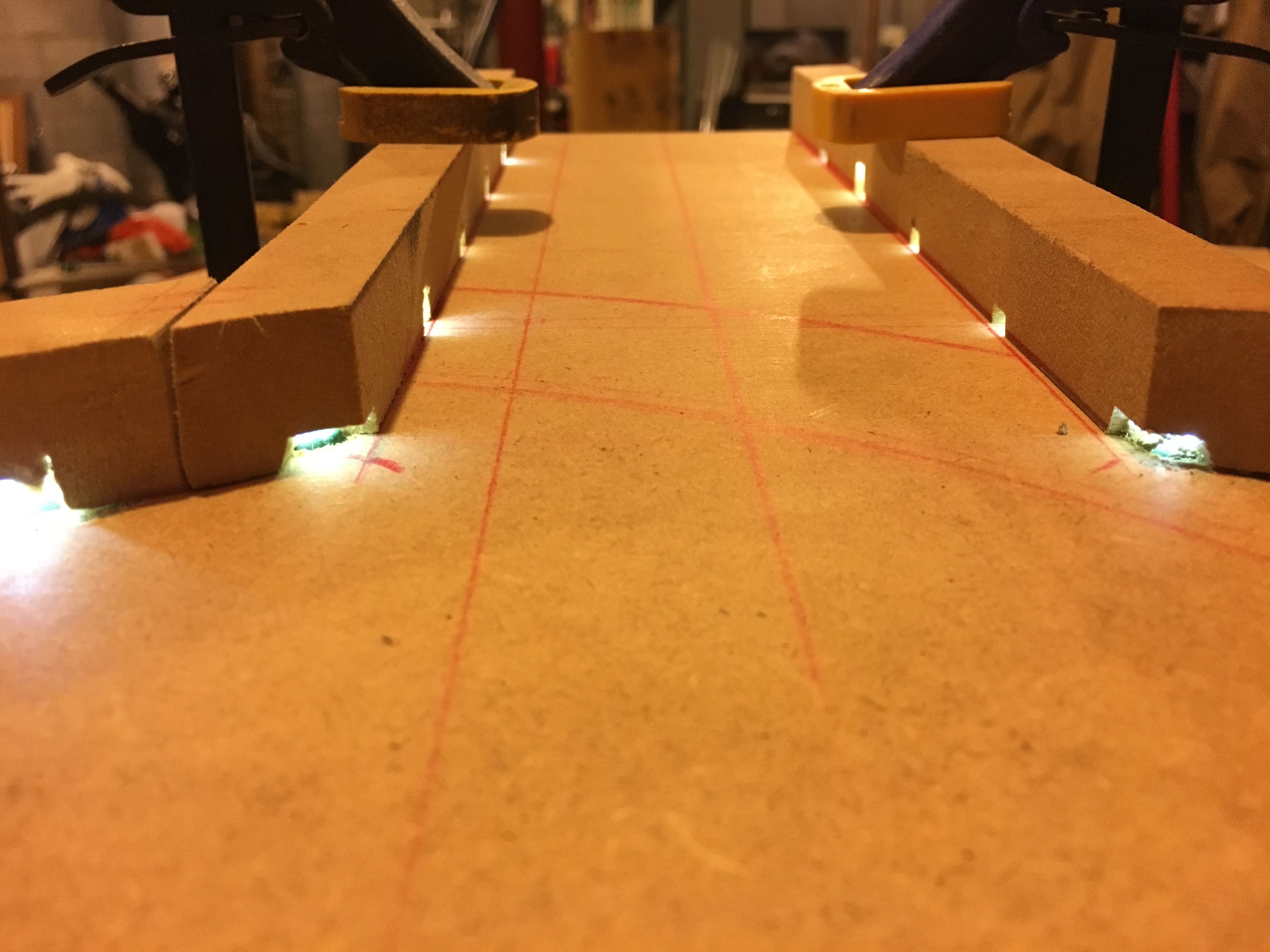

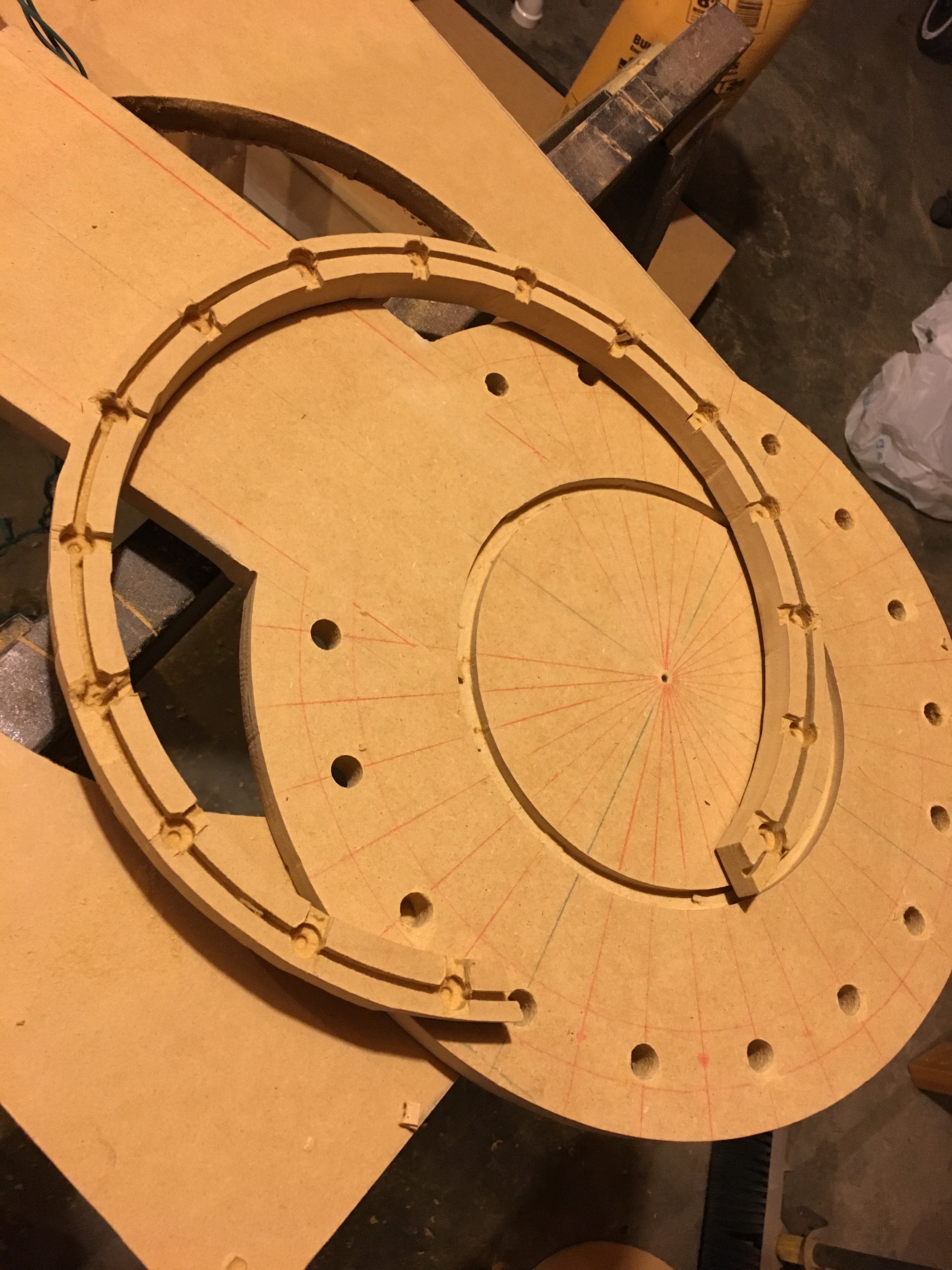

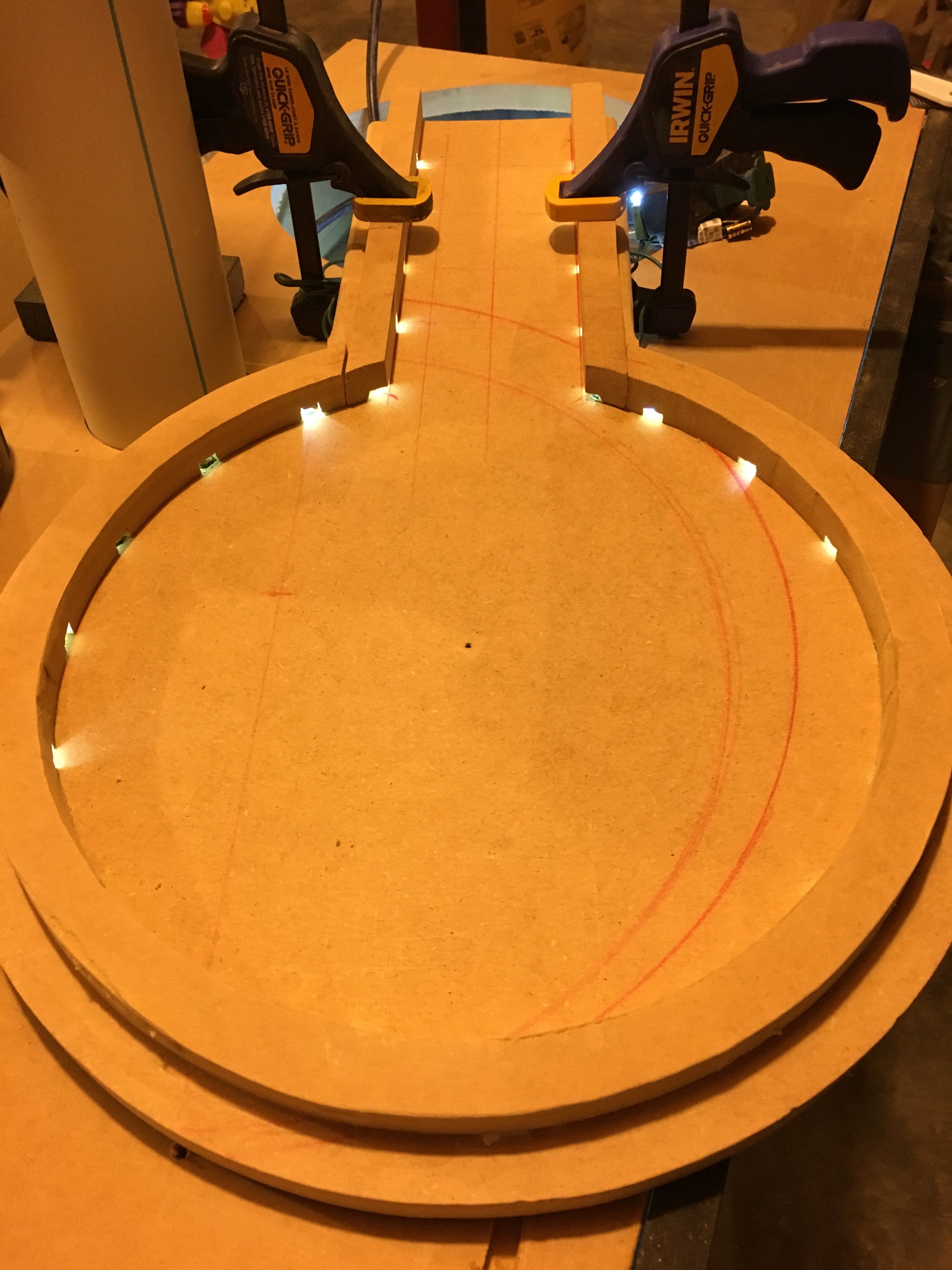

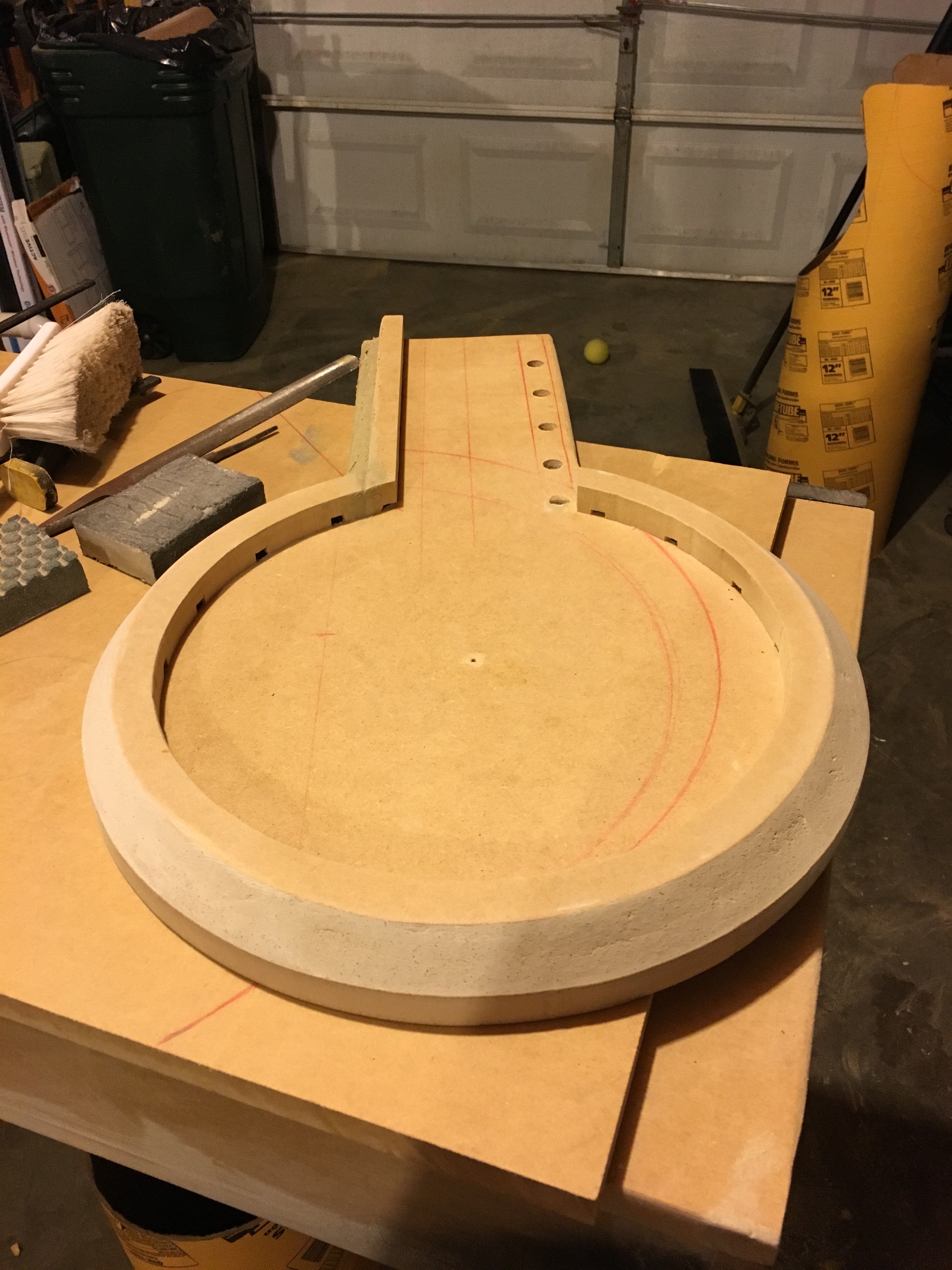

Well now, I've moved a bit forward today with a couple of new additions to the build.. not much but it is moving forward..
Today I started out with adding to the landing pad/set up area.
I will next time use hard wood for this type of configuration but I'll improvise for now!!
I wound up deciding to use LED lights for the time being.. hopefully they last forever or at least a very ling time... I just now realized that I can't permanently glue the lights in...What if one burns out? I need to be able to replace them.. Hmmm..... playdoh.. I'll use playdoh to anchor the led lights into the holes. When they dry, they'll become kinda brittle and if needed, just wiggle the wires and the playdoh should crumble if not, tug harder... lol..
Routed out a track (which wound up being unnecessary) then drilled out some lighting holes and then hand sawed the interior ports to give me this effect..
Depending on the depth of the led lights, it "throws" the light to give me the effect I'm looking for. Once everything is figured out, I will glue* (change of plans) them in place to get the right effect.

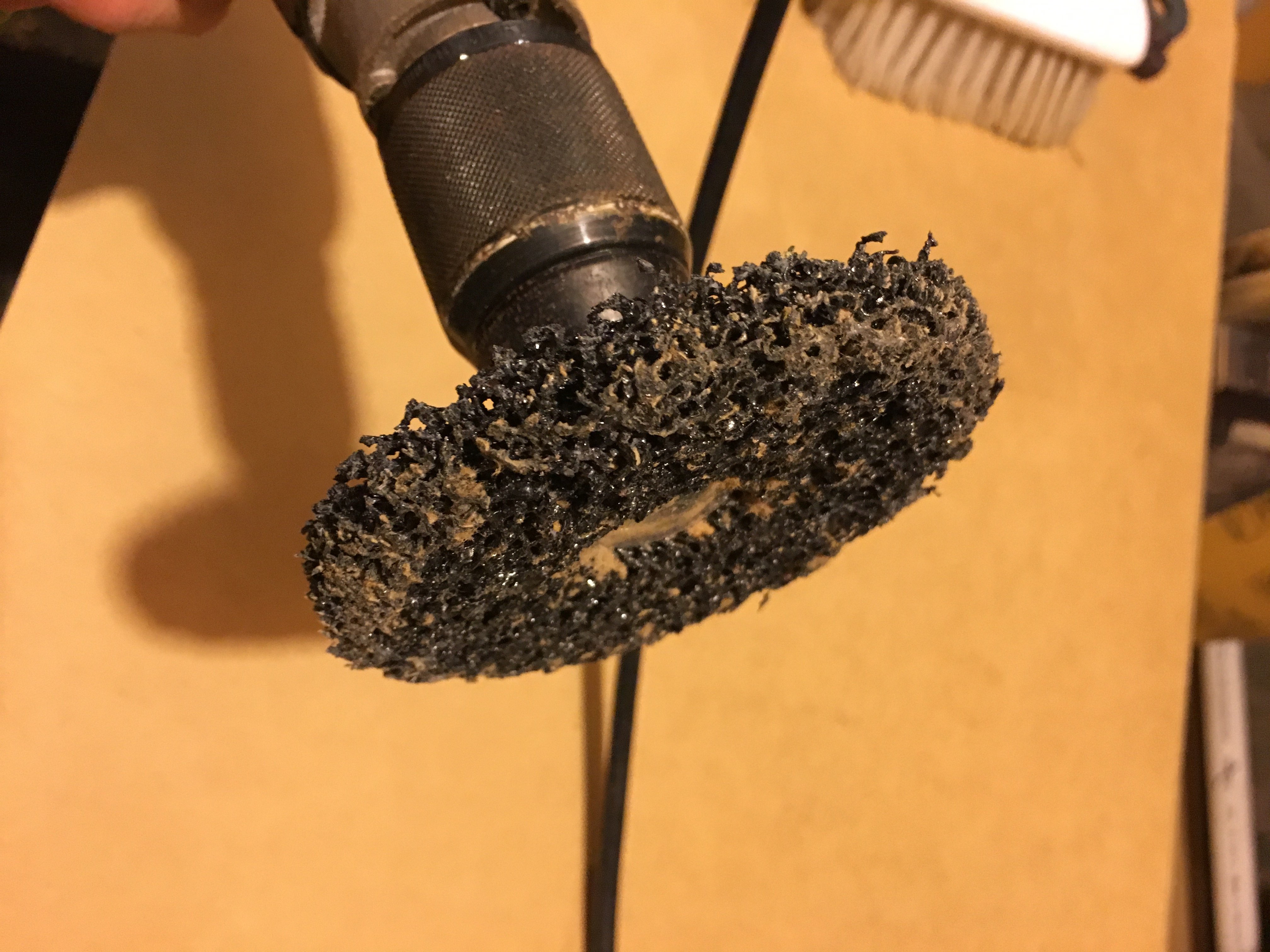

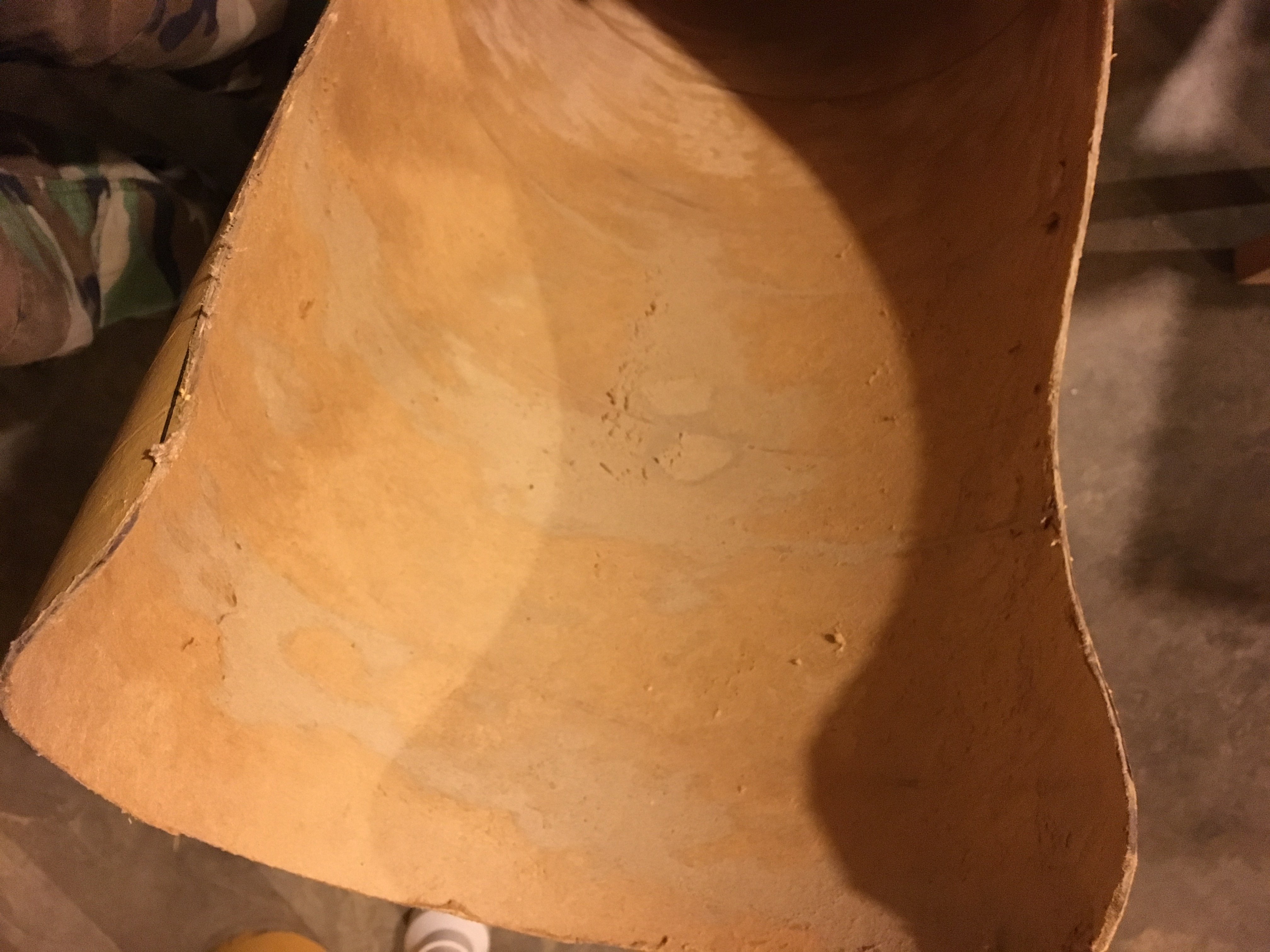

As far as the concrete tubes go, @Amazing DJ, I am going to sand them down with this monster of stripping destruction
I will use it to do this!!
Success!!! There is no wax and there are no spiral grooves... Now to test out some theories...
1) try to use polyurethane coat to smooth it out, sand and then paint color add details, reapply polyurethane coating?
2) try fiberglass bondo stuff?
3) wood putty used like bondo and sanding to smooth out and paint/polyurethane coat?
4) metallic/hammered paint to hide imperfections then sand, add details and polyurethane coat?
Who knows?? I'll get back with you...

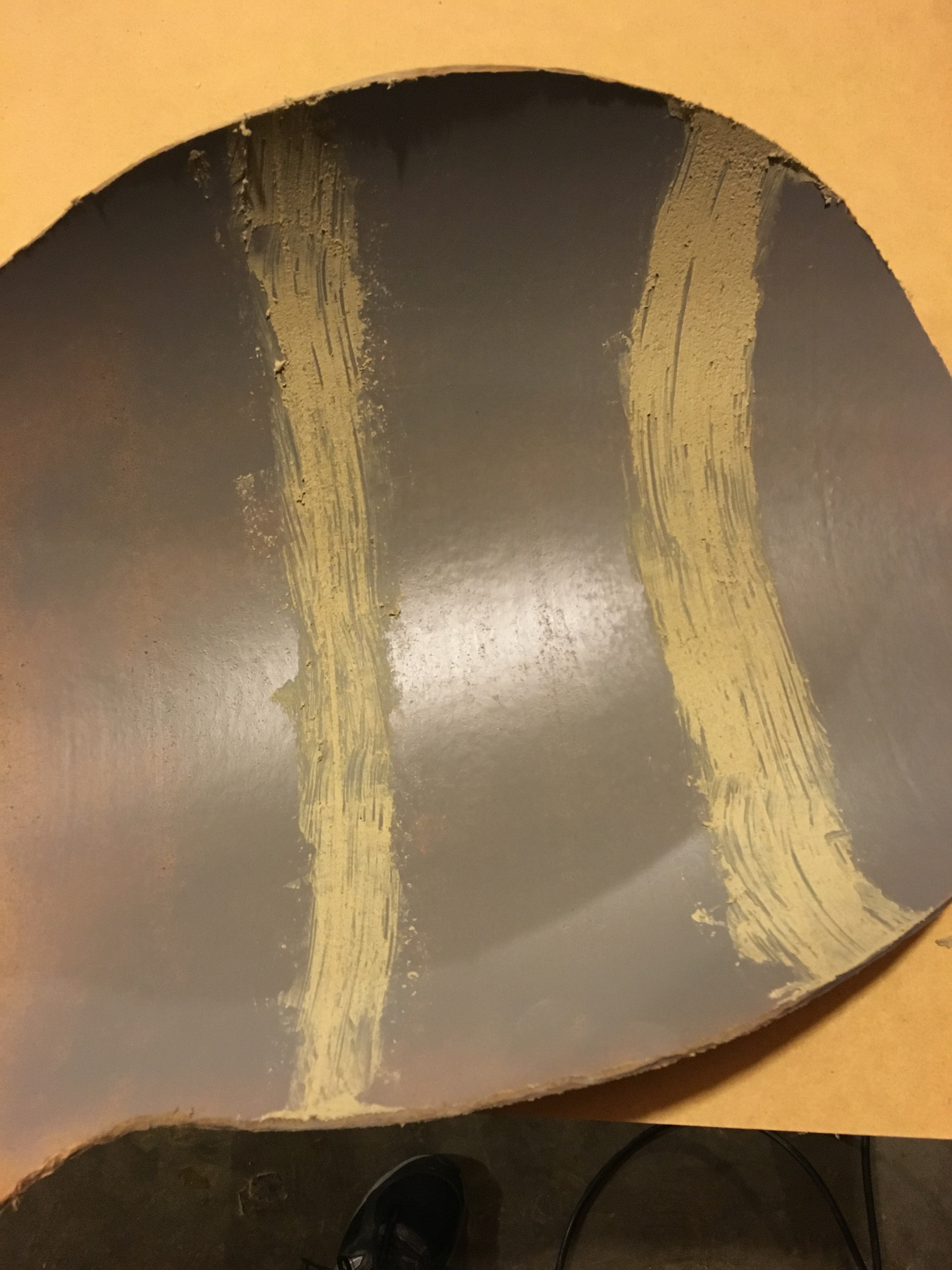

I did (however) try wood putty in the spirals without the heavy sanding... wax is still on it!! This would probably work if the piece wouldn't be handled or touched often.
I'll test this out as well just for curiosities sake..
My set up has to be able to be wiped down/sanitized.. so, I am having to try out polyurethane coatings (basically bar topping) to allow for chemical sprays to be applied for disinfectants.. I have to have it sanded without wax to be assured that the coatings can be coated correctly so they can be cleaned.. Although this part (the tube) is actually just going to be the garbage can...HA! I would like it able to be wiped down however for not only cleanliness but for aesthetic appeal as well.

I also smoothed out a bit of the molding on the work platform/docking bay as well as attaching the left light platform.....
I'm actually hoping to receive the Falcon drone or I'll buy it, just to have it take off form the platform with the lights on to re-create the Bespin scene (sort of).

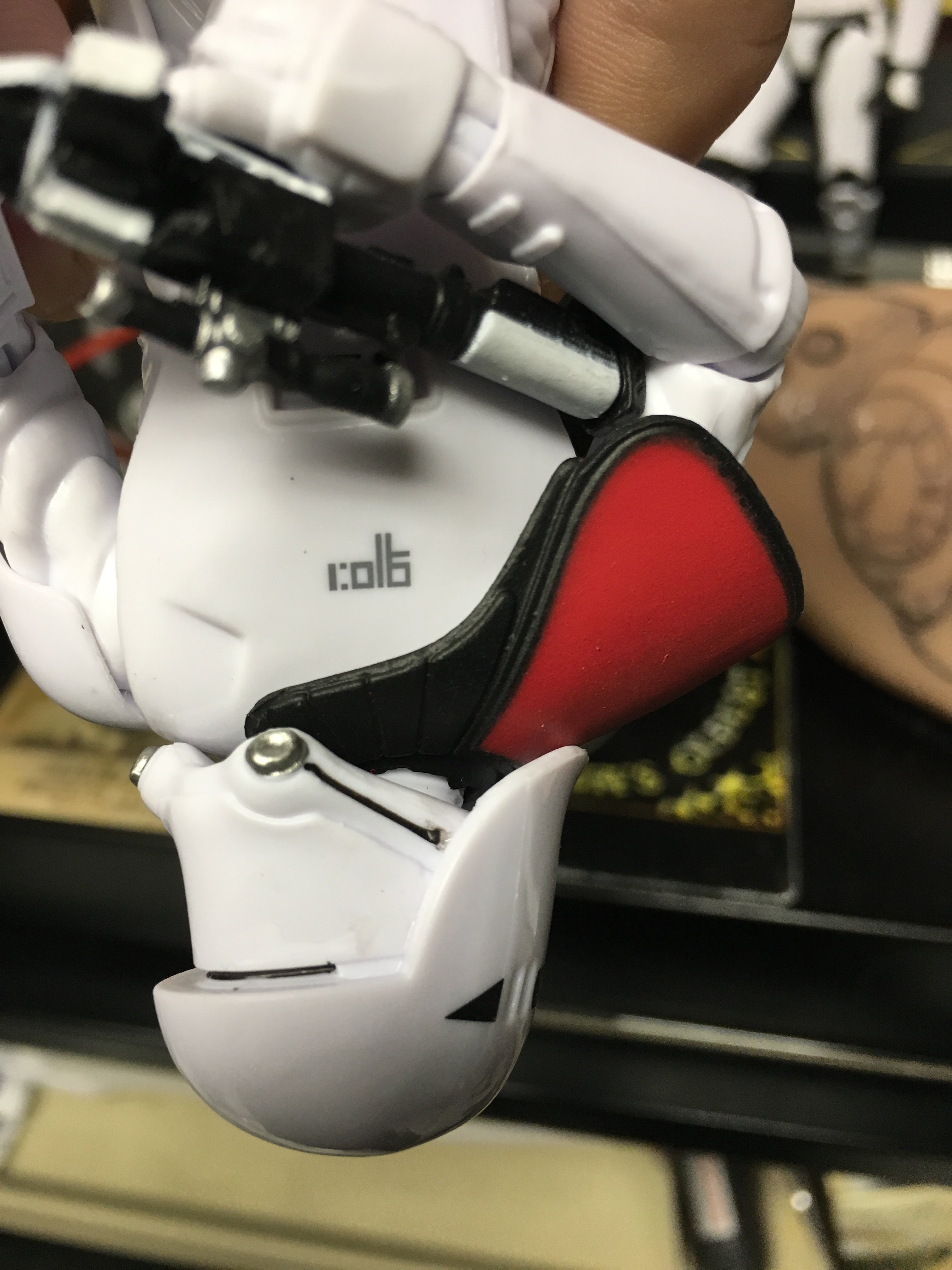

Also, a friend nabbed me this Black Series T.R.Us First Order Stormtrooper "Officer" today and I can't let them stay incarcerated inside a plastic prison, so, I open them...... And let me tell you, this dude is awesome!!!
I don't know why it won't let it post portrait... Oh well... probably image size...
Oh well...By the way...I got my tickets for Episode VII!!!! Wood Hooooo!!! Can't wait!!
P.S. Did you notice, that if you flip him upside down the "snow"trooper's armor almost spells cold!! HA!!
This is possibly the suit I will want to make to attempt to join the 501st.. ??

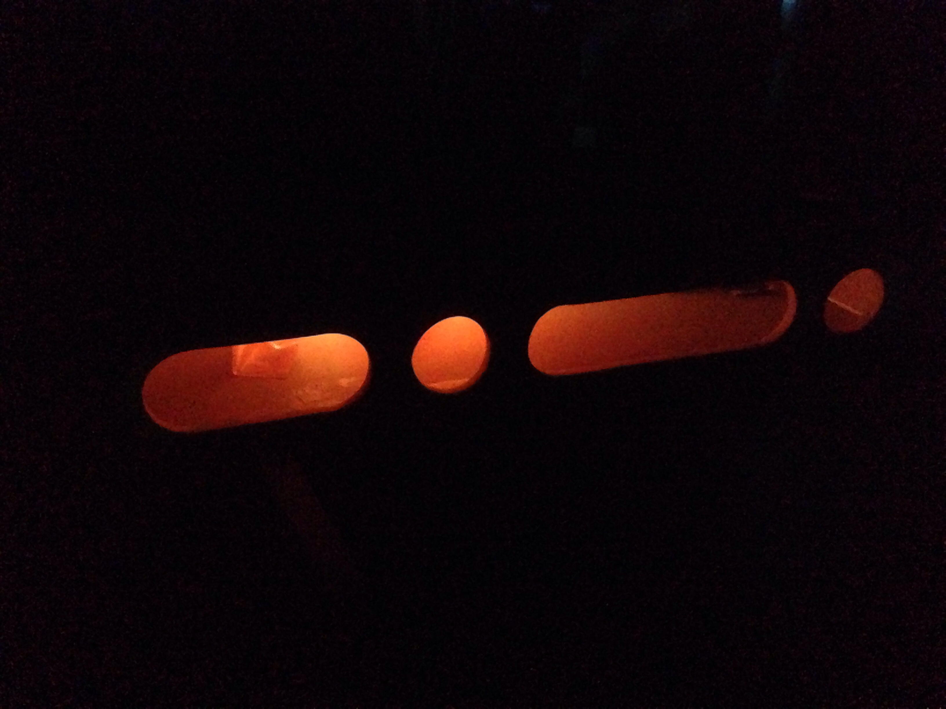

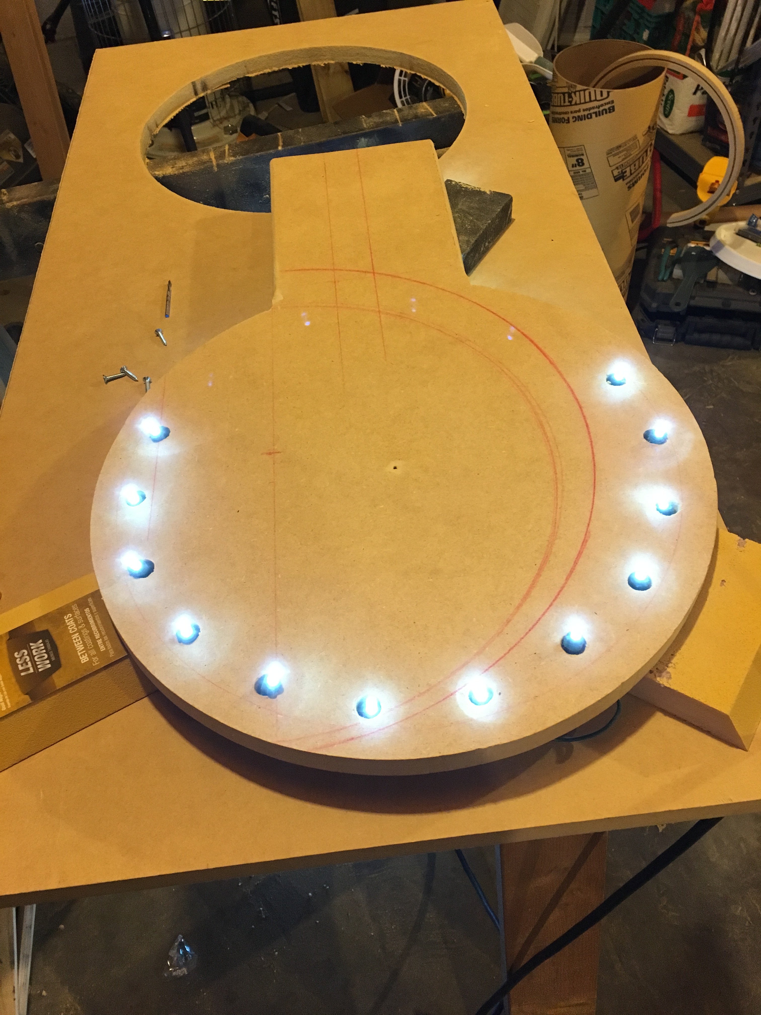

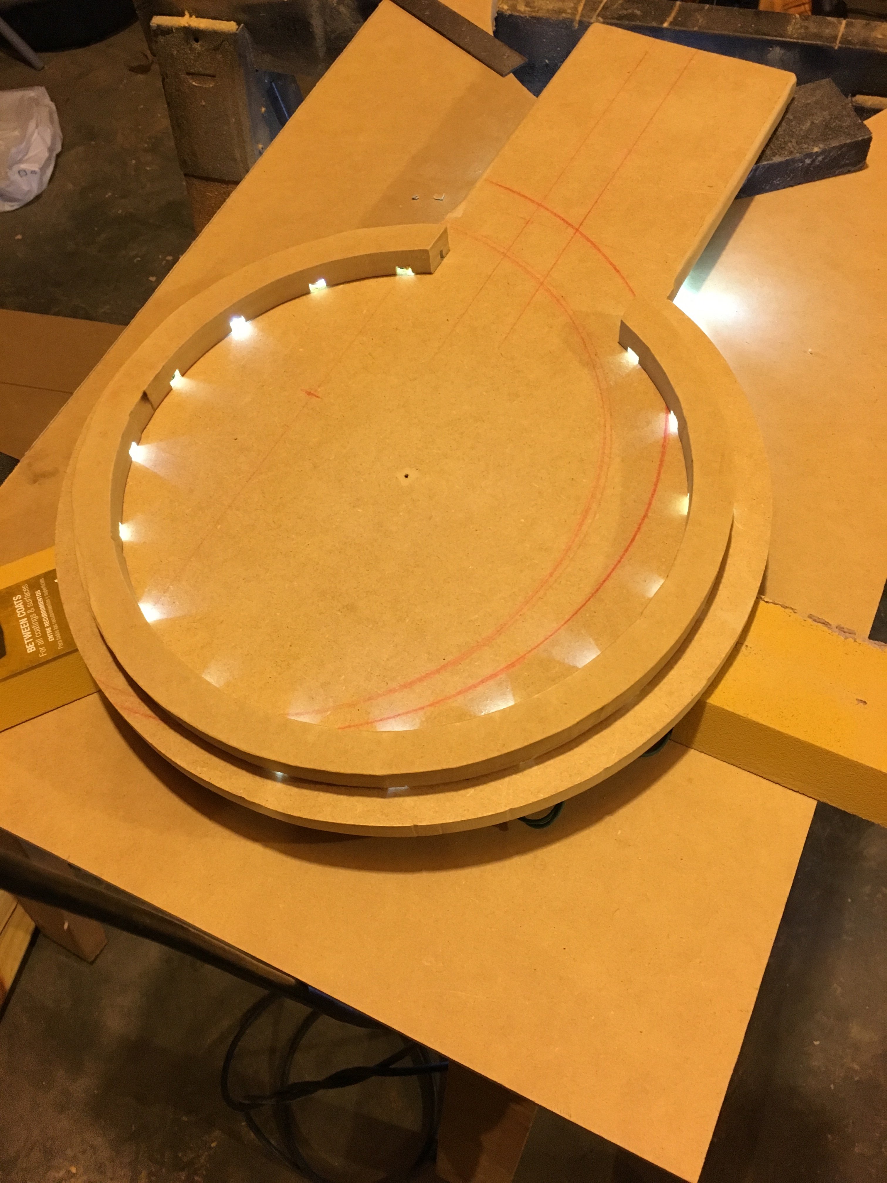

I also did a test run with the lighting..

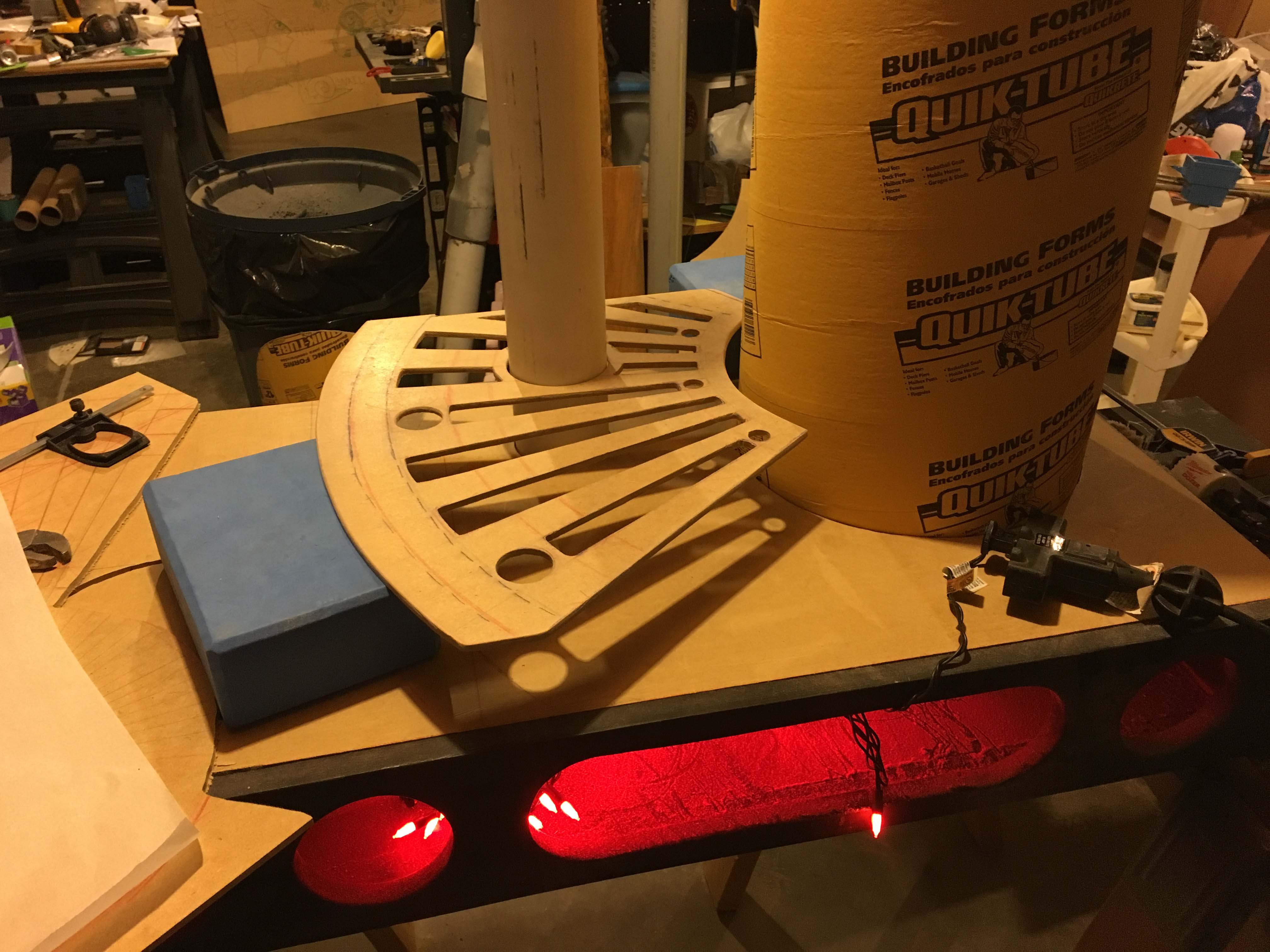

I have then moved on to the carbonite chamber area.. here is the rough cut with rotozip tool..
By the way, I went with the 1/4' board instead.. just seemed to work better... add the acrylic topping (eventually) and it'll get thicker and a bit more sturdier...
I then used the handy dandy hand file to shape the areas to satisfaction and then take a quick hand height check.

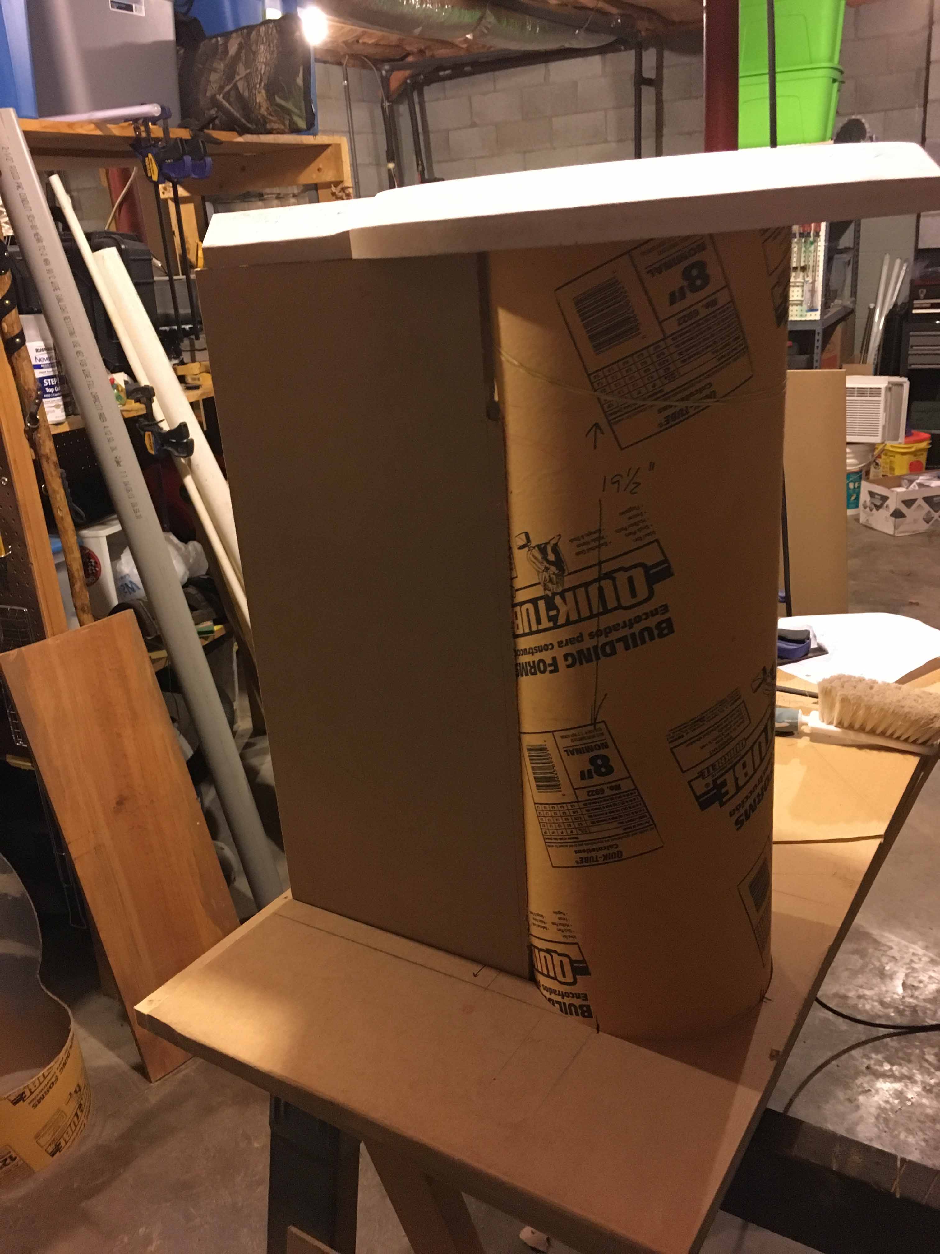

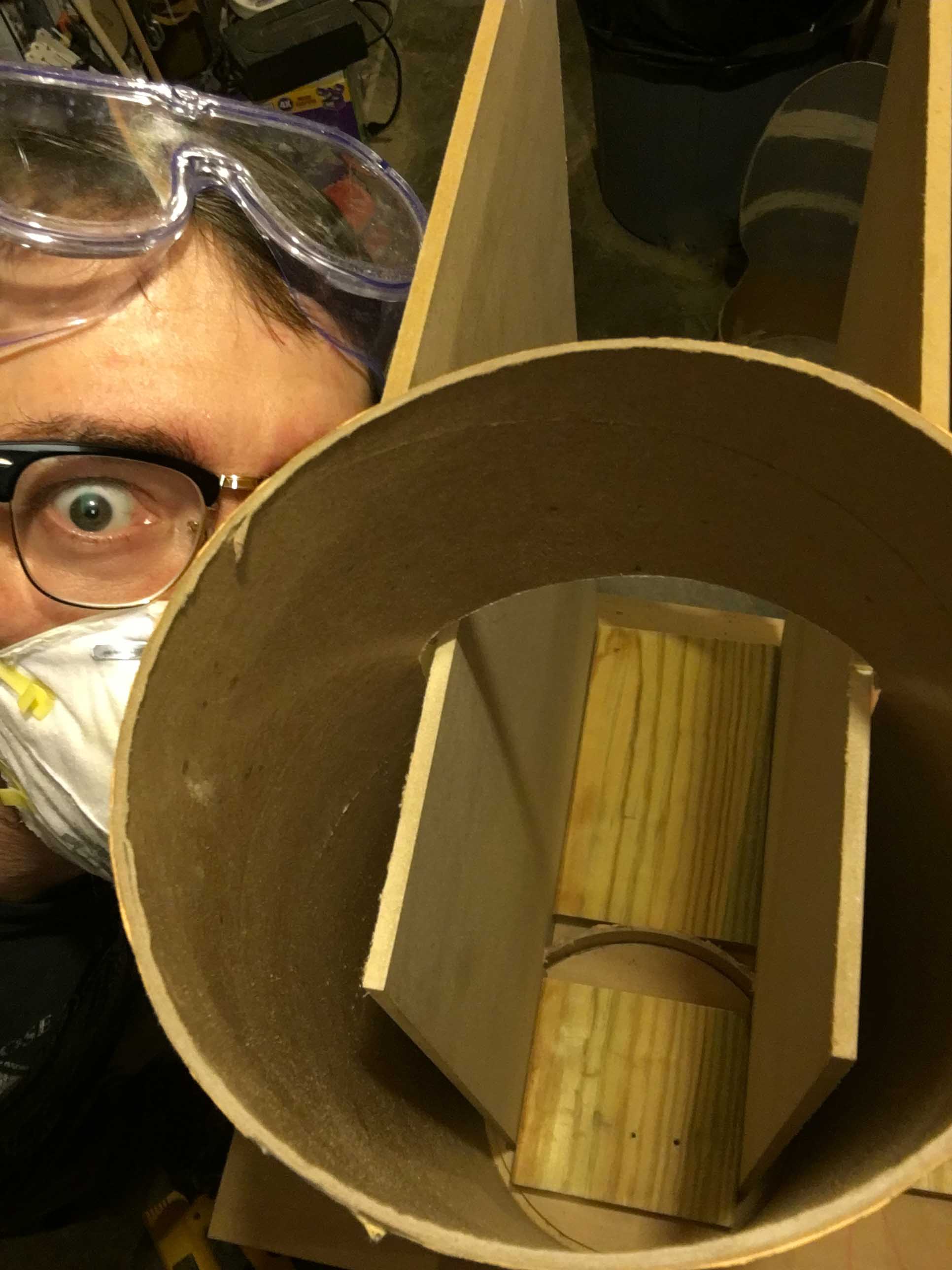

I then add the control panel tube and the (now bottle table/bespin trash bin drop tube)
Oh...... the lighting opportunities that have made themselves present...
Seriously though... I am giddy with excitement... This is too cool....

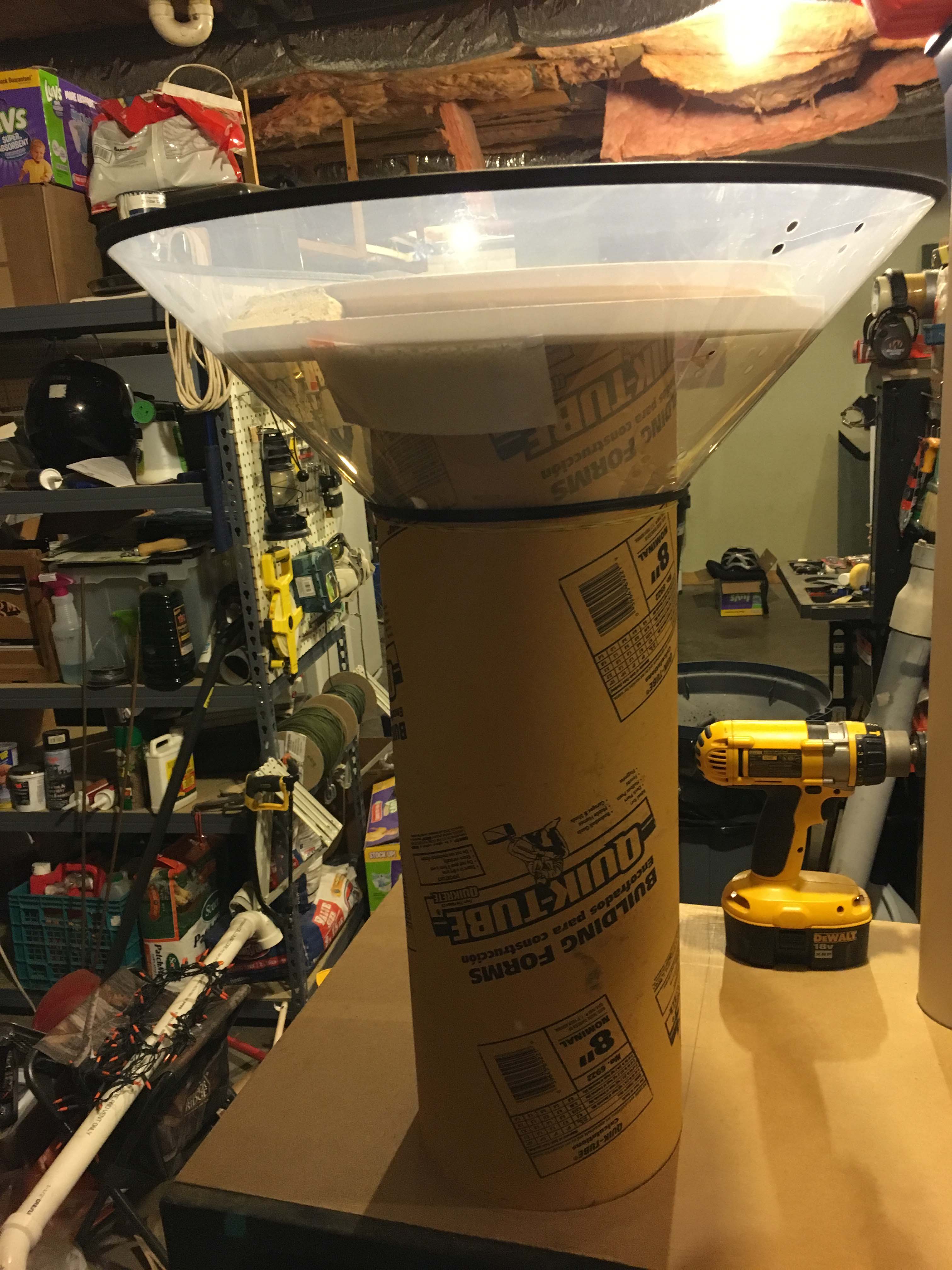

This weekends cuts are also going to help me recreate the bottom of the landing pad on Bespin... I cheated and bought a dog cone...
This gives me my arc though.. I'll transfer that to the thin plywood stuff I have and then reshape it to the tube..

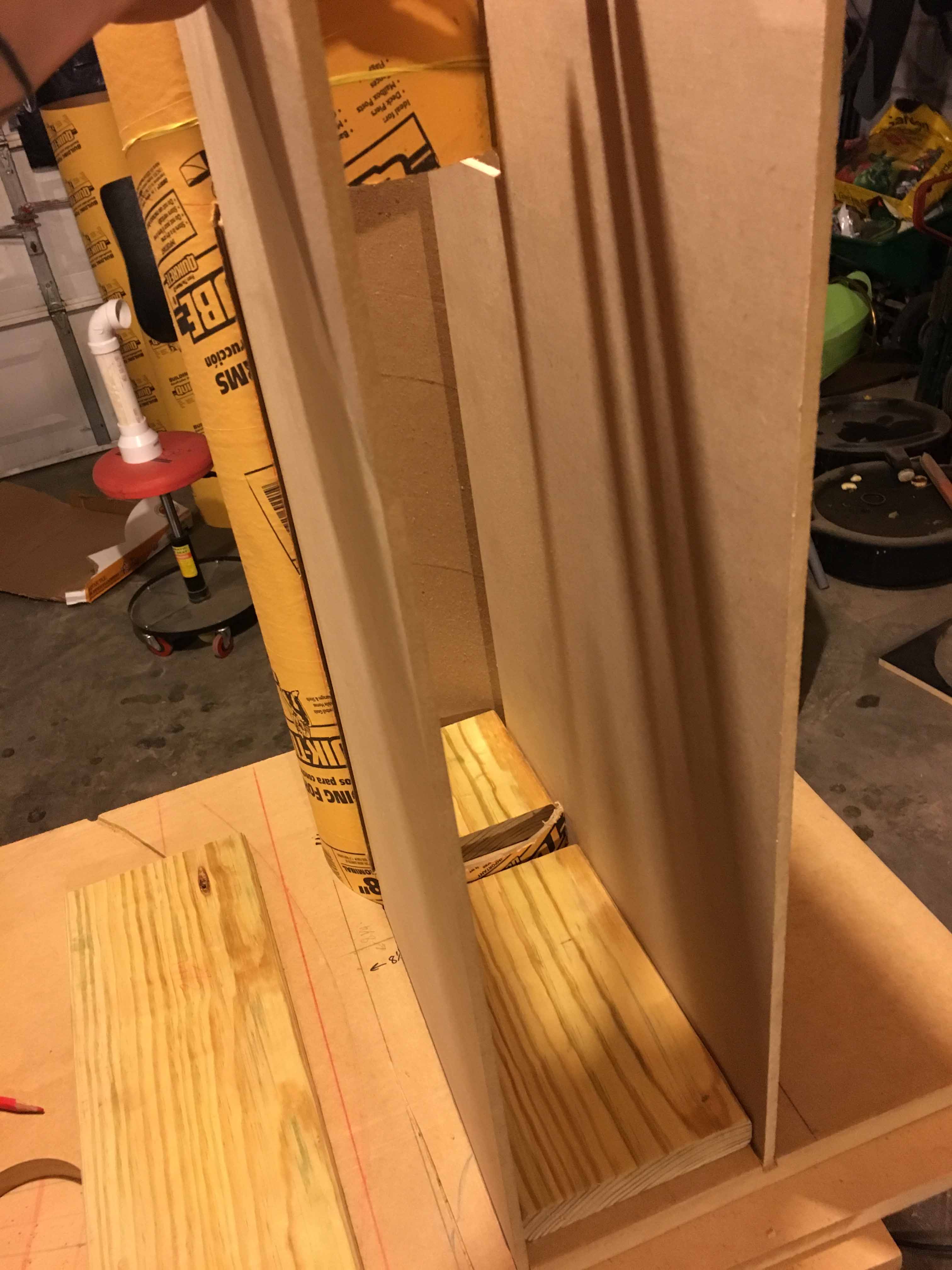

I also have added the side walls to the landing platform...
We started by routing out the side wall slots..
I then did some cutting and made walls!! Yay me!
We will be adding shelves to the right side in the very near future....

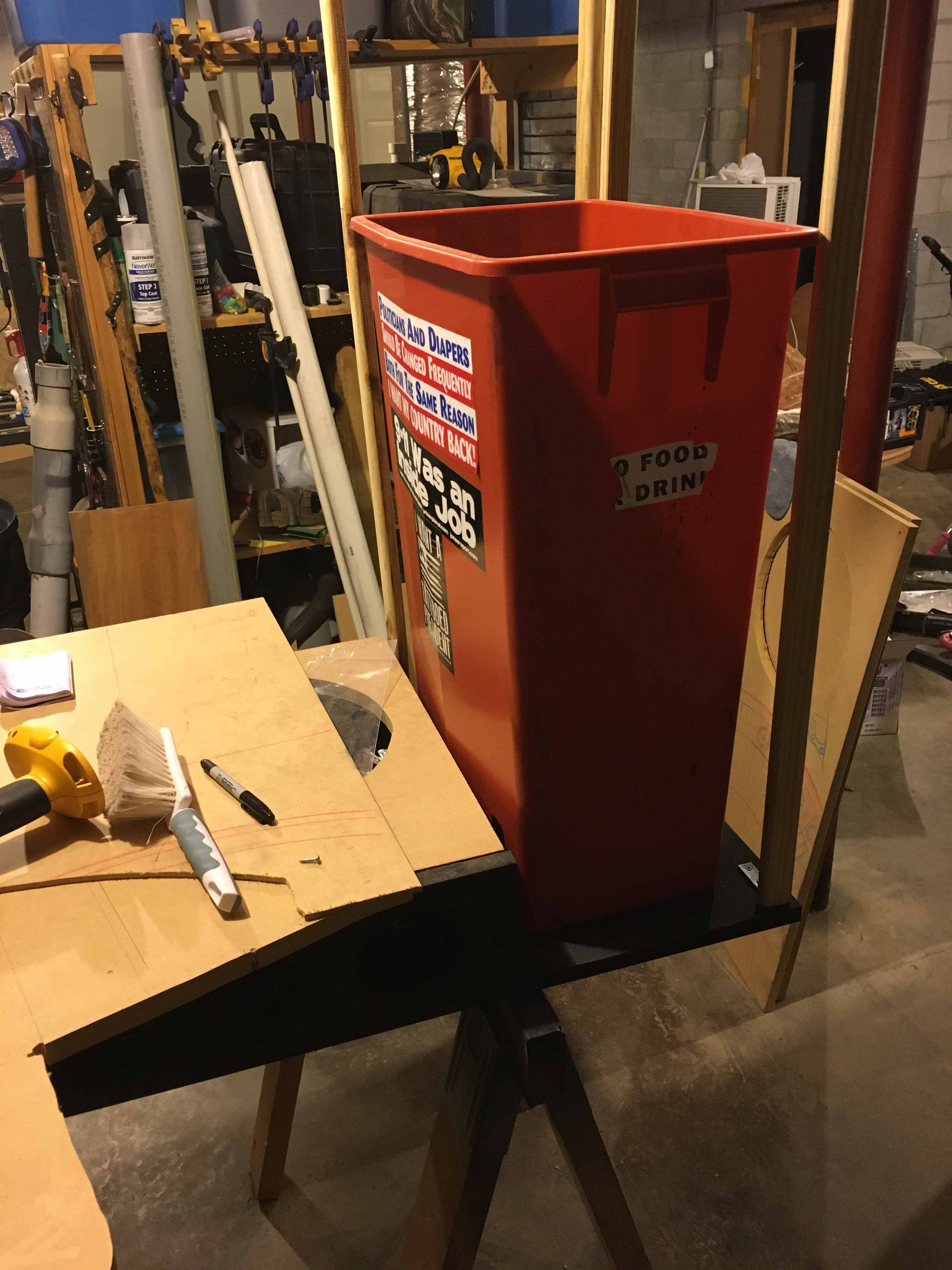

Well, as for the garbage can...
Test fit the can...

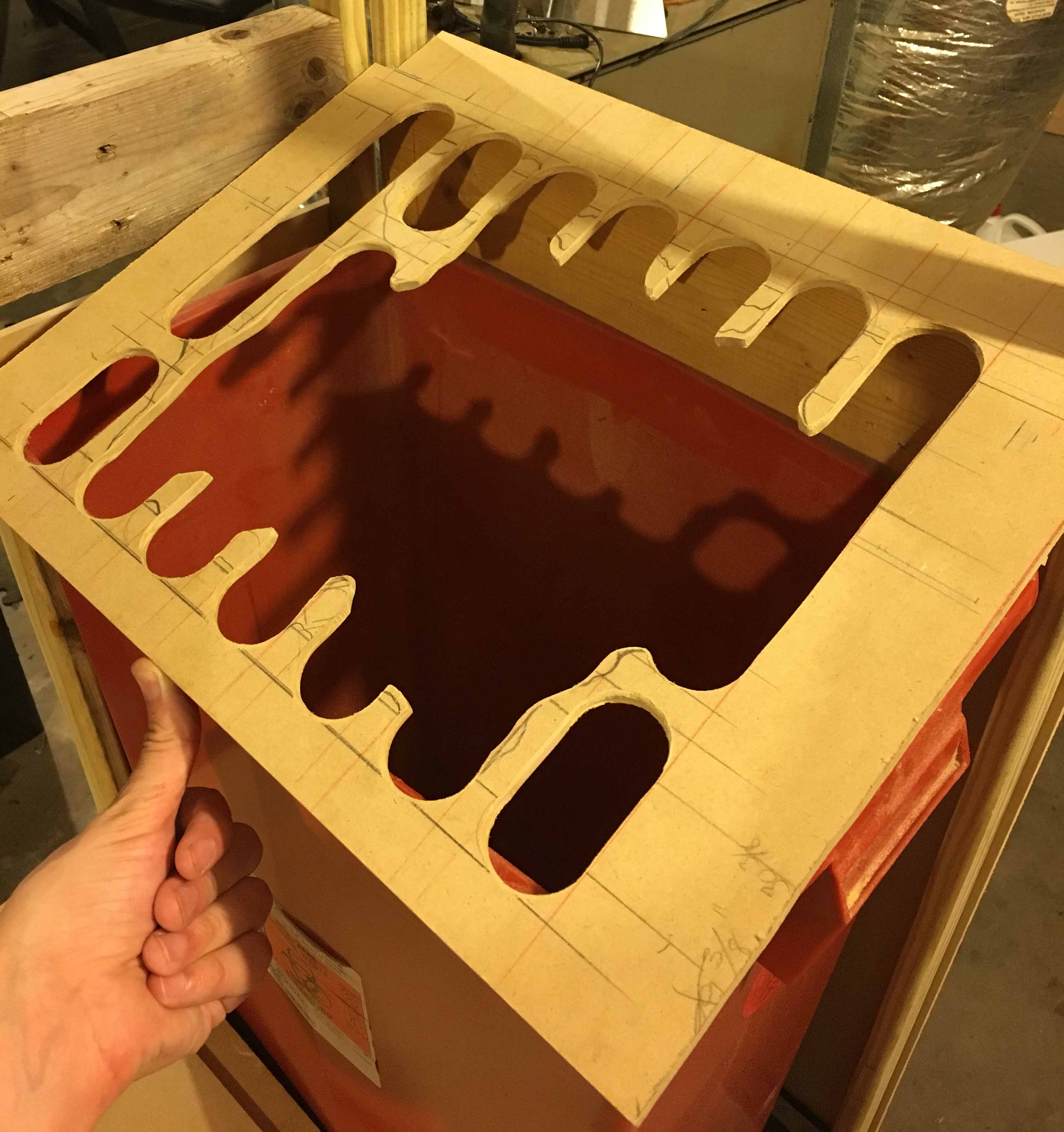

On to the fun stuff...

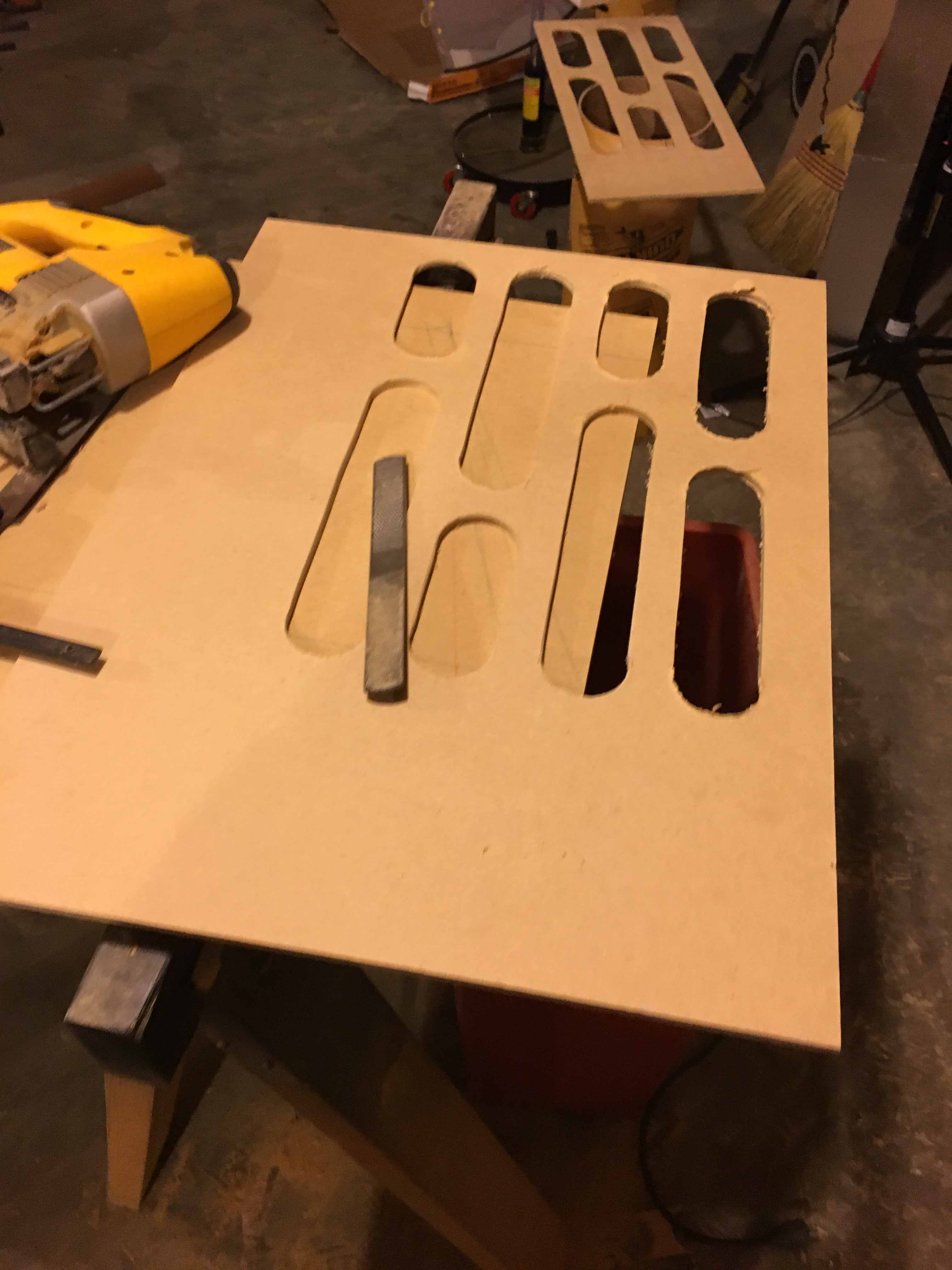

getting the back drop panels for the garbage chute...
These are still rough and I have some filing to do...

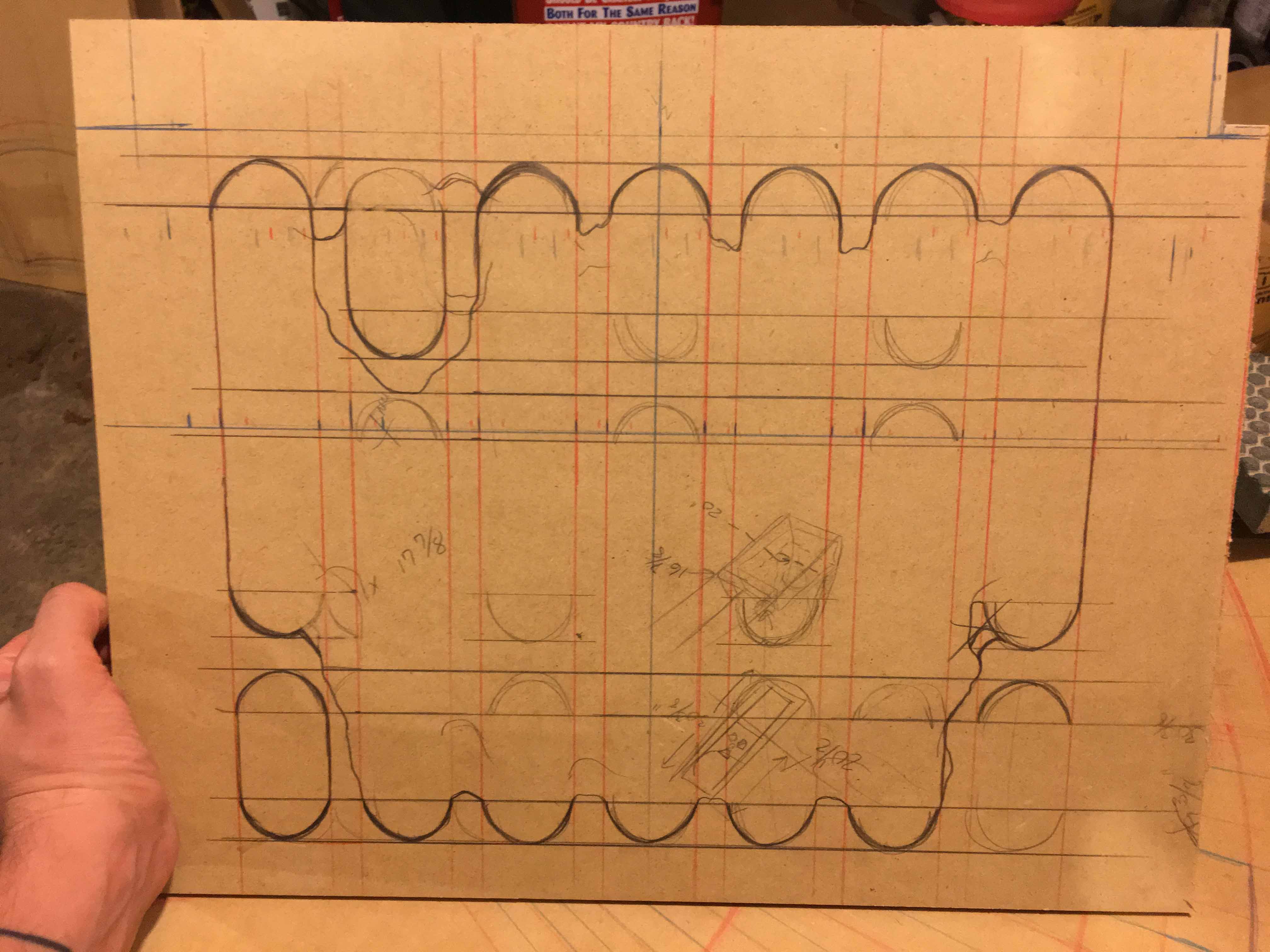

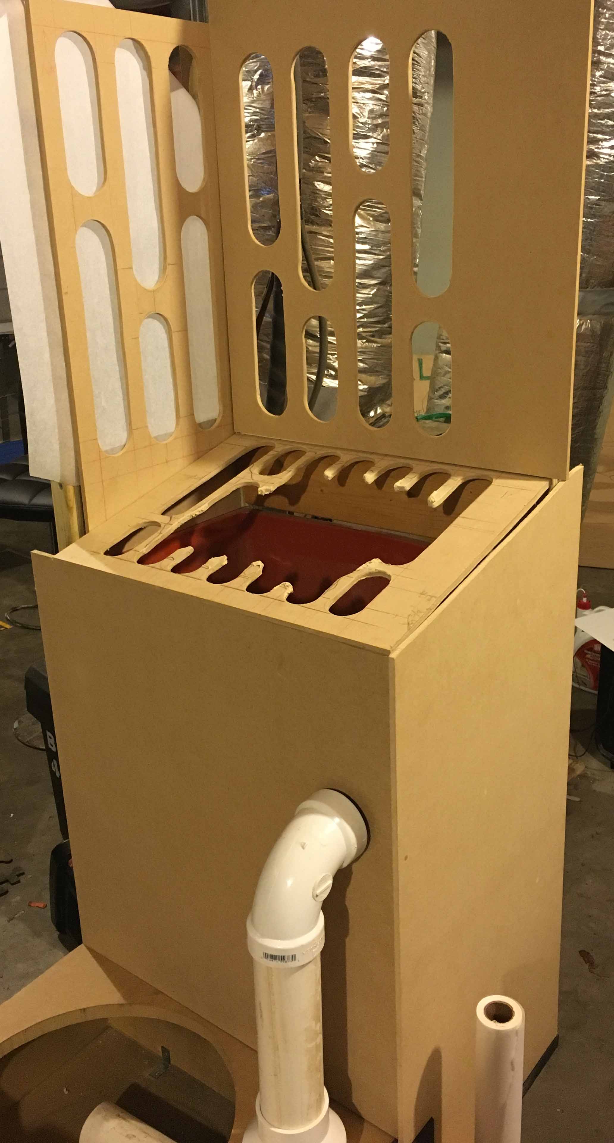

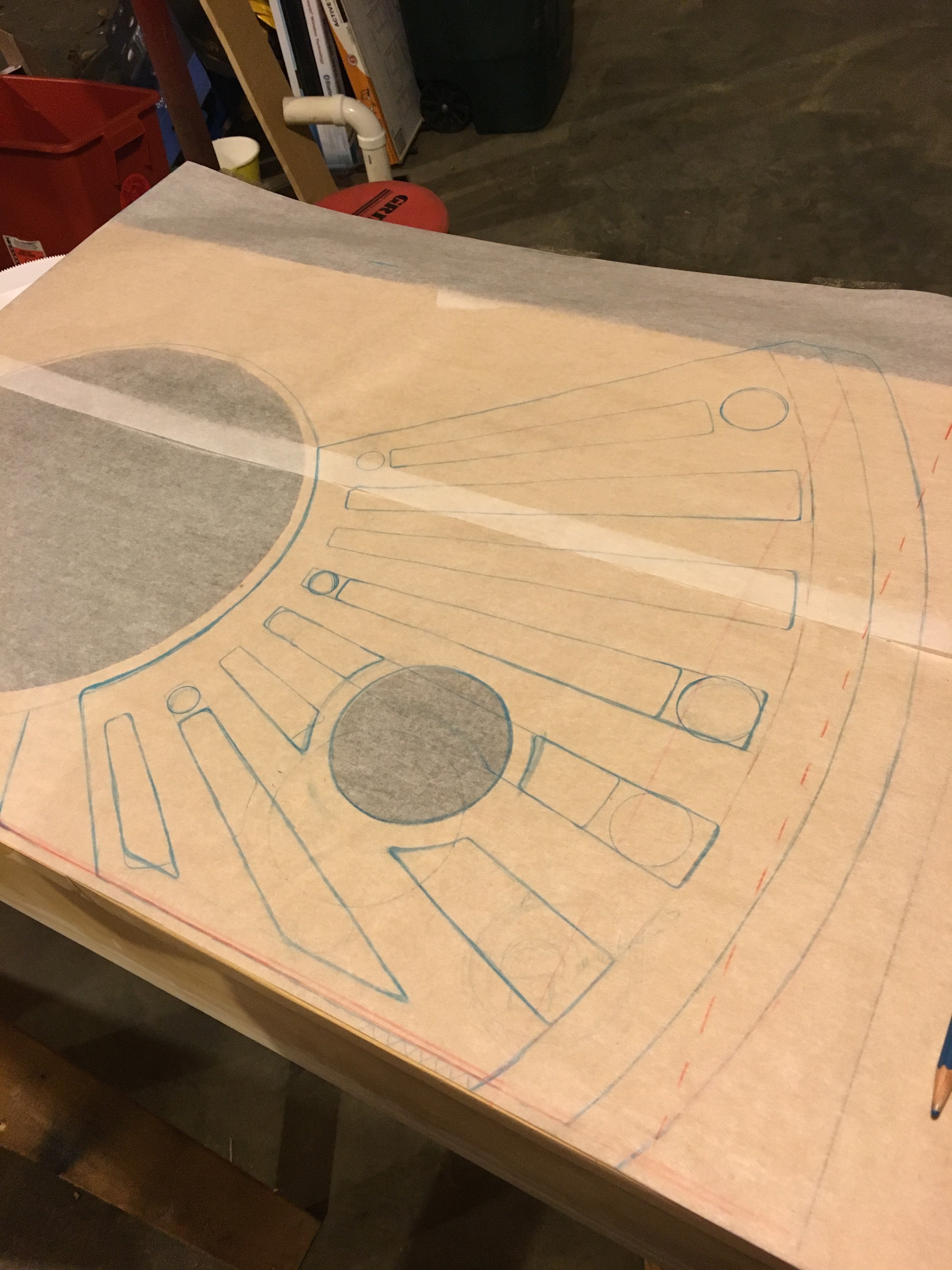

I then built a shell around the can with the idea of adding some greeblies (I think that's the term) to the side panels to give it some flair but mainly wanted the feel of the detention block escape.
So, I made this...

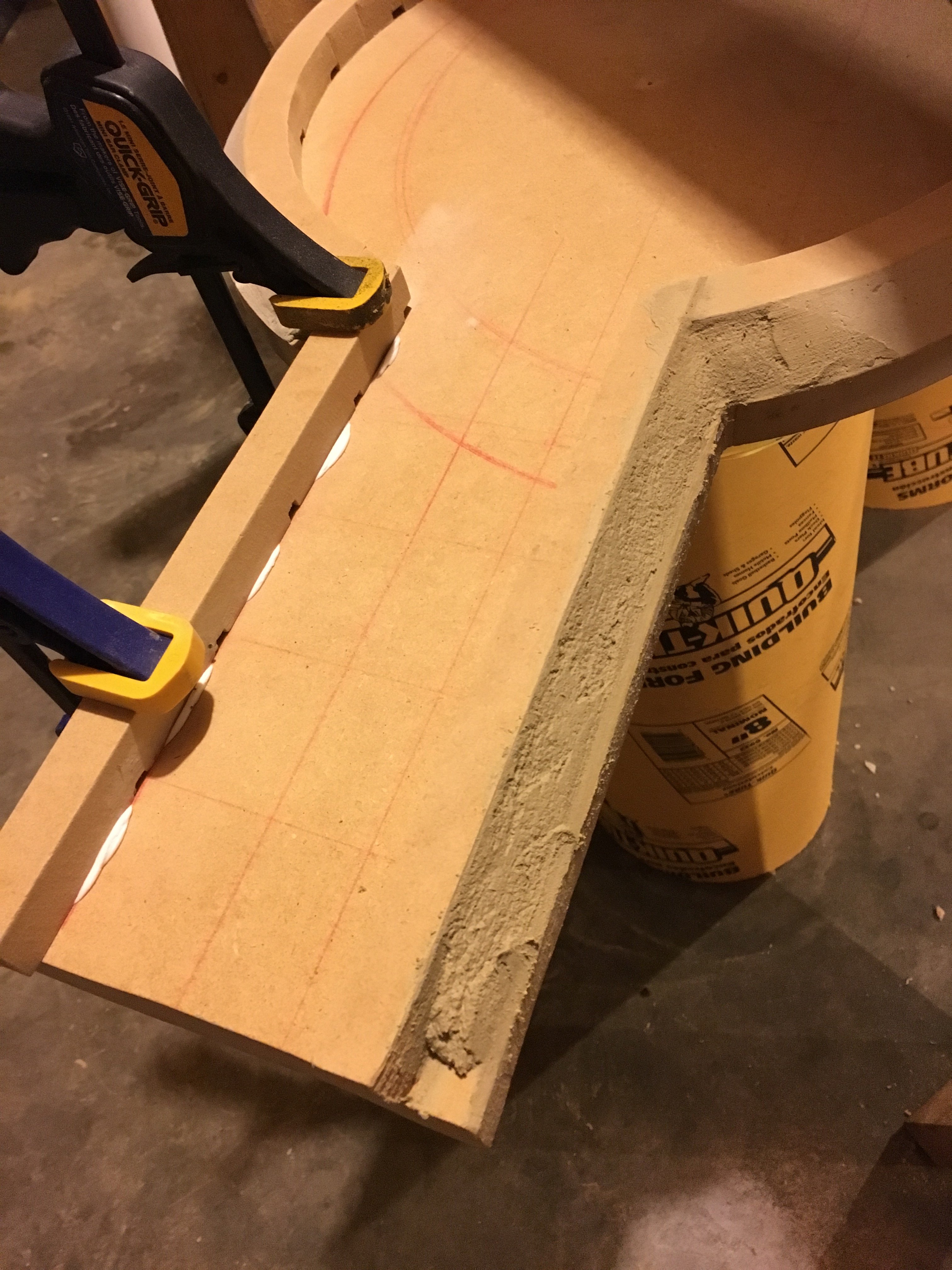

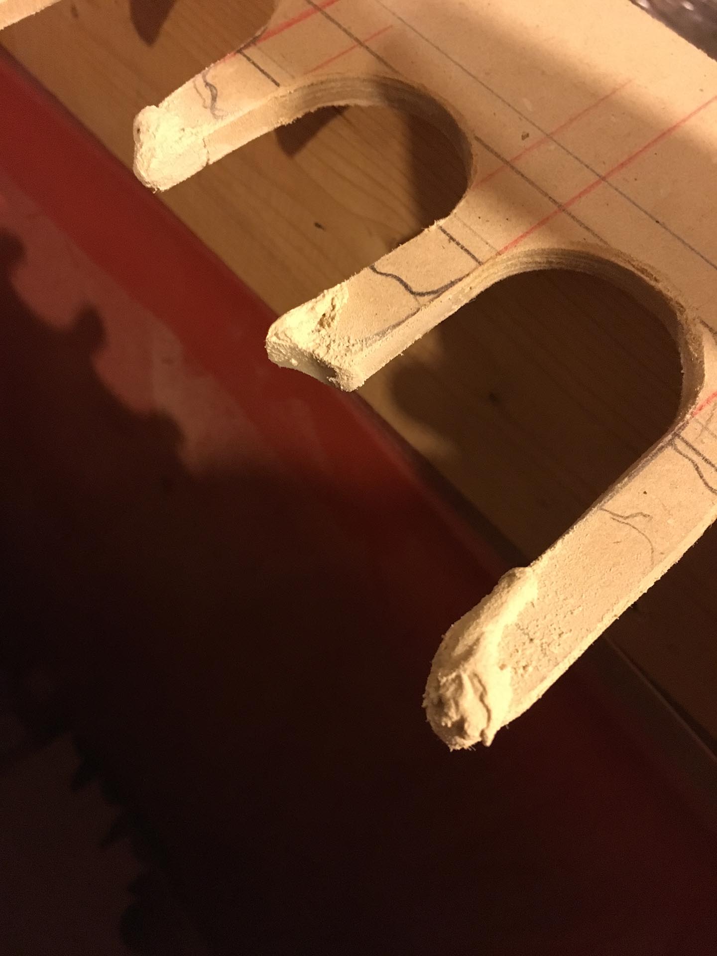

I also added some wood bondo stuff to the ends to give it that "just blasted by a princess who is ready to get the Hell out of the detention block"..
