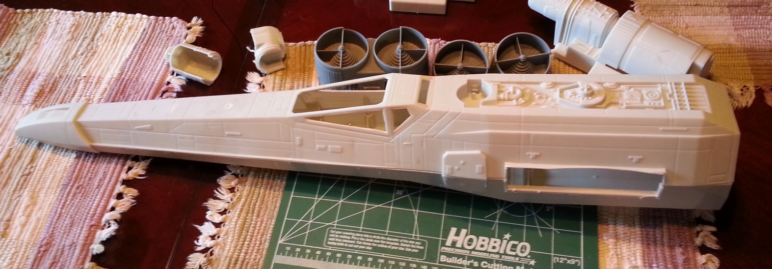

I decided to start this project with the engines and work my way forward, since the engines and wings will take the most time and effort.
So, after pulling the entire X-wing apart I closely examined these parts and compared them to ILM reference photos to see just how close this x-wing was...I'm REALLY amazed at how accurate it actually is!

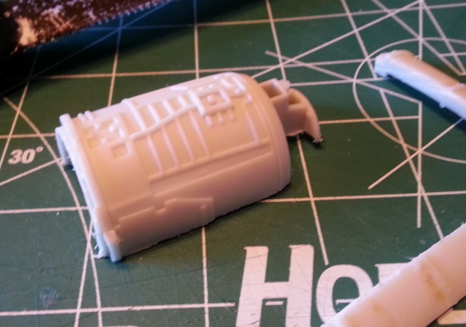

Engine intakes are molded together... those needed to be cut apart.20150928_115636.jpg

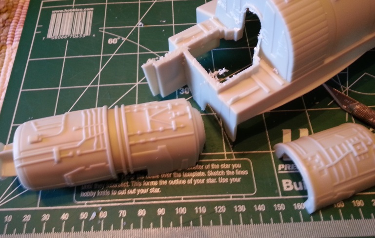

This segmented piece was trimmed off and will be added later to wrap around the bottom half of the intake.intake1.jpg

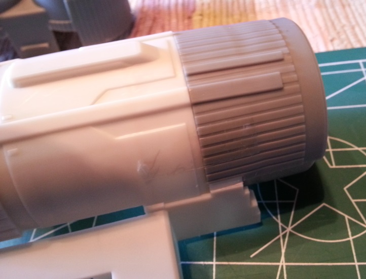

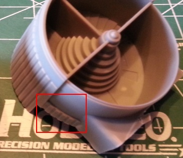

Intakes do not sit flush against the engines, there is a gap. Scale X-wings do not have this gap.20150928_120929.jpgblue1ref.jpg
These tabs need to be trimmed off.20150928_121004.jpgIntakes now mount flush with the engines.20150928_121343.jpg

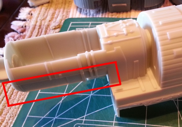

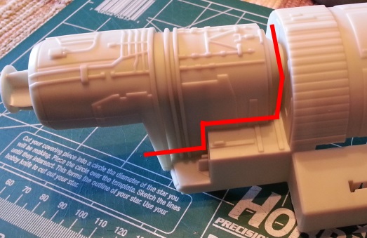

Other sections of the egine will need to be cut away and re-built, for example, the rectangle ridge on the engine can. This photo actually shows the bottom port engine and I think Hasbro molded this to act as the "landing gear" for the toy to sit on.engine1.jpg
Re: My 30" Hero series X-wing build
There are only 3 engines that will need to make ONE good one for casting!
The 1/4 of detail from one of the bottom engines will be needed.enginemod3.jpg

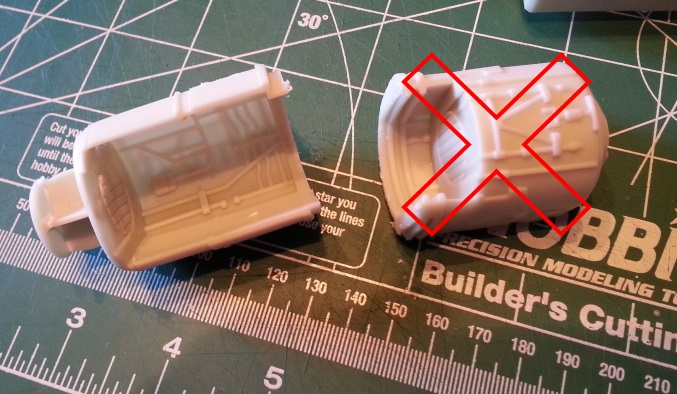

Now to put one good engine together!

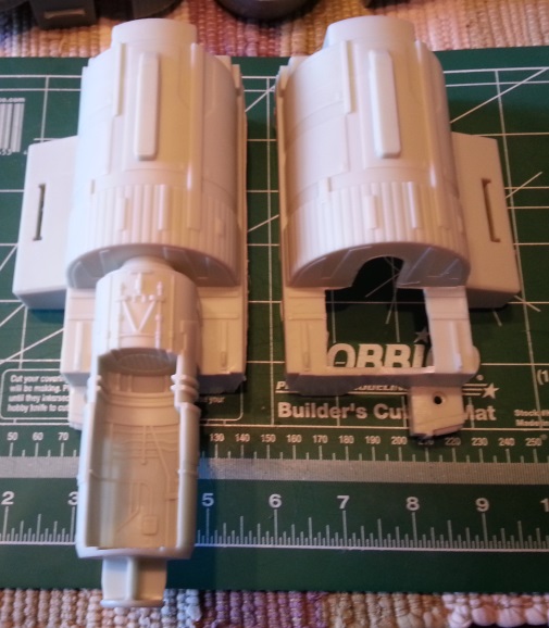

One of the Engines from the lower wings is cut off, then cut in half,
taking care not to cut too
far into any detail of said part. It's pretty thick, a razor saw makes short work of this
and you won't have to go through a box of band aids using an exacto! The half of the engine with the red X
is total scrap and shall be enjoyed by taking stress out on it and skipping it down the road or into the lake!

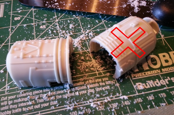

now taking one of bottom engines that I cut off earlier, cut it in half.20150928_120220.jpgRed X is scrapenginemod8.jpg
This the detail part needed to complete the engine and it ALSO needs to be cut in half.20150928_123936.jpgThen cleaned up.20150928_130210.jpg

I cut the other top engine off and it was also cut in half then in half again.20150928_131817.jpgenginemod9.jpg

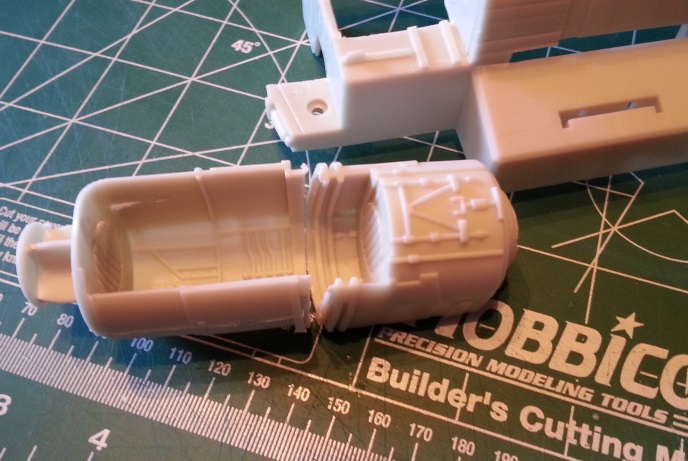

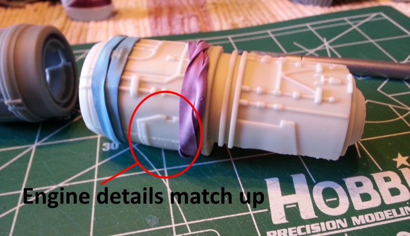

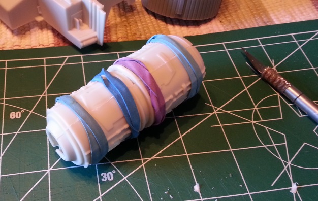

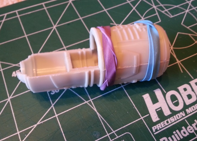

I took the top engine half and the 1/4 bottom engine detail and glued them together. 20150928_151457.jpg
You can see the engine detail lines up and if you flip it over, the other side matches up too! enginemod10.jpg
I used the front part of the 3rd engine I quartered, and glued it in place. 20150928_161916.jpg Note how well the details line up?
This made one complete engine. Takes 3 to make one!

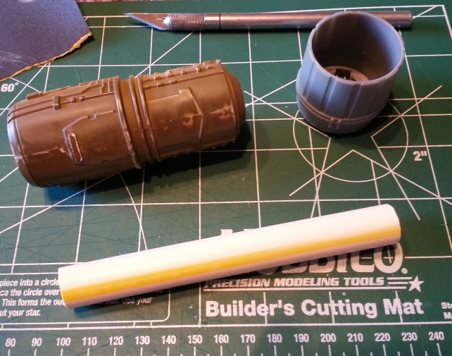

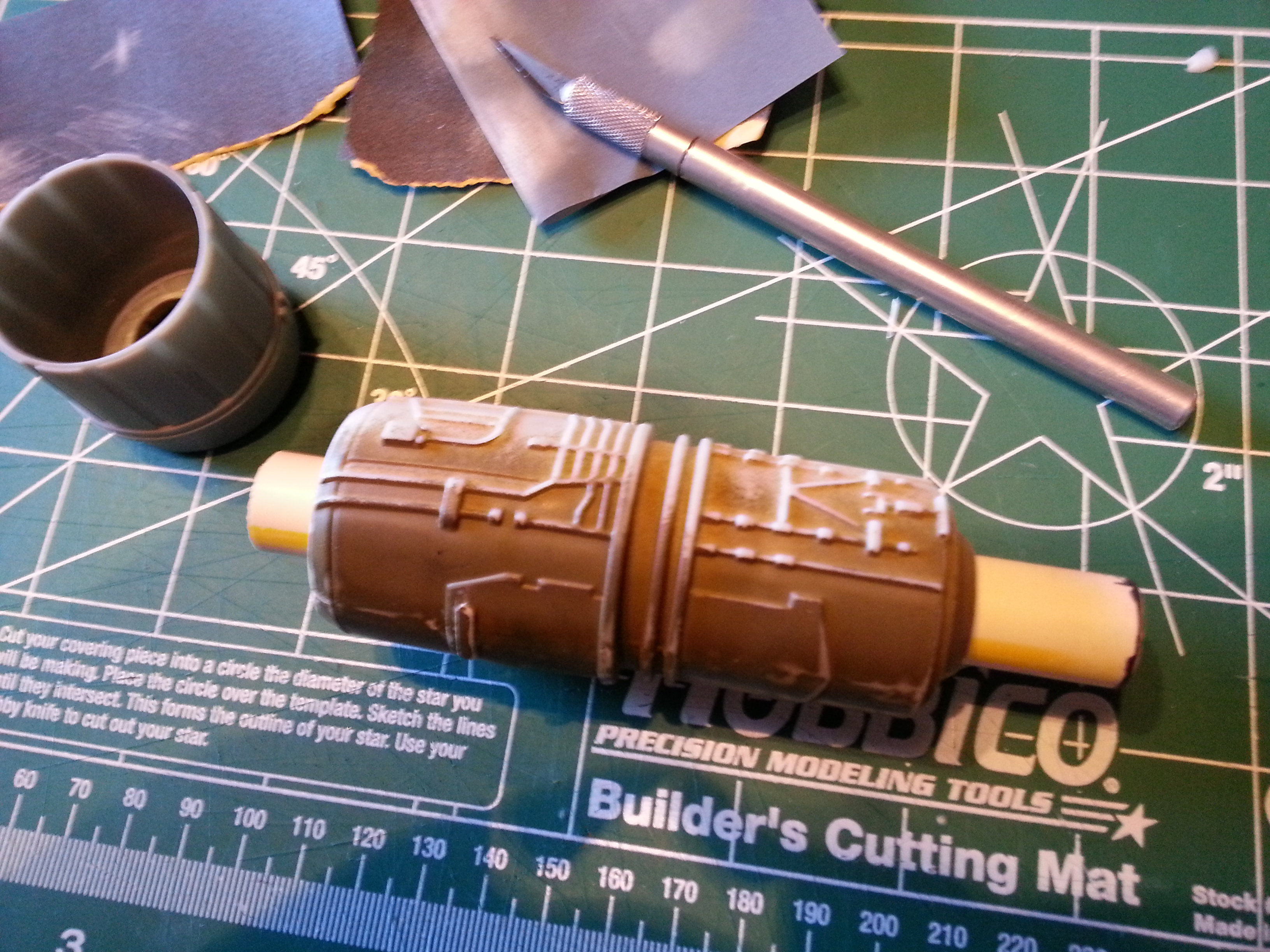

My initial thoughts for this X-Wing were to have
the engines light up and cockpit light up. I cleaned up and filled any gaps on the engine, along
with replacing/ rebuilding any detail that accidentally got cut off or scraped away.

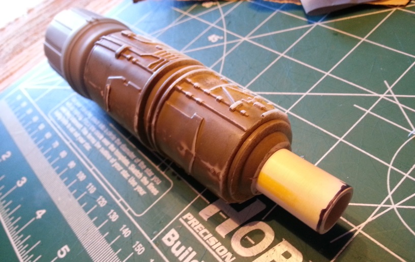

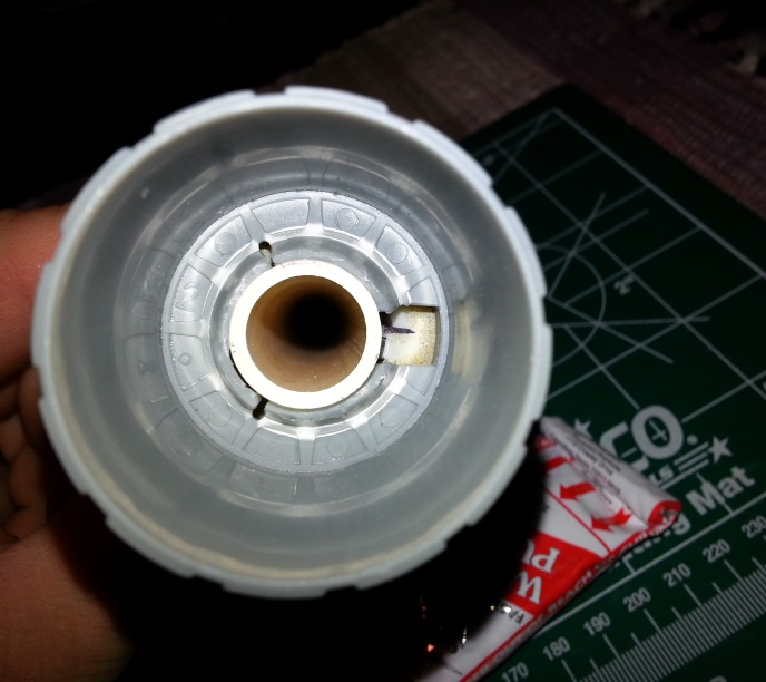

I wanted to create a channel in which the wiring/ LED's would be passed through and also
provide a more secure mounting of this engine to the main engine section. I cut a piece of PVC pipe 1/2" X 5" long. I carefully cut the hole
opening just slightly larger at the front and the rear part of the engine.
20150930_110906.jpgMaking absolutely certain everything was centered I passed the PVC through the engine.
Did a test fit of the engine nozzle. Everything lines up great!!20150930_141447.jpgCOMPLETED ENGINE READY FOR CASTING!!
Looking down the engine nozzle, square hole will be filled and internal engine details/ LED's will be added later! 20150930_142531.jpg
