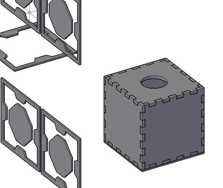

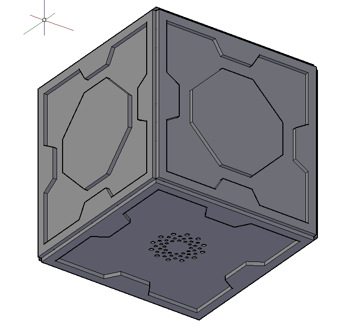

I'll be lasercutting the darker pieces shown here from 1/4" birch plywood, and will cut the lighter pieces from 1/8" wood. They'll then be painted and assembled.
I have a button and sound module to install once that's complete.

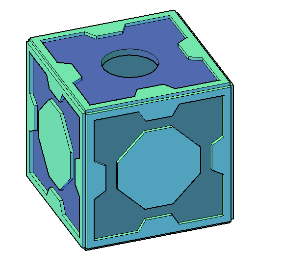

I started by taking a few screen grabs to get some good angles. Animation works differently that live action, so naturally each shot of the box won't show exactly the same proportions, but I came up with a design I was happy with.

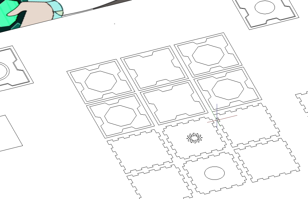

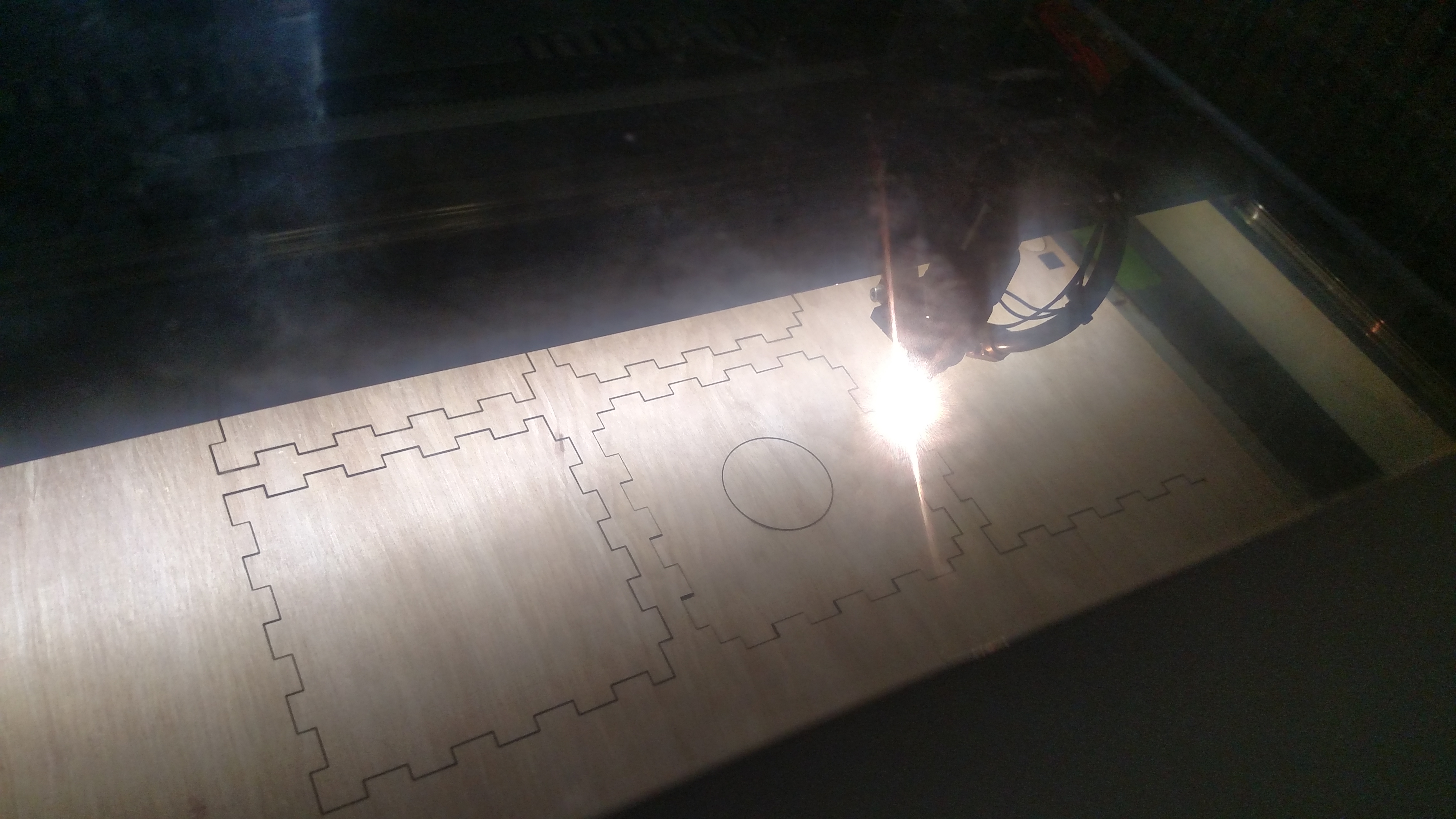

To produce the box, it'll be made from flat sheets of material, so I've laid out each of the six faces to cut. It'll be made of layers of different materials, so there's 12 squares, two for each face. The bottom will have holes for sound to escape from the speaker, and the top has a big hole for the button.

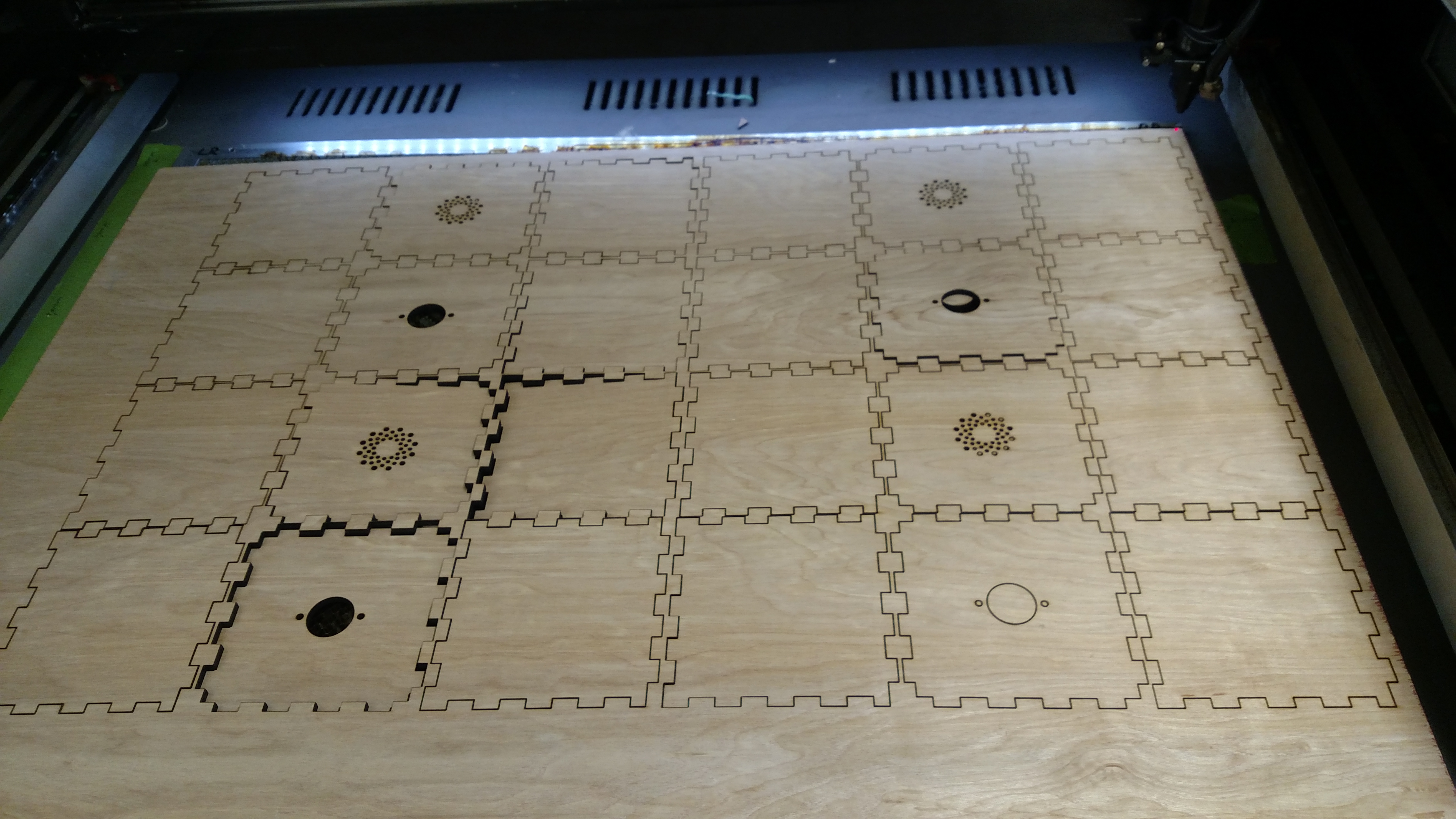

Once I cut the parts, I'll paint them, and then fold them up and assemble them like this.

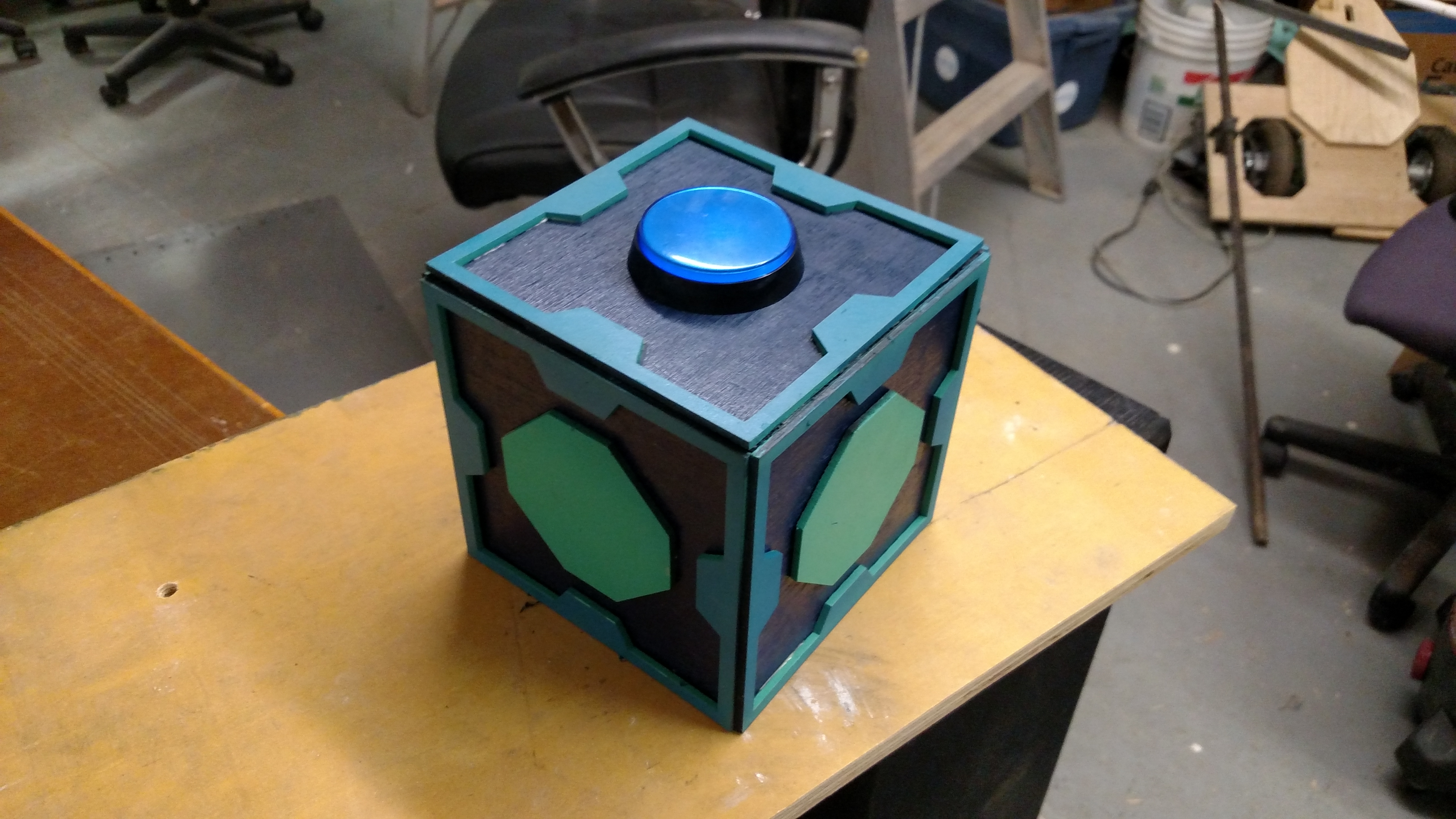

Look at me! I'm still waiting on the button, and I'm not 100% happy with the colors yet, but I just used what I had in the shop.
uploadfromtaptalk1443132836294.jpguploadfromtaptalk1443132862349.jpguploadfromtaptalk1443132887862.jpg
Sent from my XT1254 using Tapatalk
That is looking magnificent! Look at me! How big is it? It's hard to judge the scale from the picture.

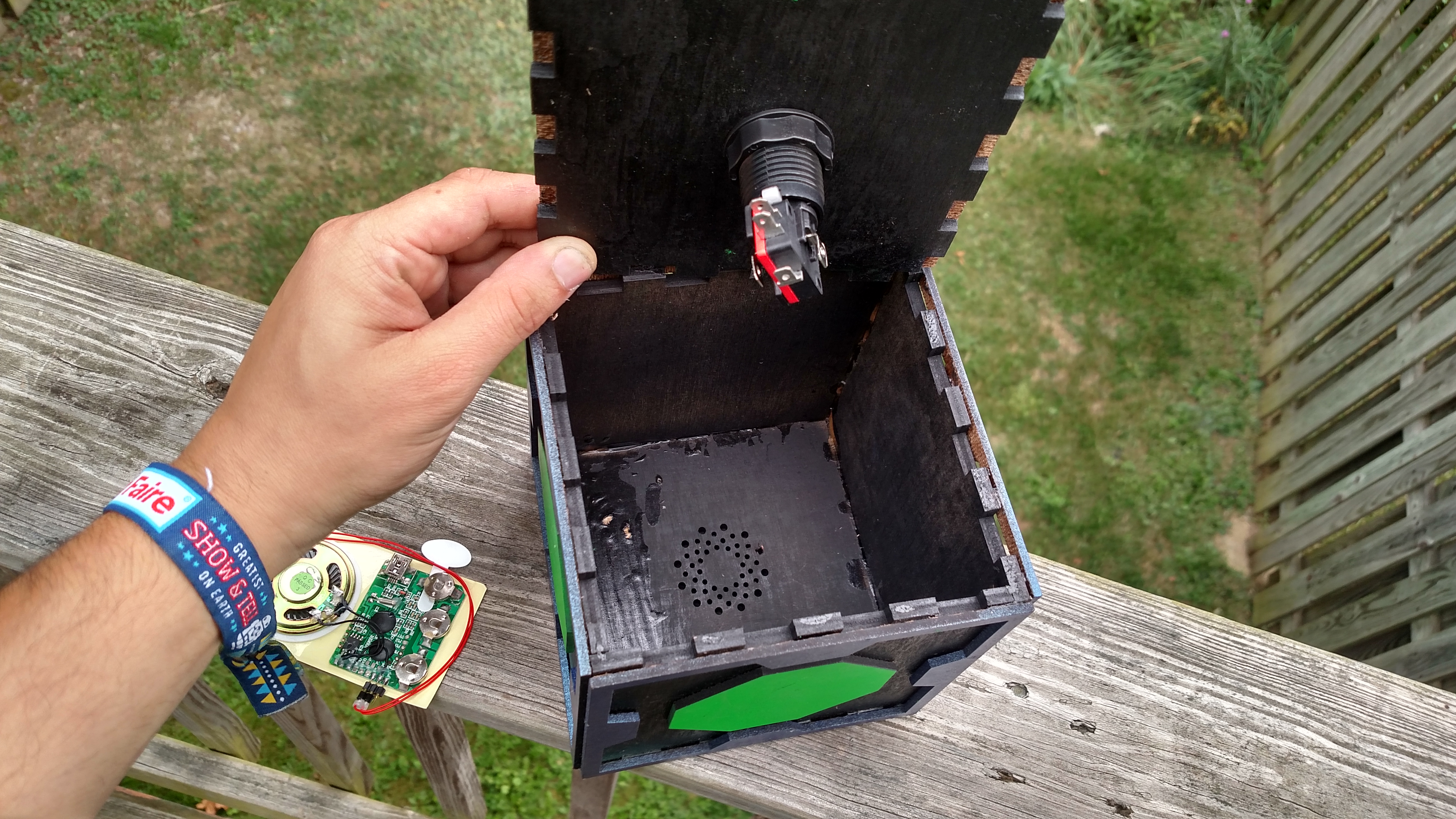

Sound module works! I loaded a few Meeseeks voice clips. I gotta wire it to the big button, increase the volume, and adjust my colors.
Soldering the button to the sound module
Those colors look great. It's cool to see the speaker wired up. Are you self-taught in electronics?
I have a mechanical engineering degree but this is pretty simple off the shelf stuff I'm just connecting. The sound module to the arcade button, adding the snap-on battery harness for the lights. Someone at your local hackerspace will show you how to solder.
