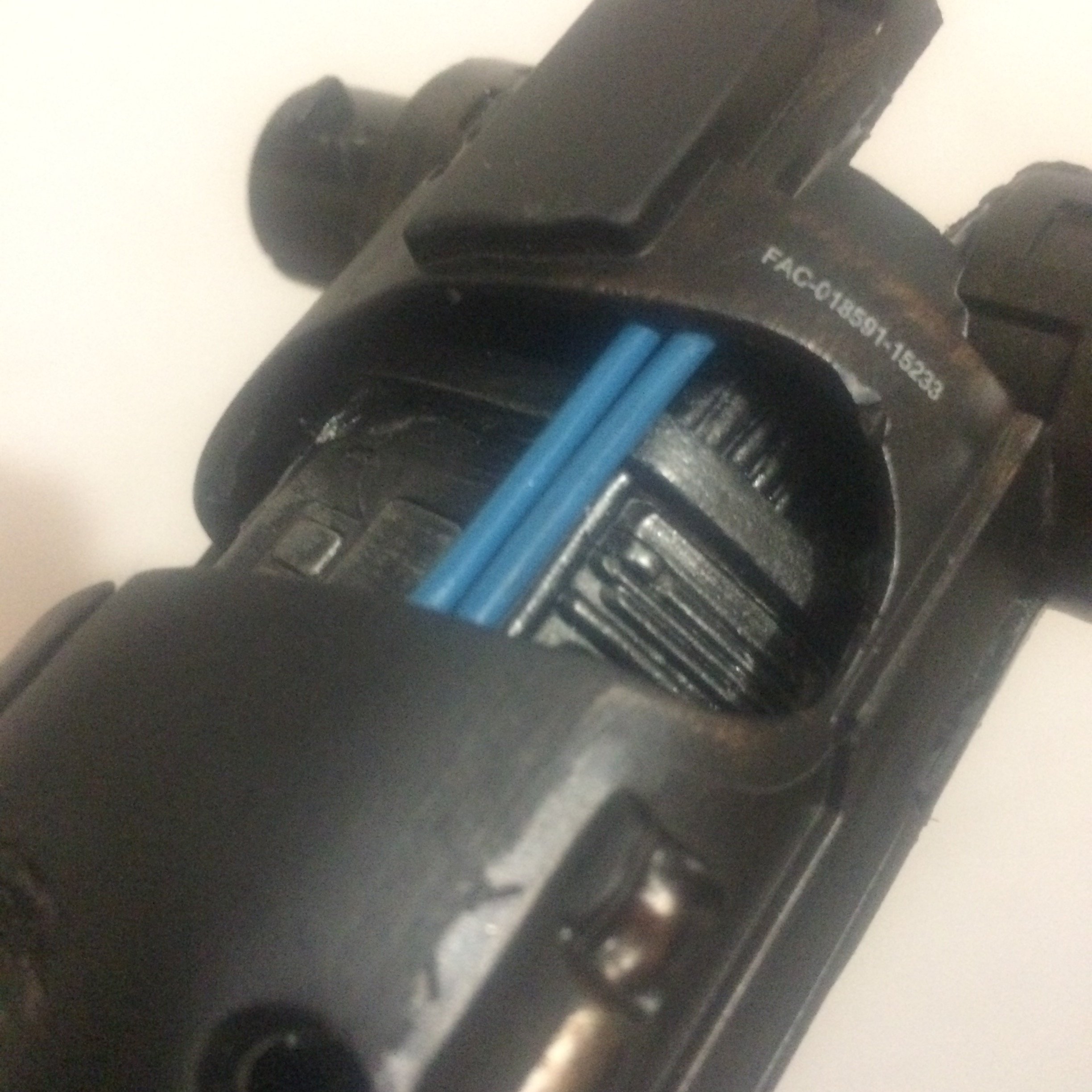

Here's what I meant for the LED connector. I think I figured it out.
The brown wire is the positive lead (I believe), the red wire is for the first 6 LED's, the orange wire is for 7-12, etc etc. Evidence (not proof) below:
You can barely see it on the PCB, but the wires drop off at intervals of six. Here is LED 18, going from 2 pcb traces (right) down to 1 (left).

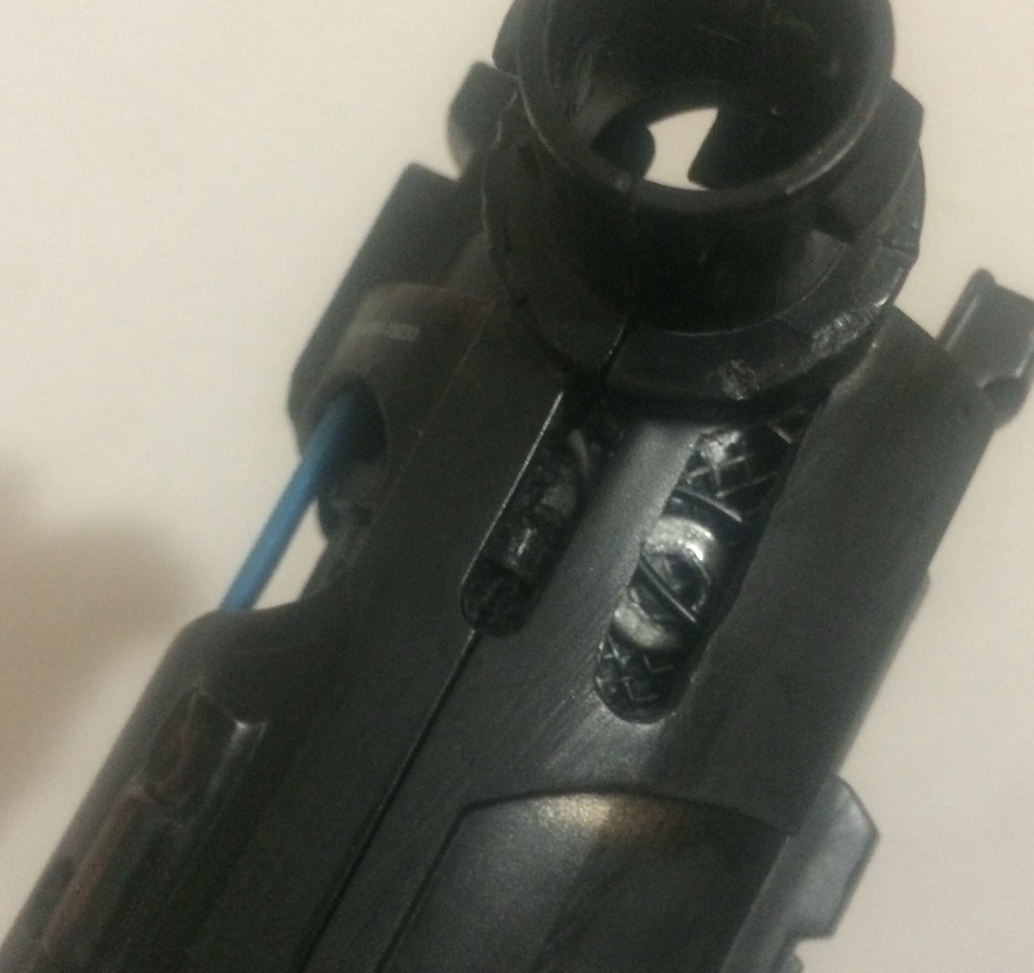

Here is the crossguard cover that I had to slice with an XACTO knife to get off. I'm going to try to fill and maybe lightly sand when I reassemble. Leaving this here for documentation purposes. Another user earlier in the thread mentioned using a heat gun to soften the plastic.
Good work! With a little cleanup and sanding it will be unnoticeable.

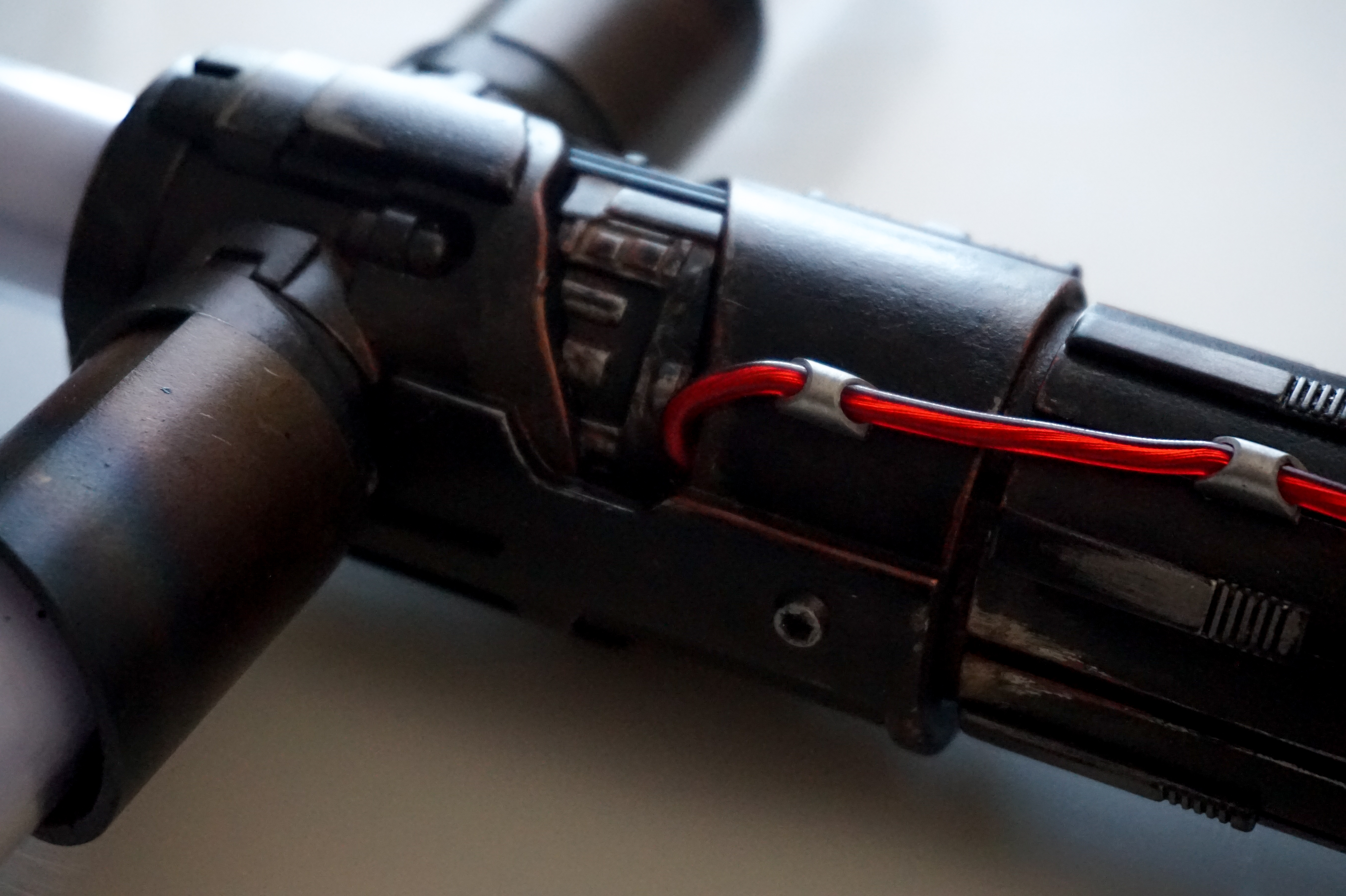

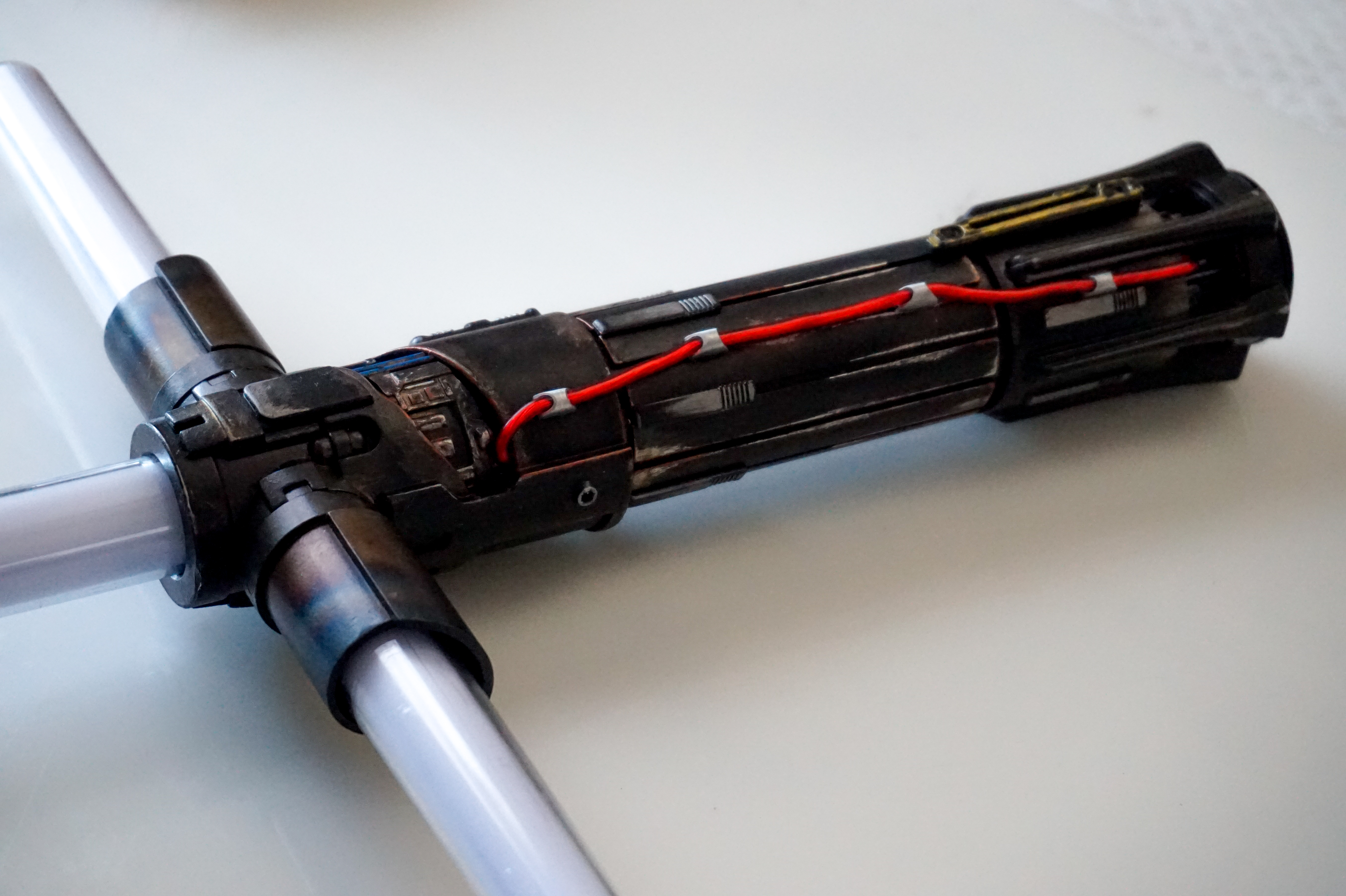

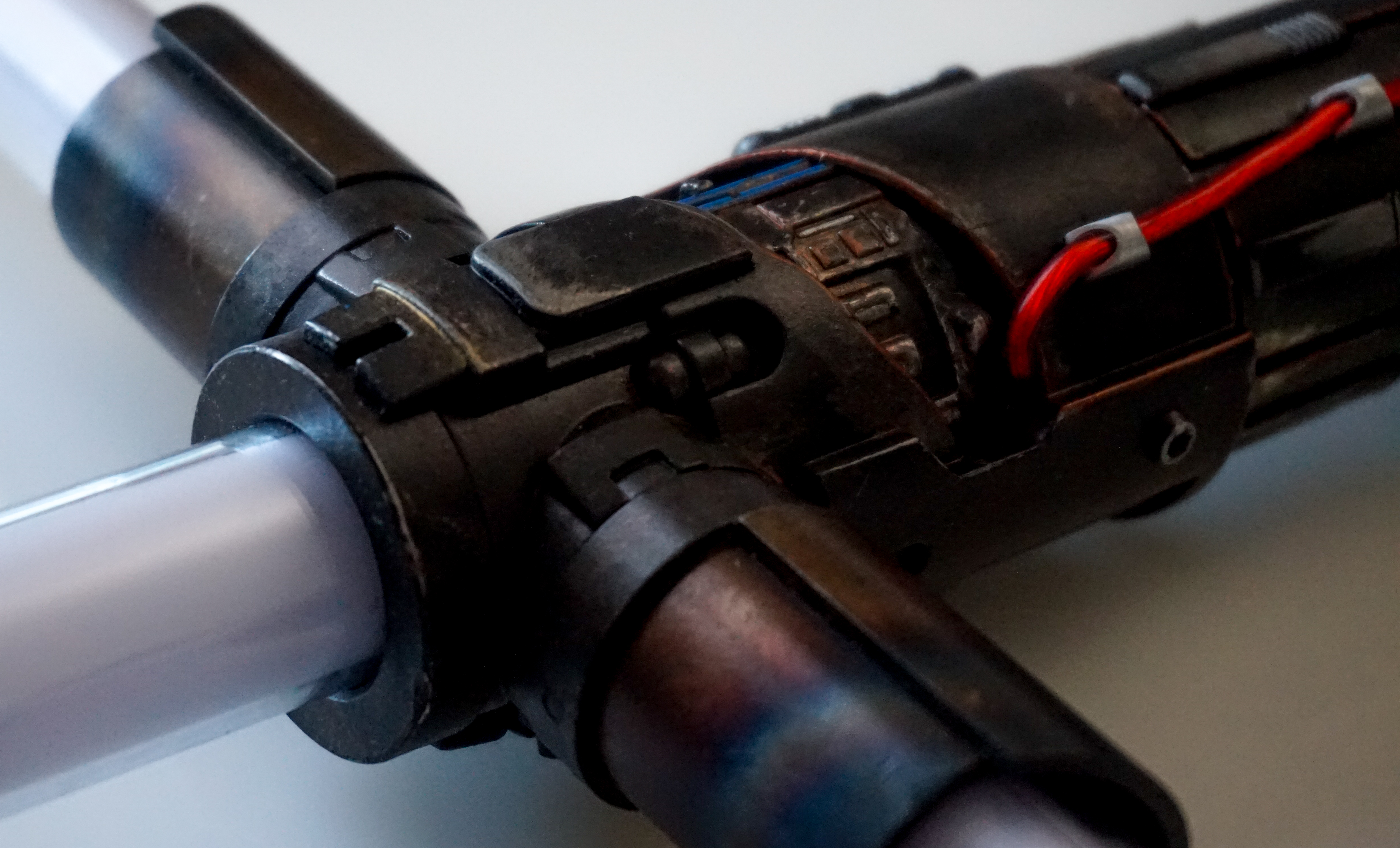

dmpsk8 Man, that looks good! I'm gonna definitely do this now, it looks like a fun side project. I would use the red transparent wire i used on my force fx though, I think its more accurate. Is the one on the disney solid plastic?
Yep, the Disney one is solid. That transparent wire looks fantastic, nice find.
