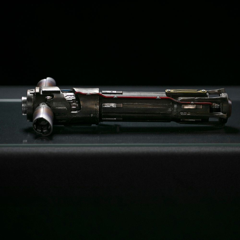

You made a great job,man.The saber looks great.But you need the tranparent red wire!;)
The originalsaber has a clear over the sword.
Good eye! I'm not replacing my wire, but I'm sure someone will have some fun with that. Looks very cool. I haven't seen this shot before. Is it the official hero hilt? I know there were apparently a few versions.
Look in the Thread "Kylo Ren Saber hollow hilt for electronics" here on board.
You will find lots of awesome HD pics of the different sabers there.
