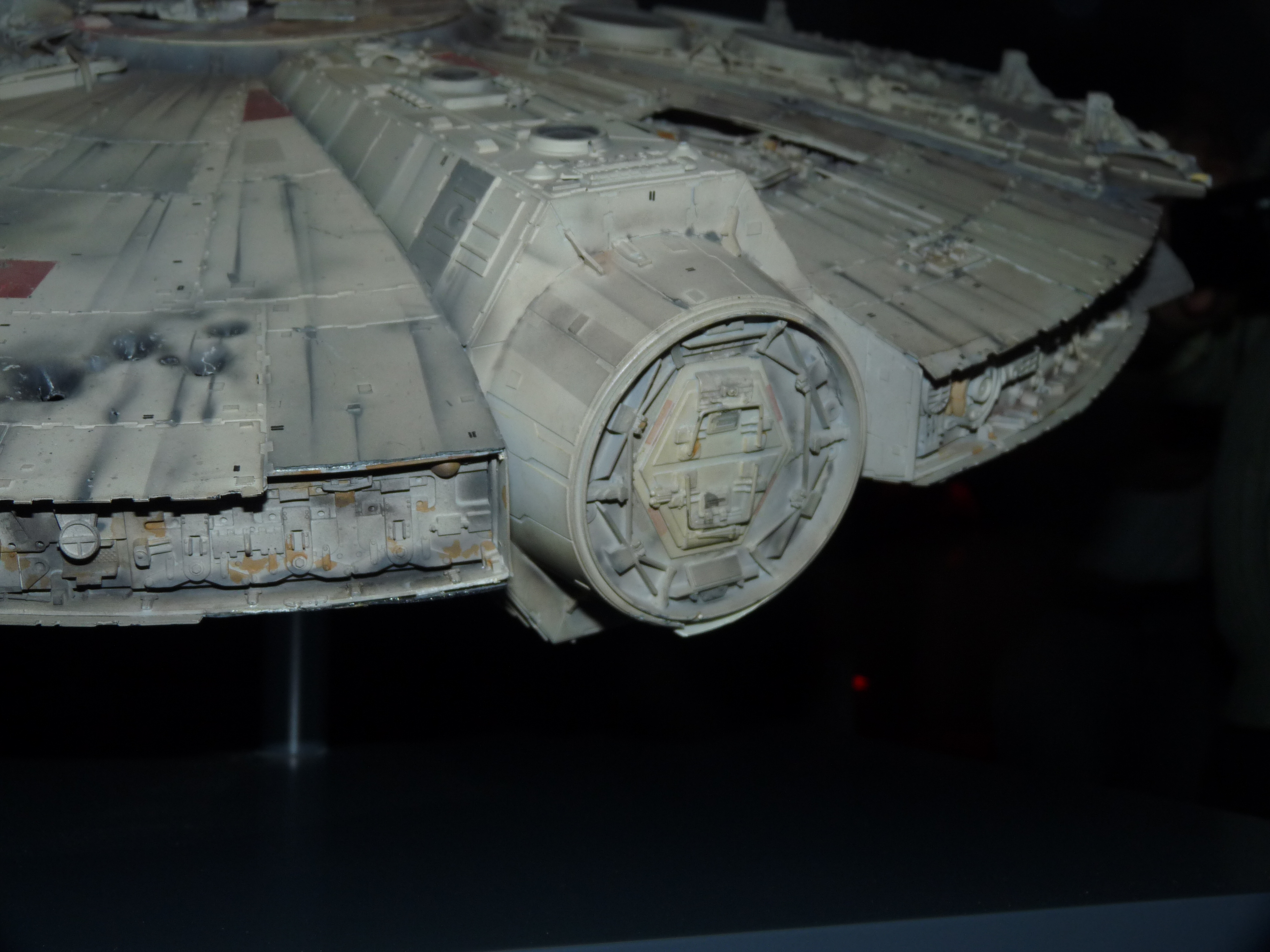

The hull panels on the hallway corridor both on the top and the bottom hulls have notches along all four sides of each panel. The part that they issued is missing the notches on the bottom edge as well as the outer sides of those panels. Take a look at this photo of the actual 32" for reference to what I am talking about and compare it to the hull panels on the part included with the kit. They did the same thing with the top TP-1 and TP-3 parts with the missing notches.
Just an FYI LrdSatyr8, that image you posted is of the large 5 foot falcon built for ANH and not the 32" model...you can tell by the decals that are on the surfaces, which the 32" did not have...although the plating is very simular
Yeah I know it's the 5 footer... but the hull plating notches are the same on both. This is a better pic... take a look where those parts meet the hull. You'll notice the notches. (and yes... this is a pic of the 32" incher this time)
It occurs on both the top and the bottom
I'm looking into it, l've the correct details info for 3 of the hull sections so may work on that at the weekend. I not that fussed to be honest! I understand the need for cockpit window correction that Dagostini are redoing.

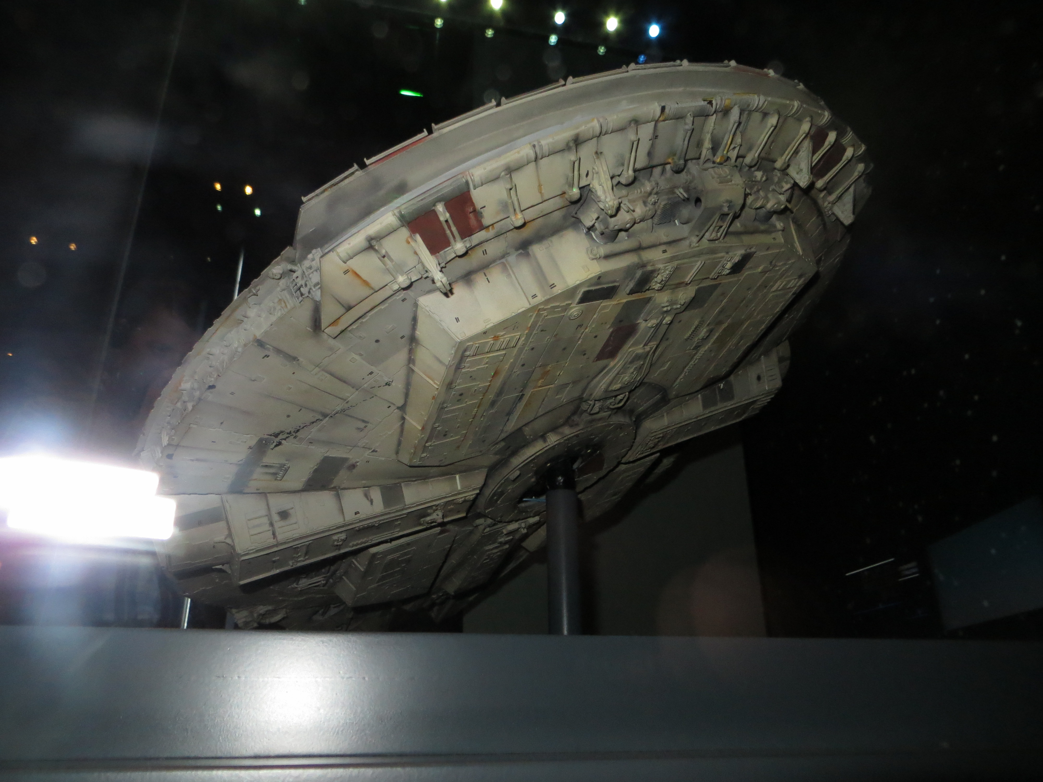

It's yellow on the big square patches...sample close up of it here...Seen it a few times on studio close ups . On others (whole shots) its a sand like colour but that could be camera,aged picture,scans etc...
I'm leaving it as a mild sand template and can change it come the Falcon bible photo refs promised in future issues!!! Btw..Great work on your scratchbuilt seats LrdSatyr8.

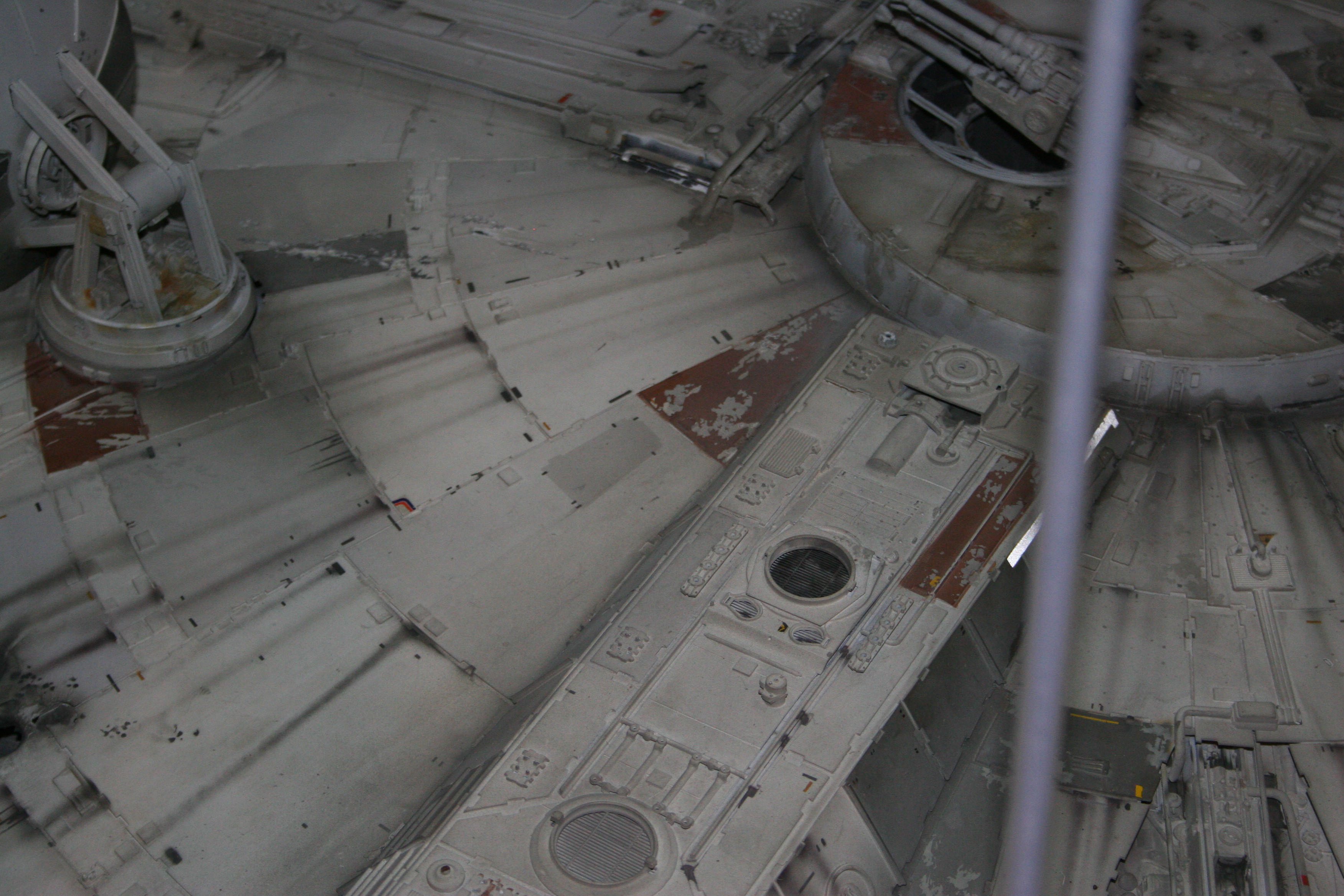

Photo RAMP underside courtesy of: http://www.dnkhobbies.net/32-millennium-falcon-reference-photos/
Great references :)
Below a studio shot of the same Ramp area...
Just have fun creating a happy medium, remember light, photos,old photos,scans all make for different colours and make it hard to truly judge what we see & redo...

Looks more like Dej'on Mustard color to me... not as bright butnot really yellow... I think it's suppose to be most of a bright rust thou because the color has faded or bleached out over the years. Thanks bro... They are coming along slowly... wish I could figure out a way of doing the hallway light slits easily.
If l put on a yellow & dirtied it down it would be...Mustard ;-) ha ha!. Good luck with the hallway lights!!! Insane details!!! Brilliant.
