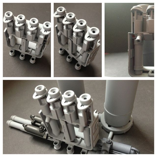

    DV, I like your 'gas pump' design; it sure looks the part. For myself, I figured 'fueling up' for the MF would be like dropping a core on a nuke carrier. In fact, I see that large M60 Patton tank hull part (at least that is what I think it is...) on the underside of the engine deck would represent the loading port / shield for the engine's fuel 'module'. Any hose connections seen in the movie were in my mind for consumable liquids & gases. Guess that jives if you imagine some of the thrust & control forces come from expelled matter (aka reaction jets.)
    So, all good!

    Yeah.. That's sounds great rbeach .lve in mind a gas & air pump as well as a water jet for cleaning ships..

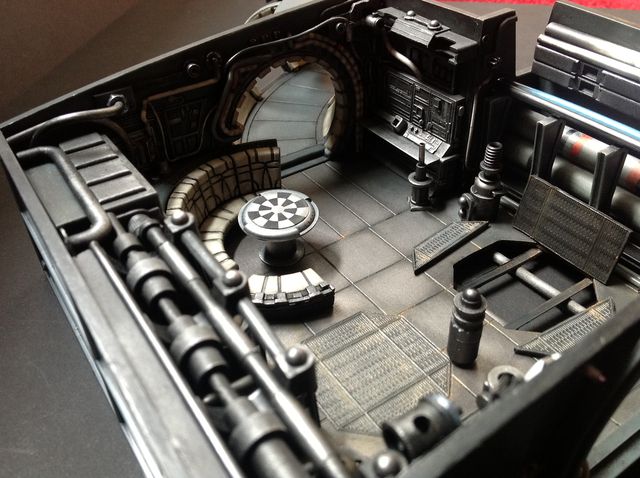

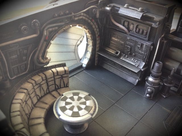

    Thanks sircharles77, welcome. l mention earlier in this thread the materials and method of using quick Winsor & Newton drying oils namely the Lamp Black... The hull is mentioned too...
    Here's an example of the main hold floor.. With a small brush apply into the crack areas..... That's Straight from the tube and on the model floor (no prime or treatment)...
    With a soft cloth rub in till you get the required effect and if you rub the central part of the squares it makes each tile look more prominent.. It looks good up to that stage but you can add a slight metallic effect by adding a very small amount of Rub n Buff pewter to a new cloth and rub in ...you can repeat the black oil process if needed.

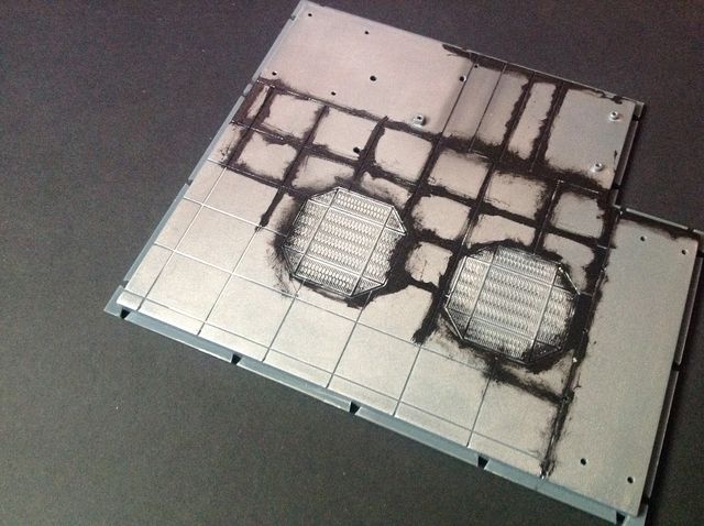

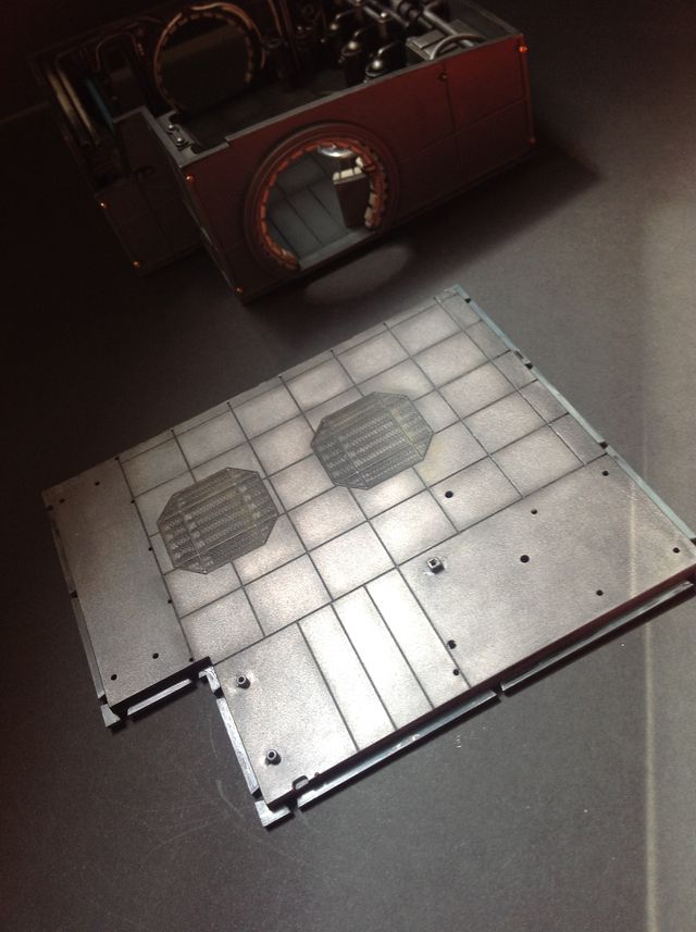

    . Cheers all...1&2 best...
    I've just received my issues 19-22 at last so plenty to do, anyway hope this helps :-) l'll try & explain as best l can...
    1. Rub n Buff, put a small squeeze of it on a paper towel.. This stuffs potent & goes far... Dab your cloth (mines a black lens cloth from specsavers) in it then rub excess off on the paper towel (bit like drybrushing) Rub like mad the flooring I left it an hour or two.. This is only if you want a metallic like effect..,
    2. The black oils into the crevices with brush..and used another lens cloth to rub it in...left that for at leased 5 hours..
    If you've used to much of either...put a tad of white spirit on your cloth and rub, it will take mistakes away.. Trial & error till you get your own happy medium.. You can add more pewter buff if you've added to much black visa versa ...
    This technic is only suited to the plastics that are pre-coloured in models...as you can imagine a primed & painted model would have their colours worn off with vigorous rubbing & a big no no on matt prayed surfaces. :-)

    Thanks so much for the explanation. Just a few clarifications. Sorry to keep bugging you:
    I don't understand this "Rub like mad the flooring I left it an hour or two." Did you apply it all over and then leave it for an hour or two before you came back to rub and buff???
    "The black oils into the crevices with brush..and used another lens cloth to rub it in...left that for at leased 5 hours." So put the oil on with a brush, wipe excess away until happy. Then leave for 5 hours. Then what??? Do you mean that's how long it needs to dry??
    "This technic is only suited to the plastics that are pre-coloured in models...as you can imagine a primed & painted model would have their colours worn off with vigorous rubbing & a big no no on matt prayed surfaces." Do you mean for the Rub n buff or both that and the oil paint??? I ask because I want to use the oil paint on painted sections as well???
    I promise these are my last questions until the next ones.

    Hi,
    After brushing into crevices I just rub in the black till I get the required effect and fade you see in my work.
    leave the black oils to (once rubbed) dry for at leased 5 hours before the pewter rub n buff...just where you want it...with the floor it's a tiny bit per square floor tile for instance.. Rub it in well.
    Best to experiment and try testers on something similar..
    This falcon models fine to use this technic on & the ready painted parts too.
