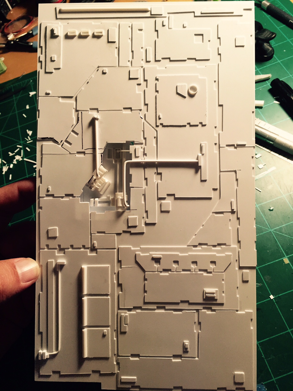

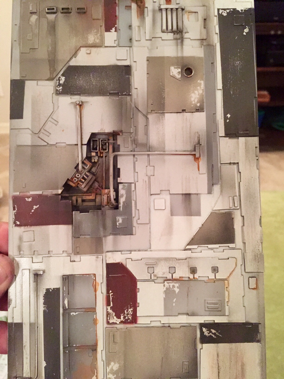

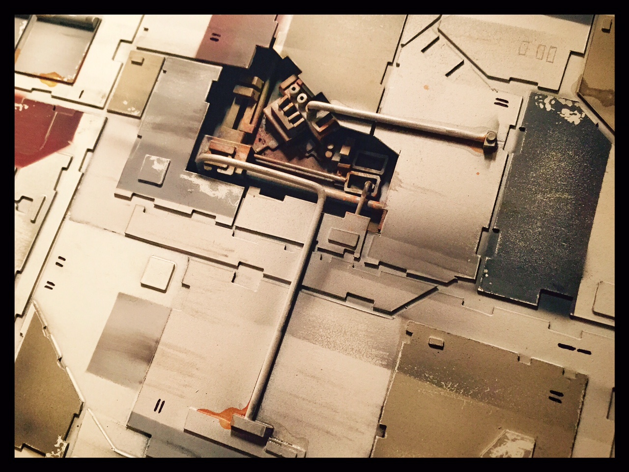

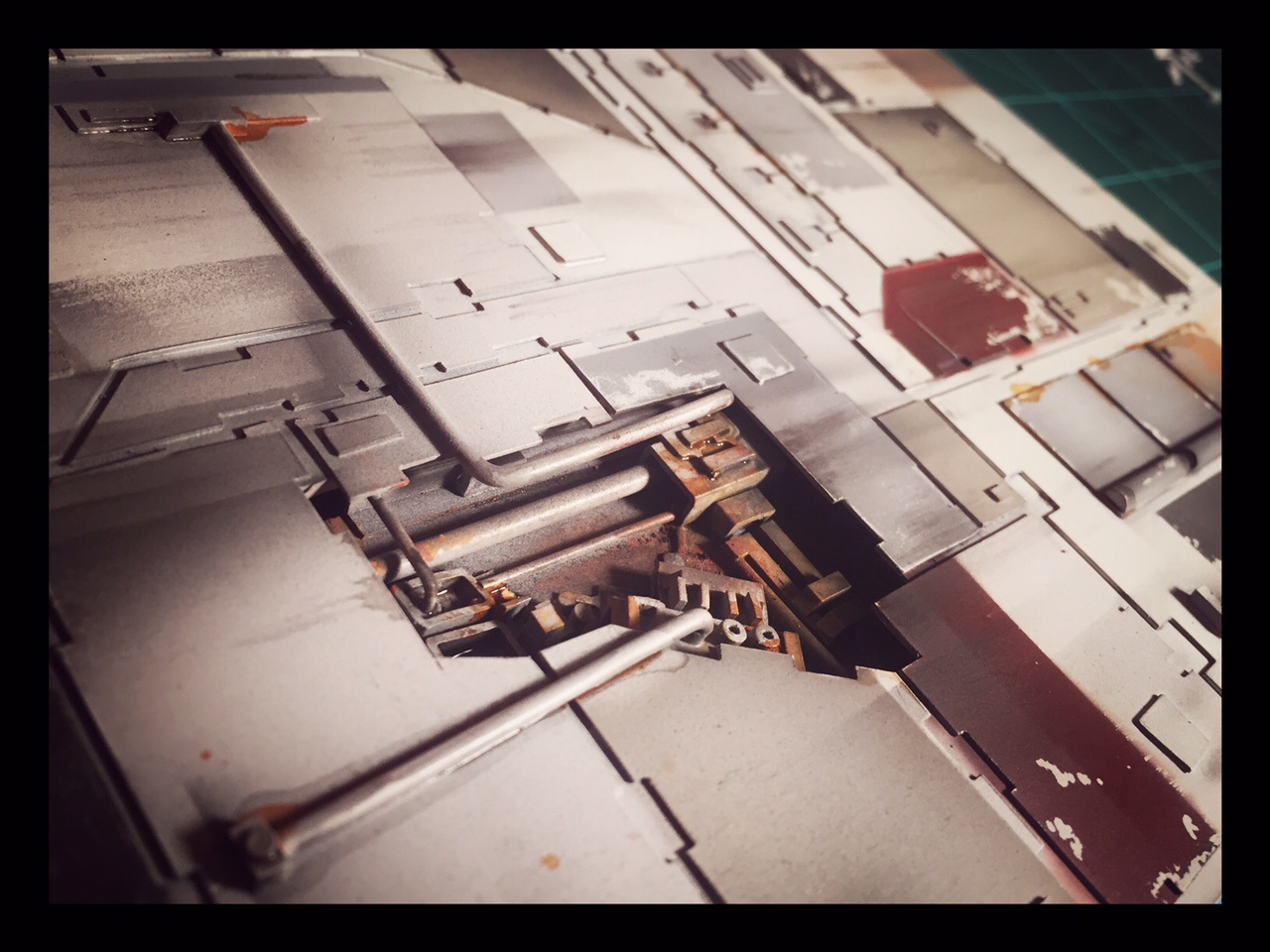

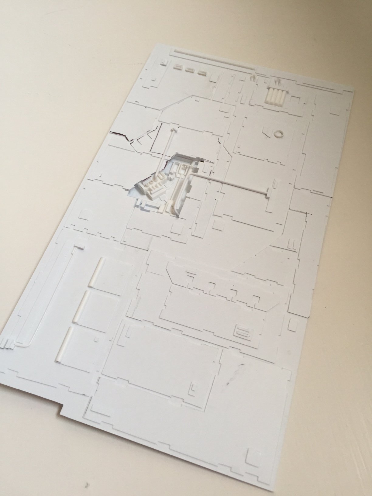

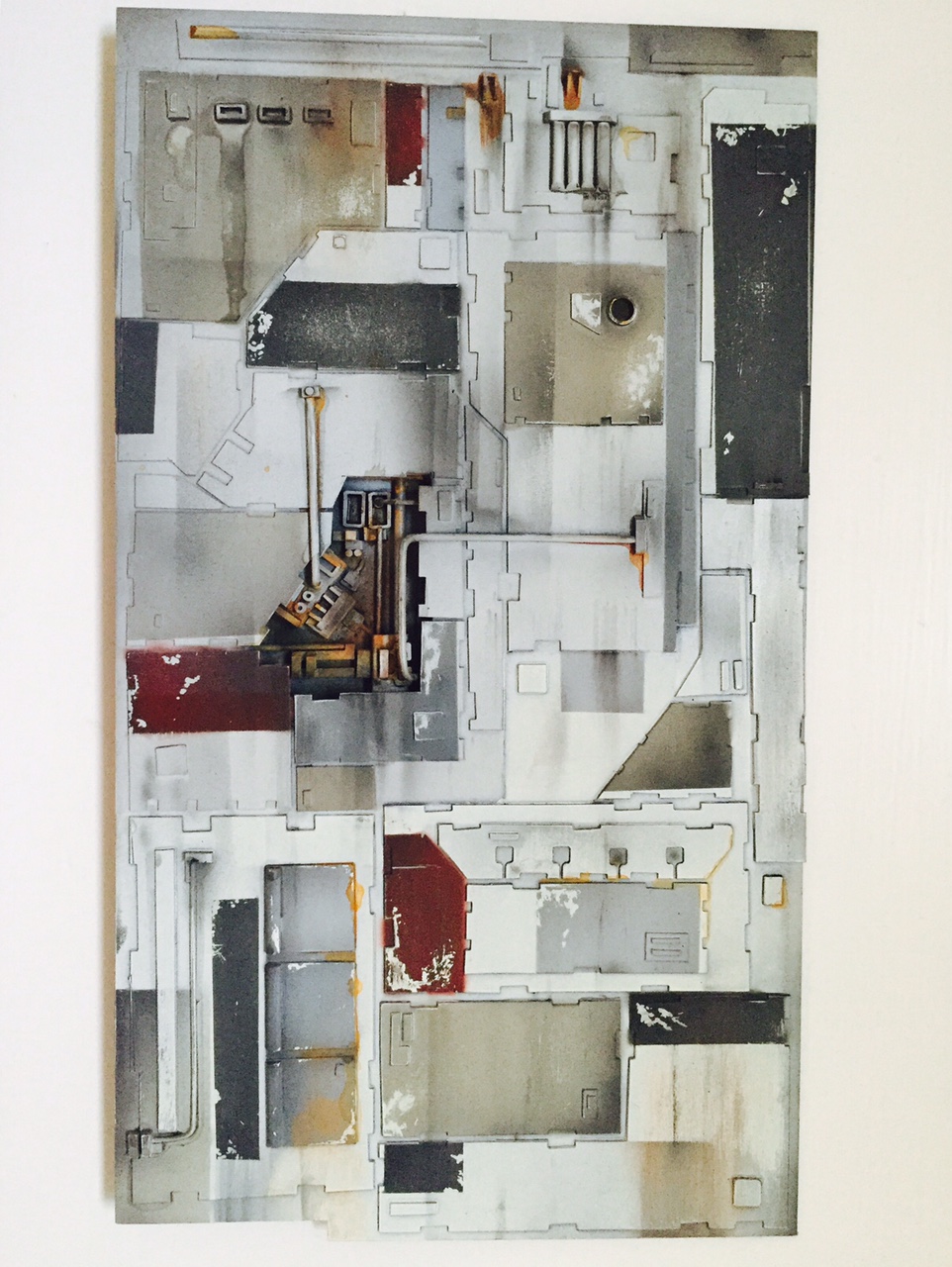

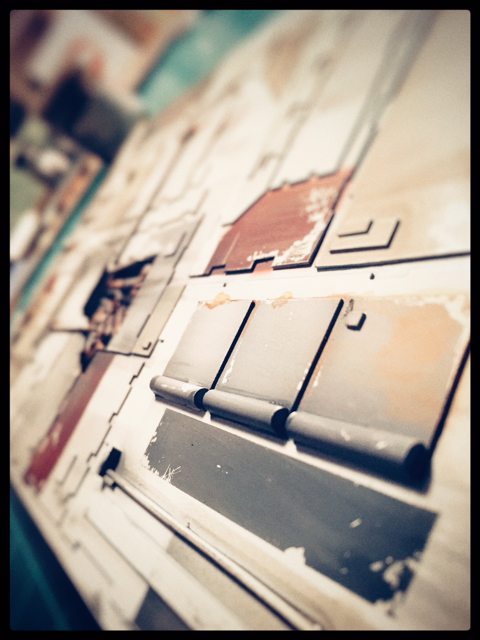

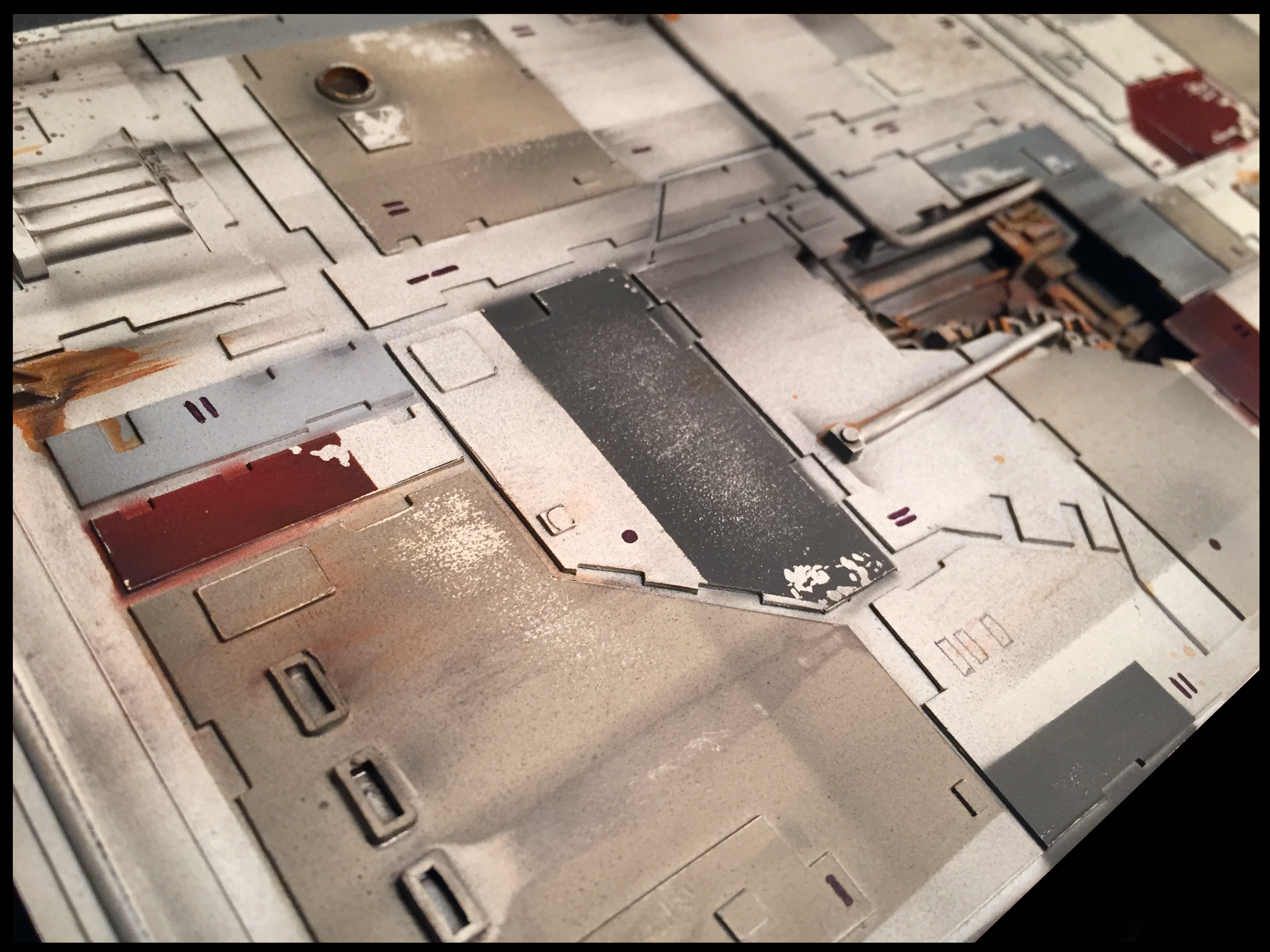

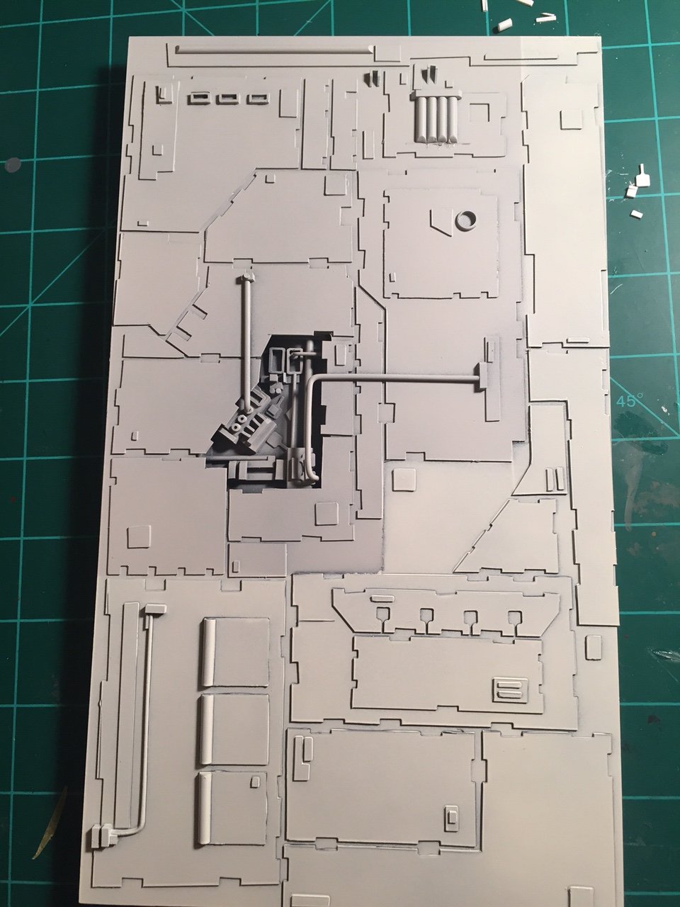

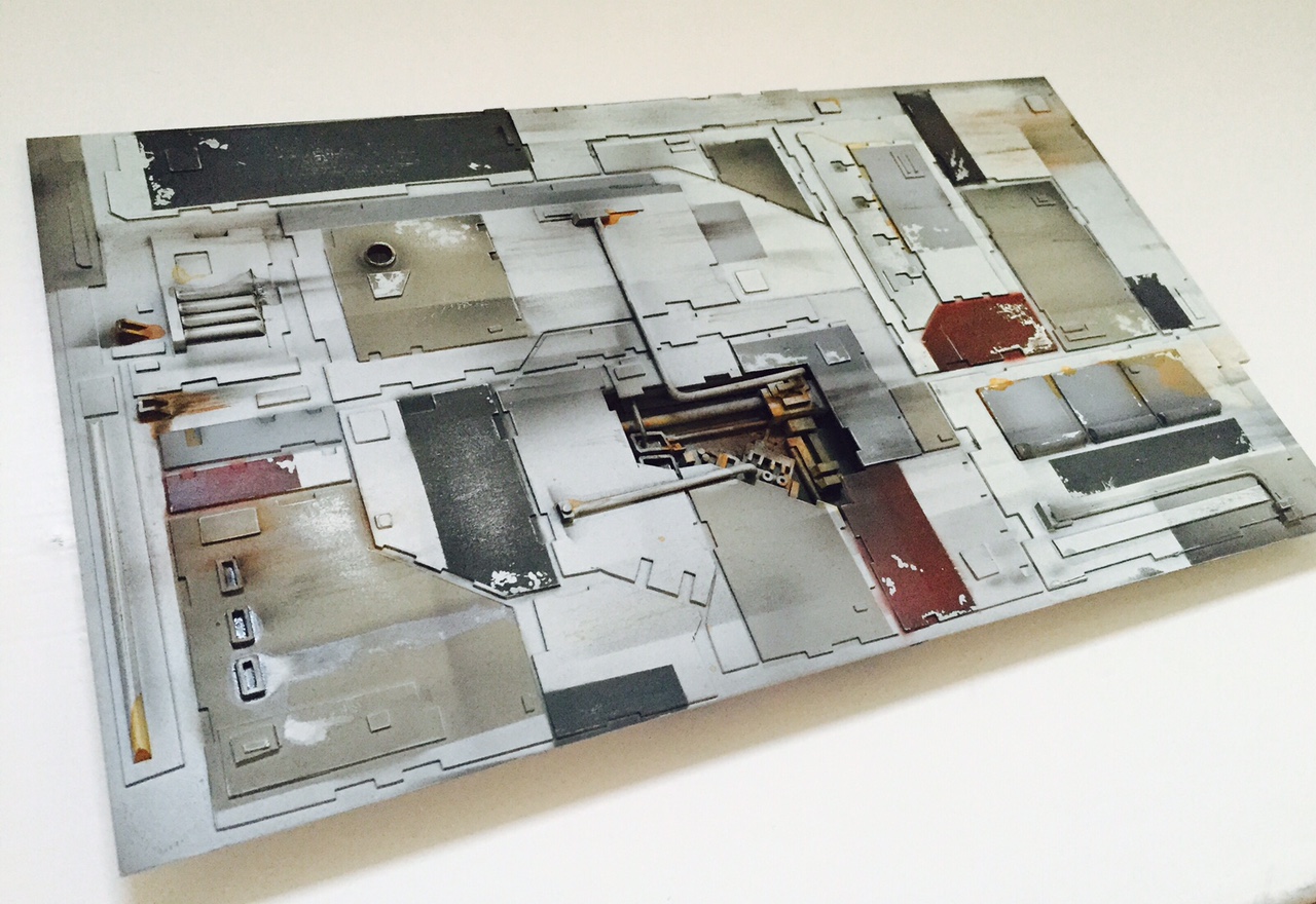

    Built this test piece to practice painting techniques on, was looking to see how much of the base color really comes through once all the other layers of paint and weathering are applied, was surprised how little it mattered, there are some traces of the original base colors cast but not as much as I thought there would be!
    The base colors are painted over black using Tamiya rattle can Insignia white ( the greyer color on the top half) and Racing White( the warmer and brighter color on the bottom half)

    Absolutely brilliant, and a great idea , what other colours did you use ?

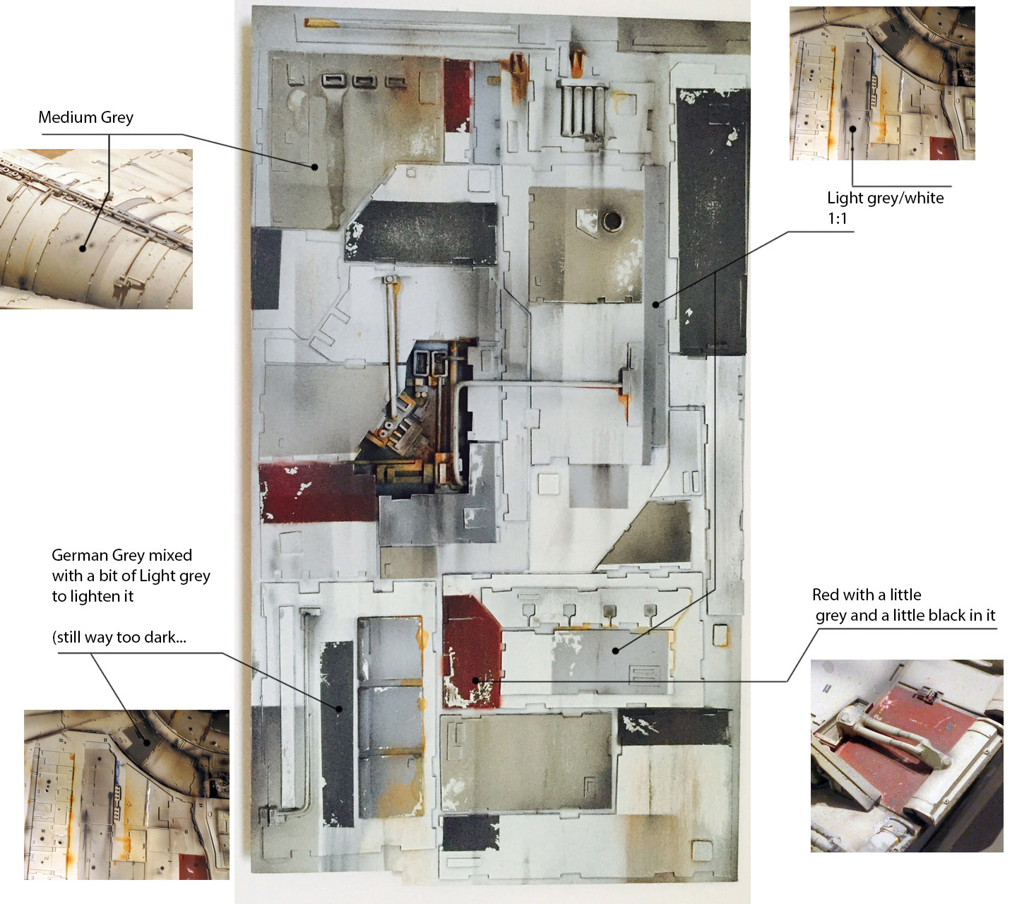

    Thanks!
    Here are colors I used, all tamiya, I need to lighten them all up a bit ( added some ref pics of the colors I'm working off) especially that dark grey and medium grey. The red looks really dark as well, I sprayed the red panels with dark grey first so that the red would not take so long to build up over the white color, I should have gone with light grey so the red would go on brighter... next time!
    all the rust stuff and some of the streaking is a weather power kit, Weather System from Bragdon Enterprises # FF-60

    Great choice going with Tamiya insignia white as the base color, I have the MR Falcon and Tamiya Insignia white is a very close match.

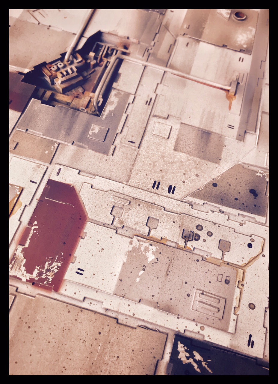

    Added some final paint spatter, and hatch marks. Overall I'm really happy with this test and feel much better about moving on to painting the actual model now! Lots of trial and error and finding out when is too much, like the paint splatter! haha

    Your paint work looks amazing!

    That looks great!!
    Only think I'd suggest is to cover the areas inside the plating notches when masking.

    For a normal, quality job that's the way to go. But apparently ILM, in keeping with the concept of a ragged looking vehicle (and possibly due to lack of time), didn't. So it's more correct in this case to keep it slapdash and rough.

    Treadwell- yeah I really wrestled with that when I started getting into this build, at first I was like wow that's really quick and sloppy looking, I had assumed they were meant to be replaced panels from other colored ships, but then I remembered the line from New Hope where they say something like "the ships markings match the one..." And started thinking that maybe it makes more sense for them to be just markings painted on the ship-at least the really dark grey and red ones- at least that's kinda how I justify it in my mind now! Haha
