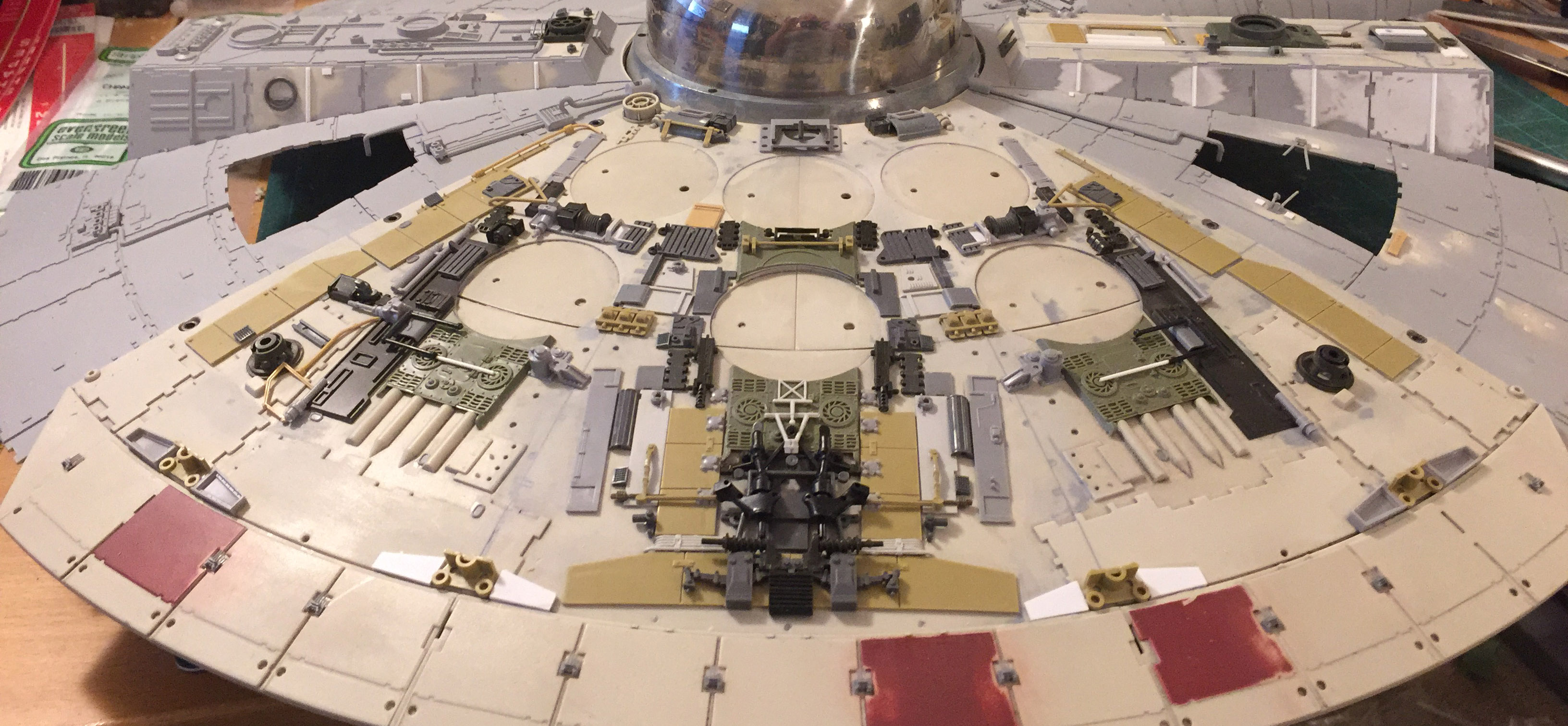

My first build (deago ESB SS Falcon!)
Thanks Kbilly! Means a lot, the maps and scans you guys have been doing are amazing, couldnt do any of this stuff without them!

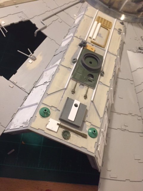

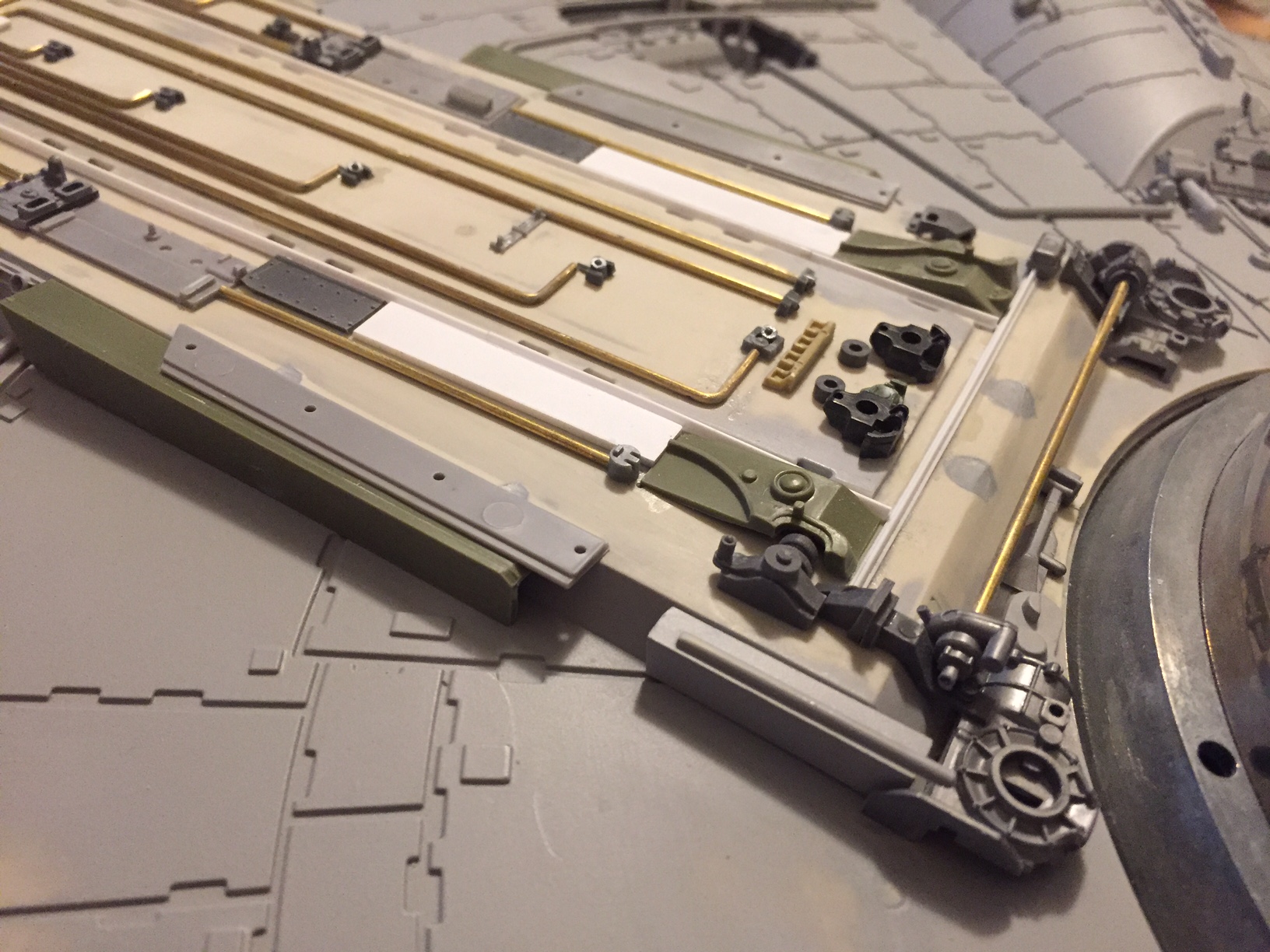

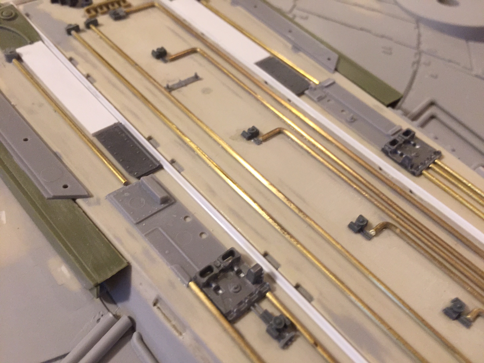

This is the first time I've seen this part of the rear deck being built with all the correct parts. I think it looks awesome, definitely an improvement over what is provided with the model.
Lots more work going on, still have to dig into the port side but soon!

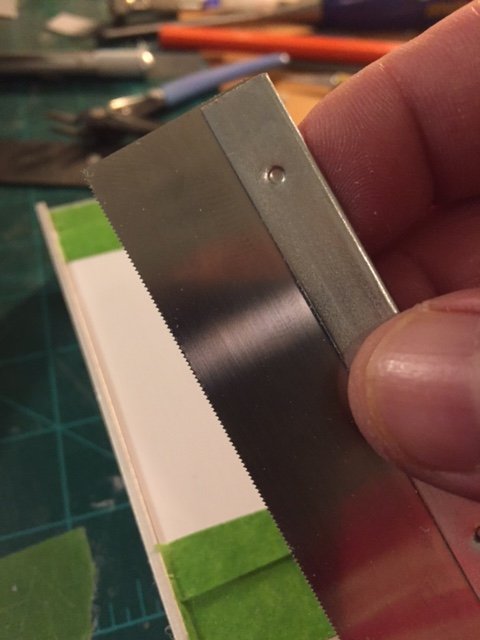

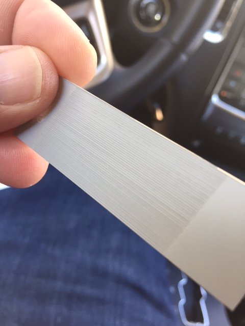

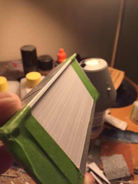

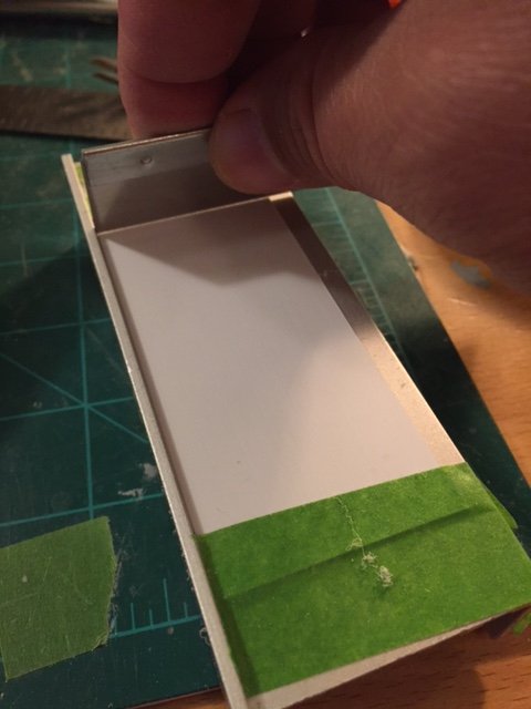

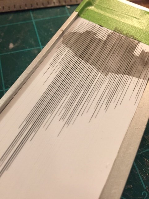

Trying to find a practical way to replicate the scaled down kool shade material for the engine vents. Here I took my sawblade and taped a piece of styrene down to it and used the lip on the miter box as a backstop for the blade so I could make multiple passes and keep the saw teeth lined up in the grooves on each pass. I pretty much worked, of coarse it really depends on the saw blade you use and the tooth spacing. My blade is kinda old so some of the teeth have been knocked back a bit I assume. Perhaps a cleaner result would come from using a new blade? Might try it out and see.
I feel the scale is right, and if I did 5 or so strips I would probably get one that doesn't have any tooth crossover and get really even clean results. The main issue I see with this is adding the 8 vertical strips and making them look correct, I saw some .5mm strip styrene but I feel that is still too thick and would visually overpower the horizontal lines made by the saw blade.
Anyways gonna keep at it a bit more with this and see if it ends up being usable. Promising at least! Would love to hear how anyone else has solved for this.

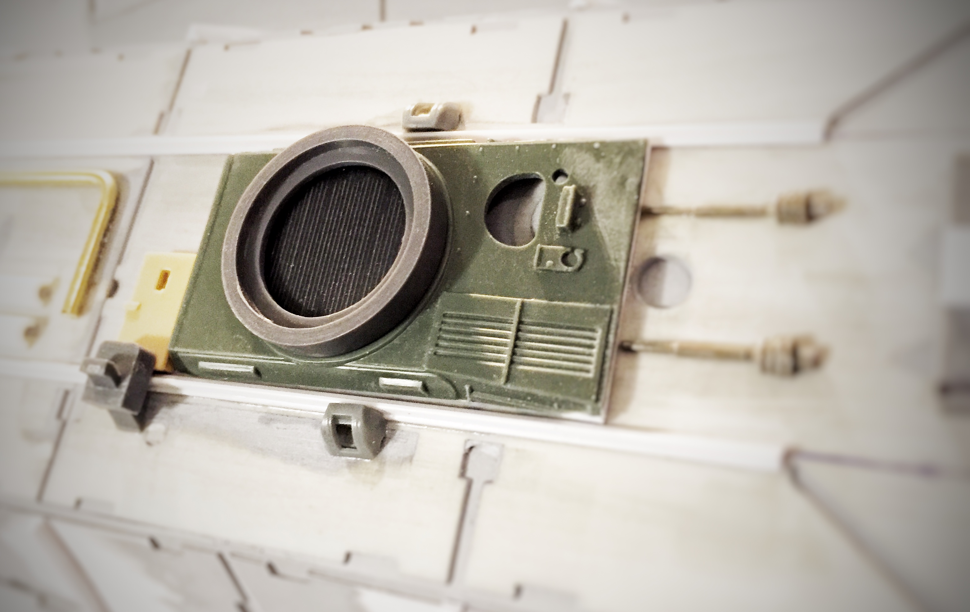

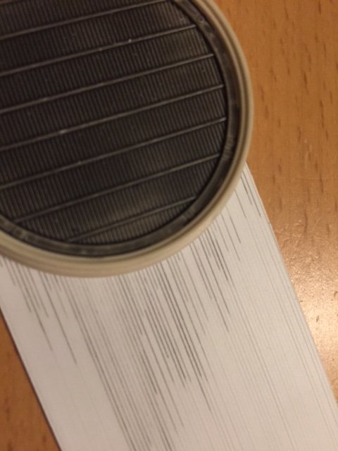

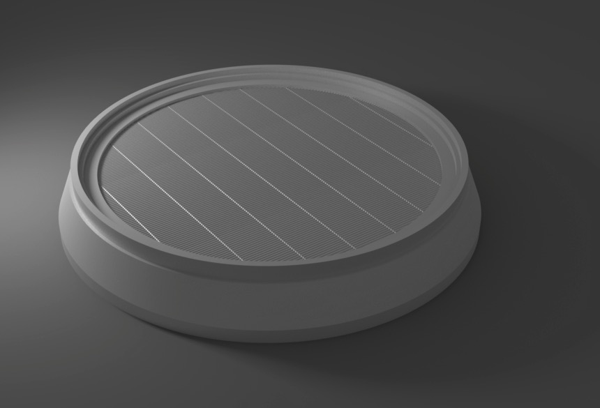

I tried modeling it into a mesh that could be printed but the shapeways site gave me mesh errors on those areas as I guess they were too small, gonna try again with a different modeling technique to get a cleaner mesh, so maybe that could work still.
going to 3D print the rings at least and add the square styrene boxes to them so the detail stays sharp, also I will need to do a bit of sanding on the printed part to get it smooth so I left the little boxes off to make sanding easier.
This is the mesh I made to have printed but the grilling was too fine I guess for the software, It's a bunch of little tubes smashed together so I'm gonna try to model it out as a contiguous surface and see if that helps.

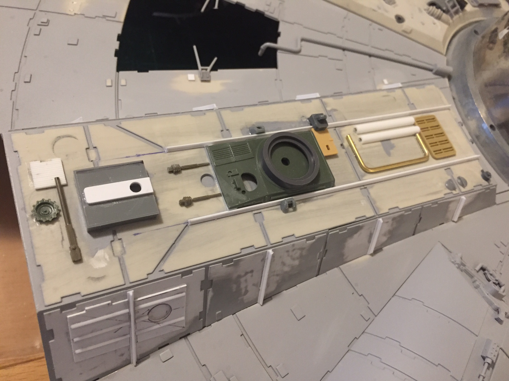

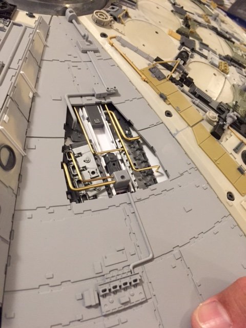

Thanks to Darkview for finding these missing pipe in the rear port pit, they mirror the pipes on the 5' model and must have broken off pretty early, was able to see them though in this pic from the chronical and in a couple from sculpting a galaxy as well once I knew what to look for. Thanks again Darkview, looks rad!
I kinda wish I hadn't terminated that pipe on the right into that empty area, should have put it next to the engine block:/ might redo that. That Empty area bugs me out!! I'm really tempted to put something subtle there, but also have a strong desire to make this accurate...grrrrr
I wouldn't worry or you'll go insane! On the originals as you'll know you look at one thing- and others are wrong on stuff.. end of the day yours will be more exact to the studio than most . . . and be amazing. Always like to think of Han and Chewy doing alterations every port at times that the never ending 100% studio modelling build we'd like that cannot be done... your close tho. ;-).

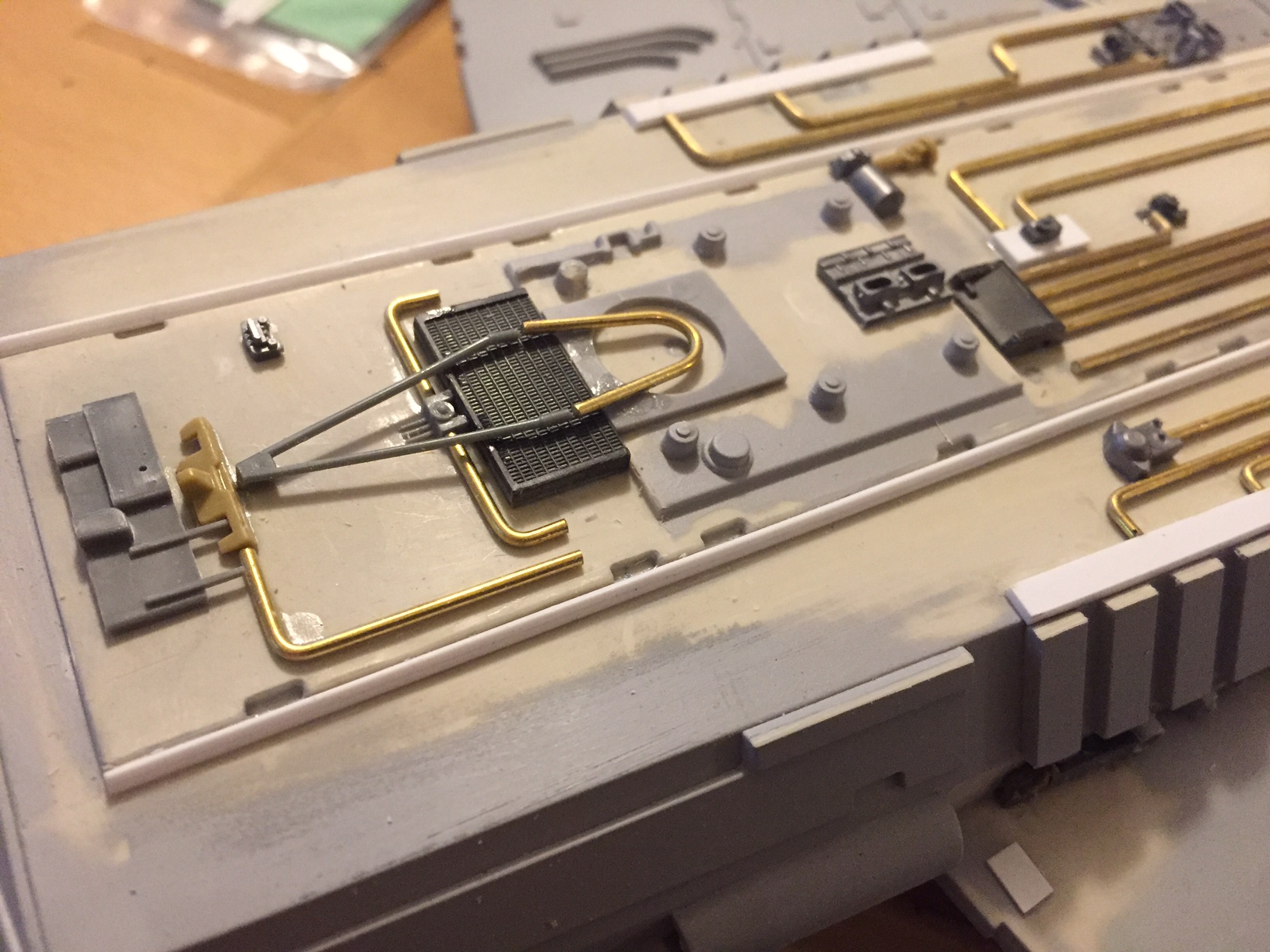

Finally got these guys! Of coarse the tops are too tall and require cutting down, cutting down cylinders and keeping them even is pretty much the hardest thing I have ever had to do - ever..
Incredible job, well done!!
How are you achieving the shaping and bending of your wires to such great standard?
Sent from my SM-G930F using Tapatalk
Thanks Antarh! For bending brass I just use a pair of needle nose pliers, and grip and bend it on the flat part between the serrated needle part and the cutting part in the back, works great and give nice 90% angle bends! For more curved radiuses I just find some cylindrical with the right curve like marker or pen and bend around that.

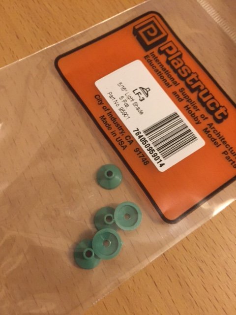

Well, they were cheap, about 5$ direct from the plastruct site, BUT they have a min order of 20$ hah so I got 2 packs(5 in each pack) and some other stuff to round out to 20. So not terrible but kinda par for the coarse with this build haha

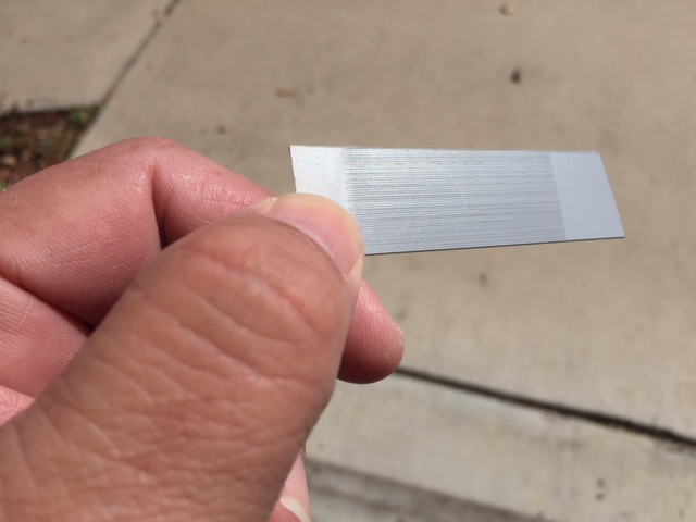

Tried out the saw tooth pattern idea for the grilling on some black styrene, really like the natural and subtle feel at this scale!
