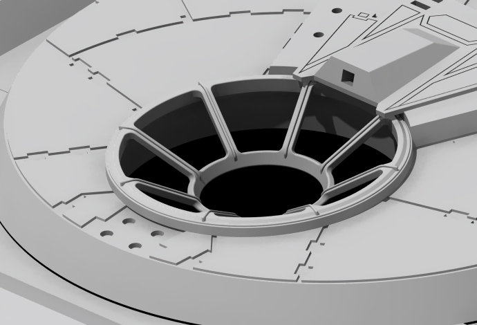

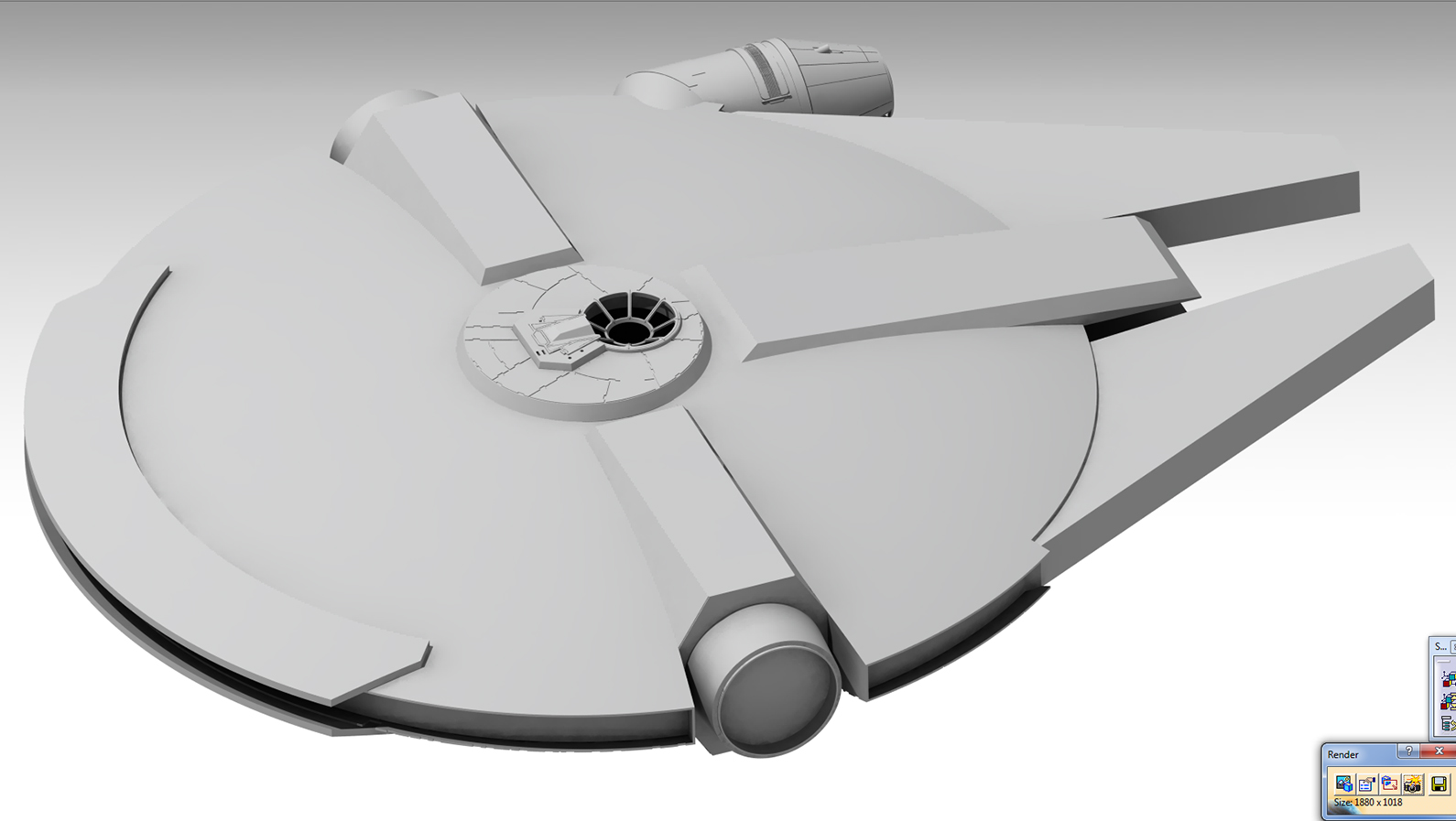

I've almost done with the exterior for now, and will be moving to the full interior soon. The exterior i was making two versions, both bolt on bolt off for the Deagostini frame. One version with hull plating, and the other with hull plating and all the greebies. These are old CAD's now, and i've practically finished them. The blank parts were just place savers, so ignore those.
Worth a note about the nose cone. I drew it at the same time i drew the cockpit tunnel, and everything lines up perfectly as it should with all of the panel lines, and plates and notches.
