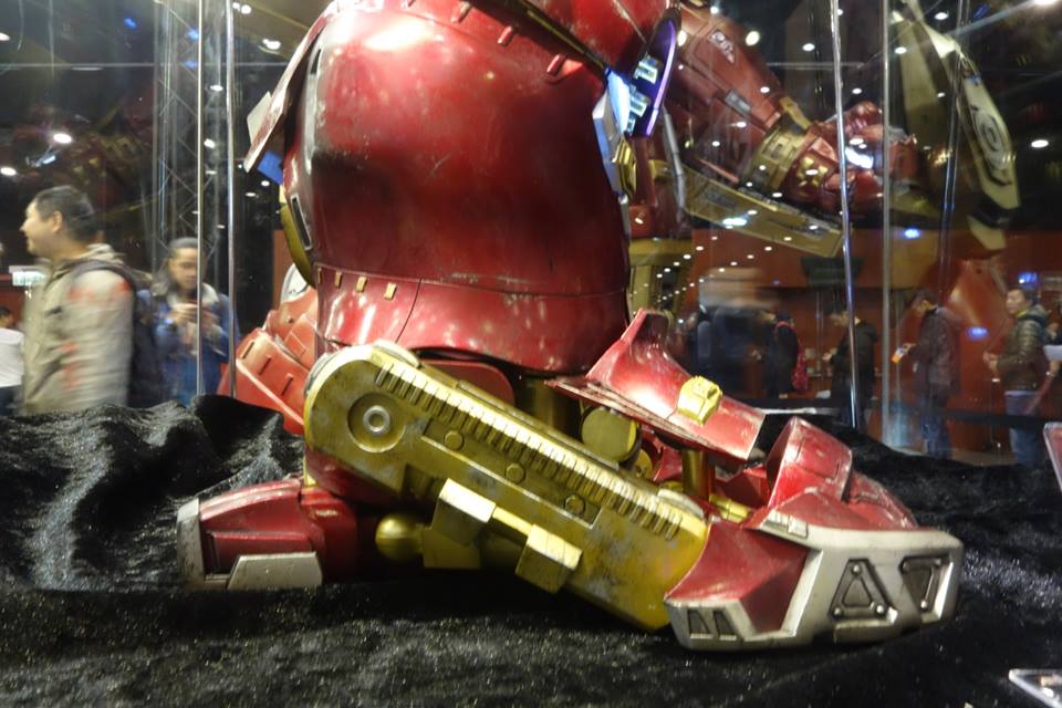

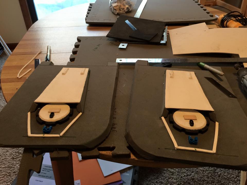

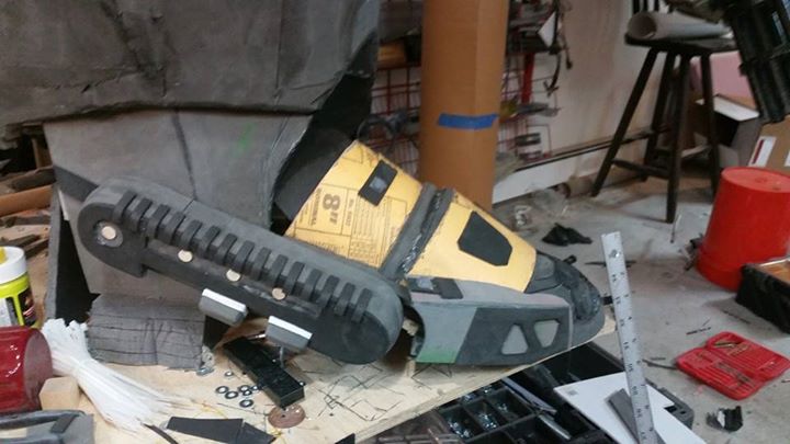

I am starting with the feet. Feet are really hard, and don't get much notice. They will be stepped on, kicked and a poor set will prevent you from taking stairs, or escalators. If they don't flex right, you can tear one off with just a misplaced step. To my joy and frustration, the Avengers model is far more detailed than the comics one, and I am building the movie version. The comics one naturally has less detail since it was hand drawn with lots of smooth curves ( those curves offer some real challenges though), while the movie version has all the endless detail of a CGI monster. The movie feet have rear facing toes as well as needing to flex in the front. This means that my 25 " foot will have to flex well enough in both directions to allow my 9" stilt foot real purchase on a stair when I go up OR down, As I am 245 pounds, this will leave 320 pounds of pressure on each foot as I travel. I have in the past sheered off a set of toes from this exact problem. Here is the start of one of the feet.

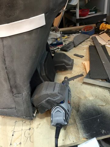

OK, here is some more progress, In the movie version, HB has 2 rear facing toes, both at a 45* angle. I am choosing to have theme rear facing, but with very little angle. This is not an artistic choice, as I step down a stair, the toes will have to fold in to pockets I have carved into the back of the foot. If the toes were at the 45* angle, then they would be far more likely to hook, and tear off. In addition, when swinging my massive ( I mean really massive ) legs back and forth past each other with every step, I felt having a hook sticking out ready to catch/ trip/tear off just seamed like a bad idea. I have also chosen to make them smaller than depicted on the toy, this is to make the logistics of having these rear facing little nightmares a little bit less frustrating. After all, looking straight down will be near impossible, looking straight down, and behind myself is unrealistic. Well, with that small amount of background into the thought process for every inch of this monster, here you go..Toes facing backwards :).

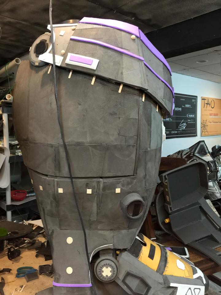

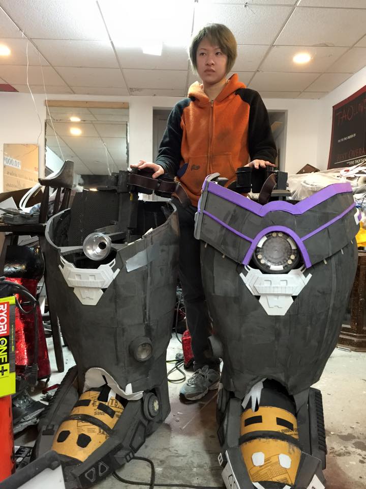

Free hand :) Here is a better shot of the legs I know everybody is looking for files, but I have always just looked, cut and glued. Sorry if I do not have a map for you guys, just the one in my head.

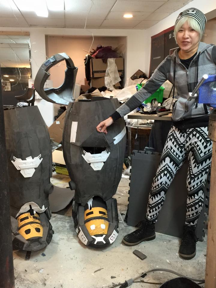

That is Quan, my Apprentice. She is 5'4" while I stand at 6' tall. I cannot stand in my shop with the legs on, it's only 6'6" to the top :)
Murdoch, I'll just kick out hat ceiling and the kitchen above that tomorrow. I think a 900 sq foot shop is not to shabby, but in my next home, there will be a stand alone shop/garage :) Logan, Quan is a very valued member of the team and brings excellent seamstress skills in addition to her foam cutting :) She is currently starting her own first giant robot build and I could not be more proud. Here is a progress shot on the codpiece, estimated waistline 54" :) .... or "Thank god there's finally an IM suit that does not require a 28" waistline "AHB13.jpg
