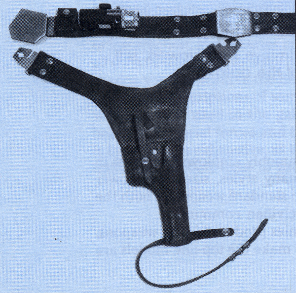

Here are a few other photos that really show how the ANH holster has no stitches on the pouches. I believe each pouch is formed around a block and then attached with rivets. You could sew the bottom of the pouches but you would not be able to sew the sides. The trick is to line up the holes in the back of the pouches to the holes in the belt. There are a few other differences when you compare the ANH holster with the other holsters used in Empire and Jedi. The first is the groove line on the belt and the holster. The second is the placement of the leg strap. In ANH the leg strap is positioned at the bottom of the holster. In the other two movies the leg strap is several inches higher.
Man, I've seen many of these photos kicking around in my searches, but it makes so much difference when they are good quality. Of course, it almost always means I have to go back and change a bunch of stuff, but that is okay. :D

Here is another photo that may help you. You can clearly see how the connecting buckles on the "Y" strap are different! I'm away from my workshop today but I will try and make a few sample pouches tomorrow to help show how I think they were attached to the belt.
Paul
Brilliant thread! I too want to make a full Solo ANH costume. I will be referring back to this when I get to the belt. I'm actually going to start with the clothes first, I want to make them from scratch to fit me. I will do the belt/holster last as it's prob the hardest for me. Great work so far, love the attention to detail.
Paul

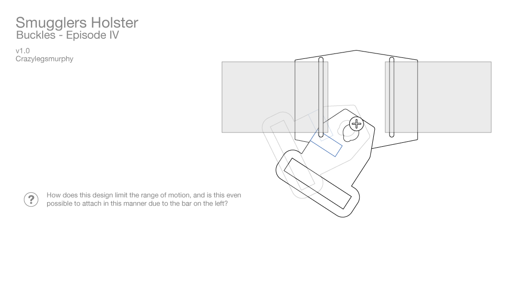

Awww, man!!
That photo has had me pulling my hair out since you posted it.
The photo you posted yesterday prompted me to redesign the ANH "Y" buckles, and they worked perfectly. Now, with this new photo, I am really struggling to figure out how that slit on the left connector, actually works with the buckle and the leather.
If I model the connector as close as I can, the range of swing motion is drastically reduced. It also requires the connector to be slid overtop the bar that holds the leather, before you attach it to the peg. Here, perhaps a photo will make more sense.
As you can see, in order to get even a reasonable range, I had to widen the slit a bit. Of course, it is kinda hard to tell on that photo with the angles and such, and so it could be wider than it seems.
With the slit that wide, that is the maximum range of motion the connecter has. I suppose that (or less) might be perfectly reasonable considering it really doesn't need that much range.
EDIT
Something else that is really bothering me is the layer of these connectors. If you look at it from the back, the order it appears goes.
Buckle - Leather Belt - "Y" Connector
Meaning, more often then not, it appears like the "Y" connector falls closest to the body. The problem is that this design wouldn't really allow for that.
The "Y" connector has to be closest to the buckle, and then the leather on top of it to allow it to freely move around the loop. It seems to shift around in different images, making this really hard to pin down.
Wow ... this certainly changes a lot about the design of ANH vs. ESB/ROTJ ... so I guess my belt and holster are more ESB than ANH due to those stitches on the pockets :wacko

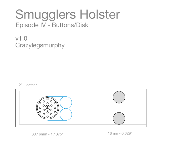

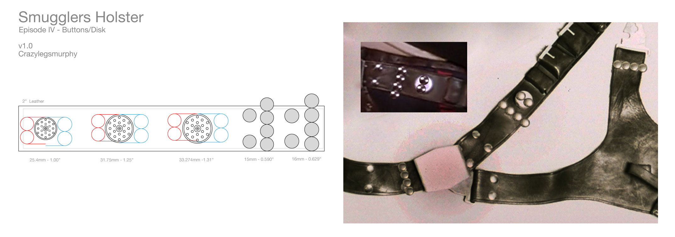

Buttons/Disk - Episode IV
Using a screen cap, and using the image posted by Uncharted Leather, I fired up Photoshop and attempted to once again determine some measurements my duplicating the buttons on multiple parts of the holster.
While this is obviously a crude way of doing this, it does help in that I know the standard diameter of the buttons that are available today, and I don't see them using anything custom in 1977.
So, from there, we can visually see how many "button lengths" things are, if we can determine the button size used.
...here is where things get a little bit wonky.
Butt-on...the-other-hand...
Here is a 100% scale image I just put together. (sorry for the size, but I wanted to make sure we weren't being thrown off by scaling issues).
So, to break this down.
On the left I have added a 2" belt, along with three potential sizes for the "disk". On the left of each disk (Red) are the 15mm - 0.590" buttons. On the right (Blue) are the 16mm - 0.629" buttons.
This allows us to see exactly how the different sized buttons look on different sized disks. Now, lets hop over to the right.
Here are the two images photoshopped using the cloned buttons. This is where my brain starts jumping back and fourth between what I think, and what I think two minutes later.
If I look at the buttons right next to the disk on both images, I would be convinced the buttons are 16mm. However, if I look at other parts of the holster, I am convinced that the buttons are 15mm.
Now, I could go off on a bunch of theories as to why they look different, but if I had to choose, I would say that the buttons next to the disk on both images point...ever so slightly to 16mm buttons.
Disk-covery
If we can agree that the buttons are in fact 16mm - 0.629" then we can turn our attention to the disk itself.
To my eyes, there is no way the disk is 1", or over 1.25". When I look at the buttons on top of the disk, I see that the hight of the disk is slightly less than the width of two buttons.
Here, we have 16mm buttons, compared to a 30.16mm - 1.1875" disk. Looks pretty close, no?

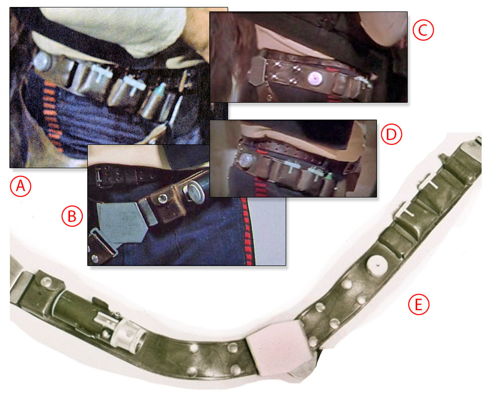

Pouches - Episode IV
The other big question of the day are these ANH pouches. How were they made, how were they attached, and what are the exact details?
I'm going to spend a few moments presenting my hypothesis, with as much evidence as I currently have available.
Leather
It is very hard for me to tell based on the images available, but I am fairly certain that the leather thickness is not the same as the ESB, and ROTJ versions.
The leather in the other movies seems to be somewhere between 5oz (5/64 - 2.0mm) and 6oz (3/32 - 2.4mm). On this version of the holster, I would guess that the leather is between 3oz (3/64 - 1.2mm) and 4oz ( 1/16 - 1.6mm) to 6oz (3/32 - 2.4mm).
The reason is that it doesn't seem to be as stiff as the other holsters, and because where you can see the edges, it doesn't appear to be anywhere near as thick.
We will come back to this in a moment.
Design
In the other two holsters, it is unarguable that each pouch is made up of a separate piece that was shaped, then sewn to the main belt. In this version however, there is evidence to suggest that the pouches were formed out of a single piece of leather, which were formed to shape, then attached. Lets take a look.
In images (C) and (D) it is most apparent that it is a single piece of leather. If you look along the side of each pouch, there are no breaks in the leather. You can also see that there is a continuous line along the top and bottom of the pouches, that connect the next one.
If this is correct, we can leave that for a moment and think about how these were attached.

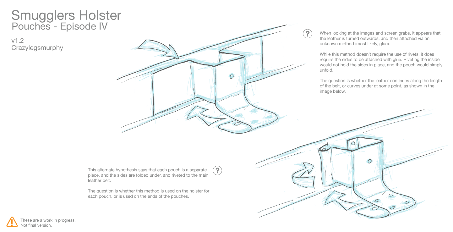

How Riveting!?
It has been suggested that these pouches were formed around a shape, and then riveted to the belt. While I agree with the first part, the second is what has me confused. Lets take a look at a drawing I made.
What I have illustrated are two different ways the pouches could be attached.
The Top/Left image illustrates a single piece of leather, that must be glued to the leather belt below. The reason I say must, is because even if the front flap was fed through the inside, and riveted, the pouch would simply unfold as there is nothing anchoring the sides.
In this case, I suggest that there were no rivets involved, but that the pouches were simply glued to the leather belt.
In the Bottom/Right image, we see the idea that the pouches were separate, and attached by folding the back, and sides under itself, and attaching them via rivets, glue, or thread.

Leather or not?
Here is where I start to question things. At this point, I am personally convinced that the pouches are in fact one long piece of leather, formed around shapes, and glued to the belt.
What I am not convinced of, is what happens at the end of the pouches, and whether the button pouch is the same.
Lets concentrate on the left (looking from the front) pouches for a moment.

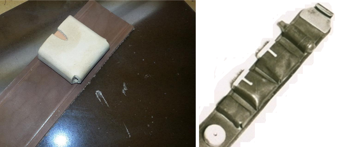

Going back to the images above, if we look at image (C) and (E) and then at the very back pouch we see where my confusion sets in. On (E) it appears as though the leather ends, and curves itself under, attaching like the Bottom/Right image above. However, looking at (C) that defining line seems to not be as pronounced, suggesting that perhaps the leather extends long the entire length of the belt.
I am very much leaning towards it curling under, and ending there, but I'm not 100% convinced.
That said, if we turn our attention to (E) and look at the very front (where the canister greebly is), it does appear that the leather continues under the hook.
Button Pouch.
Here is where things get a little strange. If we look again at images (B) and (E), and focus on the side of the button pouch, it is unclear how it is attached. One could automatically assume it was attached like the Bottom/Right illustration above, but what seems to be missing is the definite line of leather that has been tucked under.
To me, I am unsure if I am looking at the leather folding under the pouch, or outwards along the belt.
The consequence of doing one over the other is fairly significant. If the pouches fold under (Bottom/Right) then we don't have an issue. If however, the leather goes outwards along the belt, we then have to ask ourselves where that leather ends.
That brings me back to what I was talking about at the start. The 1/8 crease in the leather appears on the surface to be made with the same method used on almost all leatherwork. However if we look at the leather at the front and in the middle of the pouches (E) it does look like the crease might be a result of there being leather on top of leather.
The crease along the length of the belt could be due to it being two pieces of leather, or it could be a result of both leather and a crease being present.
Conclusions and Confusions
I think I have most of the questions I had answered. It seems pretty obvious to me there are no stitches, and that these pouches (barring any new information) were made form a single piece, formed, and then glued to the 2" belt underneath.
For me, the questions that still need answering are:
1. Does the leather fold under at the end of the pouches, and both sides of the button pouch, or does it continue along the entire length?
2. Is the crease we are seeing in the belt due to an actual crease, a result of a piece of leather on top of the belt, or both?
3. Does the button pouch extend under the hook, or fold under?
4. What is the exact thickness of the leather?
Extras
While I have your attention, I want to direct your brains towards a few little bits and such that I though worthy of consideration.
- Look at (E) and (B) at the button pouch. Look under the button a little ways. Does anyone see what appears to be a little hole?
- Look at (D) and (E), at the side/top of the disk. Does anyone see what appears to be a "notch"?

The question as to whether it was one piece or multiple pieces of leather seems to be hinging on what is perceived to be the natural color of the leather coming through.
What I would ask is, would the creators have put the entire belt together, then dyed it, or would they have dyed each piece then assembled it? Also, could the natural leather be a result of artificial weathering to give definition, or perhaps light hitting the curve?
Let me back up for a moment...
If we go back to my post above, we can see what we can assume is the same belt, under different lighting conditions. (A), (B) and the photos you've posted above were taken under studio lights, as costume test, or publicity photos. In those images we see the result of high powered lights bouncing off the different parts of the leather. Look along the top of the belt, or the curve on the "Y" shaped piece.
Now, look at (C) and (D). We still see light bounce, but because it is in a larger, more "uncontrolled" studio set, the once defined and seeming natural leather color is still there, but now, to me anyway, it appears as though there are subtle curves in the leather between the pouches.
Especially in (D) between the two larger pouches, I am not seeing a line or any indication of a fold. After the second large pouch, I am almost totally convinced that the leather curves and then is continuous.
All that said, the question is whether we can actually solve this based on the photos we have available? These ever-changing, grainy, inconsistently lit photos may simply not be adequate, to make a definitive decision.
So, what does that mean for the pattern?
What I am thinking is that I am going to add in two versions. One, using a single piece, and one using separate pouches. I will make a note of the differences of opinion, and allow everyone to decide for themselves what is the more accurate method. When, and if more information becomes available, I will update the pattern with the new information.
Other than that, I'm not entirely sure how to solve this mystery.

-- Button Pouch Size --
I realized the other day that the button pouch does not appear to be the same width or depth as the other pouches. This was my fault as I assumed they were, which I really need to make a better effort to avoid.
Ideally, what would be of huge help is if you have time, take a look at all three versions and send me a PM with your results for what you feel the width and depth are.
The reason I ask that you send me a PM is that I would like to see what everyone comes to without being persuaded by others in this post. I will post everyones results after, but I would like to see how close everyone comes to what I have determined If we all independently come up with similar measurements, then we can assume we're probably pretty close.
