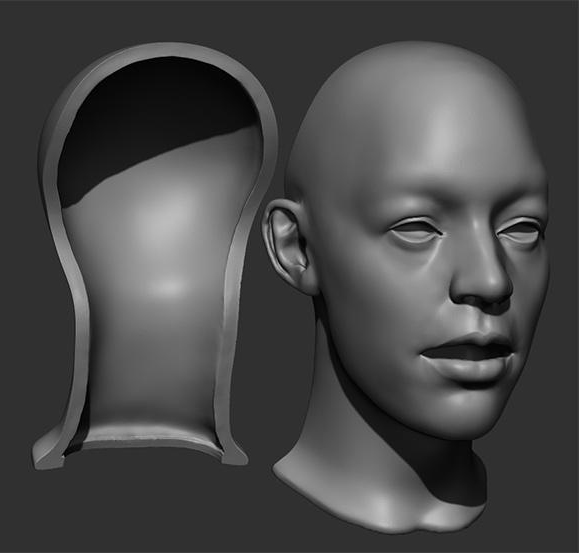

As requested. It's a typical female head, but the front and back were separated for carving then would be glued back together as this would be easier since the inside of the head needs to be hollow to accommodate my hand. Thanks.
Ah, I see. Well I don't know if this is the "best method" for salvaging your time and effort, but it "should" work.
1: Ask the CNC dept to carve this head from the harder foam their machines can handle.
2: Take foam head and cover it with a very thin layer of oil based clay, or a smoothing hardener like Smooth-Ons Epsilon.
3: Cover head in silicone.
4: Make a "mother mold" around the head.
5: Remove head from silicone sleeve and reapply it inside the mother mold.
6: Slush cast the mold using a self skinning foam like Flex Foam iT 17 from Smooth-On (or something similar)
You should now have exactly what you need. I think that is how I would solve this problem. Hope this helps, or at least points you in a right direction.

I am sure you could get someone here on the RPF to take that commission. You would however need to supply them with this laser milled head first. It would have been cheaper, easier and faster to have had a sculptor model this for you first from clay.
A laser wont work for this unfortunately. A CNC would work fine as long as they have a 5 axis machine(you may get away with 4 axis but will have a lot of post work to do). Maybe speak to another company, it sounds like this one doesn't want the job.
Maybe ask hdtheater if he can take on the job.
To carve this with a CNC out of foam it would need to be a rigid enough foam for the CNC to carve it. If it is flexible then the CNC will not make an accurate carve and the material would most likely get wrapped around the bit.
I would take the model and slice it into 1" slices and hollow out the center for your hand(unless the model already has it.) For the pieces that need to be flexible, as the previous poster said, make molds and cast out of a flexible material.
