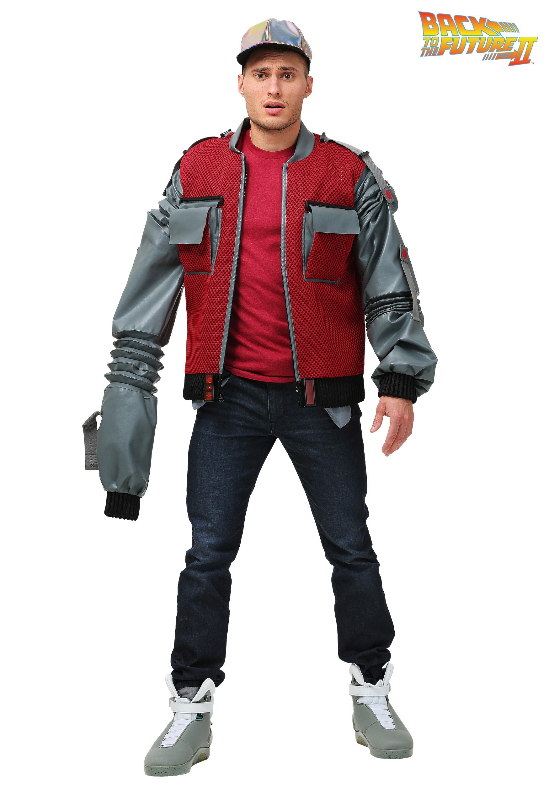

Looks like HC has a new jacket coming out soon.
Lists at $189, available Aug 26th.
http://www.halloweencostumes.com/authentic-marty-mcfly-jacket.html
Certainly has the some interesting details. Pockets-flaps look like they can be adjusted for length. And is definitely a step above the other jacket. But the body looks like drawer-liner material, which is a strange choice.
I might have to seriously consider this thing.

Hey, what do you think about these sleeves?

Sleeves are good, a bit shiny but good. The jacket is not screen accuarate, but is pretty cool none the less.
None of the factories get the body right. It's always something or another. The body on this one still isn't quite a varsity-style cut like it should be. The waist is a few inches too long.
But this jacket is several steps ahead of many other factory jackets I've seen.
It is about the belt thickness too long. I don't think that vest is anti slip mat you find in a cheap store. Even though it is not screen accurate, it does look futuristic and works well for this.
