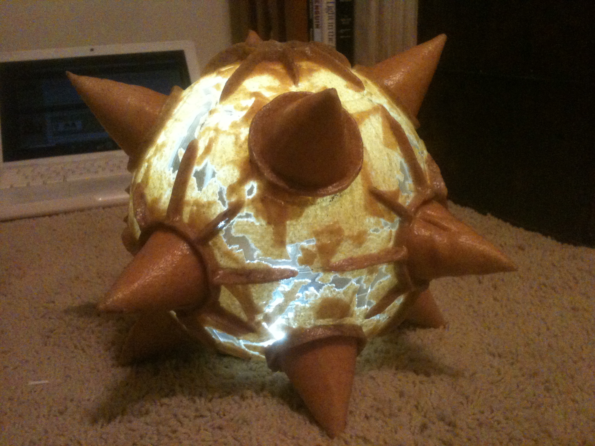

Thanks guys! Finally finished up with the detailing, except that I have yet to make the spiked belt or shoe armor. Blah, some other day. Becaaauuse: my awesome little lighting gadget came in! And it's freaking fantastic. It has ~a dozen flash patterns, and variable speeds for each. Videos of my favorites below.

Unfortunately, the LED is a bit wimpy, so I'll likely be shooting you a PM this week, Canobi!

I definitely like the LED lights light up inside the weapon,but like you said: it needs a little bit more power.
Good luck with the power-up! It's getting there! ;)

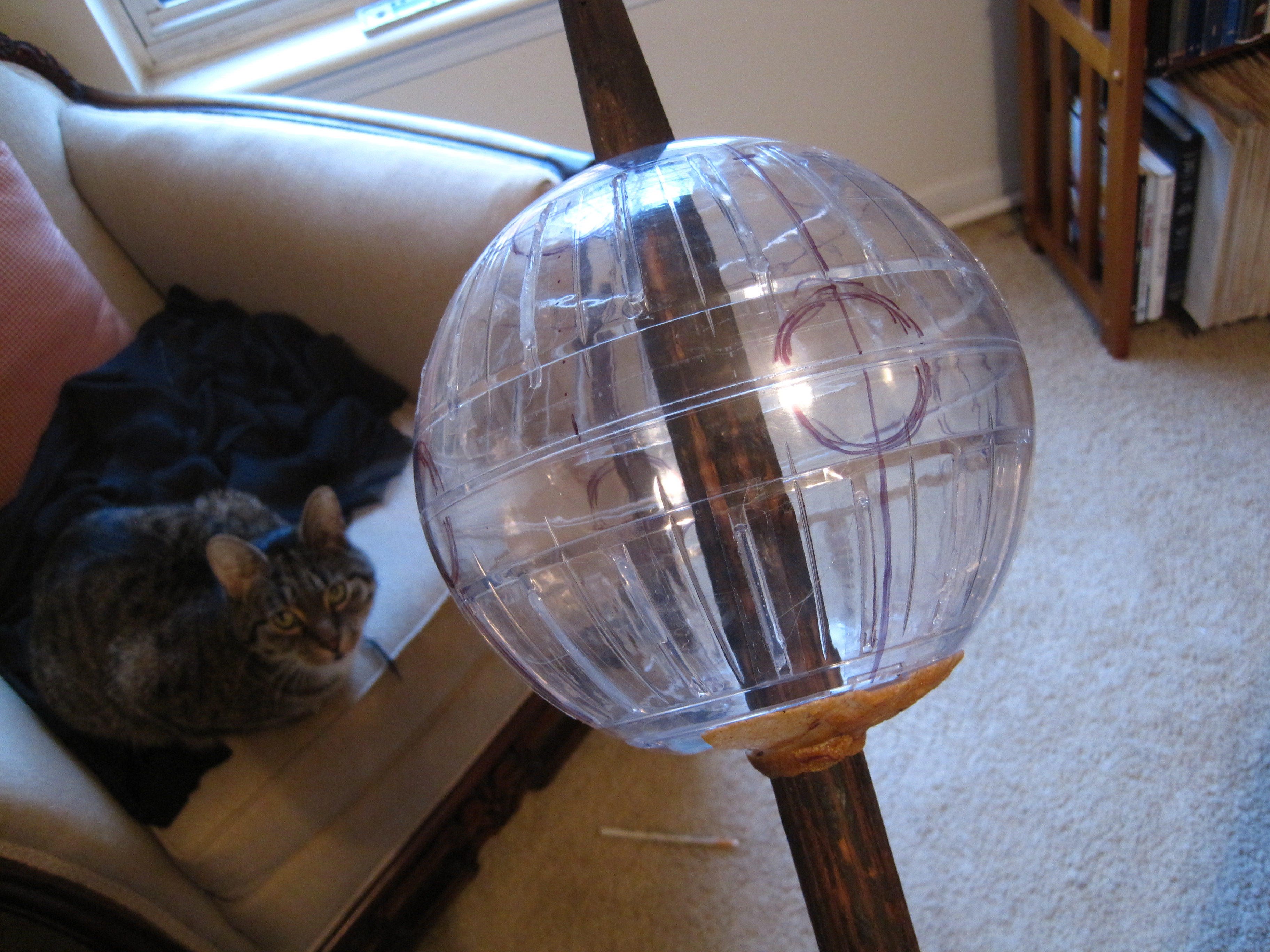

I have a few questions for you, hope you don't mind:
What diameter is the handle?
How is it attached to the ball?
How do you feel about using lithium batteries?
I have loads of tubing in various materials and diameters that I collect for making sabers and Nerf gun mods, some of which I can't use for either but would make a decent handle that's hollow. I could easily knock up an integrated system for the LED, module and batteries for next to nothing, plus I need an excuse to use them up anyway as I hate throwing potentially useful things away.
That would be great!
---Diameter is ~1 inch: your standard rake handle.
---Attachment is a bit of a wibbly-wobbly, jerry-rigged sort of job. The spike/end of the rod floats through a hole on the top of the mace head, and the bottom of the ball is a 3" lid which the handle runs through, attached with the Worbla material. (The ball twists off and removes completely, leaving only the "lid" attached to the handle).
IMG_5758.JPG photo(3).JPG (ball without handle)
---As far as lithium goes, sounds like a nice long battery life!
I previously had plans to remove the majority of the handle that runs through the ball and replace it with clear tubing, in which I would seat the LED for central lighting. However, I'm liking the idea of replacing the entire wooden rod with a hollow one, then integrate the switch into the handle. PM'd!

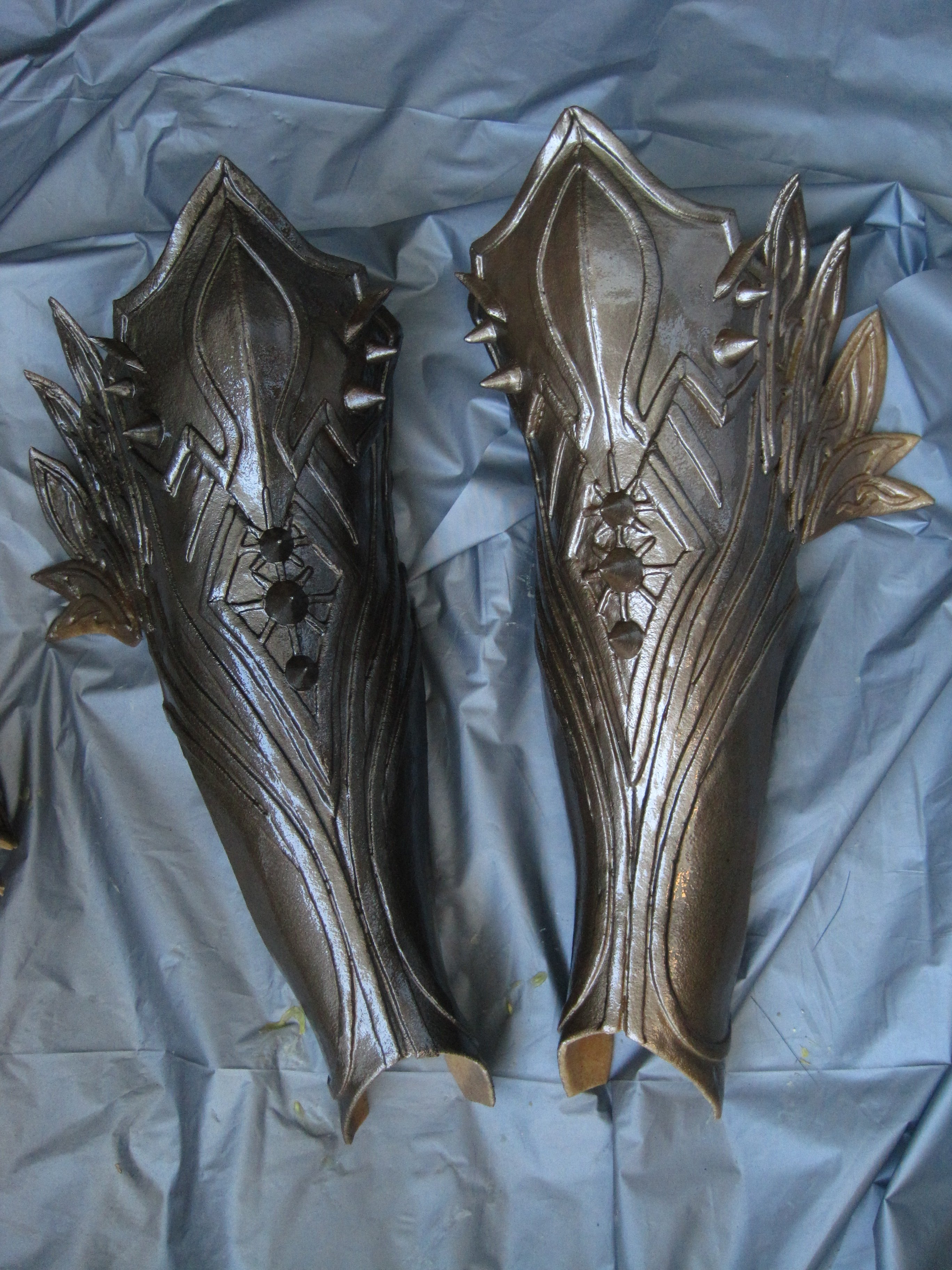

Slowly! The freezing weather is keeping me from spray-painting the armor - or from going to the hardware store, apparently... the tent poles I'm using for the wings are made of a heavy-duty aluminum alloy that I need a better drill bit to get through.

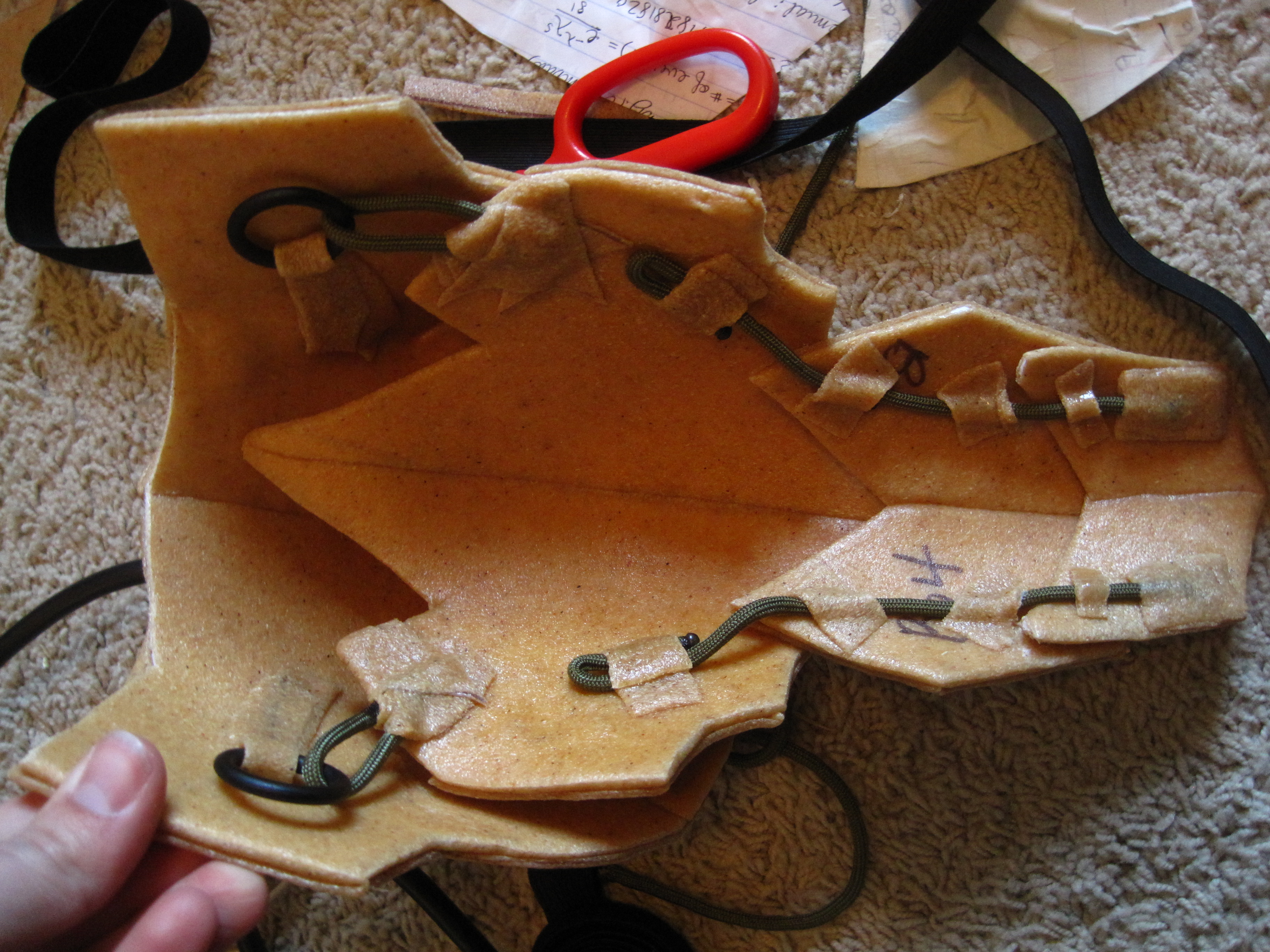

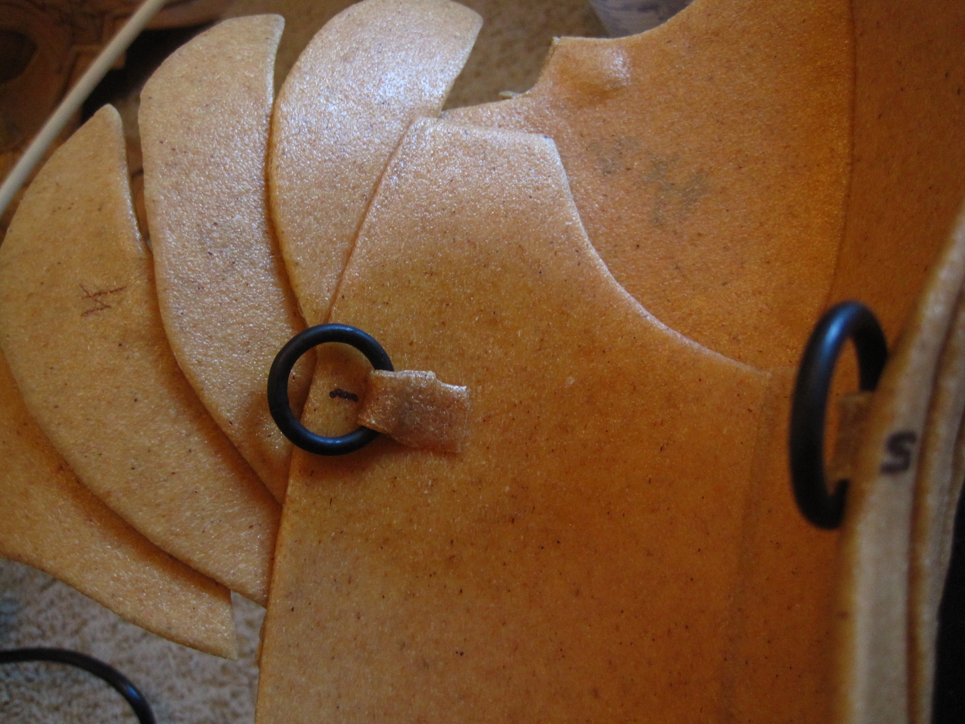

I did put some attachments on the armor today, using some inexpensive, metal O-rings from an army surplus store.
They're fixed with a double-thick strip of Worbla, looped over and heated.
For the pauldron, I wanted a flexible, tiered effect; so each piece is attached to the next with a long runner of paracord, held down with strips of Worbla.

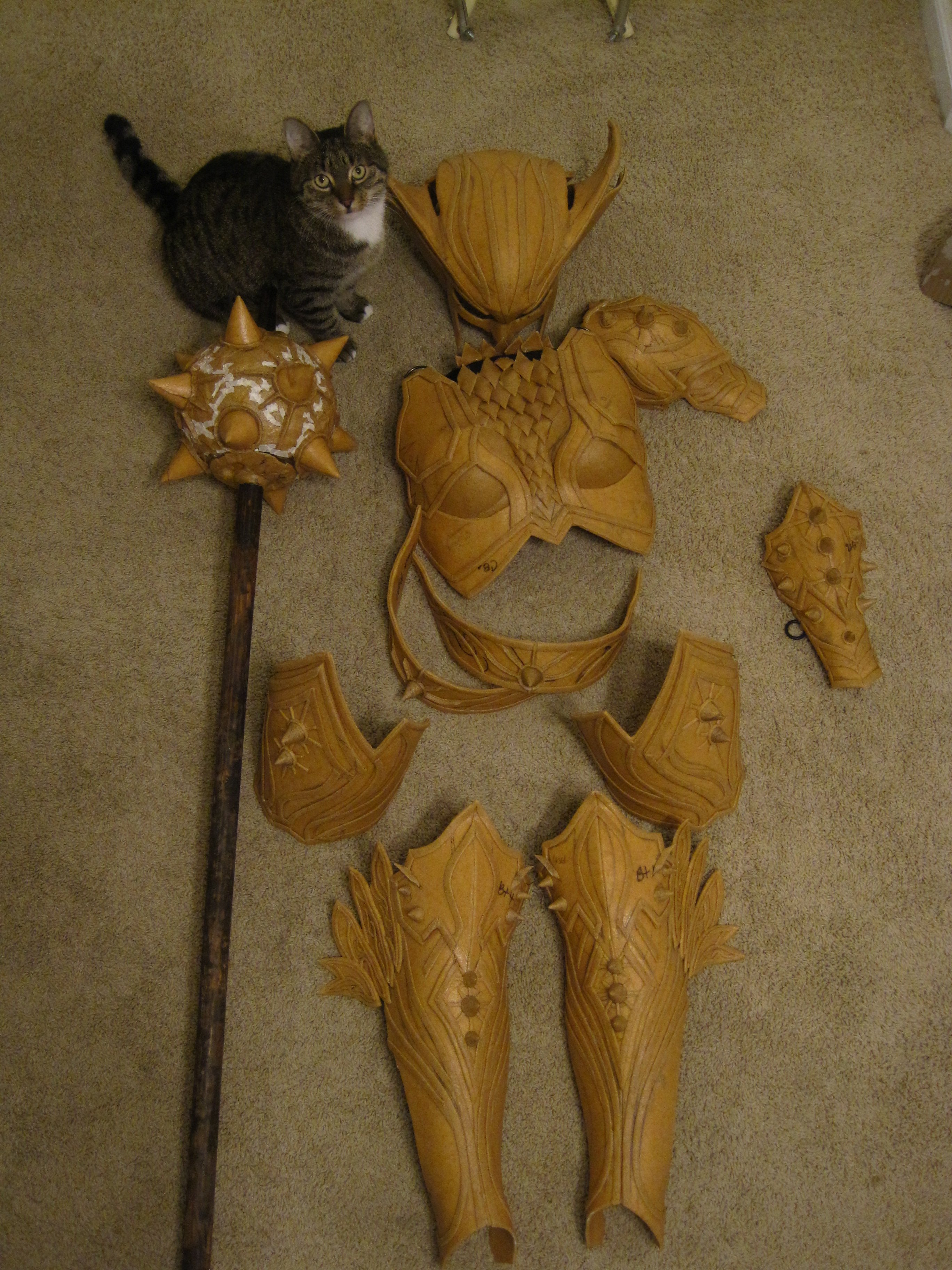

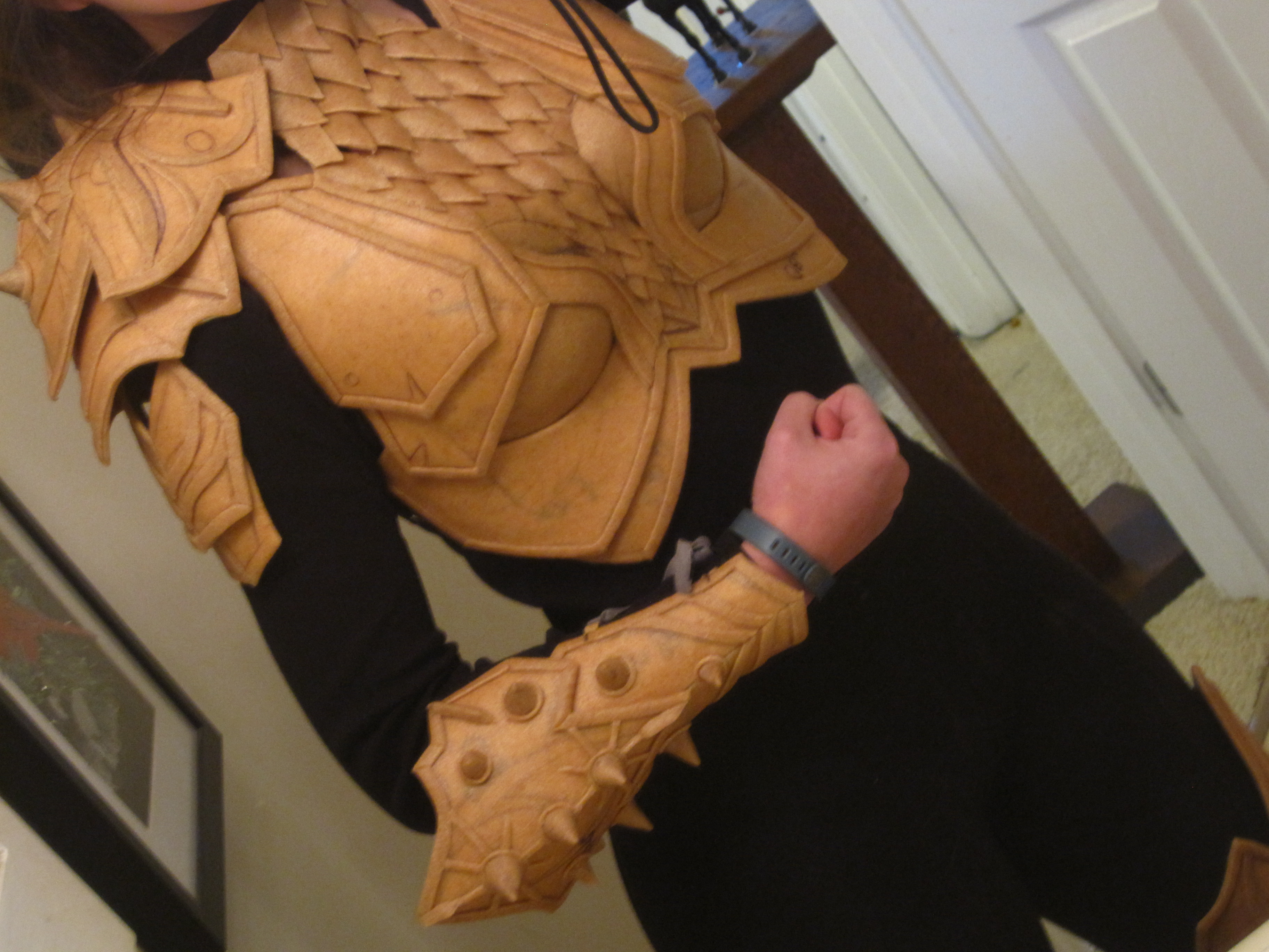

How it's coming along:
To get the full costume requires some awkward, standing-on-a-chair, bathroom-mirror camera work, so we'll skip that for now. The breastplate needs a bit of reshaping, but otherwise, the armor is ready for priming with woodglue, and ultimately paint!
The plan is to use a bronze, hammered finish spray, with gold detailing. The lower legs will be a red enamel + gold.

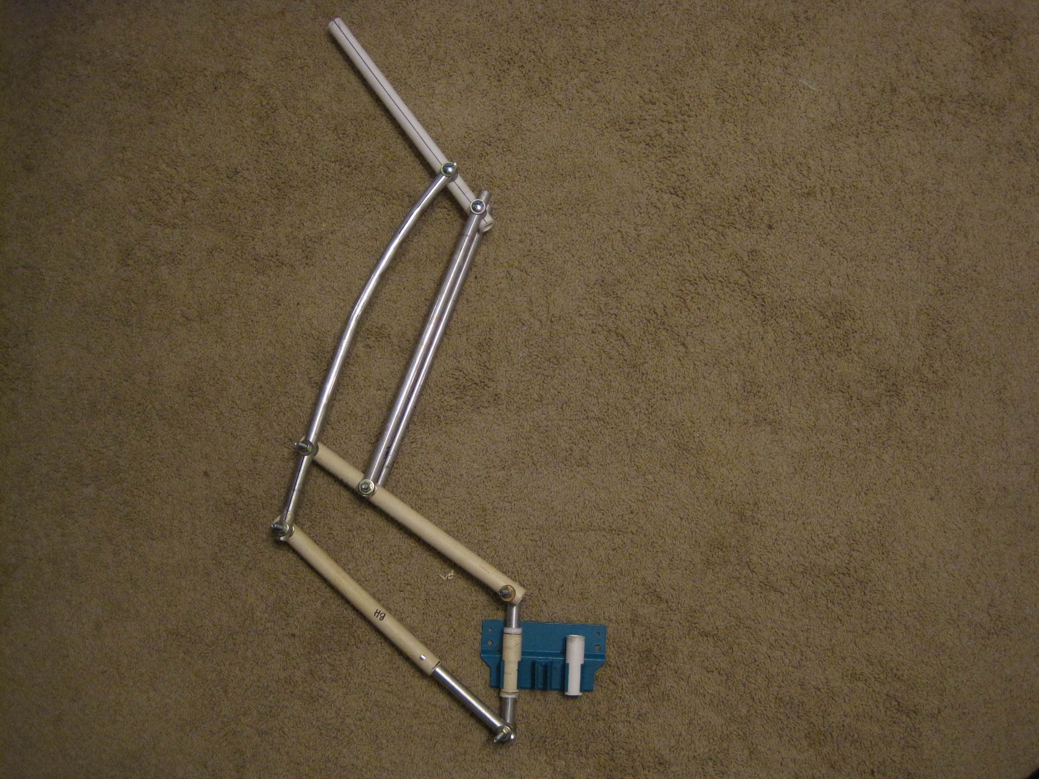

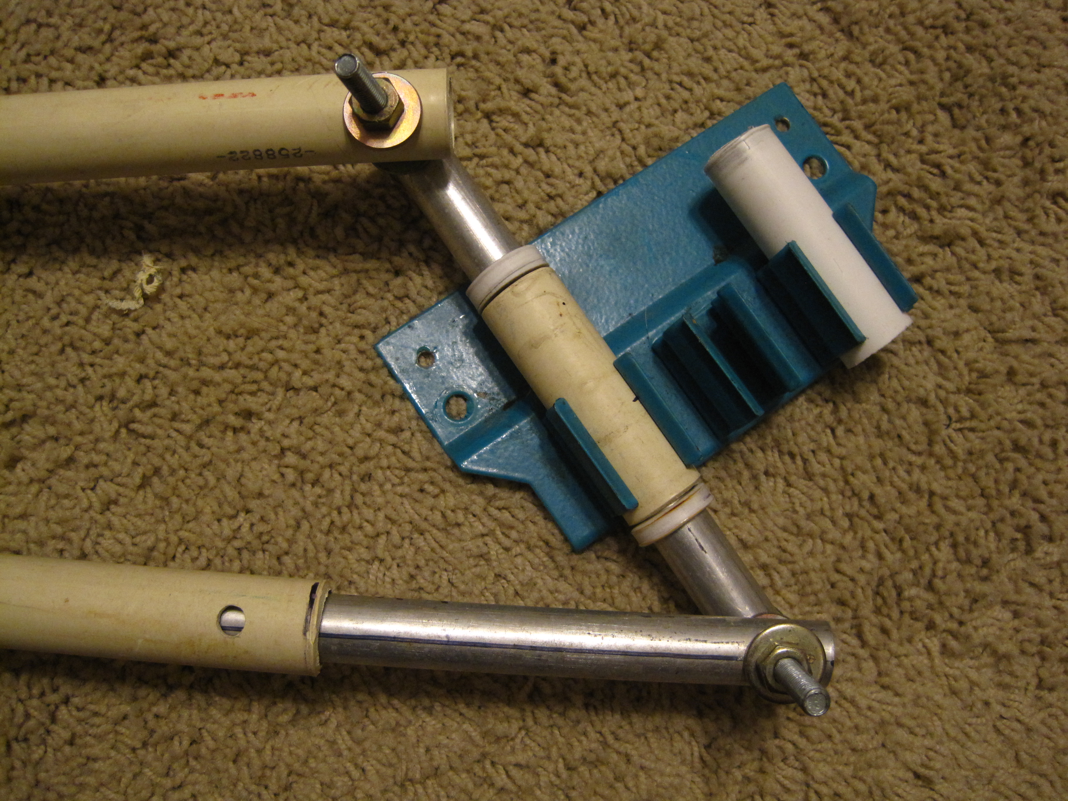

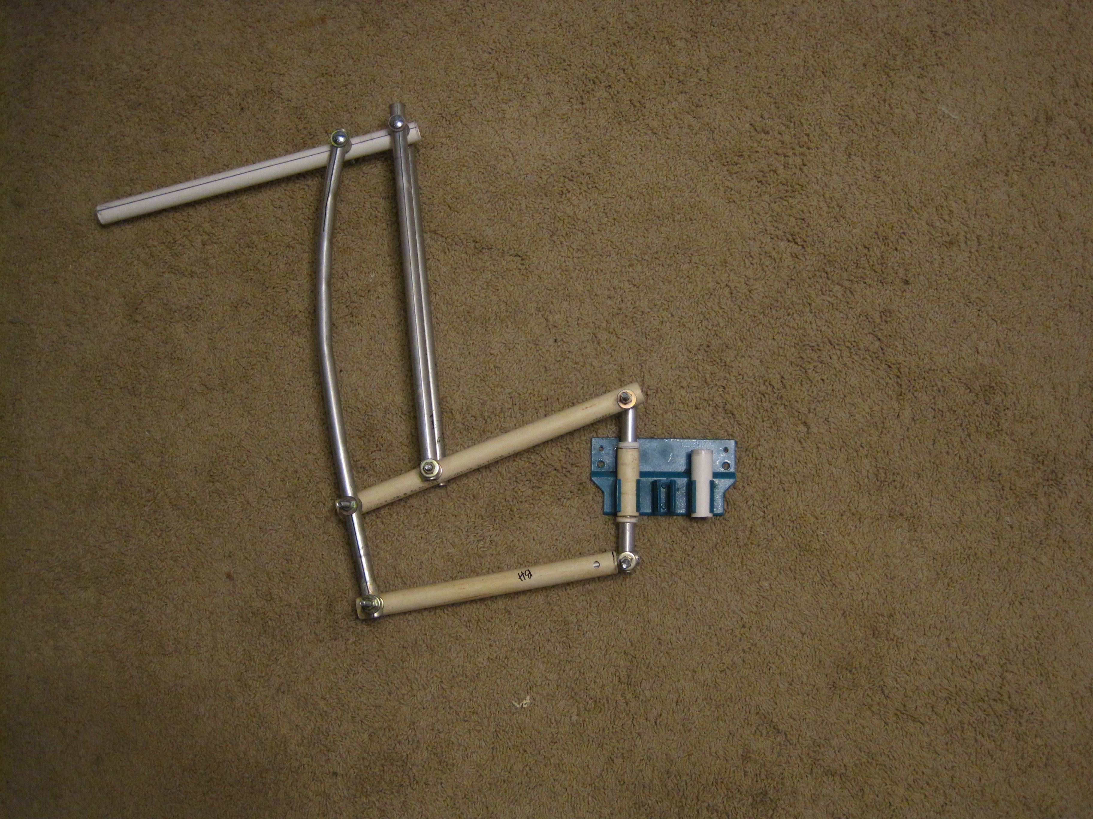

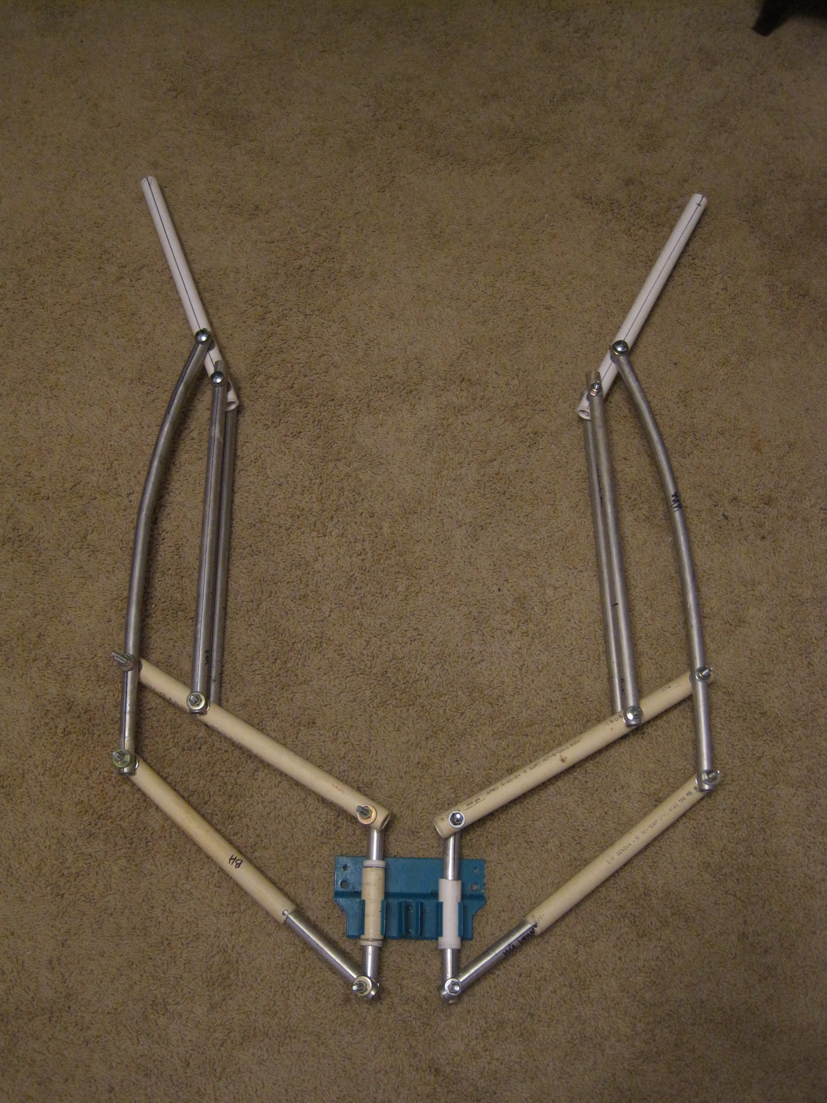

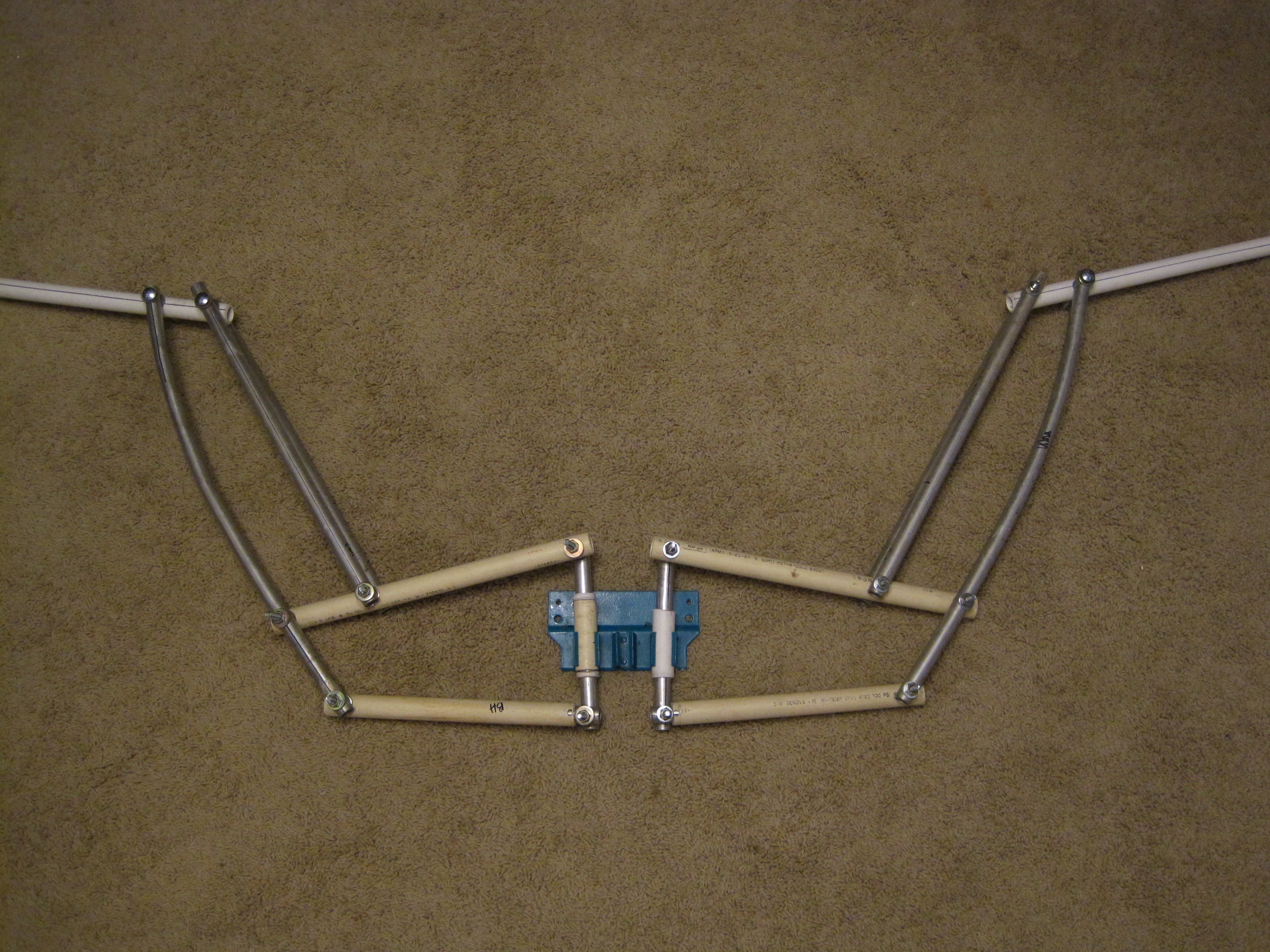

SO, I finally managed some wing progress! Which was quickly cut short by the fact that I ran out of bolts/hardware/etc. So, I have most of the the base of one wing so far, and only need bolts/washers for the other half.
I added a "telescoping" extender inside the bottom tube to allow the wings to reach up and towards each other, because I really like upward-reaching wing designs (I'll add a string inside to keep it from over-extending). I don't know how to make them keep this position when I want, but that's a problem for another day.
The blue clip/panel/thing is just something I scavenged from the trash at work, but does a decent job as a fixture. The horizontal attachment does swivel freely, which I'm going to try out, though I might make it fixed or attach a spring. Undecided. We'll see.

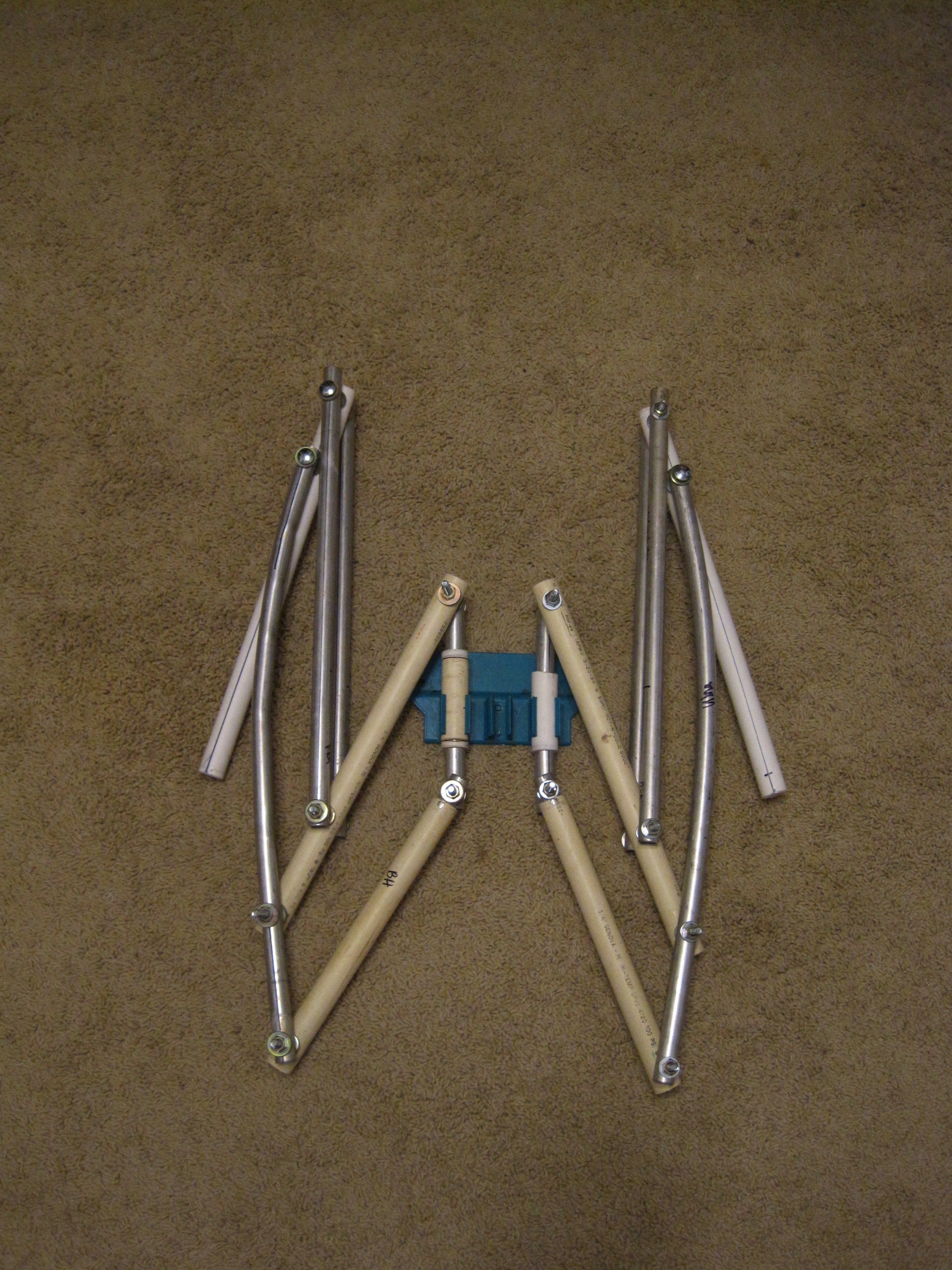

Made a bit of progress on the wings, tonight (please ignore picture orientation). Annoyingly, they ended up a bit asymmetrical, but after the feathers go on, that shouldn't be too noticeable.

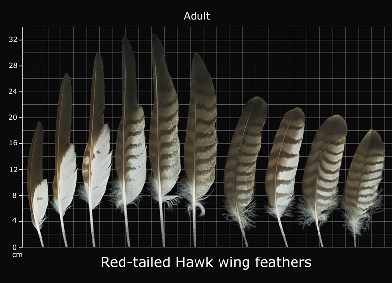

The feathers will be two layers of fabric sandwiched over a wire shaft and saturated with adhesive. I will likely use an old, white bedsheet and galvanized fencing wire, both of which I have on hand, to keep the costs down.
For the pattern/design, I'm shooting for a red-tailed hawk:
attachment.php
That image is from The Feather Atlas, which is an awesome library of feather scans by the USFWS.

The wing exoskeleton looks ingenious,however I wonder how you should place the feathers,since every section is morphing after the wings (un)fold?
Great job so far,Spring! :thumbsup
The feather placement is definitely going to be tricky. I'll do it a lot like my last pair of wings, where each feather overlaps the next, folding/unfolding like a fan. Still working on how to attach them to the frame to work like that!

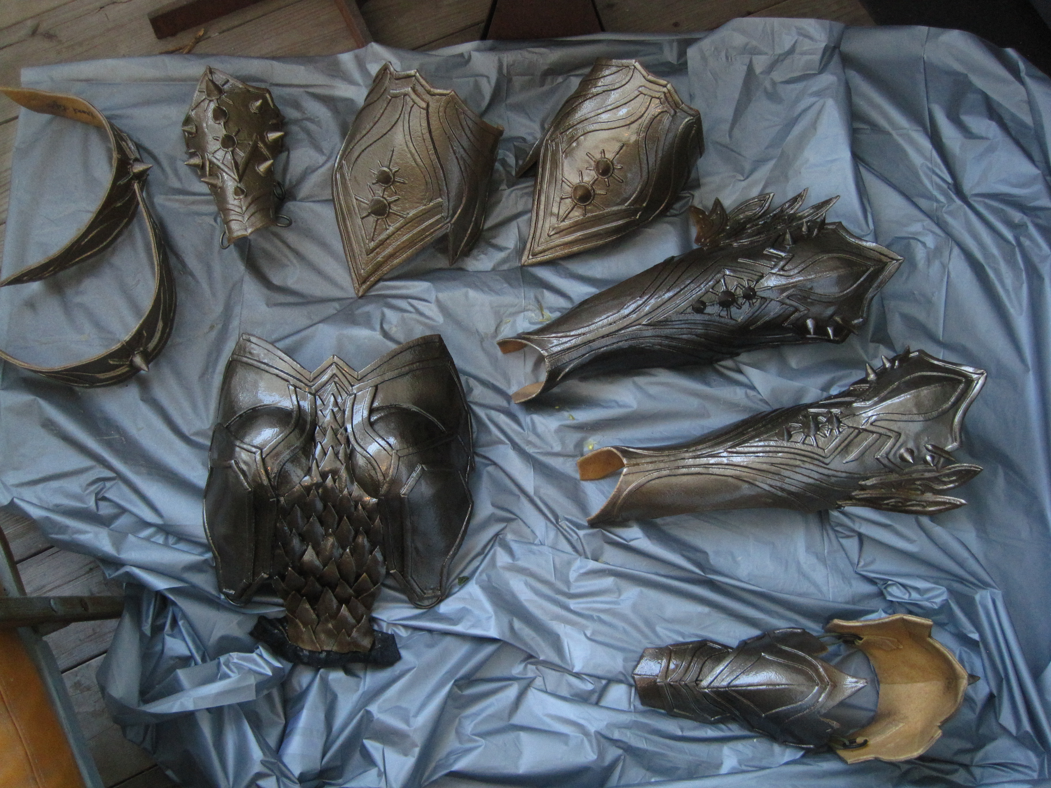

Finally, all the armor is (mostly) squared away!
I primed the Worbla with two coats of Titebond wood glue, which gives it a nice smooth surface with no sanding; wood glue is sort of self-leveling, so it spreads out super smooth with no brushstrokes.
After that dried today, I threw on a coat of Rustoleum's hammered finish spray paint. I was looking for a pewter or bronze, but settled on this "chestnut."
It looked great until, what the hell, the color changed!
Anybody use hammered paint and have this happen to them? I rattled the can more than enough, but apparently the results beg to differ! It'll work out fine, but I'm still a little annoyed. Hmm... I would like to use Volpin's technique of layering sponged-on metallic paint with weathering, which will hopefully brighten the darker pieces up.
