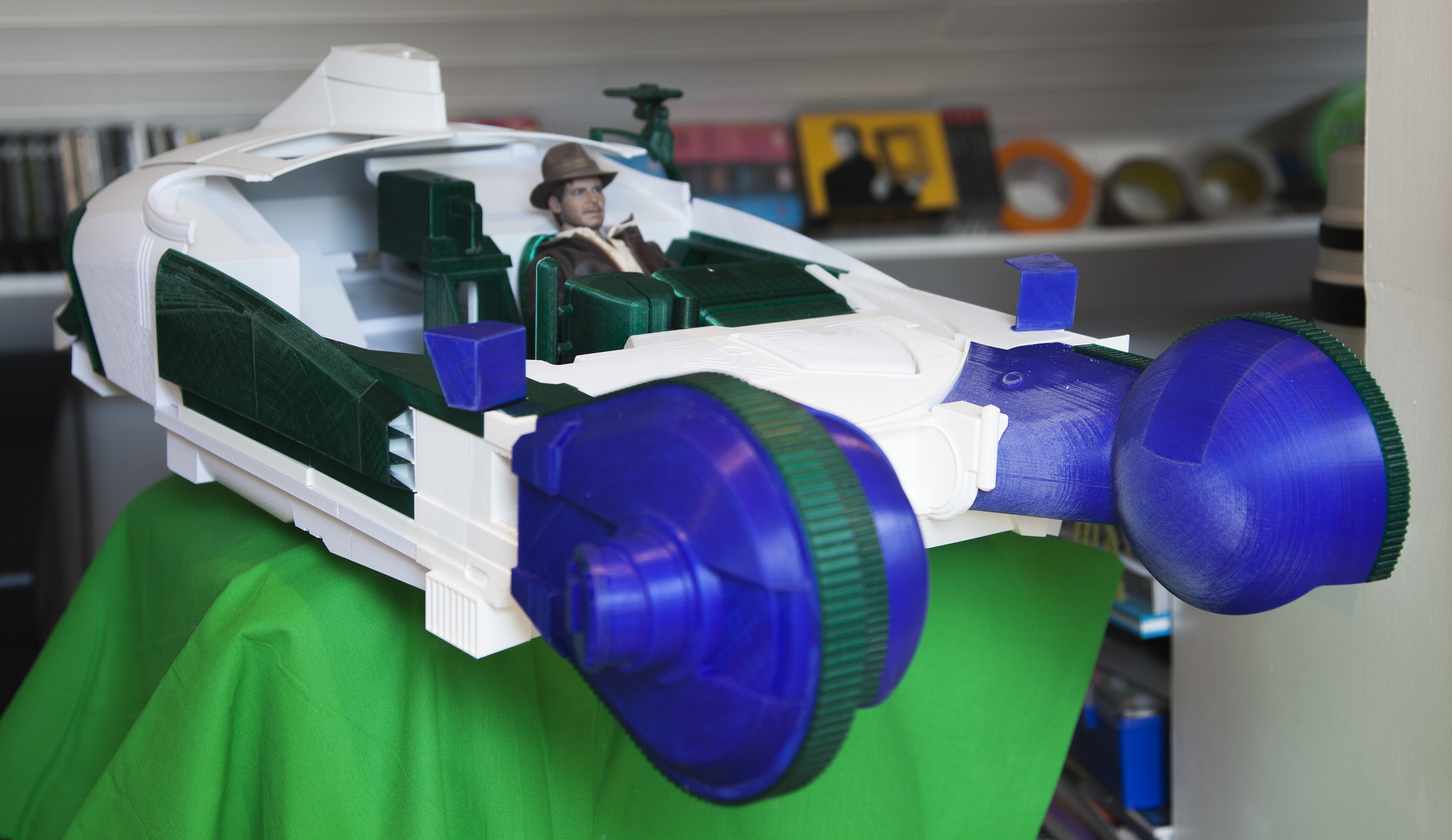

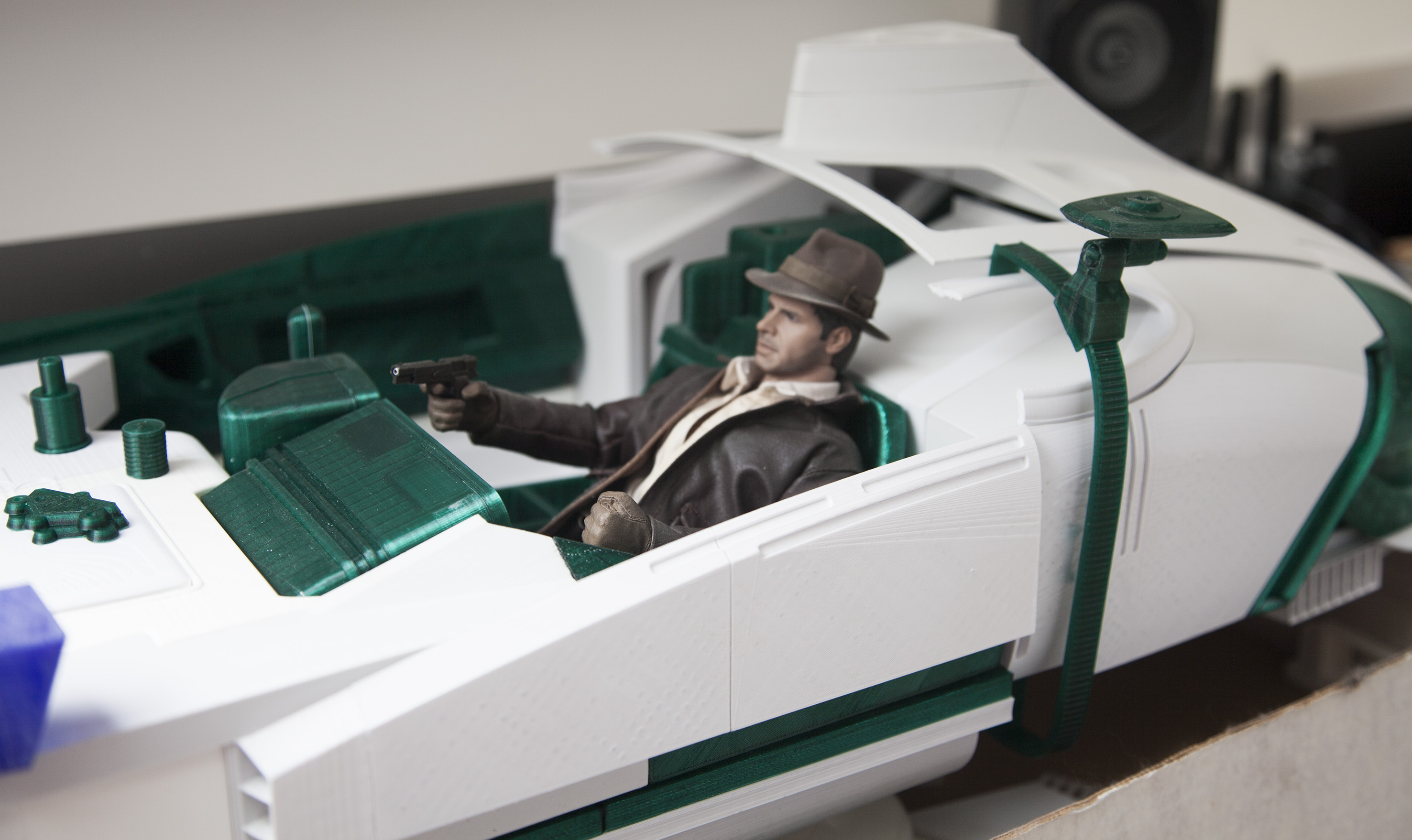

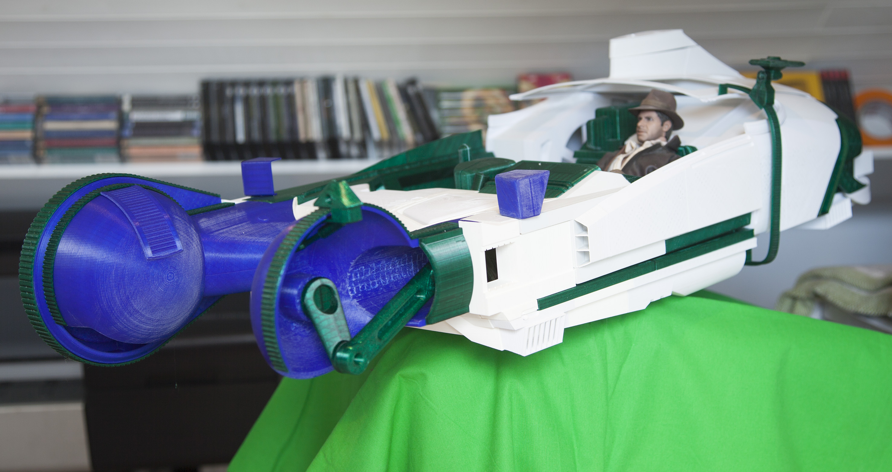

I'm still a way off but couldn't resist temporarily hot glueing the parts together to see how its going. IMG_7874.JPGIMG_7877.JPGIMG_7878.JPGIMG_7879.JPG

At the moment I've just hot glues the parts together as it makes a difference which way I put it together . i.e. if I do end up making it as a kit or just build 1. I'd like to give one to my friend Richard Yurasich so I would make sense to make a kit and of course resin is more stable than PLA in the long term. but making a kit make the hole thing very expensive in time and materials. So I'm still in 2 minds
If I did make a kit it would have to be a limited edition of say 10 any more than that and I'd get bored. I'd need help with programming Arduino for lighting and sound. but all that is a way off yet . I've designed parts so it can be posed flying or standing just incase. but I think it might come in to expensive for a kit.

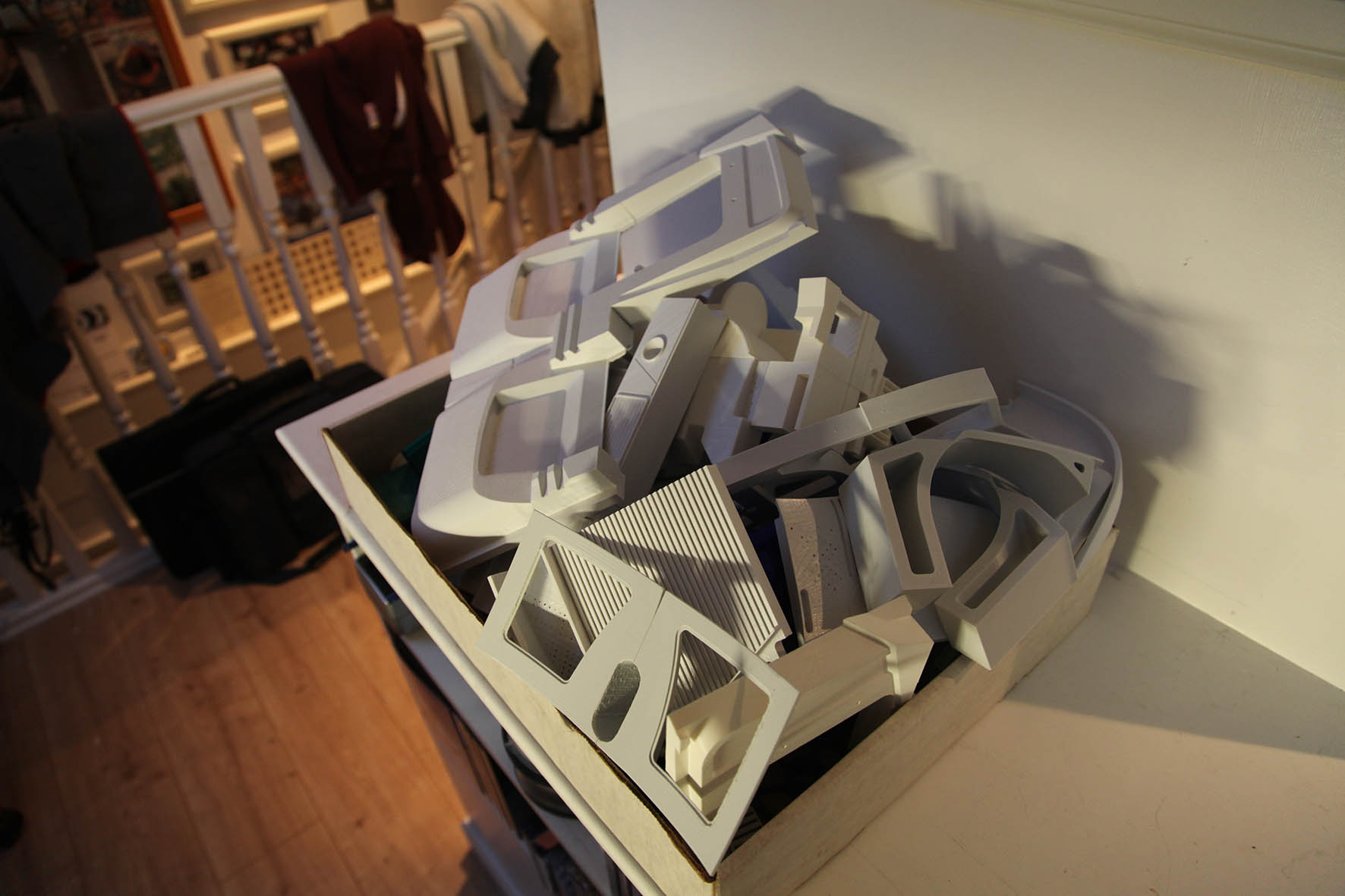

first things first print out all the parts.
As most of us here, (Well I know I do) come to see the photos, in progress. I'll try and post every now and then. spinner 1.jpgspinner 2.jpgspinner 3.jpgspinner 5.jpg. one thing I've learned wile doing this is the white PLA isn't as good as the clearer PLAs it must be the amount go pigment they use that makes it chewy. Not too much left to print before its primer and filler time. I made up an optional wheels down rig its not based on anything from the film.

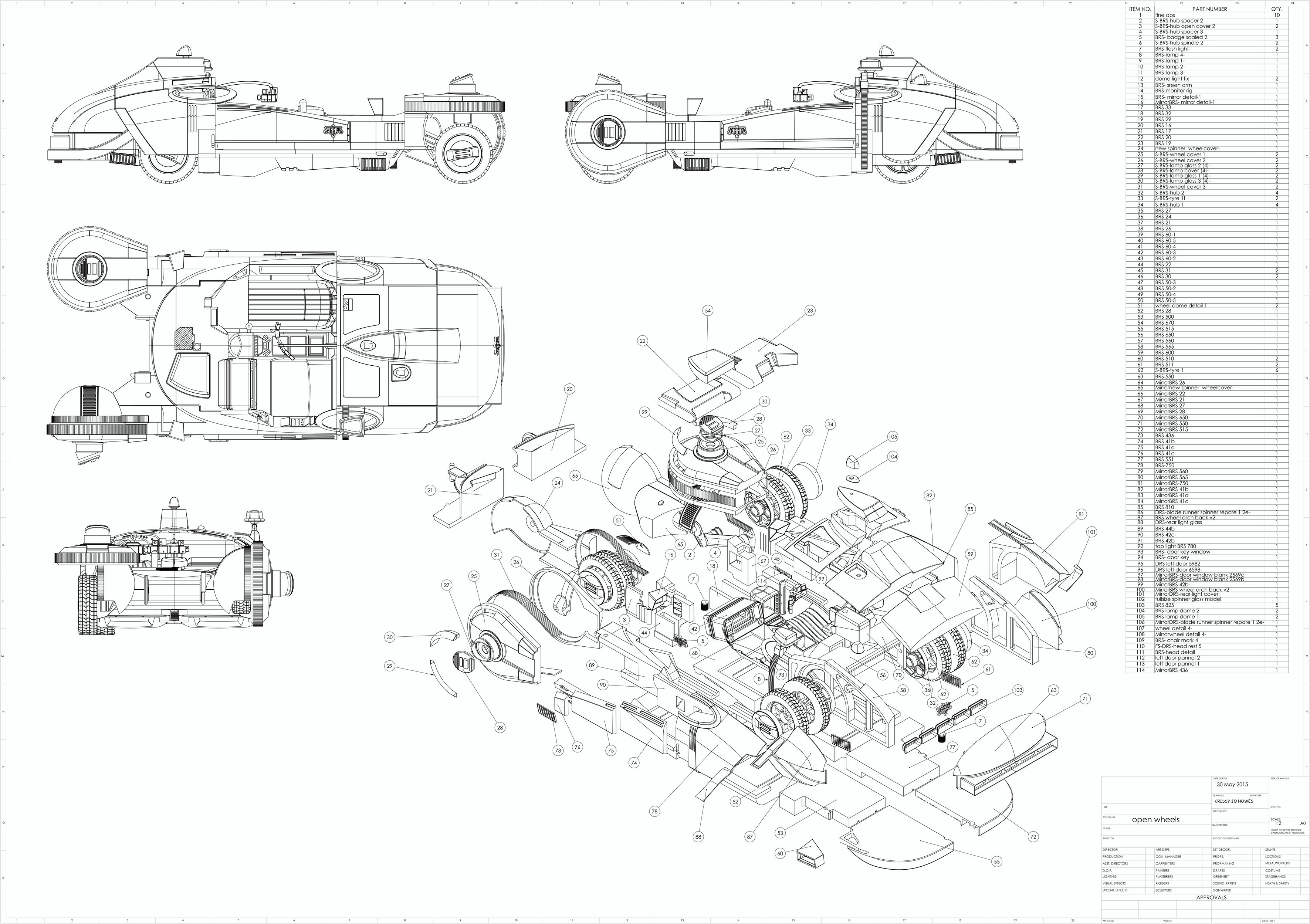

https://youtu.be/ftQMaaGZYco as the printing is coming to an end I've been playing with which way to go . so far theres over 100 pieces. 1-6th scale kit spinner.jpg if I did do a kit I'd make a proper call out sheet but this is always fun to see how far you've come. I did one of these on Edge of tomorrow to show the producer how complicated the suits where and where his money was going. but a kit would be up there in the £1000 range so I'm not that sure its worth it.

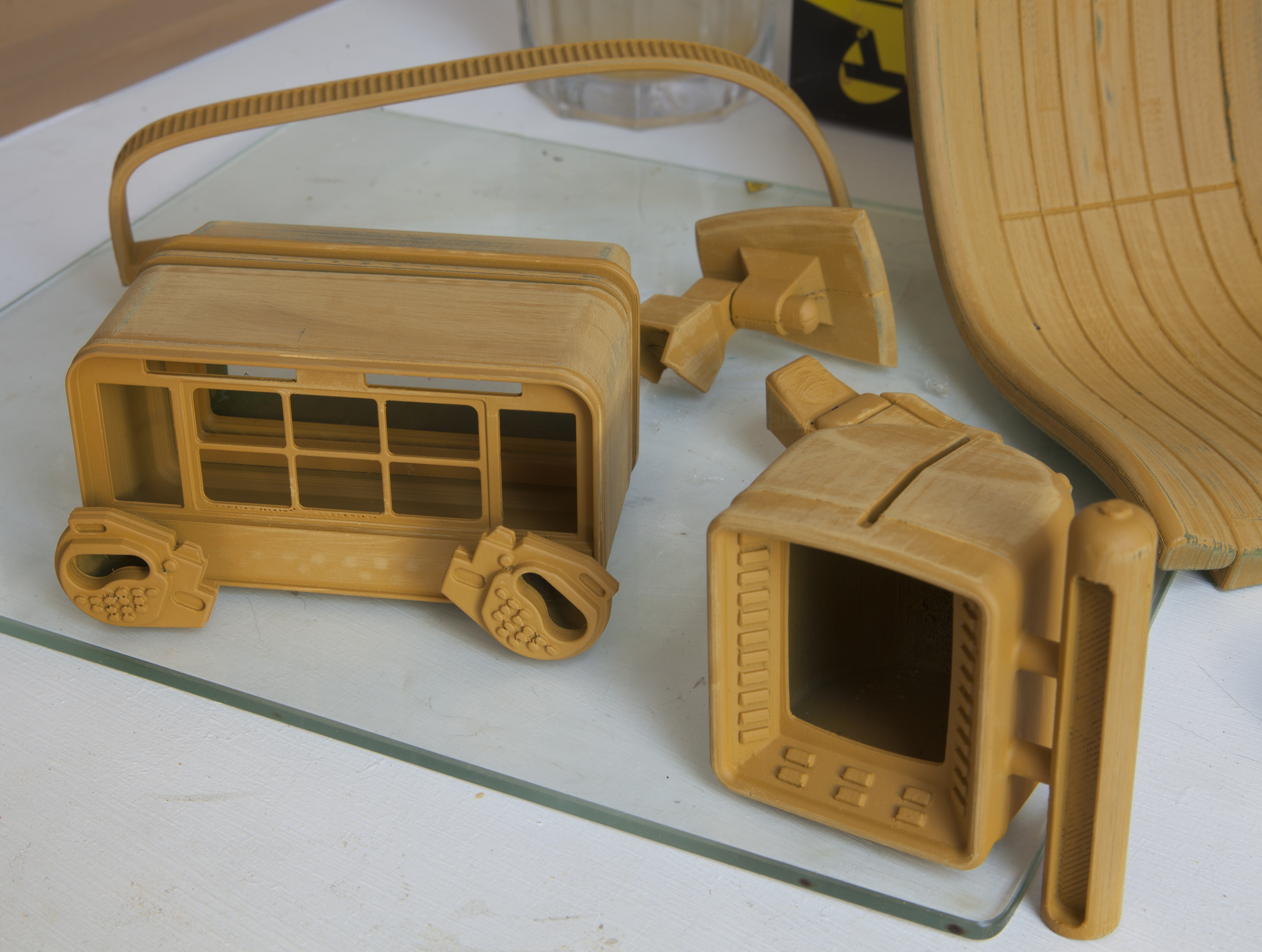

_BRS- console.jpglet the clearing begin. its a dilemma as to how far to push the clean up per molding as its all go to have to be sanded and primed once its in fast cast. The problem with PLA printing is there only so far you can push the sanding where as fast cast sand smooth so easy. all the parts are printed but the vac form pattern for the glass. I might CNC that as its up there in the 100 hour prints. I've made a set of cell graphics to back light. Some of the lighting effect might still have to be glass fiber.

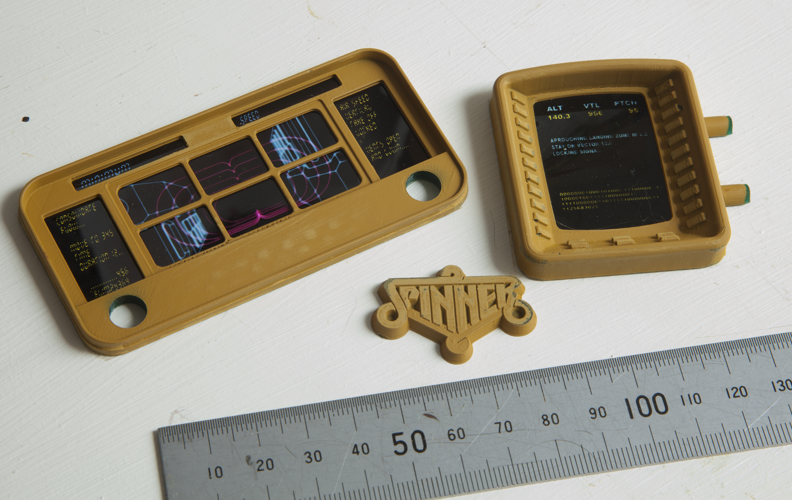

_MG_8061.jpg just for you . here my favourite part so far. I think this is pushing a PLA printer as far as you can go detail wize. I should really be doing these on an SLA printer. I do admit I should have added the switches on with styrene but I was just interested in how much detail the PLA could achieve. I can't wait to get theses cast and lit up.
