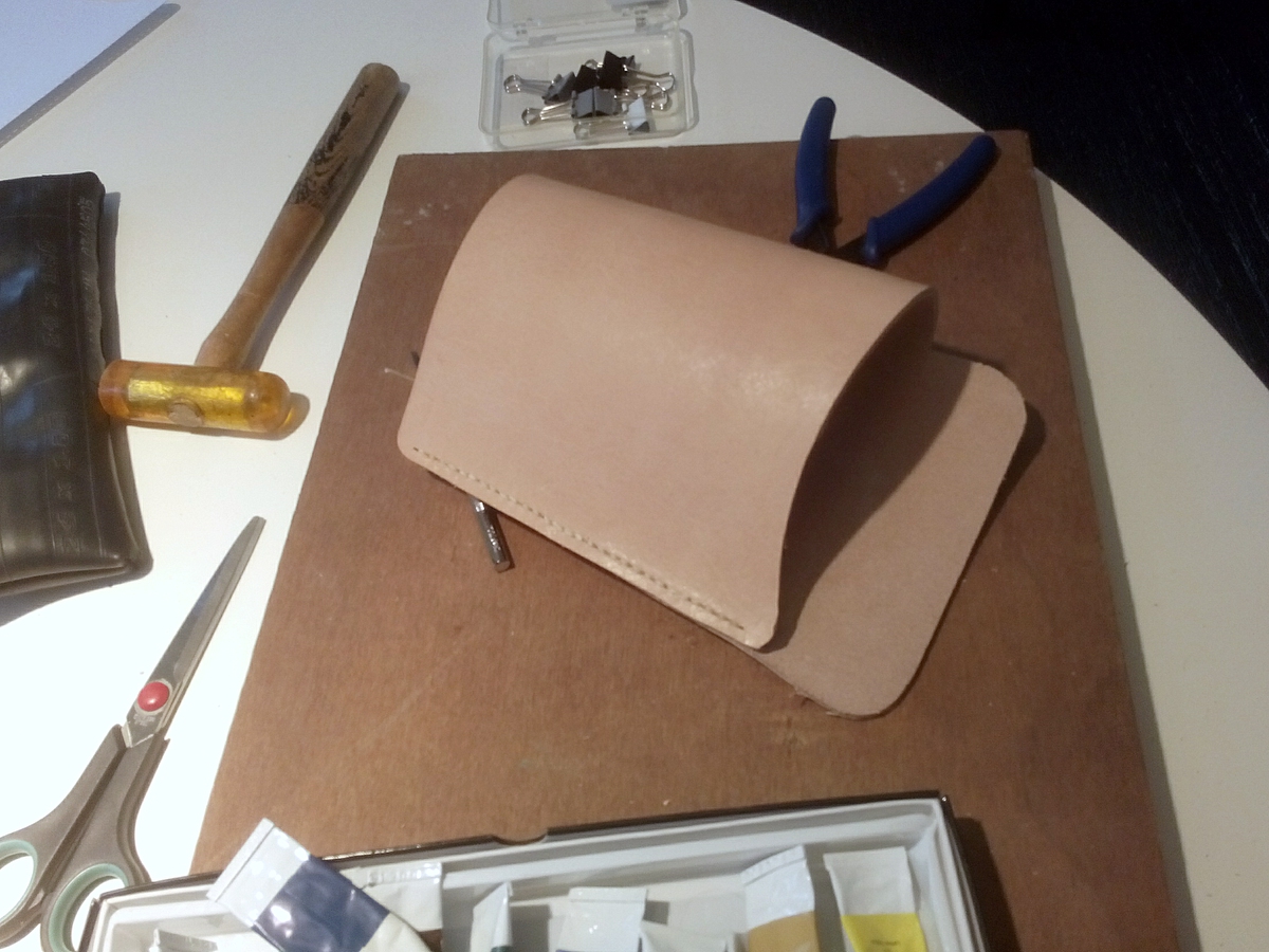

- she set to work on the holster. We did not try to match anything River wore on-screen, but rather did our own custom holster, shaped to hold the gun as comfortably and snugly as possible:
Finally, we added a belt loop and thigh lace (oh, and I cut away a bit over the trigger well for a better draw) and gave it a coating of leather grease, significantly improving the color and look - and presto, she's ready to rock:
