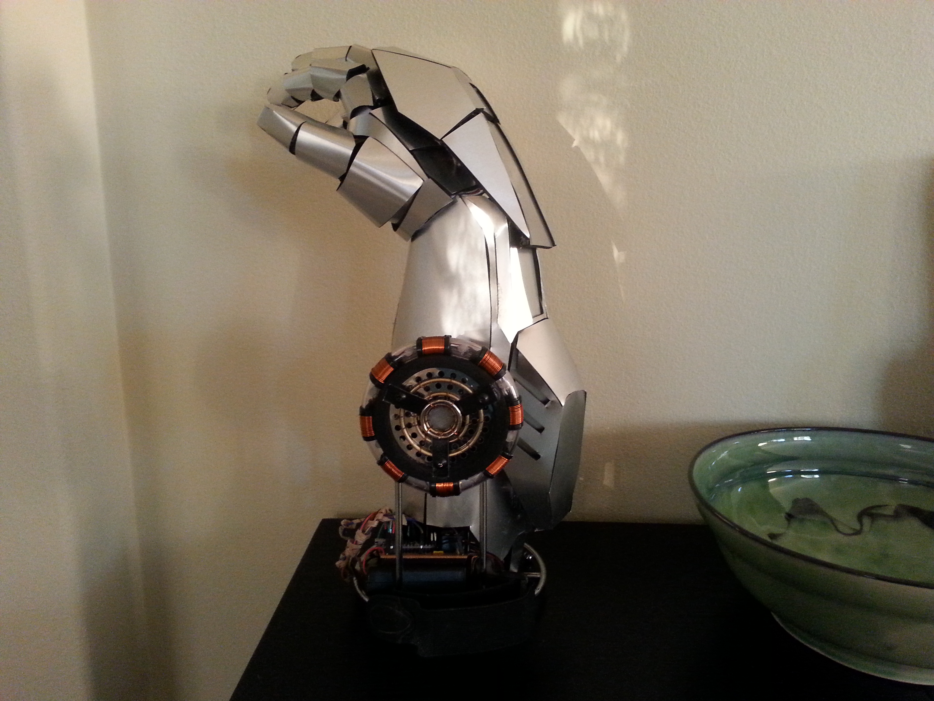

Last year, I started a foam Mark VI suit which, unfortunately, was not finished in time for Halloween 2013. While scraping together a last minute Tony Stark costume as a substitute, I came up with an easy technique to overlay aluminum onto foam and decided to start prototyping a more complete build. This year, rather than making a full suit using this technique, I decided to focus just on making a fully functional arm.
Here is a video and some pics of the final result:
Finished Product
Easy display stand using a paper towel holder
Some specs on the arm:

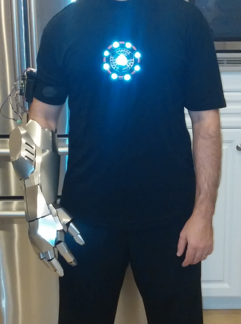

- The forearm and glove are two completely independent systems that can be coupled together as one
- Both are controlled by separate Arduino nano boards
- The forearm uses 2 servos to open/close the missile pod and a 3rd servo to extend/retract the missile/laser
- The electronics for the forearm are housed in a separate module that I have on a strap attached to my shoulder -- there just wasn't enough room for everything in the forearm.
- Activation of the missile pod is done via a small pushbutton switch on my thumb
- The glove uses a magnetic reed switch on the wrist to activate the repulsor
- The majority of the electronics for the glove are housed under the hand plate.
- The handplate magnetically attaches to the top of the hand which turns on the glove on contact.
Specs on the Arc Reactor:
- Self-contained and runs on 3 AAA batteries
- Magnetic mount system
- Adjustable brightness control
- All external components mechanically attached (I had too many issues with adhesives in the past) -- This model was originally intended to take a beating but I'll post more on that separately later ;-).
