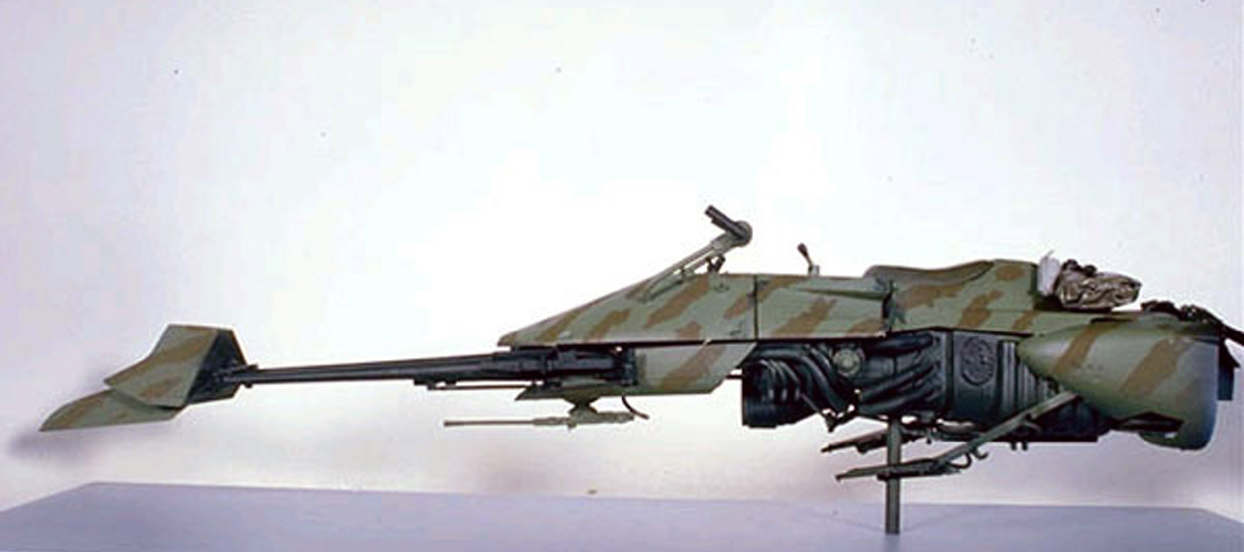

After a long absence due to another project (customisation of a Harley Davidson Night Rod Special) I'm slowly making my way back into Studio Scale modelling Although I'll be finishing my old builds (hopefully soon) I've decided to start with a new model: the concept speeder bike used in developing the final speeder bike for Return of the Jedi.

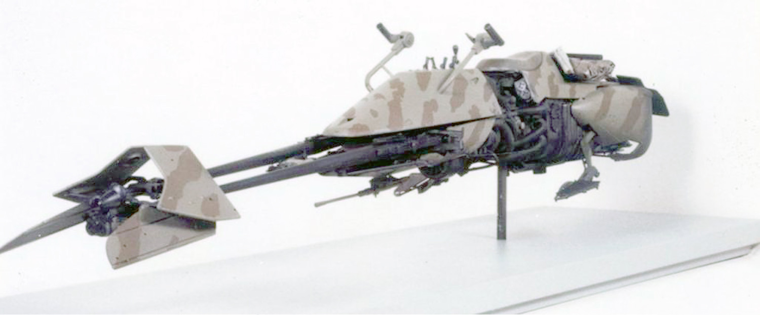

These are all the reference images I have so far. If anyone has any more and is willing to share please send me a P.M. I'm only looking for reference images of the concept model, not the filming model or the full scale model.

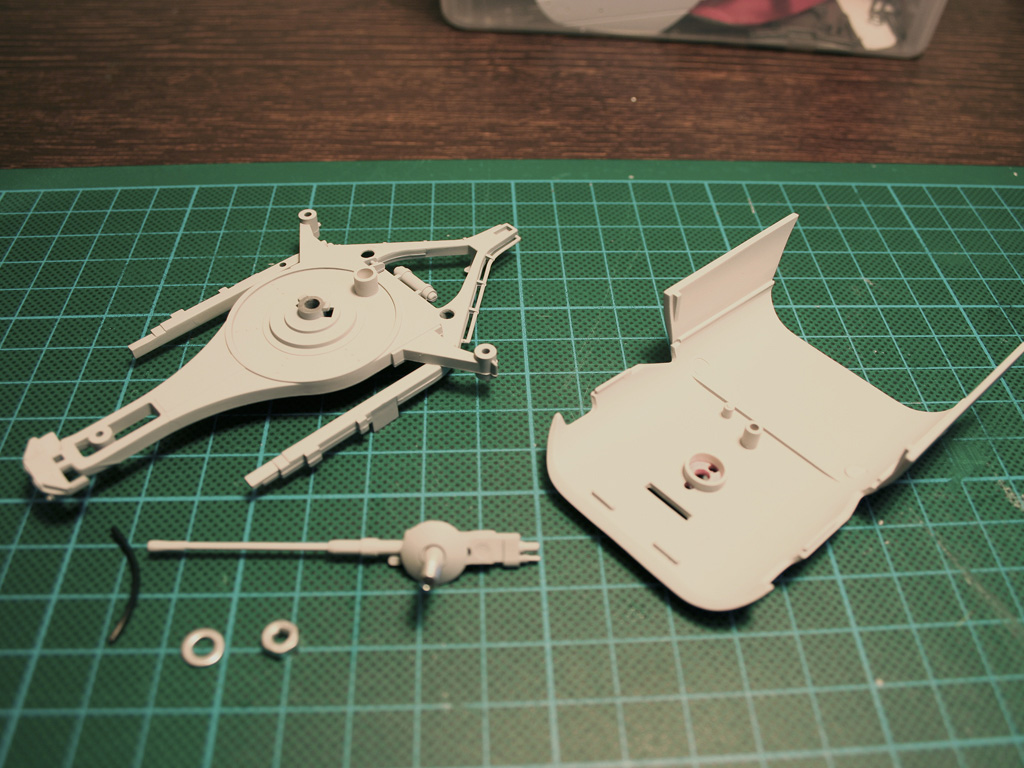

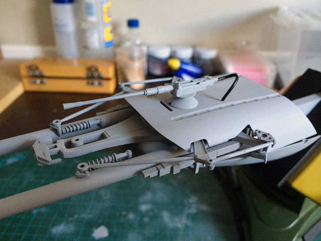

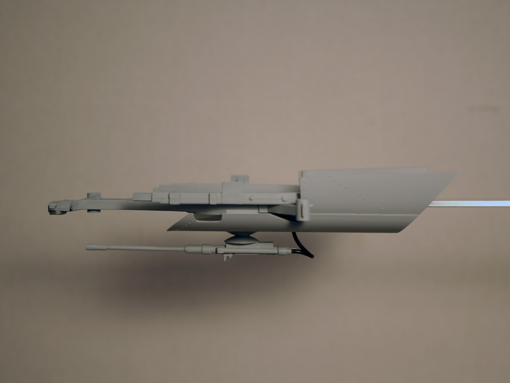

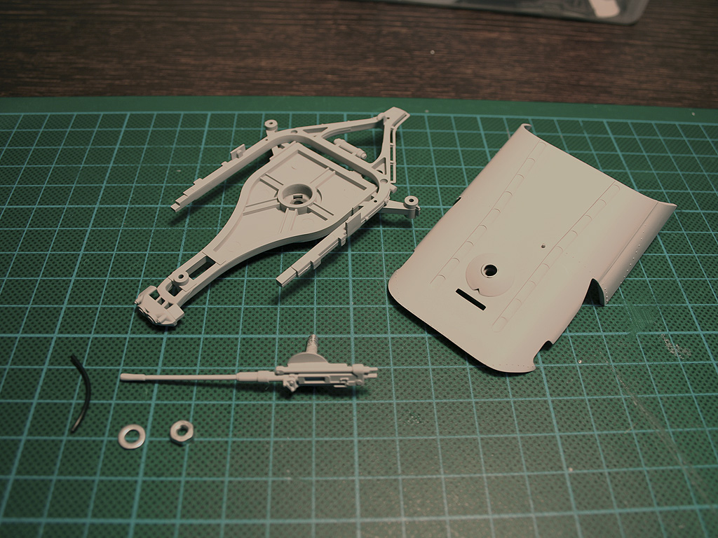

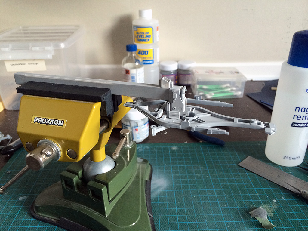

So this is the first section I was able to put together. I redid this section because I wasn't happy with my first try and the parts are cheap anyway (except that 312B cowl). The threaded bolt in the belly gun holds everything together and allows the gun to swivel.

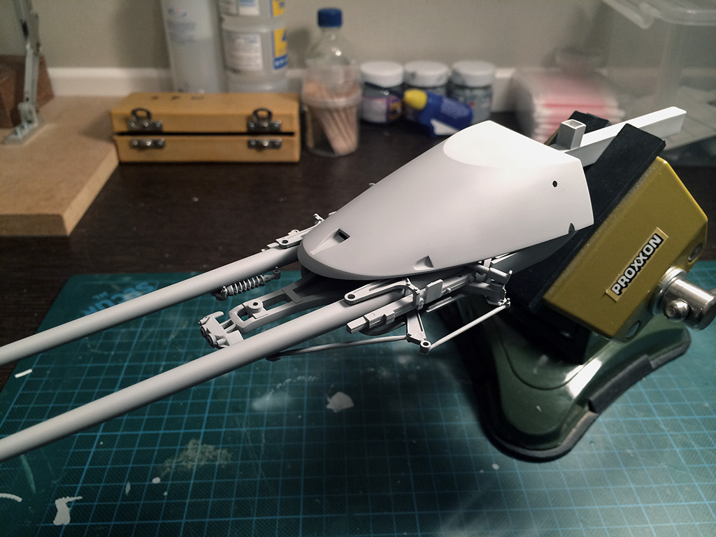

Next I made a backbone to which I'll hang all the parts. It's a square brass profile within a styrene profile for each of glueing styrene to styrene. Don't mind the greeblies on the support. I did that just in case there's an angle from which you can look inside/under the 312T cowl that will go on top. I think there isn't.

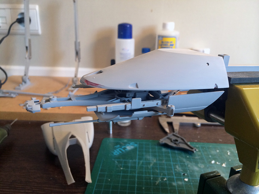

I've just started on the upper body. The front is definitely the Tamiya 1/12 312T cowl, the back is definitely the back-end of the Tamiya 1/20 BT-46. The middle part is hard to ID. For now I'm going to guess it was scratch built. The back-end was also heavily modified with styrene to get the shape in the reference pictures.

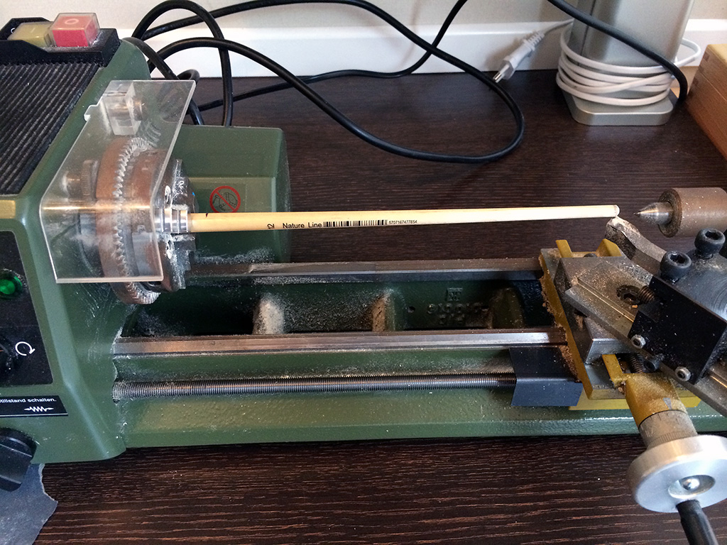

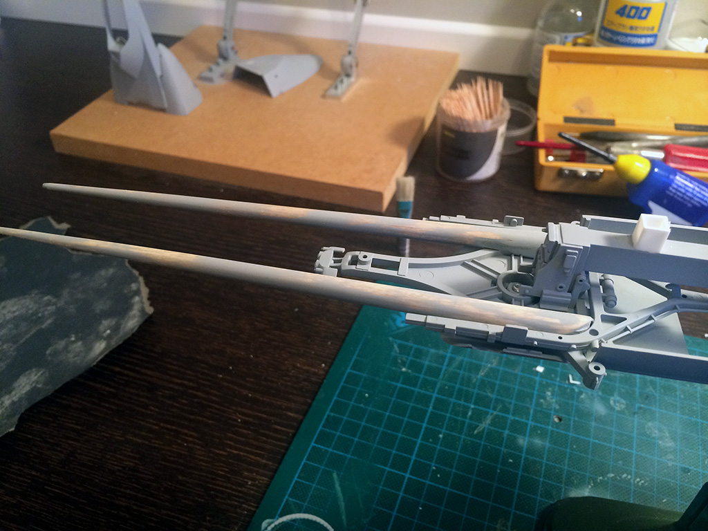

I started to work on the forks as well. I wanted to keep in line with the original by using paintbrush handles, but I couldn't fin the correct size. So I bought oversized ones, stuck them in my lathe and sanded them to the correct shape.
