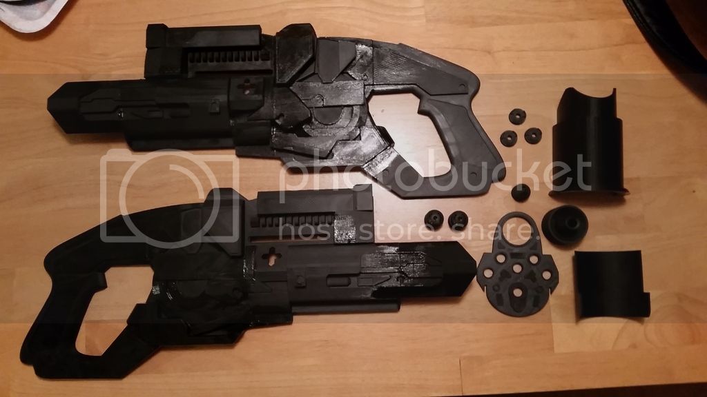

Finally got a restock on filament this week and was able to print out the rest of the shell. Apologies for the poor photo quality; they were all taken on my phone.

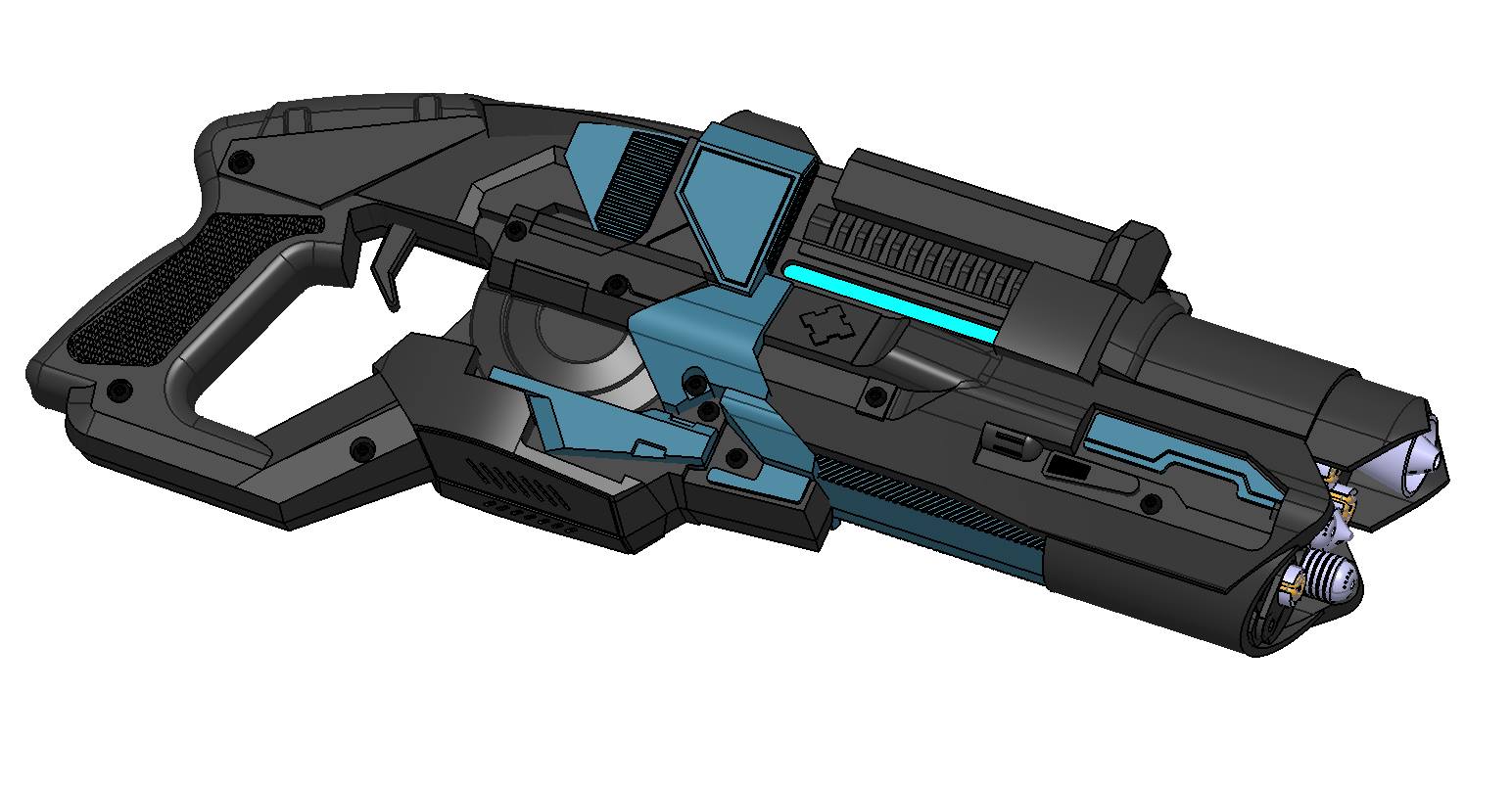

Here's the overall parts breakdown

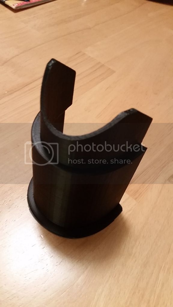

The two main halves were printed out of 7 individual pieces that were then "glued" together using ABS goo, a mix of ABS plastic and acetone

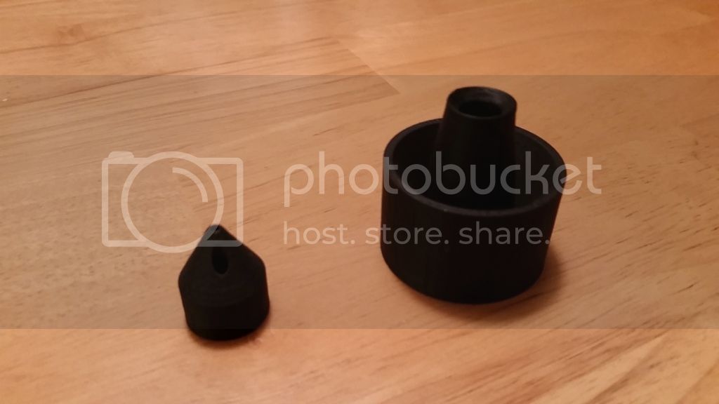

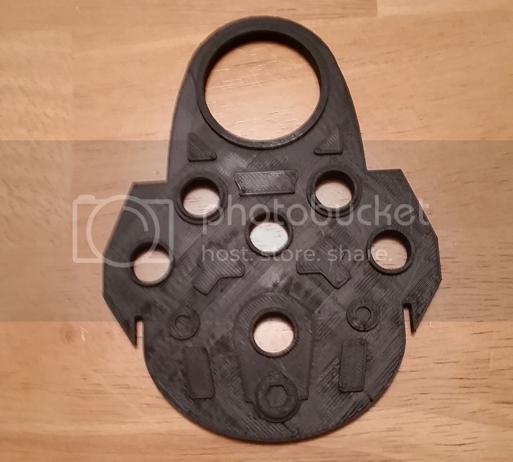

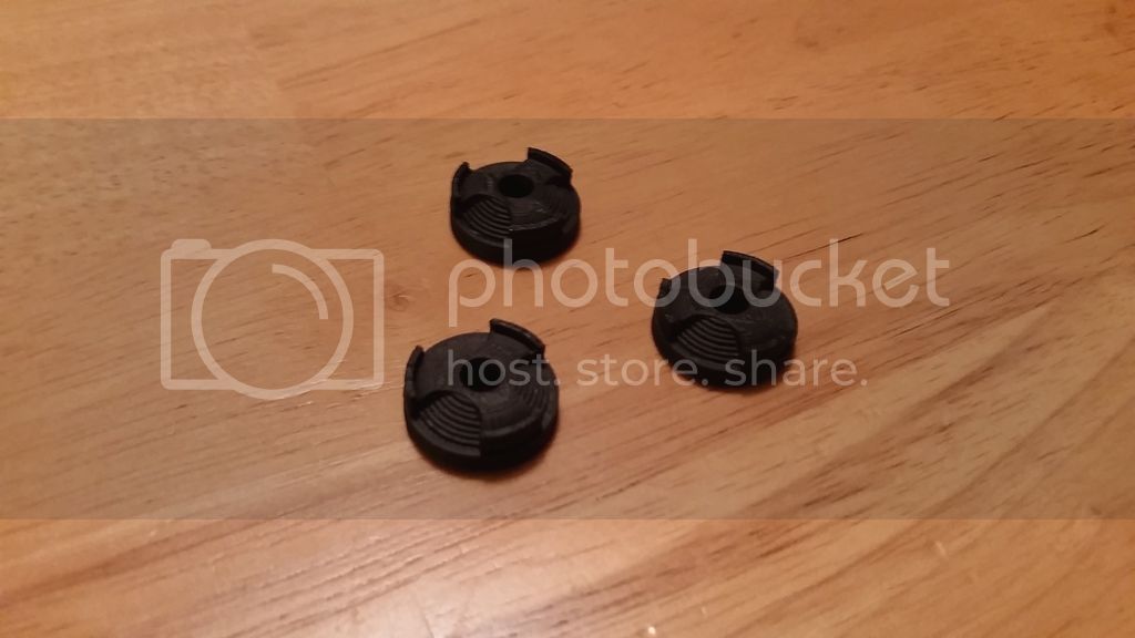

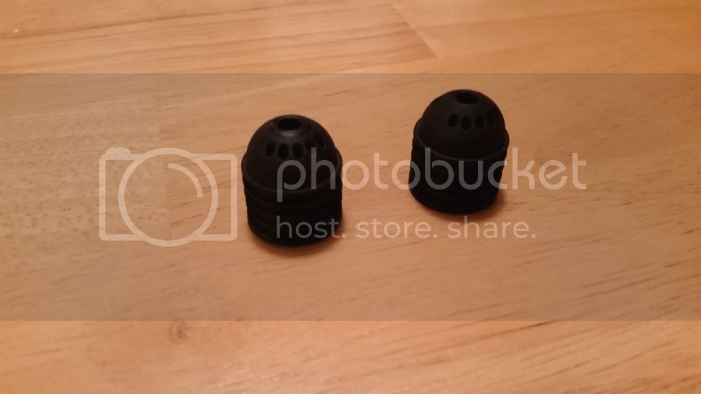

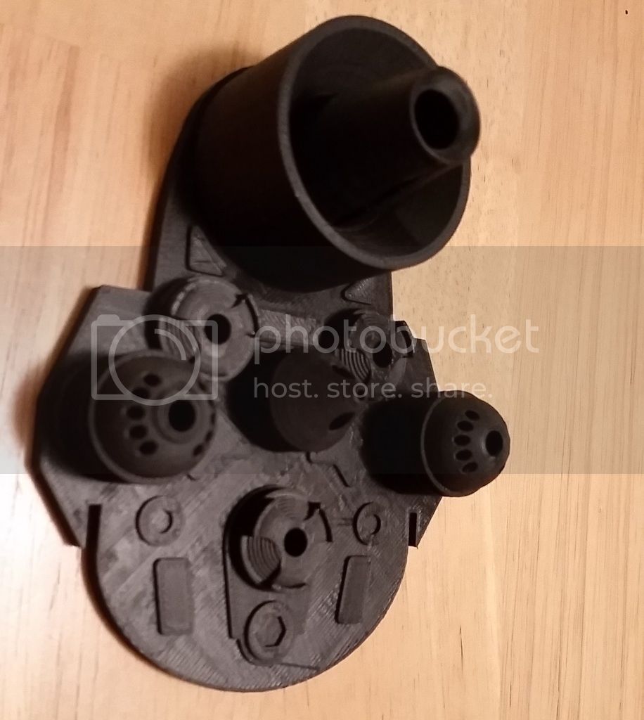

The front assembly has two different arch pieces (one top, one bottom), as well as the business end of the gun and its various greebles
Here's the business end with the various greebles where they will be glued down

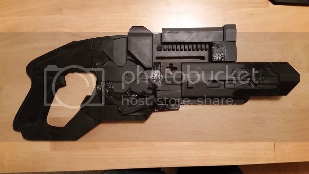

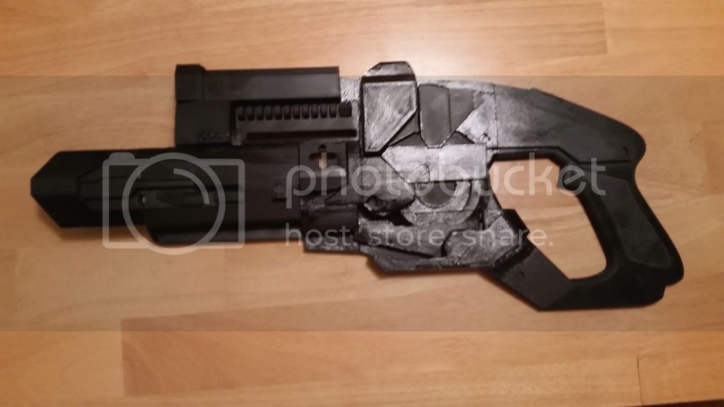

Overall, while there were a few prints that failed most of the way through their 16+ hour print time, most of the printing went extremely well. I printed at 0.1mm resolution for the entire project. I probably could've bumped it up to 0.2mm and been just fine (and halved the print time) but I wanted the finish to be extra nice on these parts. I'll be lightly brushing some acetone throughout the entire surface of the prop to fuse the filament layers and even it out somewhat (you can see the start of this where the parts are really shiny compared to the rest). I have some light gap-filling that still has to be done, but aside from that, this baby is ready for electronics and screw fittings!

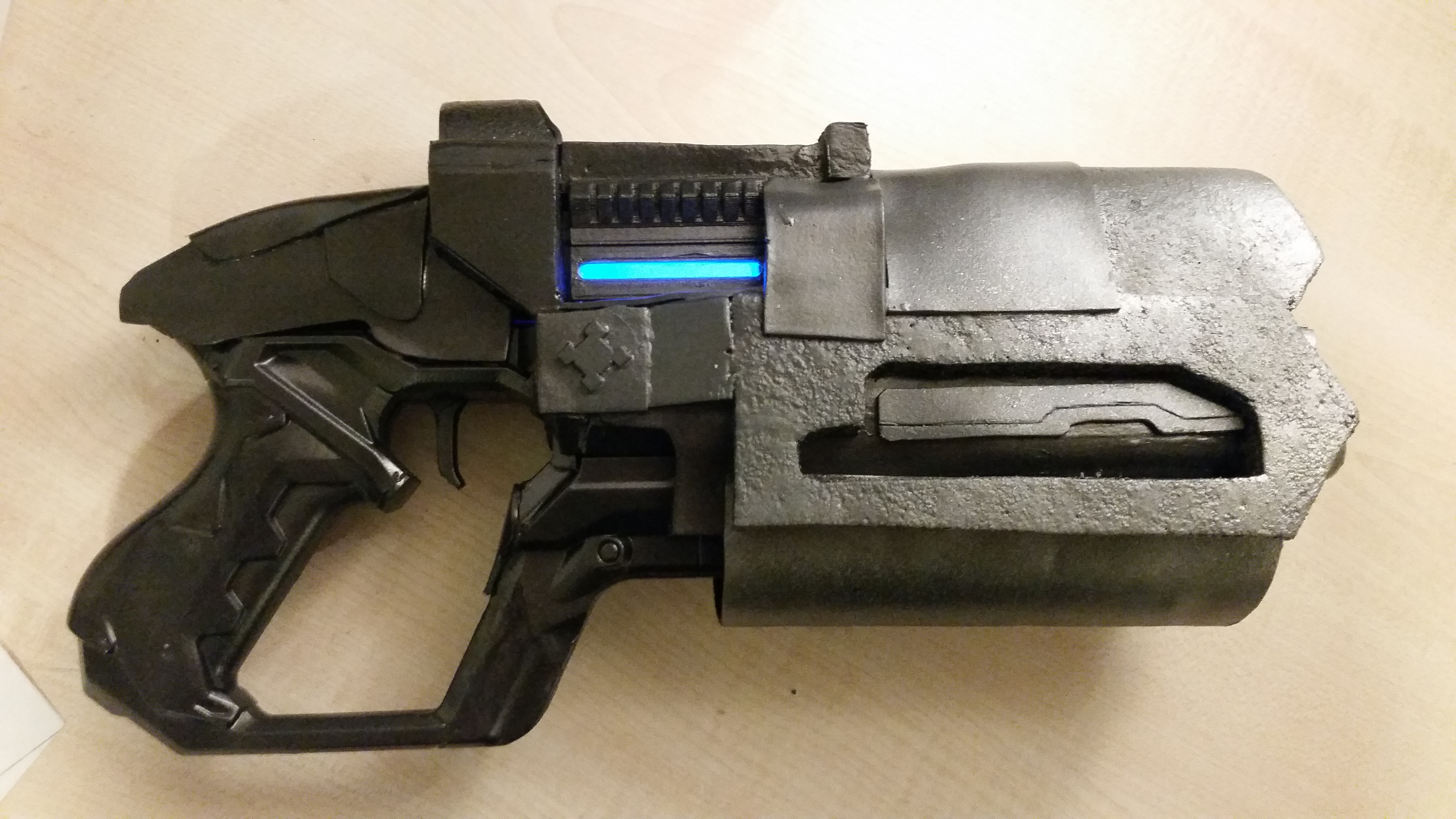

Hey everyone!

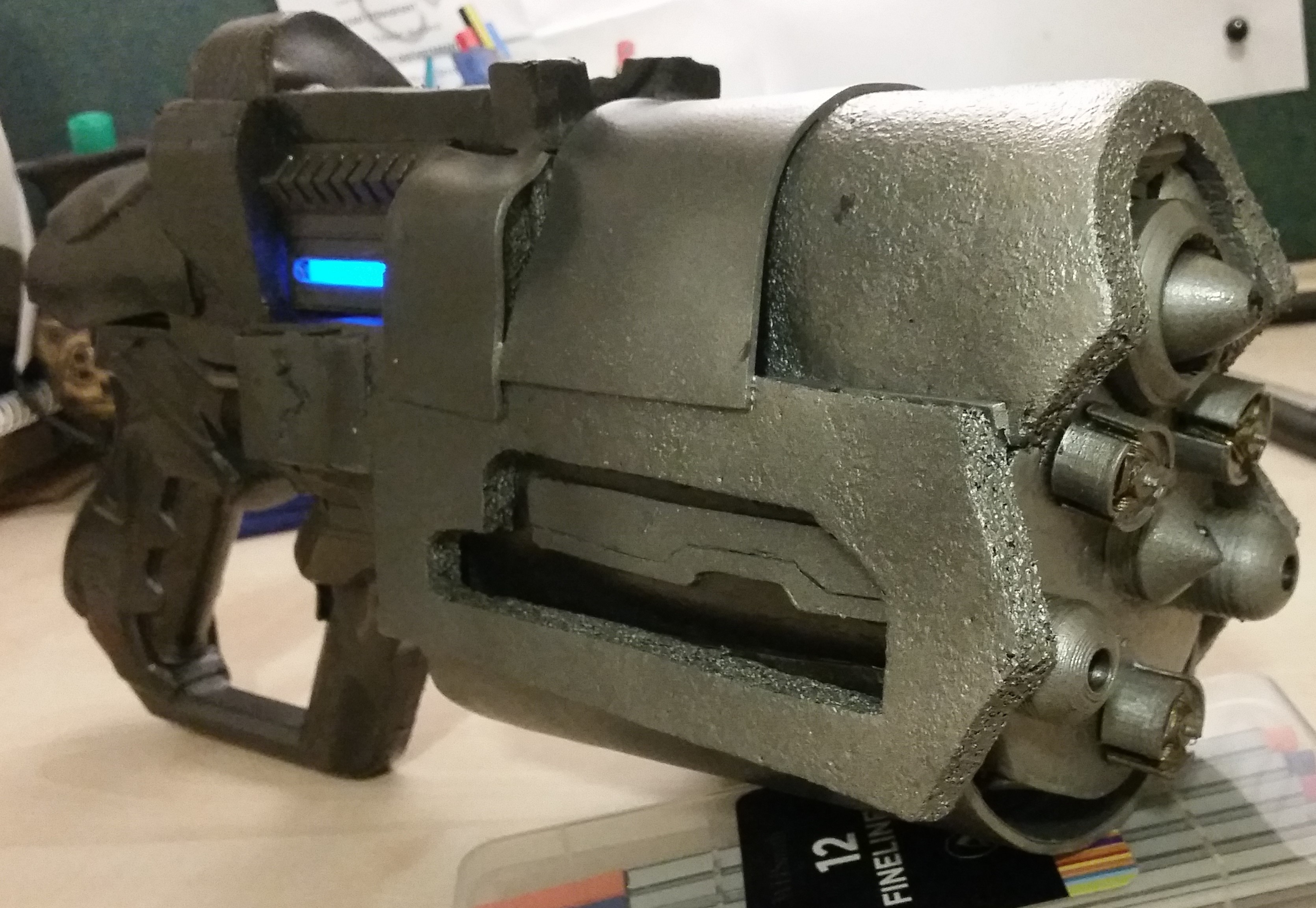

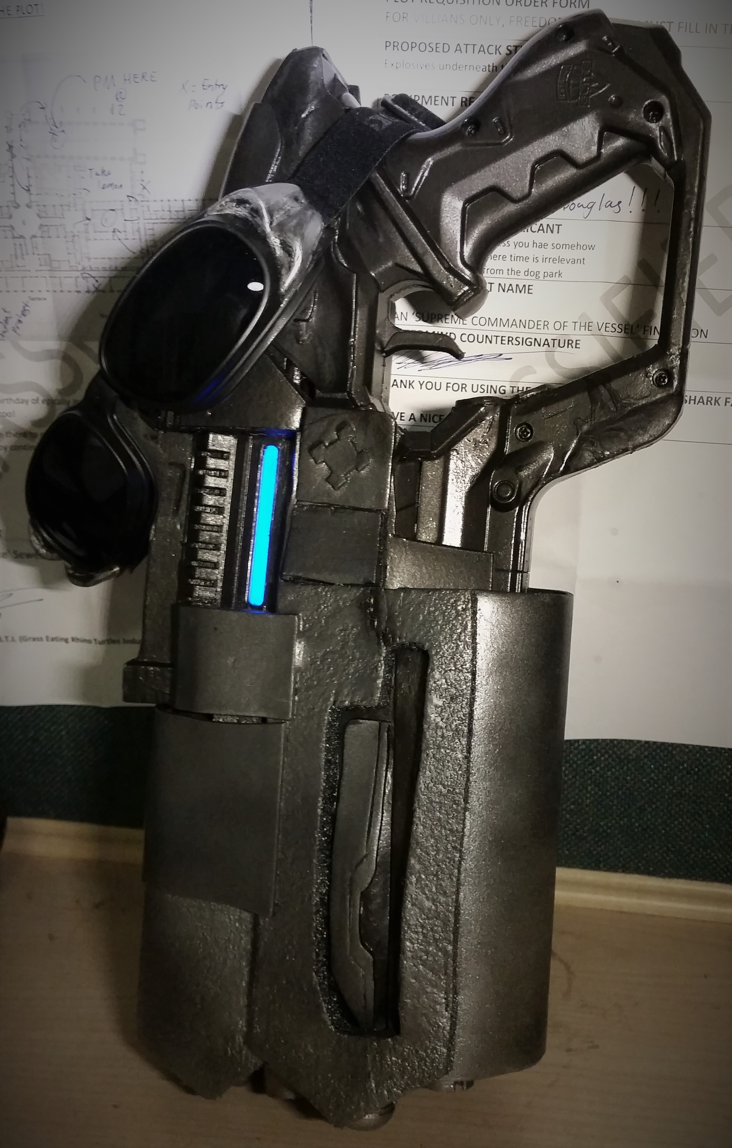

I'm going to be cosplaying Cold at London MCM this coming Saturday and I've finally completed my Cold Gun! It's modeled on the NERF Cyclone but heavily modified - I removed the barrel entirely and dremelled out quite a lot of the body to get the right shape. The panels with the energy bar, as well as the pointy bits/firing mechanisms on the end of the gun are all 3D printed, but the rest is foam.
The energy bar itself is EL tape which has been wired inside the body of the gun (the battery pack is hiding in a removable slot on the base), and the side bits of the goggles were made with milliput! If you want me to upload my progress photos (if that would be helpful to anyone) I'd be happy to, but here's the finished piece!
(it's the first prop I've actually ever made :S)
View attachment 627540View attachment 627541View attachment 627542
