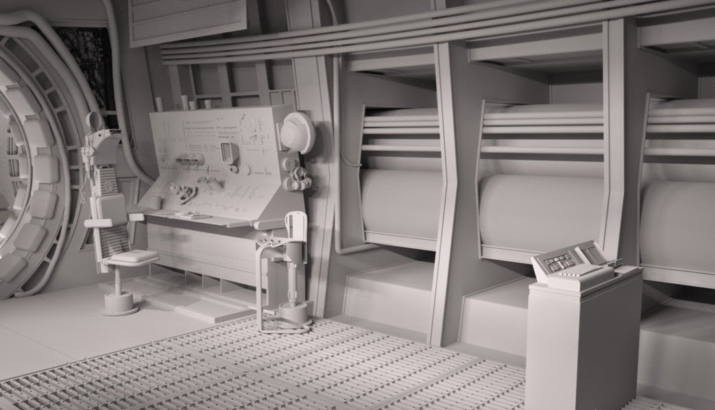

It's been a year or so since I completed (more or less) the Falcon interior I'd been working on since about 2010. A college degree's worth of time has elapsed since I first started, and now I'm doing it all over again from the bottom.
This all new version is based on photogrammetry, obsessive research, and sourcing as many original parts and props as possible. These renders represent about three months work (I think it took me a year or more to get to this point last time.)
my goal is to have a finished product that, when rendered, is indistinguishable from stills of the real set. Piece of cake, right?
rare reference is always appreciated, and if you happen to know what any props were originally based on, I'm always open to hearing about it. Also, I welcome any critiques, if something doesn't look right to you I want to know about it.
thanks, and enjoy!
