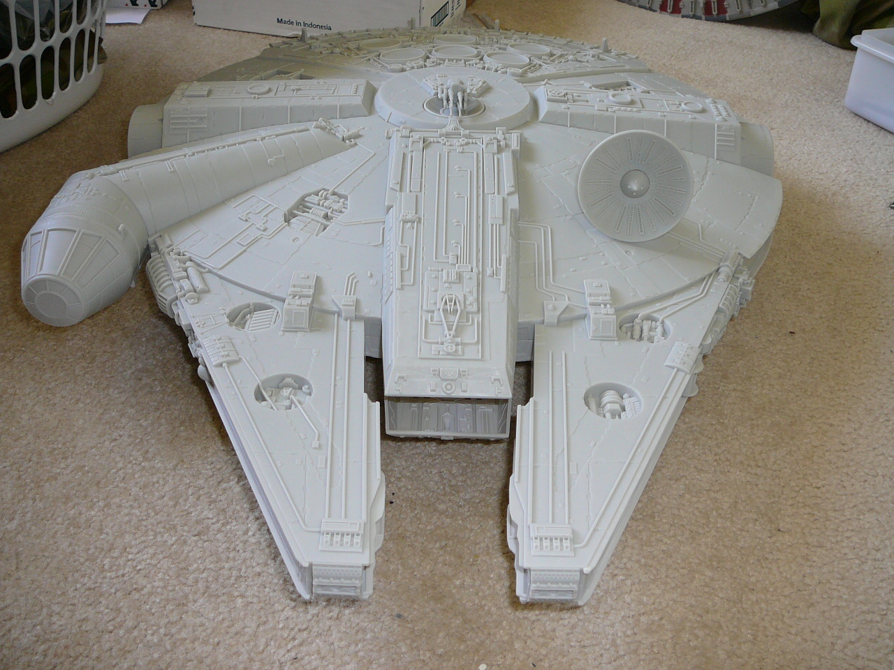

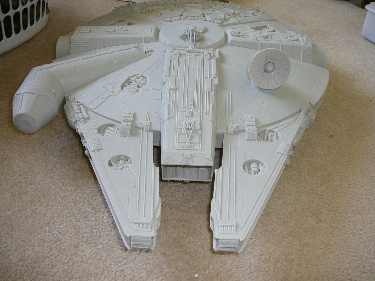

After reading about the radar being oversized radar on this I decided to photograph the ship with the original radar and the spare BMF radar dish I have. There's no question about the difference it makes.
View attachment 393174View attachment 393180
Looks good. I finally stopped being lazy the other day and pulled out my calculator to figure out what would be the correct size dish as compared to the 32"falcon. If this falcon iis .875 the size of the 32",the dish should be around 2.625". So that falls somewhere between the included one and the BMF.
I think the dish should be the same diameter as the cockpit tube , the front of the jaw & the outer ring on the docking bays

Me too I've been doing some calculations about the dish diameter. If the cockpit tube external diameter is something around 64 mm -and it seems correctly proportional to the Hasbro size-, the radar dish diameter should be the same. I've resized my 3D model to 64 mm diameter.
It's not possible to make direct conversions between the Studio Scale model, the MPC model or the 5 footer model. If you want to know the proportion between the total length of the model and the dish diameter, the results are totally different... I've tried and no luck to have a good and definitive result.

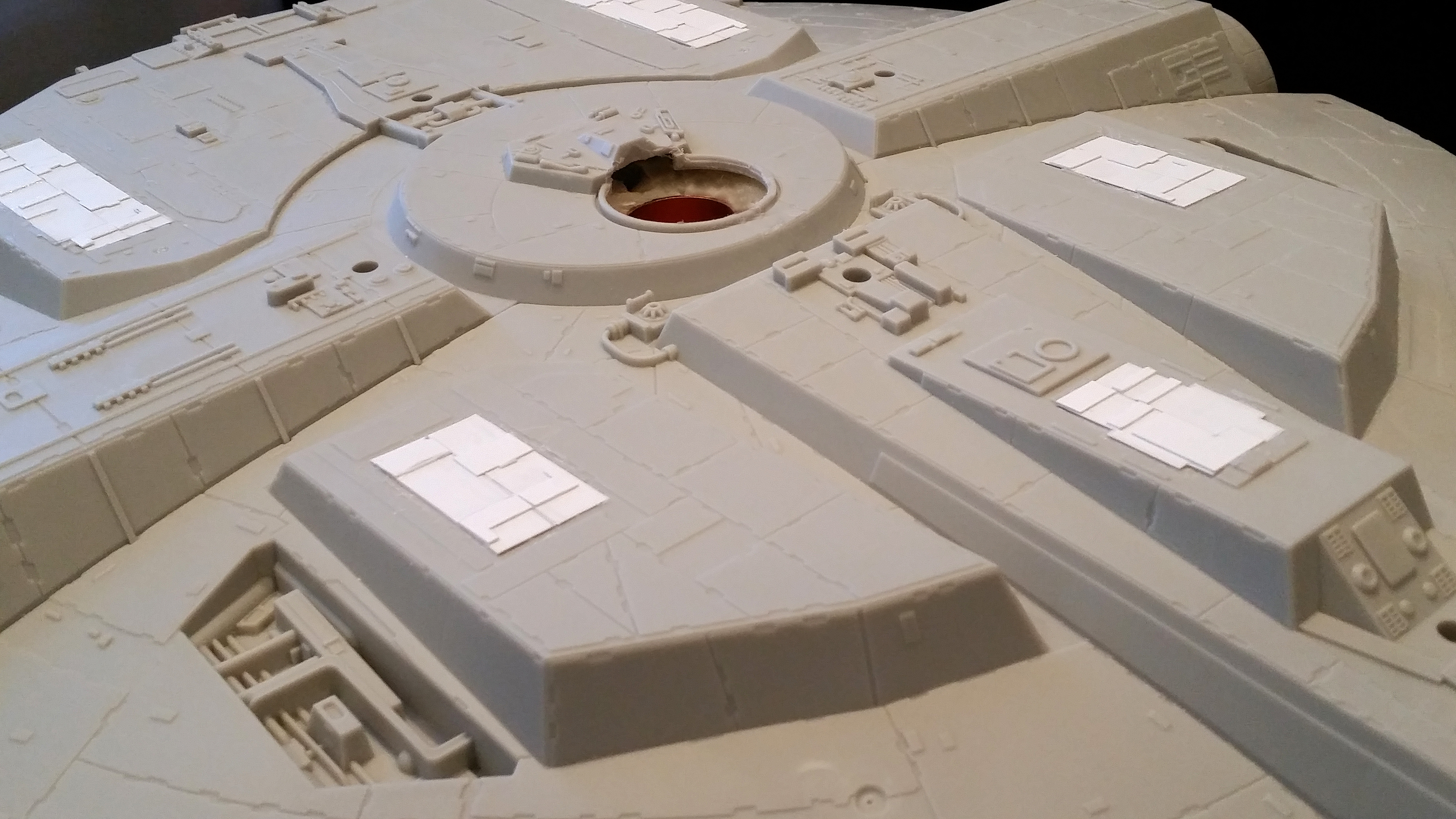

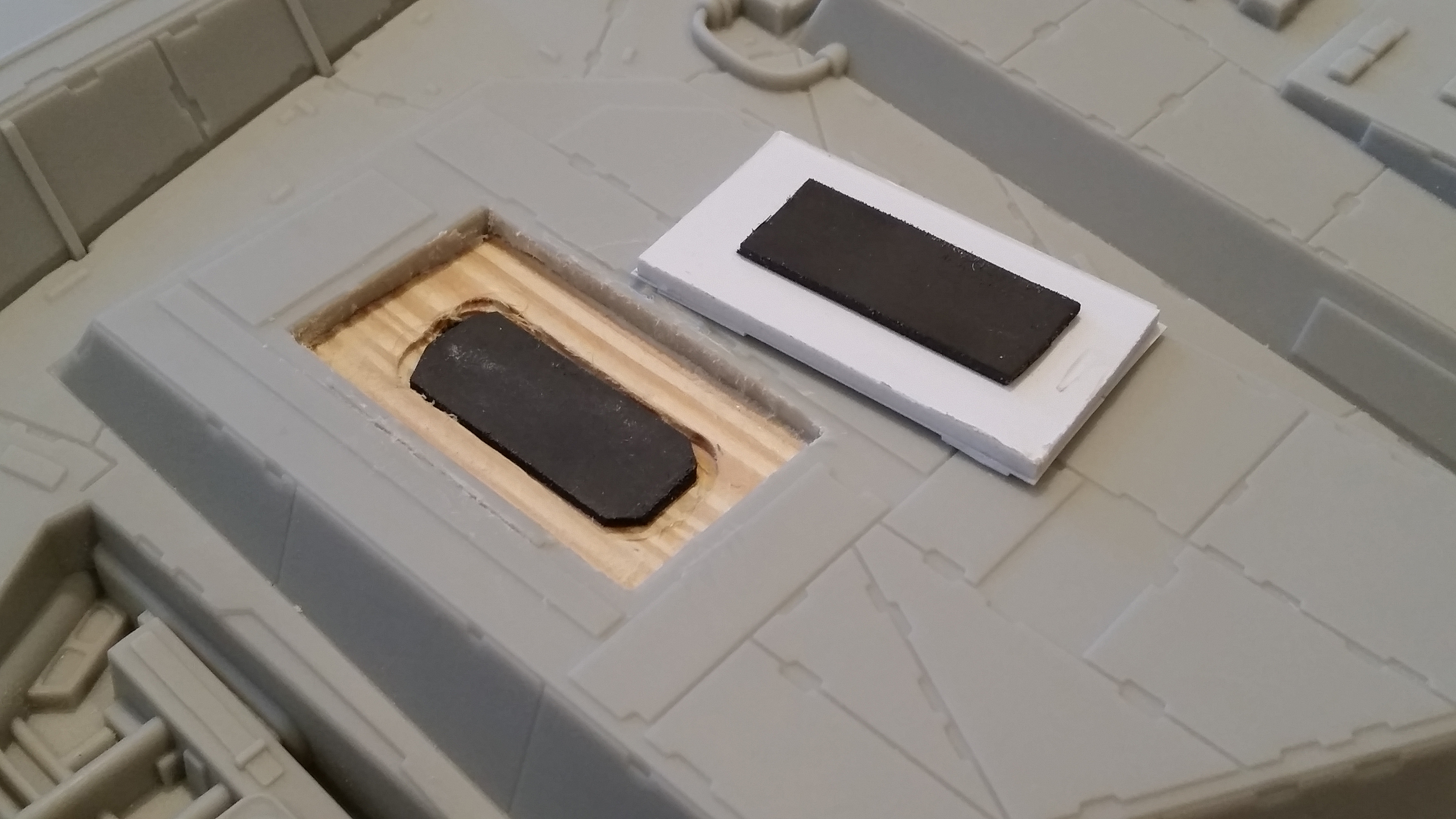

I've been working on the landing gear flaps that cover the holes left by cutting off the knobs. I started by gluing in some 1/2" wood strips on the inside. Then I used some magnets to hold the flaps on. The idea is to have interchangeable landing gear with flaps that will inset in their place. I'm hoping to purchase some created by one of our RPF members. If not, I'll build them later. The site if not letting upload photos right now (probably the dam kids sucking up band with) I will post photos later.
