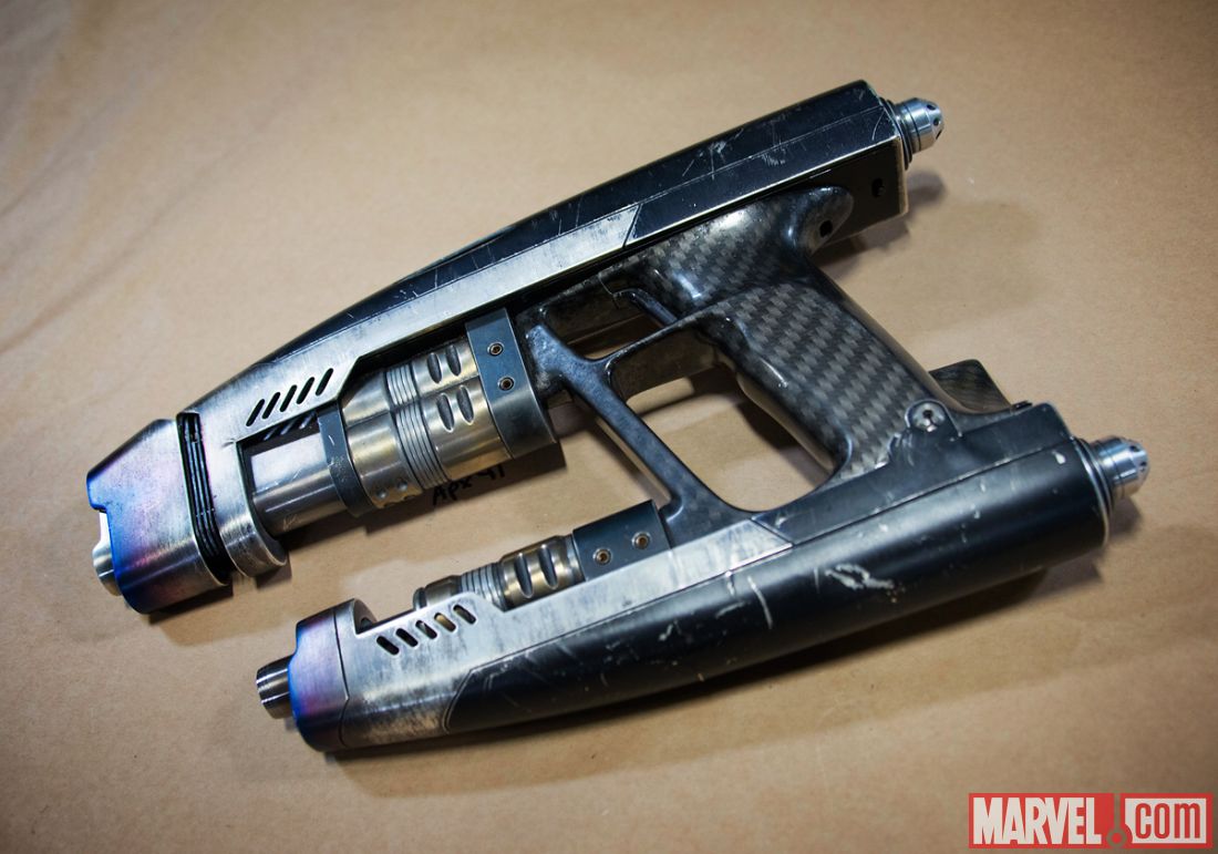

I know there are a couple models out there, but none of them had all the details that I wanted, so I decided to make my own from scratch. Luckily, Marvel put some of the screen-used props out on display, so there a ton of good reference pics that show some of the overlooked details.
For example, the cutouts on top of the gun with the metal mesh inside them, and the inner front heatsink, as seen in this pic:

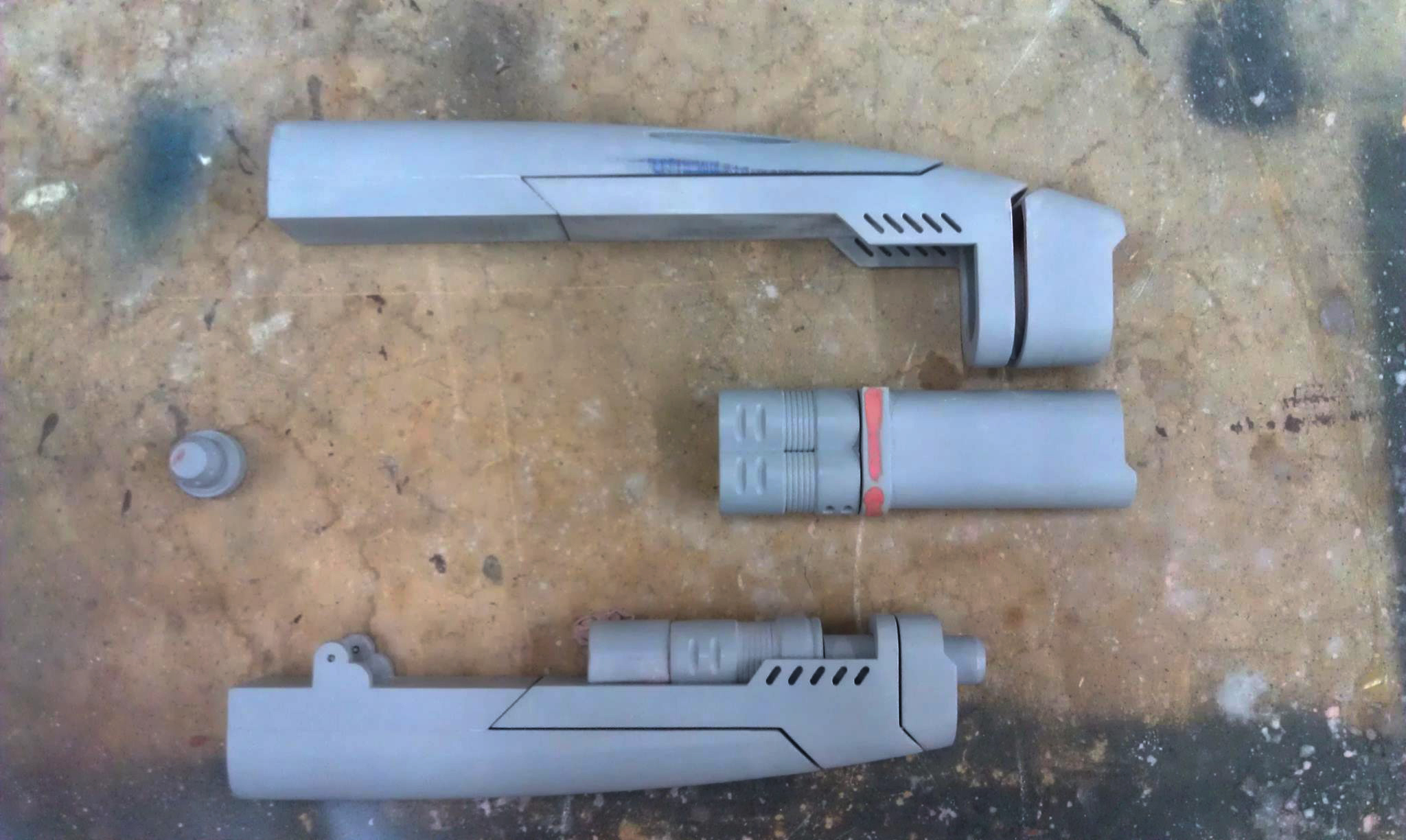

...but wait, there's more! Since I've already finalized a few of the parts, I've gone ahead and printed them:
They were printed at .1mm layer height to maximize accuracy and minimize the amount of sanding to clean them up.
After the time-honored tradition of filling, sanding, filling, sanding, filling, sanding (did I mention sanding?), and buffing, the grain is completely gone.
Here's what's done so far:
The laser housing fits perfectly into the top half of the gun to hold the front heat shield thingy in place over the heatsink, but there's no way I'm going to risk marring my beautiful polishing job for a photo before it's molded!
I had to do some fine-tuning with the model to get the tiny rings on the laser tubes to come out right, but it was worth it. With some more wet sanding and further polishing, they should have a fairly reflective shiny finish.

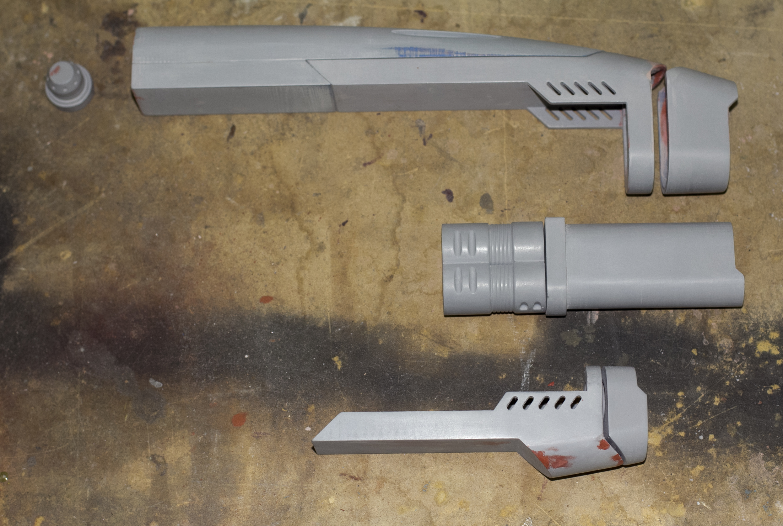

Got a few more parts finished tonight:
(cell phone pic because I forgot my camera)
Now all that's left is the grips and the back ends of the laser tubes, which are both almost done. Hopefully the masters will be completely finished and ready for molding this weekend!

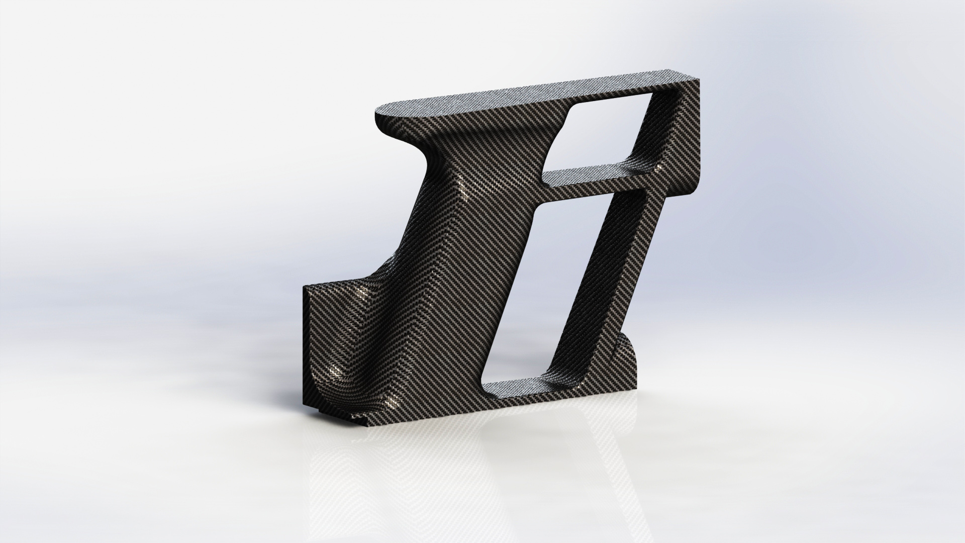

Modeling on the grip is done!
I'm still not as good with organic modeling as I'd like to be, but this will be a good base to hand-sculpt some of the fine fillets and raised edges onto.
By just eyeballing it, it looks like the grip flange has the right contour. After the test print finishes, I'll know.

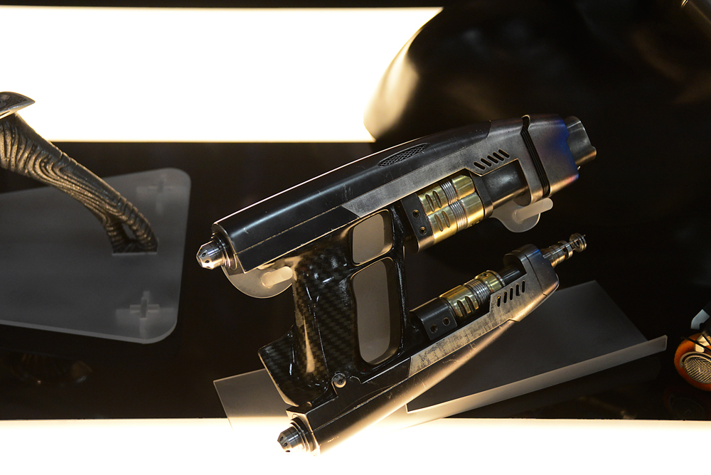

Side note: there's one more detail I haven't seen brought up. On the back of the top purple piece, there's a tiny switch:
I'm not sure if it's supposed to be the gun's safety switch, or if it was put there for production purposes to control reference LEDs or something. Based on the close-up shots from the pieces on display, the trigger is a separate piece from the grip, so maybe the originals did light up?
Your right Kevin the hole on the top of the grip (circled in green) is probably a screw for connecting the grip, but I think he is talking about the thing (circled in red) on the bottom of the top piece of the gun.
